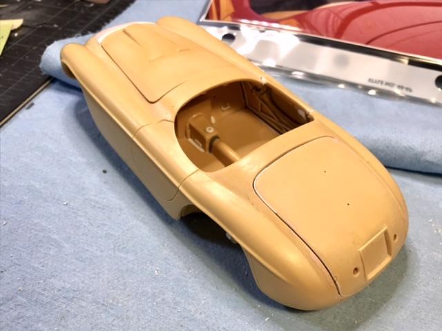

absmiami Posted August 4, 2023 Author Posted August 4, 2023 (edited) Ok. - ive got closure … IMG_2293.MOV Edited August 4, 2023 by absmiami Replacing video

absmiami Posted August 4, 2023 Author Posted August 4, 2023 It works - the trunk closes - and im learning how to d/load videos fr my Iphone - dragged kicking and screaming into the nu world … this can’t possibly end well ..

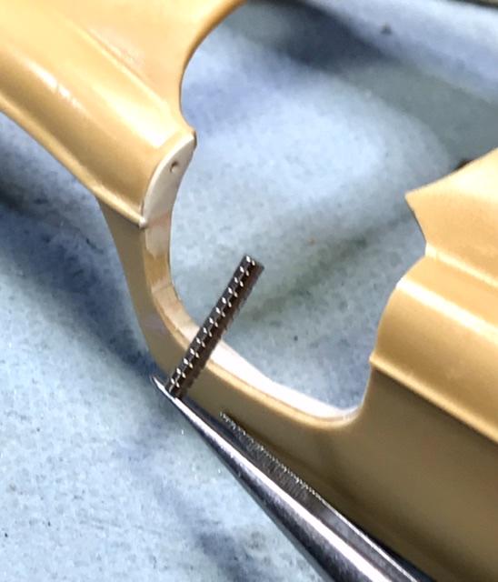

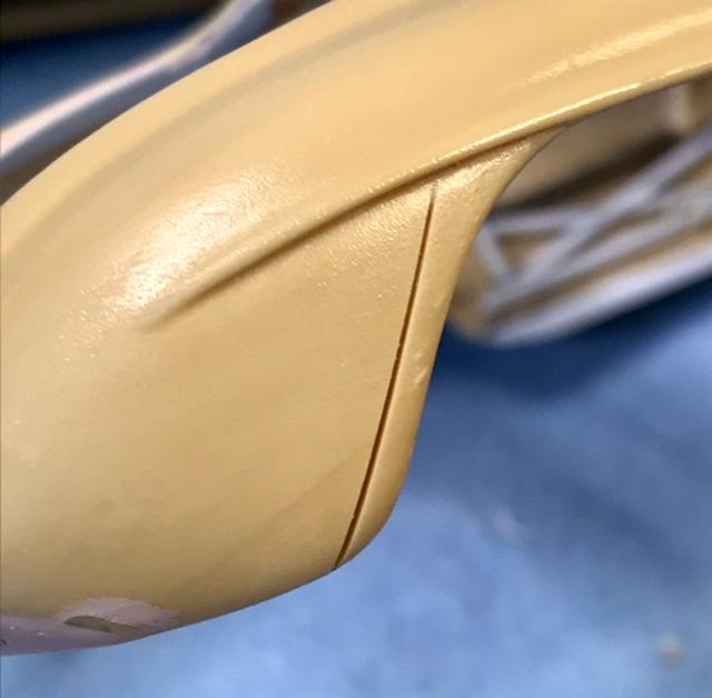

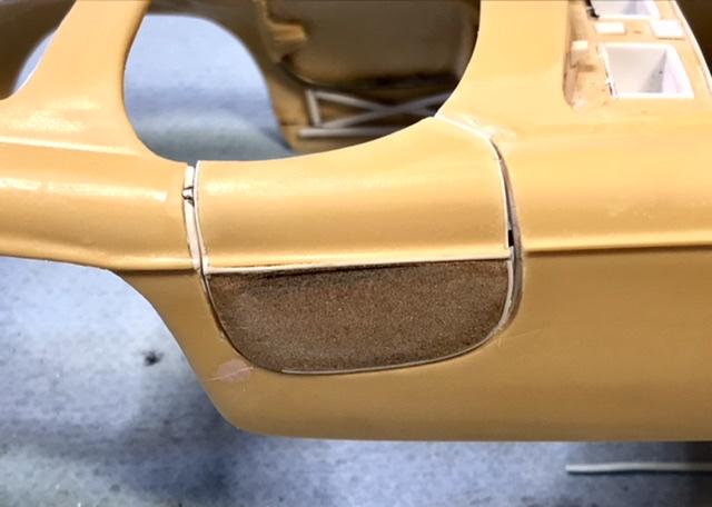

absmiami Posted August 5, 2023 Author Posted August 5, 2023 Scale Master has shown us how to use these weeny magnets - i realized that i needed them for the driver’s side door - so i hit up amazon and ordered the smallest size - which is 1 x 2 mm. First time that i had ordered something on my phone - and it actually showed up 5 days later - that can’t end well either ….

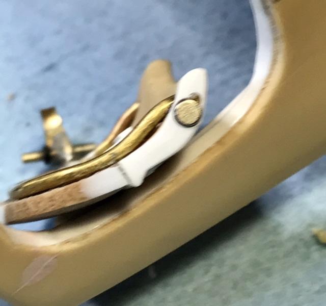

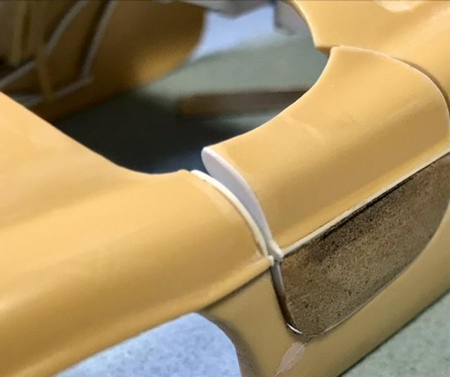

absmiami Posted August 5, 2023 Author Posted August 5, 2023 My brass hinge is strong and flexible - but this is how the door closes -
absmiami Posted August 5, 2023 Author Posted August 5, 2023 I drilled corresponding holes in the door and the body and epoxied two magnets ? - sorry couldn’t resist this emoji - my phone made me do it - the paper is in the door jam while the magnets set …
absmiami Posted August 5, 2023 Author Posted August 5, 2023 Another trim peice - and the door closes in just the right position now - that was fun - now im starting to think about using these magnets to locate the chassis to the nose of the body - ala Scale Master ‘s Lola …

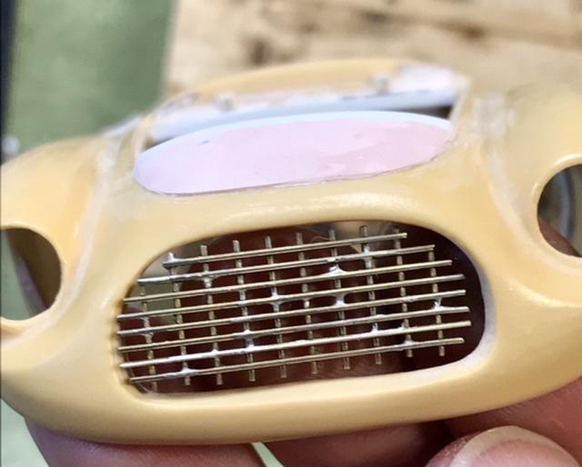

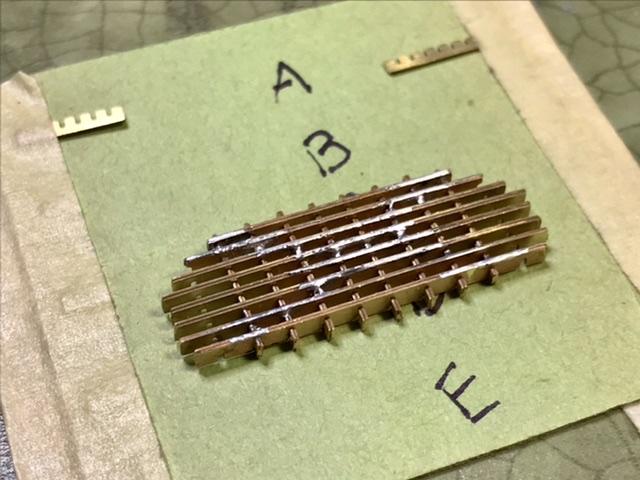

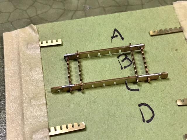

absmiami Posted August 5, 2023 Author Posted August 5, 2023 On to the grill … the photo-etch sheet containing the elements for the grill is very thick - ill measure it - very nearly scale accurate - it appears to have been made by etching top and bottom in two layers - the artwork for the photo-etch was drawn by ATL NNL forum member Jeff Edmonson - given the age of the kit - this was state of the art …
absmiami Posted August 5, 2023 Author Posted August 5, 2023 Removing the slats from the sheet was tricky - i ended up grinding away the metal on the border next to #5 and removing 5 first - then i had room to cut the others off with a small metal clipper - without bending or damage to the other elements …
absmiami Posted August 6, 2023 Author Posted August 6, 2023 Soldering some joints - don’t need to solder them all …

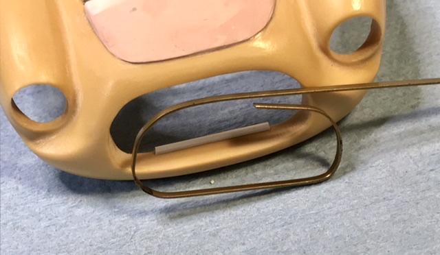

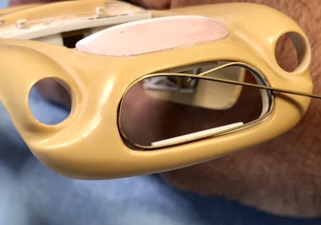

absmiami Posted August 7, 2023 Author Posted August 7, 2023 A few months ago - a few pages ago - i removed the trim around the grill to correct the shape of the radiator opening - so now i’m making a new one w a strip of annealed brass … the white peices are Evergreen meant to help locate the brass strip …
absmiami Posted August 7, 2023 Author Posted August 7, 2023 Making the brass trim is slow going because the brass “work hardens” as you go - but the grill and trim are now ready for paint - 1
Pierre Rivard Posted August 7, 2023 Posted August 7, 2023 So cool to see each builder coming up with his solution set. I would have chickened out to an Evergreen construction but real builder chooses more noble materials..like brass! Well done Andy. Looks really good.

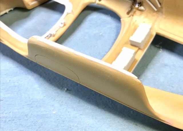

absmiami Posted August 10, 2023 Author Posted August 10, 2023 Some added Evergreen trim to close some gaps

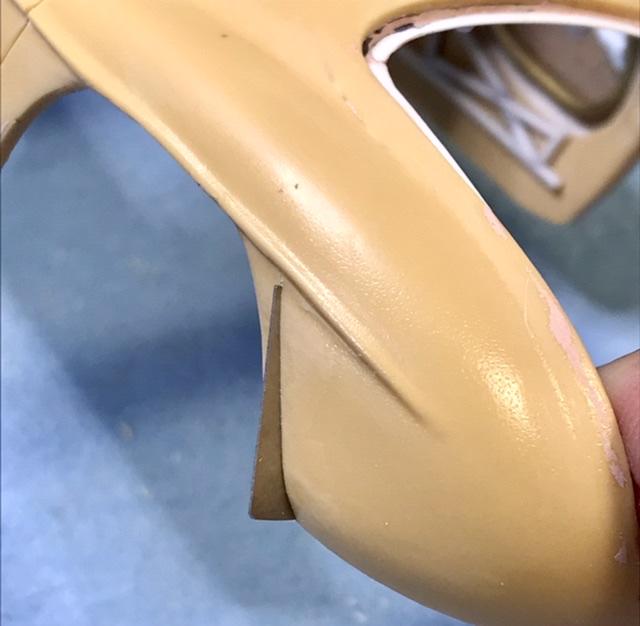

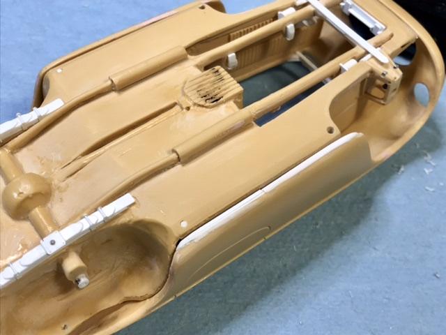

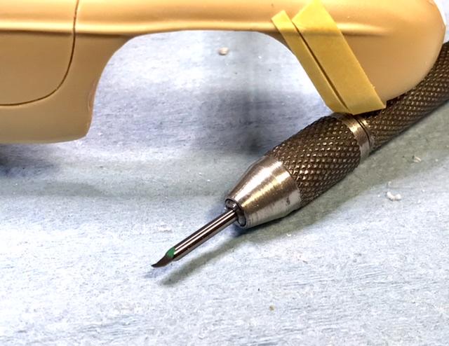

absmiami Posted August 11, 2023 Author Posted August 11, 2023 Used a .2 Tamiya scriber to cut slots for the photo-etched fender guards … 1

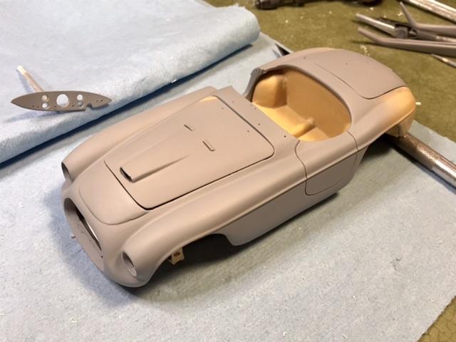

absmiami Posted August 11, 2023 Author Posted August 11, 2023 First coat of primer - Tamiya rattle can …
