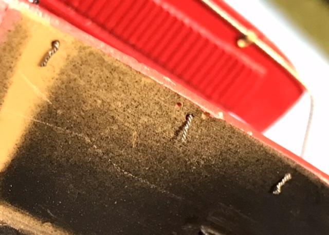

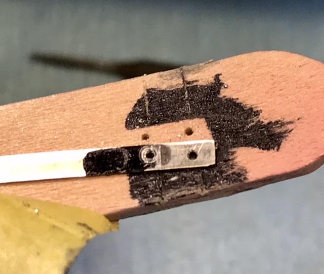

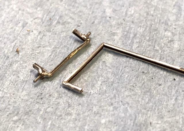

absmiami Posted August 25, 2023 Author Posted August 25, 2023 Also making the brackets from nickel silver strip …
absmiami Posted August 27, 2023 Author Posted August 27, 2023 .010 cl plastic slips into the frames …. Make the frame post handles and they’re done …

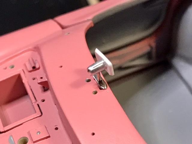

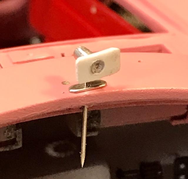

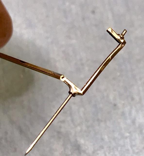

absmiami Posted August 27, 2023 Author Posted August 27, 2023 The kit had a white metal racing mirror - but it was a little small - so i made this one with a pin squeezed into a short length of alu tube - glued into the plastic mirror back plate - ill use a polished peice of nickel silver for the mirror … 1
Gramps46 Posted August 27, 2023 Posted August 27, 2023 Your fabrication skills are amazing. Inspiration for us fumble fingers.

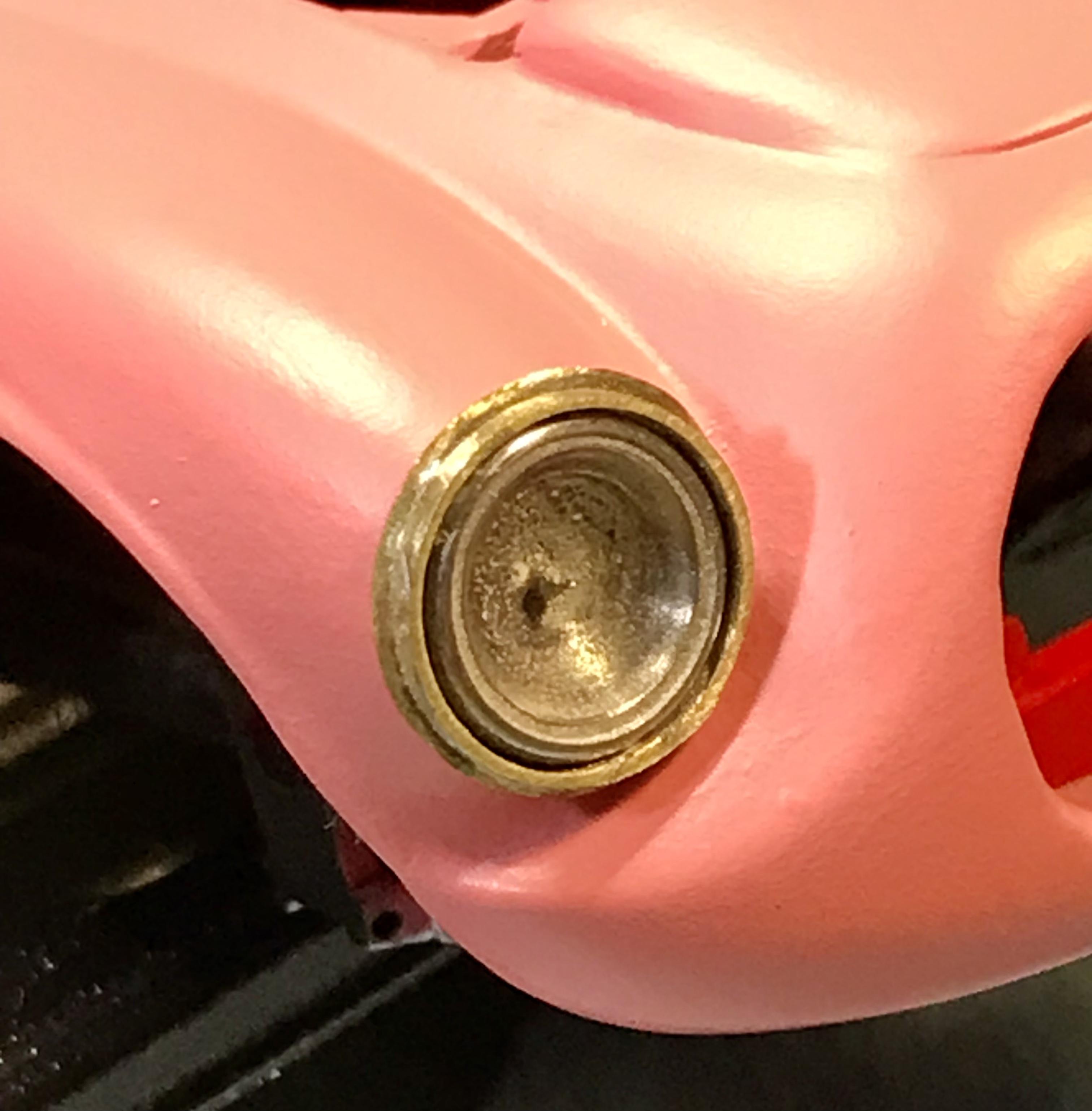

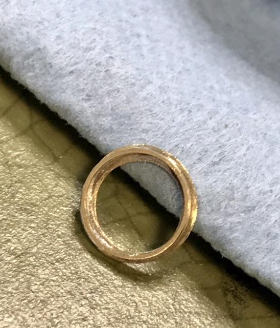

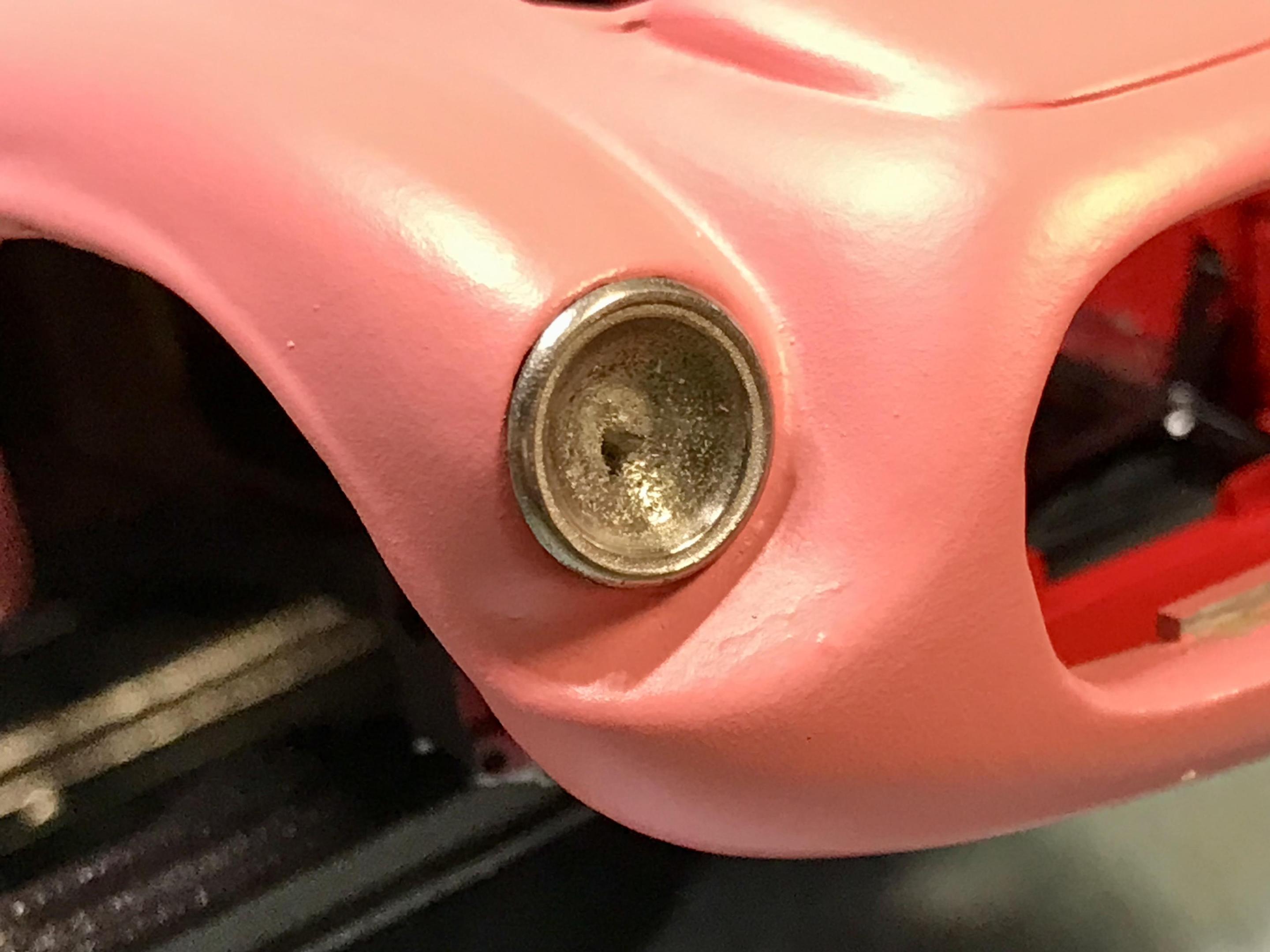

absmiami Posted August 27, 2023 Author Posted August 27, 2023 Gracias .0010 was restored w headlight screens - were probably used in the Spa race …

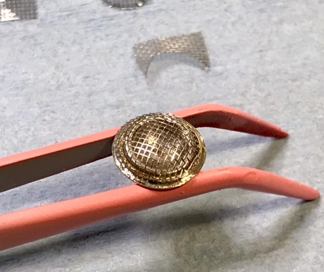

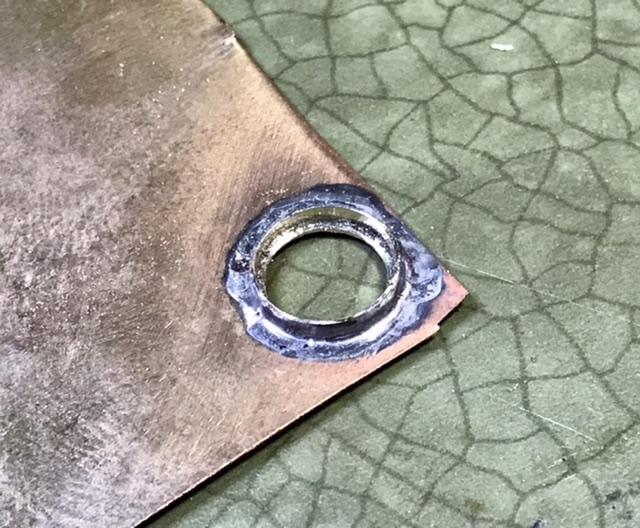

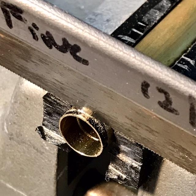

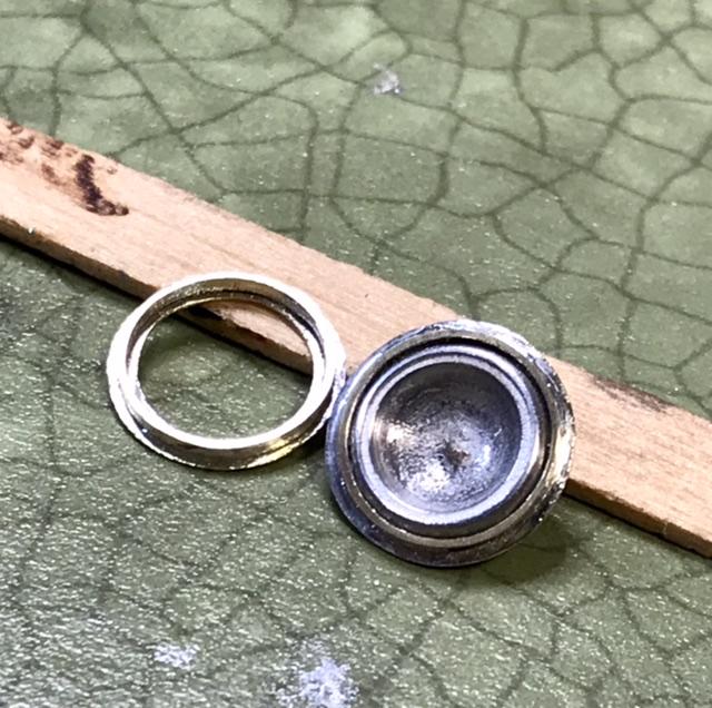

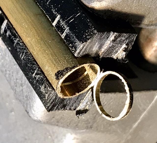

absmiami Posted August 27, 2023 Author Posted August 27, 2023 Found a length of brass tube that is the correct diameter - the bezel that seats the screen has to fit tightly around the headlight shell - cut 2 rings and soldered them to .010 brass sheet to make the parts … 1

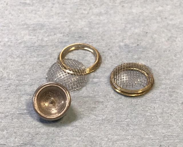

absmiami Posted August 27, 2023 Author Posted August 27, 2023 Found some photo-etched screen that is fine - so the headlights will still be visible - put i got to make a part to stamp/shape the screen
Straightliner59 Posted August 28, 2023 Posted August 28, 2023 Wonderful fabrication, Andy. Isn't it great, not to be afraid of working metal?? It opens up an entire world of possibilities. For future reference, you might want to look into "Silver Screenz". I used them for the screens on this Corvette (which I'll get back to, once the dragster's done). They're made for certain recreational pipes, but the wire is very fine and the weave fairly open, allowing excellent visibility of the lights, behind. Although I may or may not frequent a dispensary, now and again, I found these, online, looking for screens for this car. 2

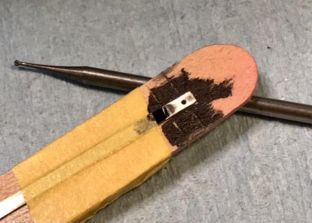

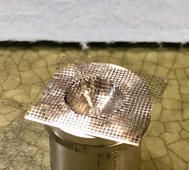

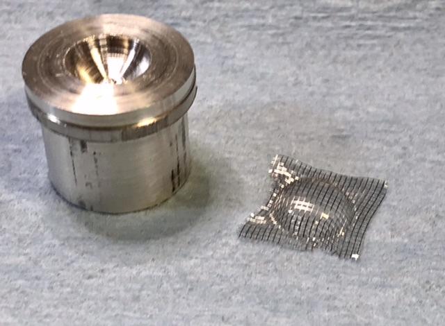

absmiami Posted August 29, 2023 Author Posted August 29, 2023 Here’s the screen i’ve chosen - Acu-stion made some nice accesories - but they haven’t been active in years - this screen was used because it’s relief etched on one side - with a weave effect - 1

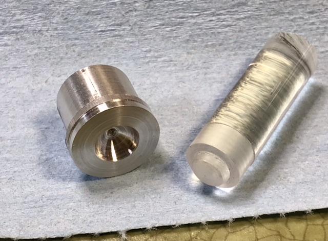

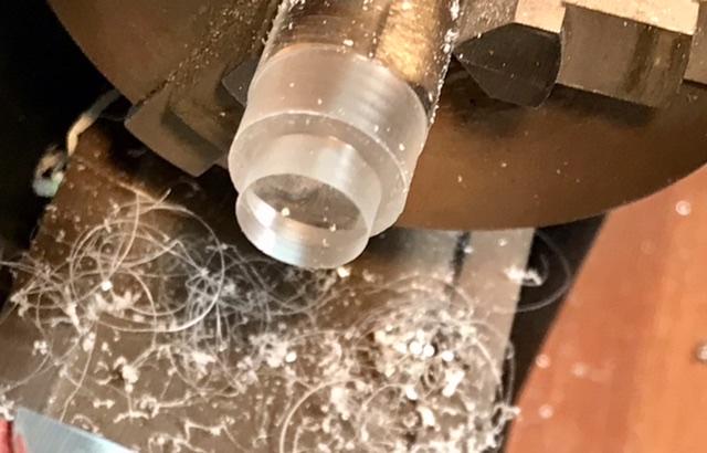

absmiami Posted August 29, 2023 Author Posted August 29, 2023 The screen will be a stamping - using this stamp / die thingy that was turned on the Sherline …
OldNYJim Posted August 29, 2023 Posted August 29, 2023 2 minutes ago, absmiami said: The screen will be a stamping - using this stamp / die thingy that was turned on the Sherline … Clever! So much masterful work to enjoy in this thread! 1

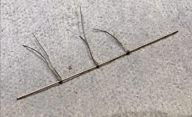

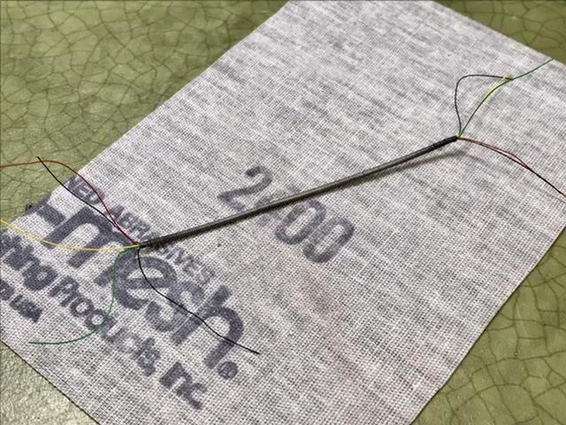

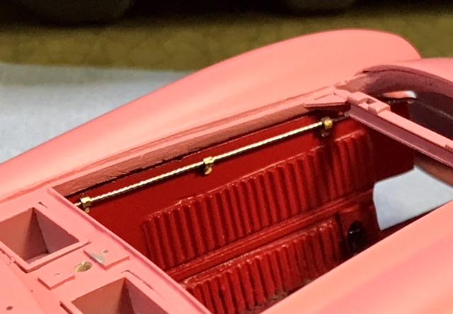

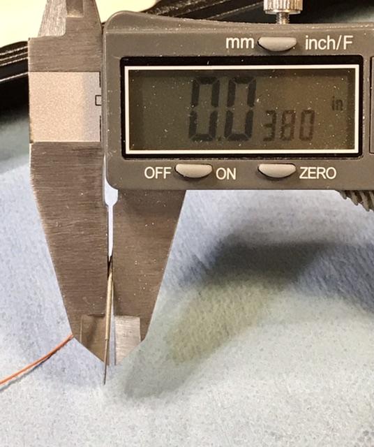

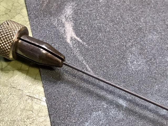

absmiami Posted September 1, 2023 Author Posted September 1, 2023 Working this week on some shielded lines …. The trunk has one for the light wires- these run to the tail lights and the trunk supplemental lights - squeezed 5 .0075 wires through the shielding - wanted 6 - # 6 wouldn’t fit - the shielding is .0085 steel wire wrapped around and around and around a length of .022 brass tube … scalemaster showed us all how to do this on his L O L A Lola ….

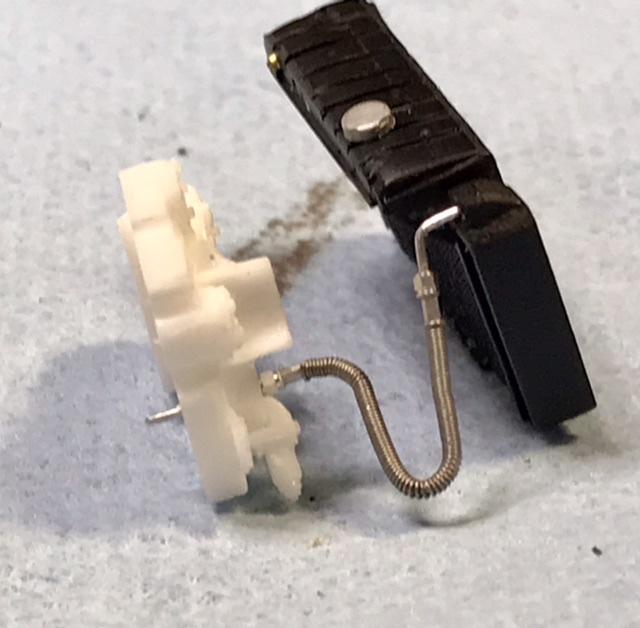

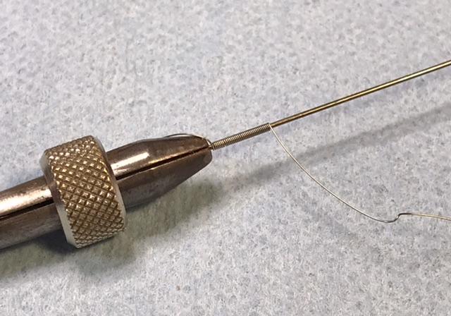

absmiami Posted September 1, 2023 Author Posted September 1, 2023 Shielded oil lines in the eng bay - running in and out of the oil radiator - the line is aluminum .050 wire - shielding is wound with .0075 steel wire - w RB Motion fittings …. Nice and flexible … 4

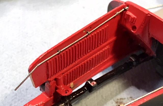

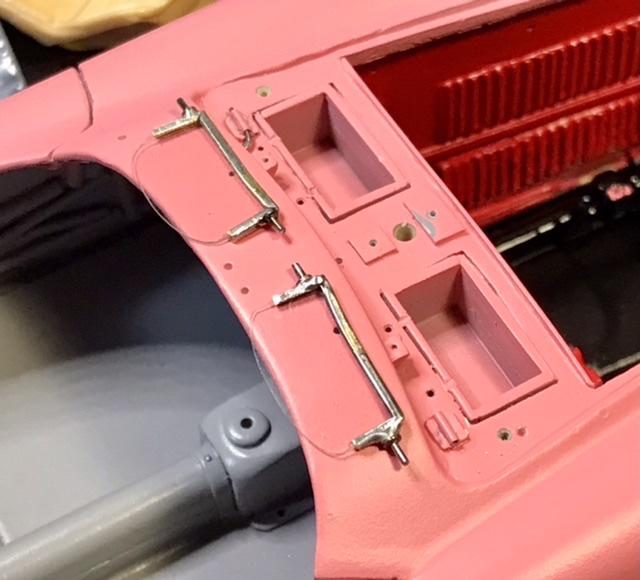

absmiami Posted September 5, 2023 Author Posted September 5, 2023 Rattlecan : humbled back to eng bay - the shielded lines that run from the bulkhead left and right forward are painted metal wires that are model railroad accesories - they are tied to the panels with wire on the right side - leaving room for the bonnett brace - the left side wire runs thru metal clips made from pins and soldered nickel silver …
absmiami Posted September 5, 2023 Author Posted September 5, 2023 These lines carry the headlight and fog light wiring - pretty sure
