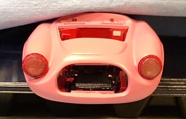

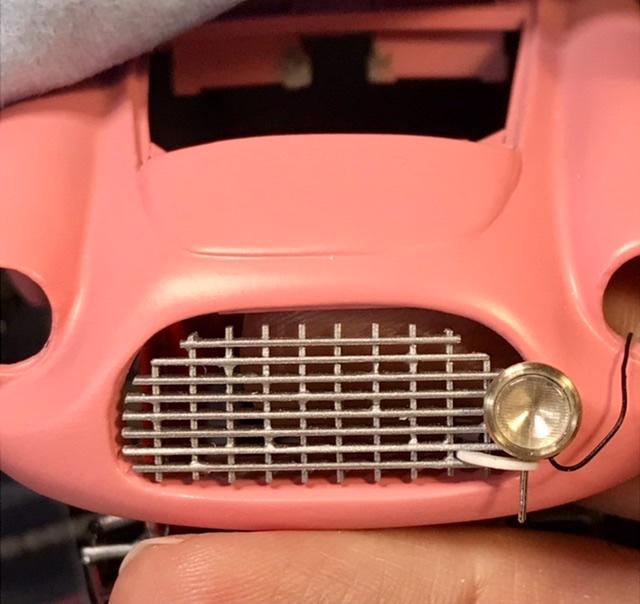

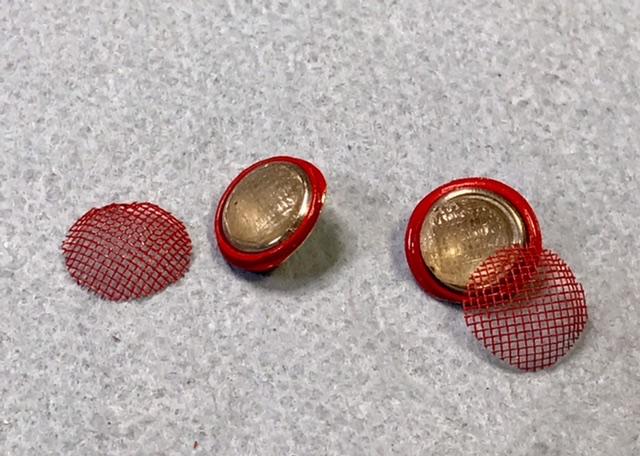

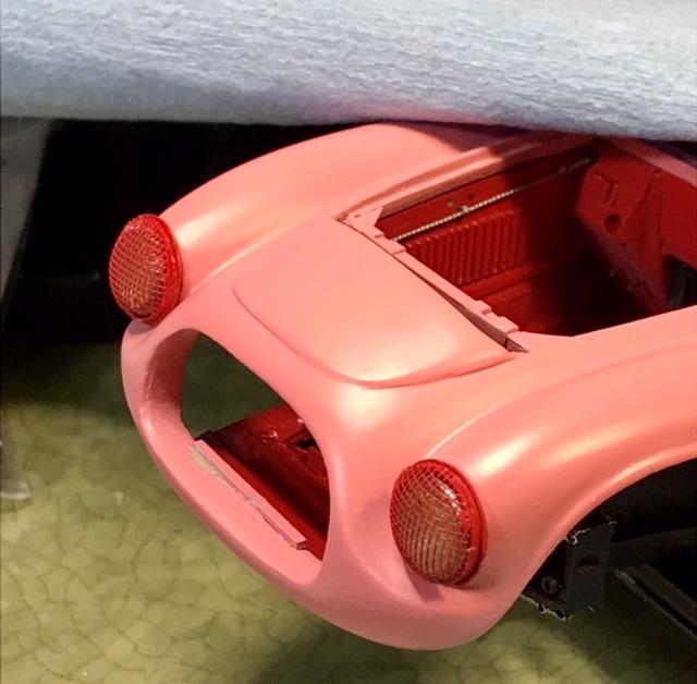

absmiami Posted September 6, 2023 Author Posted September 6, 2023 Barbie has headlights - the shells and screens were painted T italian red and then glued together w CA - the screens were hard to glue - but the CA should secure them … 1
absmiami Posted September 6, 2023 Author Posted September 6, 2023 (edited) .0010 had two fog lights - the kit has just one center mounted - thats correct for .0008 so i’ve ordered some 3/8 nickel silver to make two foggers … Edited September 7, 2023 by absmiami
absmiami Posted September 6, 2023 Author Posted September 6, 2023 Gotta paint a white border around the radiator opening - thats tricky - but think i should paint this before painting Barbie red …
Pierre Rivard Posted September 7, 2023 Posted September 7, 2023 Wondering if pink bleeds through like red. You might have to do a silver layer before the white. The headlamp screens are seriously good. Can't wait to see the engine come together with the detailing.

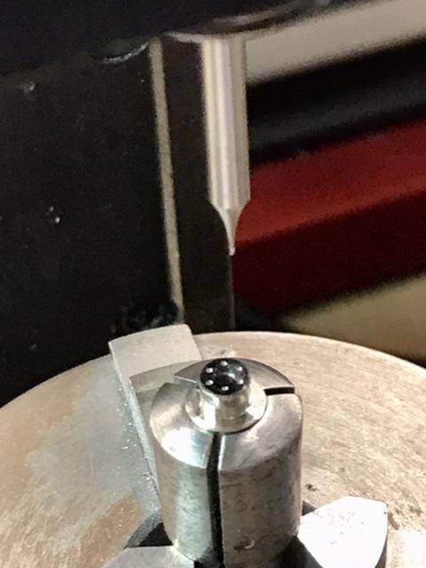

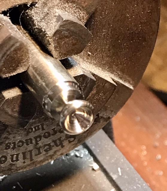

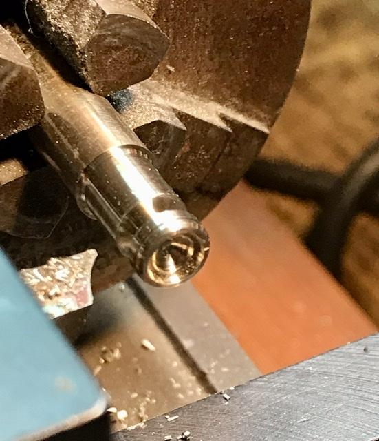

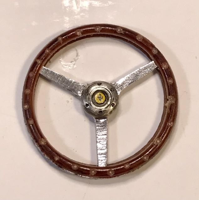

absmiami Posted September 11, 2023 Author Posted September 11, 2023 The steering wheel has a boss in front and a collar behind - nickel silver on a Sherline lathe and mill …
absmiami Posted September 11, 2023 Author Posted September 11, 2023 The kit decal sheet has an emblem for the st wheel - but its too large - i replaced it w a decal from an old stash of 43rd sc markings .. and i marked put some dimples for some paint to represent the rivets on the rim … 1

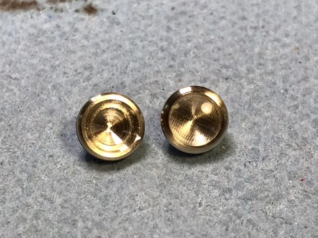

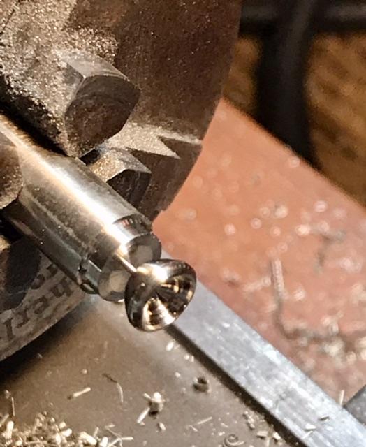

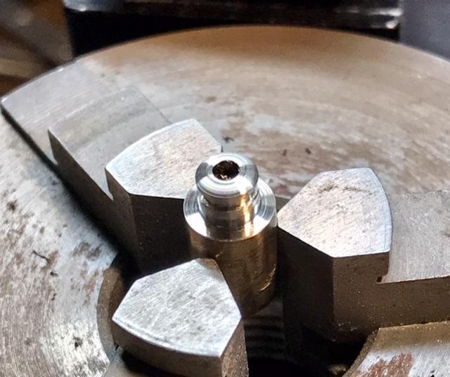

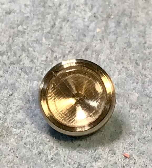

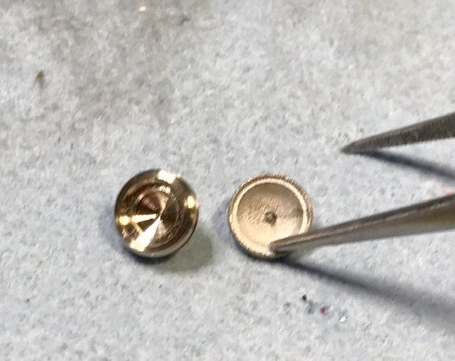

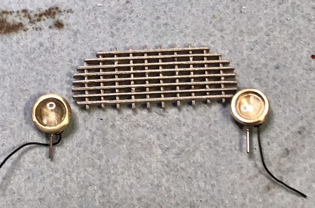

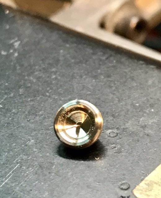

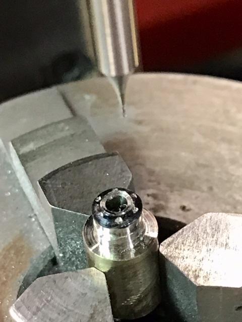

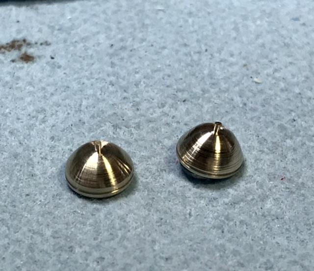

absmiami Posted September 12, 2023 Author Posted September 12, 2023 The kit fog lamp is center mounted on the Lemans winner - my car has left and rights - so i turned two on the lathe - same diameter as the kit part - but deeper - bout 3.5 scale inches … 1
absmiami Posted September 12, 2023 Author Posted September 12, 2023 Nickel silver bar - left the tips on after parting - they will help me secure the lamps in a vice to mill holes for the lamp wire - and the attachment posts …
Straightliner59 Posted September 13, 2023 Posted September 13, 2023 Those lights are gorgeous. Excellent work!

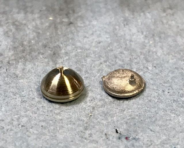

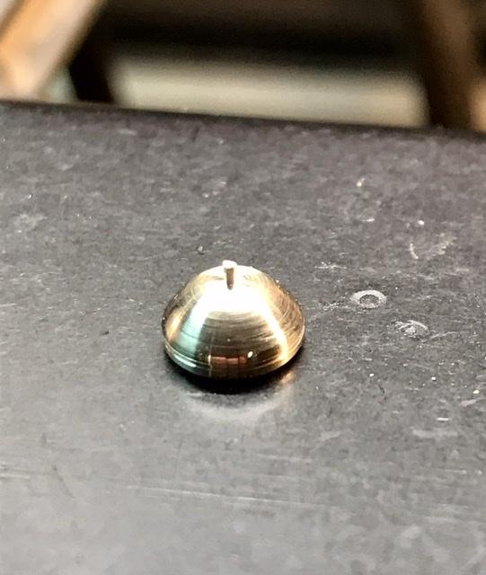

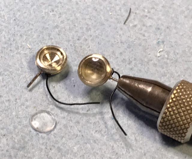

absmiami Posted September 15, 2023 Author Posted September 15, 2023 Posts soldered to the lamps and lamp wire added … now ill make the brackets that support the lamps ..

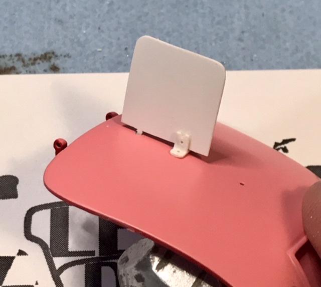

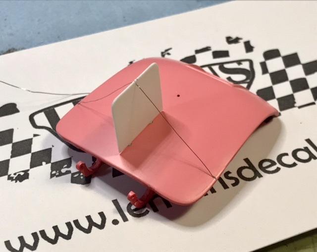

absmiami Posted September 15, 2023 Author Posted September 15, 2023 The postal sevice brought something cool yesterday …. lemansdecals.com makes the markings for 0010 at Spa - how great is that ? With these - i can trim and size the vertical number placard that was wired To the tail - but if you’re tempted to build the Spa winner - note you will need two decal sheets …. The numbers on the sheet are an unusual design - correct for .0010 - and you won’t find a matching number font - i was not looking forward to free-handing these … now i can prime the placard …

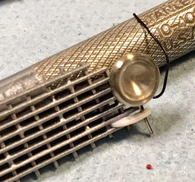

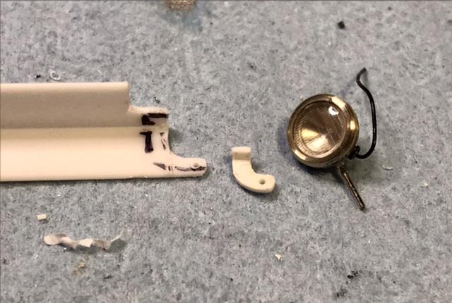

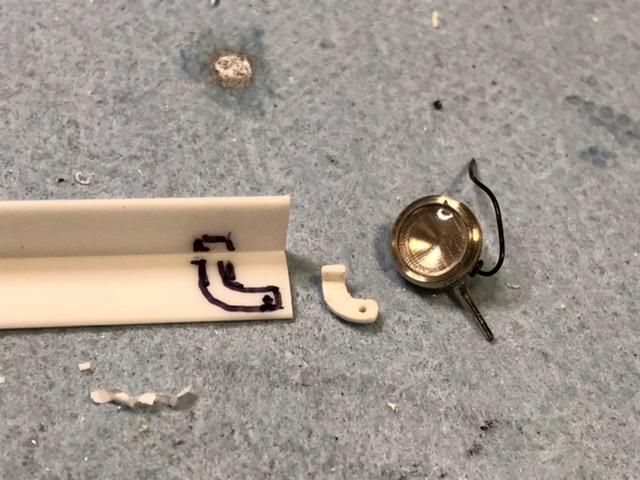

absmiami Posted September 17, 2023 Author Posted September 17, 2023 Carlos Sainz Jr broke his Ferrari duck last nite - so this progress report is offered in his honor - the fog lamps are held out in front of either side of the grill by a curved bracket - first one was too small … made fron L shape angle Evergreen - the next two were just right … Singapore sling … 3
