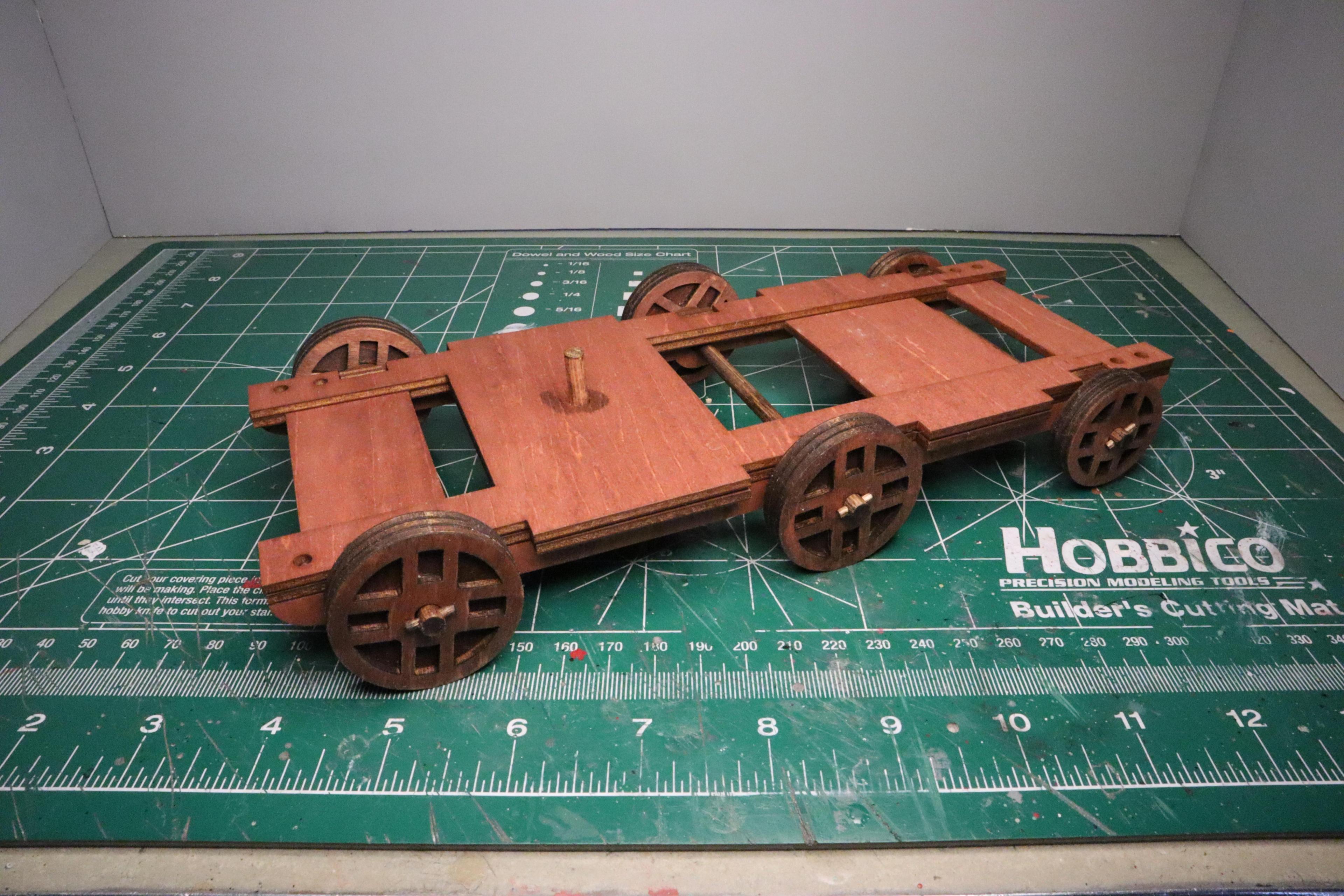

David G. Posted December 8, 2021 Author Share Posted December 8, 2021 (edited) Hello Everybody! The first assembly step is building the side rails. The directions don't call for gluing these but even when mated to the platform pieces, there is no positive connection that holds them together. There is no adhesive included in the kit so I'll be using Zap Canopy Glue Formula 560. Any of the thicker PVA based adhesives should work as well. If you should decide to glue these together, be mindful when gluing the axle grommets to the rails. The rails definitely have a left side and right side. Or inside and outside depending on how you want to regard them. I almost got caught on this one! I also glued the lower deck and the rails together and set them to cure. After about half an hour, I decided to check on the assembly and found that it had developed a twist of about 1/8 of an inch. I didn't get a photo of the twist because my mind went into panic mode and immediately locked on fixing the problem. I sprayed the chassis... deck?... hull?.. superstructure?... with a light misting of water, shimmed up the contacting wheels, applied some weight and waited overnight. That took care of it. Here's one quick bonus tip: To symmetrically align the spokes on the sides of the wheels during assembly, align the attachment points that held them to the frame. As always, thanks for taking the time to look and please feel free to comment. David G. Edited December 14, 2021 by David G. Quote Link to comment Share on other sites More sharing options...

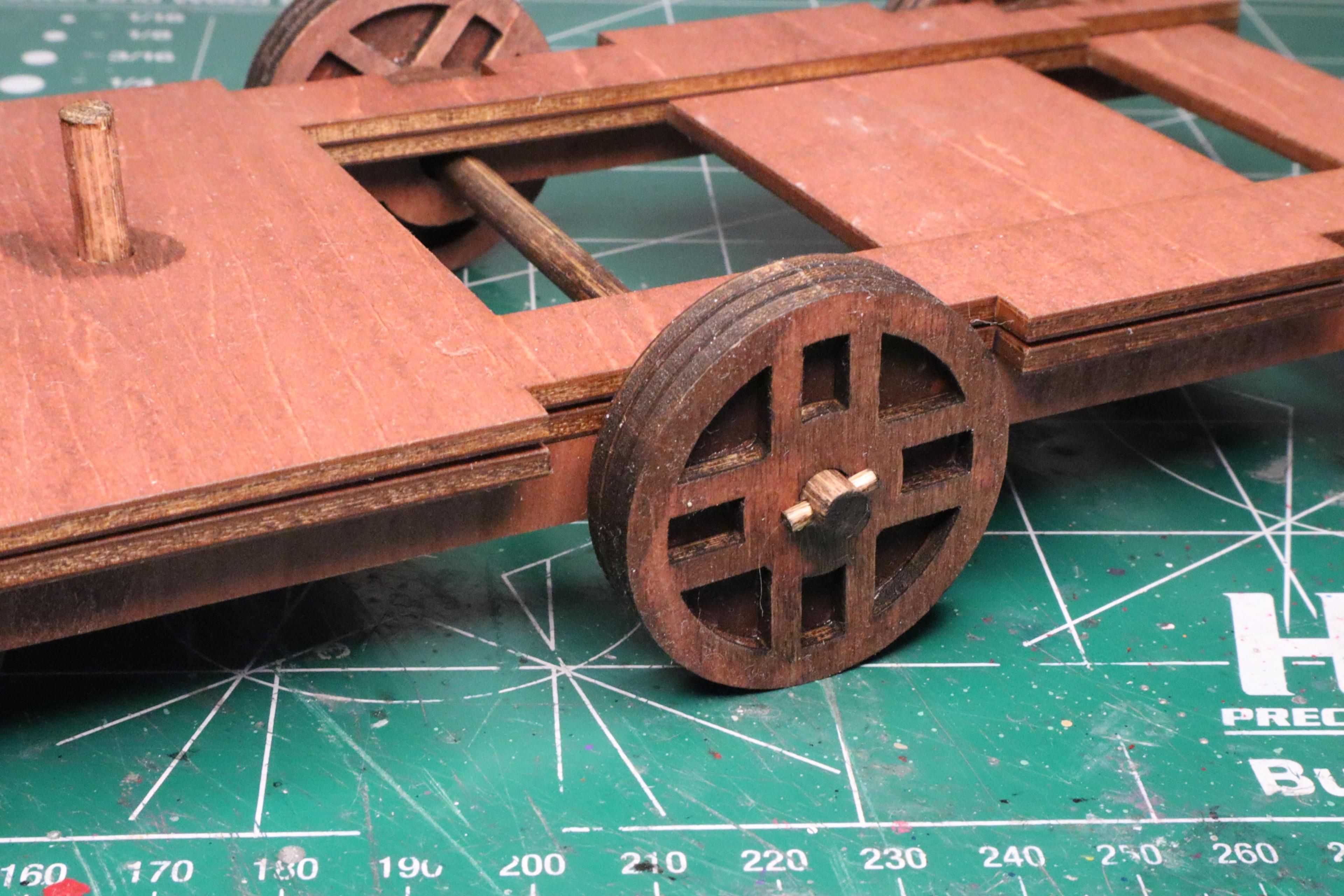

David G. Posted December 14, 2021 Author Share Posted December 14, 2021 Hello Everybody! Just a quick update on the Super Trebuchet. Wheels Down! The directions called for the wheels to be glued directly to the axles. Unfortunately, there was too much space between the wheels and axle shafts for any type of adhesive to bond properly so I secured the wheels in a more prototypical fashion. With linchpins! I drilled the axle shafts (5/64" I think) then trimmed wooden toothpicks to an appropriate length and inserted them. And since they're held in place by friction, there's no need for glue! I think this looks better too. As always, thanks for taking the time to look and please feel free to offer any comments or suggestions. David G. Quote Link to comment Share on other sites More sharing options...

David G. Posted December 19, 2021 Author Share Posted December 19, 2021 Hello Everybody! In getting ready to assemble the main deck, I discovered more warpage. This makes two of the two main structure pieces that have had a significant warp. As this is really the first wooden model I've built, I don't know if this is unusual or just the nature of the beast. I was able to "weight it out"... for the most part. The main frame uprights were composed of four parts per side and were assembled lamination style. Thankfully, they were straight and mostly square with the deck when assembled. I think there will be enough flexibility to allow for some tweaking if it needs to be trued up as assembly proceeds. And still, the warp. 😕 The wide tolerances of the design seem to allow for some variation so I don't think it will be much of a problem. As always, thanks for taking the time to look and please feel free to comment. David G. Quote Link to comment Share on other sites More sharing options...

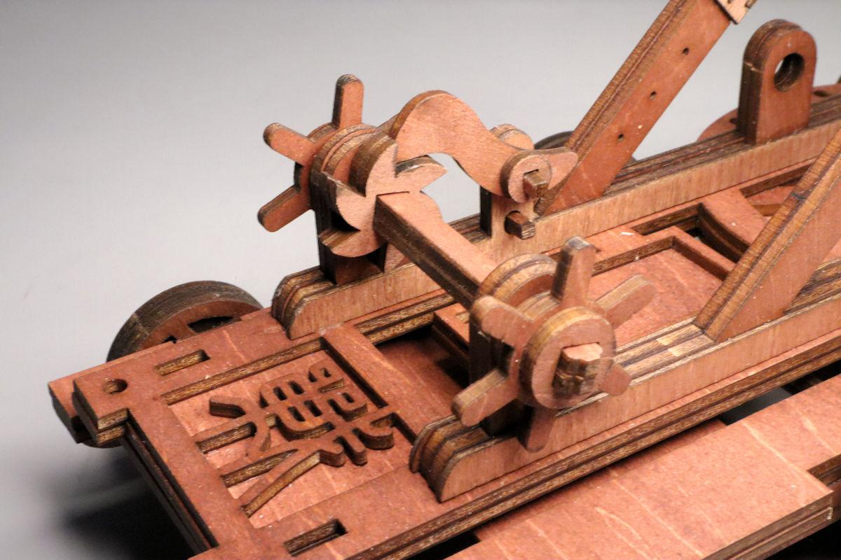

David G. Posted December 23, 2021 Author Share Posted December 23, 2021 Hello Everybody! Here's the next bit of advancement on the Trebuchet. The winch assembly with its ratchet and pawl is complete. I also added the support gussets, which are mostly cosmetic. But they do add some visual interest to the model. Thanks for stopping by for a visit, always feel free to comment. David G. Quote Link to comment Share on other sites More sharing options...

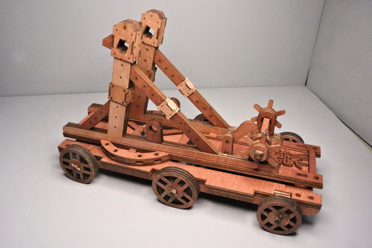

David G. Posted December 24, 2021 Author Share Posted December 24, 2021 Hello Everybody! The building work on this one is complete! All I have to do now is run the rigging and add the finishing touches... and get some photos. I'll have to find an alternate location for the completion photos. This machine is just a little too big for my picture box. As always, thanks for taking the time to look and please feel free to comment. David G. Quote Link to comment Share on other sites More sharing options...
