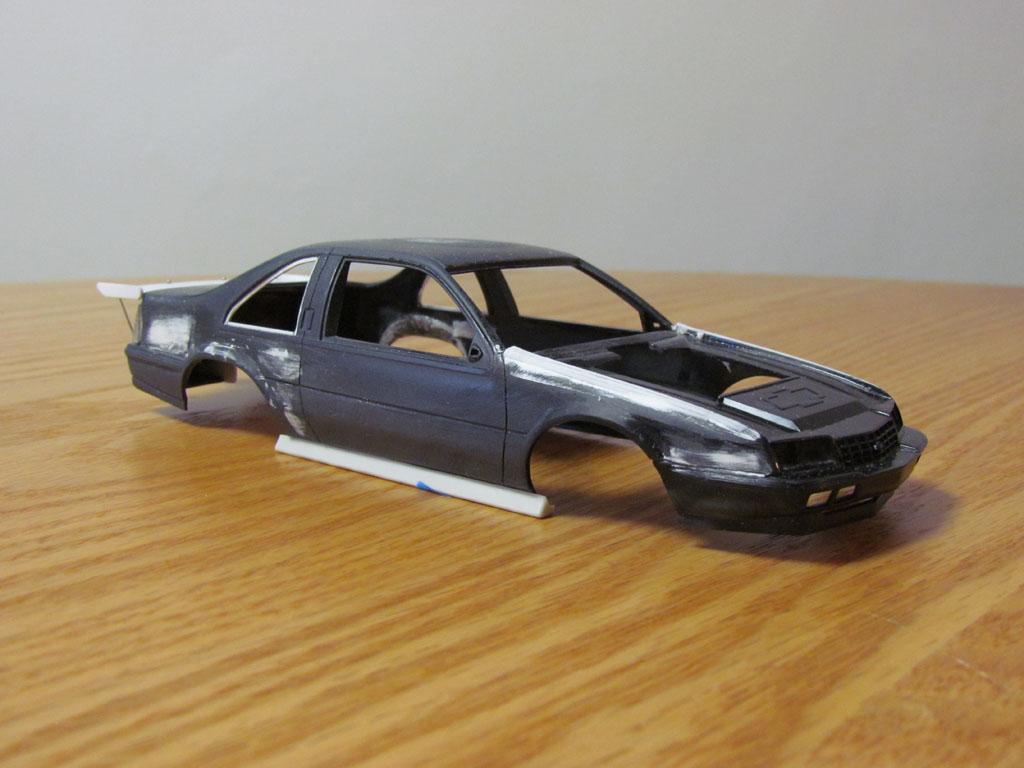

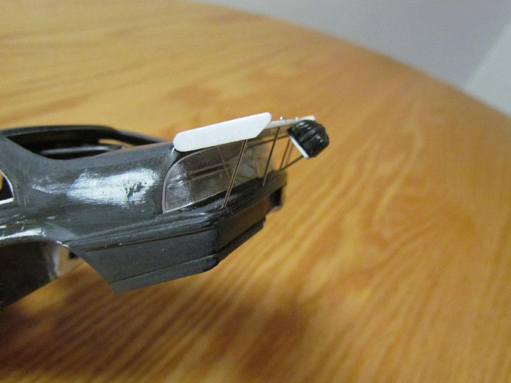

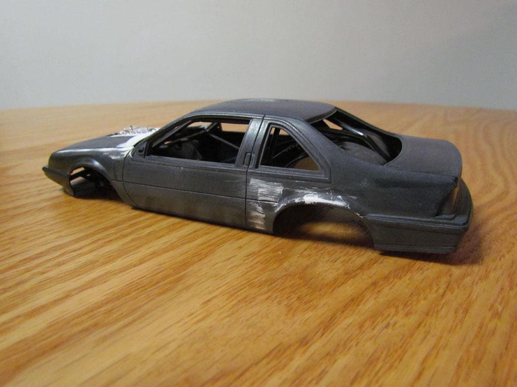

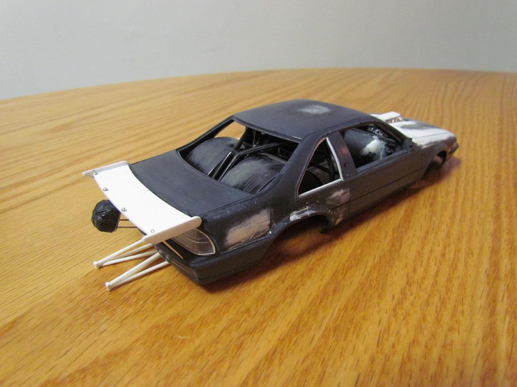

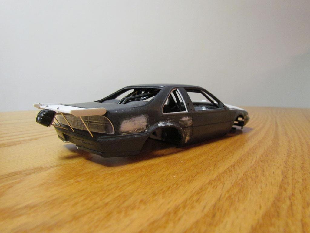

crowe-t Posted January 29, 2022 Posted January 29, 2022 (edited) I needed to paint a body to test some new clear. I have a few Revell Beretta Pro Street kits so I decided to build one. It was supposed to be an out of box build but I got a little carried away. lol The Revell Beretta body is basically a stock Beretta. I enlarged the rear wheel openings 5 mm so it would look like a Pro Street car and I extended the hood and fenders back towards the windshield and removed the hood scoop. The blower is from a 68 Corvette kit. The rear end was goofy since there is no suspension so I took a spare 9 inch rear's housing and scratch build a 4 link and wheelie bars. The wheelie bars are more of a Pro Mod design but due to the small diameter styrene rods(1.2 mm) the cage design gives it strength. I also didn't have any 1.6 mm styrene rods so I made due. I thought it needed a rear wing so I made one from some sheet styrene. I'm holding it in place in the picture with a pair of tweezers. This kit has a Lenco which isn't too realistic for a Pro Street car so I ordered a resin Turbo 400 for it. This is about all the modifications I'm doing on this one except I might make the rear quarter windows a bit larger. The quarter window frames on this kit are too wide and make the windows too small. Here's some progress pictures. Edited January 29, 2022 by crowe-t 1

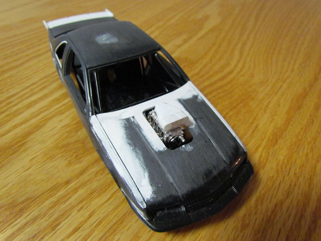

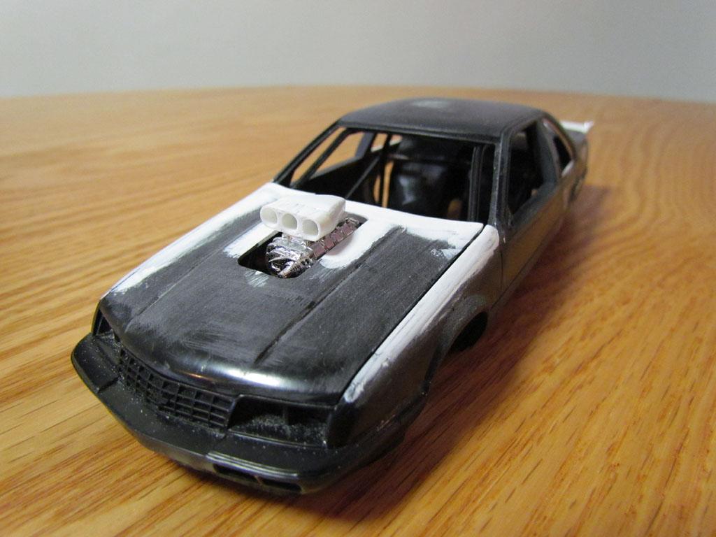

crowe-t Posted February 3, 2022 Author Posted February 3, 2022 (edited) I installed three 1 mm brass rods into the wing to attach it to the rear deck and used straight pins for the four supports that go into the bumper. I used the kit's parachute which I made a bracket for and also used straight pins. The fenders and hood are raised up slightly towards the windshield and the rear quarter windows are opened up which I feel looks more accurate to a real Beretta. This kit doesn't have a Beretta dash board. The dash board in the kit is basically a flat top piece which has a large gauge panel that goes underneath. I'm not using the gauge panel so I started building a Beretta dash board. It's rough but I'll clean it up and add some details. I had to file down some of the inside of the transmission tunnel to fit the Turbo 400 so I added some .75 mm styrene sheet to the sides. I think it actually looks better now that it's wider. I attached the front of the chassis rails in the engine compartment and added some supports. I'll be painting the chassis rails and roll cage the body color. After these are painted I can glue the roll cage in. The interior will have dark gray door panels, seats and dash board and possibly red carpeting on the floor. I'm not sure if I'll spray the transmission tunnel and rear wheel tubs in polished aluminum or use carbon fiber decals. What do you all think? I cut out the front of the belly pan to accommodate the Turbo 400's pan. It's larger than the Lenco but I made it fit. I started making a tunnel in the rear of the underbody for the wheelie bars. Thanks for looking in and comments are welcome. Edited March 28, 2022 by crowe-t

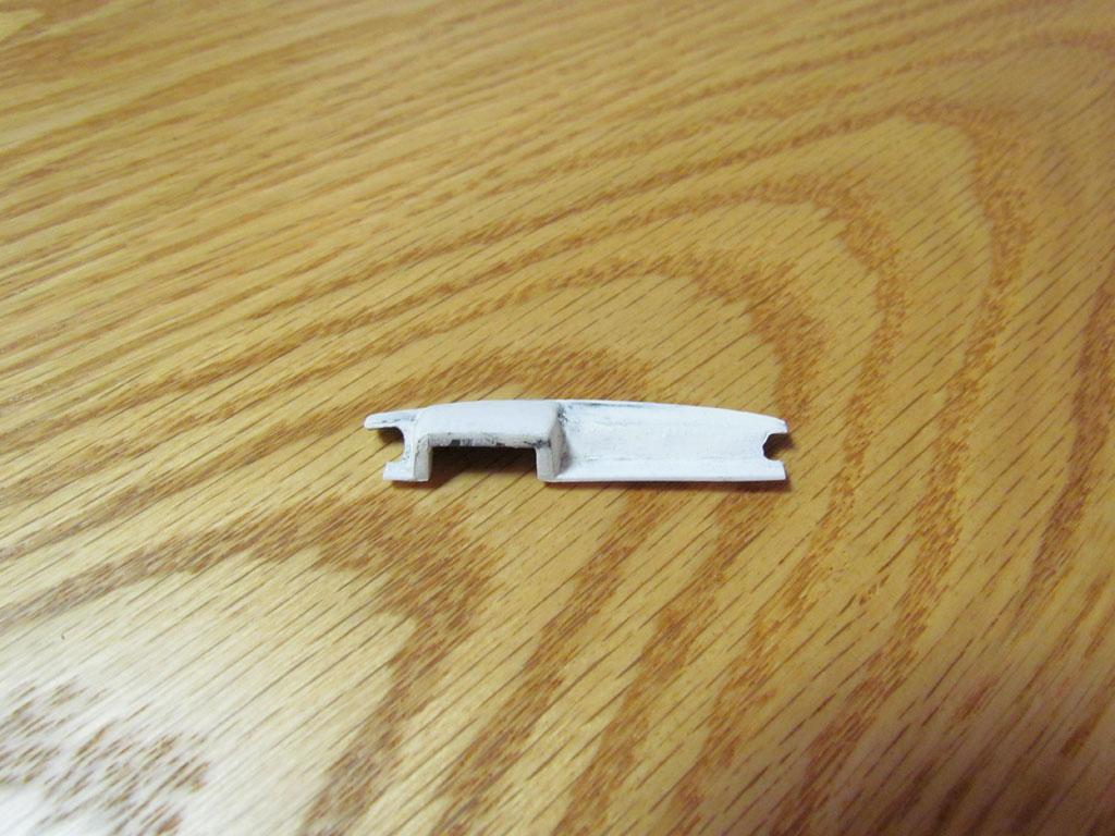

crowe-t Posted February 4, 2022 Author Posted February 4, 2022 What do you guys think, ground effects or no ground effects? The part I taped on for the picture is from an MPC Beretta GT kit but it's too long. It's even too long for the MPC body which has the same wheelbase as the Revell body. I started scratch building an Enderle bug catcher injector scoop.
NYLIBUD Posted February 4, 2022 Posted February 4, 2022 1 hour ago, crowe-t said: What do you guys think, ground effects or no ground effects? The part I taped on for the picture is from an MPC Beretta GT kit but it's too long. It's even too long for the MPC body which has the same wheelbase as the Revell body. I started scratch building an Enderle bug catcher injector scoop. Yea go with the ground effects.I guess U would just have to trim the sides,and I think it would look cool.
Cool Hand Posted February 5, 2022 Posted February 5, 2022 Excellent re working of a kit to suit your vision.
Spottedlaurel Posted February 5, 2022 Posted February 5, 2022 Great work. I'd say no to the side pieces, just try and get the unmodified body sitting as low as possible. Comically small gap between the rear arches!
crowe-t Posted February 5, 2022 Author Posted February 5, 2022 9 hours ago, Spottedlaurel said: Great work. I'd say no to the side pieces, just try and get the unmodified body sitting as low as possible. Comically small gap between the rear arches! What's the 'Comically small gap between the rear arches!'?
Spottedlaurel Posted February 6, 2022 Posted February 6, 2022 13 hours ago, crowe-t said: What's the 'Comically small gap between the rear arches!'? The little gap barely big enough for the back end of the transmission tunnel between what I d call the inner arches, but you might say tubs?

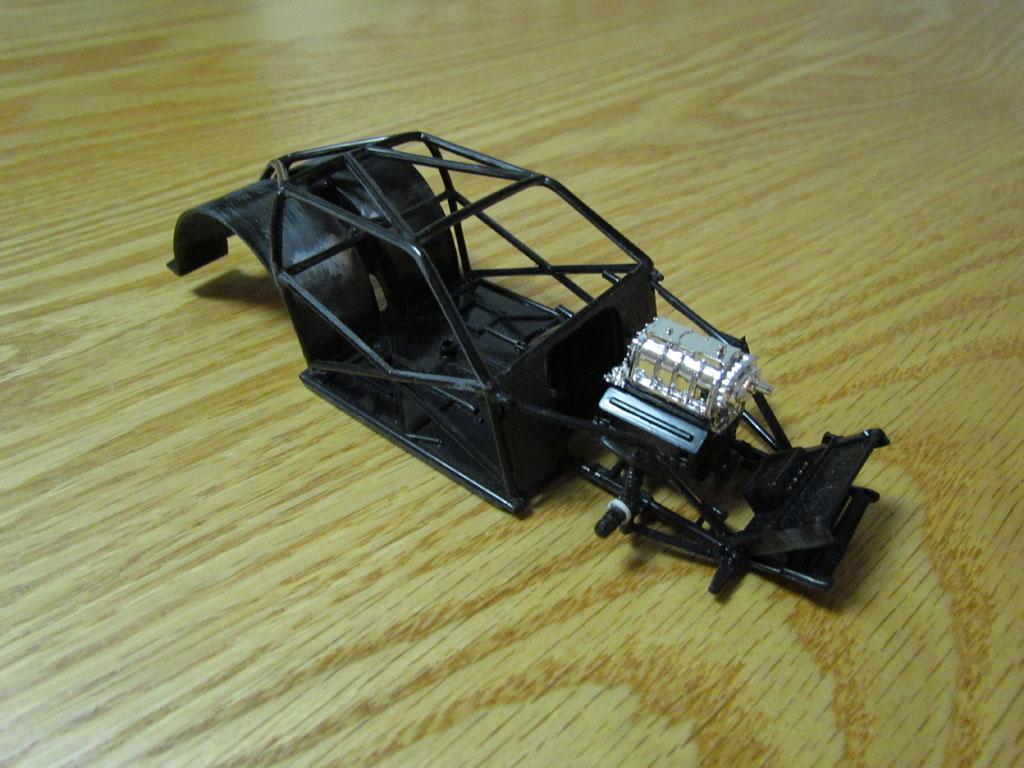

crowe-t Posted February 9, 2022 Author Posted February 9, 2022 (edited) I got inspired and I stretched the nose/wheelbase. It actually solved the problem I had trying to get the rack and pinion to fit. I had originally moved the engine forward and the rack and pinion didn't fit. Now that the nose is stretched I was able to move the engine back to almost it's original location. I also attached the Turbo 400 to the engine. Edited February 9, 2022 by crowe-t
