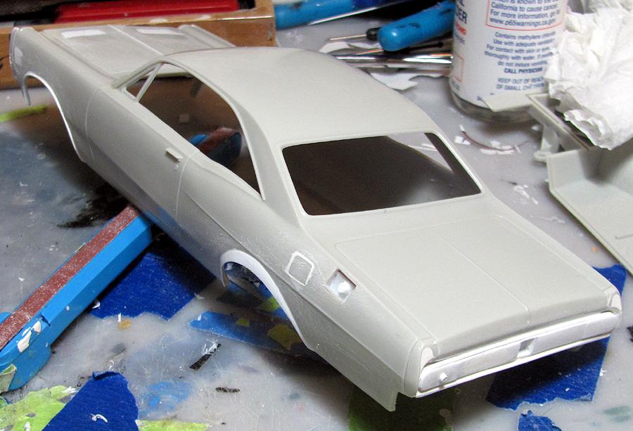

MarkJ Posted March 21, 2022 Author Posted March 21, 2022 I just need to smooth the areas around the headlights and maybe install some small .020 rods along the top and bottom of the center panel that runs between the upper and lower grilles. Looks like there was something like that before the front end damage that happened during the race. After that I will sand the whole body and prime it. then I will do the three tone paint job. I bought some liquid mask I want to try to hopefully get a sharper line between the different colors of paint. Aircraft guys use it when doing camouflage paint jobs, and it appears to do a good job. Apparently you just peel it off when you're through painting.

Pierre Rivard Posted March 22, 2022 Posted March 22, 2022 Mark, the body looks very, very good. I look forward to learn from the work you do with the liquid mask. I've never tried it so I am quite intrigued. Red, black and white. Is there a better color combo out there? Don't think so.
MarkJ Posted March 22, 2022 Author Posted March 22, 2022 4 hours ago, Pierre Rivard said: Mark, the body looks very, very good. I look forward to learn from the work you do with the liquid mask. I've never tried it so I am quite intrigued. Red, black and white. Is there a better color combo out there? Don't think so. Thanks, Pierre. Yes I am hoping the liquid mask works out for me. I am always masked challenged when it come to masking tape. I can never get a crisp line between the colors. I'm hoping the liquid mask adheres better then the tape and it peels off leaving a nice concise line between the colors. And none of the paint sneaks under the mask like it does with tape. We shall see.

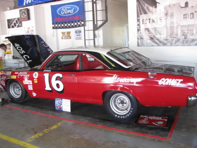

jjsipes Posted March 23, 2022 Posted March 23, 2022 Hey Mark, it just hit me and I went looking in my pictures from past car shows. Back in 2014 I seen this restored car at the Ford Nationals in Carlisle, PA. I have attached pictures in case you are interested in them.
MarkJ Posted March 23, 2022 Author Posted March 23, 2022 Thanks, Jason. I was able to find these too. For a museum car its mostly correct. I think they got the color too dark for the red on the body and the wheels at the Southern 500 were white, not silver. The upper and lower grilles are not correct either. They used stock comet grilles instead of the Cyclone grilles. My grilles won't be correct either,. But they will be close enough for government work. My dad used to love to say that all the time. He worked for the Federal government.

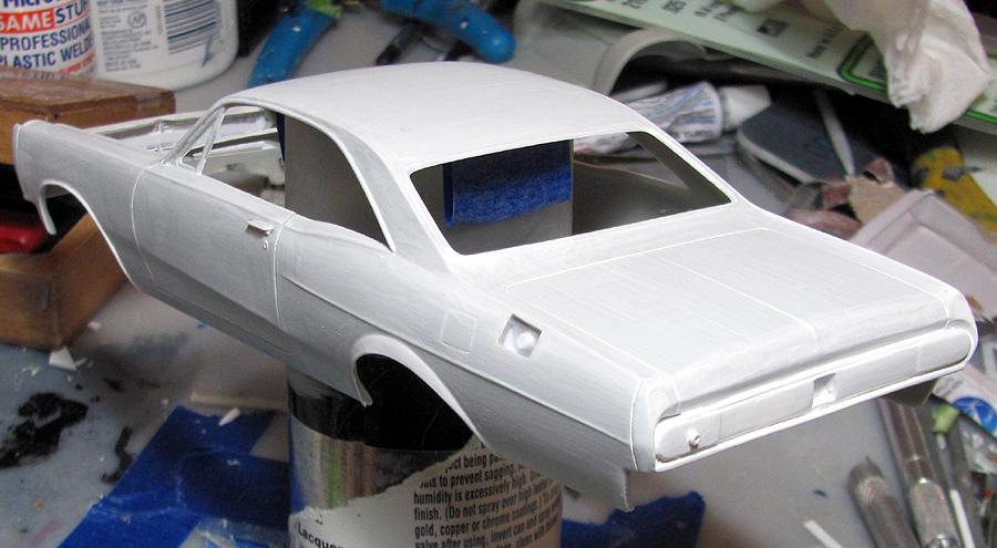

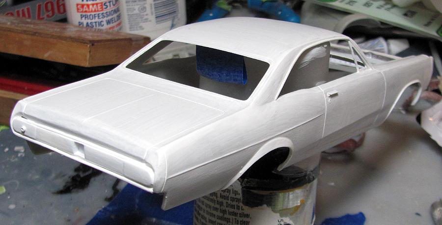

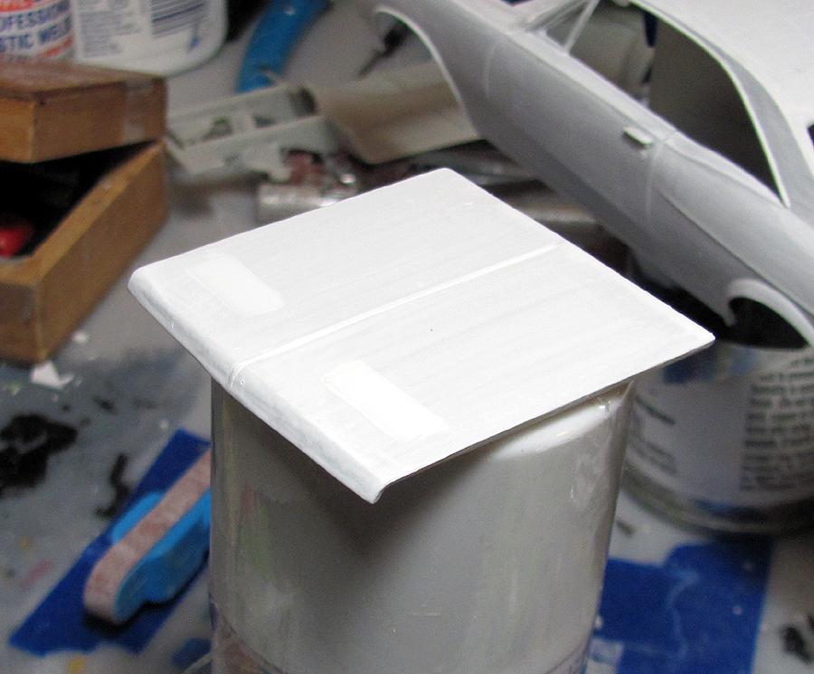

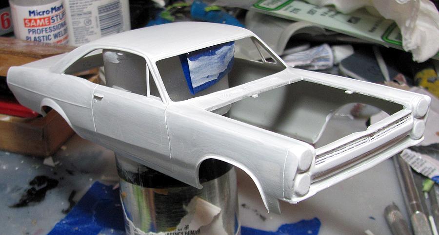

MarkJ Posted March 24, 2022 Author Posted March 24, 2022 Got the first primer session done. I need to block sand and see if I can remove any voids that I missed with the first sanding. The primer brings out the faults you didn't know that you have. I will use a scribe on the trunk and door seams so they don't go away from the primer sessions I might have to use. A primer session is when you mix some primer in the pallet and keep going around the model till you use up what you have prepared. A session lasts until you get the opacity you need to do the block sanding. I did about 5 of these in the first primer session. it shouldn't take as many in the second session. This Vallejo primer is very thin when it is thinned out and not very opaque when applied. that is what makes you have to keep filling the pallet chamber until you feel the session is over. If the body was white, I'm sure the session would not take as long. This body is gray. I need a white primer surface to paint the white roof, or it will turn out looking light gray.
Bill J Posted March 24, 2022 Posted March 24, 2022 Mark, your turning a 67 Comet into a 66 is absolutely amazzing. You never fail to impress and inspire. Looking forward to the finished car.
MarkJ Posted March 24, 2022 Author Posted March 24, 2022 Thanks, Bill. I'm kinda turning a 67 into a 66. Don't look too closely after its finished. There are a couple of things that are way off, but i'm not telling anybody what they are. It's still going to look more like a 66 then a 67 and my chances of getting a 66 kit was zero. I'm trying to build as many Southern 500 winners as I can. Especially from the fifty's and sixty's. So far I have the 54,55,56,57,58,59,63, and this will be the 66 winner. I have the kits to do the 64 winner but it will be one of these cut and paste cars.
Pierre Rivard Posted March 25, 2022 Posted March 25, 2022 Looking good so far. Vallejo primer needs a few coats to build up but I find it helps see the small blemishes needing a bit of fixing. What sort of tool do you use fro scribing panel lines?

MarkJ Posted March 25, 2022 Author Posted March 25, 2022 1 hour ago, Pierre Rivard said: Looking good so far. Vallejo primer needs a few coats to build up but I find it helps see the small blemishes needing a bit of fixing. What sort of tool do you use fro scribing panel lines? Thanks, Pierre. I bought it some where . It looks like a pencil with a metal tip. you can also use the back side of a number eleven exacto blade, I have decided to use the gray vallejo primer for the red and black areas. It seems to cover better then the white. The Vallejo primer is very hard to sand compared to the aerosol Tamiya primers. But I am staying true to brush painting everything. I really dislike aerosol cans and I am really not fond of airbrushes. Cleaning them is not fun and neither is using them.

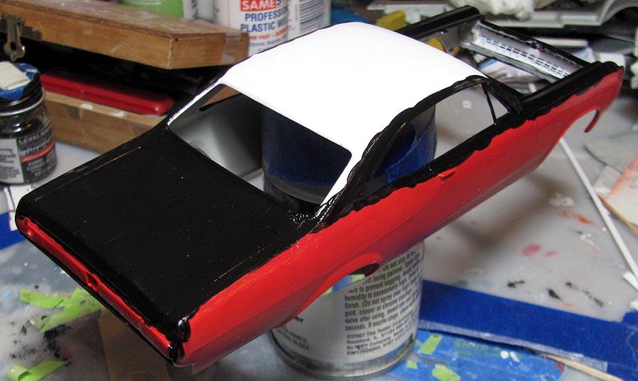

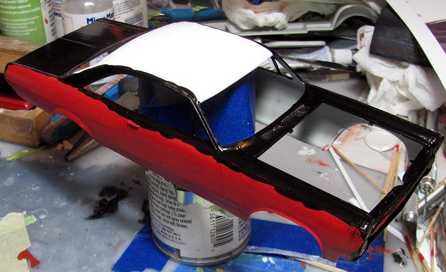

MarkJ Posted March 29, 2022 Author Posted March 29, 2022 (edited) I will let you know how good the liquid mask works tomorrow. If not, I have a lot of work ahead of me fixing this. The liquid mask dries clear so you can't really see it in these pictures. I just hope it comes off easy. Edited March 29, 2022 by MarkJ
Pierre Rivard Posted March 29, 2022 Posted March 29, 2022 Very interesting. What brand material are you using and what is the method for doing this?
