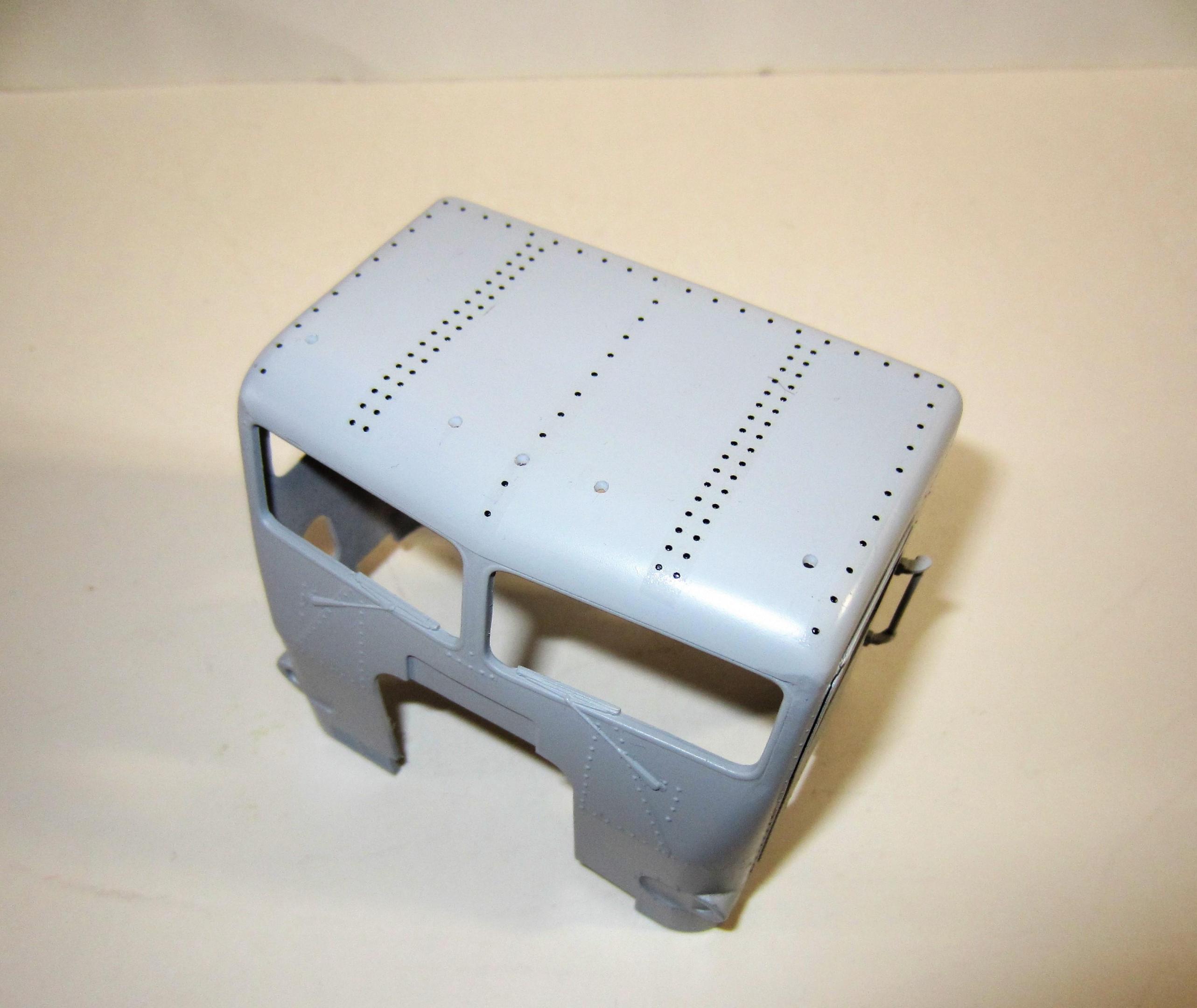

Archer water slide rivets.
Do they need a glossy surface, or can they be applied directly to the primer?
I have done some research and it seems to be the best way to deal with the seam on the Freightliner COE.
Thanks
   Rog?
Thank for the info!
One of the videos I watched said to use the G scale 5(8 rivets.
He said it was almost a perfect match for the kit rivets.
Thanks agin.
    Rog?
Another question?
Do you have to cut close to the rivets or will primer hide the edge of the carrier just fine?
Thanks
   Rog?

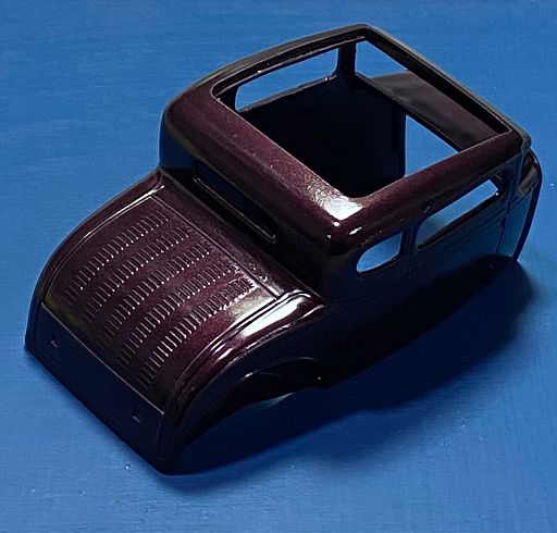

Here are the Archer louvers applied to my current project. Should have the same results as using their rivets.
Before paint, note the edges of the decal, especially at the sides.
1645447033772
And then after one coat of primer and 2 coats of paint. The line disappears
1647255694316
