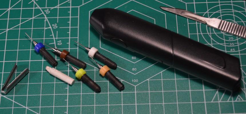

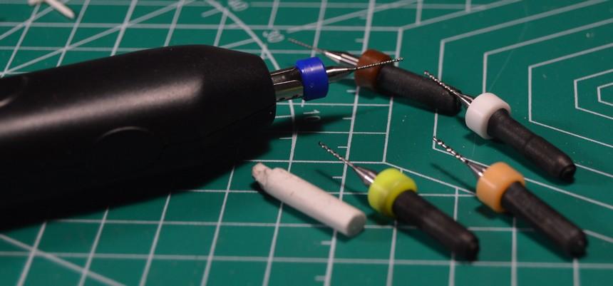

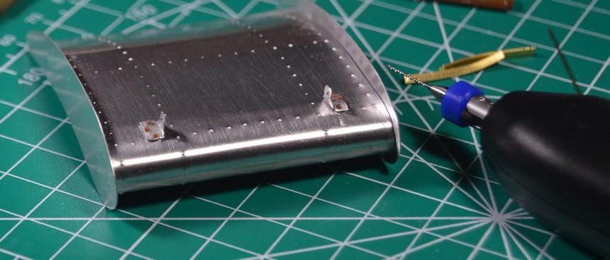

Straightliner59 Posted March 27, 2022 Posted March 27, 2022 I bought this power eraser a while back, in my eternal quest to find an easier way to create engine-turned finishes on aluminum sheet. It doesn't really work, for that, so...Today, I needed to drill some holes in the surface of the wing for my Supermodified. I saw the eraser, and thought about how I could make a high speed bit fit in the eraser. Three layers of heat-shrink tubing later, I had my holes! It's high speed, and low torque, which is ideal for this application. The low torque doesn't snap the bit, if it binds. I decided to keep these all together, 'cause this is now a "thing"! 1

iBorg Posted April 3, 2022 Posted April 3, 2022 Sorry the eraser didn't work for the engine turned panels. I am glad you found a use for it. The idea of not enough torque to break bits is a huge plus. The wing looks killer!
Straightliner59 Posted April 3, 2022 Author Posted April 3, 2022 7 hours ago, iBorg said: Sorry the eraser didn't work for the engine turned panels. I am glad you found a use for it. The idea of not enough torque to break bits is a huge plus. The wing looks killer! Thanks, Mike! That low torque is what makes this so valuable. I have a Dremel with a flex shaft, and a mill. They both have too much torque. This thing, if a .5 mm bit catches, the motor stops!
