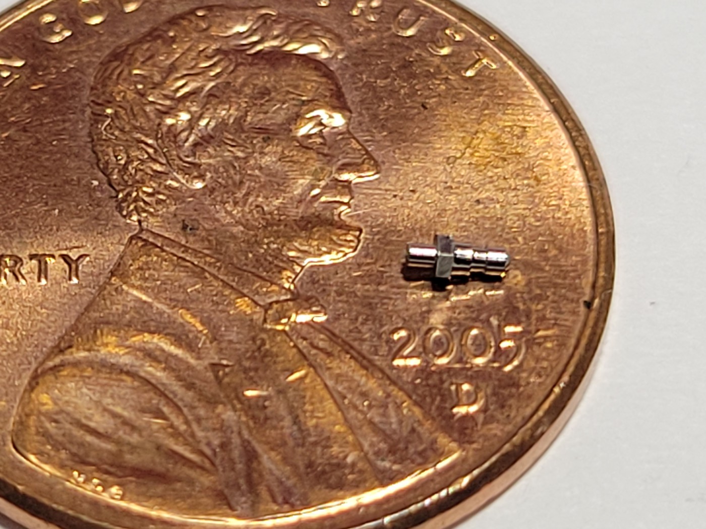

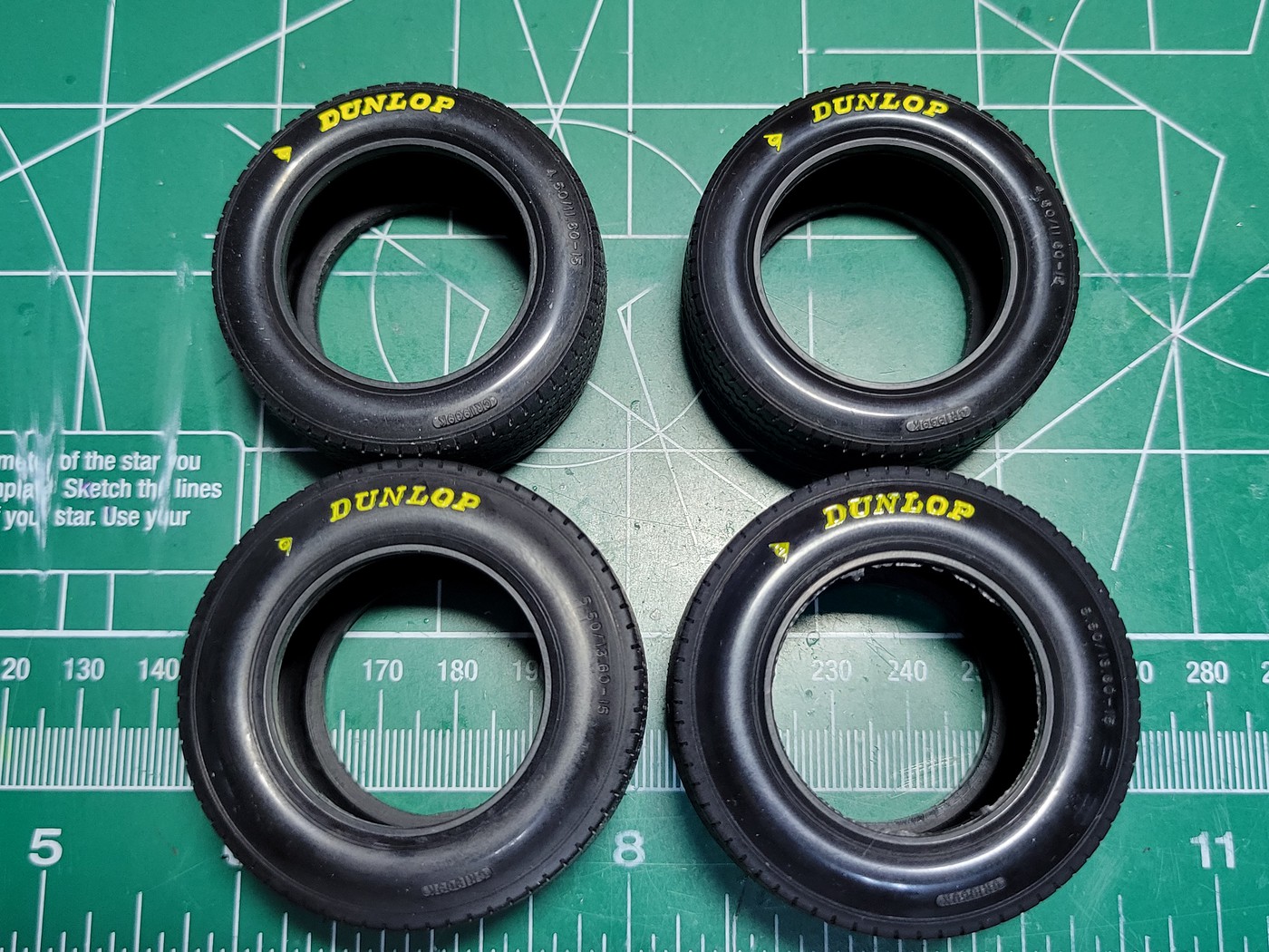

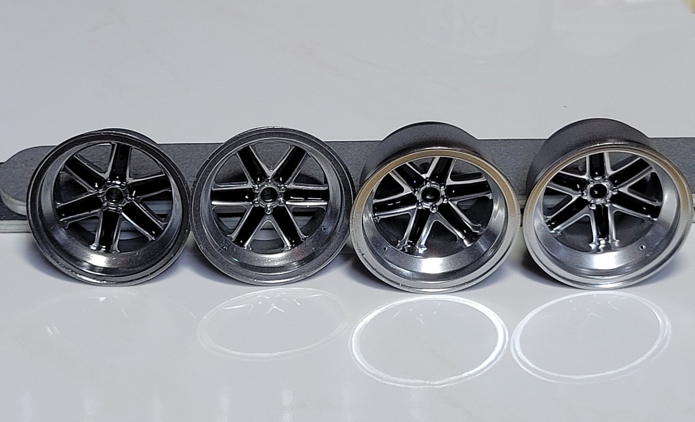

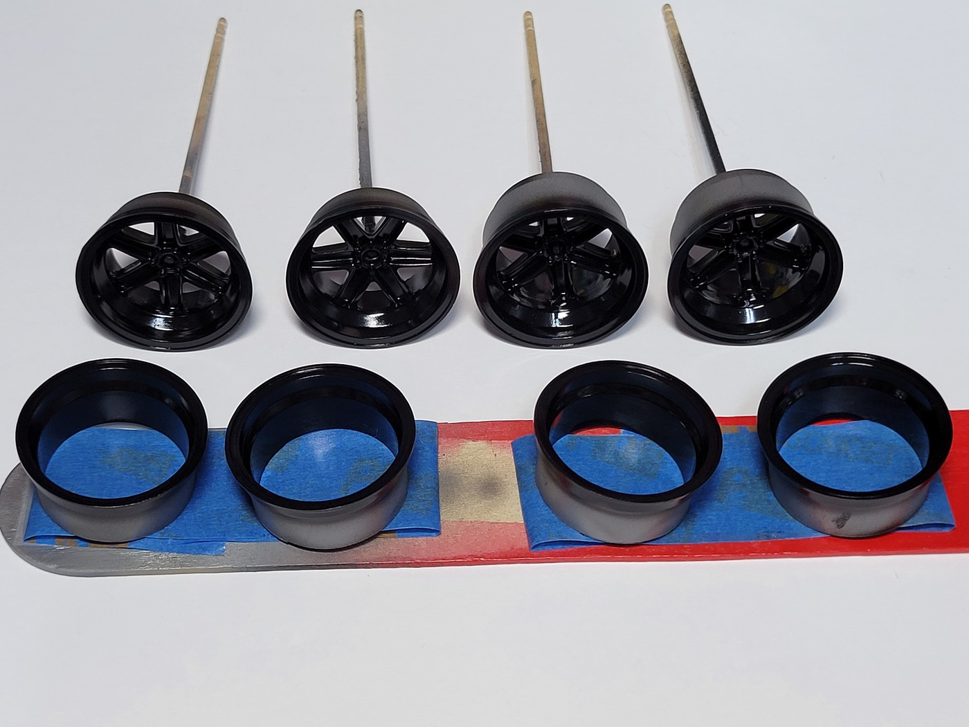

Nacho Z Posted August 30, 2022 Author Posted August 30, 2022 If it's Monday night, it's update time! I may miss the next couple of weeks. Building a F4U-1 Corsair for a FB group build. Wheels and tires. They can make or break a model, IMHO, especially on a street car. Not so much on a race car but they can make a difference. This was not simply slide the tire over the wheels. It was a little more involved than that. As I pointed out earlier in this build thread, this is a poorly molded kit and the wheels did not escape that. Here is what I am trying to replicate. The kit wheels are 2mm too wide. I used a razor saw to remove the 2mm. Original wheel size on the left, modified wheel on the right. The spokes on all 4 wheels are poorly molded. I cleaned them up as best as I could. To make them perfect was well beyond what I was willing or able to do. Pictured is a beautifully machined air valve stem from Top Studio. All 8 wheel parts were primed in Gravity Colors, (Spain), dark gray primer and then airbrushed in Tamiya's LP-1 Black. The wheel faces were airbrushed in AK Interactive Xtreme Metal Chrome and the wheel backs were airbrushed in AK Interactive Xtreme Metal Aluminum. I hand painted the middle of each spoke in acrylic black. Two coats. I also painted the lug nuts. The Dunlop letters and logo were hand painted with Tamiya acrylic yellow with Tamiya acrylic smoke added to the yellow. Two coats, both sides of each tire. The real car's wheels had wheel weights. I thought I should add some too. Styrene rod was flattened, cut to various lengths and painted. Final results. 3

Nacho Z Posted August 30, 2022 Author Posted August 30, 2022 20 hours ago, stinkybritches said: Very nice work on the wheels. Thank you, Rob! I am very happy with how they turned out.
Nacho Z Posted August 30, 2022 Author Posted August 30, 2022 8 hours ago, absmiami said: Never occured to me - the smoke darkens the yellow just enough - right ? Yup, that was what I was shooting for. I didn’t mix up very large batches of the color at any one time so the “brew” is not exact. I added 1 drop of Smoke to only a handful of drops of yellow. I don’t remember the exact ratio because there really wasn’t one.
Chris Smith Posted August 30, 2022 Posted August 30, 2022 (edited) The tires and wheels came out great! Edited August 30, 2022 by Chris Smith 1

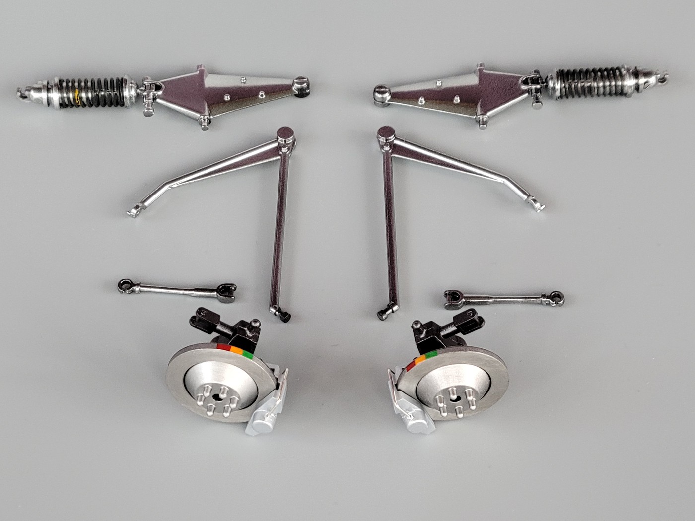

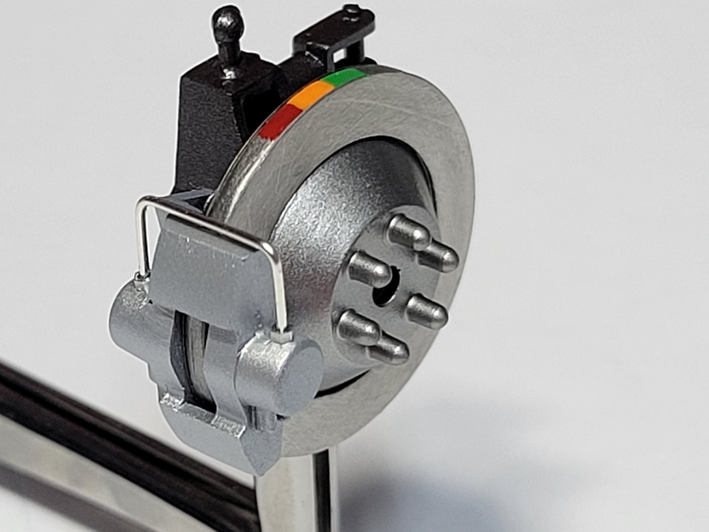

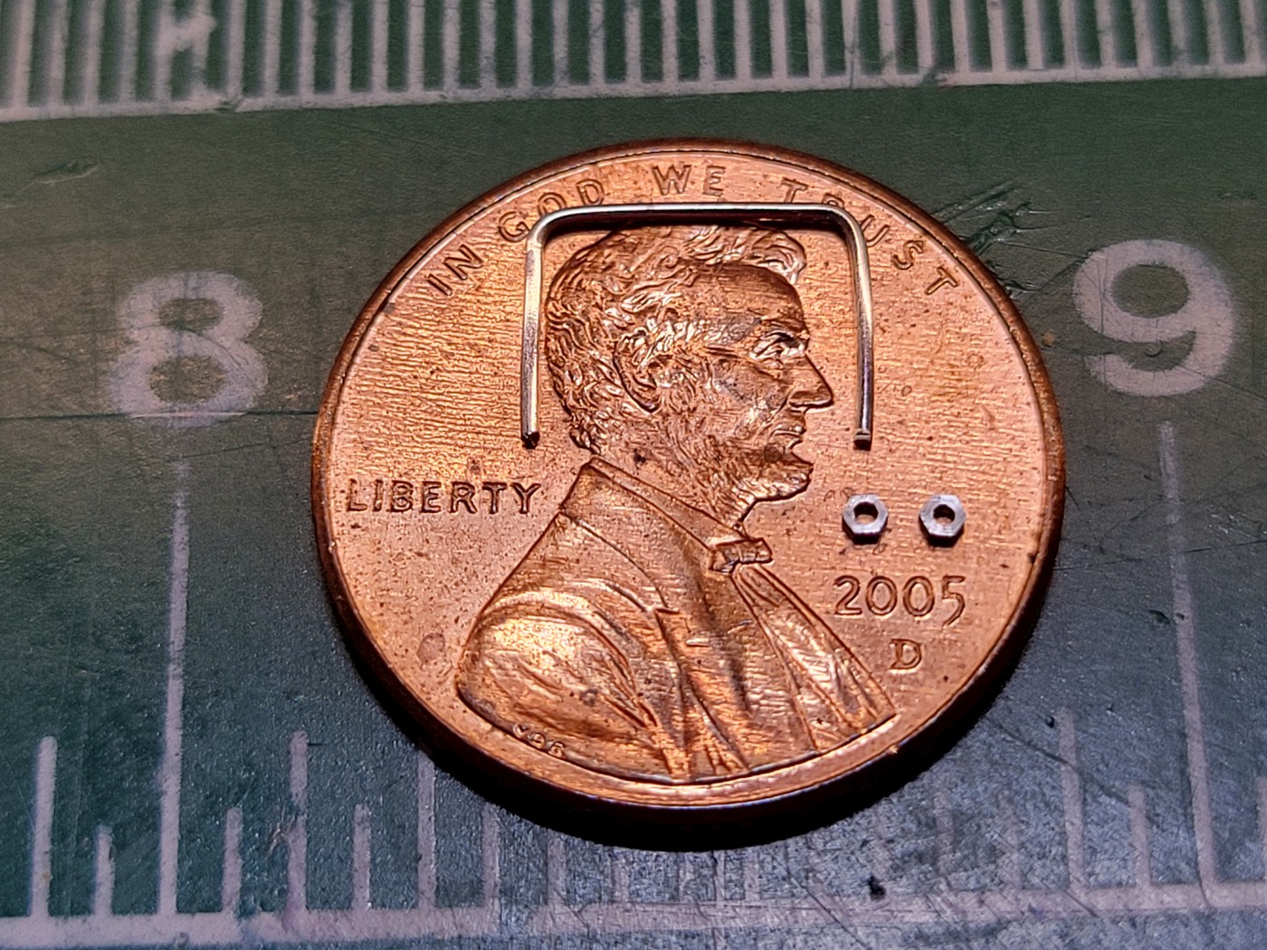

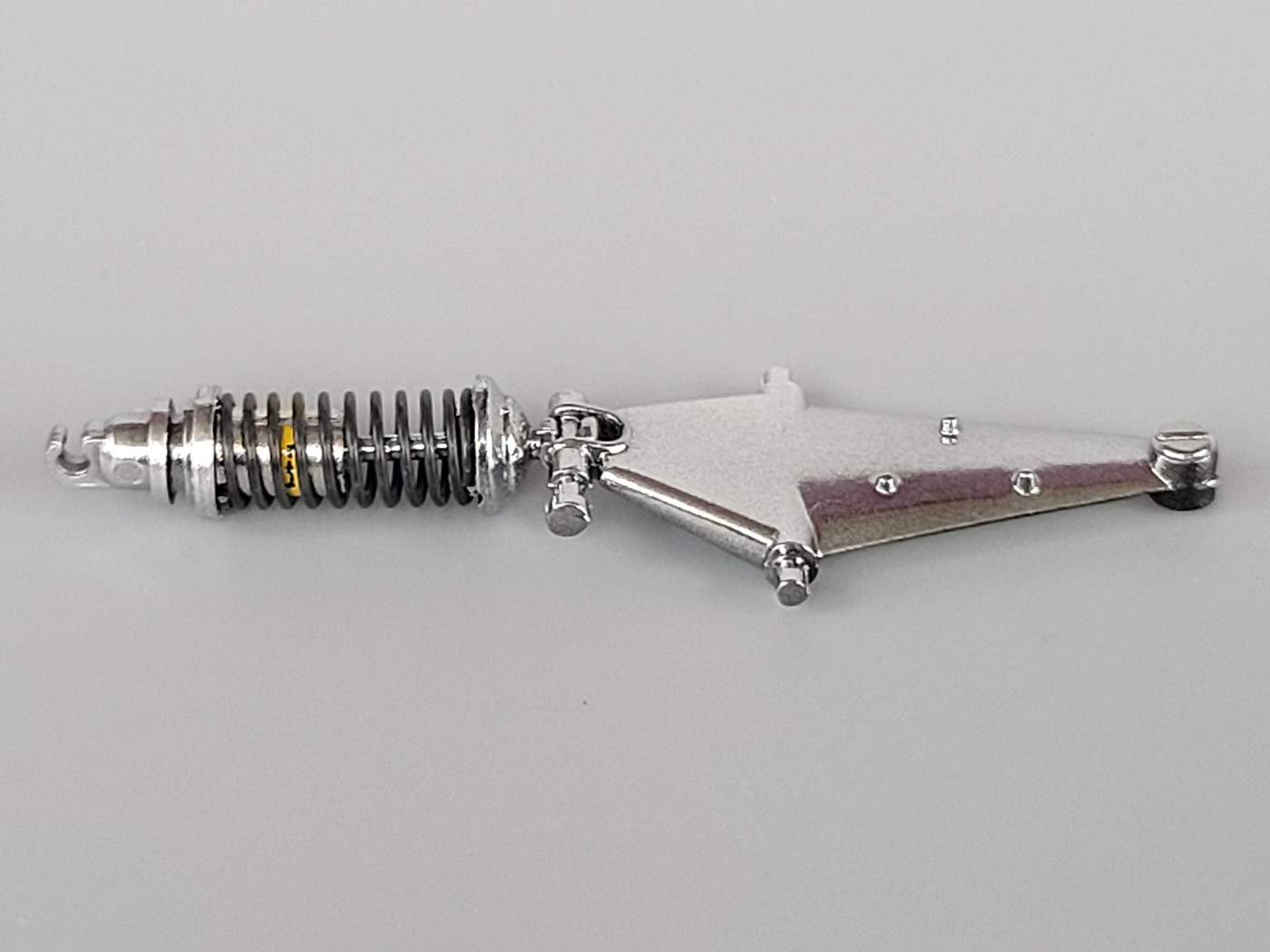

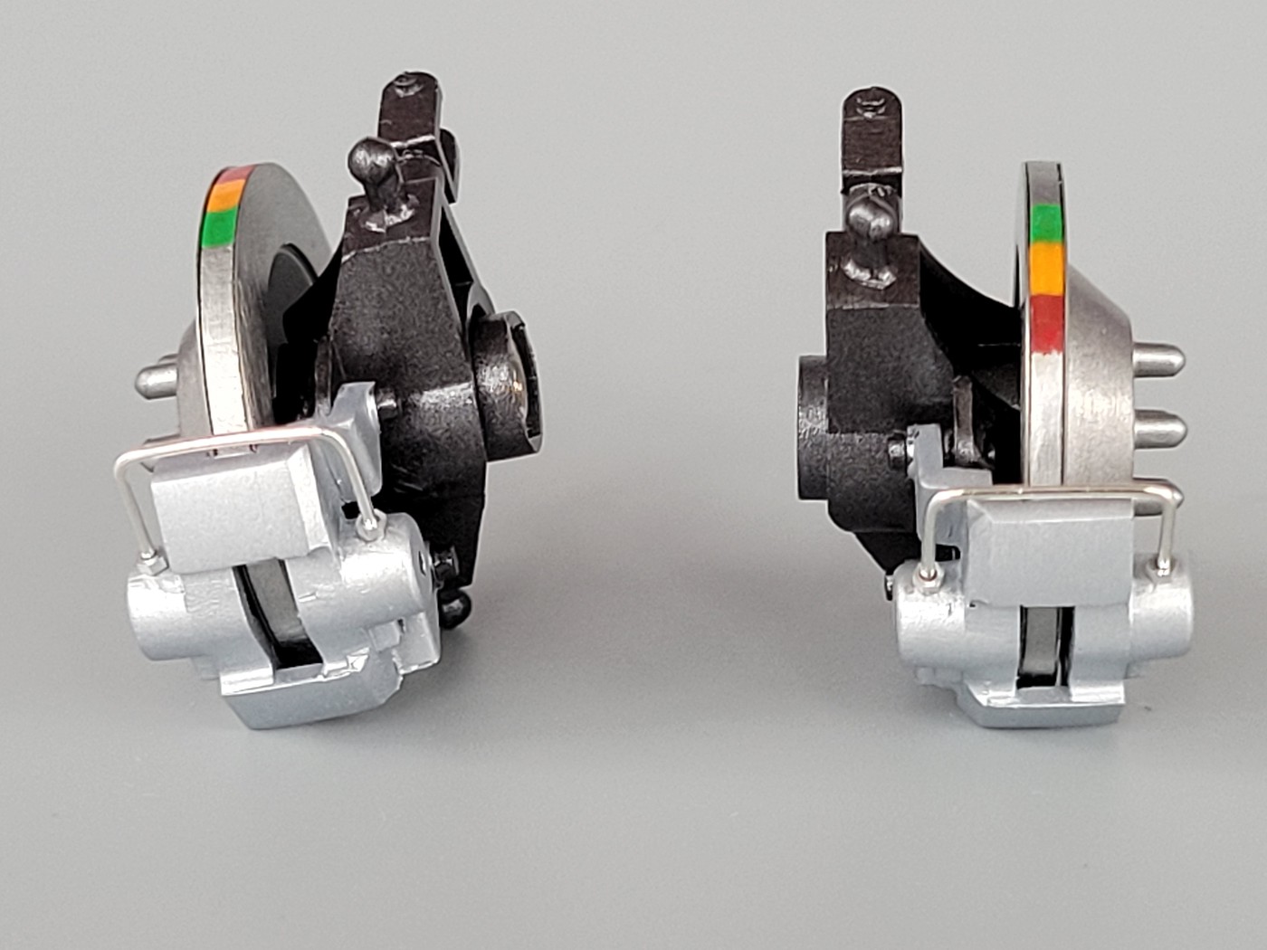

Nacho Z Posted September 20, 2022 Author Posted September 20, 2022 It is Monday night and I'm back on track with updates. For those following along, I mentioned that I was going to miss a few weeks because of a FB group build. I did finish the Corsair and it is posted here on MCM. Getting back to the Matra, the last update was the wheels and tires. They needed something to mount to so I began work on the front suspension. I don't have a lot of in progress pics, there wasn't much to document. This car used 6 wheel studs rather than 1 wheel nut like those used in modern F1 cars. I made crossover tubes from #24 wire and aluminum hex nuts. (I did not use the wire in the picture due to the bend in the right side leg.) All parts with kit chrome were stripped, cleaned up, primed and base coated in Tamiya LP-1 Gloss Black lacquer and shot in AK Interactive Xtreme Metal Chrome, Dark Aluminum and White Aluminum. Coil over shocks have a decal and working springs. The suspension arm looks much better now than how it came in the kit. Calipers were two parts. Photo etch rotor faces, front and back. Crossover tubes and fittings added. Temperature paint added to the rotors. A brake line will be added once the rotor assemblies have been mounted. Another view. Two part calipers were assembled, filled and sanded prior to paint. One last view. 1
Chris Smith Posted September 20, 2022 Posted September 20, 2022 Really nice job on brakes and front suspension

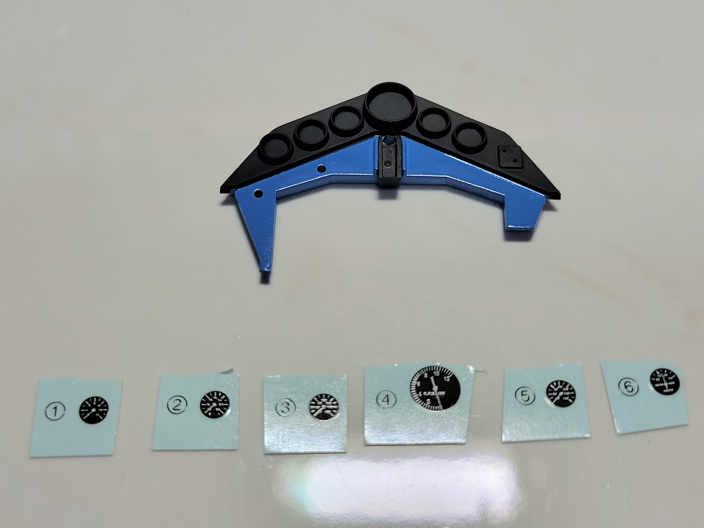

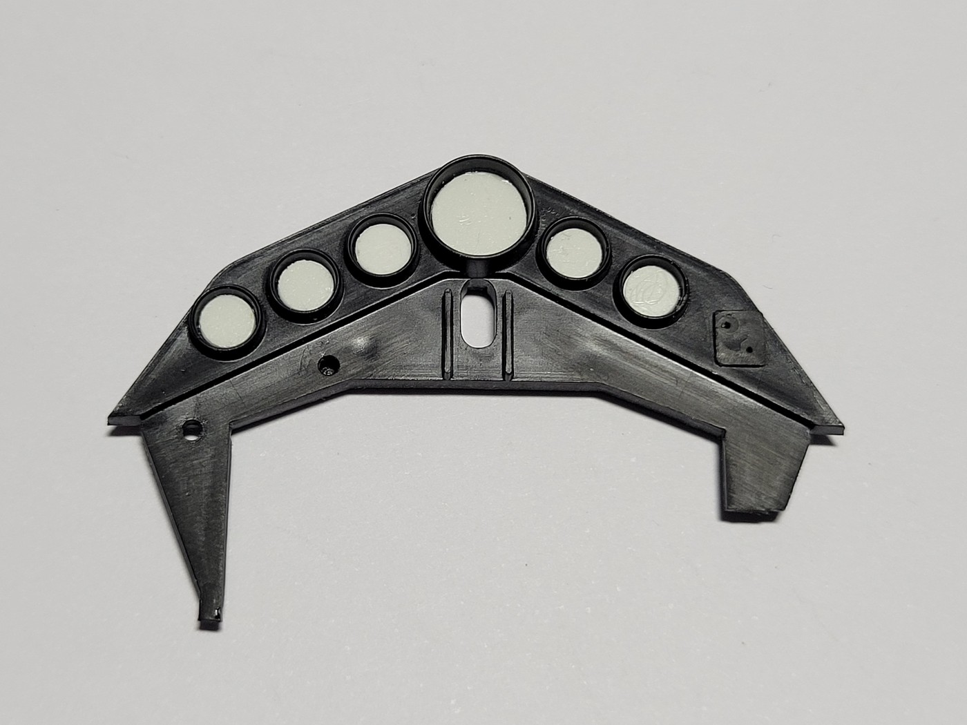

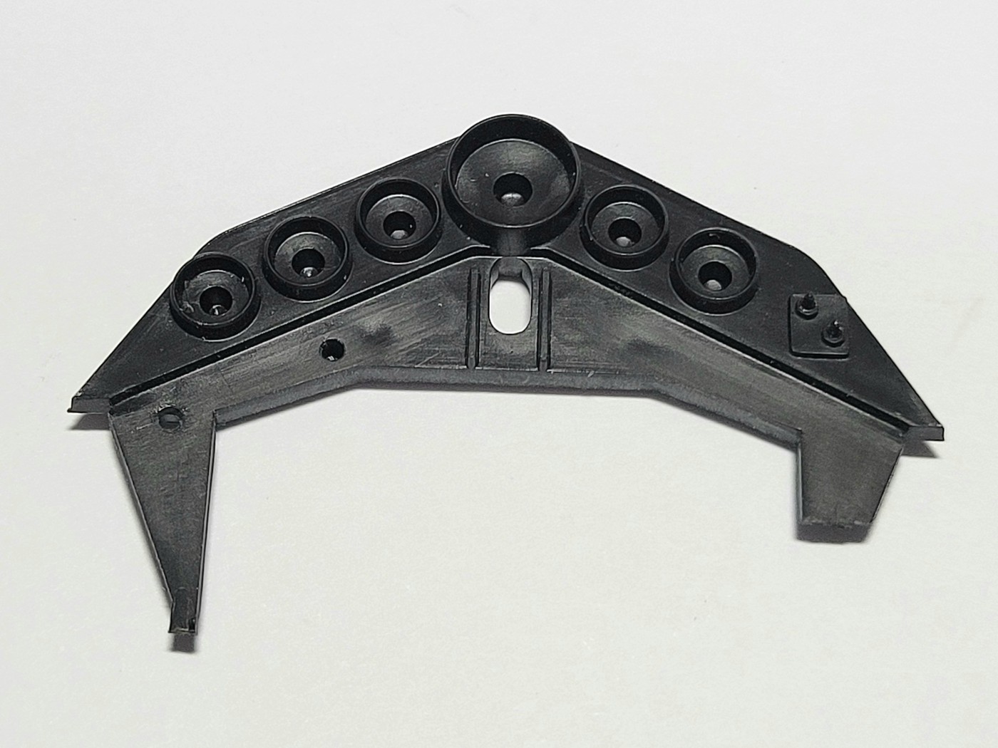

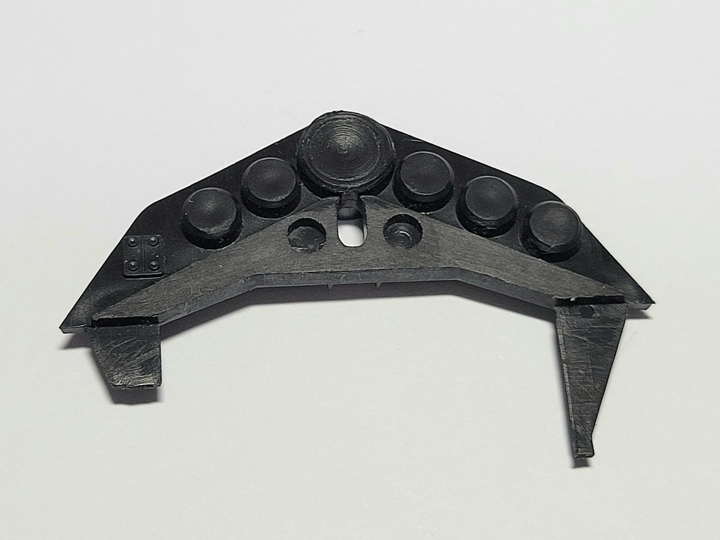

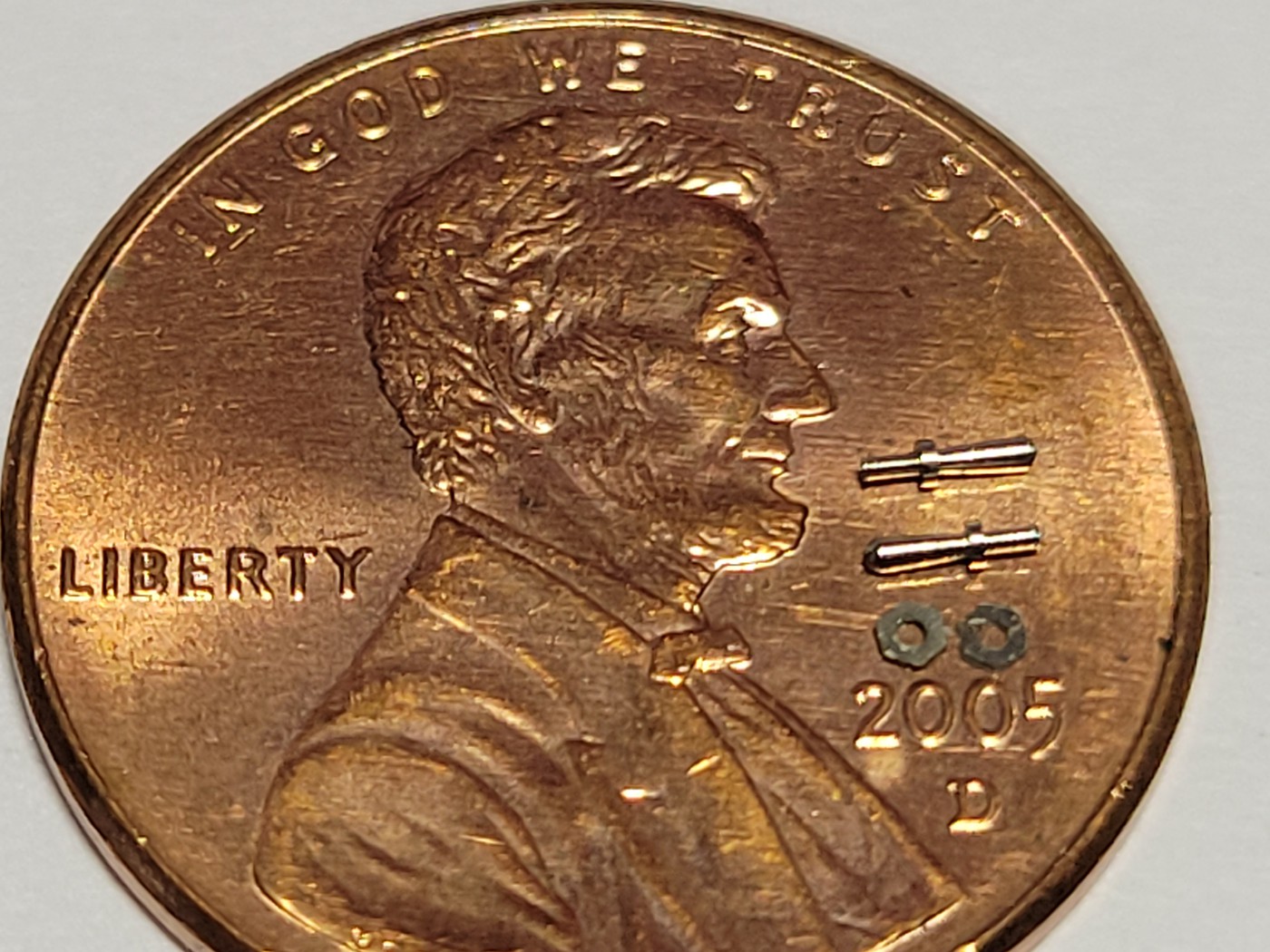

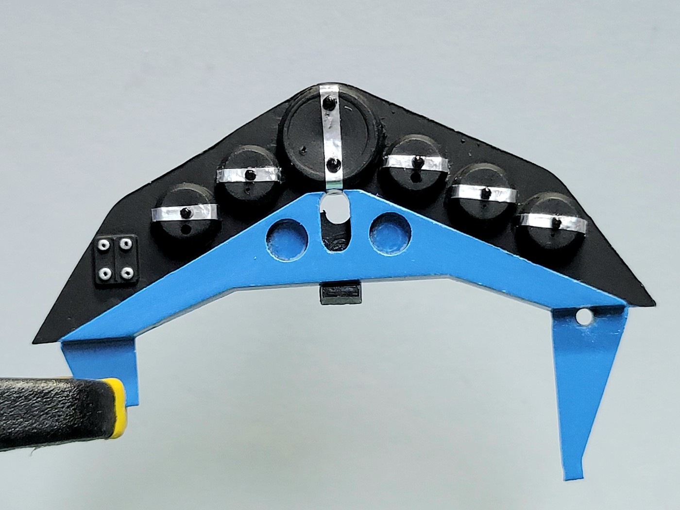

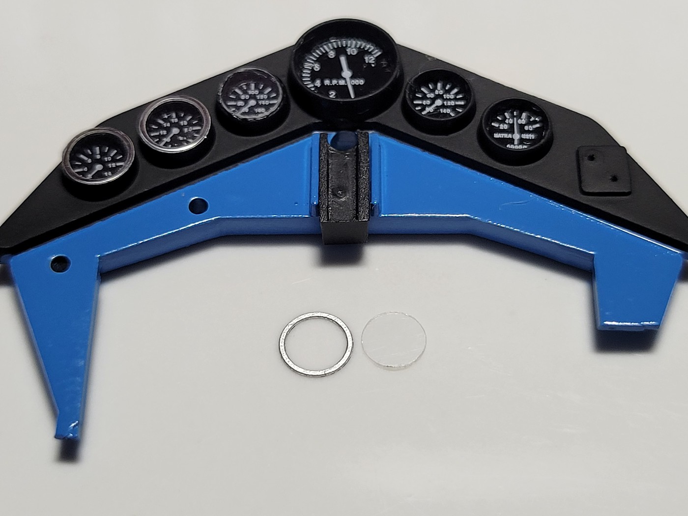

Nacho Z Posted September 27, 2022 Author Posted September 27, 2022 (edited) And here we are, ready for another Monday night update. This will more than likely be the last update for a month or so. I will be working on my Halloween themed build for 2022. I may sneak an update or two in, in the next month, but I doubt it. This update is all about the gauge cluster. If you go back to page 1 of this build thread you will find where I began working on the gauge cluster. You will see my failed attempts at various scratch building ideas for the gauges. I will repost a few things from page 1 just to show the steps I took to get to the final product. Front of the gauge cluster as it came in the kit. Back of the gauge cluster as it came in the kit. Using a punch tool to make styrene discs for each gauge housing. These styrene discs cover the oddly molded "wells" in each gauge housing. Beautiful machined toggle switches from Top Studio. Gauge cluster was primed and then painted Tamiya TS-10 French Blue. Once cured it was masked and airbrushed Tamiya LP-3 Flat Black. The decals were then applied. I used the same punch tool to punch discs from clear sheet that had been polished to nearly glass like quality. These were glued in place and then photo etch rings, which were also polished to a chrome finish, were added. Two gauges are done. You can see the clear disc and photo etch ring for the third gauge. For the large center gauge I did not have a punch large enough. I hand cut and hand sanded the clear sheet to make one that fit correctly. It took three attempts to make. Gauges are done. Toggle switches added. Fire extinguisher painted, foiled and decaled. To the back of each gauge I added heavy/thick tinfoil to replicate brackets. I added a bolt and nut head to each bracket. The toggle switches will be wired and all gauges will have the appropriate wiring or plumbing added. Edited September 27, 2022 by Nacho Z Added photo 1
2whl Posted September 27, 2022 Posted September 27, 2022 John, I just went through the WIP, and I must say you are doing an outstanding job detailing this kit. Being an early Tamiya kit, it has rather crude detailing compared to today's kits. But you're bringing it up to current standards. I'm looking forward to your next update. If you have a Michael's nearby, take a stroll through their beading department. You can find all sorts of thin wires in various colors for reasonable prices.

Nacho Z Posted September 29, 2022 Author Posted September 29, 2022 On 9/26/2022 at 9:16 PM, 2whl said: John, I just went through the WIP, and I must say you are doing an outstanding job detailing this kit. Being an early Tamiya kit, it has rather crude detailing compared to today's kits. But you're bringing it up to current standards. I'm looking forward to your next update. If you have a Michael's nearby, take a stroll through their beading department. You can find all sorts of thin wires in various colors for reasonable prices. Paul, thanks for checking out this thread, I appreciate it. I don’t think these odd subjects get a lot of traffic and/or discussion. It is nice to get someone stopping by, as it were. On 9/27/2022 at 7:00 AM, absmiami said: Great looking gauge cluster I always appreciate the nice comments, Andrew!
