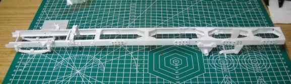

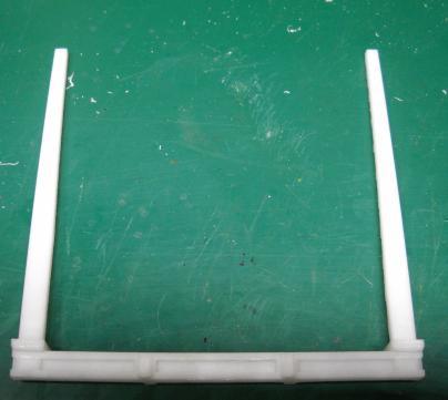

PHPaul Posted May 4, 2022 Posted May 4, 2022 (edited) After some searching, I settled on this kit as a basis for a logging truck. In my part of Maine, a straight truck with a stretched frame, tag axle and a grapple loader is a common sight. The picture is a pretty standard example and the basis for my model. So far I've stretched the frame a total of 6 inches - 4 in front of the rear axles, 2 after the rear axles. I designed and 3D printed the frame inserts and added fish plates with bolt castings at the joints. I also designed and 3D printed two extra frame crossmembers and a tag axle assembly. (It's flopped over in the wrong direction in the picture.) I do wish I'd added the fish plates with the frame oriented differently so I got them all square with the frame, but it's a little late now... I 3D printed the log bunks rather than build them up from components. 3 hours per print times 6 bunks! Nice thing is, I hit "print" and then go do something else. 3D printer to the rescue again as I assemble the grapple head for the log loader. Comments/Suggestions/Constructive Criticism invited, as long as you bear in mind that (A) I have limited resources so resin castings are probably not going to happen, (B) Even tho I'm 70-mumble I'm just getting started building semi-custom stuff rather than "shake-the-box" and (C) with Summer coming on, this is going to be a VERY slow build. Edited May 4, 2022 by PHPaul

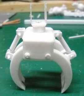

PHPaul Posted May 9, 2022 Author Posted May 9, 2022 Grapple head assembled. A little fine tuning needed on the pins once the glue has cured. The loader I'm modeling has a rotator on the grapple head in addition to the jaw hydraulics. 1

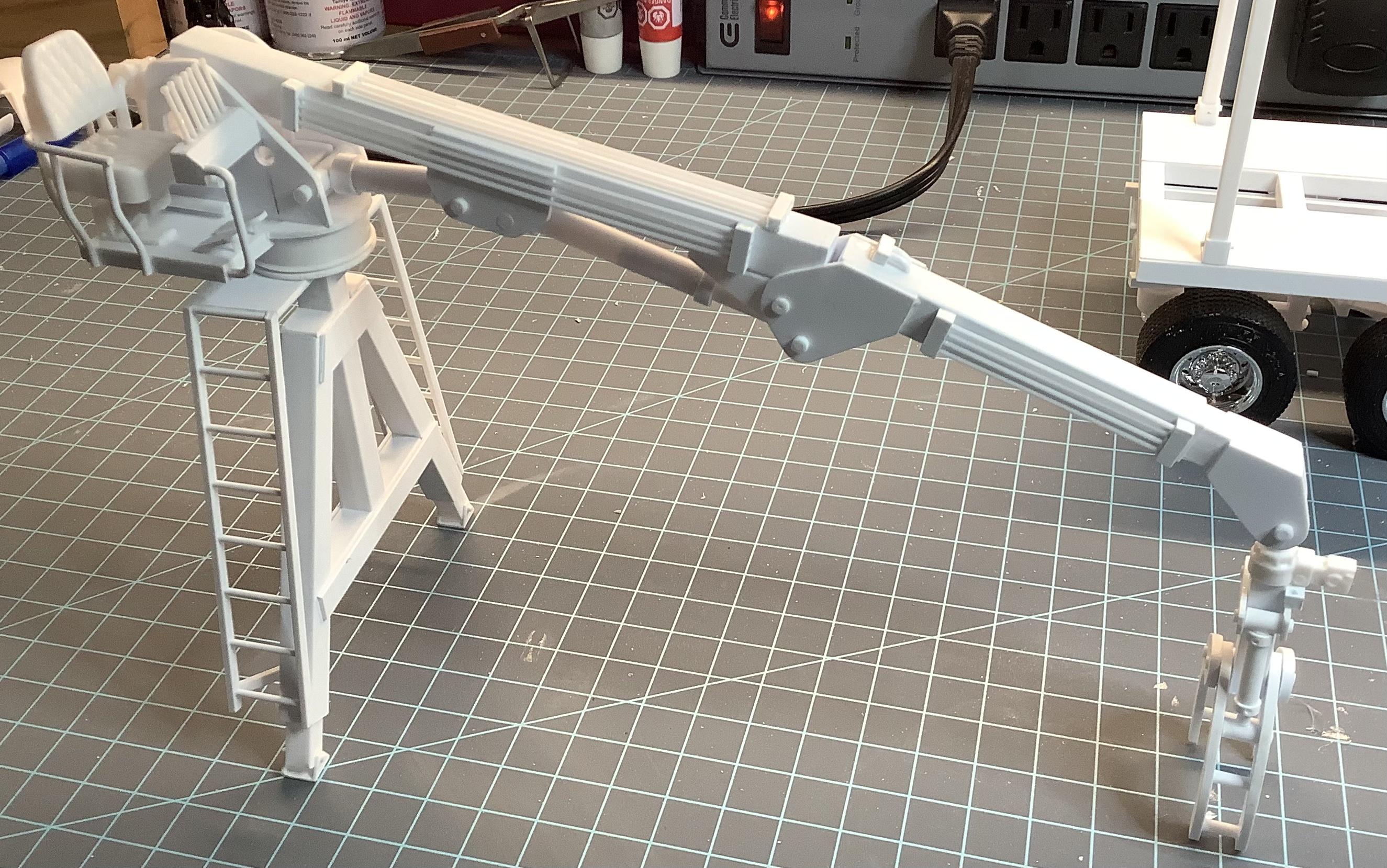

PHPaul Posted May 31, 2022 Author Posted May 31, 2022 Several cold and rainy days this month so getting an little bonus bench time in. Working on the log loader. Mast, rear boom mount, hydraulic tank and seat 3D printed, the rest being scratch built from plastic shapes. Finished loader will articulate and swivel.

PHPaul Posted June 4, 2022 Author Posted June 4, 2022 A little more progress. Working on the loader boom and figuring out the geometry. Also working on the operator's position atop the boom tower. The pins for hydraulic levers looked good originally, but in the pic they look a little out of scale. I'll probably sand the ball ends down a little if I can, or replace them if not.

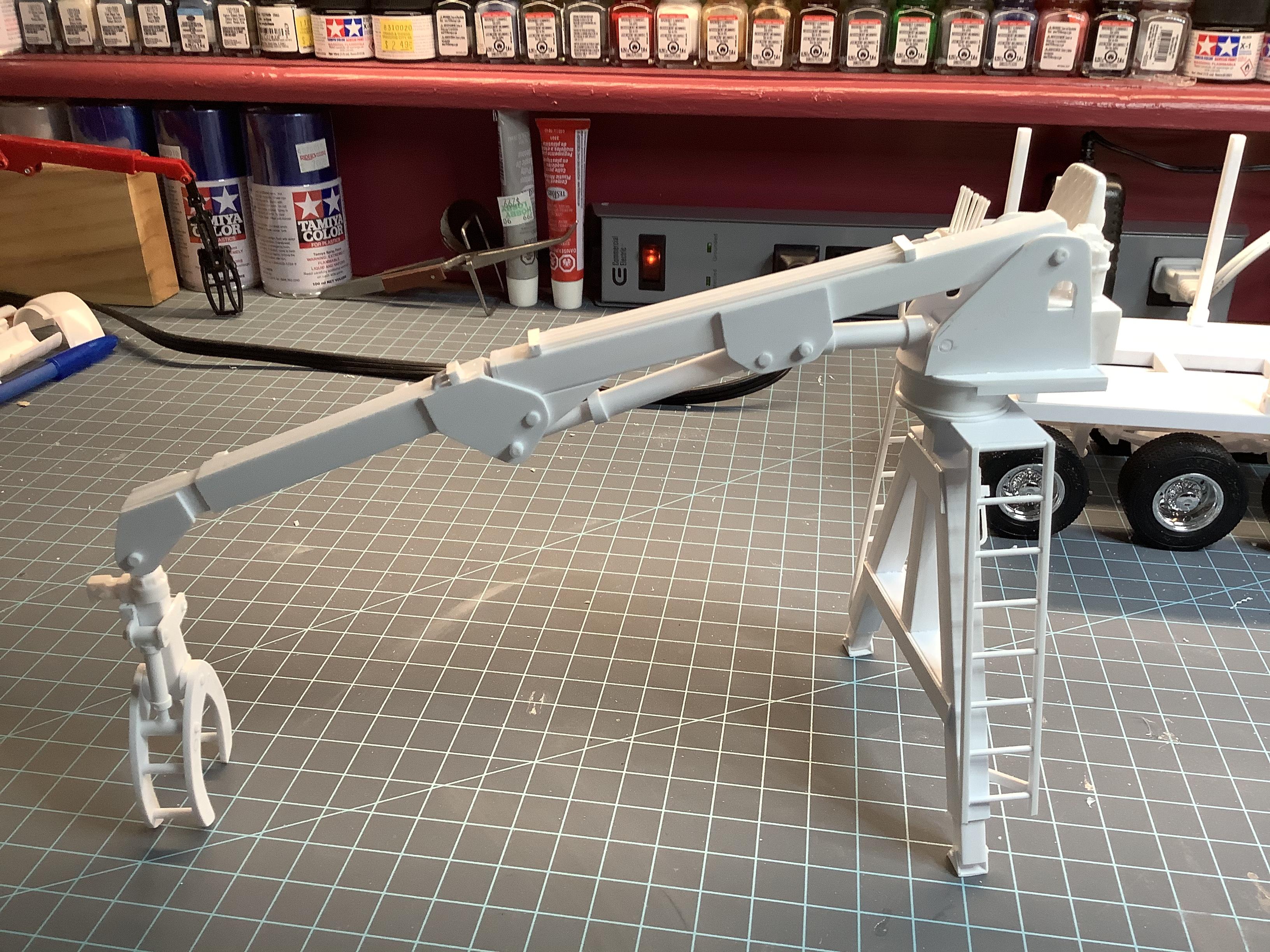

Gary Chastain Posted June 5, 2022 Posted June 5, 2022 Not sure if this is any help. Built this last year.
PHPaul Posted June 5, 2022 Author Posted June 5, 2022 Wow! That's outstanding, Gary! That'll be a big help and also confirms some assumptions I had to make on mine. Thanks!

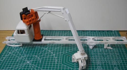

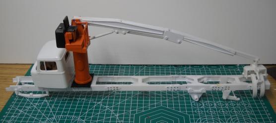

PHPaul Posted June 7, 2022 Author Posted June 7, 2022 Here's what I have so far. I'll be adding hydraulic hard lines and hoses. And stabilizer legs of course. Looking at it (compared to Gary's most excellent example) I think the grapple is quite a bit out of scale. Thinking I'll re-do that.
Gary Chastain Posted June 8, 2022 Posted June 8, 2022 Lookin good, my build was based on an older unit, multiple control sticks. The newer log cranes look a little different and are two stick controls like you built.

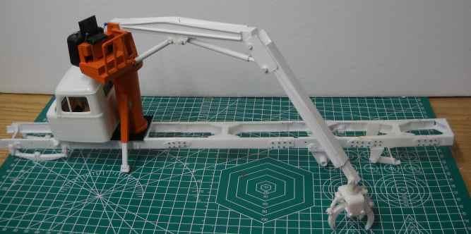

PHPaul Posted June 9, 2022 Author Posted June 9, 2022 I spent the day redoing the grapple head at 75% of the original. Looks MUCH better. Also redoing the main hydraulic cylinders with larger barrels. Don't have that back together yet, but thinking that's an improvement as well. Also got the stabilizer legs roughed out. As soon as I get everything mocked up with the modifications, I'll post a couple of pictures.

PHPaul Posted June 9, 2022 Author Posted June 9, 2022 Before After Before After. Need to redo the joint between the boom and the stick, larger cylinder interferes with hinge.

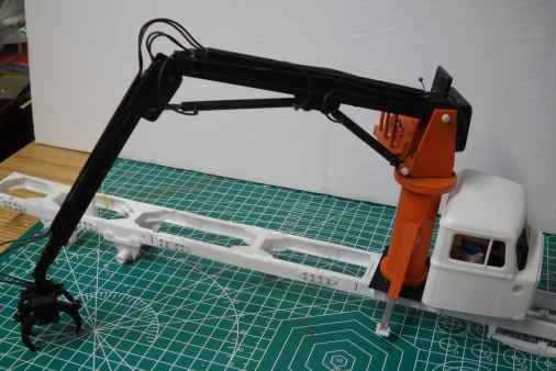

PHPaul Posted June 15, 2022 Author Posted June 15, 2022 Hydraulic hoses installed and a little paint. Have some artwork for decals for the loader, just need to print them out. I'll wait on that until I have all the decals ready, hate to waste a chunk of decal paper for one little decal. 1
