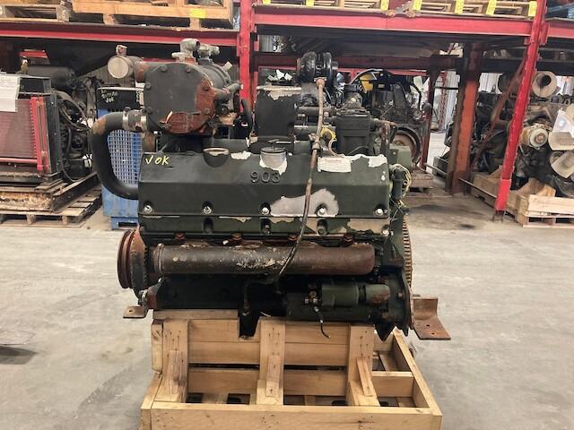

landman Posted May 23, 2022 Posted May 23, 2022 How does one achieve the scaling (peeling) effect in the photo?

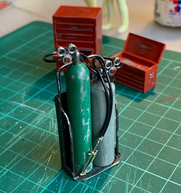

Pierre Rivard Posted May 24, 2022 Posted May 24, 2022 Pat, many ways to do this. Here's mine. I brush a coat of mixed Tamiya silver and flat gray to achieve the dull metallic underside I coat it with the desired color, usually with Vallejo acrylics. Light sanding with 400 grit dry, carefully as the paint goes off easily. Add brown/mud color washes. Optional, but not done on this pic, you can add little spots of rust using the Vallejo...Rust. 1
