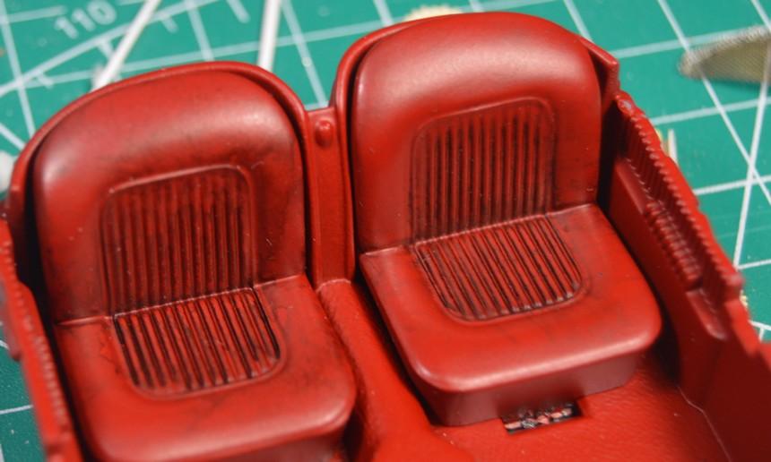

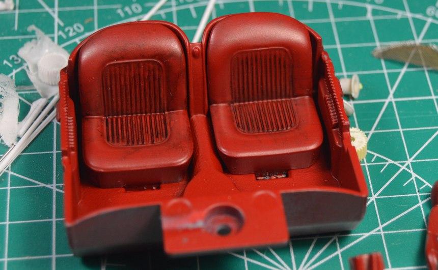

Straightliner59 Posted June 14, 2022 Author Posted June 14, 2022 I've started messing around with the interior. It's all painted with the same Krylon red I used on the Supermod. This time, with a flat clear coat over it. I used India ink on the seats to create something of a mottled look to them, and to deepen the pleats in the inserts. The real car has white stitching in those pleats and those on the door. It's rather prominent. I think I can simulate that with a white Prismacolor pencil. Its effect can be seen on the test seat, in front of the model's seats. I drilled the holes for door "knobs". Model railroad rivets will serve as the knobs--a touch of white glue, or super glue will round them out. I plan on using black embossing powder for carpeting. I am "changing" the trans over to a four-speed, so I will make a cover for the void left by the three-speed shifter, and put a new one a tad farther back on the tunnel. I'm making knobs and photo reproduced white-faced gauges for the dash. Questions, comments and critiques are always welcome. Thanks for looking! 1

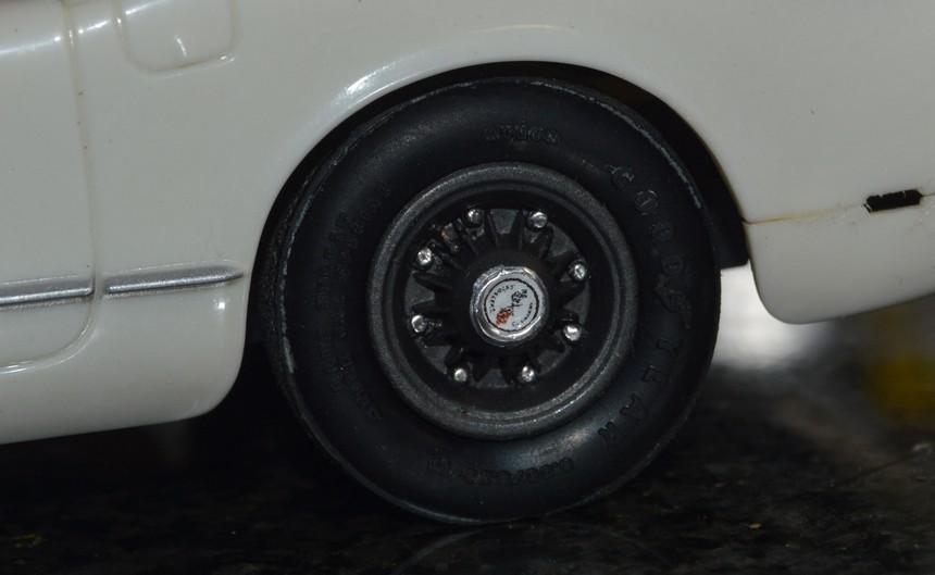

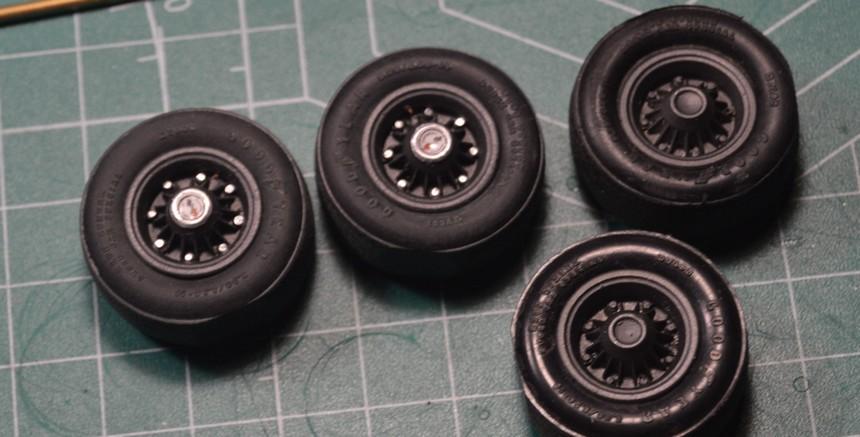

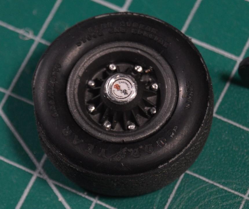

Straightliner59 Posted June 17, 2022 Author Posted June 17, 2022 I got one of the wheels done, except for the silver Prismacolor, down the edge of each rib (it's since been done). I used a punch I made from 1/32" brass tube to punch the tiny discs that cover the lugs. I printed Corvette badges for the wheel centers. I'm happy with the way the wheel looks. Now, just three to go! I have most of the large interior components painted--still a way to go, on that front, though. Questions, comments and critiques are always welcome. Thanks for looking! Â Â Â Â Â Â 6

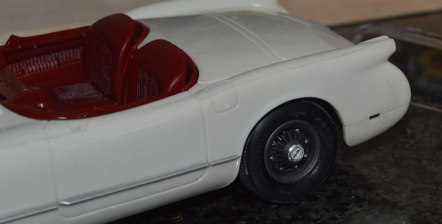

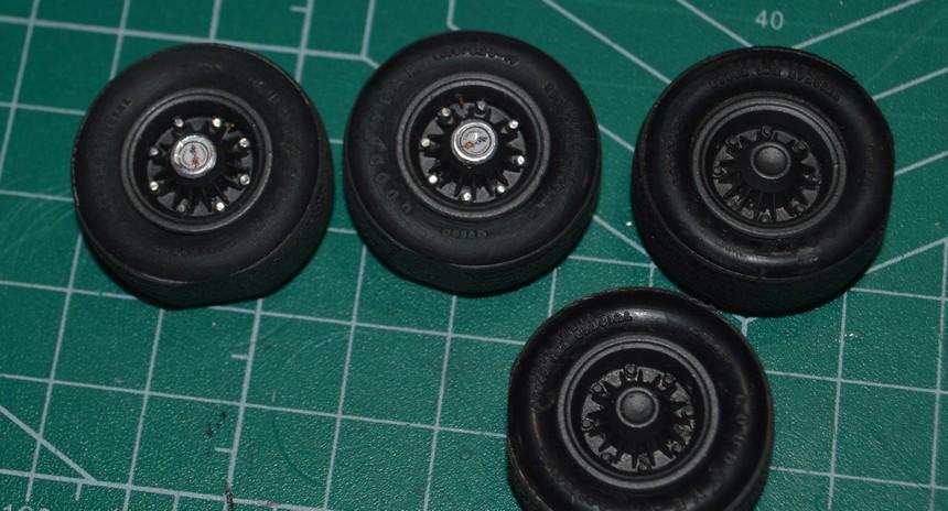

Straightliner59 Posted June 18, 2022 Author Posted June 18, 2022 Here are two of the wheels/tires completed, alongside two that have only been painted. I used a Scotch Brite pad, coned, and kind of shoved through the center of the tire, so that I could easily spin the tire, dulling the finish. I wanted to be sure I got a shot that illustrated the difference between the two "finishes". I added a drop of Floquil Crystal-Cote to the center of each wheel, to return the shine to them, after shooting Dullcote over the wheels (only).I really like the way these turned out! Questions, critiques and comments are always welcome. Thanks for looking!

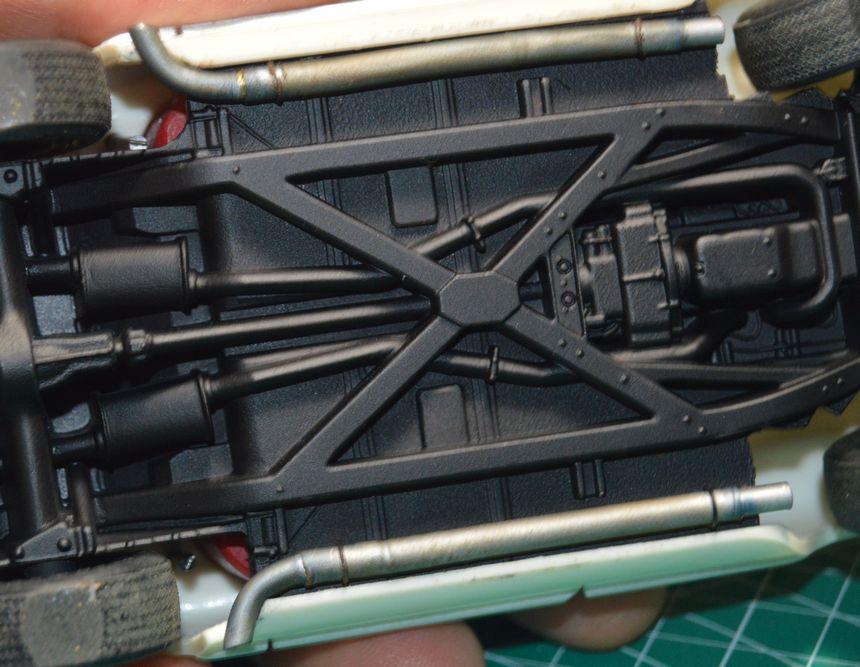

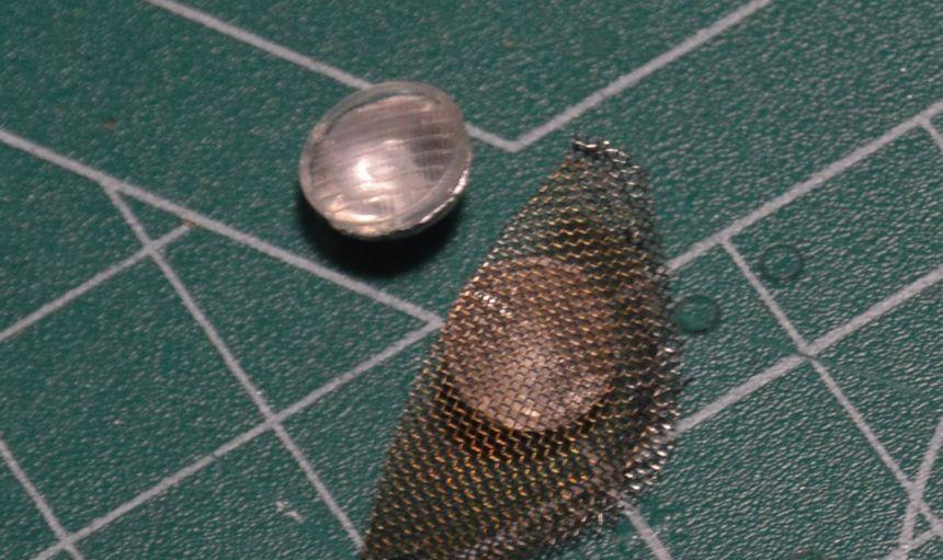

Straightliner59 Posted June 22, 2022 Author Posted June 22, 2022 Okay...I got the wheels and tires mounted to the chassis, and the pipes hung. I used Tamiya's engine/exhaust weathering set. I've used it on a few projects, now. I haven't found anything else that accomplishes the effects, it does. Great stuff! The pipes are essentially sidepipes that run along behind the rocker panels. I have some solder that happens to be 1/8". I'll use it to run the pipes up and out of sight. The roll bars are solder, as well. I'm trying to decide about the paint. I have a couple of ideas. The screen I am using for the headlights is from an old Brita on-tap filter. It's got a fine-wire, and fairly open mesh. The headlight screen bezels are going to be tricky. Given the proper-sized brass tube (1/2"), I can make a pair of punches to cut them from tooling aluminum, but, I am waiting on the tubing. I think, as Rusty said, that the wheels give it a real badass look! I like it. I'll probably work on the interior, next. I have white gauges printed, and drew a custom speedometer in white. As always, comments, critiques and questions are welcome. Thanks for looking! 2

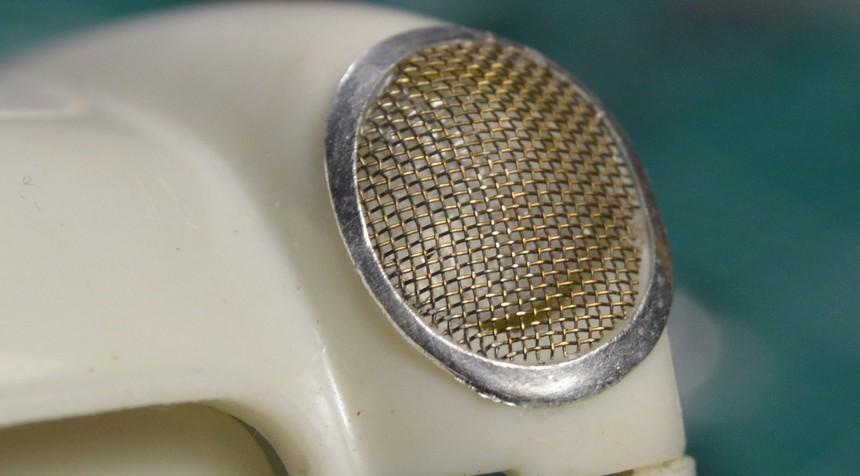

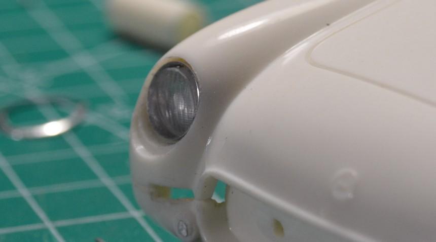

Straightliner59 Posted June 25, 2022 Author Posted June 25, 2022 I got the 1/2" tubing I was waiting on. I made a pair of punches from 1/2" and 3/8" tubing, then formed them to elliptical shapes. I punched this bezel from duct tape. I will make the finished ones from tooling aluminum. I trip to the doming block will smooth the wrinkles, and give them a slight curve. I think this'll work, just fine! 1

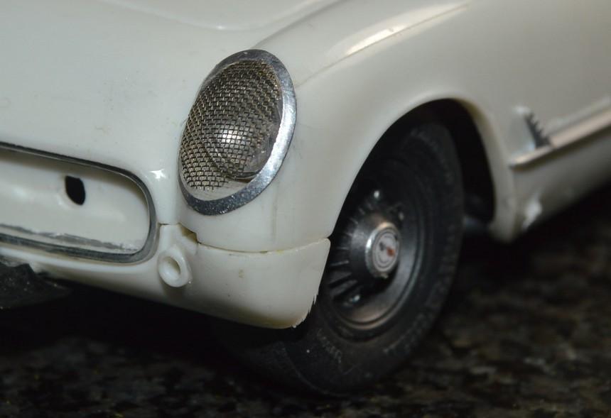

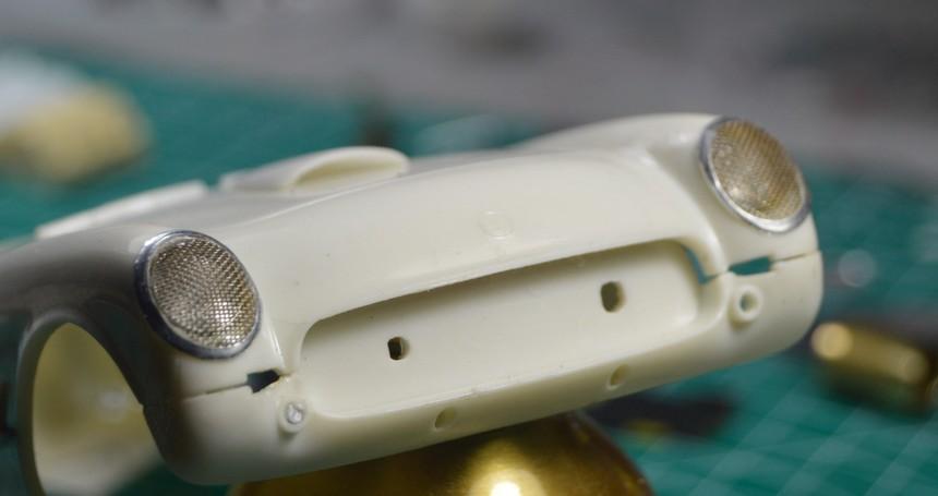

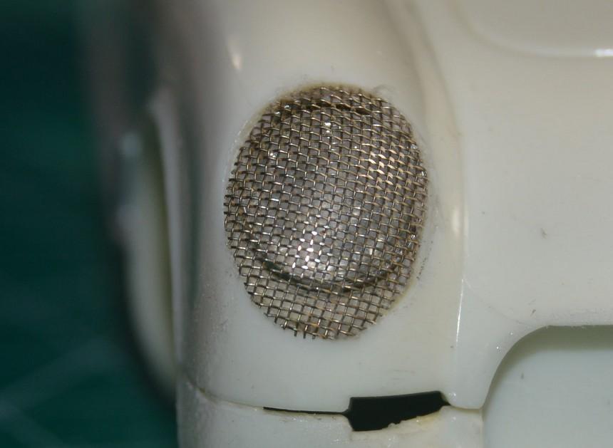

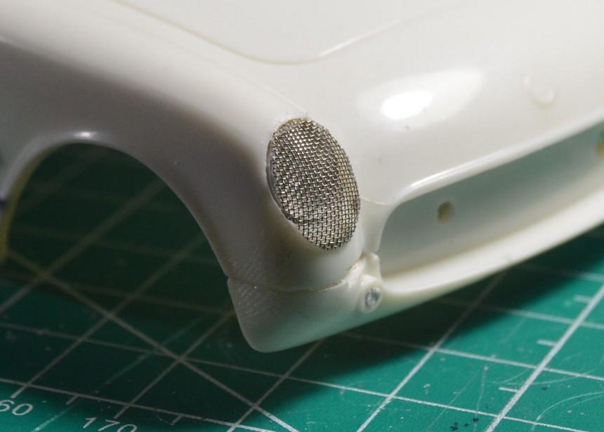

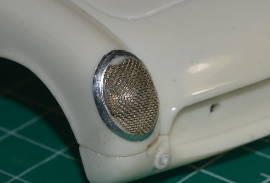

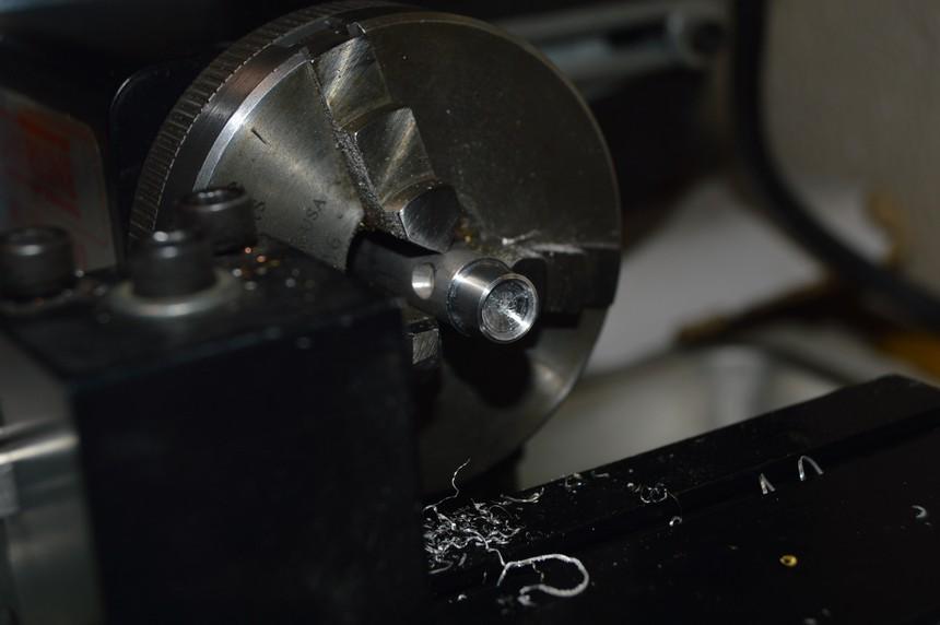

Straightliner59 Posted June 26, 2022 Author Posted June 26, 2022 I got the headlights sorted. I will grind away the rear of the tunnels, before any paint goes on the body. A bit more trimming and fitting, and the screen will be perfectly fitted. I punched the screen bezel from tooling aluminum, using homemade punches, then shaped it with a doming block. I turned the headlight ring on the lathe. It was a tight squeeze, getting that in. Everything except the headlight "tunnel" (I still have to do all of this, for the other side) is only white glued in place, and will be fine tuned into position, upon final assembly. Questions, comments an critiques are always welcome. Thanks for looking! 3

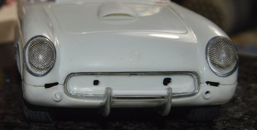

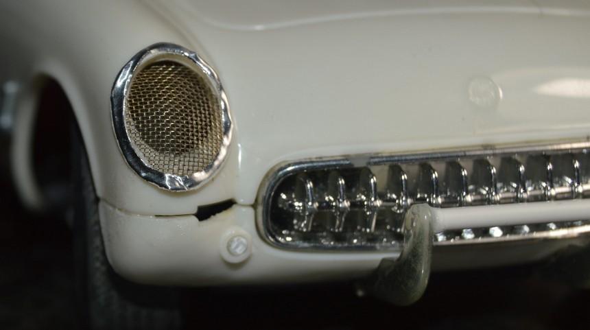

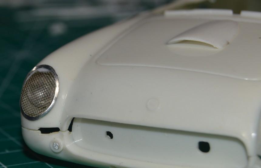

Straightliner59 Posted June 27, 2022 Author Posted June 27, 2022 Ya' gotta have a pair! I still need to make the ring for the headlight, itself. I'll probably end up making more of the screen rings, until I get an even pair--these punches aren't exactly simple to align! Anyway...I now know I can have nice headlights. Thanks for looking! 1

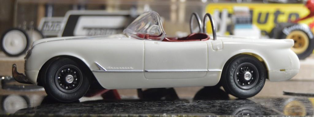

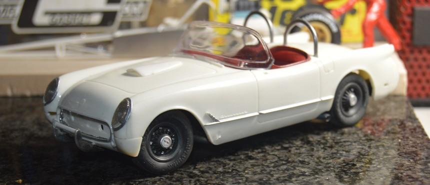

Straightliner59 Posted June 30, 2022 Author Posted June 30, 2022 (edited) I am awaiting some items to arrive, for this project, but, there's still plenty I can do. I remade the exhaust, and got it hung. I've been working on little items for the interior, like the door handles (knobs), and the switches for the spartan interior. I am thinking I'll make the switches for the lights, main power and fuel pump resemble the factory switches/knobs, in white, red and yellow, respectively. I'm blocking off the radio and heat controls. I opened the grille, but I nicked the face with the Dremel (DOH!), so I have another kit on the way. I also am getting some stainless steel screen for the headlights. Anyway, here are a couple of shots of it, back on the wheels. Thanks for looking! Edited June 30, 2022 by Straightliner59 1

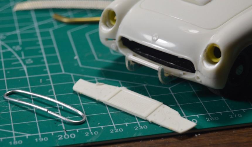

Straightliner59 Posted July 2, 2022 Author Posted July 2, 2022 I made a new grille surround from .052" aluminum wire. I'll add a bit of detail to the radiator wall, and install it behind the open grille. I'm considering a small aluminum chin spoiler, too. The grill surround needs some fine-tuning, but, I'm happy with it! 1
