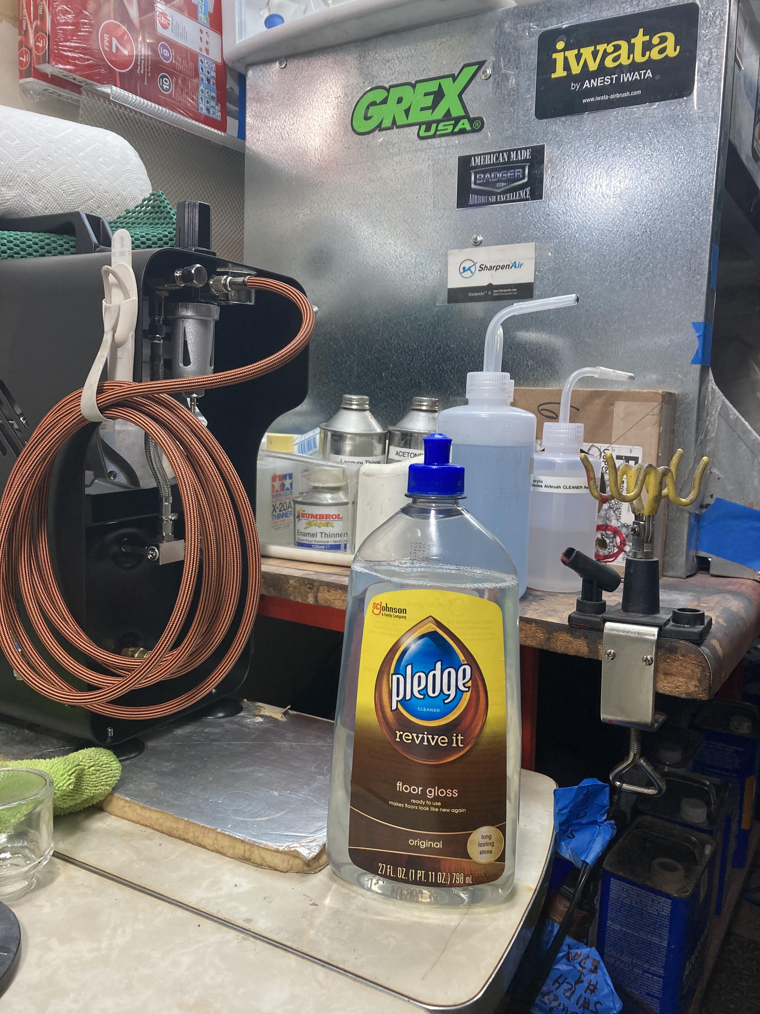

Because its a because non-yellowing and self-leveling, I`ve been airbrushing Johnson & Johnson Future aka Pledge Revive It Floor Gloss as a clear top coat for awhile. Also, its not to hot for ANY kind of base color coat; be it lacquer, acrylic,enamel etc PLUS it will not harm decals. However, I`m interested in venturing out of my comfort zone and trying other clear coats that are airbrush-able. I prefer airbrushing because you have far more control of the spray output and it`s more cost effective than rattle can. So I`m interested in what you good folks are using as a clear top coat. All suggestions and input are welcomed. Thanks for replying in advance.

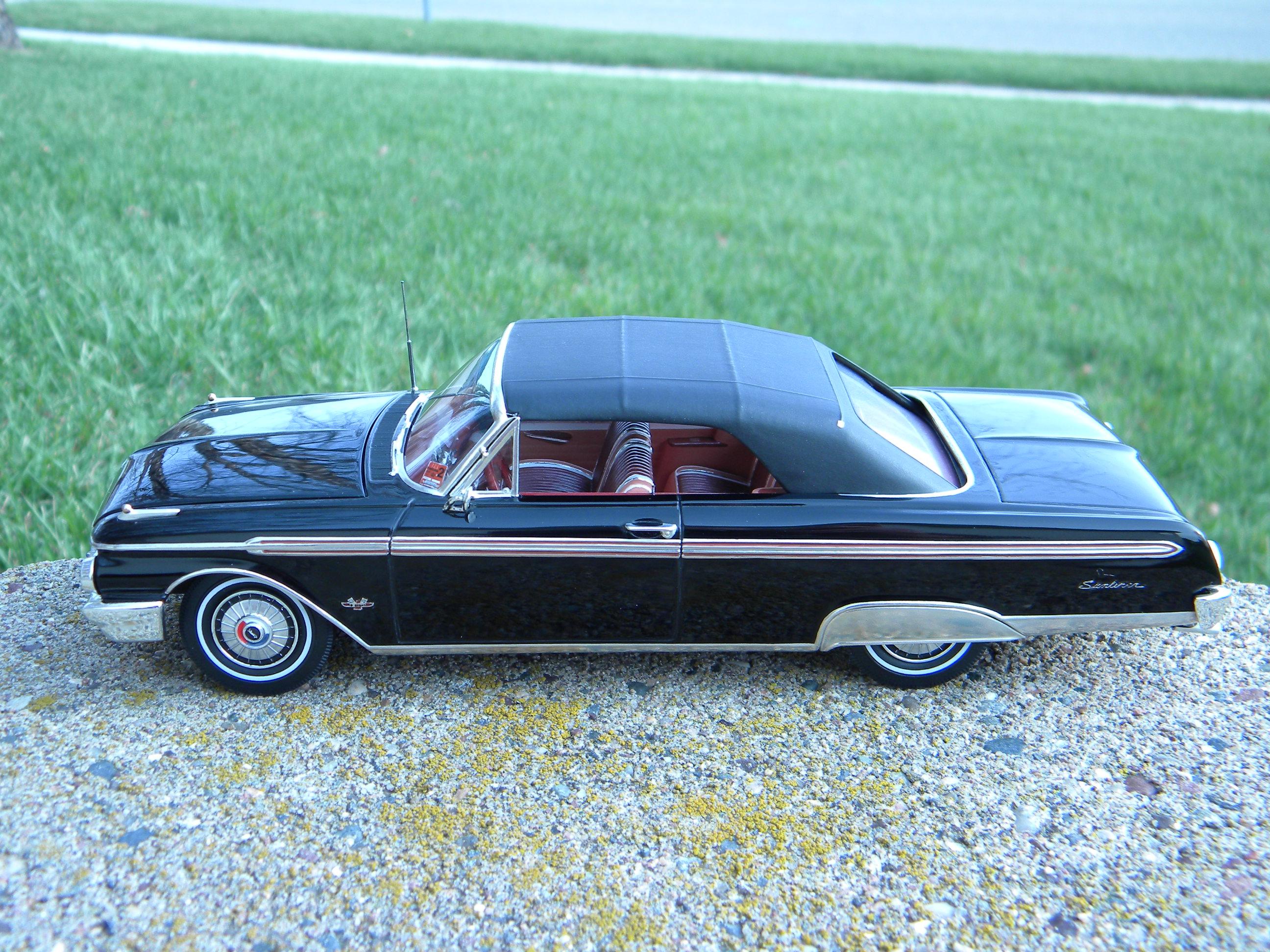

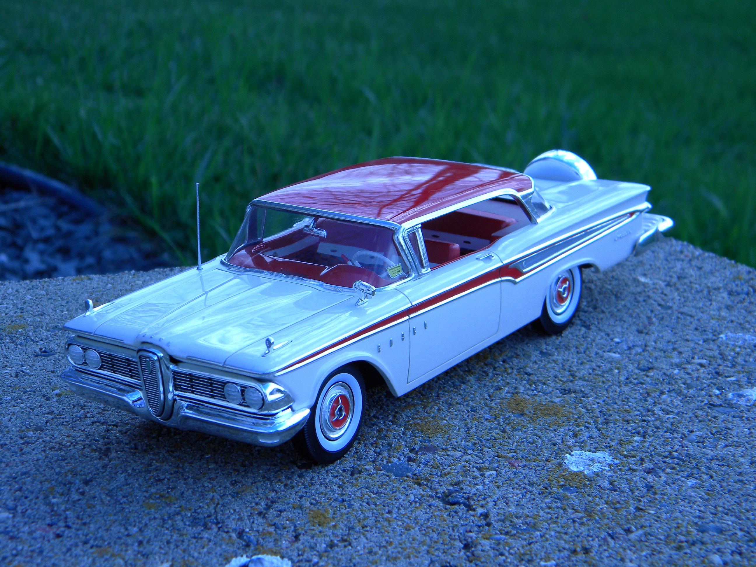

Well, It's not air brushable, (unless you want to decant it) and it's only usable over lacquer, but I use nothing but Duplicolor "Clear Protective Top Coat".
I love the stuff because it sprays on so nicely, with great control with the fan spray nozzle, and goes on so thin that multiple coats are possible, which allows for polishing depth without hiding detail, and it dries to a very tough, durable finish.
It's not initially as glossy as some other clear coats, but it polishes out to a very smooth, shiny and realistic looking finish.
I routinely use as many as 5 coats of the stuff, right out of the spray can, without any detail hide.

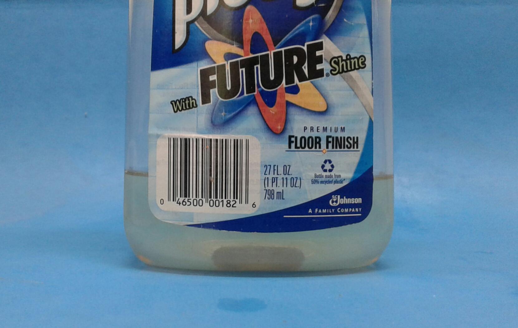

Future WILL yellow over time. But, it's not a big deal unless you put it over white or a similar light color.

I use Micro-Mesh pads and Novus polish, with a little Turtle Wax "Scratch and Swirl Remover" at the end.
I know that a lot of builders look for ways to apply paint to avoid any polishing, which is just great.
But my opinion is that even a shiny paint job can benefit from some polishing.
To my eye, raw paint can often have a "hard candy" appearance that can sometimes make a model look like a model instead of something closer to the real thing.
After all, the absolute best automotive painters still "cut and polish" their projects before they go out the door.
As far as I know, yellowing isn't a problem with Duplicolor clear.
I have several models in white that are at least 8 to 10 years old, and there is no signs of yellowing.

Plowboy I appropriate you setting me straight on the fact that Pledge WILL yellow over time..particularly when sprayed over "white" color coats.
