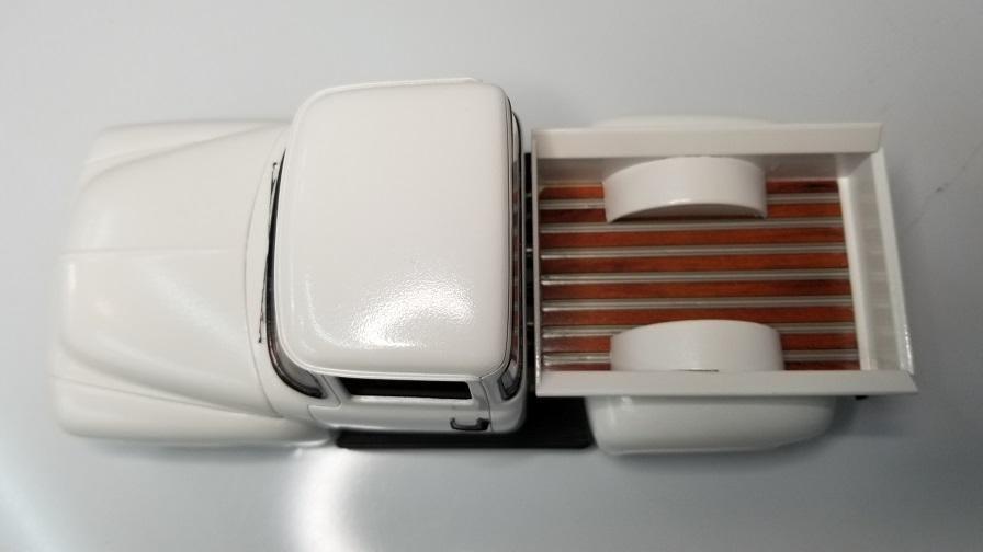

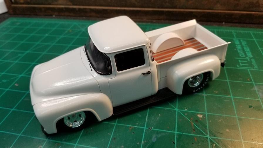

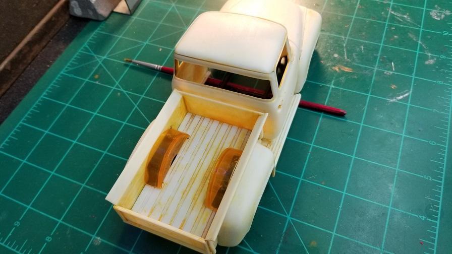

Zippi Posted July 23, 2022 Posted July 23, 2022 I used pill bottles on my first attempt at turning a 56 Ford pickup into a Pro Street. The AMT 67 Chevelle Pro Street and AMT 66 Nova Pro Street chassis are used a lot under various kits. I used the 67 Chevelle chassis under the AMT 55 Chevy to Pro Street it. More than one way to skin a cat. I'm still learning myself.

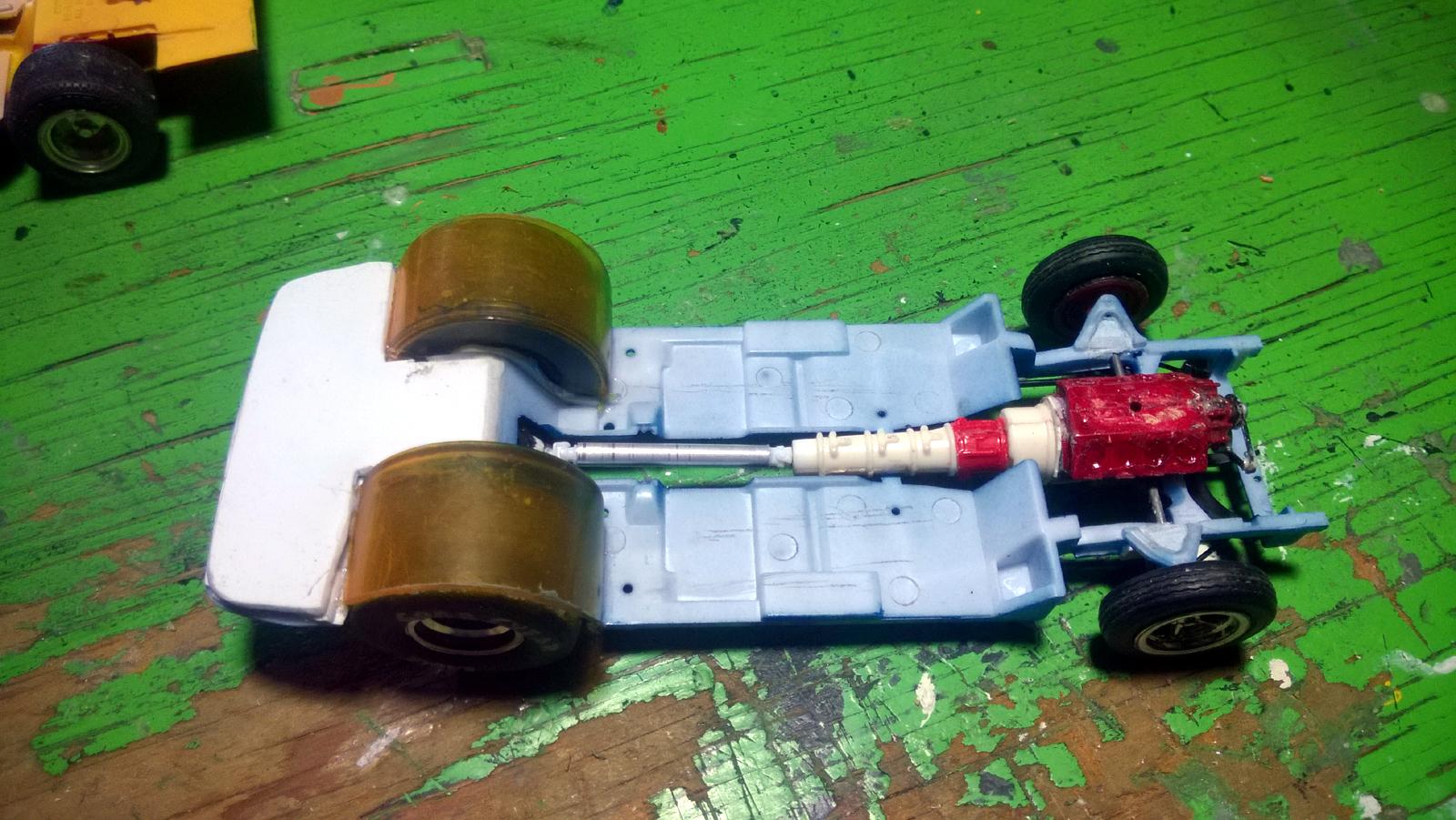

Daryl Romain Posted August 13, 2022 Posted August 13, 2022 Yup. Pill bottles. This is a Revell '70 Cuda, but the technique is the same.
