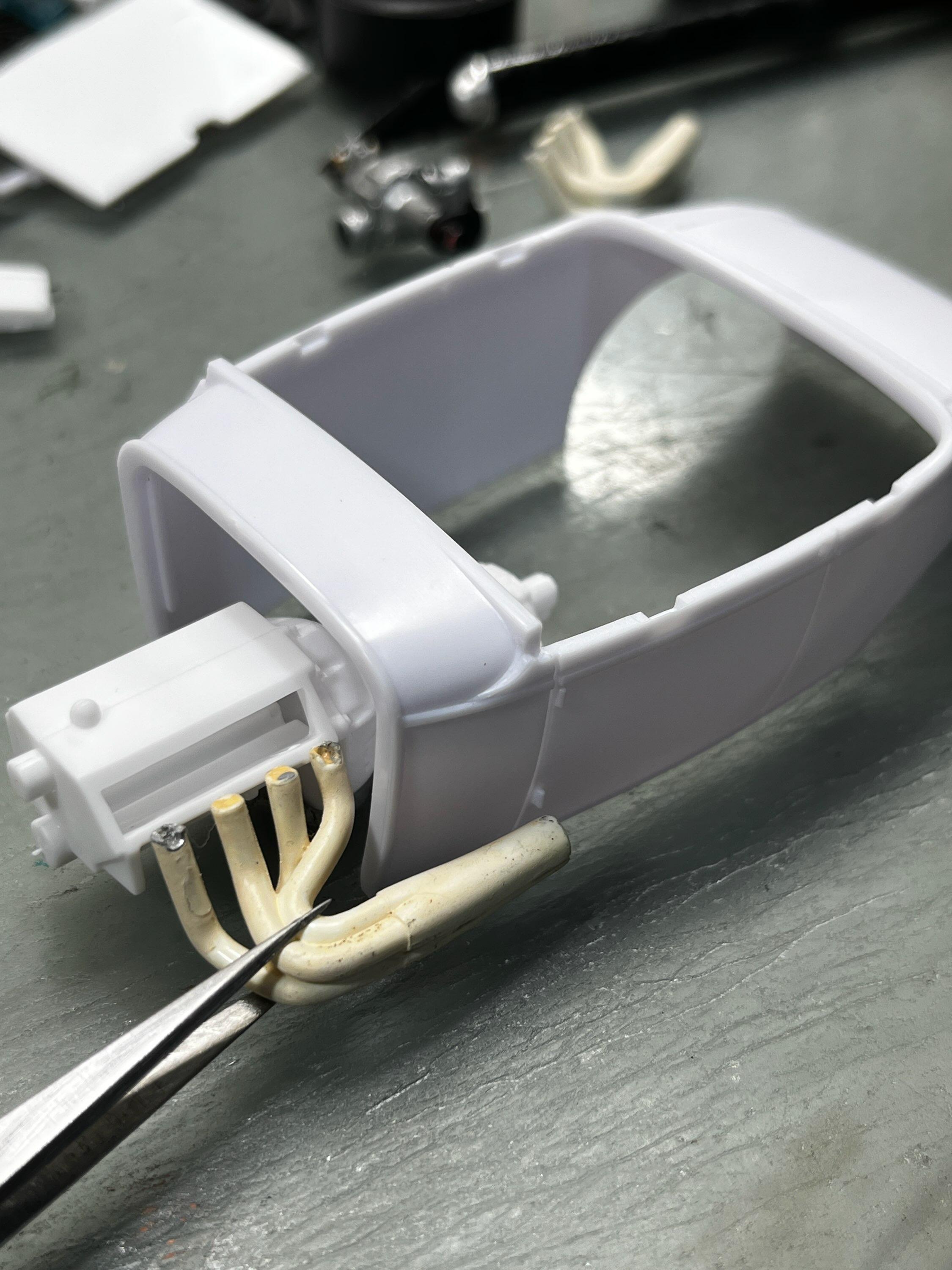

We talked about a couple different power plants and RRR started gathering parts:
This is where RRR starts getting all up in the build... actually a bit excited!

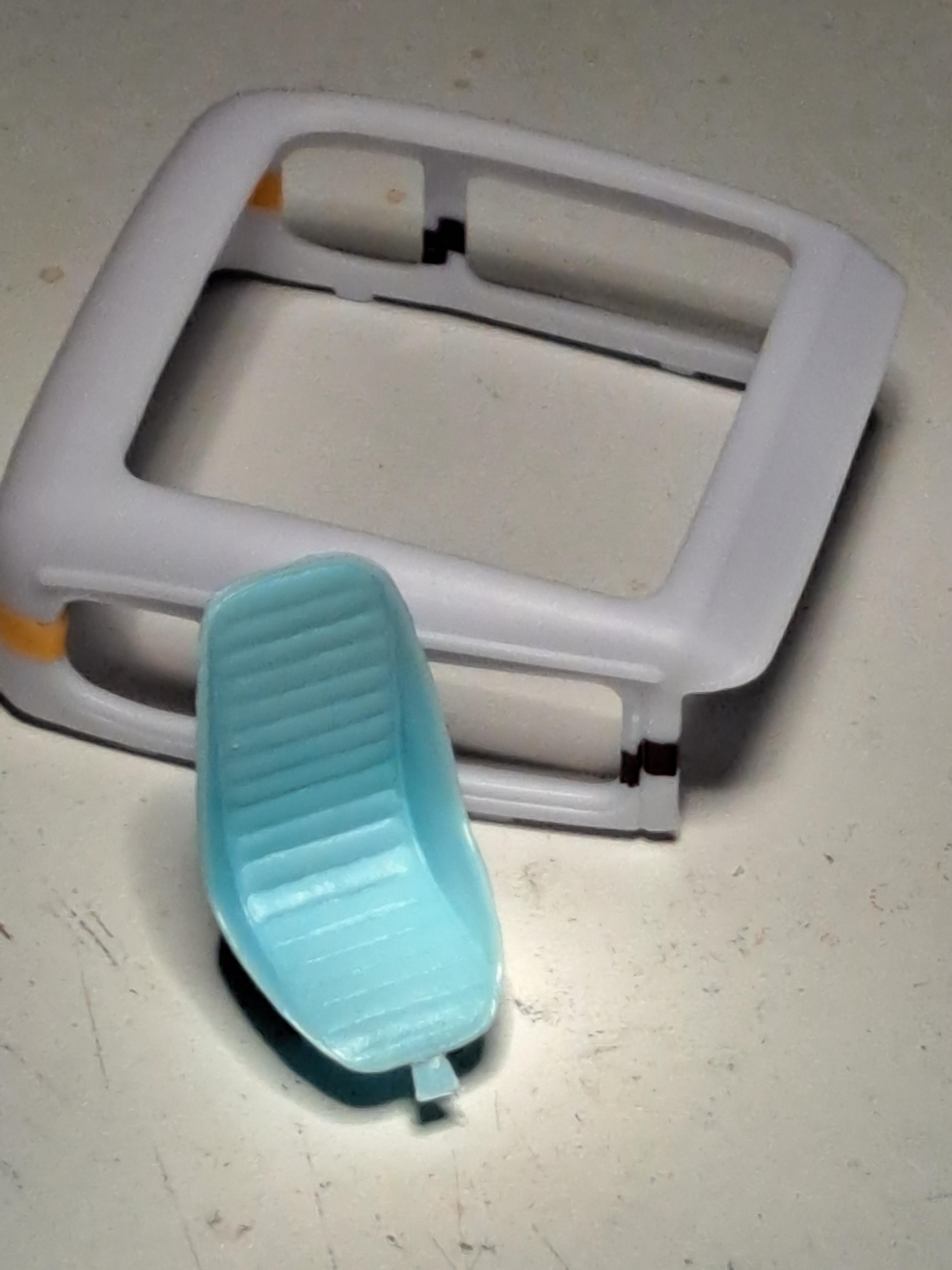

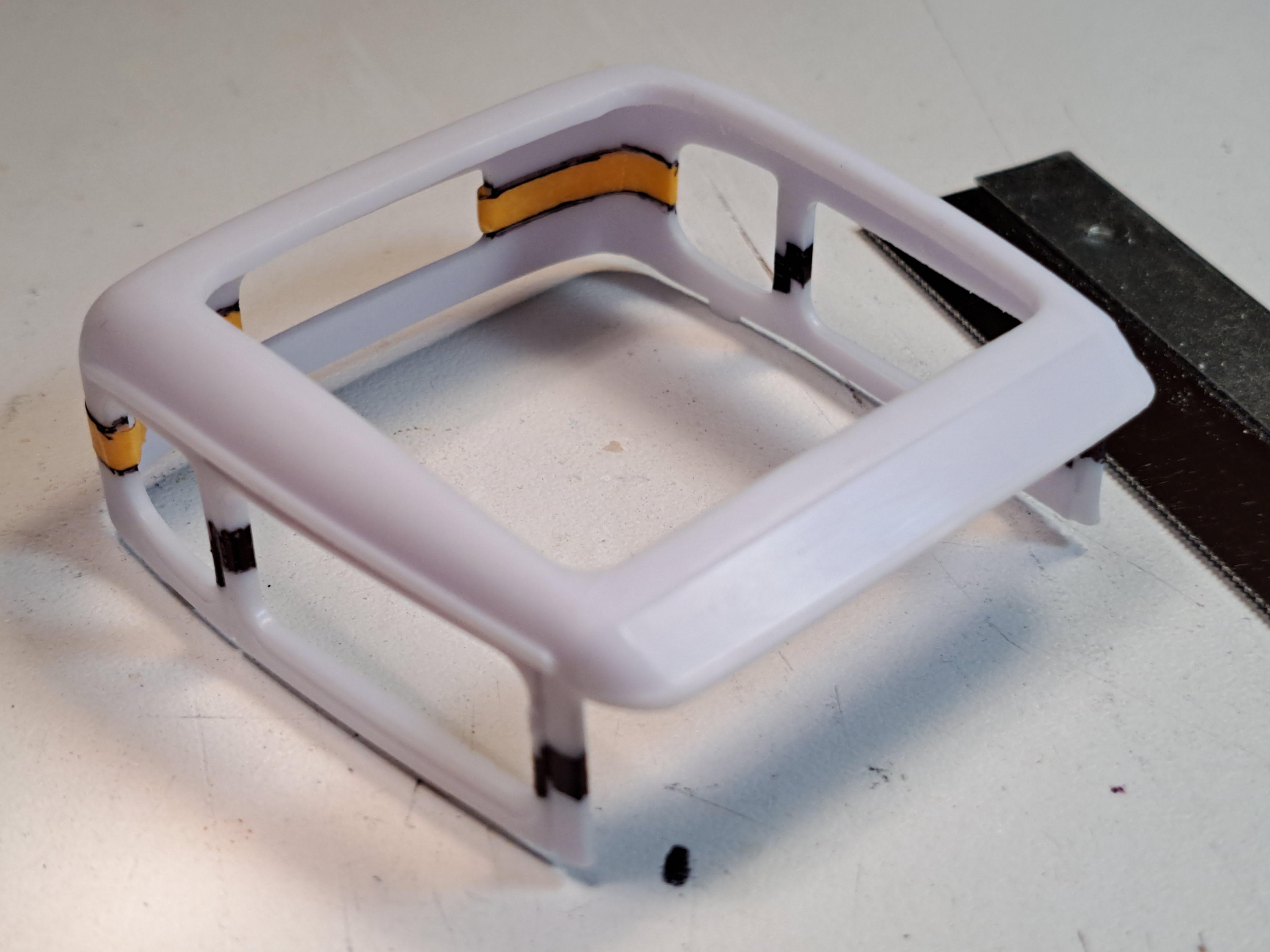

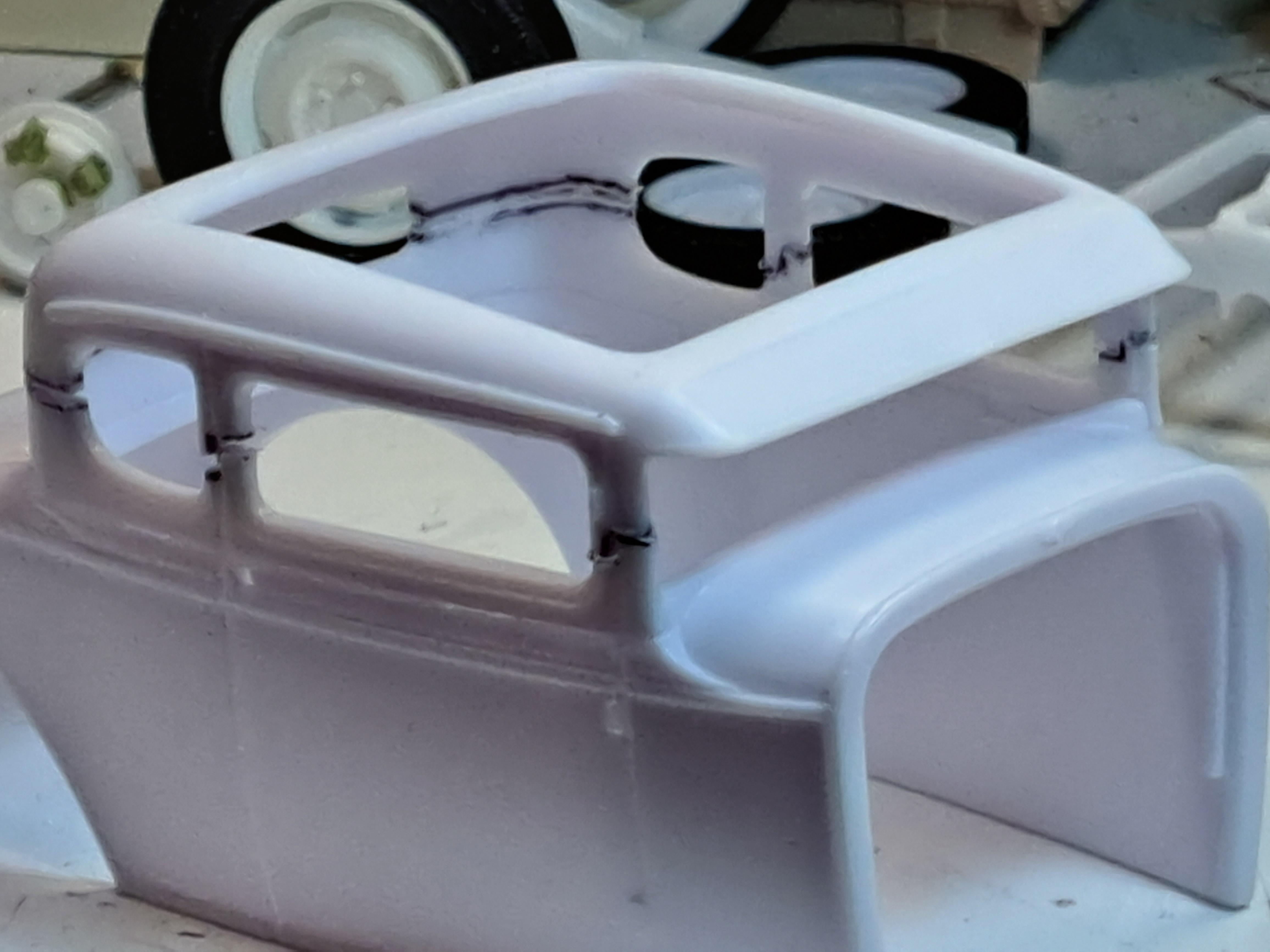

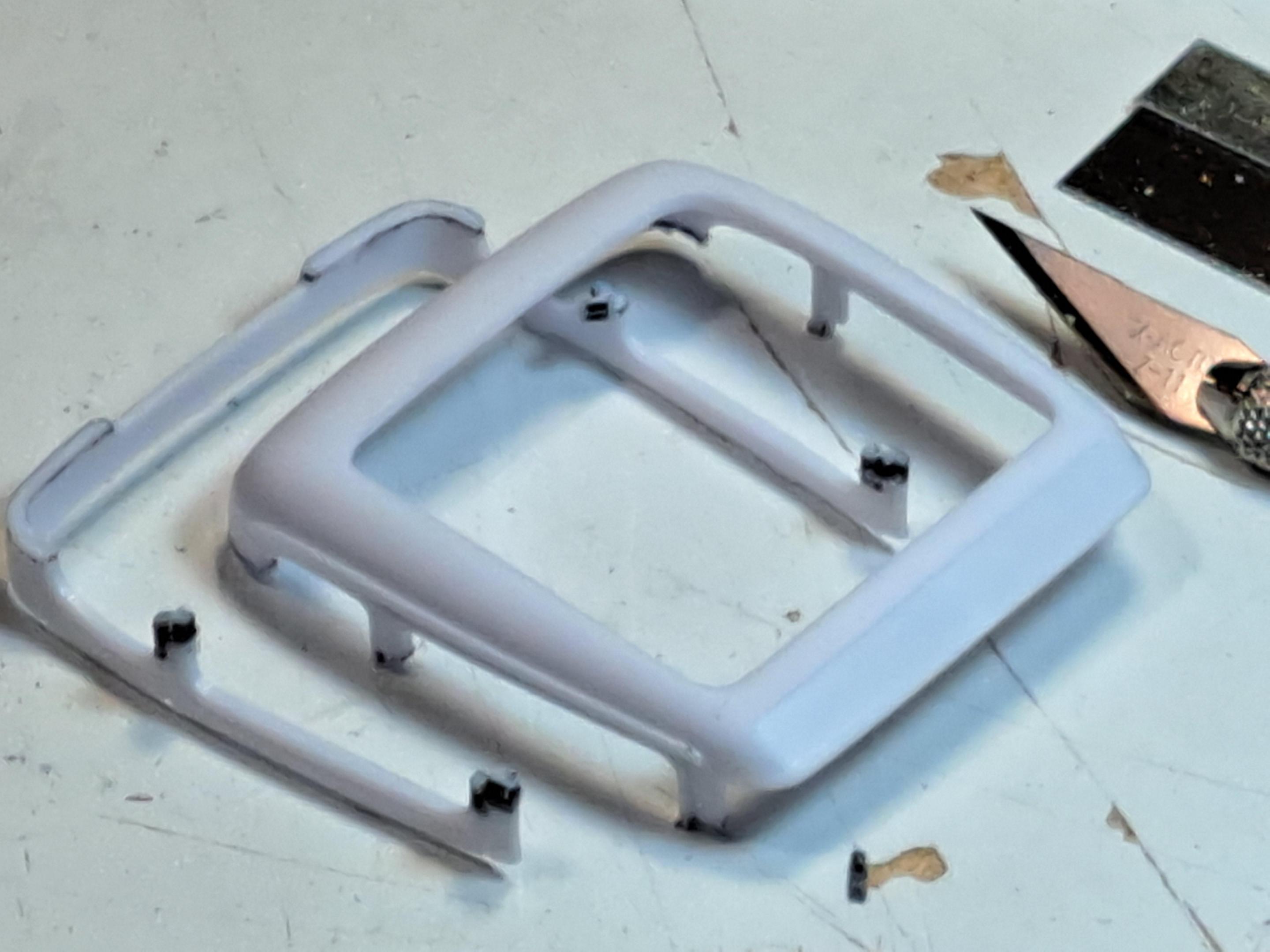

This is where his missing top became my part of the mission goal... my orders "Chop It!" Oh, and send the passenger's bucket seat out of the AMT '33 Willys...

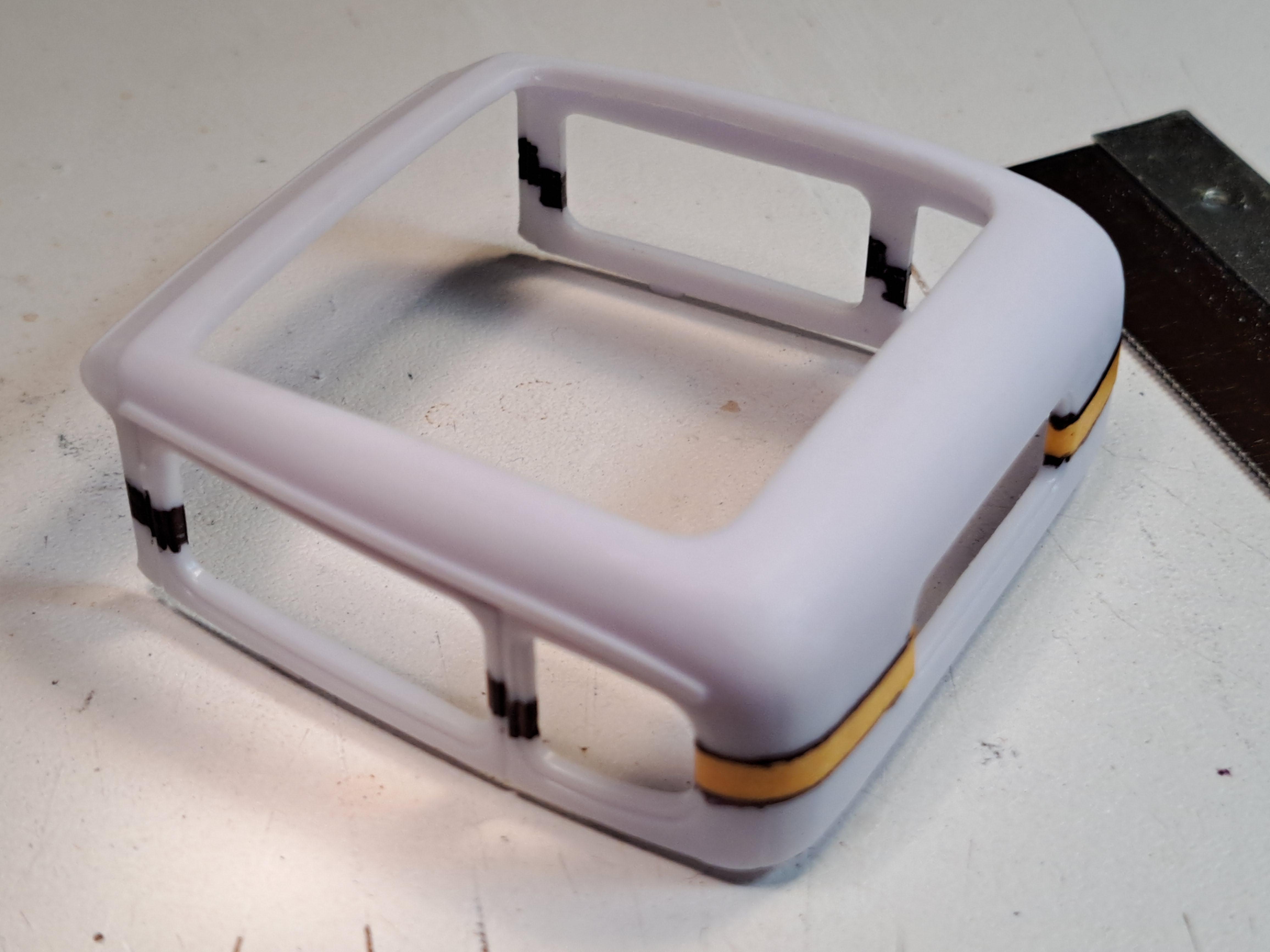

Laid out the first step:

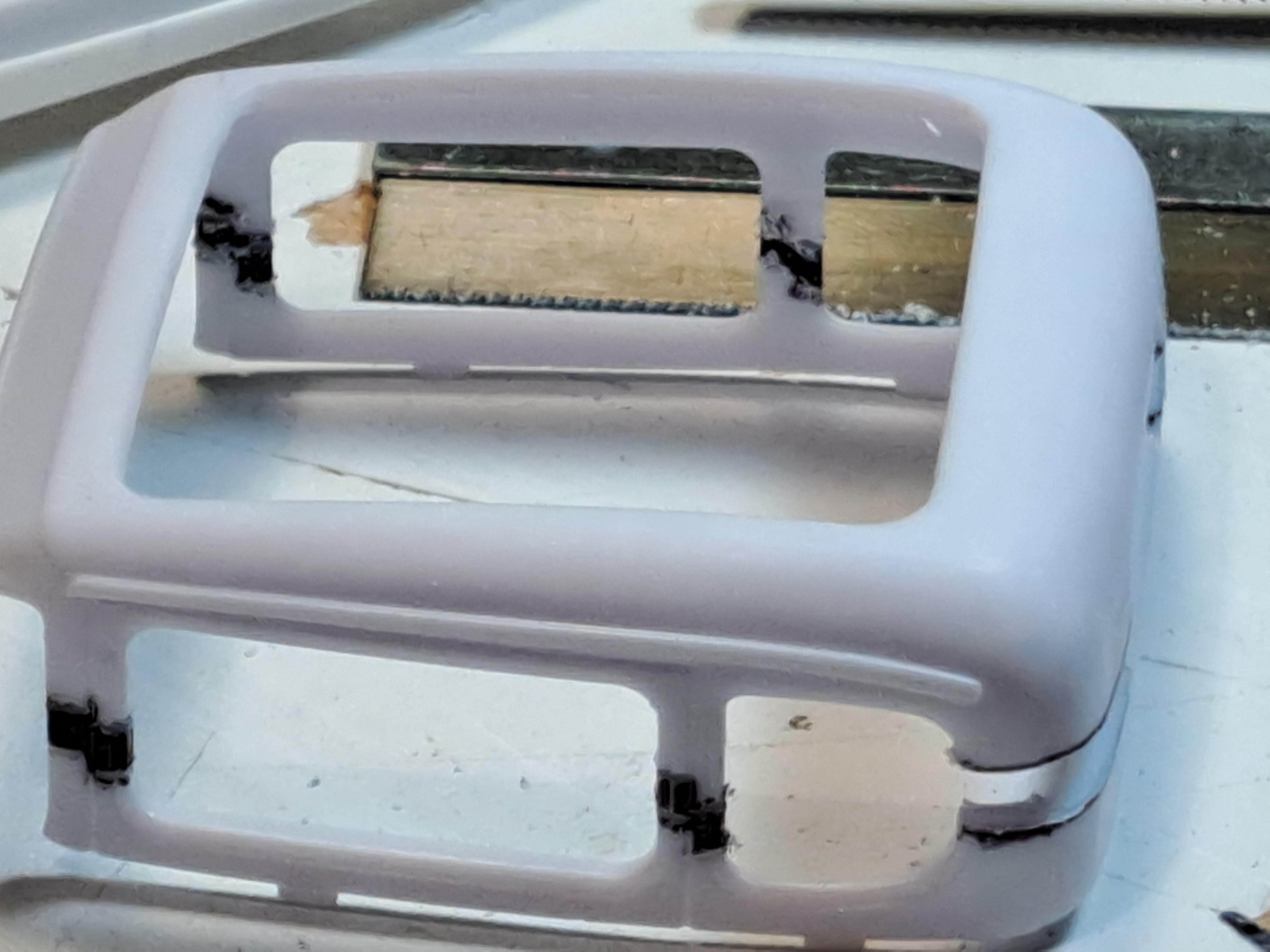

Traced the cut down tape:

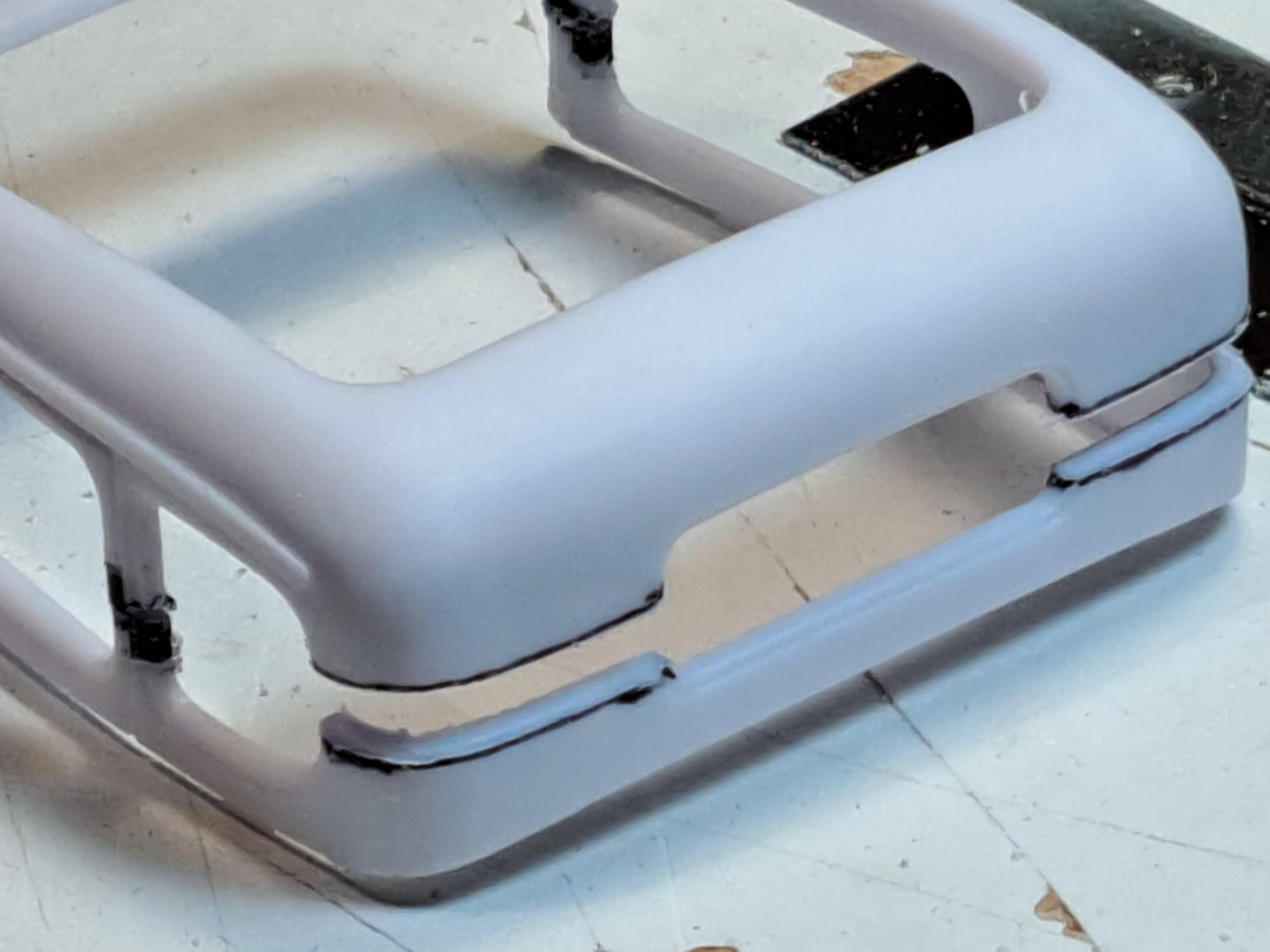

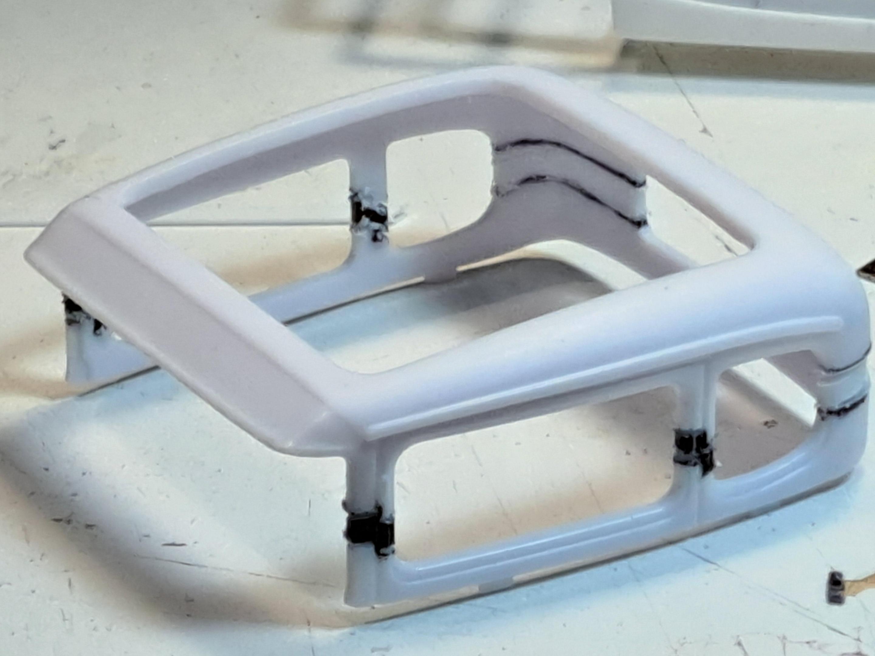

Removed the tape pattern and started alternating cuts... this is where "leave" v "take" the line matters!
We'll leave this here for now... Big twist is yet to come!! -KK&-RRR

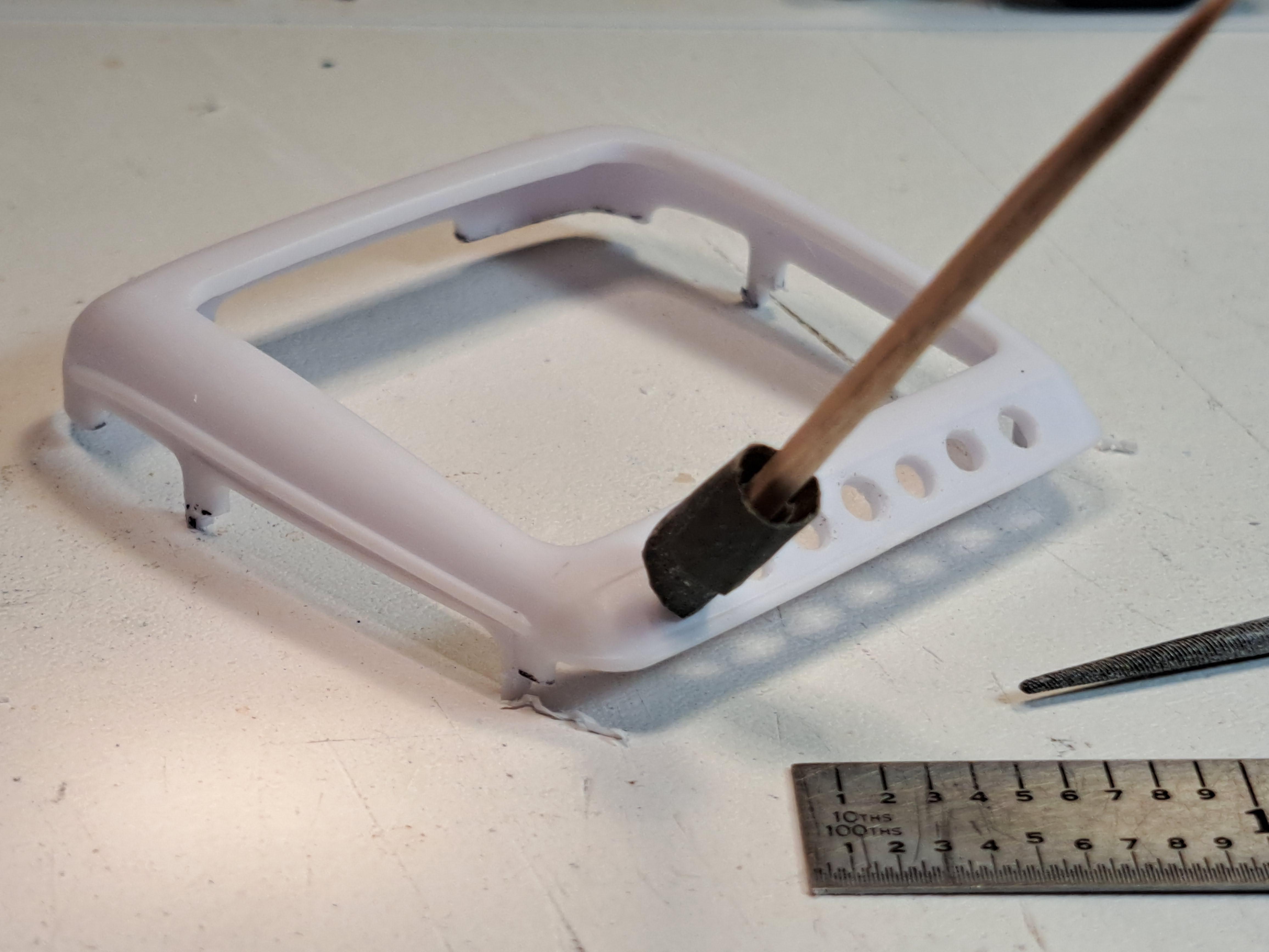

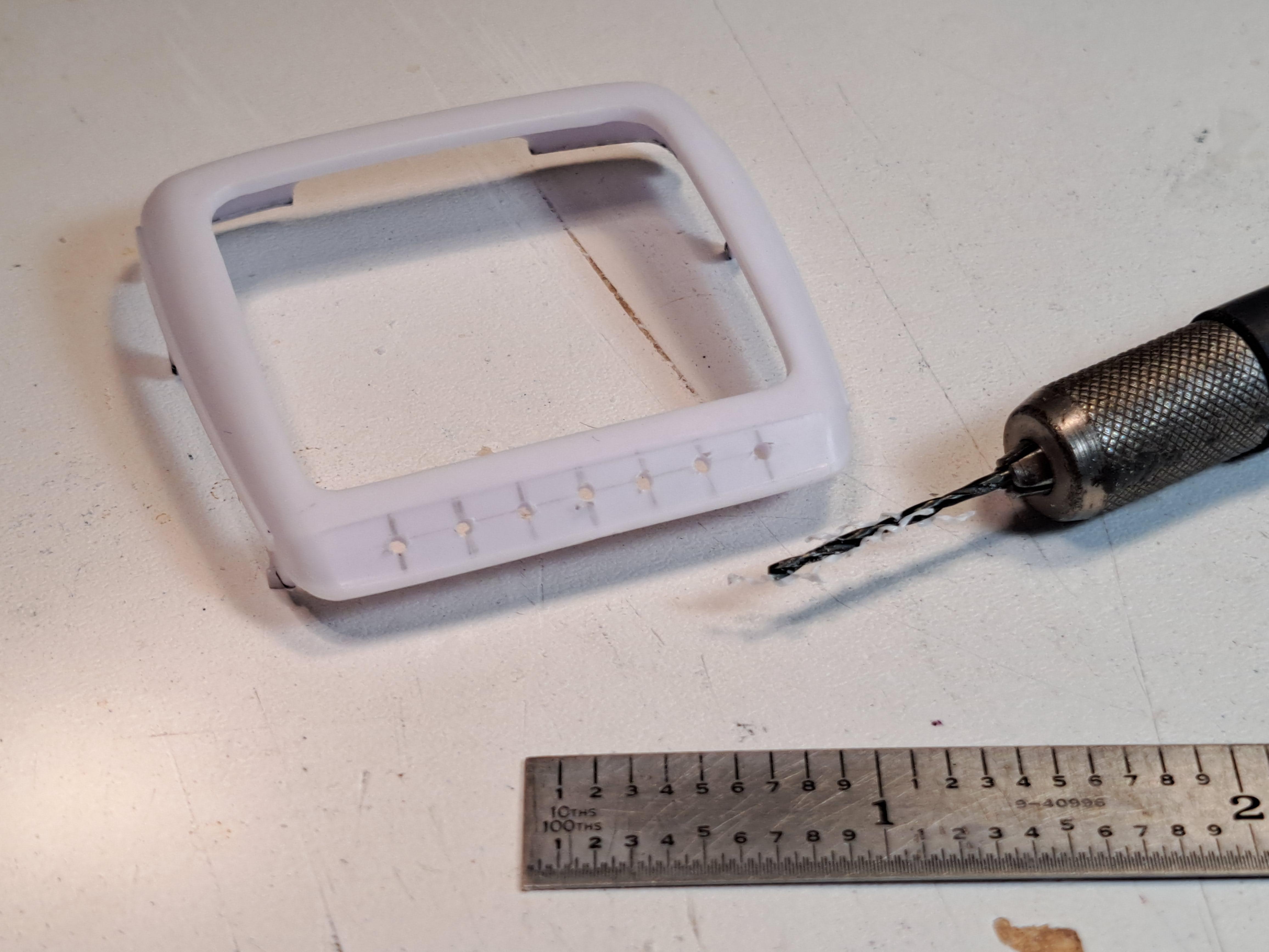

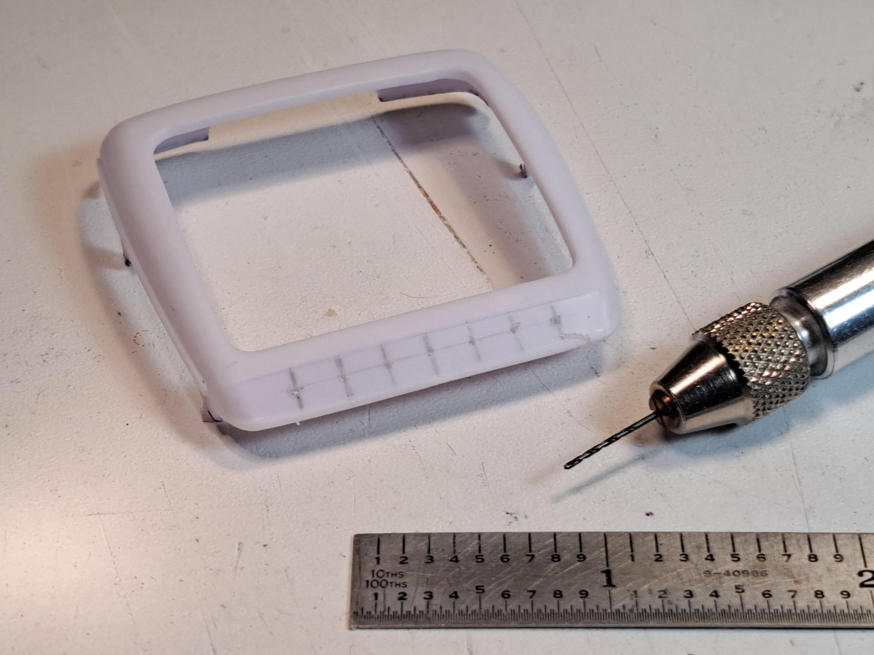

Stepping into the subject matter at hand... work, under the direction of @Rocking Rodney Ratthe modifications to the 5W's wheelhouse continue:
Space out 7 points to drill holes in the visor pre-drill the pilot holes with my favorite pin vice...
Step the bit size up a notch... using my antique no-name pin vice found at a local garage sale thirty years ago and it was old back then!

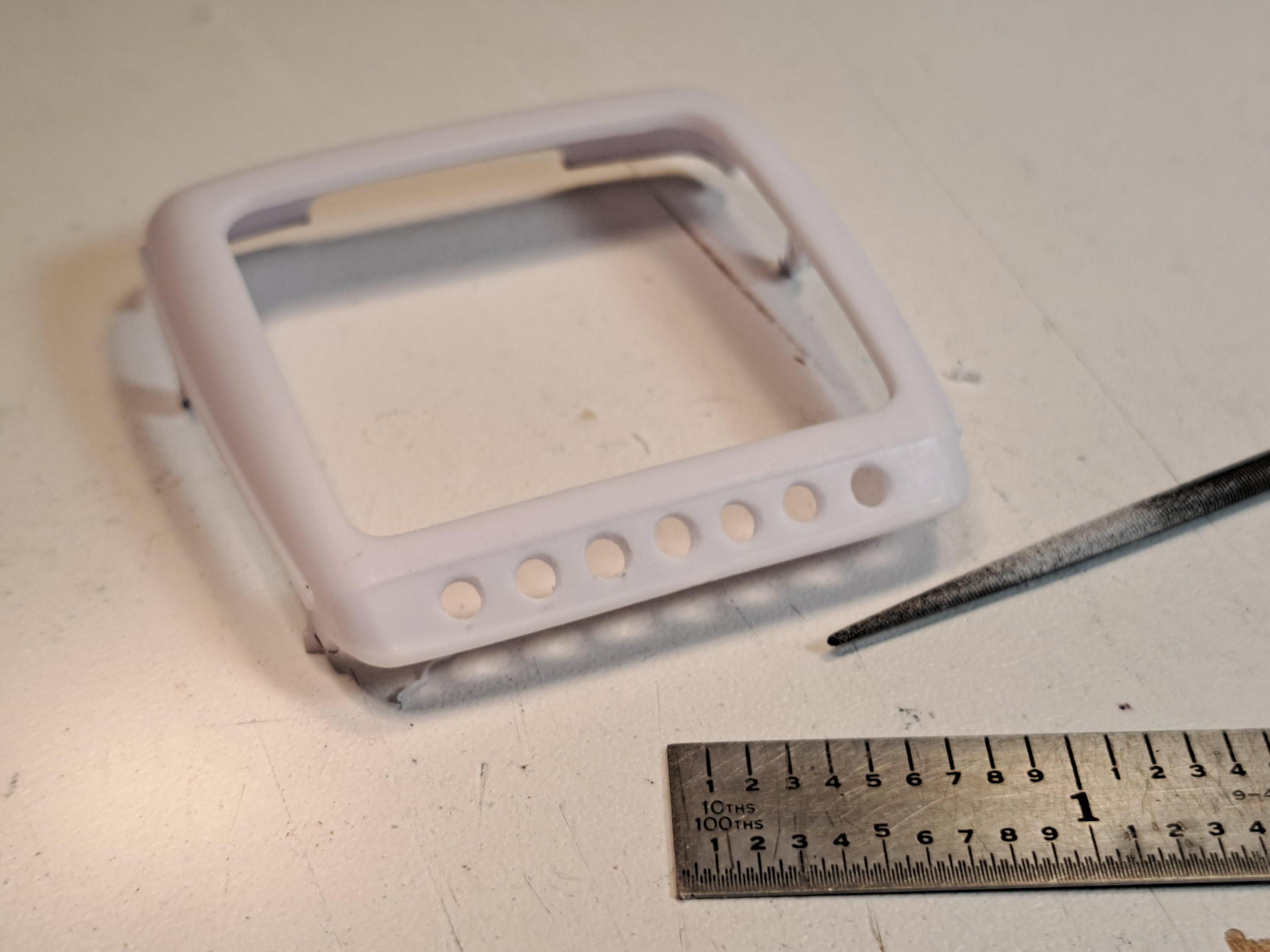

Last turn with a hand brace and bit to counter sink the outer edges of each orifice...

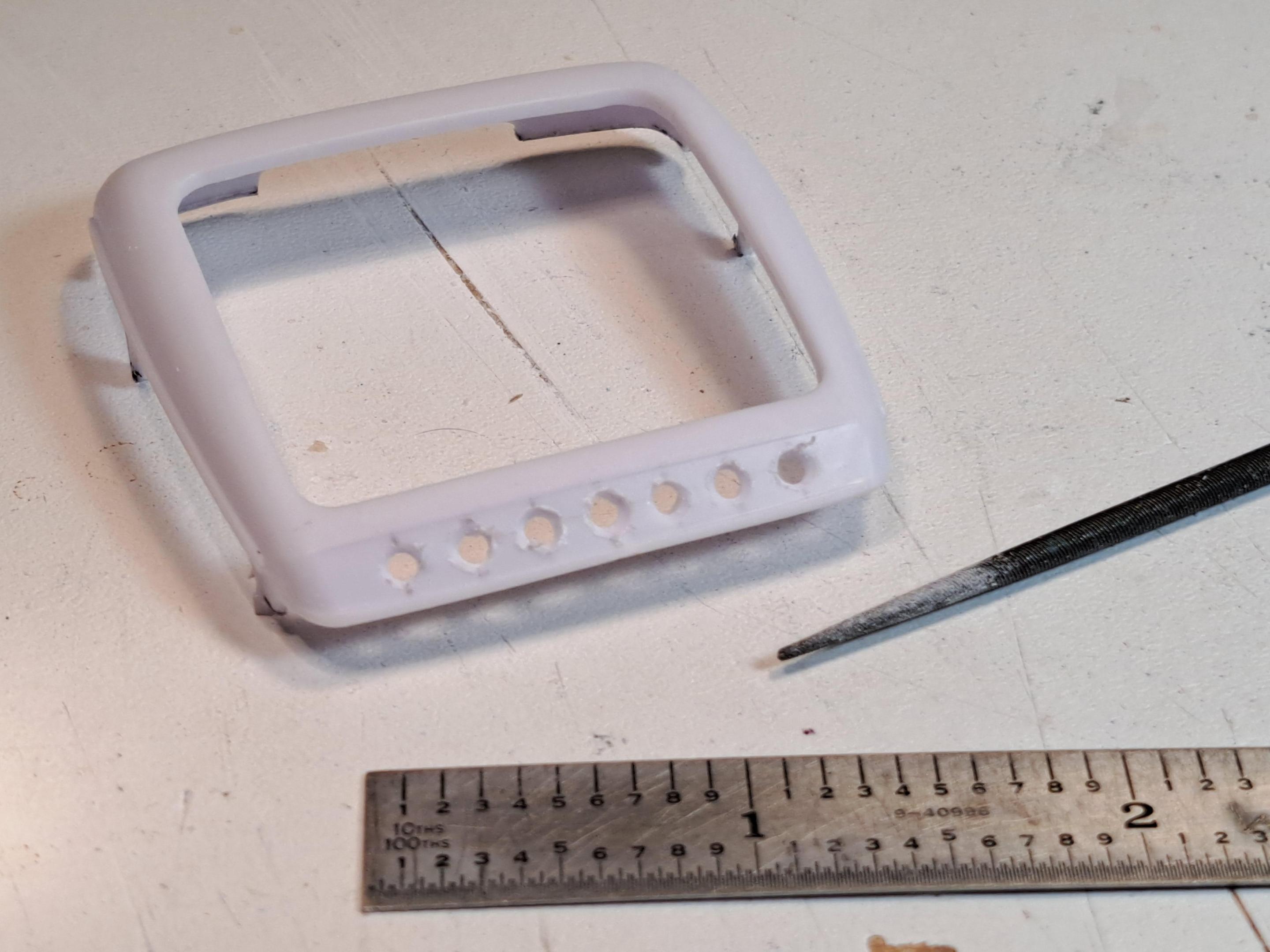

Even out the inside diameter with my jeweler's round rattail file...
The center hole is placed intentionally to catch the viewer's eye!  There are 7 "Lucky Seven" lightening holes across the visor about to be finished...
Wrap a torn piece of fine sandpaper around a wooden toothpick & turn slowly until smooth! -KK

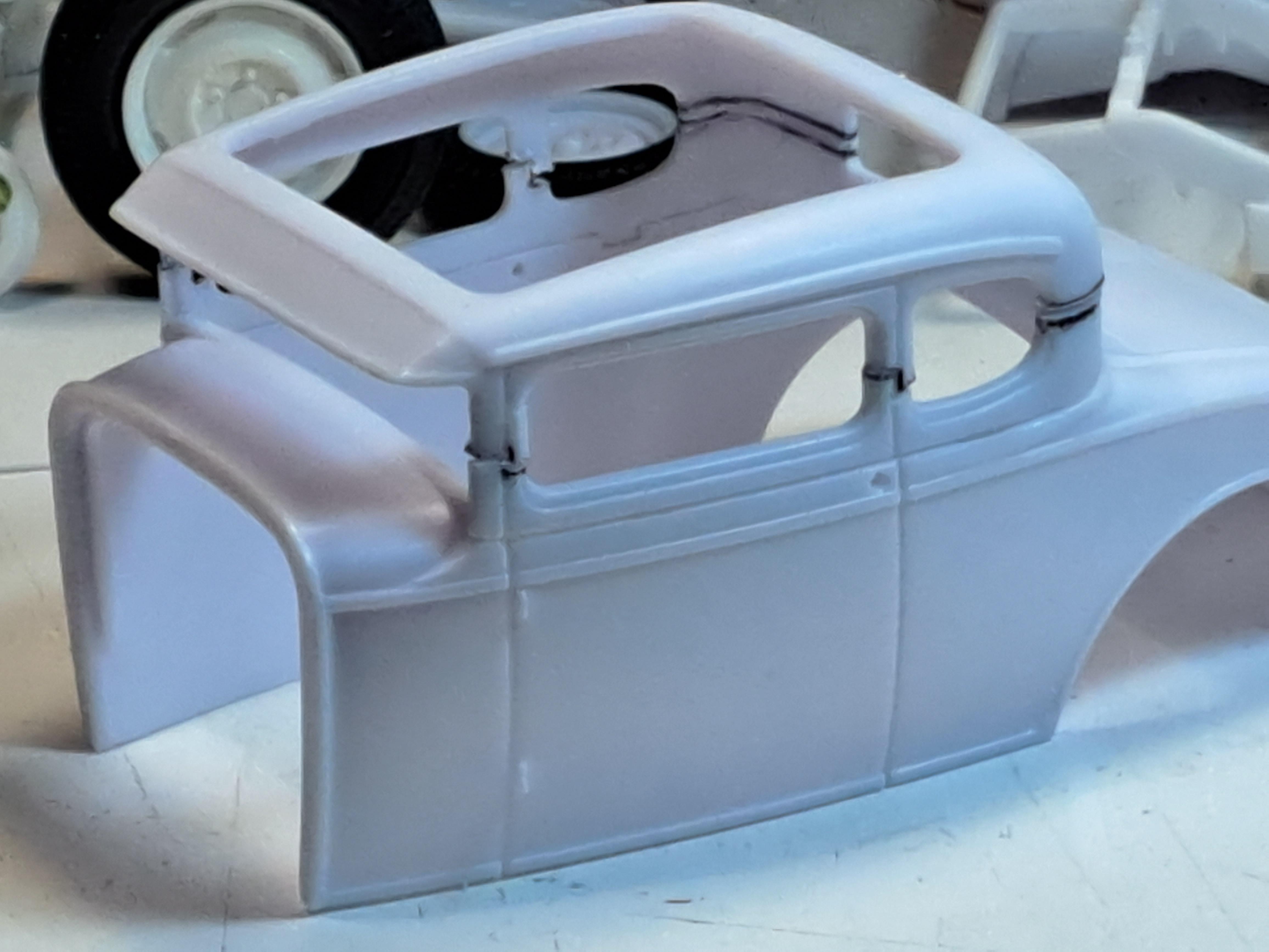

After a short discussion it was agreed to that the two pieces that make up the greenhouse would be better served being assembled by @Rocking Rodney Ratonsite.
Everything above the belt line is crated and has been shipped along with a few aftermarket products and a couple sets of 12-spoke wheels & tires!  -KK

Oh, and the '33 Willys Passenger Side Bucket Seat was shipped in the same crate with the wheelhouse cabin... Now it's up to you to bring this wicked Model A to life! -KK
