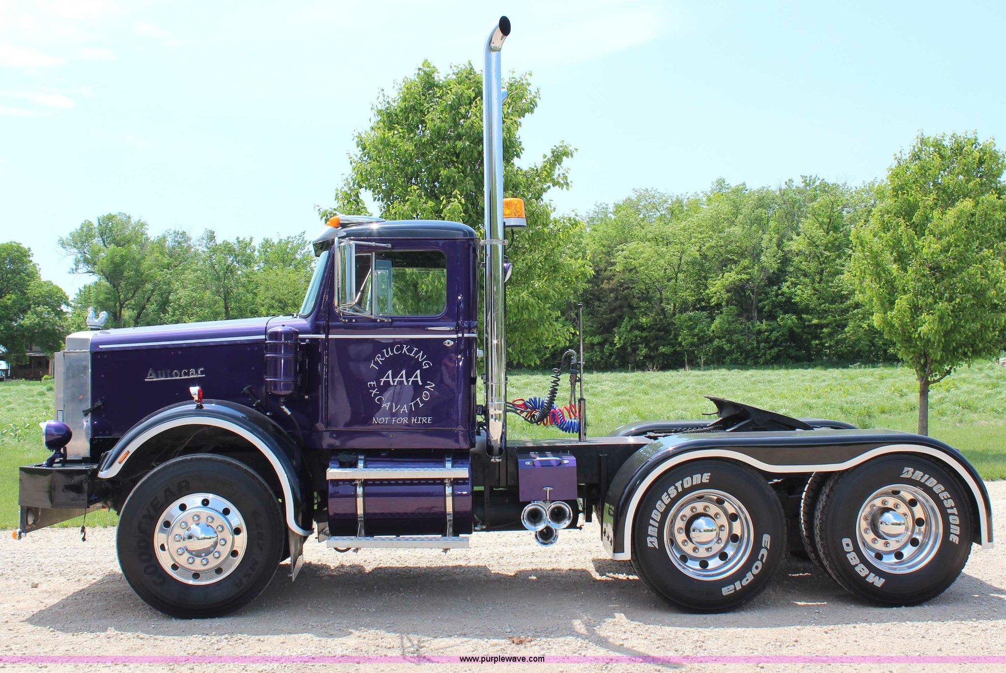

Jim B Posted August 10, 2022 Posted August 10, 2022 I am finishing up the AMT 1972(ish) Autocar A64B. The kit comes with some black vinyl tubing for the tractor-trailer air lines. I want it to look moderately correct, so about how long were these hoses generally? Or were they vehicle specific? Thanks.
yh70 Posted August 10, 2022 Posted August 10, 2022 1 hour ago, Jim B said: I am finishing up the AMT 1972(ish) Autocar A64B. The kit comes with some black vinyl tubing for the tractor-trailer air lines. I want it to look moderately correct, so about how long were these hoses generally? Or were they vehicle specific? Thanks. 12' to 15'
Jim B Posted August 10, 2022 Author Posted August 10, 2022 That long? Wow, didn't think they were that long, but I guess longer is better.

yh70 Posted August 11, 2022 Posted August 11, 2022 4 hours ago, Jim B said: That long? Wow, didn't think they were that long, but I guess longer is better. here is a picture of the real one 15' long...https://r.search.yahoo.com/_ylt=AwrEZ6p6dPRio3sAQhYPxQt.;_ylu=Y29sbwNiZjEEcG9zAzMEdnRpZAMEc2VjA3Ny/RV=2/RE=1660216571/RO=10/RU=https%3a%2f%2fwww.gpartsinc.com%2fair-power-line-3-in-one-air-line-for-tractor-trailers-big-rig-trucks%2f/RK=2/RS=By.llVKThIDY8tnMA1MuoCzSPnY-

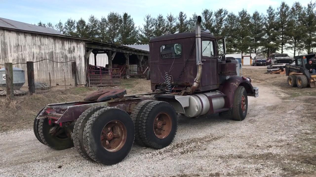

W Humble Posted August 13, 2022 Posted August 13, 2022 Minimum length of the 'glad-hand' airlines was enough not to pull-up tight on a maximum angle turn -- or when backing 'jack-knife' style. Too short and they broke. Thus, they always drooped down in the old days, then when the 'coily' style evolved just dangled and bounced. Lots of trucks, especially conventionals with long wheel-bases (twin screws) had jack-staffs to support them and provide a mounting place when not pulling a trailer. I used to see small memo-type pads with coily-type retaining cords for the ball-point pens they carried; seemed like a good simulation of the latter day type. We always spat on the seals of the air-line glad-hands and rubbed them on our palm to make sure (?) of air-tighness. Well, you had to depend on those trailer brakes on long grades, man! I remember the time in '73 when I was comin down Stirling City grade with a load of stumps, there by Magalia road... Wick 1

OldTrucker Posted August 13, 2022 Posted August 13, 2022 12 hours ago, W Humble said: Minimum length of the 'glad-hand' airlines was enough not to pull-up tight on a maximum angle turn -- or when backing 'jack-knife' style. Too short and they broke. Thus, they always drooped down in the old days, then when the 'coily' style evolved just dangled and bounced. Lots of trucks, especially conventionals with long wheel-bases (twin screws) had jack-staffs to support them and provide a mounting place when not pulling a trailer. I used to see small memo-type pads with coily-type retaining cords for the ball-point pens they carried; seemed like a good simulation of the latter day type. We always spat on the seals of the air-line glad-hands and rubbed them on our palm to make sure (?) of air-tighness. Well, you had to depend on those trailer brakes on long grades, man! I remember the time in '73 when I was comin down Stirling City grade with a load of stumps, there by Magalia road... Wick I always would wet the seals after inspecting them for wear. Always carried spares.
W Humble Posted August 13, 2022 Posted August 13, 2022 Right! I always try to look where I'm spitting! I just wish my boss would have sprung for some spares! Then, there was the time... Wick
