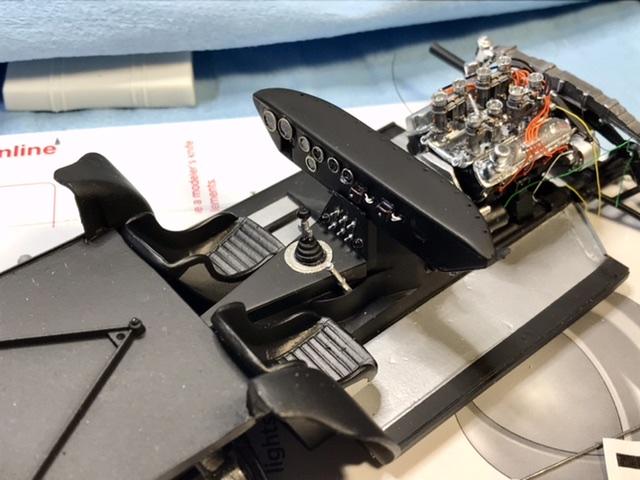

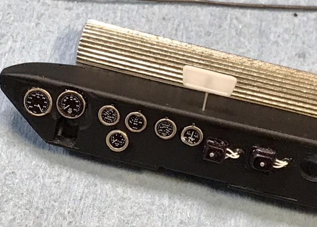

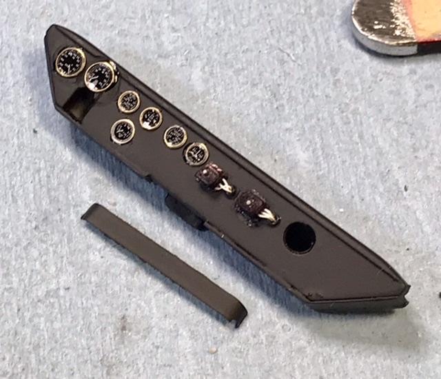

absmiami Posted February 2, 2024 Author Posted February 2, 2024 The toggles look great - but since they are printed resin - they are brittle - if you look closely - you’ll see that the top/left toggle broke off fr handling and was replaced w a switch made fr nickel silver - but im a punishment glutten - so im also using some Decalcas brake and clutch parts - the number marker lights will be Decalcas 3D printed parts also …

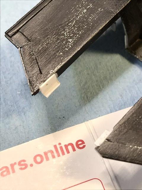

absmiami Posted February 2, 2024 Author Posted February 2, 2024 Some L shaped Evergreen strip tabs placed on the front of the pan - these will locate/secure the front of the frame …

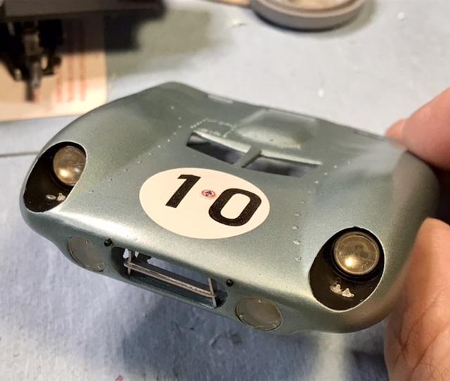

absmiami Posted February 3, 2024 Author Posted February 3, 2024 2287 still carries the splitter that it wore in the ‘64 racing season …

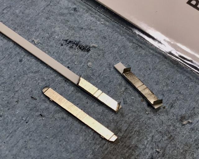

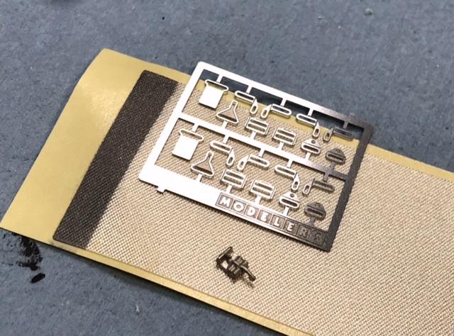

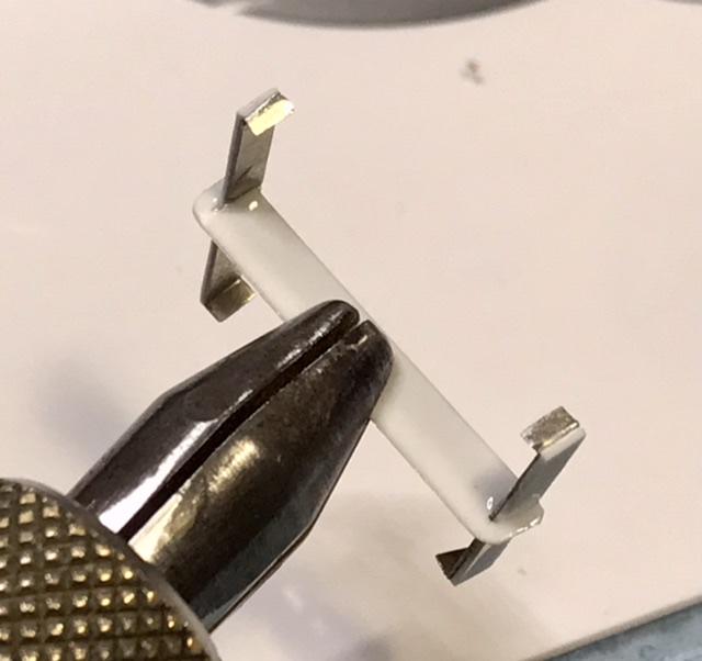

absmiami Posted February 3, 2024 Author Posted February 3, 2024 The splitter is made fr 3 parts of photo etch that are re-inforced with some .010 Evergreen strip for strength - then painted silver - 1

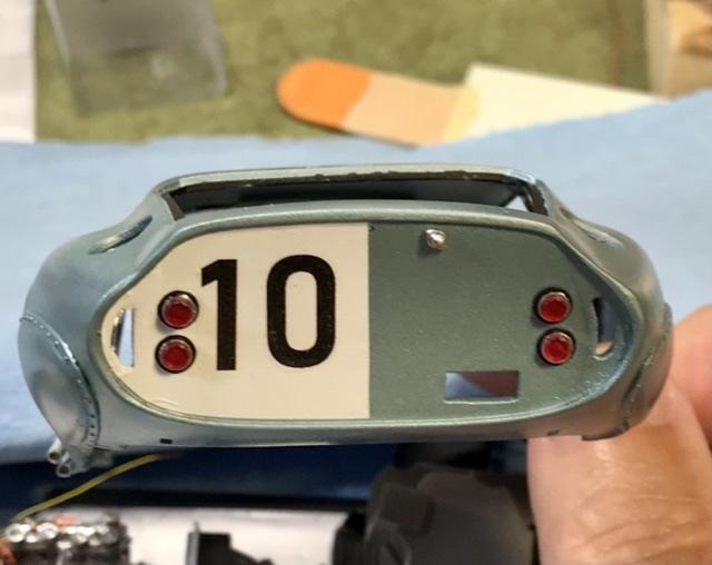

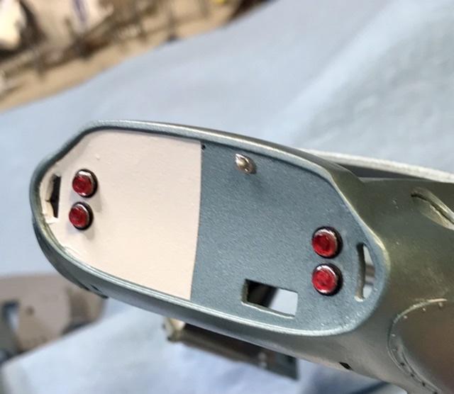

absmiami Posted February 3, 2024 Author Posted February 3, 2024 Tail lights - kit resin bezel air brushed w Molotow chr over a seal punched fr some black coated paper …. Lights are pre-coated kit parts … 1
absmiami Posted February 4, 2024 Author Posted February 4, 2024 The splitter fought me all the way - but its in … 1

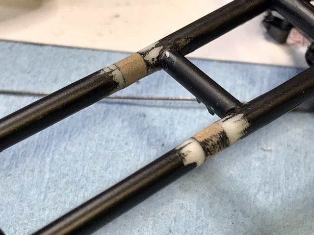

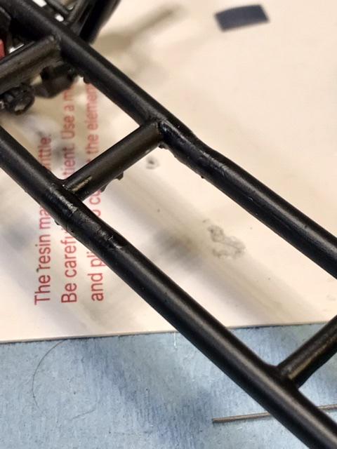

absmiami Posted February 5, 2024 Author Posted February 5, 2024 2287 had these cute - basically useless - “bumperettes” on the nose - another detail not carried over to the ‘65 cars … and some cleanup on the frame where it added length …

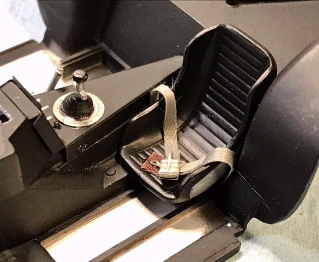

absmiami Posted February 5, 2024 Author Posted February 5, 2024 Did the Shelby team cars have lap belts in ‘64 competition? The drivers were not required to use them - but they may have been installed …
Gramps46 Posted February 6, 2024 Posted February 6, 2024 On 2/5/2024 at 6:06 PM, absmiami said: Did the Shelby team cars have lap belts in ‘64 competition? The drivers were not required to use them - but they may have been installed … Expand I went through all the period photos of the Daytona interiors in both 1964 and 1965 and could not find even a hint of a seat belt.

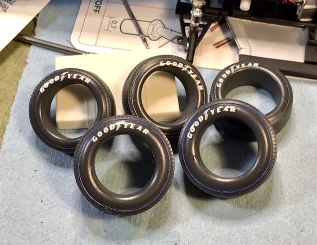

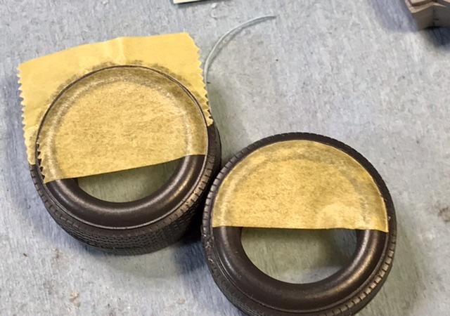

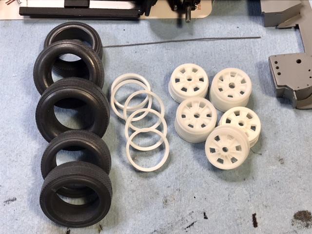

absmiami Posted February 6, 2024 Author Posted February 6, 2024 Wheels and tires are resin - tires are black resin - they all need some prep …

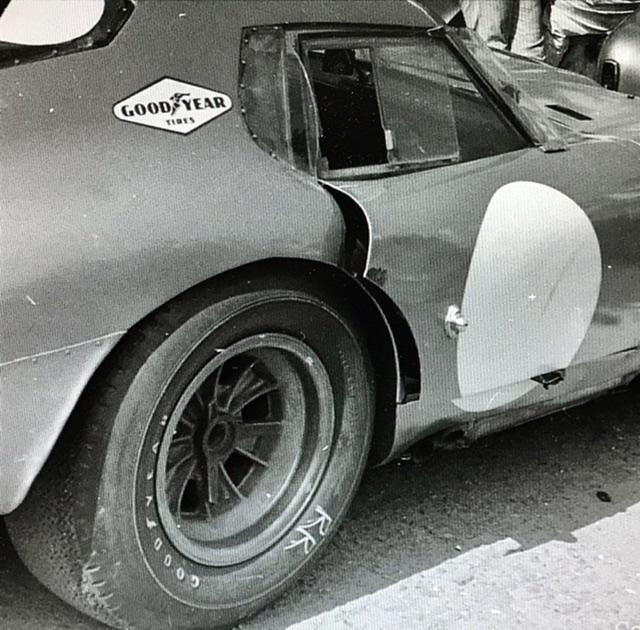

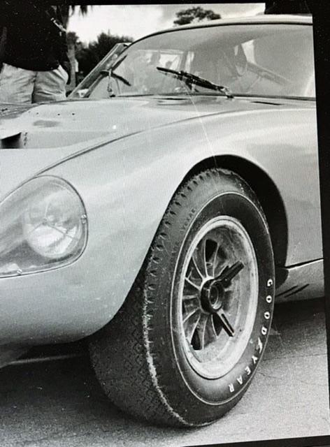

absmiami Posted February 6, 2024 Author Posted February 6, 2024 Team Shelby used Goodyear Blue Stripes …

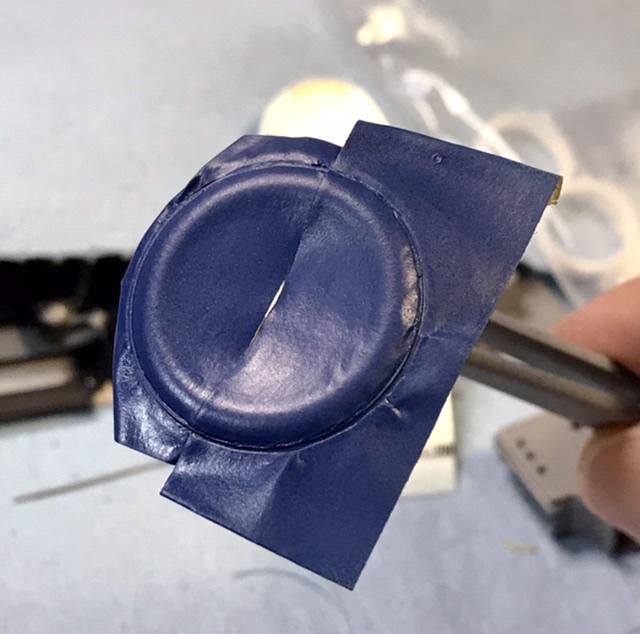

absmiami Posted February 6, 2024 Author Posted February 6, 2024 The decal tire rings never seem to work for me - but the rear tires have a pronounced ridge - enough to allow me to air-brush a flat blue ring with Tamiya masking tape and a new xacto blade - the resin tire is sprayed gray and then blue … for the fronts - ill just pretend …
absmiami Posted February 6, 2024 Author Posted February 6, 2024 The Gooodyear markings are from an old Speedline decal set made by Cartograph - the tires are air-brushed semi-gloss clear first - then the decal - and once everything dries/sets - ill overspray some flat … 1
Pierre Rivard Posted February 6, 2024 Posted February 6, 2024 On 2/6/2024 at 4:40 AM, absmiami said: Rip em out or keep them in ? Expand Un-detail a model? NO!

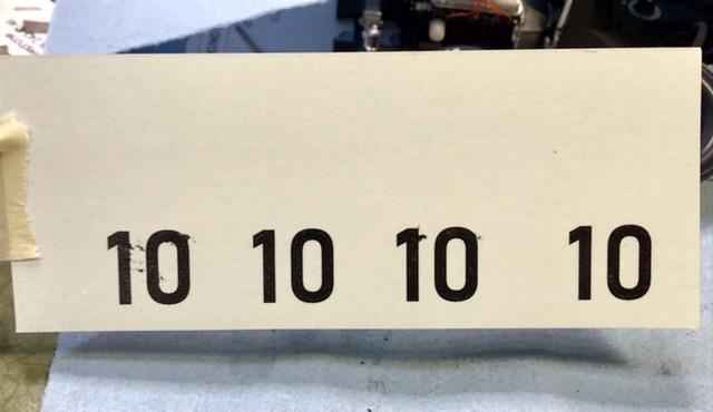

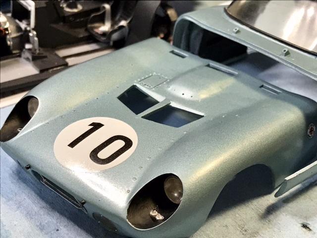

absmiami Posted February 6, 2024 Author Posted February 6, 2024 Needed smaller 10s for the tail and bonnet - found the right font in W Perfect and printed on decal paper - the smudgies occurred when i handled the unsealed sheet too quickly - but i only need two … sealed with Tamiya semi- gl clear … 1

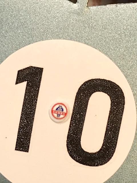

absmiami Posted February 6, 2024 Author Posted February 6, 2024 How good are the VRM decal sheets? I used the smaller of the two Cobra badge sizes on the Cobra sheet - check it out … 3

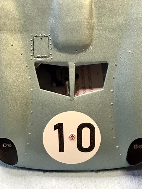

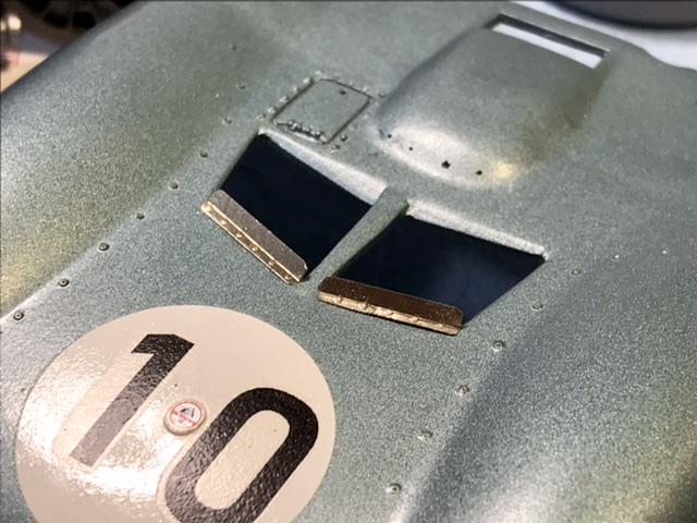

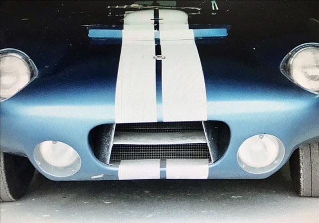

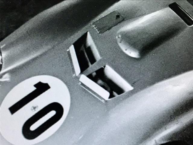

absmiami Posted February 8, 2024 Author Posted February 8, 2024 I believe this is a Douglas Morton(?) photo - showing the first use of the deflector on 2287’s bonnet - its a two part affair - mine are made by modifying the one part photo-etched kit part … 1
absmiami Posted February 8, 2024 Author Posted February 8, 2024 These copper sheets are thin and easy to bend - handy for making the glare shield for the dash - the rear view mirror was not mounted above the windshield on 2287 until some time after Daytona and Sebring - probably when it was prepped for Lemans …. 1
