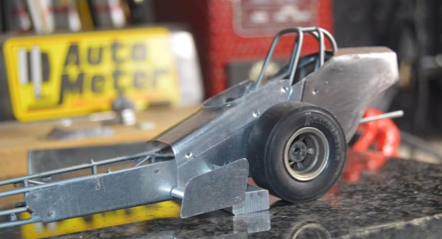

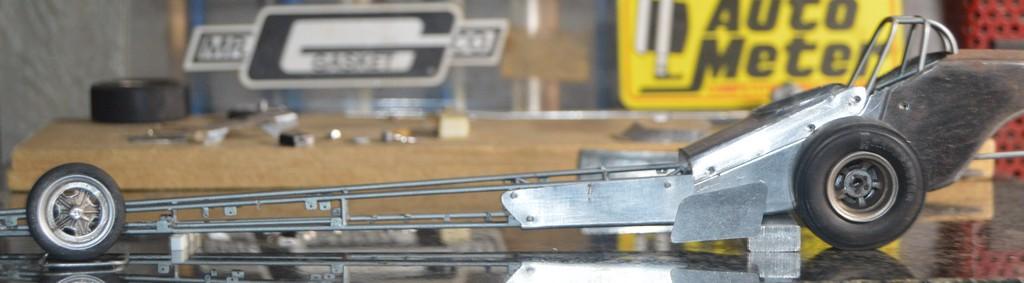

Straightliner59 Posted January 11, 2023 Author Posted January 11, 2023 19 hours ago, Ian McLaren said: I really like the new pieces, certainly a step up. Thank you, my friend! The whole body, now that it's made from the flashing, is worlds stronger. It does look better, too! 18 hours ago, Joe Nunes said: Nice addition to the model! ? Joe Thanks, Joe! I had them on there, originally, but the supports broke off. I redesigned those, and built new canards from step flashing. It's sold as being .011", but, once it's stripped of its protective coating, it goes about .008", or so. I seem to use a lot of it! Not all of it successfully.?

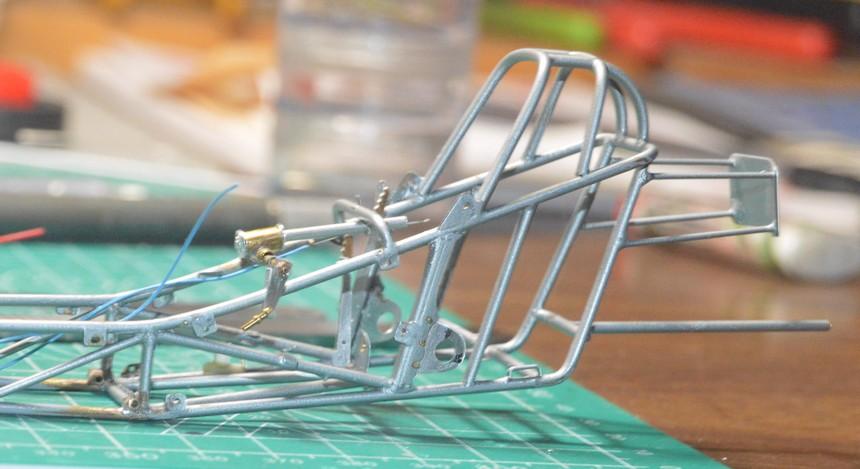

Straightliner59 Posted January 11, 2023 Author Posted January 11, 2023 I made a new seat. That was easy! Every once in a while, the universe throws you a bone. Although I used the original seat to make most of the outline for the new seat, I changed a couple of cuts on the new one. Luckily, it still fit, first try! I need to get it out, so that I can do the cutouts for the harness. I am also going to make a liner, for it. I'm trying to decide if I'll use leather, or thin, dense foam rubber. I think this is the last of the major components that needed fabrication, before the big mockup--once I remember/figure out what all these tabs were/are for! A lot of the other stuff is built--brake handle, master cylinder, chute releases, fuel shutoff...those were all built during the original construction period. Thanks for looking! 2
AmericanMuscleFan Posted January 11, 2023 Posted January 11, 2023 Great job Daniel, I love the seat, it fits perfectly in the cage. I was wondering to know what is the thickness of the flashing you used for the canards and the wing? This material is probably easy to get at the hardware store, but I have some old .005" offset printing plates and I know that .007" plates from larger presses are available, do you think this is a material that would also do the trick?
Ian McLaren Posted January 12, 2023 Posted January 12, 2023 (edited) 7 hours ago, AmericanMuscleFan said: Great job Daniel, I love the seat, it fits perfectly in the cage. I was wondering to know what is the thickness of the flashing you used for the canards and the wing? This material is probably easy to get at the hardware store, but I have some old .005" offset printing plates and I know that .007" plates from larger presses are available, do you think this is a material that would also do the trick? Hi Francis. I'm using flashing as well for almost and of my modeling, especially the last 4. I bought mine from Rona Home building supplies. 6 inches wide by 10 feet long, $24.00 Canadian. The stuff I got was 6061 T6 mill finish and .008 thick. It's quite forgiving as shown by the cowl on the Royal Canadian Dragster that I hand formed before Daniel informed me how much easier thing go when it is annealed. LOL Drills and cuts fairly easily. Edited January 12, 2023 by Ian McLaren 1
Straightliner59 Posted January 12, 2023 Author Posted January 12, 2023 12 hours ago, AmericanMuscleFan said: Great job Daniel, I love the seat, it fits perfectly in the cage. I was wondering to know what is the thickness of the flashing you used for the canards and the wing? This material is probably easy to get at the hardware store, but I have some old .005" offset printing plates and I know that .007" plates from larger presses are available, do you think this is a material that would also do the trick? Thank you, Francis. It really does fit, beautifully--first try. ? Doesn't seem to happen too often, but, it sure is nice, when it does! The flashing lists as .011", but, once the protective coating is sanded off, it's about .0075". It's become one of my favorite building materials, for sure. Step flashing is available at hardware stores and lumberyards, generally. I've even seen it on Ebay. I know a lot of guys who've used printers' plate, and they swear by it. I've never tried it, because I'm too lazy to call around to print shops who still do offset printing, to find it. I would be interested to know its properties, though. The more materials you know, and have, the better equipped you are to overcome an obstacle in a project, no? ? 5 hours ago, Ian McLaren said: Hi Francis. I'm using flashing as well for almost and of my modeling, especially the last 4. I bought mine from Rona Home building supplies. 6 inches wide by 10 feet long, $24.00 Canadian. The stuff I got was 6061 T6 mill finish and .008 thick. It's quite forgiving as shown by the cowl on the Royal Canadian Dragster that I hand formed before Daniel informed me how much easier thing go when it is annealed. LOL Drills and cuts fairly easily. Yes--I love using the stuff! I acquired mine, for free, one day when I was driving a truck back to the lumberyard, after we'd done an insulation job. It was a hot Minnesota late-afternoon, and the truck wasn't air-conditioned, so both cab windows were down. Unbeknownst to me, there was an open bundle of 5"X7" step flashing under the seat. I hit a crosswind that started the air swirling around, inside the cab, carrying aluminum blades around the cab, with it! I swatted one that was flying at my face, as I was stopping the truck. The modeler in me said, "Hmm...this tried to kill me! I guess I'll have to take it home and cut it, and beat it, and burn it!" It took a little while to really get a feel for it, but, the learning path was always fun and interesting! There are many instances where annealing it is unnecessary, but to form compound curves, it's a must! 1

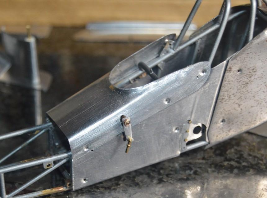

Straightliner59 Posted January 12, 2023 Author Posted January 12, 2023 5 hours ago, Tortuga Kustomz said: Awesome update, love the idea how to do the seat Thanks, Marcos! I did some more work to the seat. I cut it out, for the lap belts, and did some finishing to the leading edges of the seat, by lightly hammering them over a piece of 1/16" tube. That should slightly curve them out, around the support tubes. I also cut the cowl to clear the steering, so, that's done! It feels like I've made some decent progress, over the last couple of days. As always, comments, questions and critiques are welcomed. Thanks for looking! 2

Straightliner59 Posted January 13, 2023 Author Posted January 13, 2023 17 hours ago, Ian McLaren said: The seat is turning out great, progressing nicely. Thank you, Ian. I think, other than covering it, it's done. It doesn't need cement. Once it's in, the chassis tubes hold it perfectly together! That seat worked out maybe as well as anything I've ever built. I'm still amazed! It was just "BAM!", done. ? I'll take it!

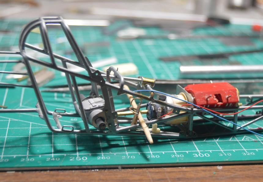

Straightliner59 Posted January 14, 2023 Author Posted January 14, 2023 I started temporarily hanging some of the cockpit details. I need to make a new brake fluid reservoir. White glued in place are the brake handle (wood grip), the fuel shutoff (aluminum handle, next to brake) and the reverser handle (wood grips--shorter, under dash pipe). I also cut a piece of wire for the fuel shutoff cable. I noticed a chassis upright tube that needs to be replaced, as well. I need to build the loud pedal, and replace the pin that mounts the handles for the chute release and (I guess? I'll have to go back to my old research) the high-speed leanout. Still quite a way to go, but, maybe not as far as I originally thought! I apologize for the photos. It's hard to get a good focus, with so much going on, and without the tripod. Thanks for looking! 4

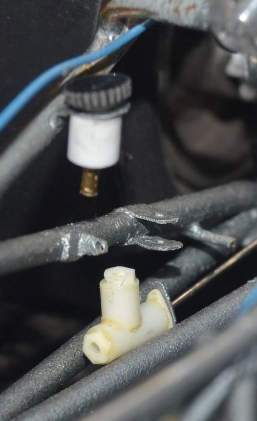

Straightliner59 Posted January 15, 2023 Author Posted January 15, 2023 I got the master cylinder in place, along with the reservoir. Both are temporarily white glued, thus the crooked cap on the reservoir. The brass fitting on the bottom of the reservoir will get filed down shorter. I made the reservoir and cap from plastic, and will not paint them since the prototypes are plastic, although the tank itself should be a bit less opaque. Next up, I'll build a throttle pedal--or something!? 2

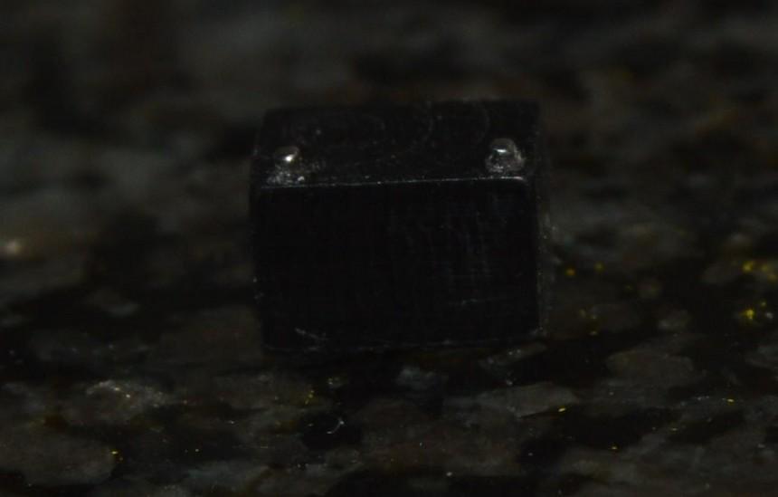

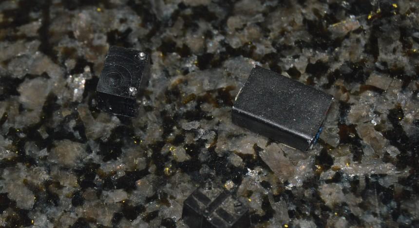

Straightliner59 Posted January 15, 2023 Author Posted January 15, 2023 1 hour ago, Ian McLaren said: I Like it good progress! Thank you, my friend! I started working on a battery. I milled it out of a piece of Delrin I bought a while back, for making 1/43 scale tires. I still need to add the cell caps. Now, most of these seem to be using dry-cell batteries, but, in the '90s, wet-cells were fairly common. I still haven't started on the throttle pedal, either. All this little stuff needs to be addressed, anyway! Comments are always welcomed. Thanks for looking! 2

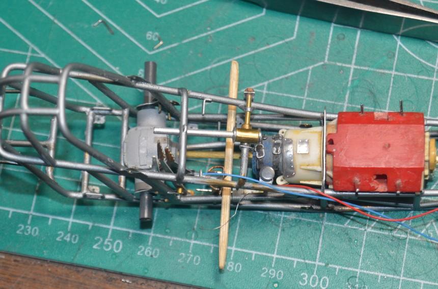

Straightliner59 Posted January 17, 2023 Author Posted January 17, 2023 Throttle pedal built--it fits...clutch pedal, next! Thanks for looking! 2
Straightliner59 Posted January 18, 2023 Author Posted January 18, 2023 I'm trying to get a little bit done, every day. Today was the clutch pedal. Pretty basic stuff--.015" brass strip with a pedal of 3/64" brass tube. I just kind of threw the actuator arm/cross shaft together. I want to do some more work to them. All the controls are white glued in place. I wanted to see how it looked with the panels on. I still need to make the butterfly, and the clutch blow-back rods, along with a few other little items. Thanks for for your comments and thanks for looking! 1
