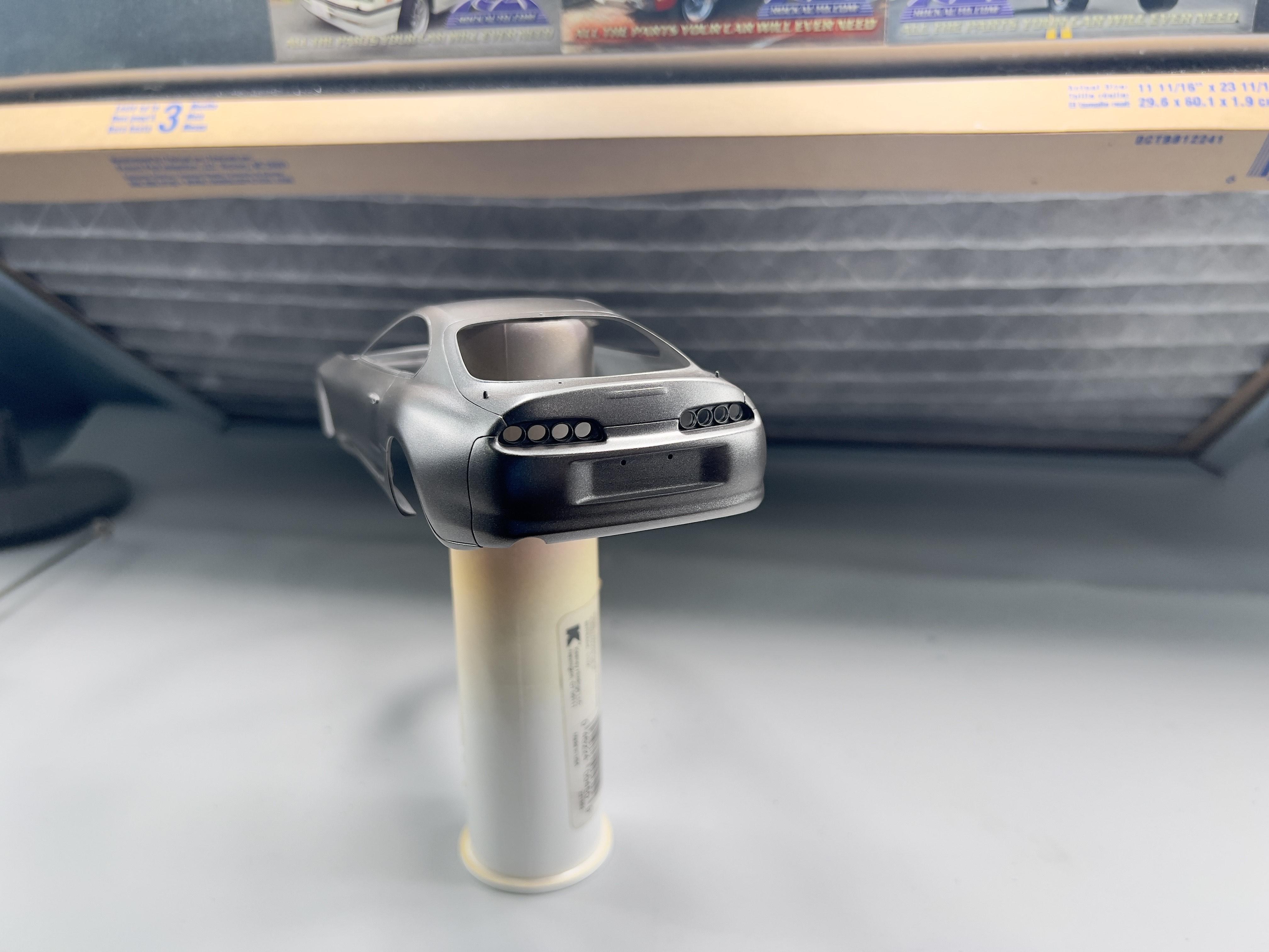

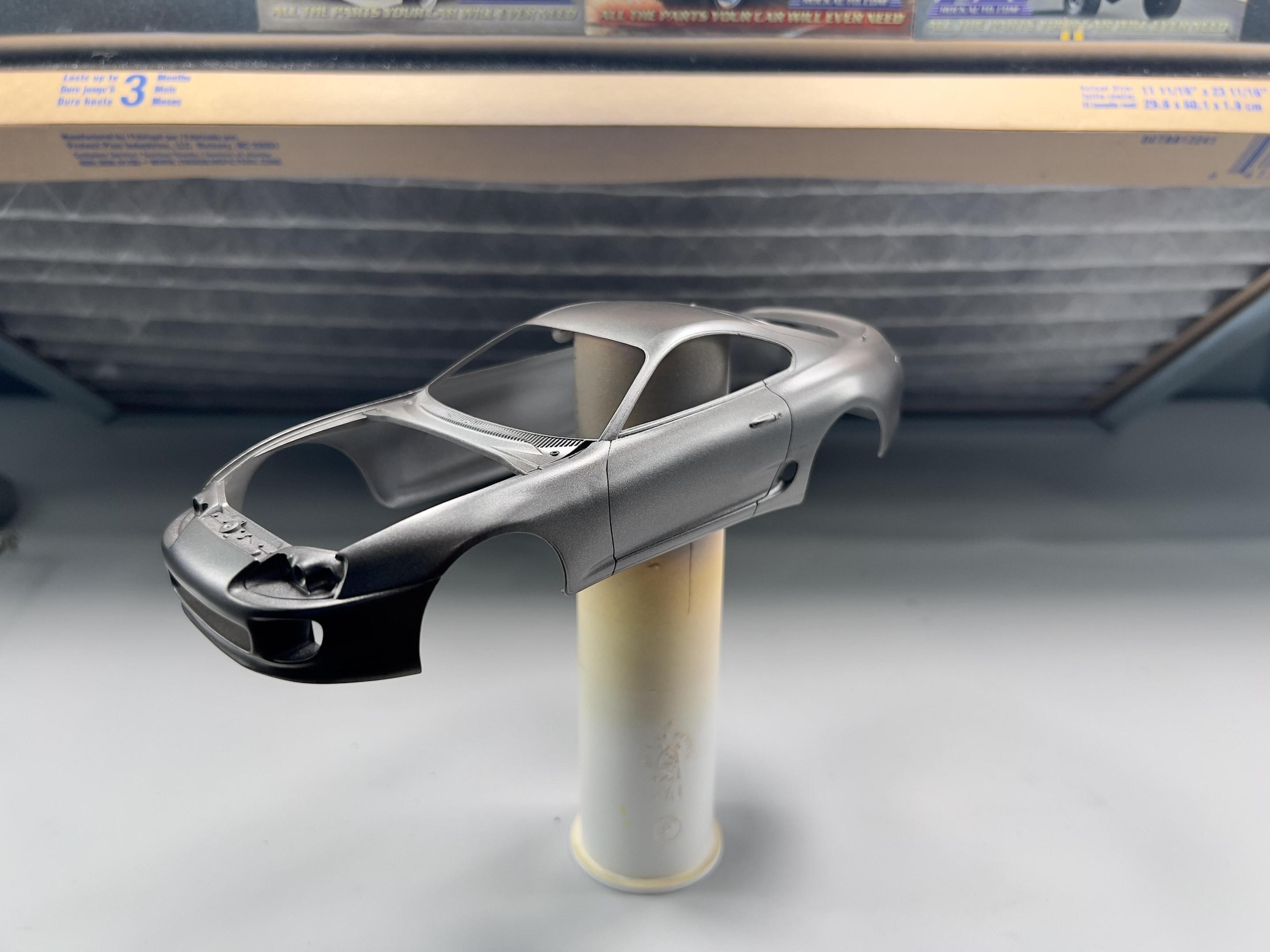

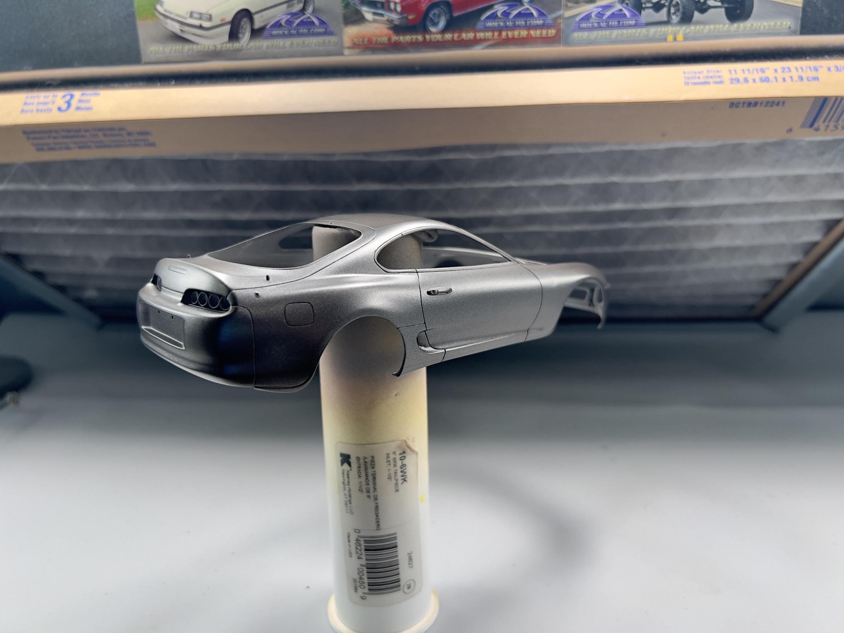

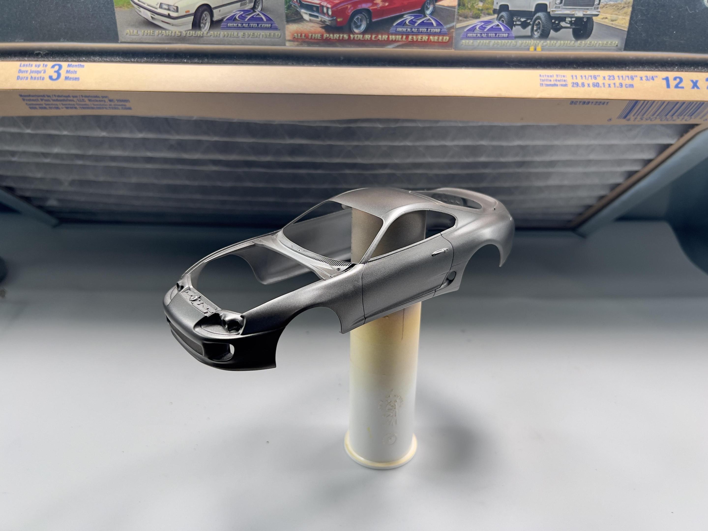

Here are some pics of a toyota supra i just painted today in zero paints brown gray toyato color.  Each coat 10 mins each total of 5 coats.
IMG_0902.thumb.jpg.65427927d113bfef846455c2b9a0a493.jpgIMG_0900.thumb.jpg.abe1b5ce3882fc29b936cb0277f15f4f.jpgIMG_0901.thumb.jpg.dab3a9ad0e325f1e1c526df30635c742.jpgIMG_0904.thumb.jpg.cf12bbececf6a0f07c3a290767a62550.jpg
That looks exactly as it should. First it looks like this:
And the on goes the clear coat, and it looks like this:
The clear coat transforms what the paint looks like. With Tamiya TS or lacquer paint, you can get a pretty good-looking effect just from applying the base paint well, or applying it then polishing it directly with, say, Novus. Mostly, the TS-13 clear coat is an option. With Zero Paints, both the base layer and clear are essential to the final appearance. It's not just the shine, but the clear deepens and makes the base colour richer...
