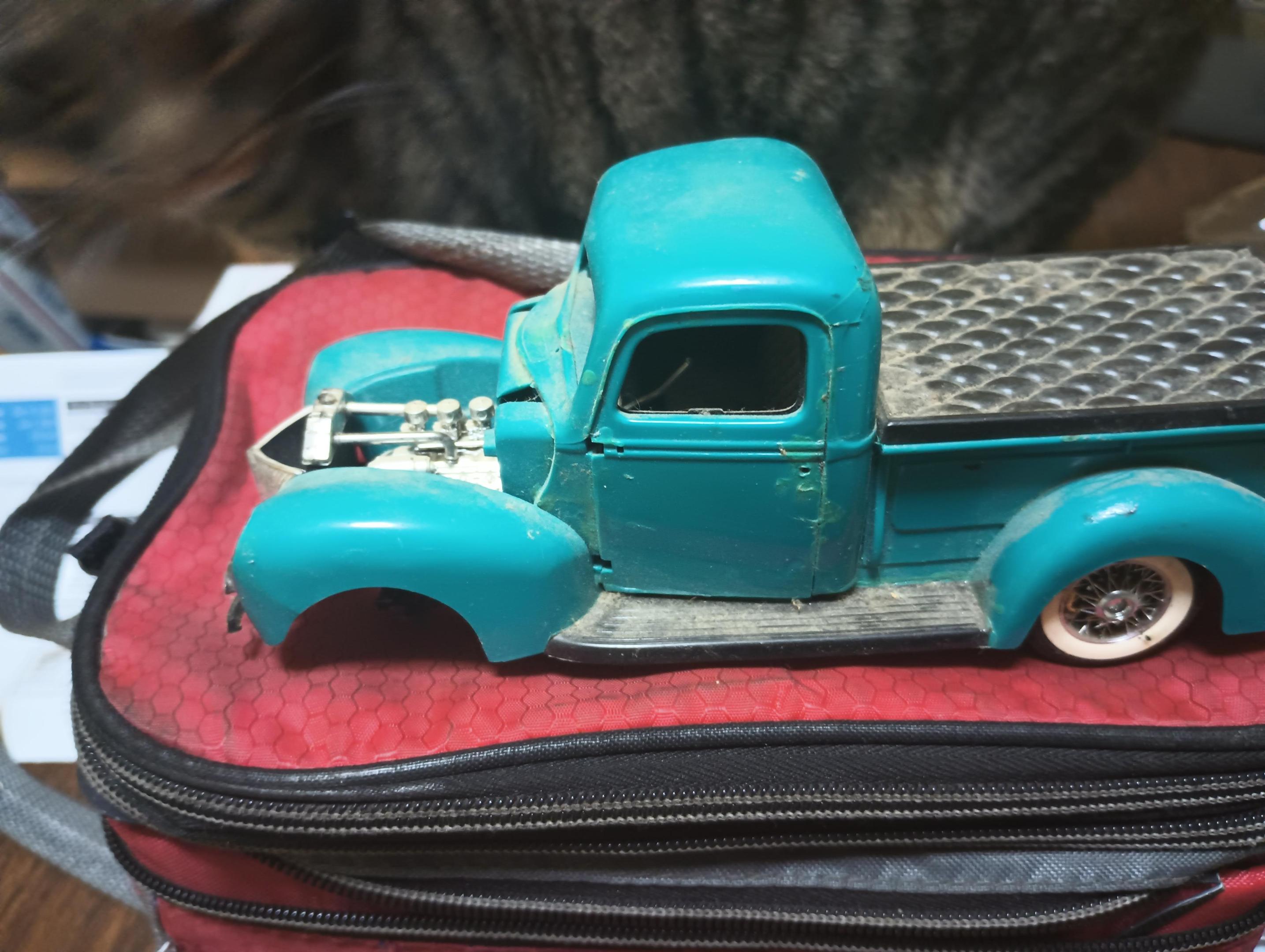

The last one arrived today and do not need any more,this one has the engine parts the other one was missing and have all the parts for the 60s kit bash.  This one was heavily glued and the bed broke taking the bed cover off so I doubt I will be able to save many more parts,I am going to see if I can salvage the chassis but everything else will be destroyed taking apart.

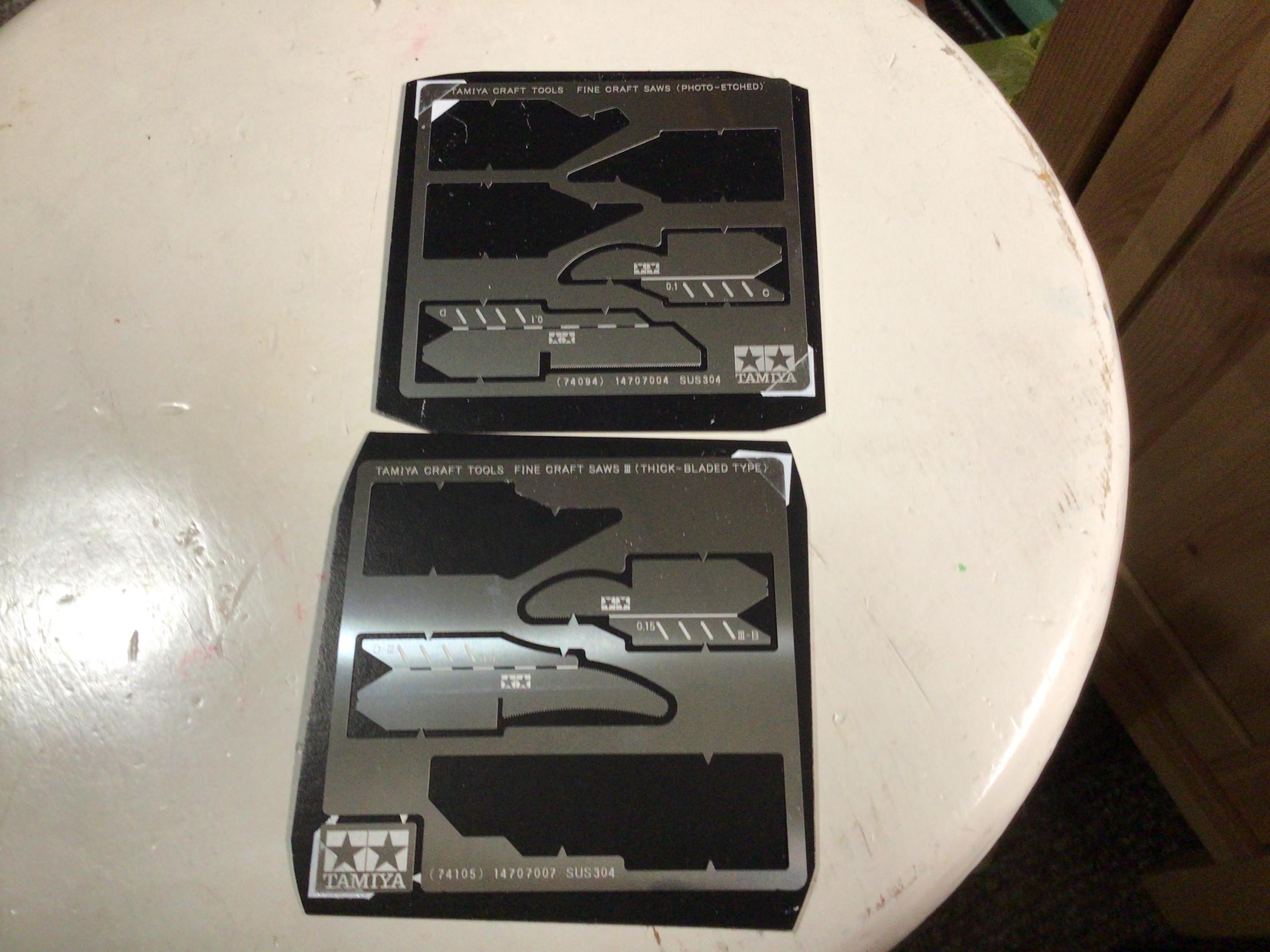

Patience, go slow, use the right tools for the job.  Thin saw blades that fit an X-Acto handle, even the hot knife tip for a small soldering iron have saved parts for me in the past with little damage to repair later
Yes, these photo etch saw blades are fantastic. A real light touch is required to avoid bending them, but they are very sharp and you lose almost no material. They come in at least two thicknesses.

I lied and bought another,it's a 80s version that I got for parts to fix two 60s versions.  I got a can of bad paint and messed up the bed for the 40 that had the flatbed and need a chassis for another that I robbed parts off of,the bed with the messed up paint will become a utility trailer.
