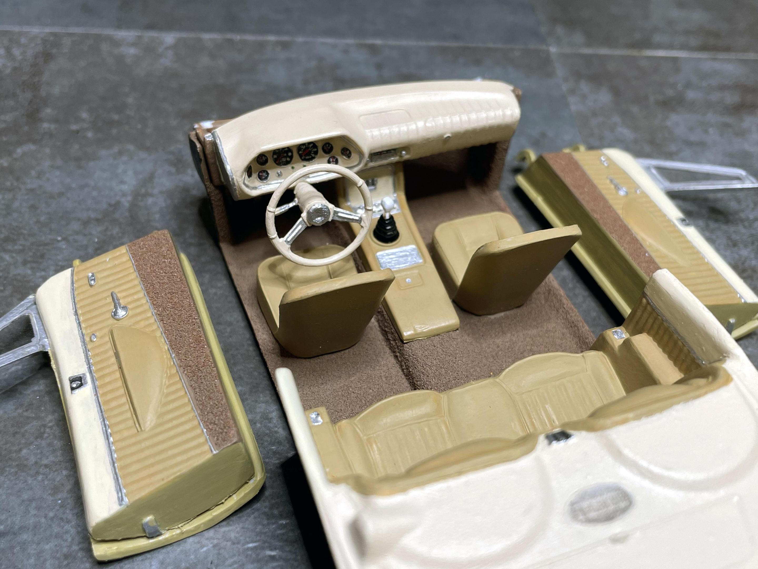

bh1701 Posted December 30, 2022 Share Posted December 30, 2022 I built the Prestige version of this kit and was quite happy with it. The only issue I had (as mentioned by others in this post) was the opening doors. I had to do some sanding on the edges of the exterior and interior door panels to get them to fit well. I wish I had used some hidden magnets inside the doors panels and the body to keep the doors closed snugly. I hadn't learned that trick using magnets at that time. The doors do close well, but when you pick the model up, one or both doors tend to pop open slightly. Bart 4 Quote Link to comment Share on other sites More sharing options...
