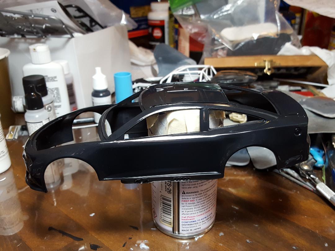

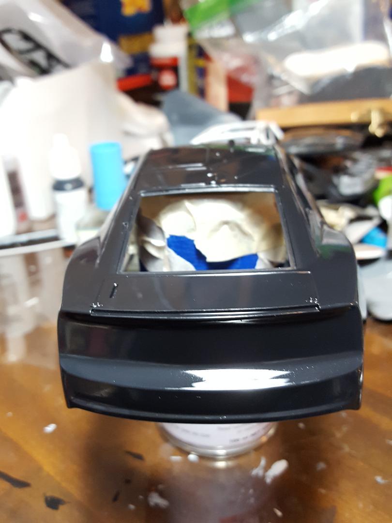

Well, I tried Future as a finish for my body and really like it. I just did the hood as a test, and it came out better than I thought it would. I went ahead and polished out the whole body and will future it today.

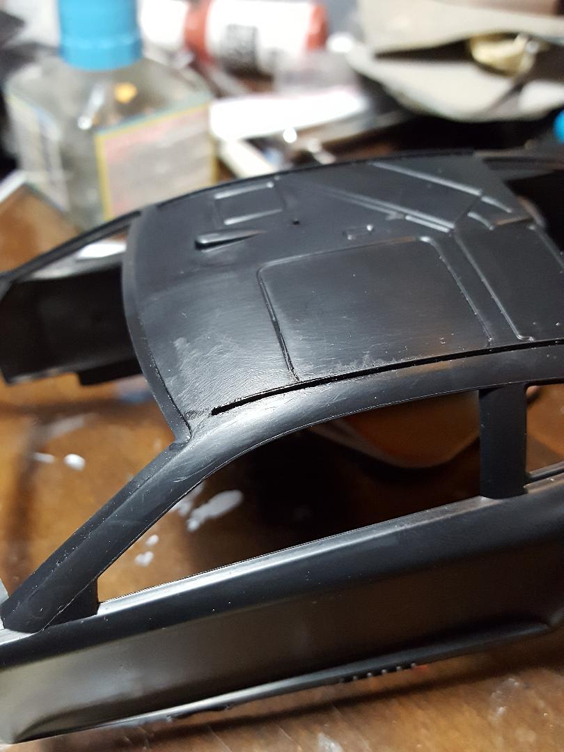

Weird. The best black paint job I ever did and the only black paint on this body is where I added a rib to the roof that Salvinos left off. And I did it with a brush. Go figure.

Yes. The model is 75% decals covering the body so it just needs to be black between the many decals. So, I think it should work out okay.  It just seemed like a lot of work to prime it gray and then paint it black and then polish out the black paint that would not look as good as the future over the polished body. I would then future over the decals which is what I will do after I put on all the decals. We shall see how the finished product looks. I hear that some people are just putting the decals on the raw body and that's all their doing. Thanks for checking in on the build.

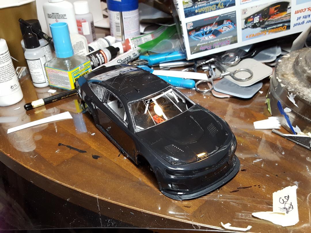

Got the glass installed except for the left front side glass. I wanted to keep the body set down over the chassis till I'm sure the windshield glue is cured completely. If you try to install the windshield on the body with it not in place, it will not fit correctly. At least that is what I have discovered. The body has to be bowed out a bit to get the windshield to fit flush.

I understand your frustration .  It seems like Salvinos goes to great lengths to get their bodies and 75% of other parts correct but then completely drops the ball with the last 25% of parts , it's like they think nobody will notice . As for using Future . . . it's self leveling and yes the best way to apply it is with a brush , I found those cheap 1" foam brushes from Harbor Freight are the best . Also any damage to the Future or fogging from the MicroSol should completely disappear with a final coat of Future .

Thanks, Bob and Pierre. Bob you are right, the last coat of future did the trick, and the finish looks better than any paint job I ever did. But I won't be doing anymore just future paint jobs. I will post the finished build pictures for sure. It came out just as good as the first build. I might take a picture with both builds side by side just for grins. Another thing Salvino's needs to think about is how they package the parts. I had to use my wife's hair dryer to unwarp the hood, the body, and the chassis floor. The first kit did not have this bad warpage problem. I think that might be where some of the extra 6 hours came from. I also spent some time making a bonus part for the build that the first model did not have. and I added some stuff to the interior, the switch plate, that I did not do on the first one.
