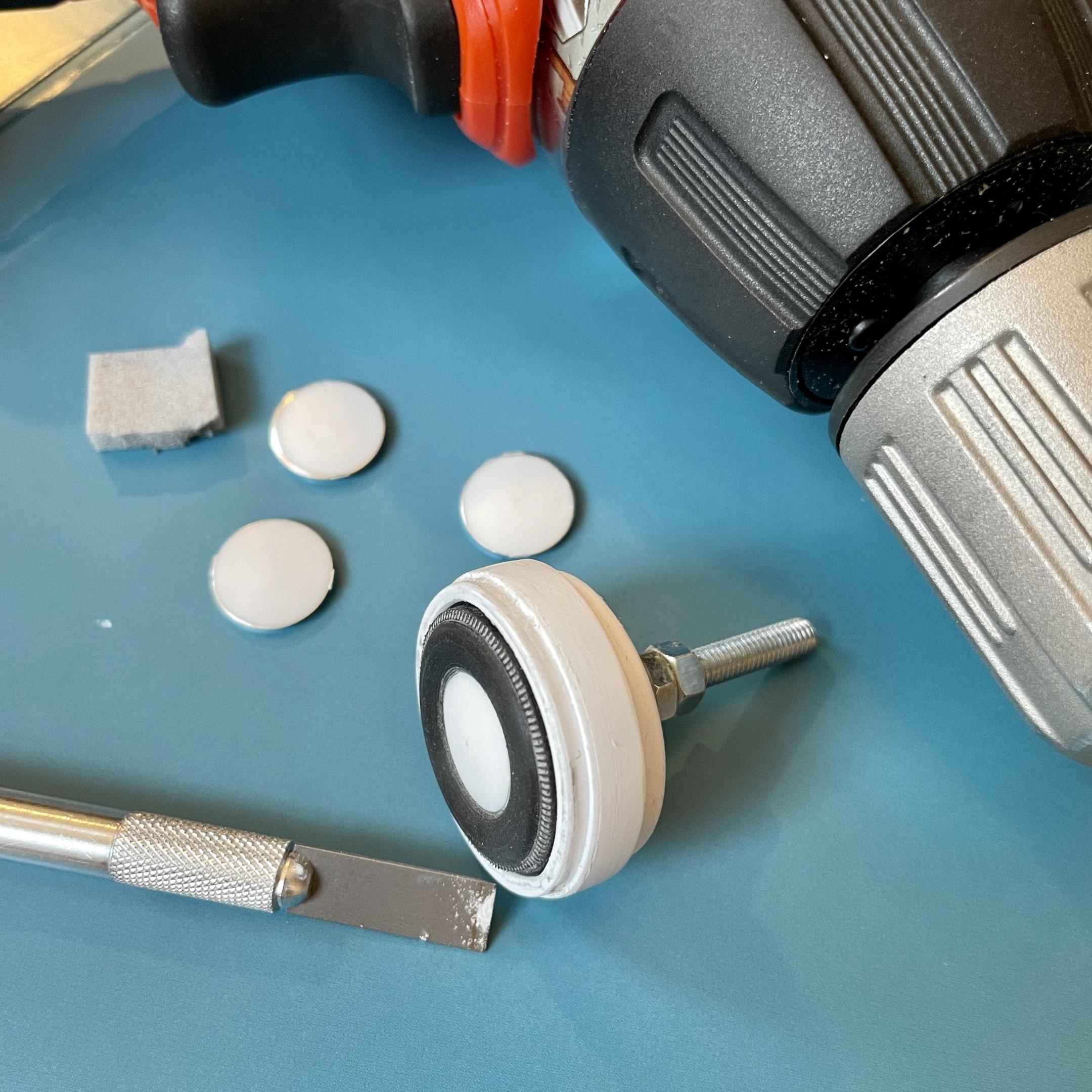

I have made my own stud of bolt nuts some plasticard and an AMT tire to be able to grind and paint rims.
It went pretty well "turning" the Moon caps, two out of four had sink marks, the primer will tell the truth.3C5D3CB4-B82A-42D5-9593-4ACA200DE747.thumb.jpeg.8cf2275fab64987cb07c446ba33fdd56.jpeg

Nice improvising, Ulf. Good looking Moon caps. I do something similar with a bench top drill press. It's a bit of a pain working vertically, but my turnings are pretty simple, and it gets the job done. One of these years I'll pull the trigger on a proper lathe.
