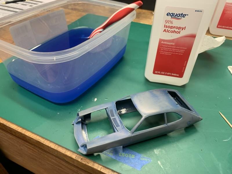

atomicholiday Posted April 23, 2023 Author Posted April 23, 2023 Finally got to the store to pick up some alcohol. Party time!! Oh wait, not that kind… I soaked the body in 91% isopropyl alcohol for about 15 minutes and then scrubbed it with a toothbrush. The results were amazing. The old paint brushed off with very little effort. *Good tip for future reference: to remove Testors Extreme Lacquer, use 91% isopropyl alcohol. Job done! And the best part? Most of the primer stayed on the body and the body filler is almost totally unaffected! I was really dreading having to redo all the body work. So this one is back on track (sort of). Next steps - hit it with a very light coat of primer, scuff it, and repaint. That’s gonna have to wait a while though. Our warm weather from the last couple of weeks is gone. It actually snowed again (!) the last two days in a row. Indiana weather. What can you do? It’s actually holding me up on a number of projects, not the least of which is getting my boat ready to go in the water. Thanks for following along!

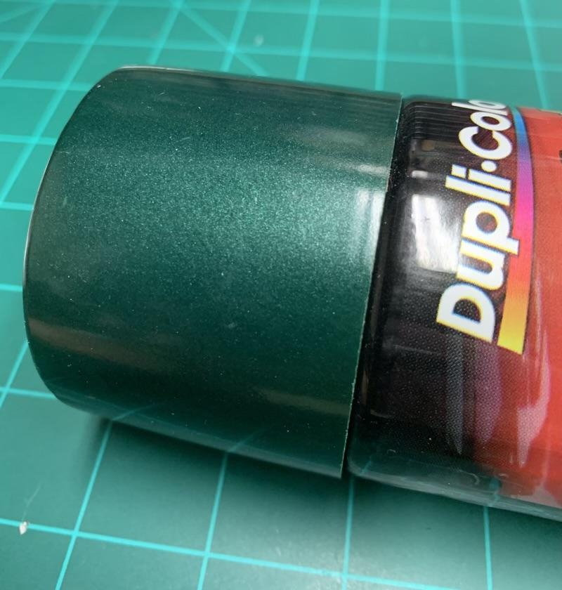

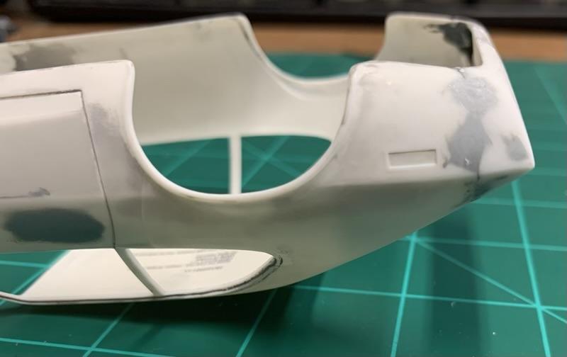

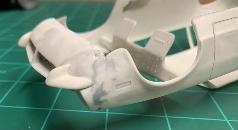

atomicholiday Posted May 10, 2023 Author Posted May 10, 2023 (edited) Been working on this one a little more. I decided I wasn’t happy with the primer. I felt it was too thick, so I stripped it off too. This thing has been in the pool three times now… So I’m back to doing body work again. It’s starting to feel more like I’m building a model in reverse. My next update might just show me gluing parts back onto the sprue!? I do think it was the right thing to do though. I don’t feel like I would have been happy with it otherwise. So since it’s back to raw plastic, I thought I’d show a little of the body work since I skipped it at the beginning of this wip. I need to sand a bit more and then hit it with a light primer coat to check my progress. Here you can see how the front end fits together after a ton of shaping. It fits nothing like this when you start. I decided to change colors too. After seeing it in the blue, I wasn’t digging it. The shade felt a little too “modern” for the vibe I want. Instead, I’m going with Dupli-color forest green pearl. I think it’s a Chrysler color. To me, it feels more 70’s. Never shot this stuff before, so I’m going spoon painting soon to try it out and get used to it. Last update. I’m calling the engine done! Edited May 10, 2023 by atomicholiday

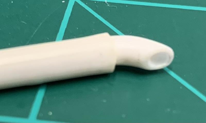

atomicholiday Posted May 11, 2023 Author Posted May 11, 2023 I think I’m gonna call the floor pan done too, except for some minor touch-ups after assembly. The white blocks are what I’m going to mount the side pipes to. They will get touched up later. And yes, I did say side pipes! Speaking of which, I did some work on them the other day too. I opened up the hole at the end. They’re flat right out of the box. Ugly. I may open them a little more, but I’m afraid I’ll go to far and cut through the side of the pipe. We’ll see. Haven’t decided yet. 1

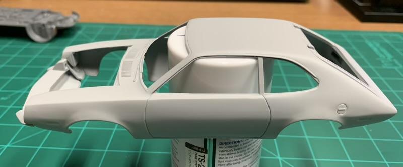

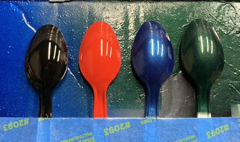

atomicholiday Posted May 14, 2023 Author Posted May 14, 2023 Got a coat of primer on it today. And it looks like just a very little bit of sand on the rear quarter and it’ll be ready for a final primer coat and then finally some color. I did a test shot of Dupli Color forest green pearl with Rustolium clear lacquer on a spoon. That’s what I’m going with now. The other spoons are various experiments for other projects.
OldNYJim Posted May 15, 2023 Posted May 15, 2023 That Duplicolor paint, in my experience, can be a little ‘hot’ for some types of styrene and can wrinkle them…be sure to exercise caution with that… 1
ea0863 Posted May 15, 2023 Posted May 15, 2023 I'm keeping my fingers crossed Jeremy! I love the green, now hopefully it lays down nice for you. 1
atomicholiday Posted May 15, 2023 Author Posted May 15, 2023 6 hours ago, ea0863 said: I'm keeping my fingers crossed Jeremy! You and me both. I'm ready to be done with this one.
David G. Posted May 15, 2023 Posted May 15, 2023 Nice recovery on the body work. Your color choice looks right for the era. David G.

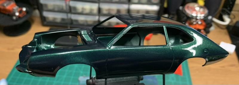

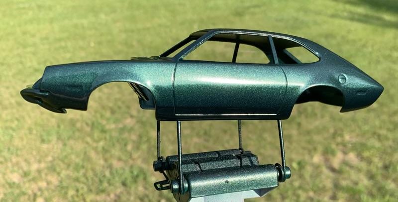

atomicholiday Posted May 18, 2023 Author Posted May 18, 2023 I got the paint on it today. I’m really happy with the way it came out. I’ll definitely be using Dupli color again. Hopefully later this weekend I can get some clear on it. And then again maybe not. If it still looks this glossy after it’s cured, I might just skip that step. 3
atomicholiday Posted May 20, 2023 Author Posted May 20, 2023 Thank you gentlemen! I’m pretty happy with it myself.
atomicholiday Posted May 21, 2023 Author Posted May 21, 2023 Just a short update. After the paint has cured out, it still looks pretty good and smooth. But it has lost a bit of the gloss, so I will be clear coating it sometime in the near future.
atomicholiday Posted May 21, 2023 Author Posted May 21, 2023 Got the clear coat on the Pintera this afternoon. I sprayed Dupli Color clear. Finally making some headway on this thing. 3
