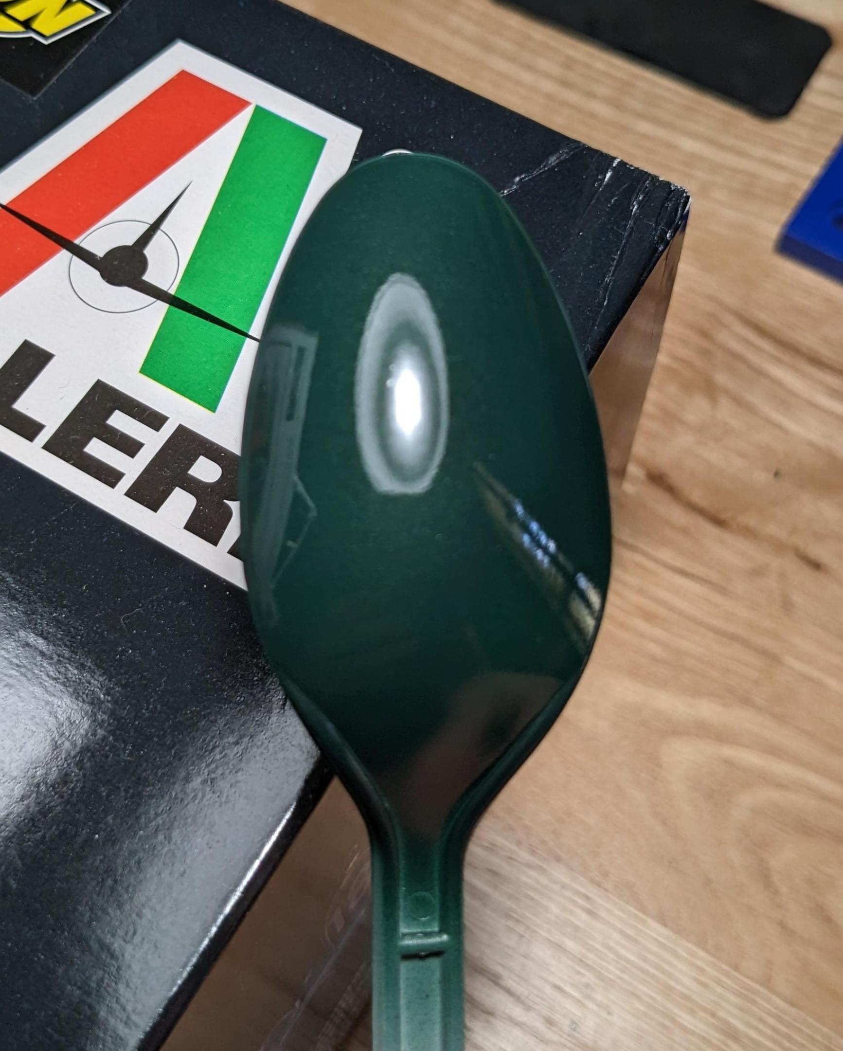

jaymcminn Posted March 28, 2023 Author Share Posted March 28, 2023 On 3/18/2023 at 10:56 AM, Ben Brown said: If you don’t want to hassle with decanting TS-13, Tamiya’s LP clears thinned with Mr Leveling Thinner are great and will work fine over Splash Paints. I thin mine with about 1/3 thinner, since it isn’t as thick as Mr Color clears. Ben Update for all... Spoon test with Splash Bentley Racing Green pearl over Tamiya grey primer with Ben's suggested clear mix. Absolutely fantastic. The Splash paint went down beautifully over the primer and the clear really does bring it to life. The self-leveling thinner is great, the extra drying time eliminates orange peel and lets the passes blend together perfectly! 1 Quote Link to comment Share on other sites More sharing options...
