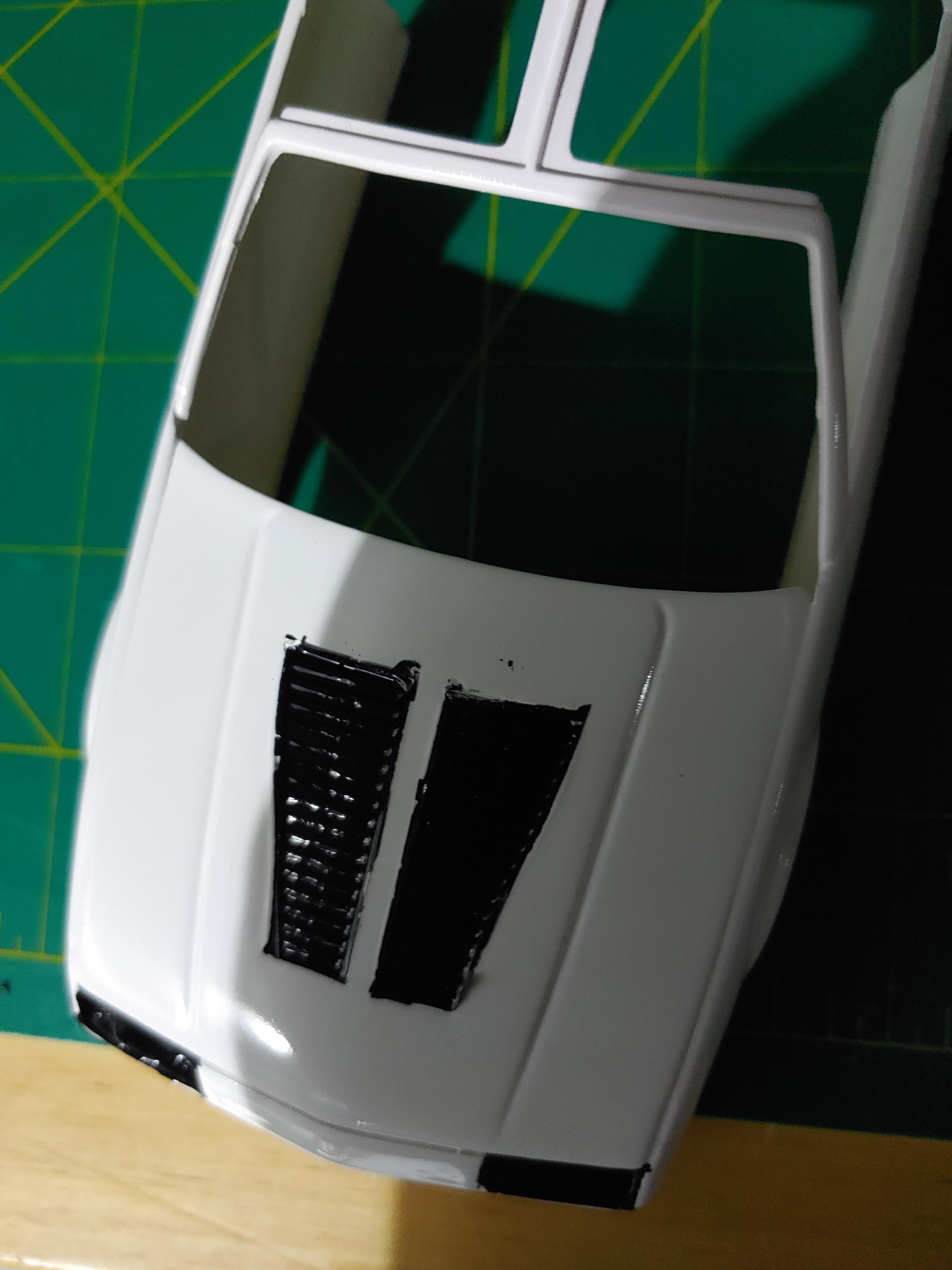

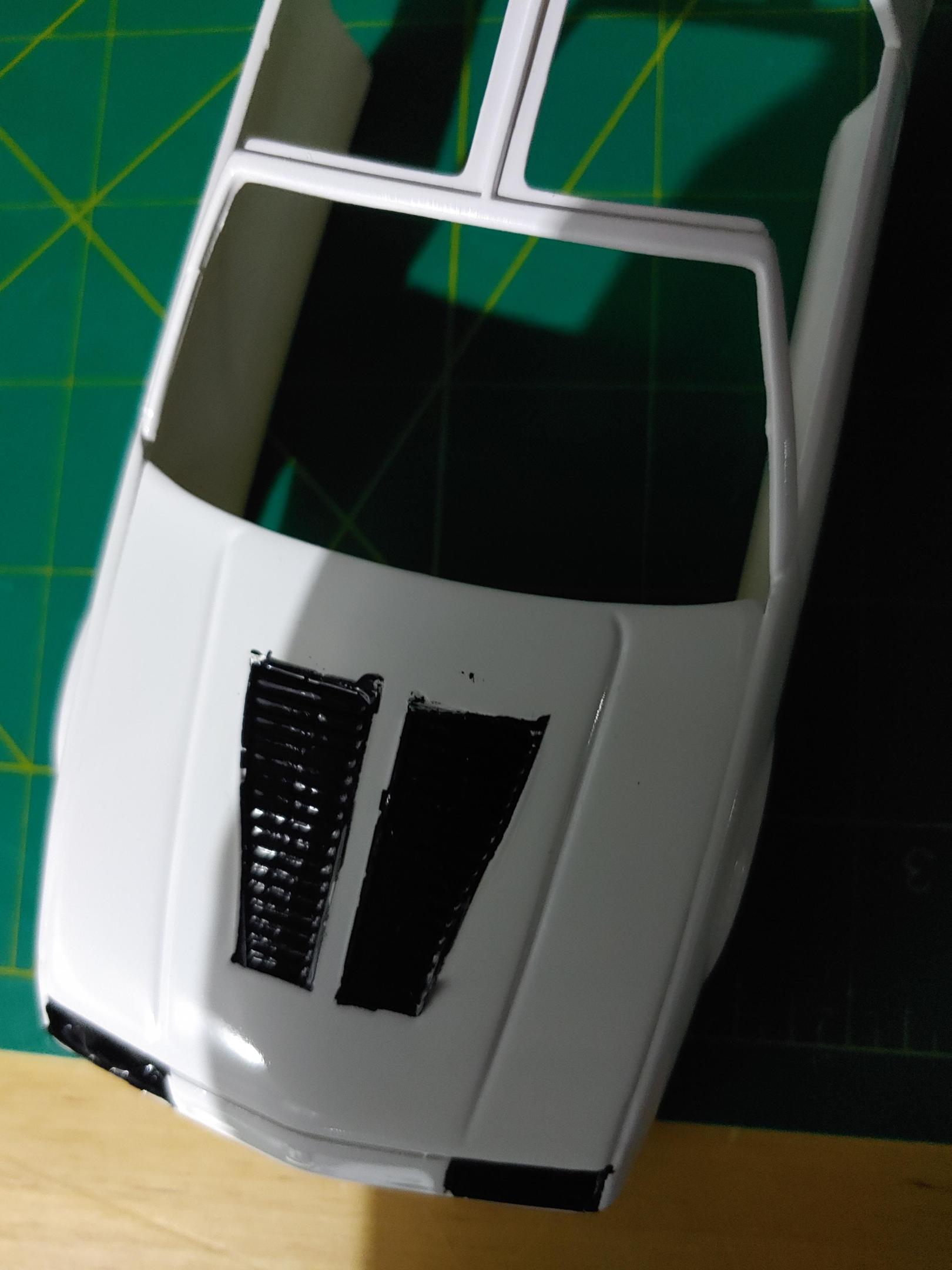

TheCamaroKid Posted March 20, 2023 Posted March 20, 2023 I was hand painting the louvers of my Camaro IROC Z model Kit. My Camaro IROC Z is white (matching my real car), and I wanted the louvers black. I covered everything in Tamiya masking tape. I had painted the louvers with lacquer. They came out decent. What disappointed me most was that random black dot on the back of the hood. I'm not even sure how that got all the way over there. Minor runs near the louvers don't bother me, but that's like that Seinfeld episode (the red dot sweater)! Is there a fix? I'm building this is as a slot car drag car. I'm not sure if I want to strip it down, since the rest of the paint looks great!
Modelbuilder Mark Posted March 20, 2023 Posted March 20, 2023 (edited) Fine detail areas, I know some people use Bare Metal Foil for the close up area, then tape off a wider area. THEN, despite being an extra step, shoot a light coat of the color behind the tape, in your case the white, around the tape edge, that way if anything bleeds under, it will be the same color, then when that dries spray your black. For what you already have here, tape of the reverse this time to cover the black, and you may be able to VERY carefully sand away the offending areas. Edited March 20, 2023 by Modelbuilder Mark
Lunajammer Posted March 20, 2023 Posted March 20, 2023 If the paint is still soft you can sometimes carefully, lightly, scrape it off with an Xacto blade. Just not sure in this case if it will leave a shadow on that white.
TheCamaroKid Posted March 21, 2023 Author Posted March 21, 2023 On 3/20/2023 at 5:31 PM, Lunajammer said: If the paint is still soft you can sometimes carefully, lightly, scrape it off with an Xacto blade. Just not sure in this case if it will leave a shadow on that white. Expand I put it away for now. I might buy a second IROC Model kit and try the above guy's spray paint technique. Come back to this project later. Maybe strip it down and paint it all black.

Ace-Garageguy Posted March 21, 2023 Posted March 21, 2023 You can almost certainly fix it by VERY CAREFULLY wet-sanding, right up next to the bleed edge, using a folded over piece of 600 grit, then use a polishing compound to bring the gloss back up. CAREFULLY is the watchword, but I've fixed stuff worse than that. In the future, you might also consider one of the 3M fine-line green plastic tapes made for real cars. They adhere very well to prevent edge-bleed, are very thin, and will follow curves well. I've used the stuff for flames and stripes on real cars and numbers on real aircraft for decades. 1

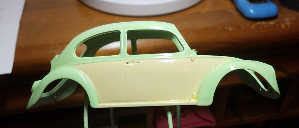

Sidney Schwartz Posted March 26, 2023 Posted March 26, 2023 I'm about to try out this tape. I'm trying to paint a VW Beetle in this style... For the first attempt I used Tamiya masking tape. I burnished the edges and then brushed 2 layers of clear coat over the edges to try and seal them. The result was so awful that I considered it unfixable and stripped it down to the plastic. It'll probably take me a few days to finish the painting. I'll post the results here.

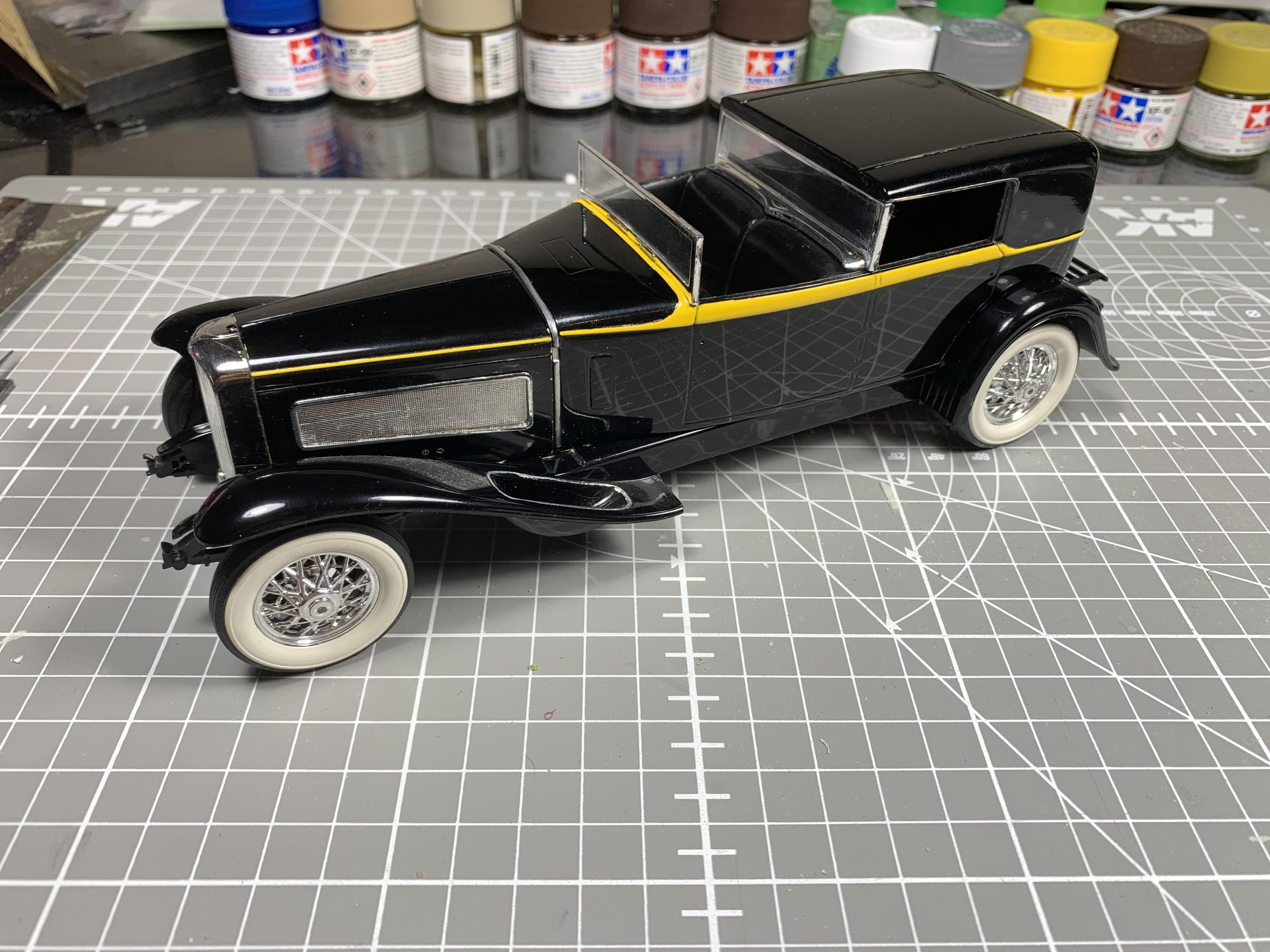

Sidney Schwartz Posted March 30, 2023 Posted March 30, 2023 Wow! Zero bleed through! There are some other imperfections that are my fault, but this plastic tape worked perfectly. Thank you Ace-Garageguy. ?
Sidney Schwartz Posted April 1, 2023 Posted April 1, 2023 Here's a better pic now that the clear coat is on. Looks great! 1
Ace-Garageguy Posted April 1, 2023 Posted April 1, 2023 On 3/30/2023 at 9:02 PM, Sidney Schwartz said: Wow! Zero bleed through! There are some other imperfections that are my fault, but this plastic tape worked perfectly. Thank you Ace-Garageguy. ? Expand Glad it worked for you. It's never let me down yet.
