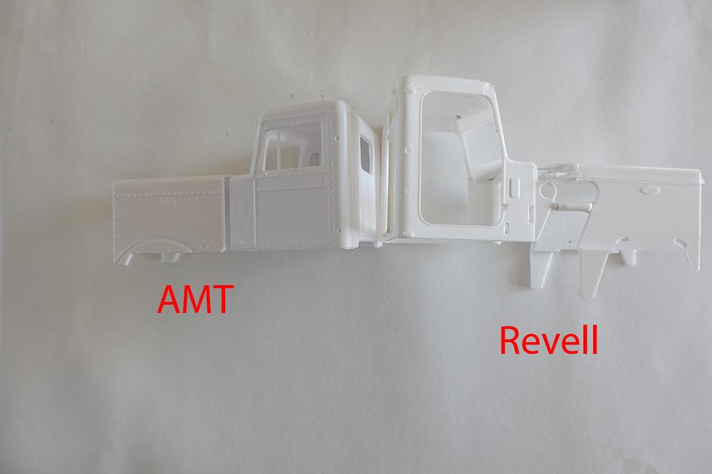

I actually wanted to build TWO Peterbilt 359s, so I purchase of of each, one from Revell and the other from AMT.
Interesting to see the difference in size of the cab and also placement of rivets between these two companies.
After some consideration, I decided to build Revell kit first.
It's because they are different cabs.
The AMT cab is the early Unilite "small window" cab also used for 351's made up to 1972, the cab in the Revell kit is the later 1100 series cab with larger windows and it's also taller, and that cab came 1972 and after the end of 1972 Peterbilt replaced the Unilite cab on all conventional trucks, AMT also has a kit with the 1100 series cab but this is not it.
The AMT kit was the first truck model kit made and it first saw daylight in 1969 as the California Hauler as a day cab truck, and the California Hauler with the sleeper came 1973, this kit was later replaced with their 1100 series cab kit in 1975 and the earlier Unilite cab kit was forgotten until 2014 when it came out again.
The Revell kit on the other hand first came in 1982 and your kit is the latest reissue..

18 hours ago, tractoraholic said:
Very Cool, I have the Revell Peterbilt in my collection to be built.  I'll be watching, I like how you point out fit issues and things to watch for when assembling or modifications to make it better.
I couldn't find many WIPs on 359s although I see many completed 359s in this forum.
This kit has some issues. ;)  Nothing major, but it requires some awareness.
I knew about the short windshield version vs long, but didn't know 1972 is the triggering point.
