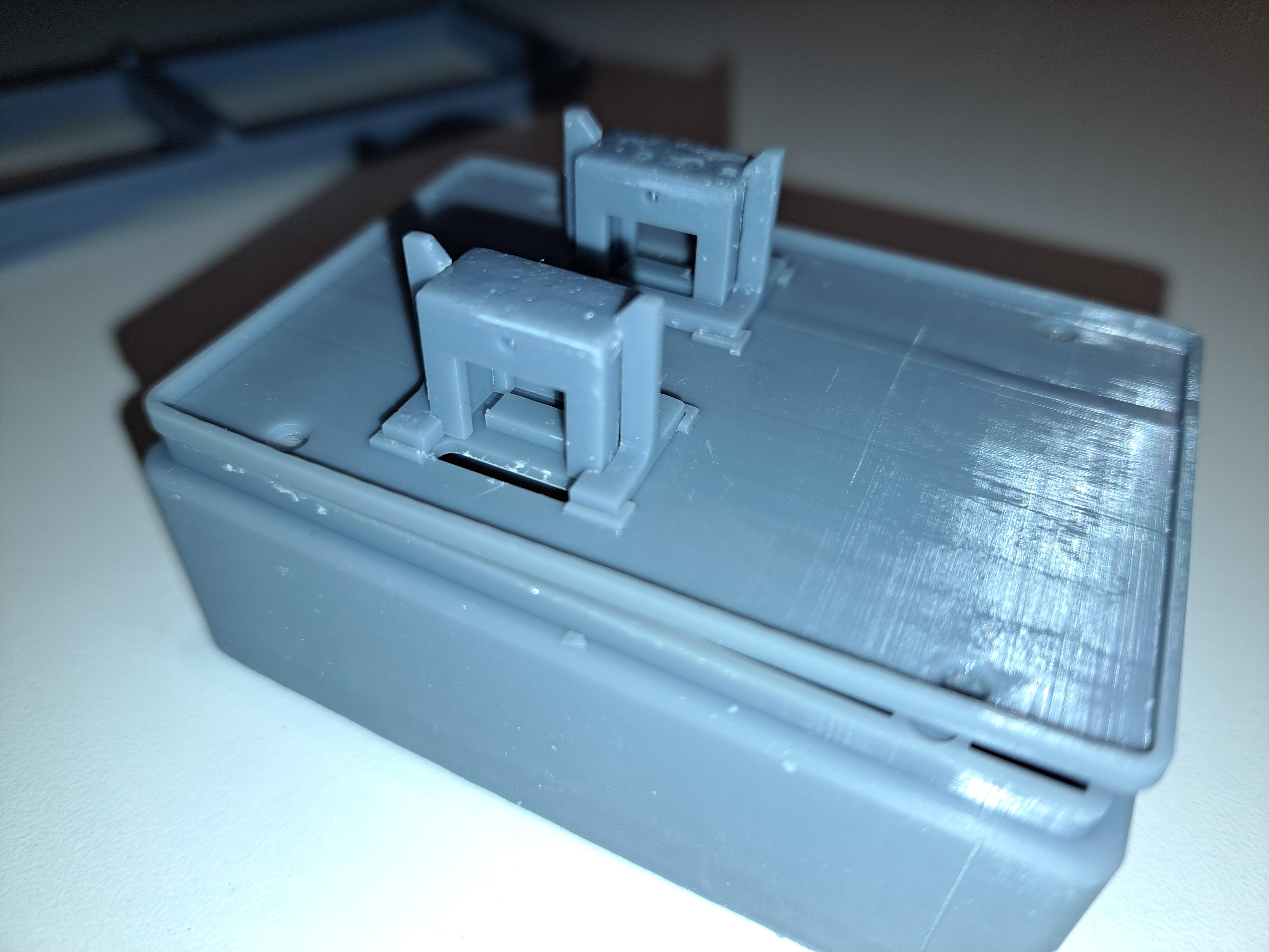

I incorporate 2 slider switchs inside that will be actuated by the lever. Since I'm not too sure of the quality of these switchs,  l designed a snap in switch holder so that if they fail, I can easily replace them. Naturally,  the lid is remocable and held in place with magnets.
Some of the parts printed. The lid and support frame ate not correct and will be reprinted.

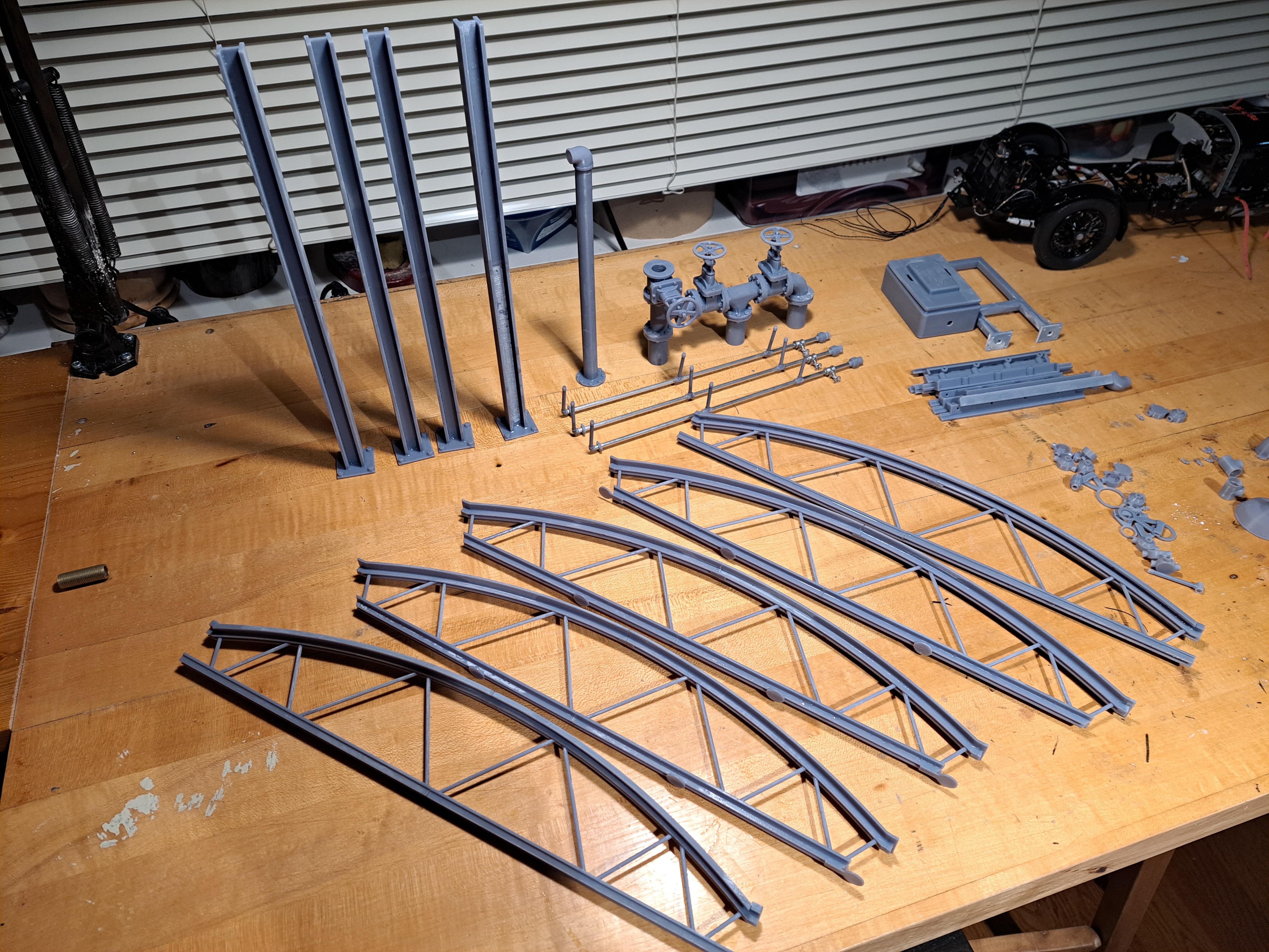

I printed many parts for the display case today. Many more still to print.
Structure printing plate
Lighting and electrical box printing plate
All parts washed and cured
Lighting components
Electrical box components
Structure components

Started some sub assemblies on the display case today.
All 5 trusses are glued
4 H columns
They were too long to print in one piece so I did them in 2. I added a locating feature at the ends of both half to assure a good alignment.
Did the large gate valve assy
And the 3 sprinkler pipes

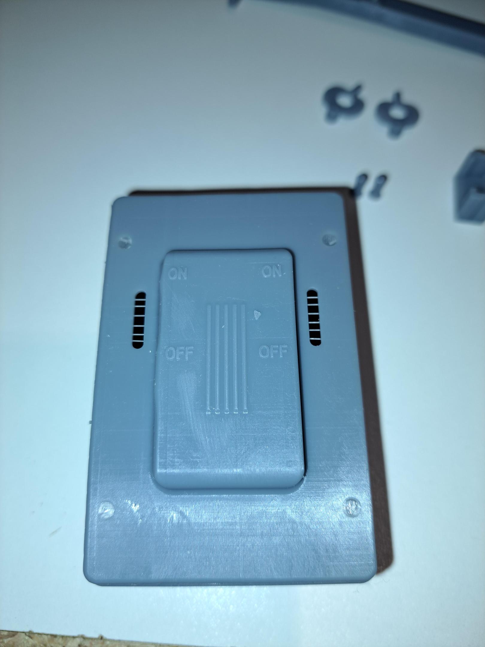

I started painting the different components and fabricated the front and back panel frames. I received 1mm thick plexiglass.  I need a thin plexiglass for the curved roof, I'll see how this thickness works for the side panels. I also assembled the electrical box with the 2 switchs.

Electrical box painted and assembled
Working switchs

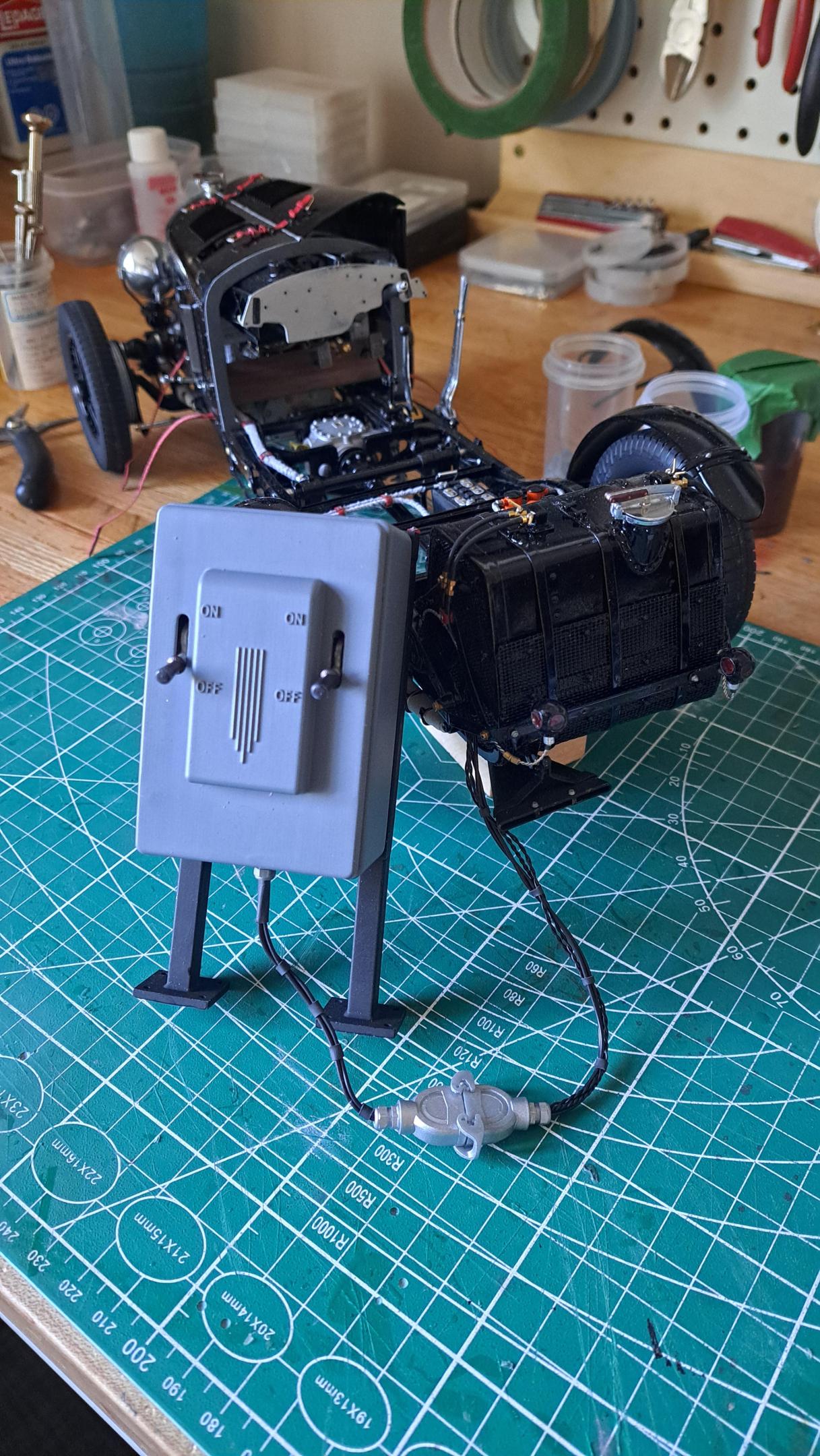

Did a bit more work on the electrical cabinet.  The model will be hooked up to this cabinet but I want to be able to unhook it if I need to remove the model from the display case.  So I modeled and printed a miniature multi pin connector complete with locking latchs. I've used these type of connectors many time on machines when it was necessary to separate one piece of equipement from another,  exactly what I want to do here.
All connections to the battery box and switchs are done
Here's the cable connector on the cabinet
And the multi pin connector
