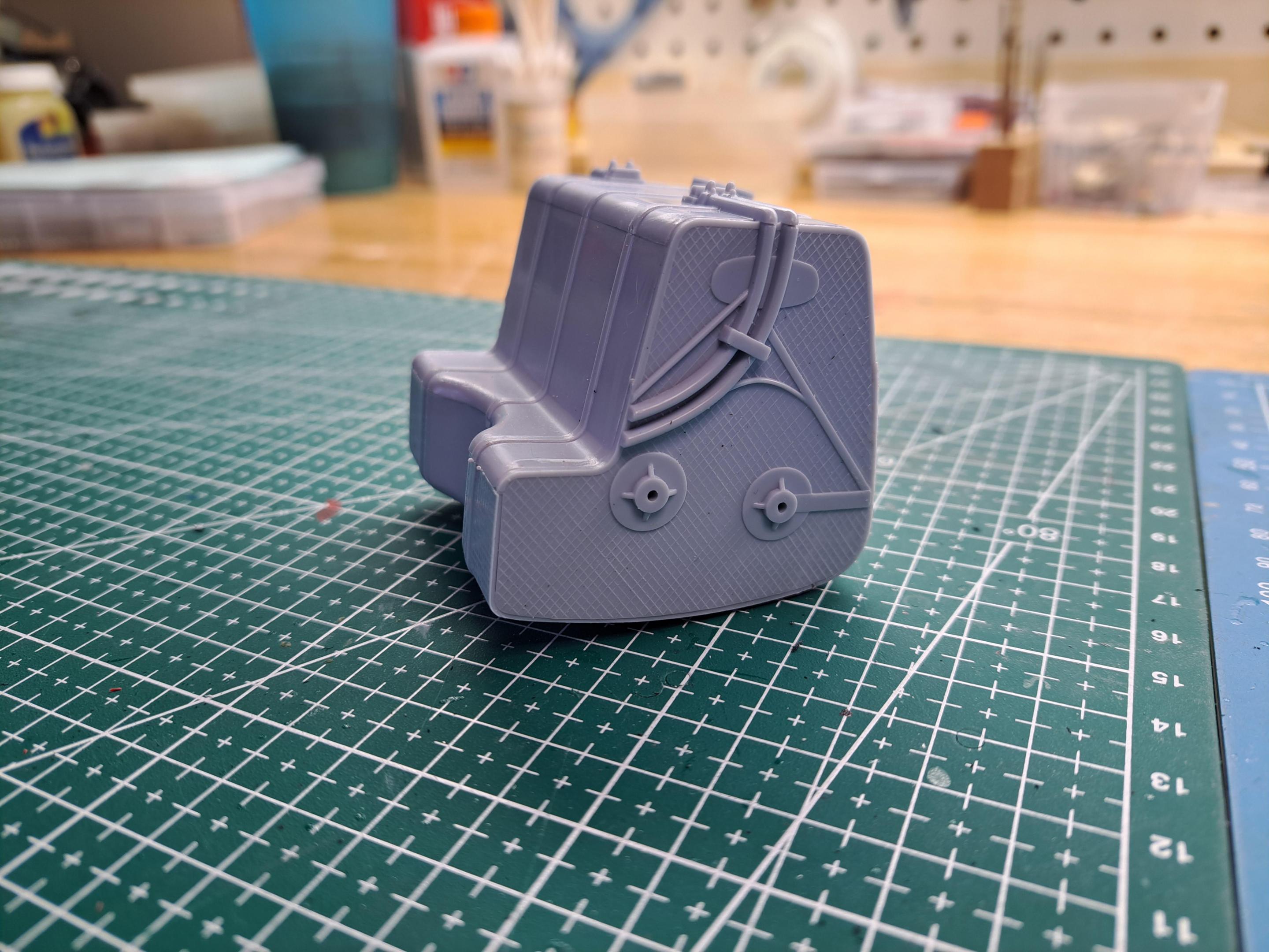

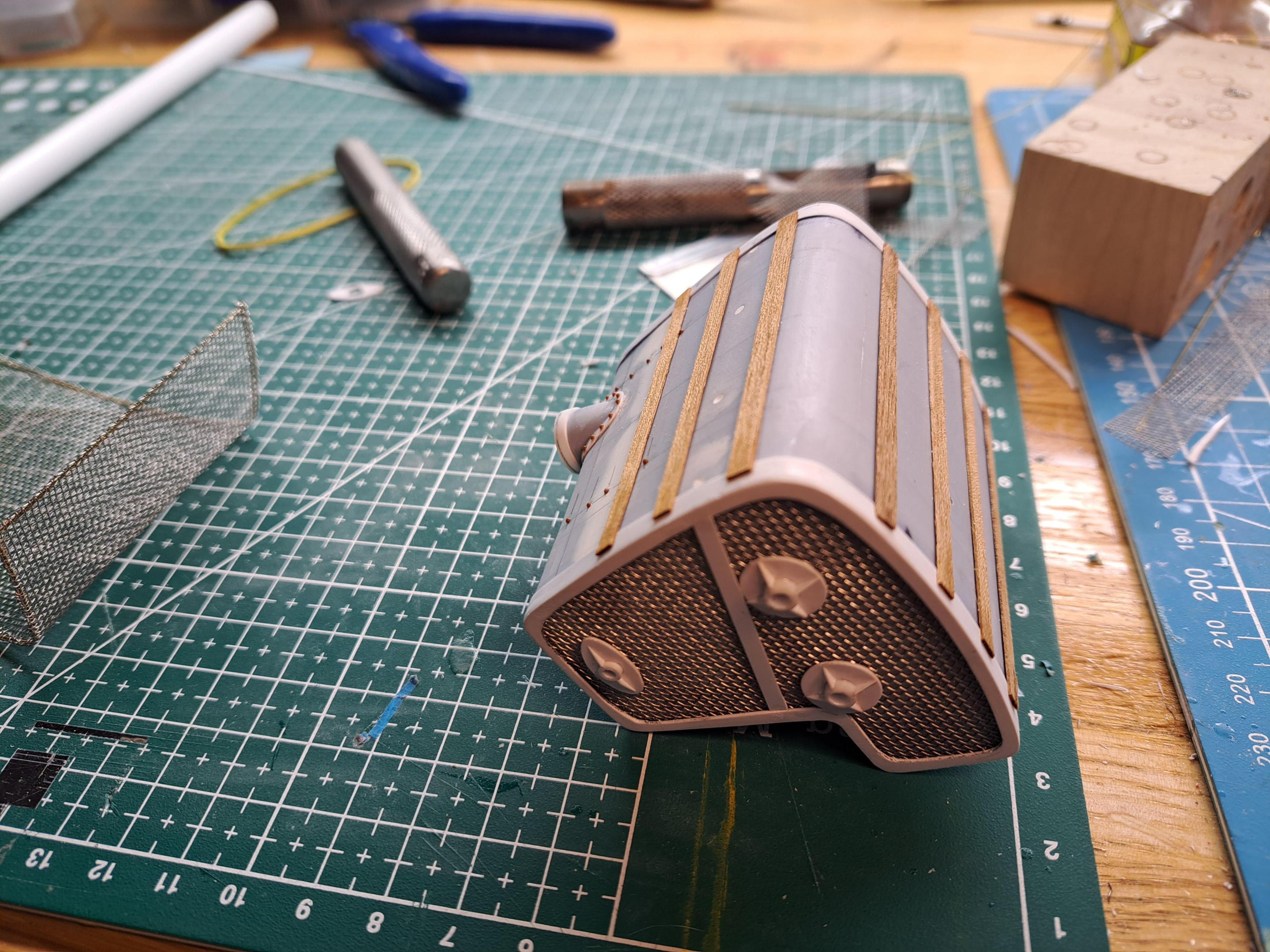

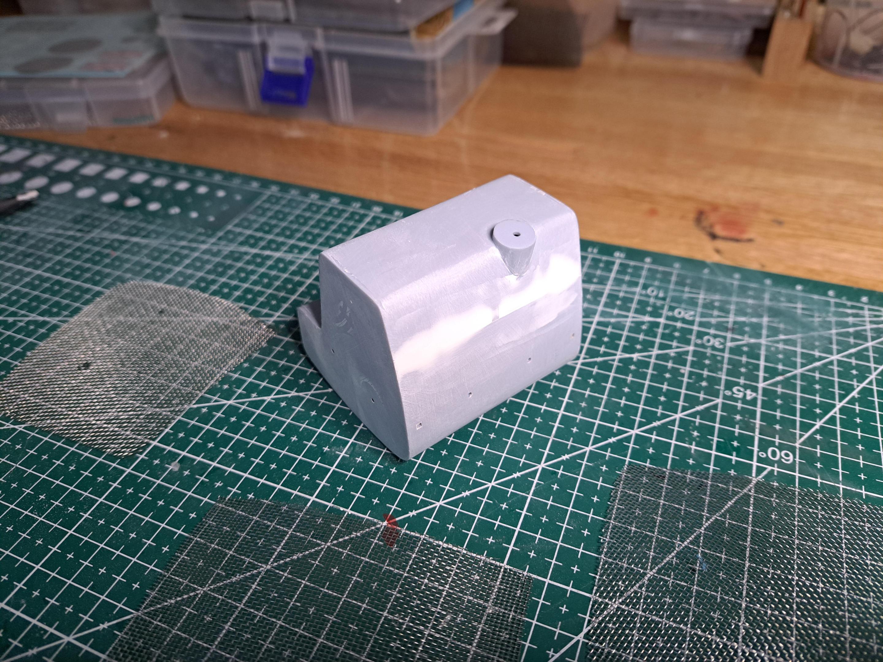

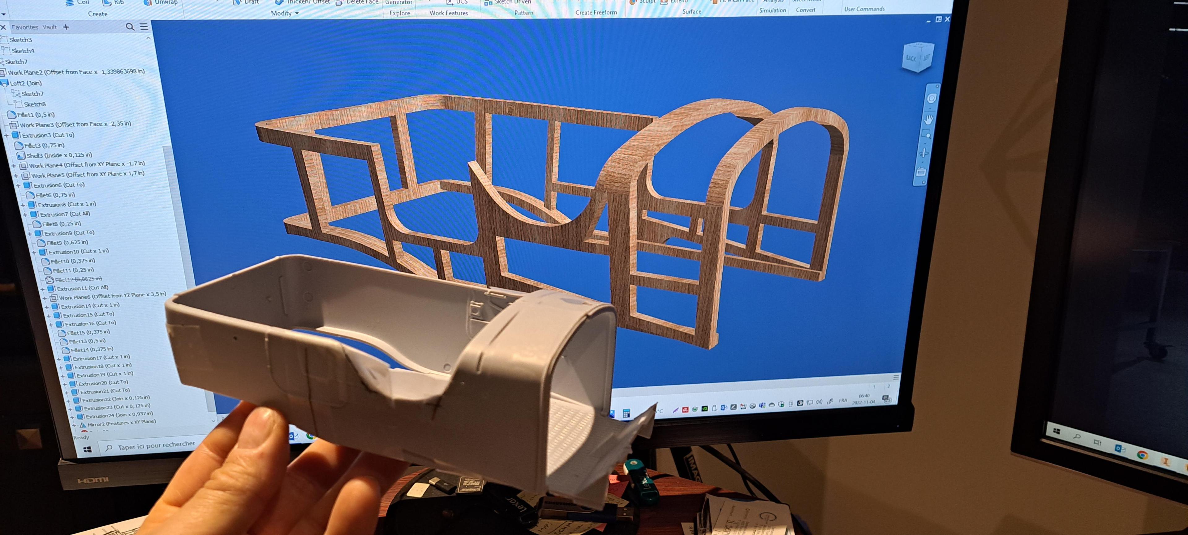

François Posted May 24, 2023 Share Posted May 24, 2023 Hello, I started building the Bentley blower from Airfix. This kit is very old with moulds dating back to the 70's, so the fit and details are not very good. It will be up to me to improve. In 2020, Bentley decided to build 12 new 'old' Blowers using the original fab drawings. The result is nothing short of amazing. As a reference car, I decided to go with car 'zero' of this new old series. We usually see these cars in the more traditionnal british green with green interior. The zero car is black with a red interior which is very nice. Here's what I'm hoping the end result will look like. Here's a quick list of the modification I would like to do to the base kit. Fully detailled fuel tank Wired wheels Working brake linkage Working inner engine parts, 3d modeled and 3d printed Leather upholstering Carpeting as per ref car Fully detailled engine Cloth rag top with working top frame Adding nuts and bolts Fabricate the body either from real wood or 3d print it. The kits body is plastic,naturally, but the actual body was a wooden frame with aluminium sheets on certain areas and then covered with a man made material called Rexine. Very cheap at the time but very expensive today. Bentley had to refurbish old machinery to make the material for the 12 new old cars. I'll be using a very thin rubbery material that, I think, will look pretty good. My first task was to 3d model the body using the kit's body as refenrence to eventually fabricate it out of wood or to print it (or both). real wood body Now, that being done, I decided to sleep on it a bit (or a lot) to figure out how to make the thing. In the meantime, I started on the fuel tank. Here's what the kit gives And here's what I'm aiming for Here are a few pictures of the process I hope all of this is to par with what is normaly posted. more to come 7 Quote Link to comment Share on other sites More sharing options...

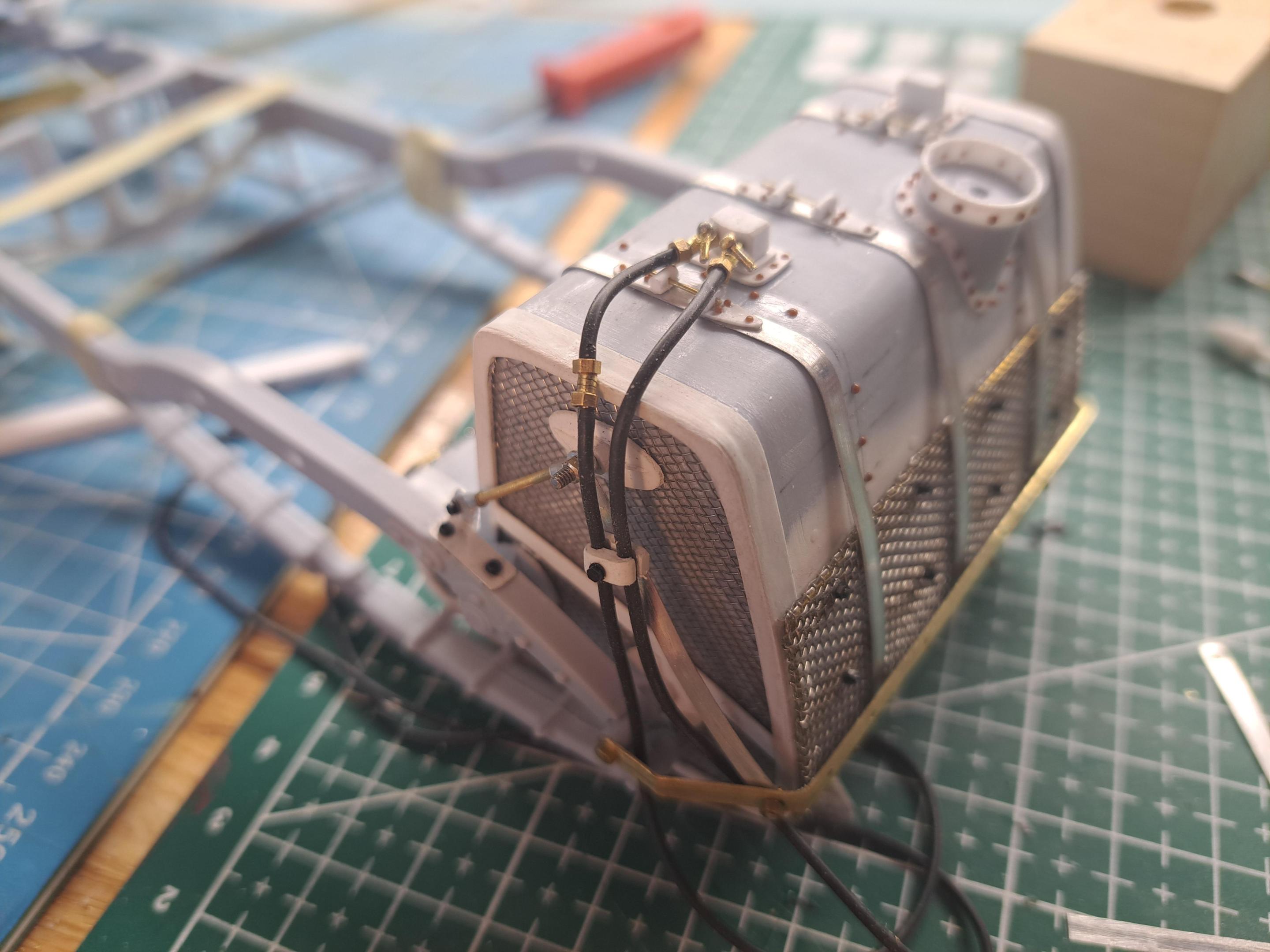

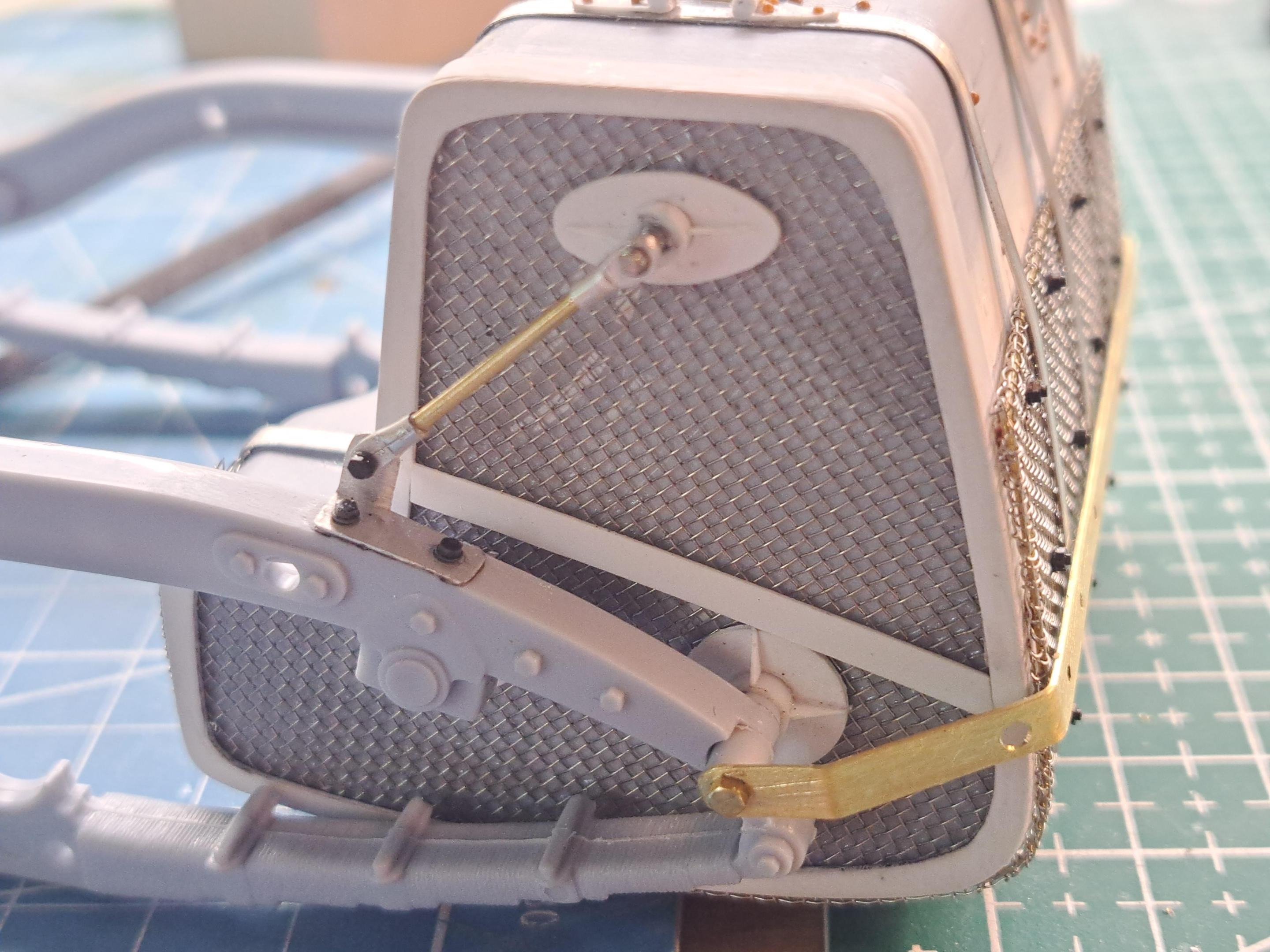

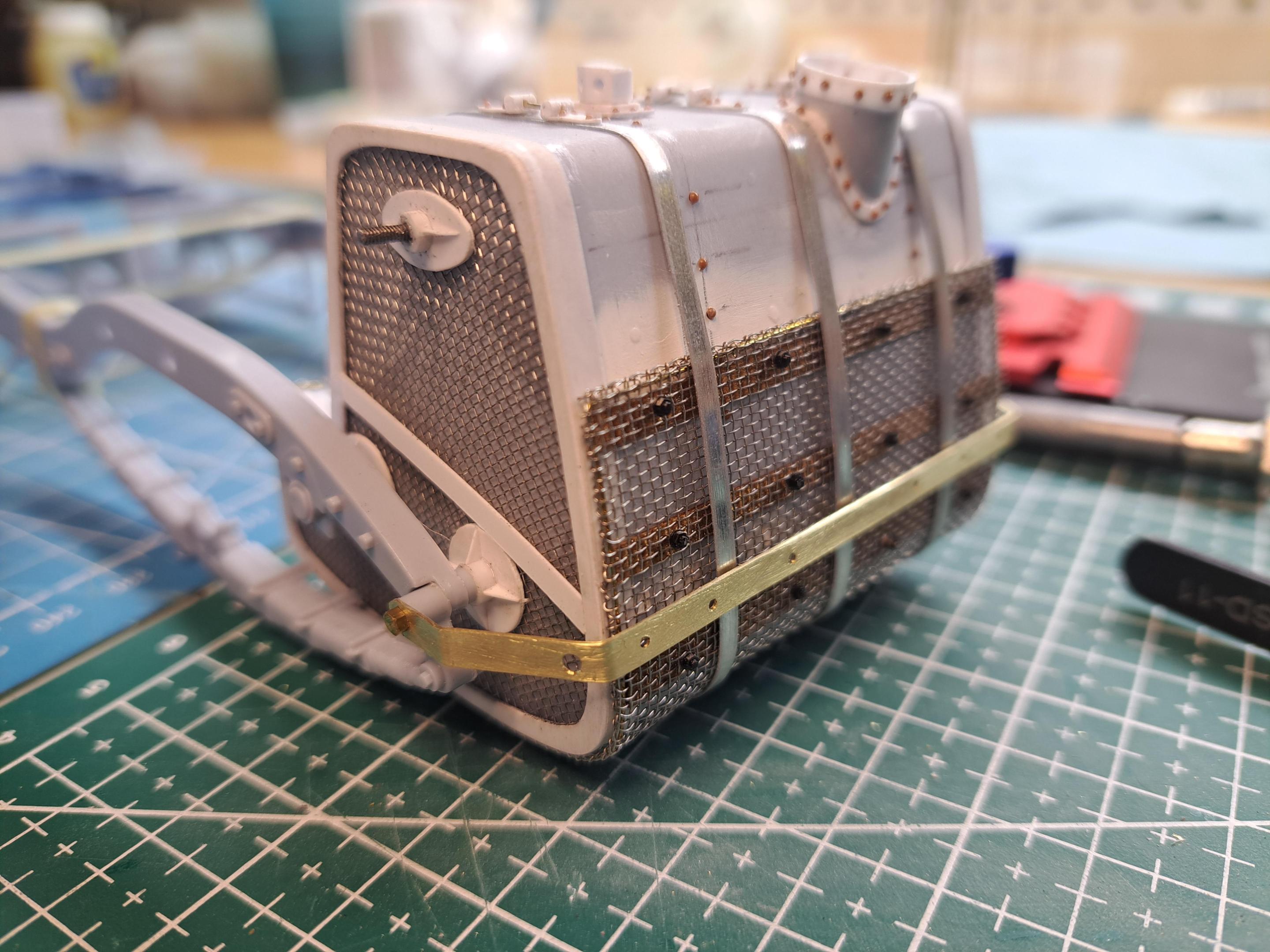

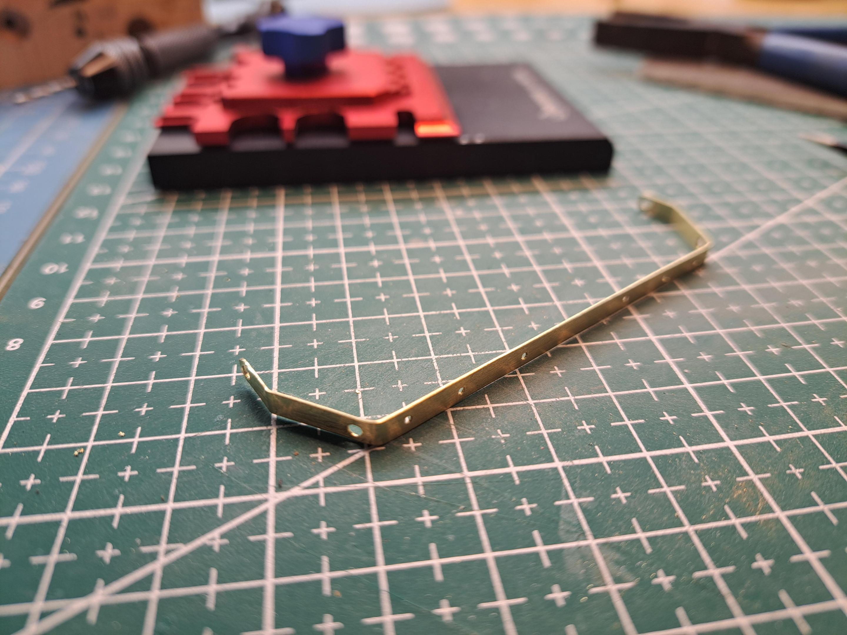

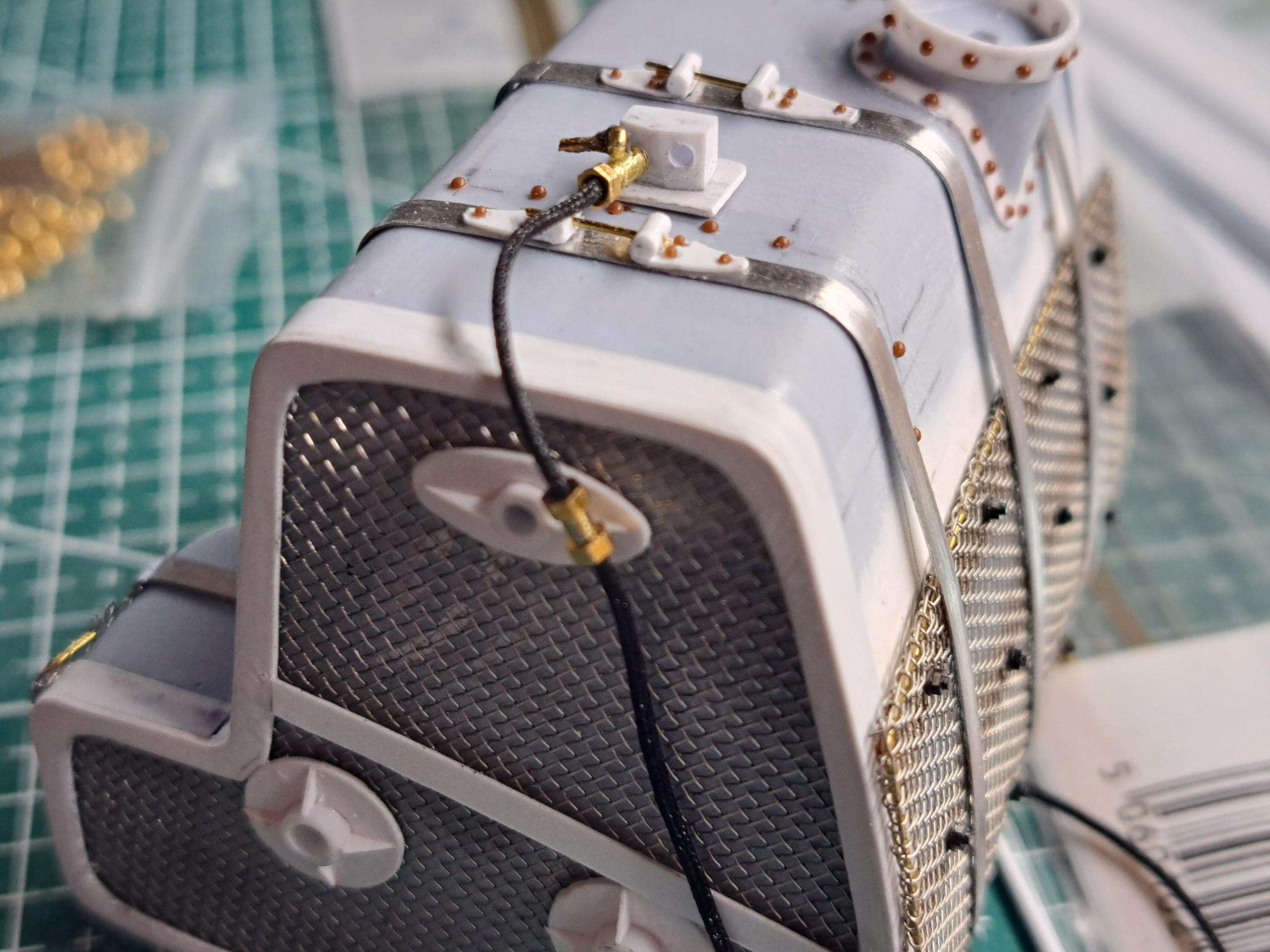

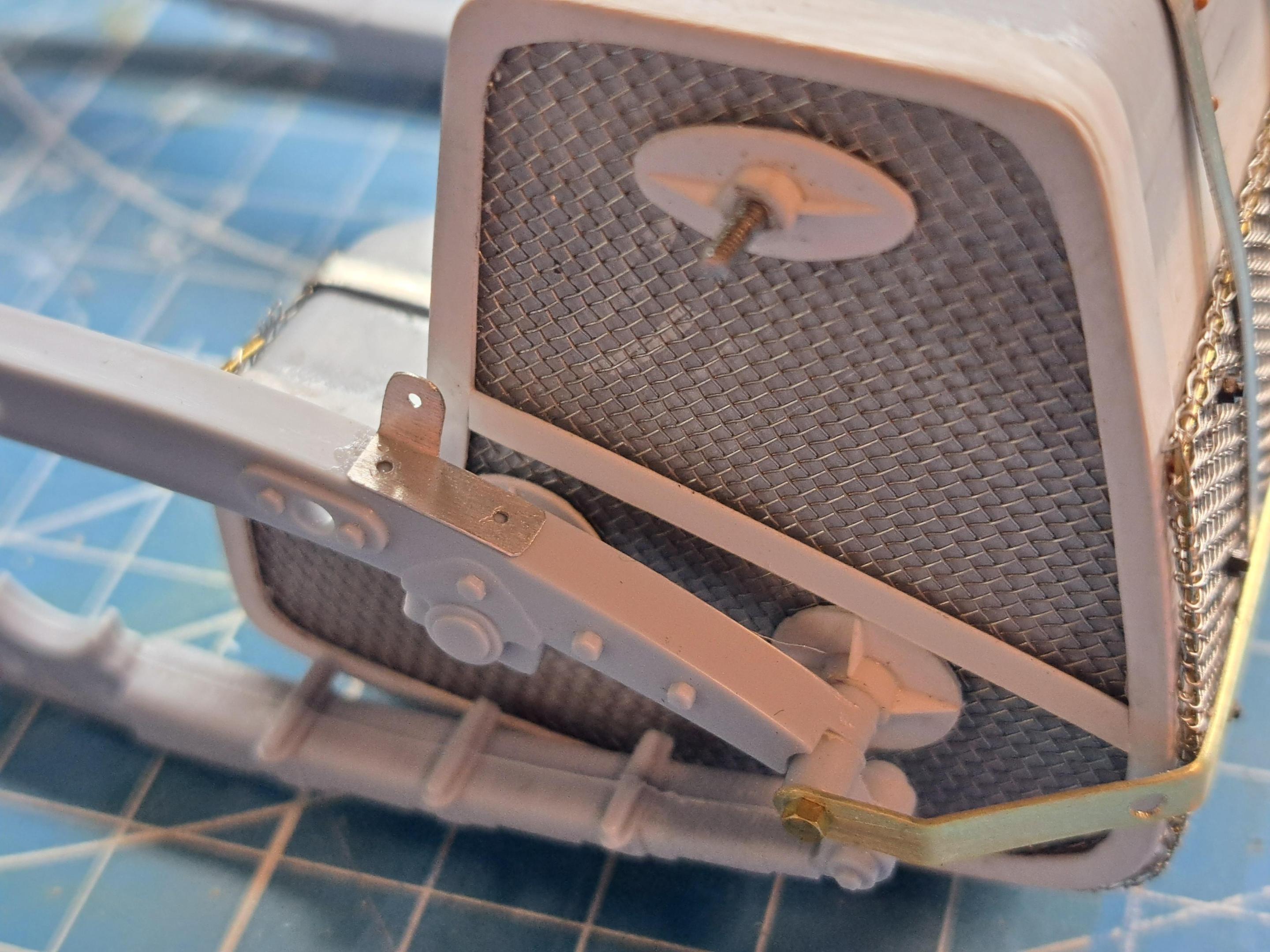

François Posted May 25, 2023 Author Share Posted May 25, 2023 Did a bit more work on the tank this morning. Made the bumper out of a brass strip made the left and right tank support strut bracket And both tank support struts Still have the fuel hoses, fuel hose clamps, clamp support bar and tail lights brackets to do. Should eventually look something like this. 2 Quote Link to comment Share on other sites More sharing options...

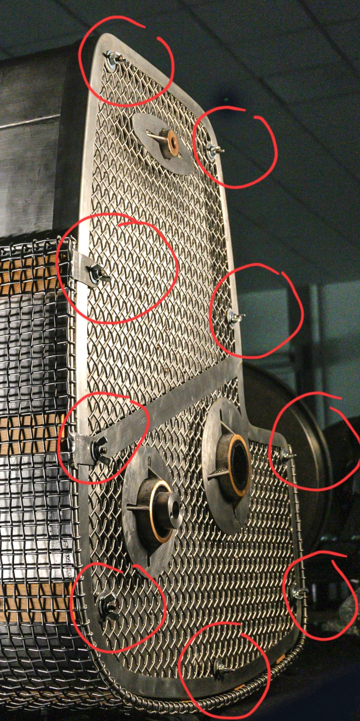

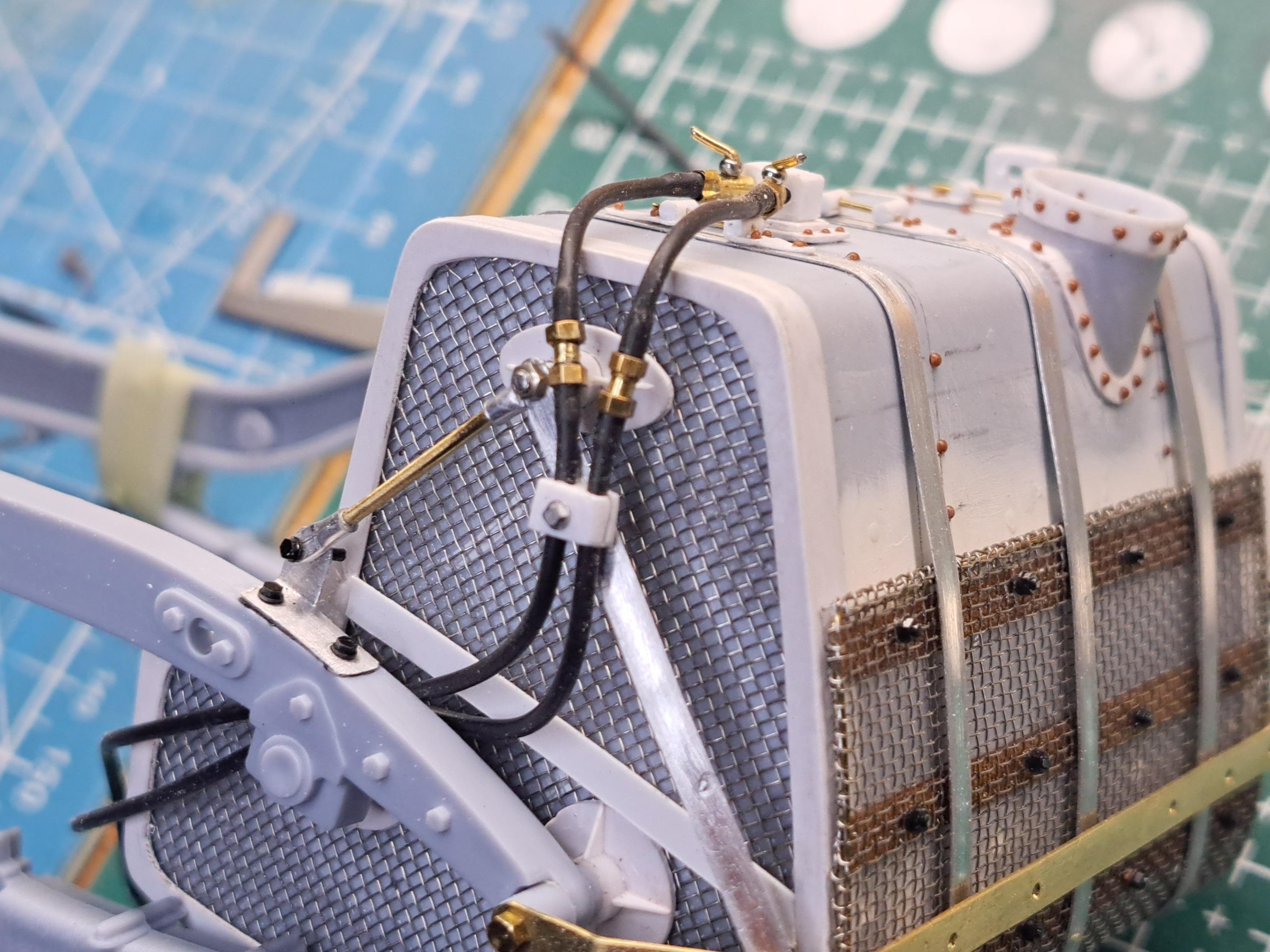

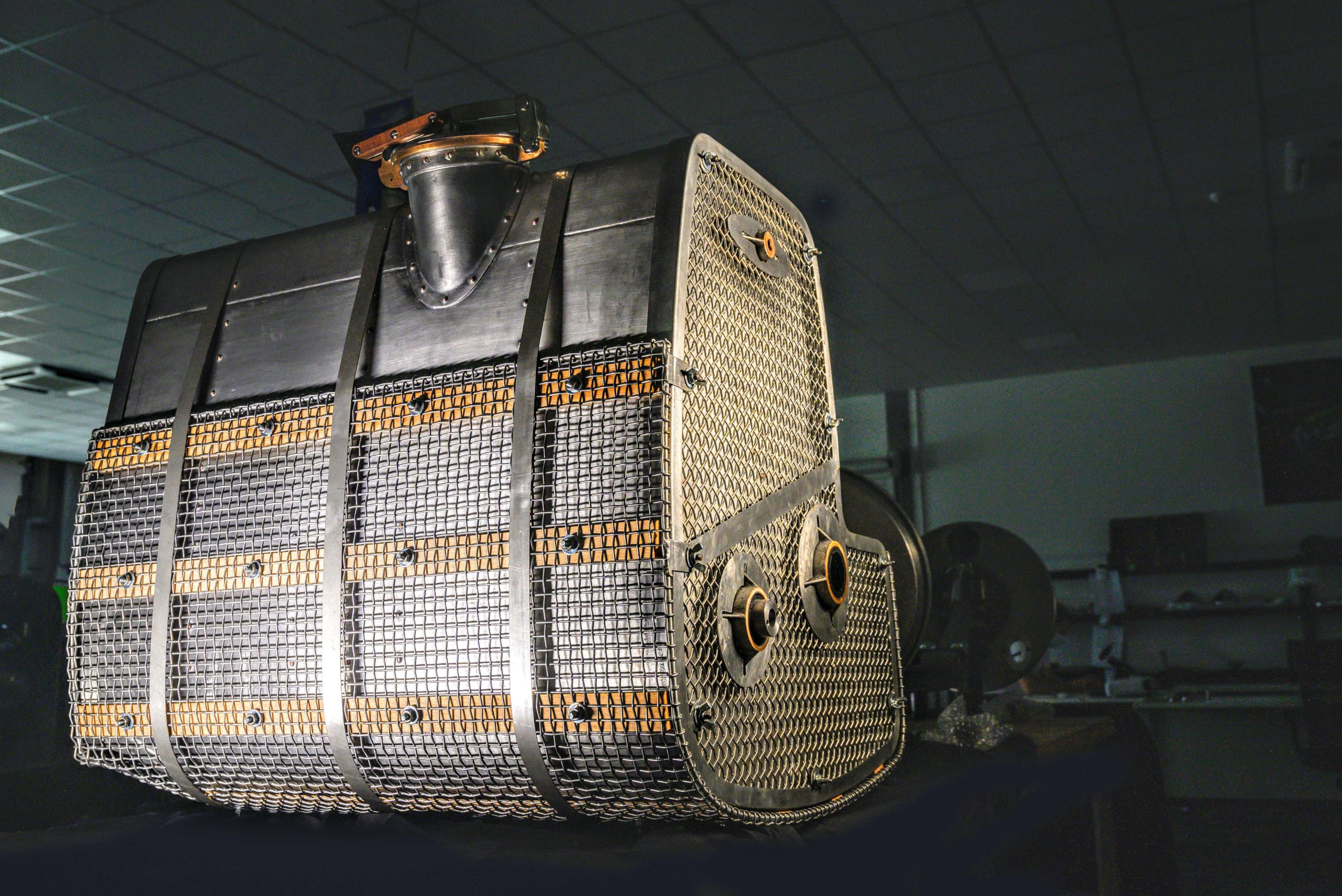

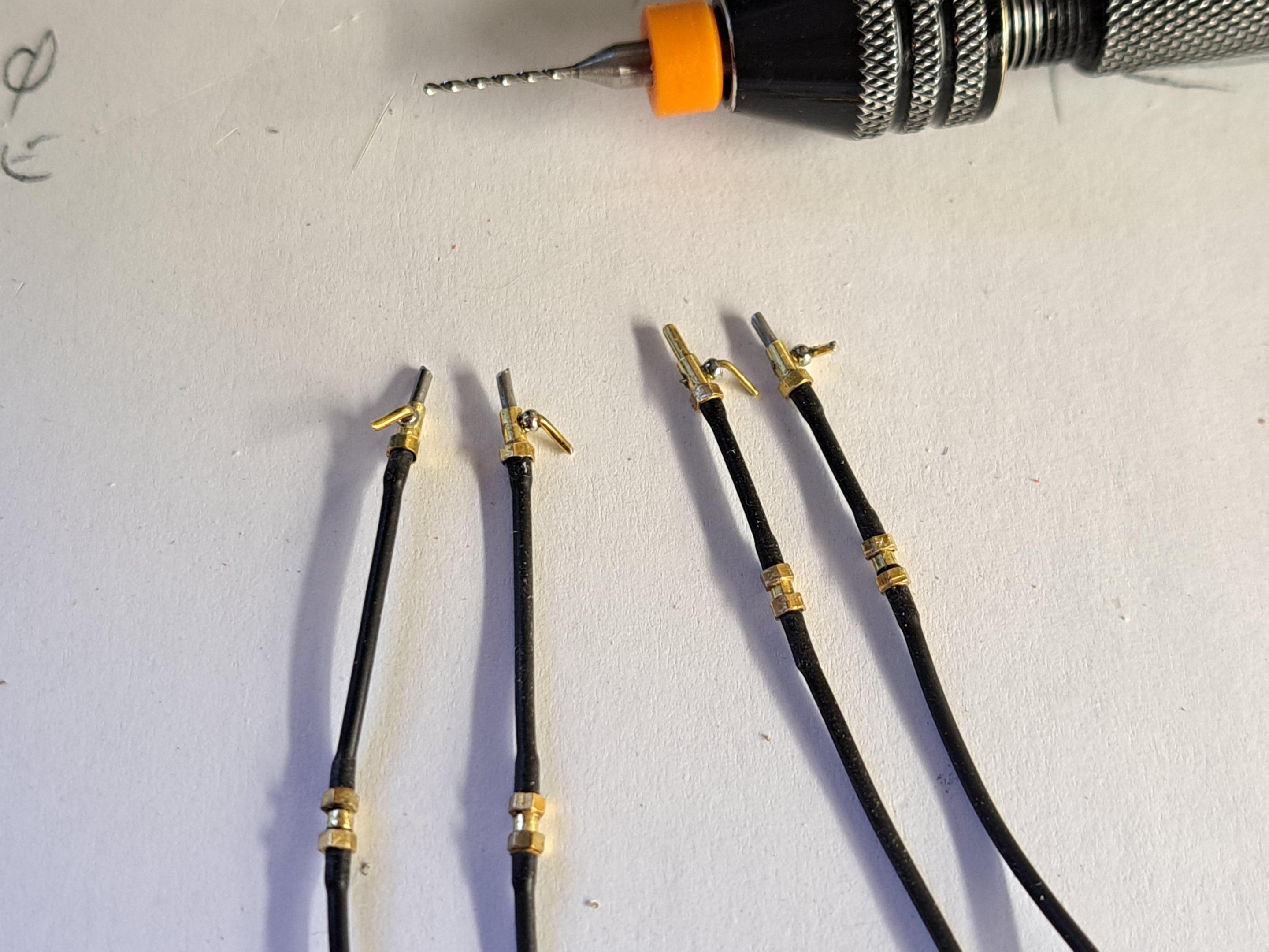

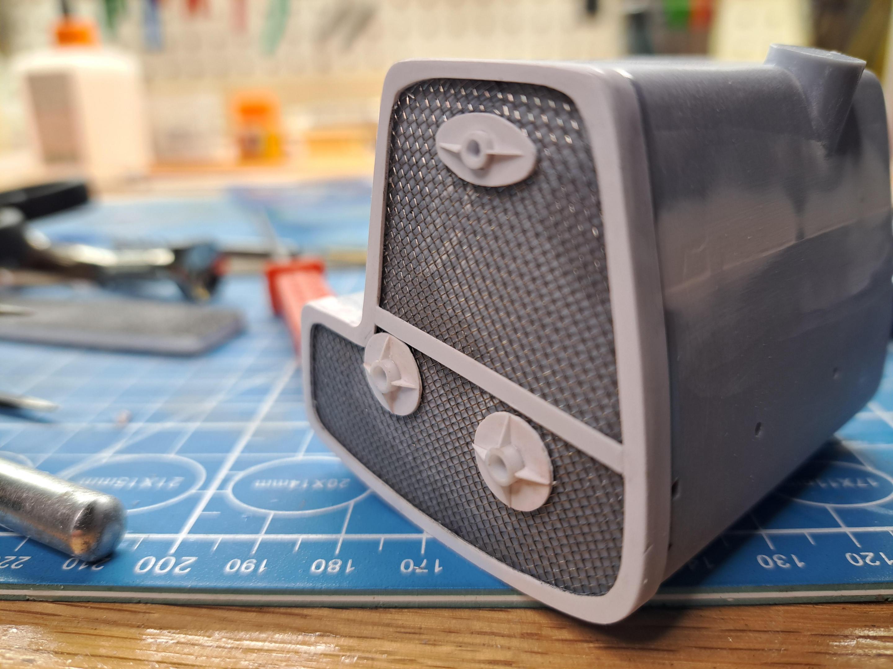

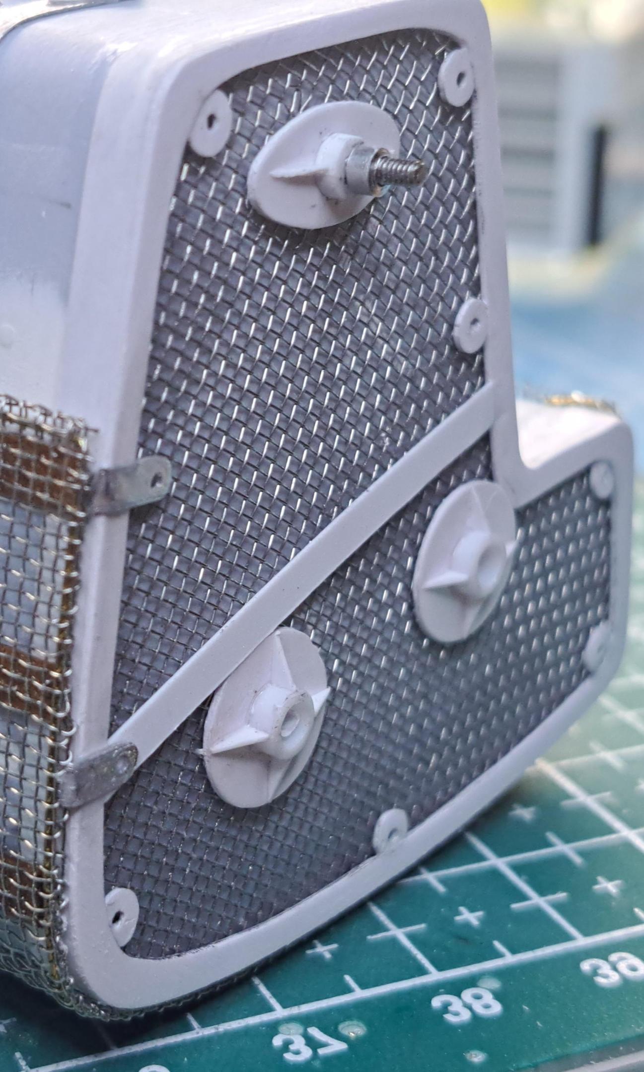

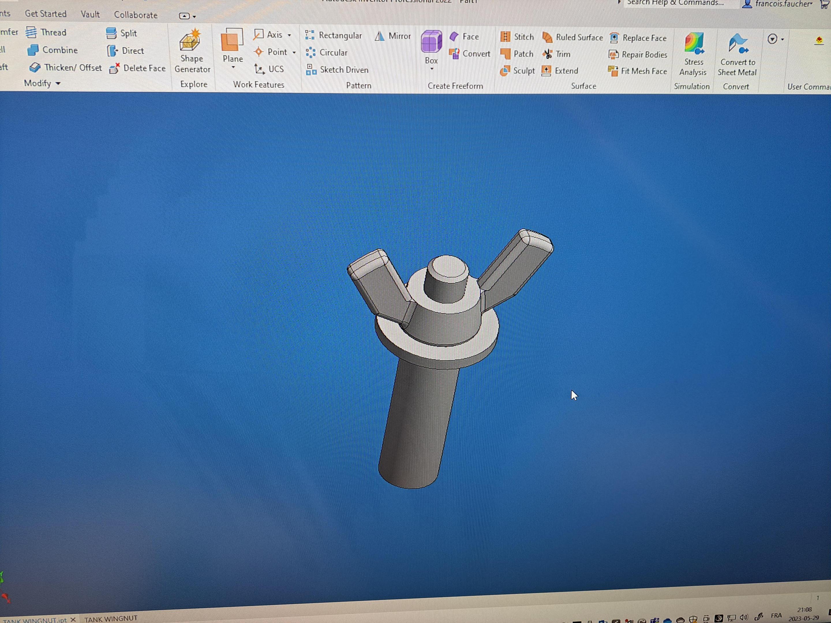

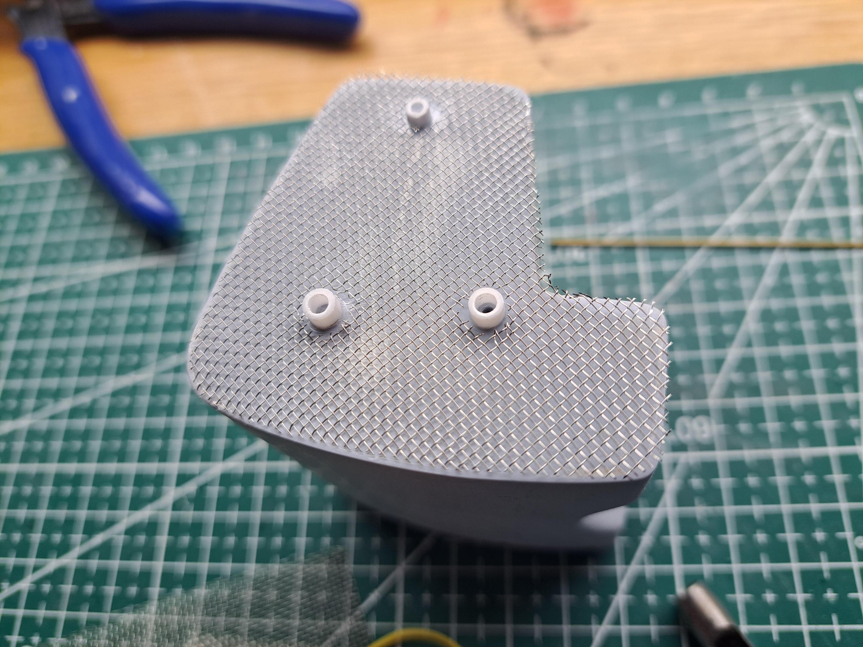

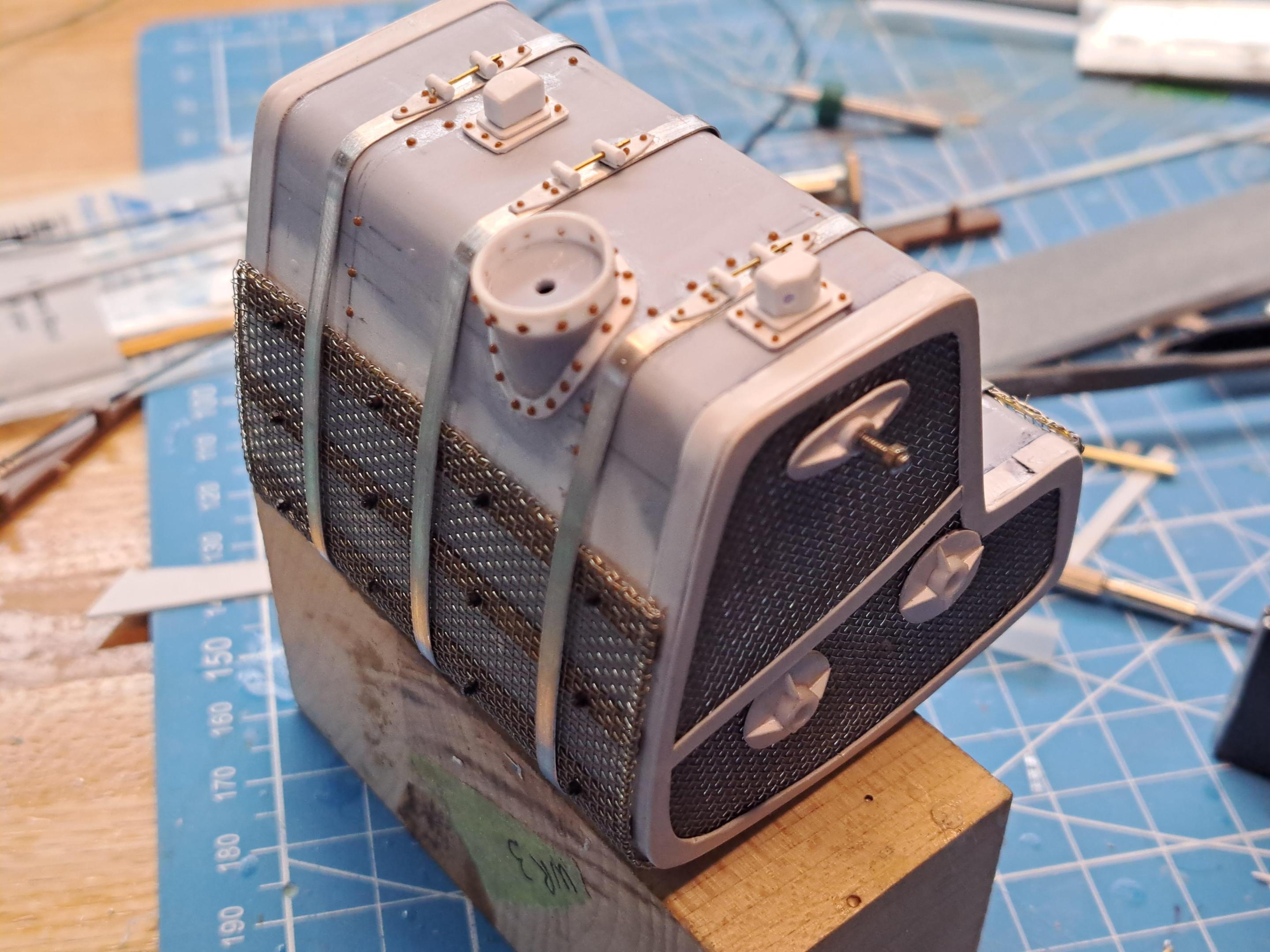

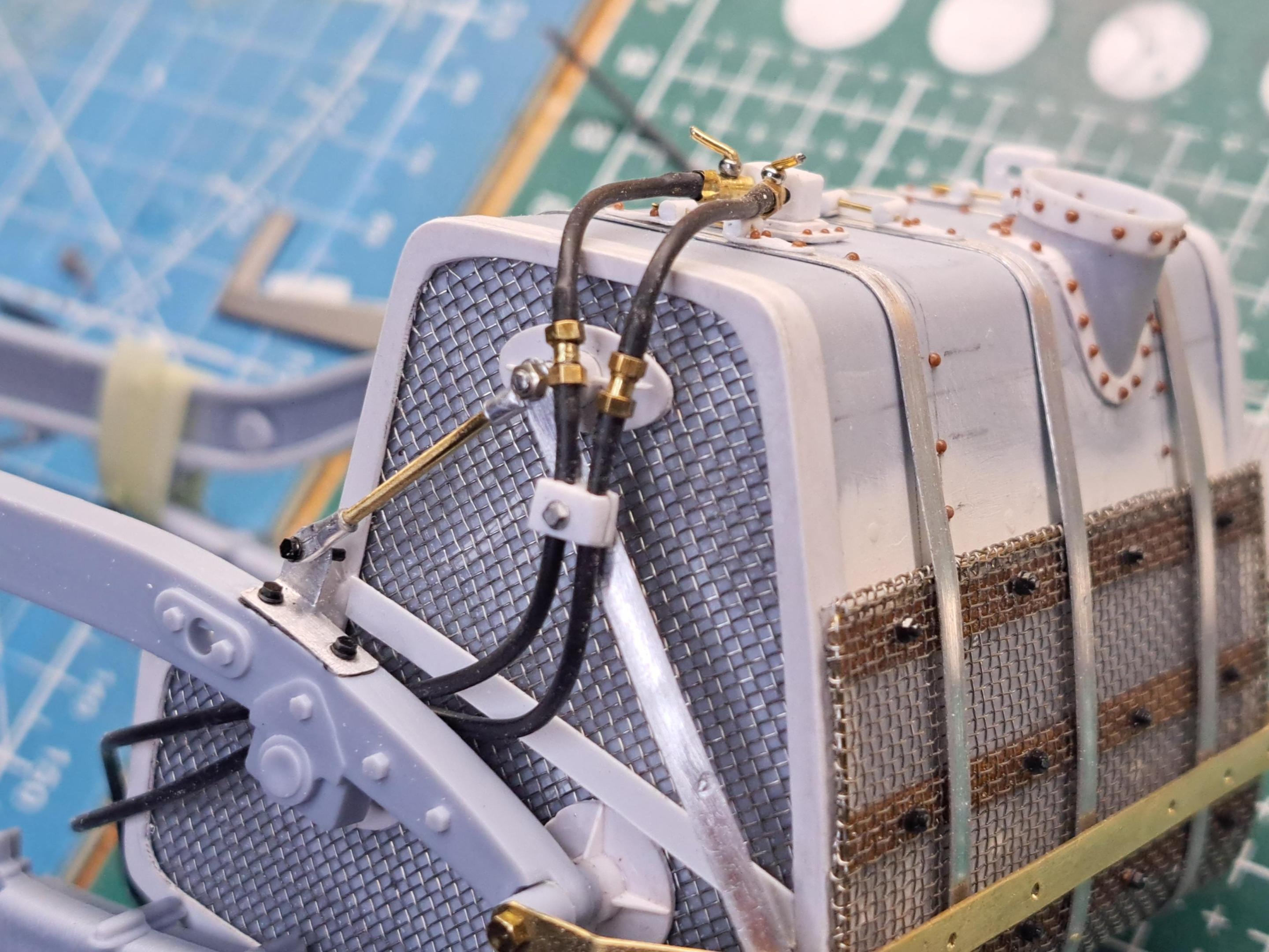

François Posted May 30, 2023 Author Share Posted May 30, 2023 Finaly got all 4 fuel hoses done complete with a better looking petcock than my first try and splicer coupling. and on tank with hose clamp only one more detail to add to the tank before primer and paint. The wire mesh on the real tank is held in place with wingnuts screwed thru welded taps. I tried finding 3d printed wingnuts but all l could find came from europe (so very pricey onces delivered) and I really wasn't sure that the size would be ok. So I 3d modeled a properly sized wingnut for my application and will have it printed locally. Wingnuts on real tank taps installed 3d modeled wingnut ready for printing 2 Quote Link to comment Share on other sites More sharing options...

François Posted May 31, 2023 Author Share Posted May 31, 2023 I hinged the gas cap and added a brass flanged sleeve to act as a filler neck. I'll eventually put wood on the cap handle. Now if I could only figure out how to remove the chrome, this is no paint, it's very hard. So far, I've tried bleach and draino. Didn't do a thing. The only thing that works seems to be sanding. There are many chrome parts on the car and none are nice enough to keep. Does anyone know a way to do this? 1 Quote Link to comment Share on other sites More sharing options...
