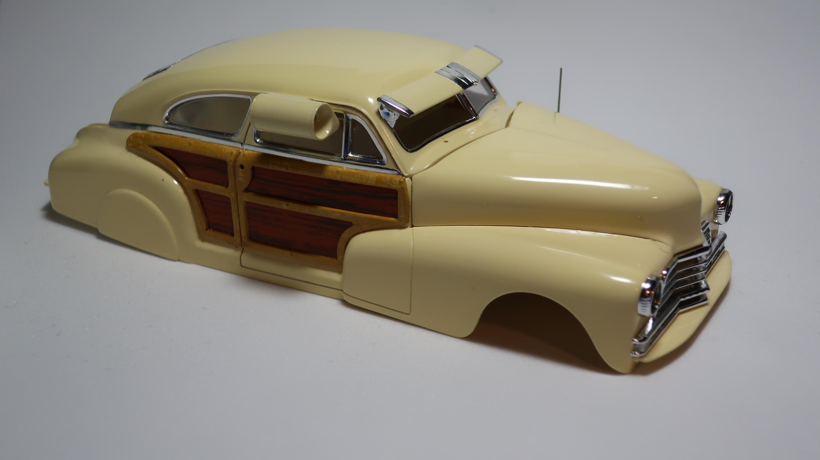

Len Woodruff Posted June 2, 2023 Posted June 2, 2023 (edited) I have been using this paint decanted on several bodies. I like the results but I have gotten a few fish eyes in a few places. Not sure why? Any ideas? Edited June 2, 2023 by Len Woodruff add pic

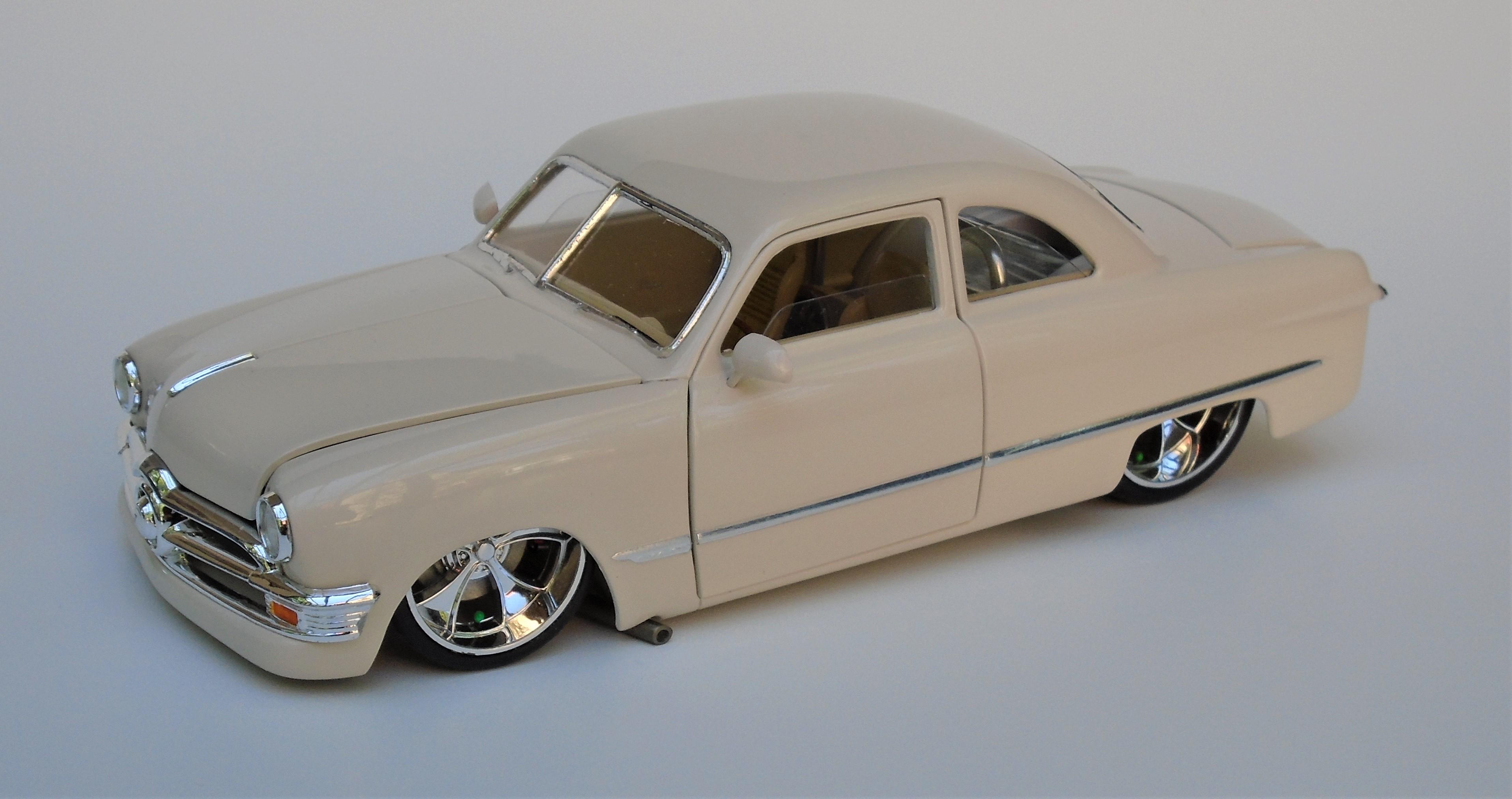

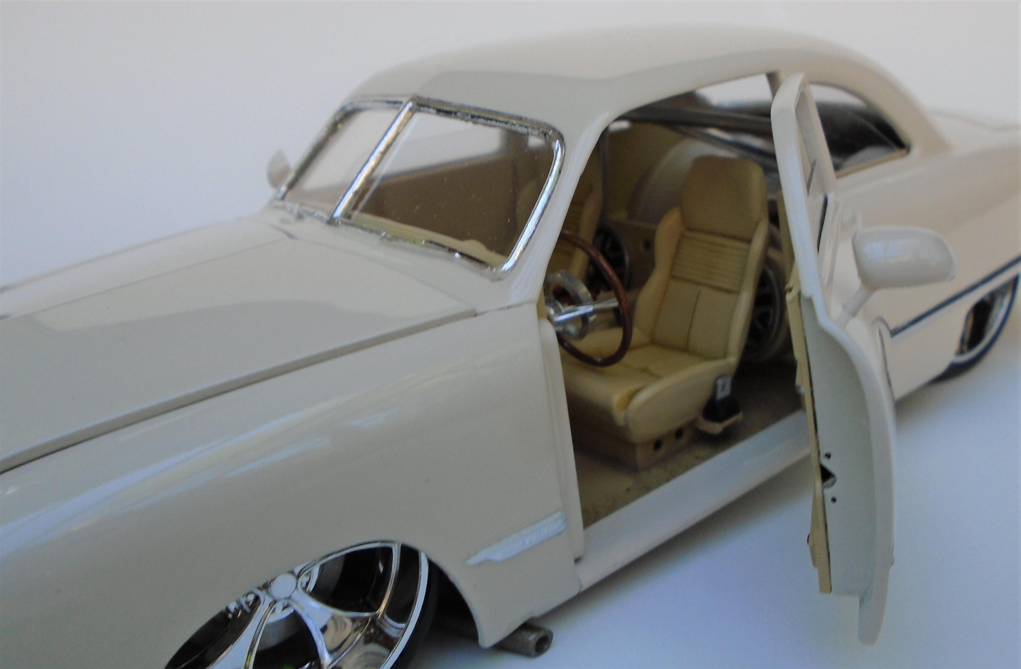

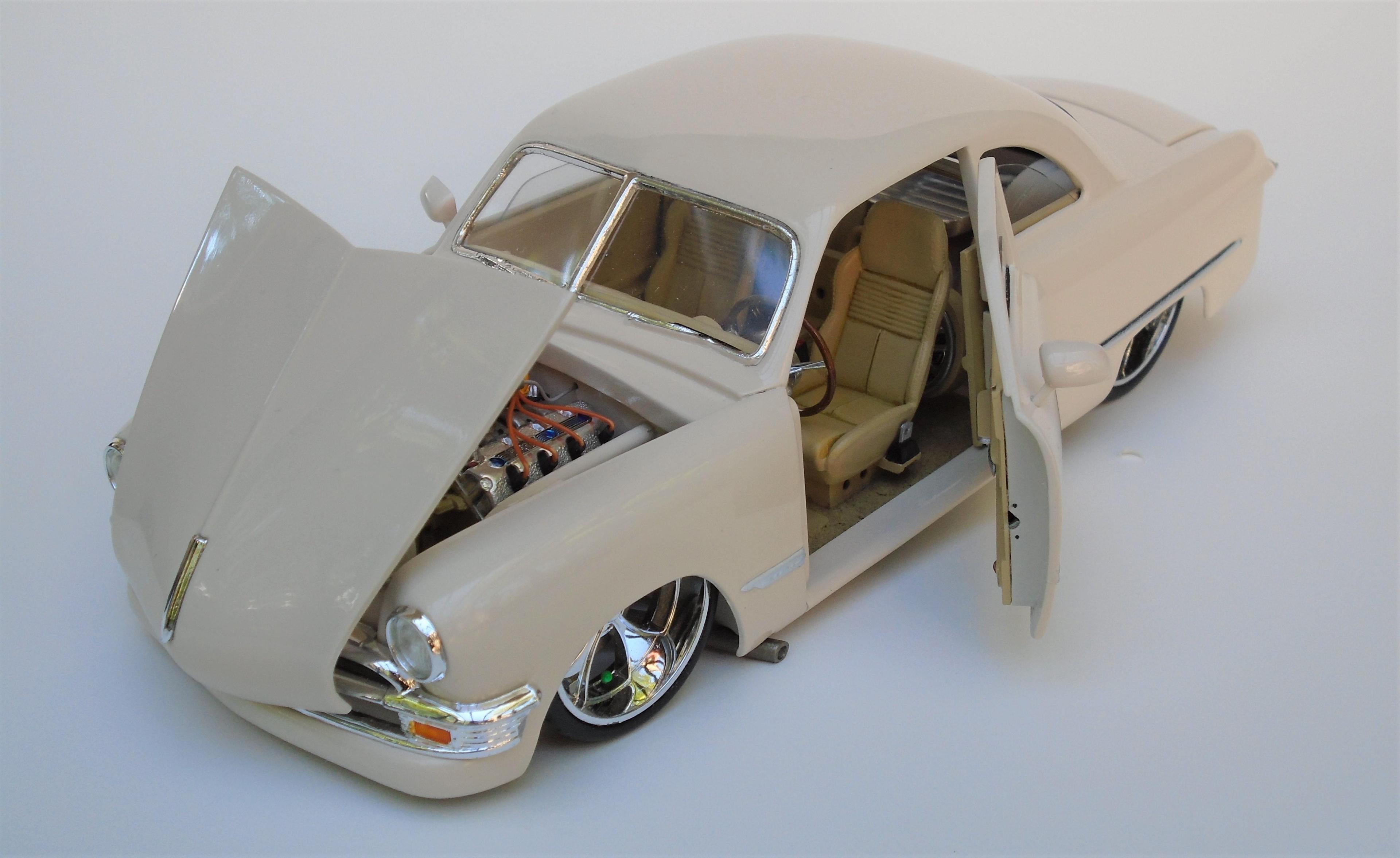

Ace-Garageguy Posted June 3, 2023 Posted June 3, 2023 On 6/3/2023 at 1:03 AM, Claude Thibodeau said: ...Here's a 49 Ford I painted with a Model Master acrylic custom mix with an airbrush, then cleared with the Wet Look clear. Almost no rubbing, believe it or not... Expand Yup, once you master the process... ?

Mark Posted June 4, 2023 Posted June 4, 2023 The coupe kit is a '49, but the hood, grille, and rear bumper (slightly different) from the '50 convertible kit drop right in place as both kits were created alongside one another. There are other slight differences between '49 and '50, but between the two kits someone wanting a '50 coupe (or '49 convertible) should find what is needed.
Claude Thibodeau Posted June 4, 2023 Posted June 4, 2023 On 6/4/2023 at 3:19 PM, Dave G. said: The paint and build in general look great. The question: how did you manage to get this in a 1950 version ? Is it a kit bash ? Expand HI! I did mix some of the custom parts from the 49 & 50, and modified the grille to fit a lower roll pan in lieu of a bumper. Fun you did notice! CT

Dave G. Posted June 5, 2023 Posted June 5, 2023 On 6/4/2023 at 6:28 PM, Mark said: The coupe kit is a '49, but the hood, grille, and rear bumper (slightly different) from the '50 convertible kit drop right in place as both kits were created alongside one another. There are other slight differences between '49 and '50, but between the two kits someone wanting a '50 coupe (or '49 convertible) should find what is needed. Expand That's what I kind of figured, thanks. I have a reason to build a 50 Ford coupe.
