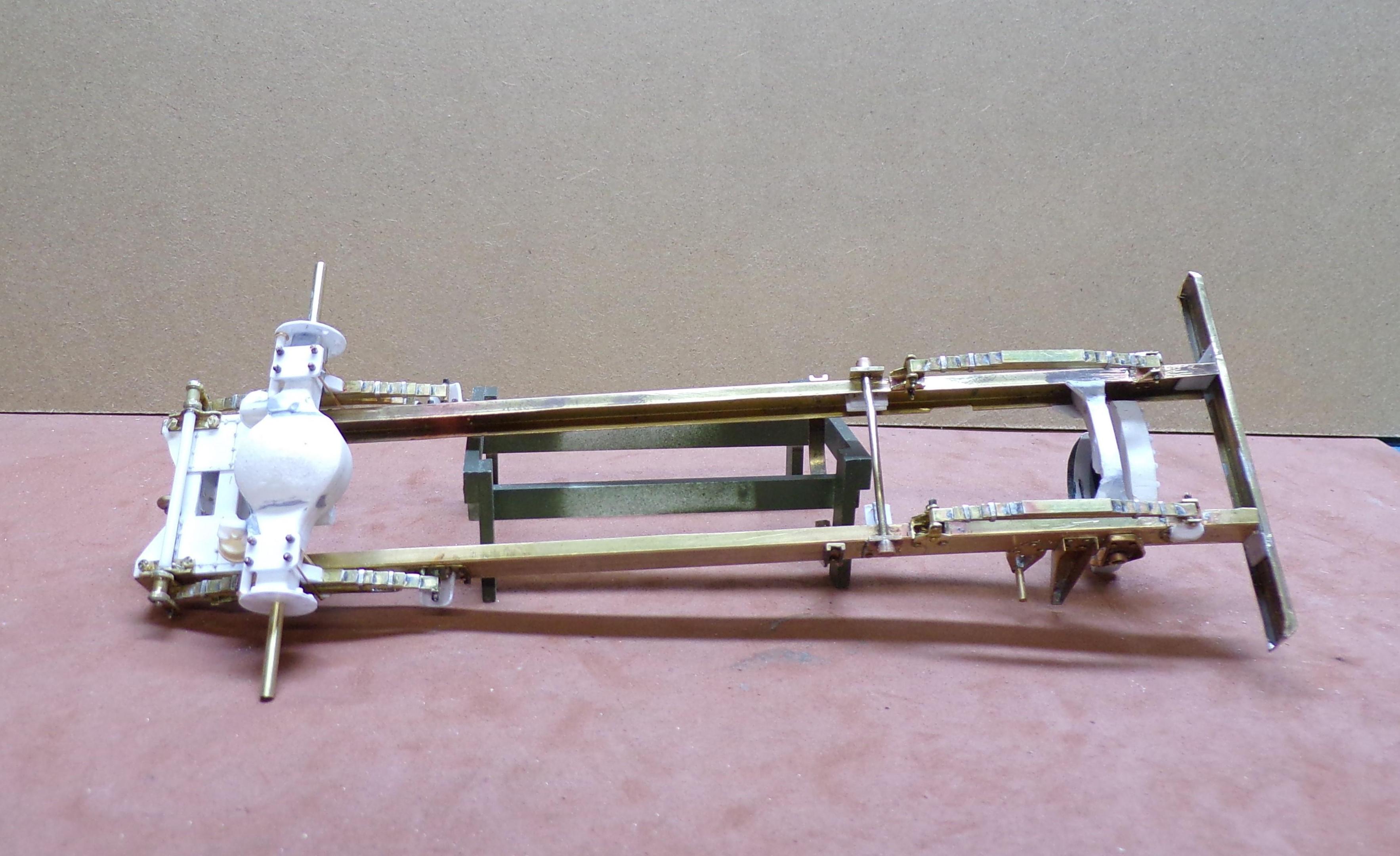

Springs are now mounted on the frame and the rear axle is set at the proper height.  Still work on the front axle to do in order to get the right location and wheel track.  Here is where we are now.

Did you find some brass for the springs?
greg
Used what I had which is a tad narrow but it worked out ok.  The real springs would require a 3mm width but all I had was 2.38 mm.

Saw a video about cutting brass strips from sheet by scoring and then fatiguing the grooved metal in a vise. The width of the vise was extended with aluminum angle but I have an inexpensive aluminum bending brake that would work too. Of course, stacked styrene strips for a leaf spring is an easy option for us hacks that can't solder, LOL
So much detail going into this, thanks for sharing the journey!
hey, Bob.  I've tried styrene strips a couple of times but you have to roll the edges a little to maintain the look of individual leaves.  That is the beauty of the brass in that the sides already have just the tiniest bit of roundness to them.  Even painted the leaves still stand out.  BTW, soldering the leaves is one of the easiest of things to do.  I used a butane torch to heat just the ends one at a time to pull the solder in between them.  Start with the shortest pieces first and build up from there.  There's no solder in the middle at all.

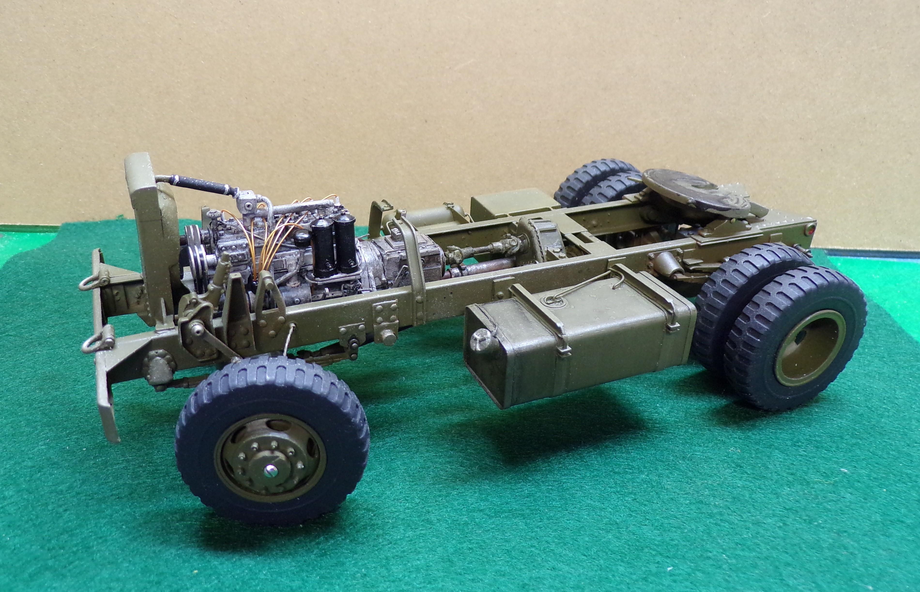

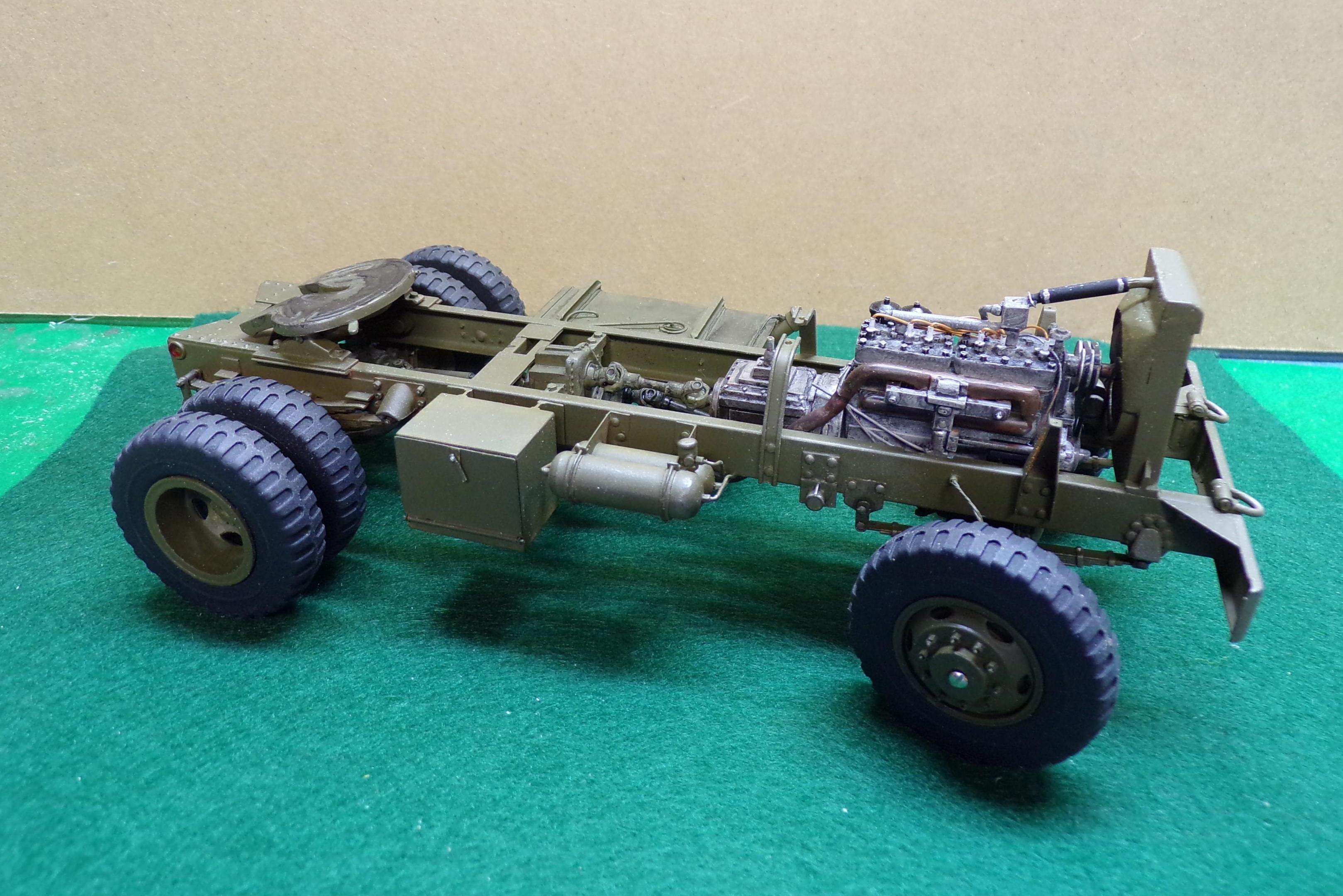

The elves continue to be busy.  The frame and running gear have been painted and the engine is installed.  Exhaust has been added.  A tool compartment is now behind the air tanks and the fuel tank is on the left side just behind the cab.  All of the driveshafts are in position.  I was able to get some 3D printed U-joints and put them on sections of brass tubing.  They are very well defined and are easy to use.  The hand brake is also now behind the transfer case.  Got a few details to go on the cab with the air cleaner, fuel pump, 50 cal. mounting brackets, windshield wipers and motors and finishing up all of the details inside the cab.  Plenty on the plate still to go!?

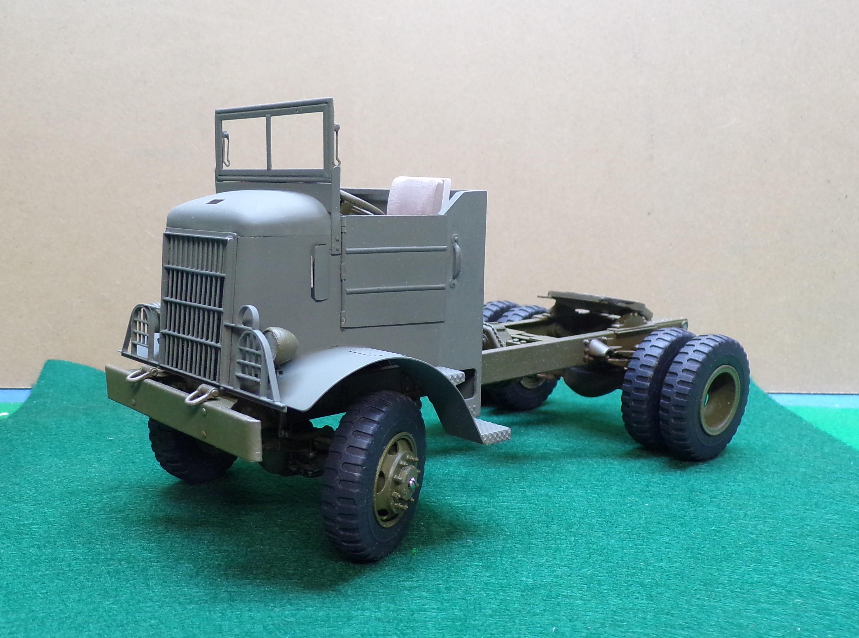

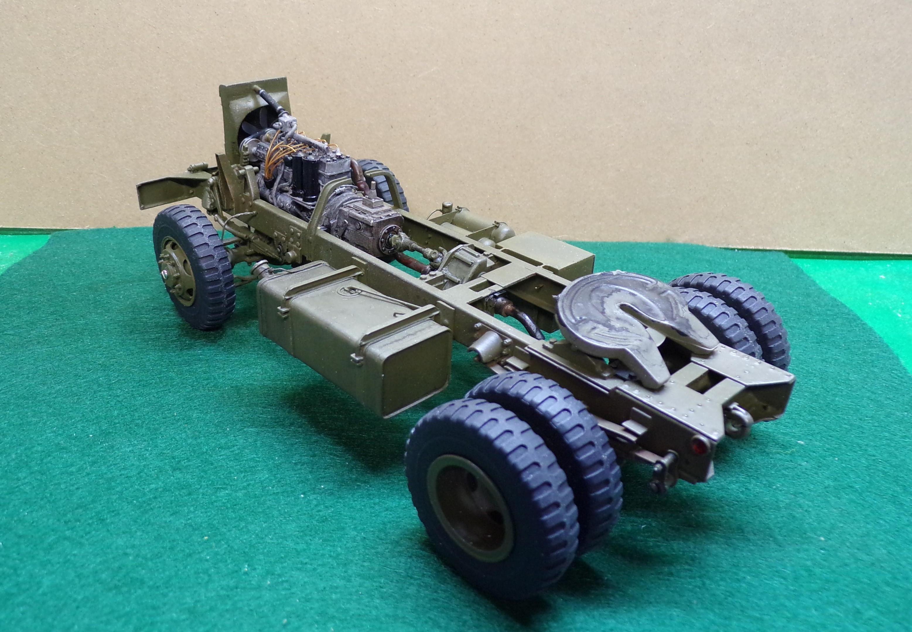

Here's the latest pics of progress.  Some additional details have been added to the cab and the interior is done.  Rear fenders are in place along with the 5th wheel and the plates that direct the trailer to it.094.JPG.da075cb5ccb322f75e90f57f9b2c334b.JPG
Tail lights are installed on each side of the pintle hook.  Reflectors are on the outside of the frame.
101.thumb.JPG.d38b20d80bd14ba678ef571dfcd41f98.JPG103.JPG.a21fa57c661c5ae5317bafef8234bebd.JPG

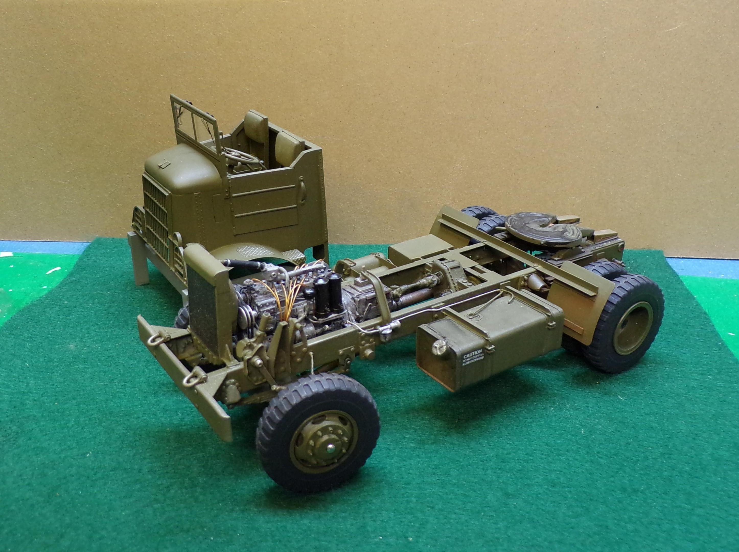

Decision was made to keep the cab removable, otherwise the engine detail would never be seen.  I jury rigged a stand to set the cab on for display purposes.
