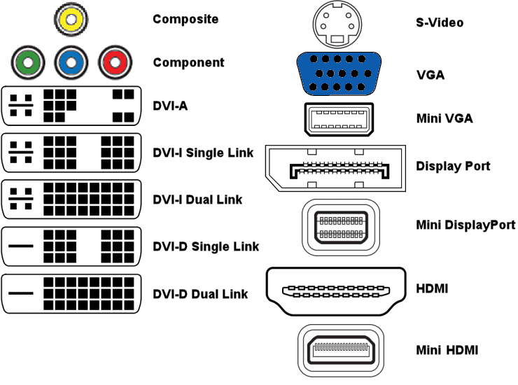

Raoul Ross Posted June 6, 2023 Posted June 6, 2023 (edited) Most monitors, and computers as well, have more that one type of connector. Options are, VGA (the 3 row 15pin connector) DVI (a wider connector with some horizontal blade-type pins on one side), HDMI (looks like a wider USB connector). Dell also uses a Display Port, but it needs a Dell monitor to use it. Chances are you monitor will work just fine. Check the specs on the Dell as far as Video Out connectors and see if your monitor has them. Here's a chart that may help. EDIT: There is usually a menu on the monitor that can be set to do an Auto Scan of it's different connectors. Hook it up and turn the monitor on and let it find the connector that's connected and it'll auto sync-up. Edited June 6, 2023 by Raoul Ross 1
