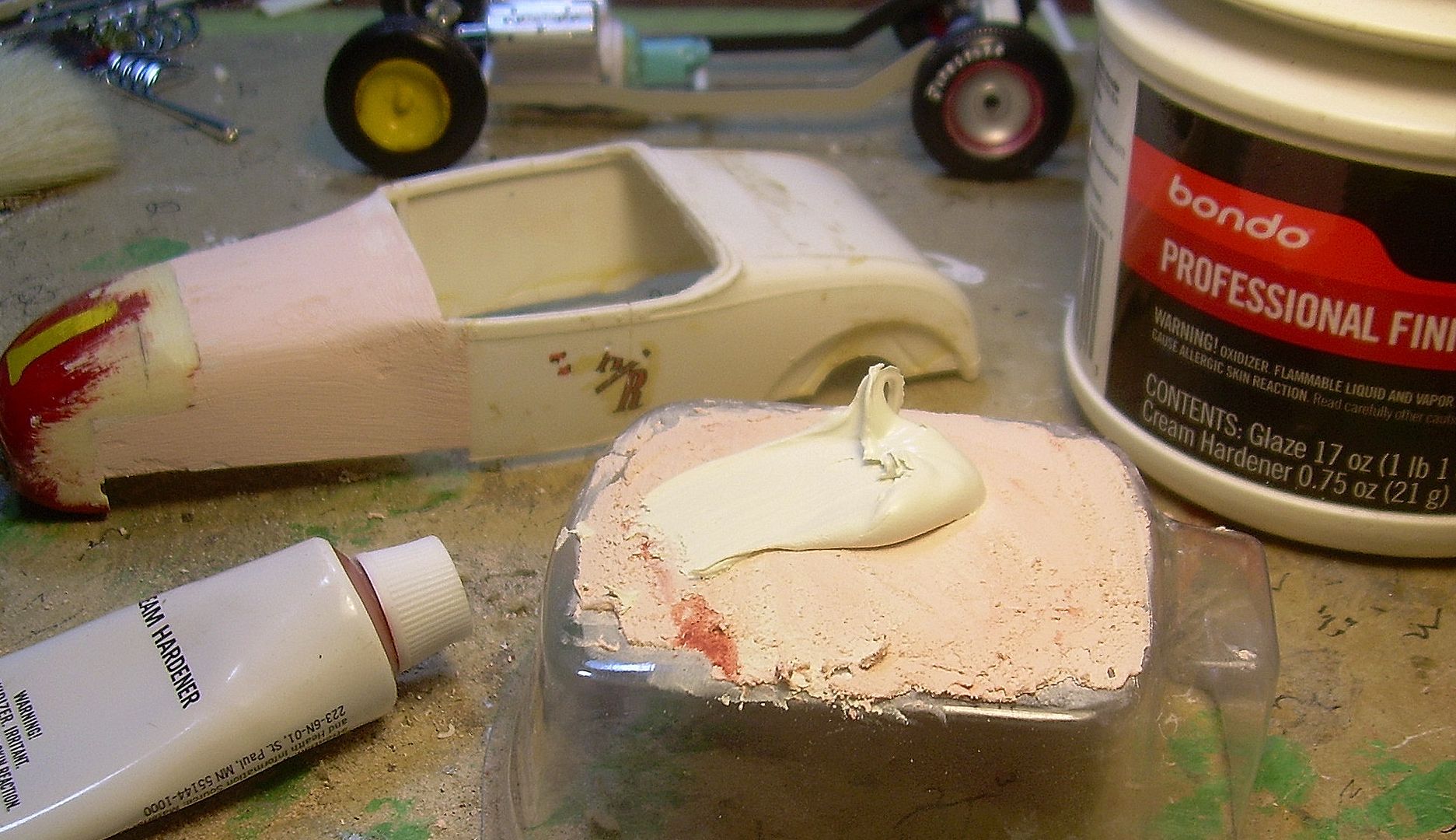

gary jackson Posted June 27 Share Posted June 27 so will regular two part bondo stick to sanded styrene Quote Link to comment Share on other sites More sharing options...
ctruss53 Posted June 27 Share Posted June 27 Yes. It actually works very well. But it is very stinky. So be prepared for that if you use it in your home. Quote Link to comment Share on other sites More sharing options...
redscampi Posted June 27 Share Posted June 27 I would guess so. It certainly sticks to everything else. Although it cures pretty hard and might be difficult to sand without damaging the styrene. Quote Link to comment Share on other sites More sharing options...
ctruss53 Posted June 27 Share Posted June 27 (edited) Here, I actually just started a fillers discussion yesterday. I came to the conclusion that a CA with some filler powder in it is worth a shot. Edited June 27 by ctruss53 Quote Link to comment Share on other sites More sharing options...
Ace-Garageguy Posted June 27 Share Posted June 27 (edited) 39 minutes ago, gary jackson said: so will regular two part bondo stick to sanded styrene Absolutely, yes, 100% IF you sand thoroughly and mix correctly. I sure as H. wouldn't put this much effort into something that didn't work. Edited June 27 by Ace-Garageguy 2 Quote Link to comment Share on other sites More sharing options...
peteski Posted June 27 Share Posted June 27 (edited) As I understand, Bondo is a polyester resin based body filler. It will adhere to polystyrene well. As for the small, I actually like that odor (in small and low-concentration quantities). Edited June 27 by peteski Quote Link to comment Share on other sites More sharing options...
