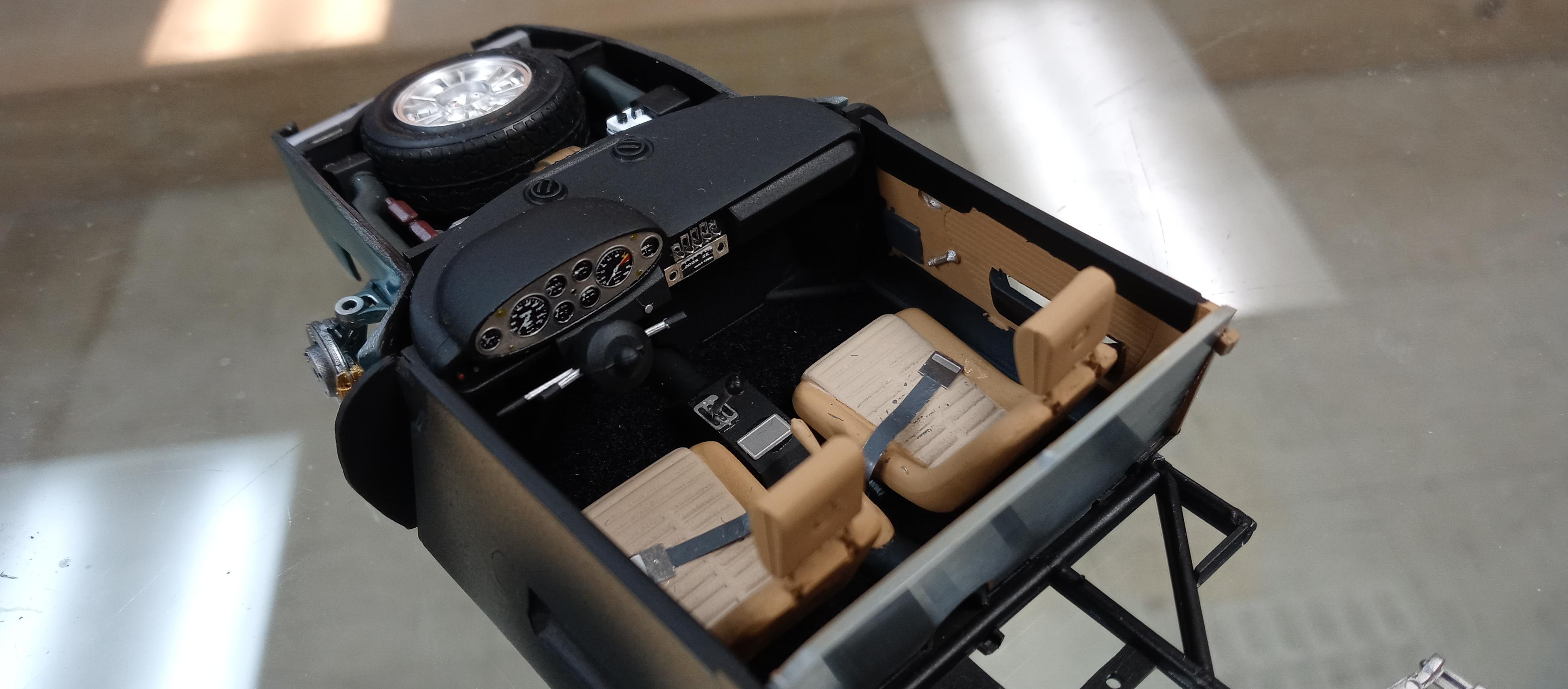

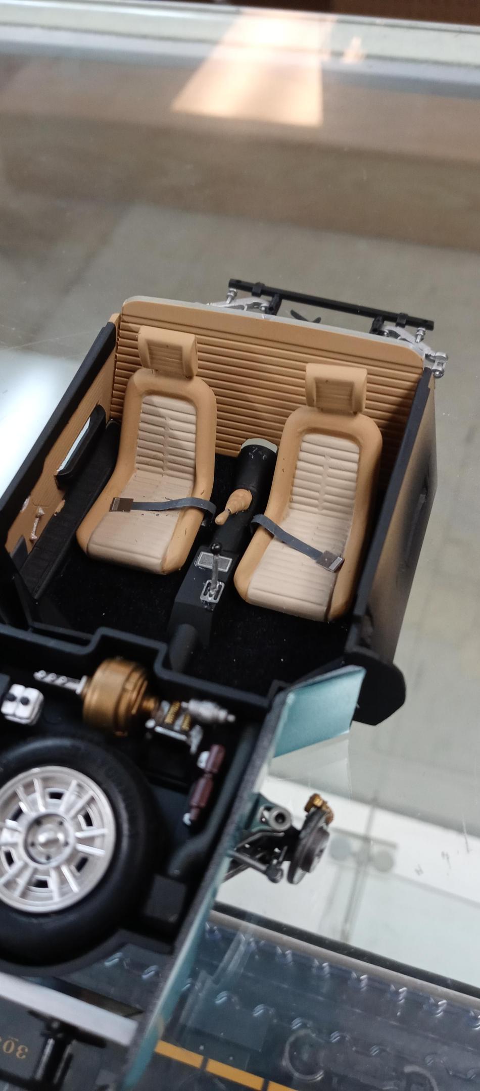

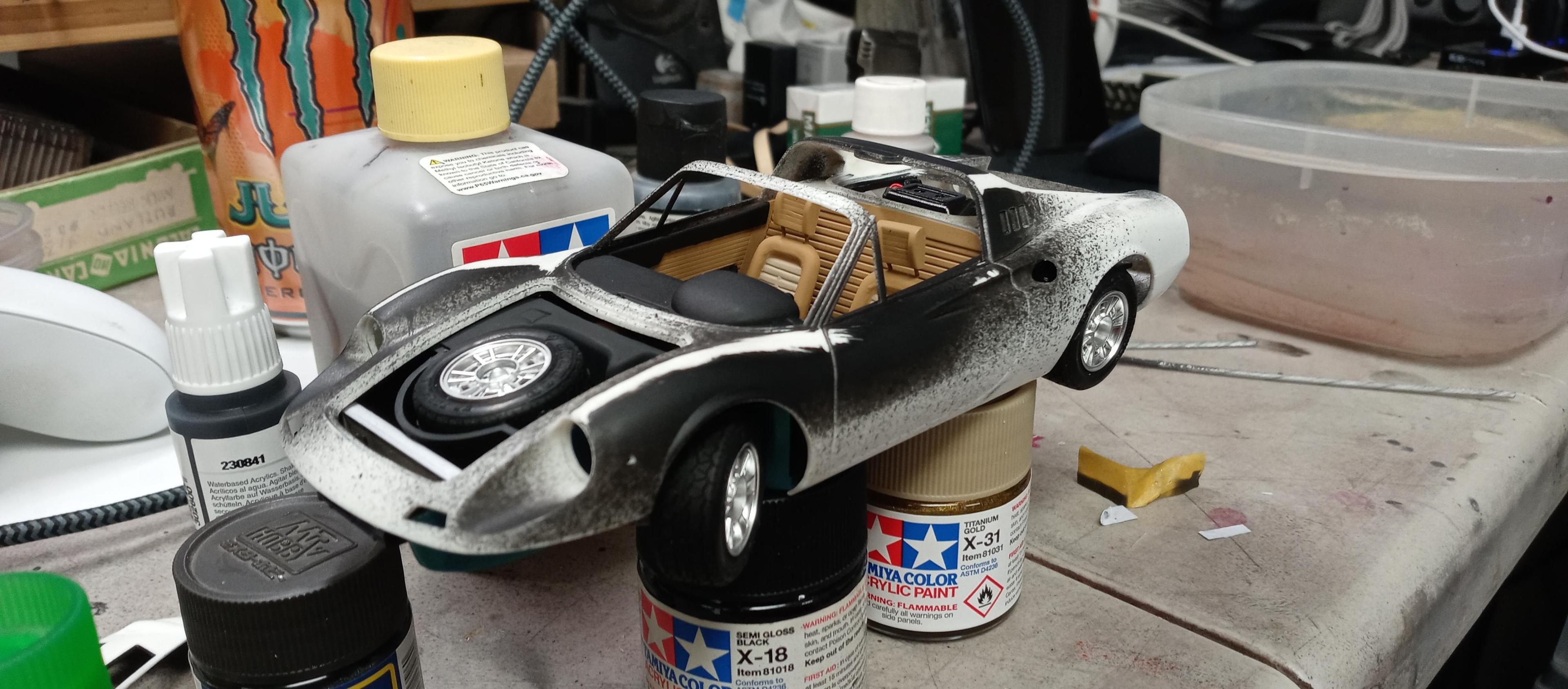

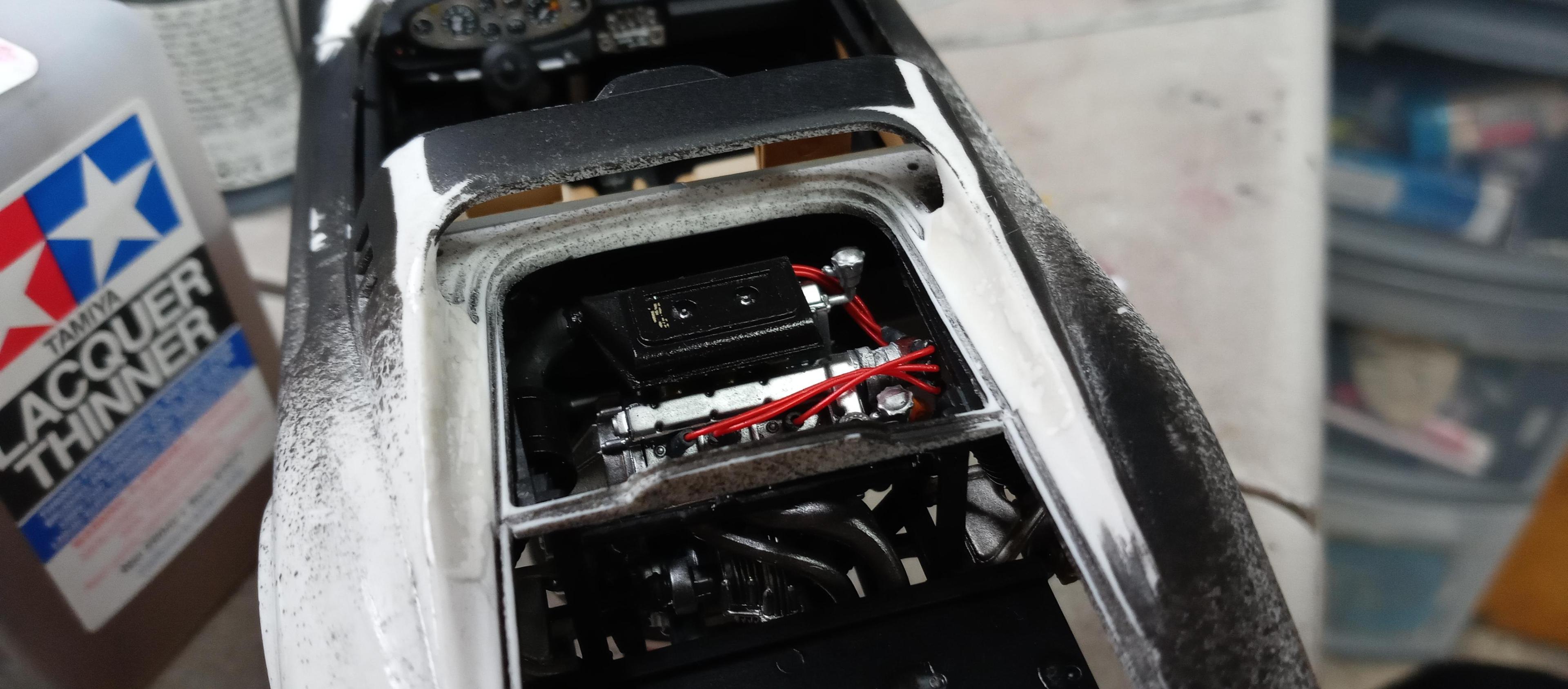

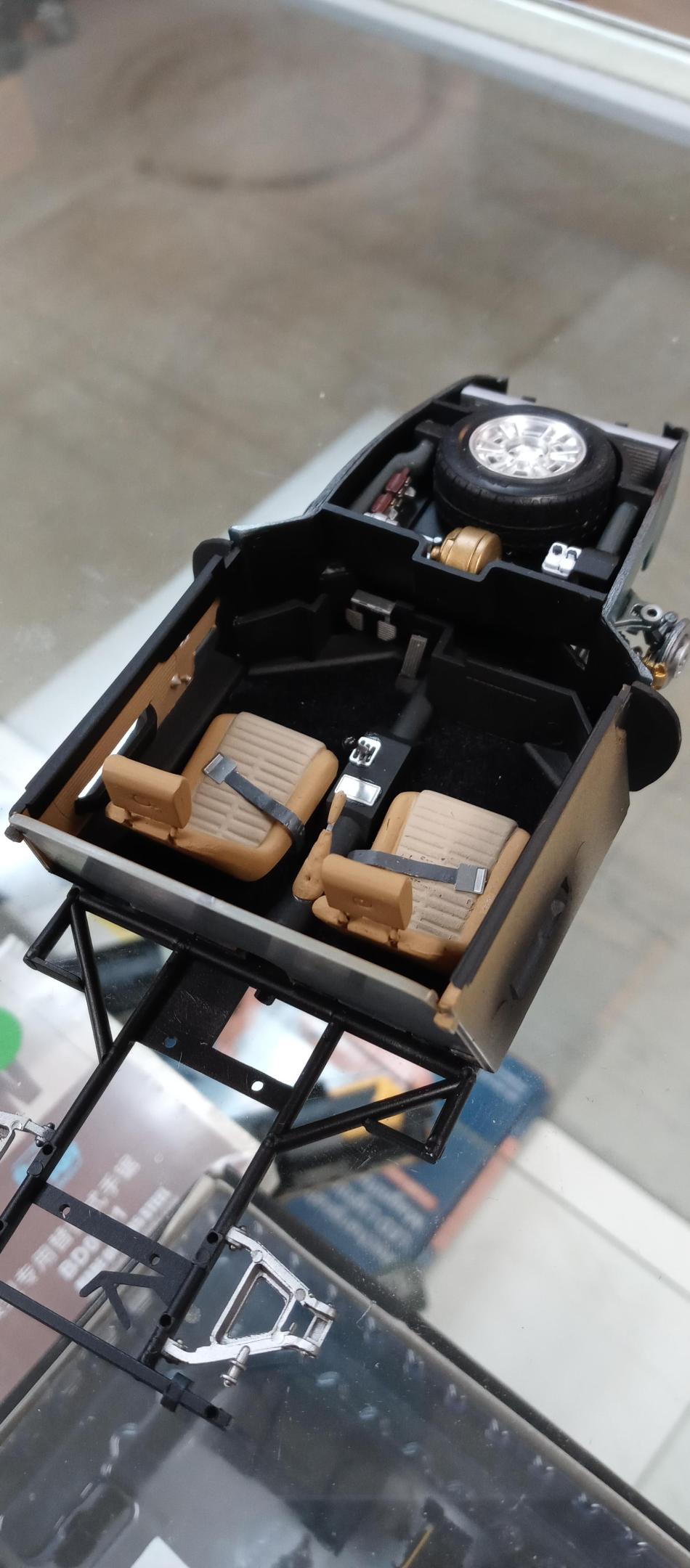

The interior is continuing right along for the Dino 246GTS. A combination of Mr Color Flat Black, Tamiya XF-59 Desert Yellow, and XF-57 Buff coupled with Ken's Fuzzi Fur black flocking for the carpets finished off what's already inherently a very nicely detailed kit interior. Next up will be the trickiest part of the kit; installing the driveline and assembling the rear framework and suspension.
  • Like 4

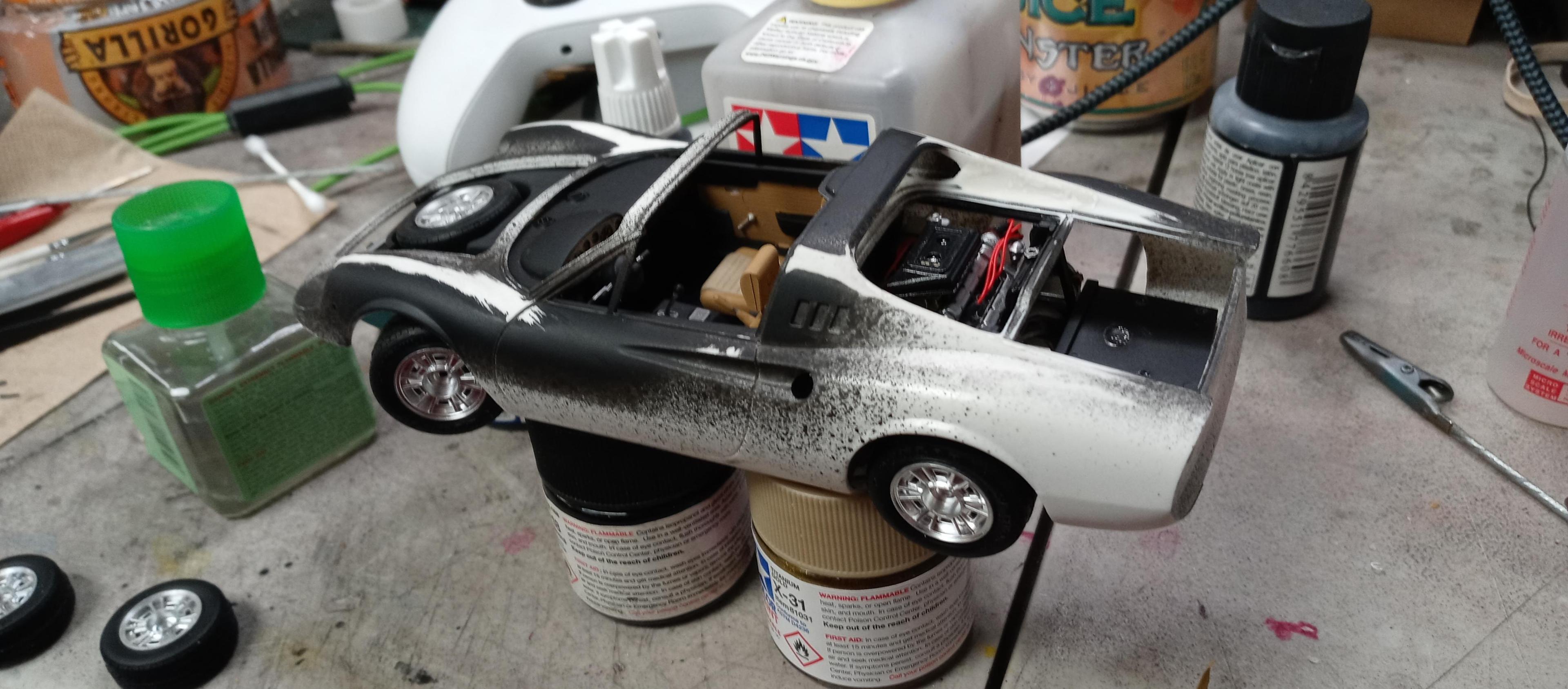

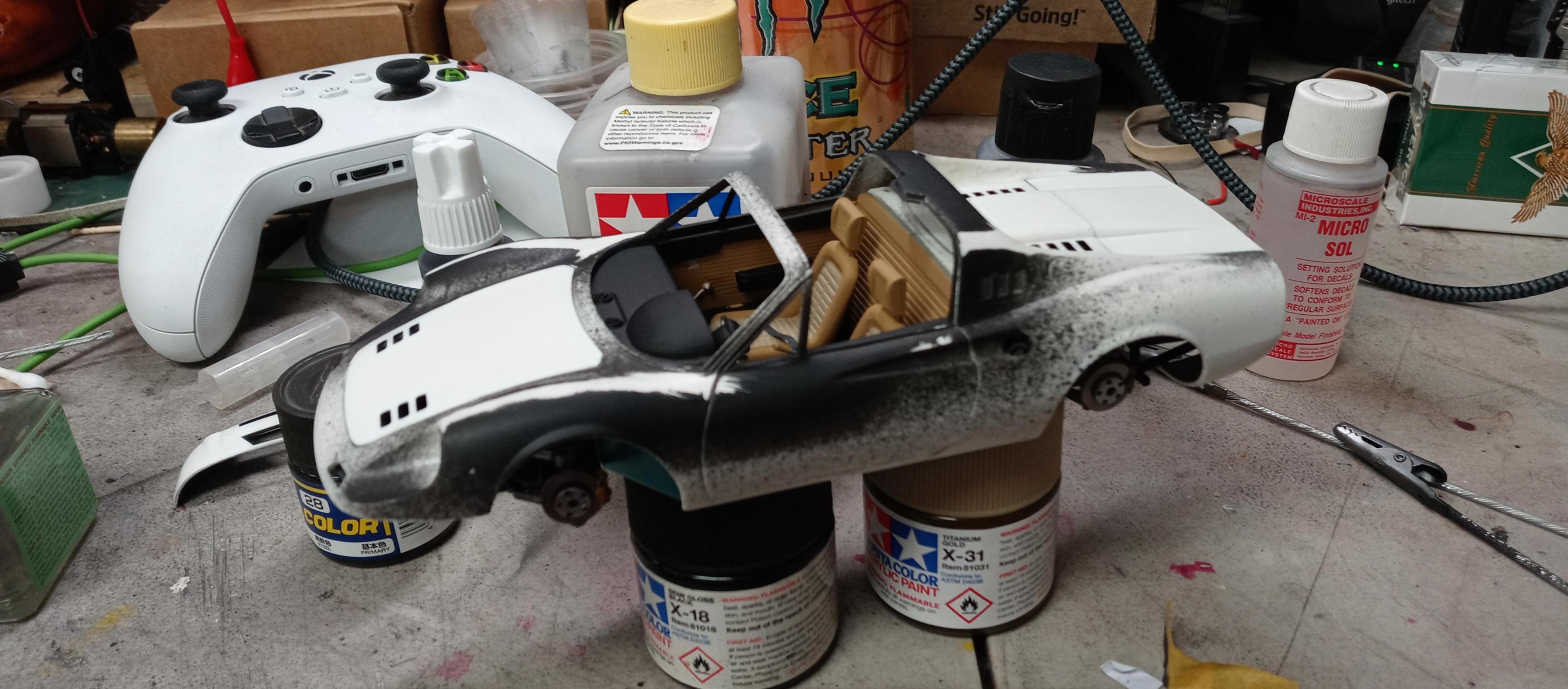

New update on the Dino. While they're not yet attached, the Dino is up on all four wheels and actually sits true. That alone is a relief. I've also begun addressing the bodywork with a few hits of flat black as a guide coat for some of the most prevalent mold lines plus the much feared buttress seam. It's really starting to come together now.

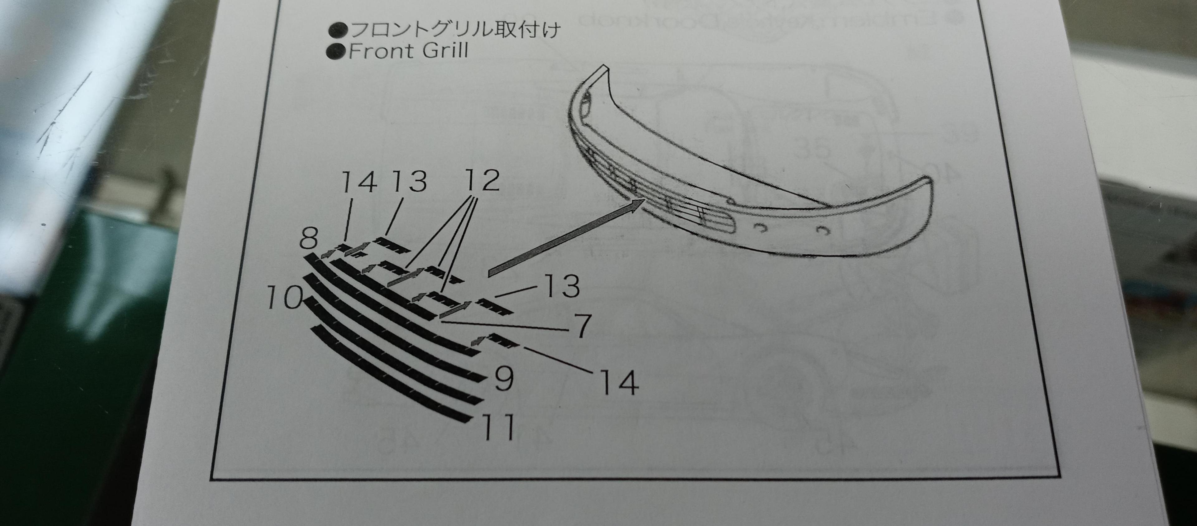

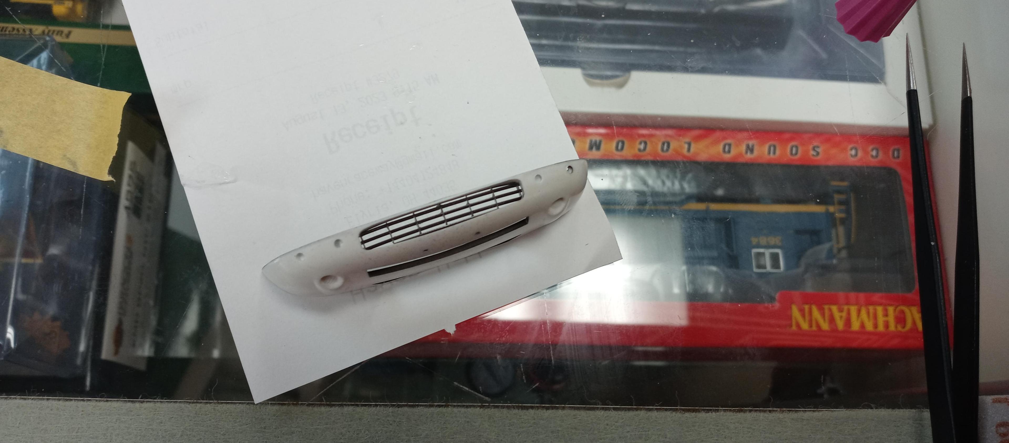

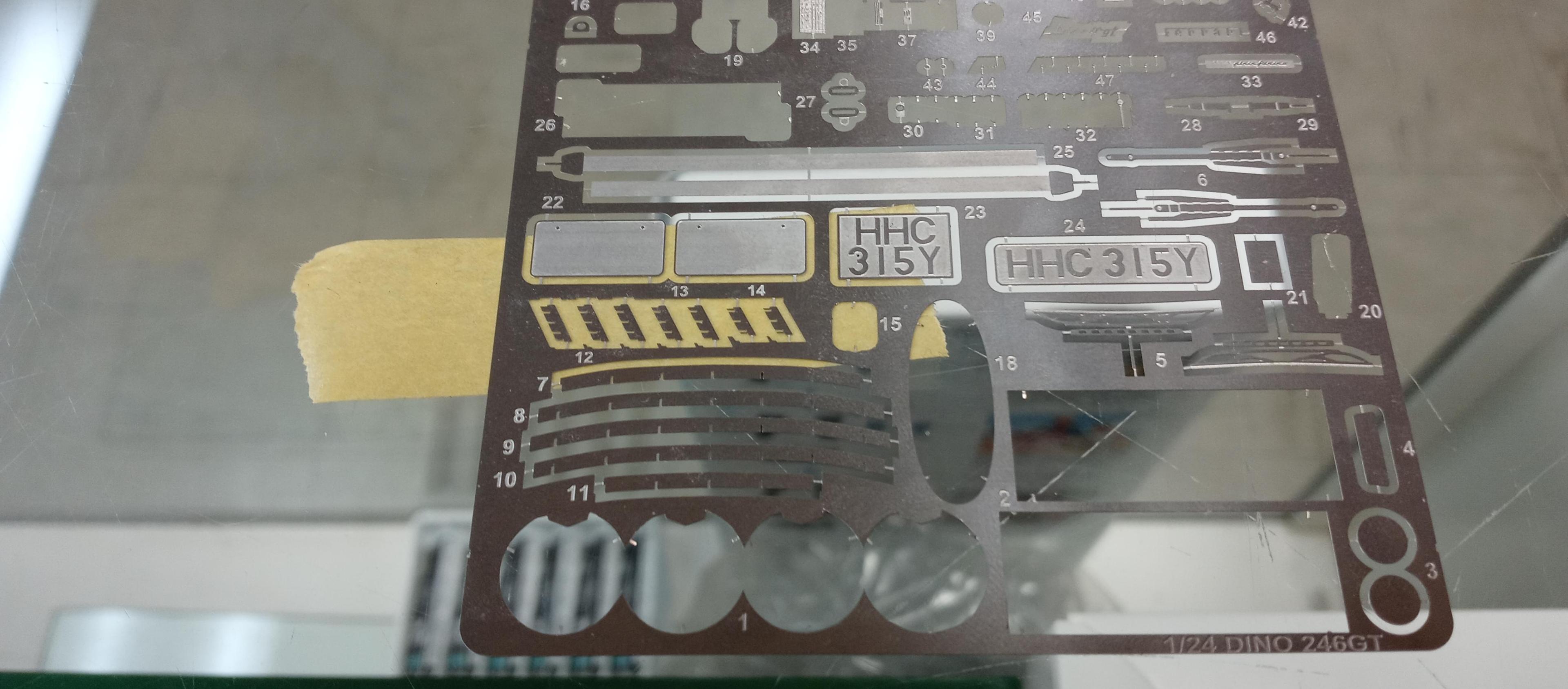

Small but critical update. I took the time last night to assemble the PE grille for the Dino. I will definitely say this, the fit for the Studio 27 set was MUCH better than the fit of the factory Gunze Sangyo parts on my 250GT SWB build.
  • Like 2
I like that grill!
With regards to the body, I found lots of sink marks to deal with on my kit, especially on the rear panel between the taillights.
  • Like 1
That PE looks fantastic. Something to keep in mind though, I believe the bumper is attached to the front end as one piece. I know there is a chrome trim that pretty much covers the seam but it might be worth puttying and smoothing over.
  • Like 1
There is indeed no seam between the lower valance and the upper works of the nose. My plan is to fill the gap with CA - specifically AK Interactive Black Widow CA - which will also strengthen the joint which will be put under considerable strain when it's finally time to push the chassis into the body permanently.

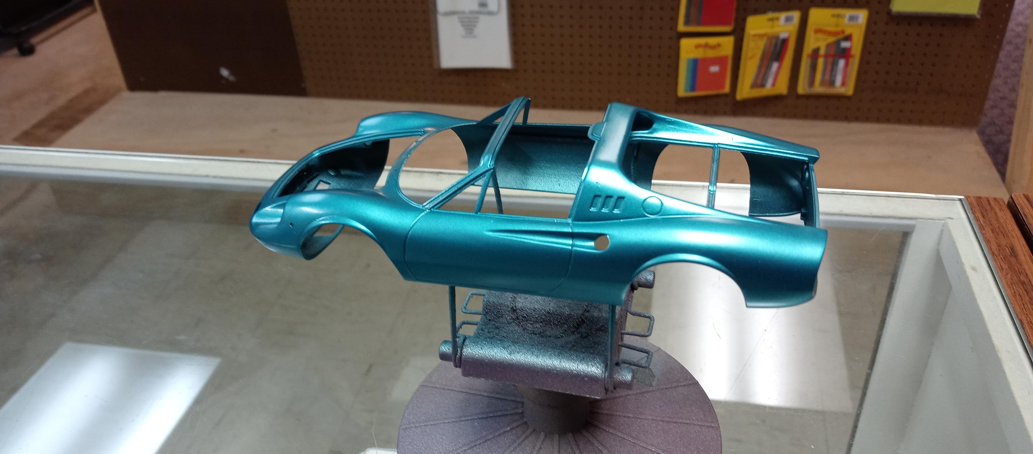

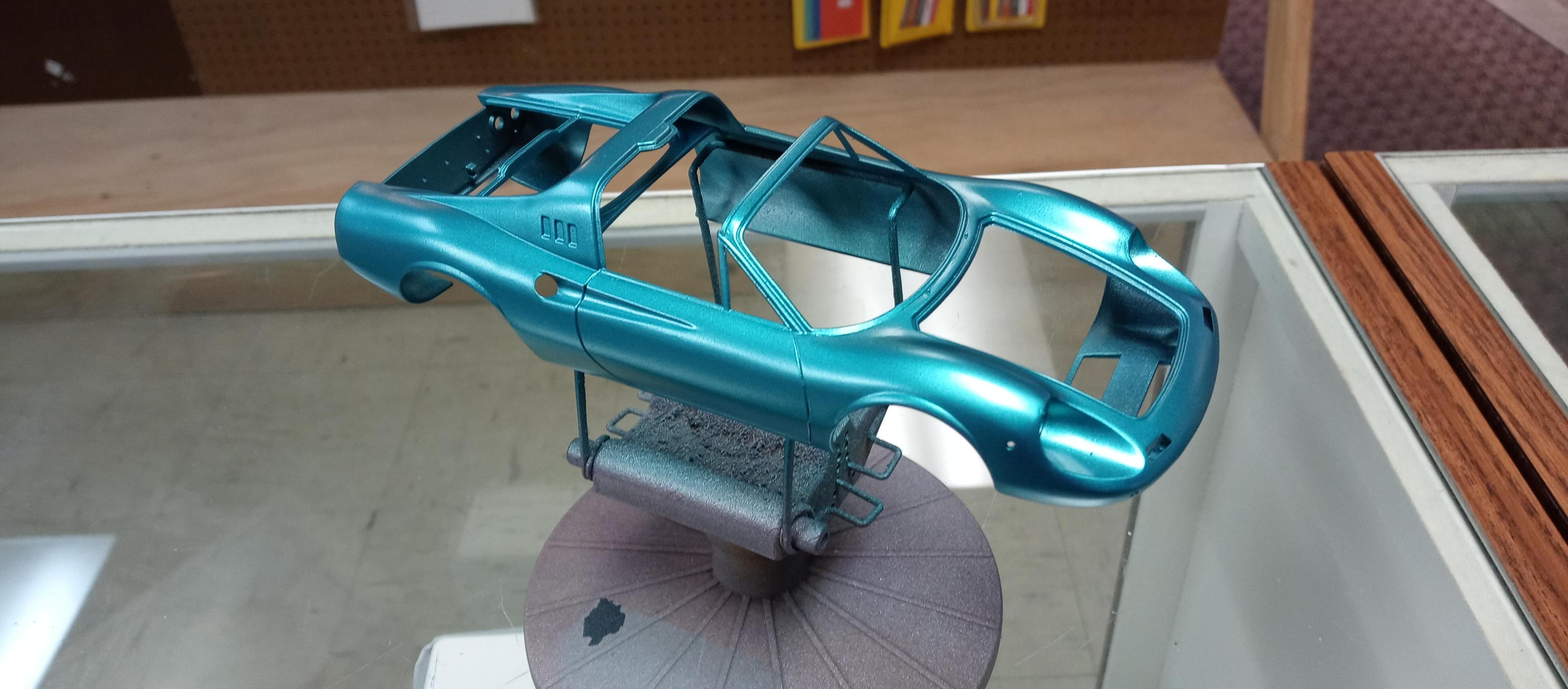

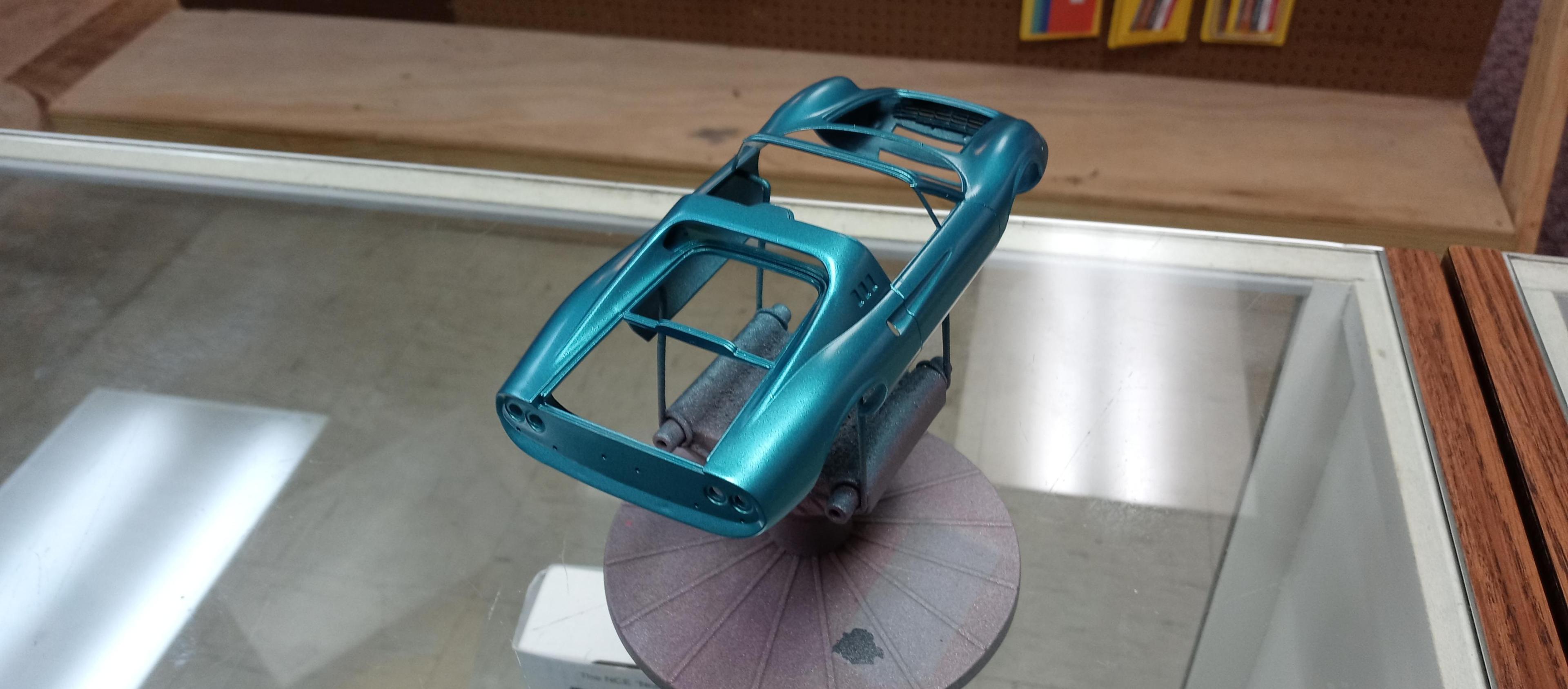

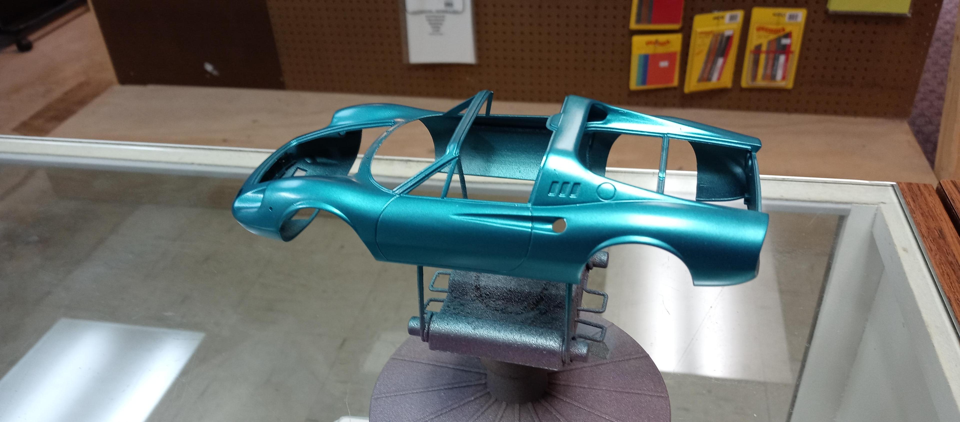

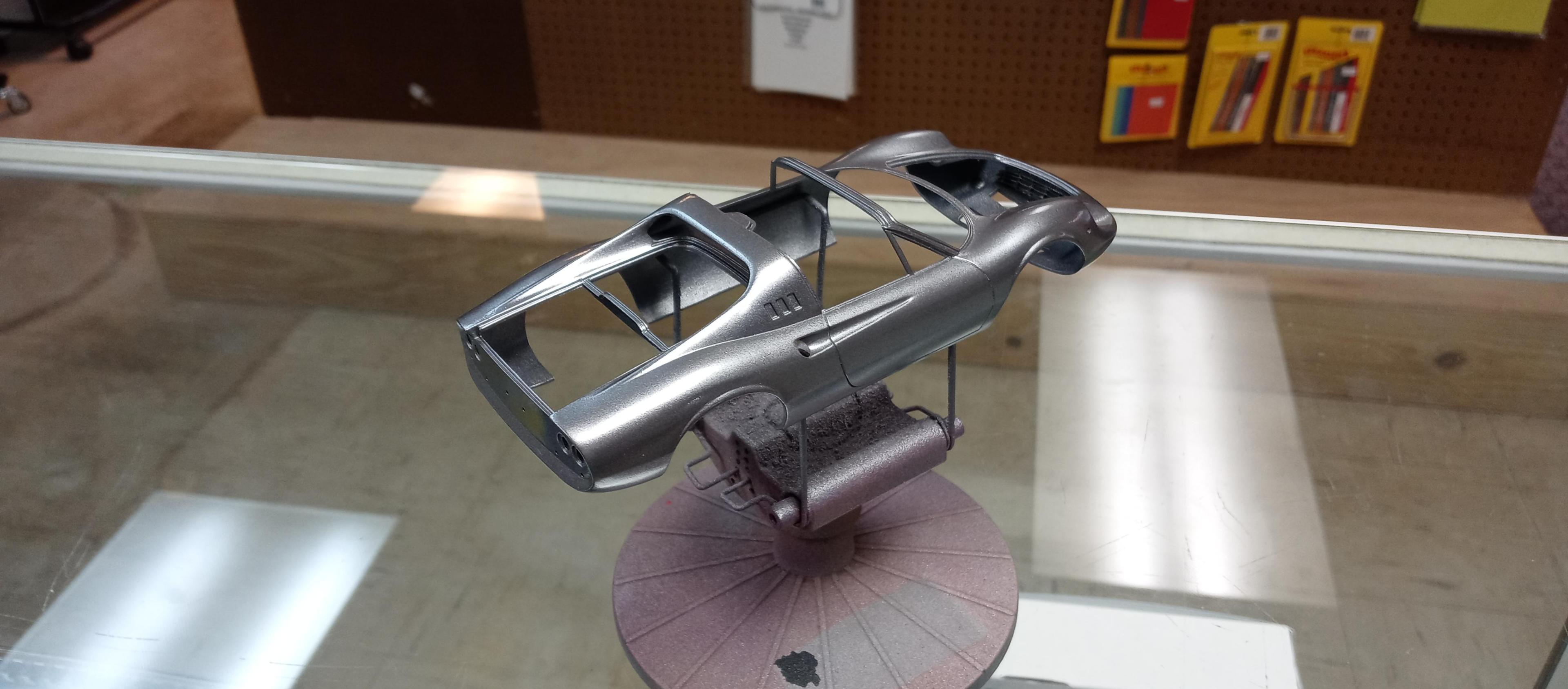

Big moment for the build of my Fujimi 1/24 Dino 246GTS Spyder. After laying down a basecoat of Tamiya TS-42 Light Gunmetal, I finally airbrushed the color coat of Gunze Mr Color C57 Metallic Blue Green, giving me the Pino Verde that I wanted for this build. I'm seriously pleased with how the color turned out!
Justin...gorgeous color!
I think this thread is fascinating as I do not recall seeing the Fujimi Enthusiast series kits previously being presented in a build thread done in this level of detail.  And as someone who appreciates seeing paint detailing used to enhance kit-based builds, I find your efforts here to be of great interest.
Finally, seeing you do this level of work, for me, greatly enhances the credibility of your posts on new kits in the kit review section, and personally I do not know of any other hobby shop owners who are capable of achieving this level of results from automotive model kits.
Best of luck on finishing this one up and keep up the great work!  TIM

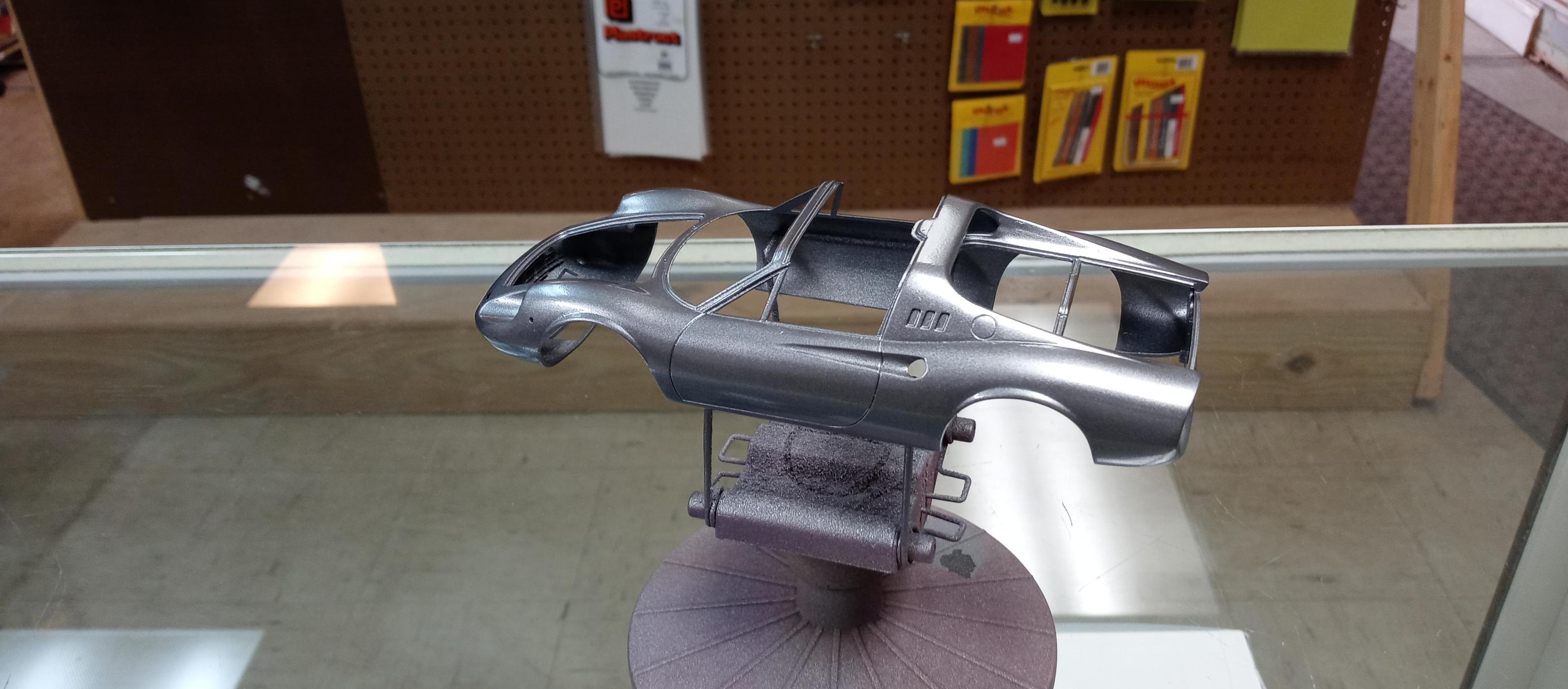

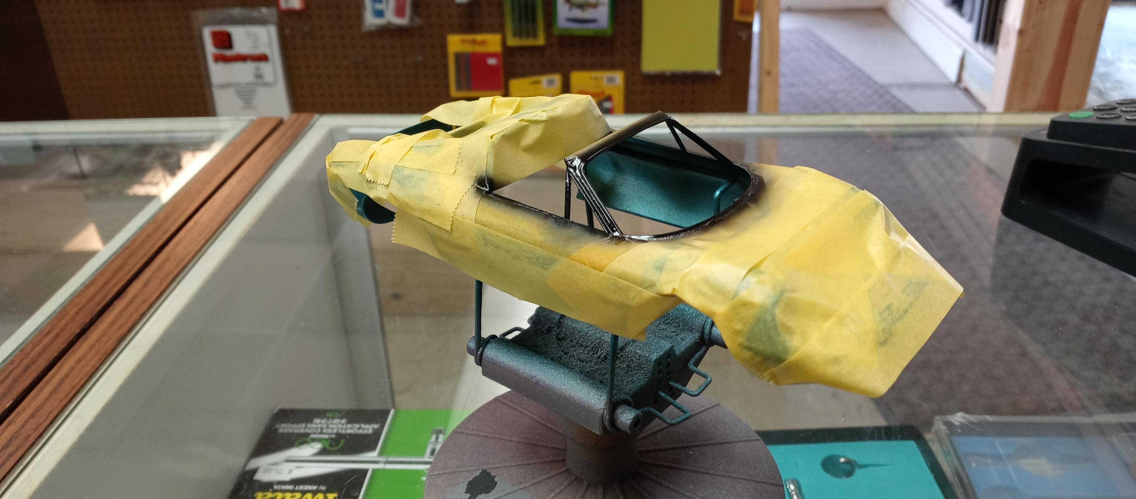

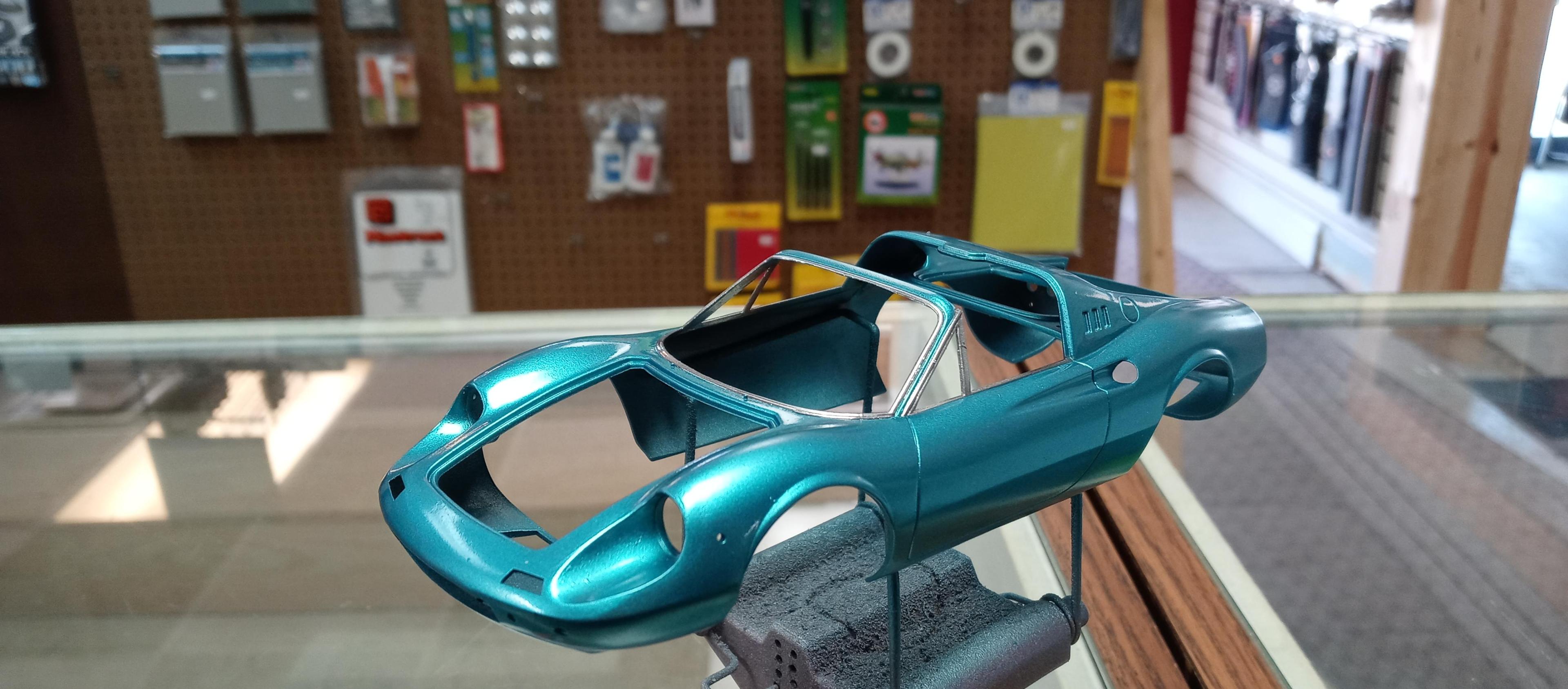

Very small but fun update on the Dino. First, I gave it its clearcoat. I decided to go with Alclad Aqua Gloss which I've had good luck with in the past and it really seems to have drawn out the shine here. Secondly, a quick spate of masking, and a hit of AK Extreme Metal Chrome gave me the window and windshield trim. Also, while not pictured, the windshield in the kit was pretty hazy - which I blame Testors for - so it got a quick polish with Novus to knock out most of the cloudiness.

Looks very good so far, but why appears the windshieldframe black on the second photo? Is this a primer?
Yes it is, or more specifically a gloss black basecoat for the AK. It's a similar paint to Alclad except enamel based rather than alcohol like Alclad. I tend to use it more often than Alclad because I find it a bit more durable and I like the tones of their various metal shades.
