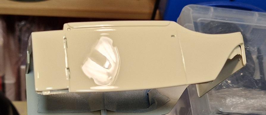

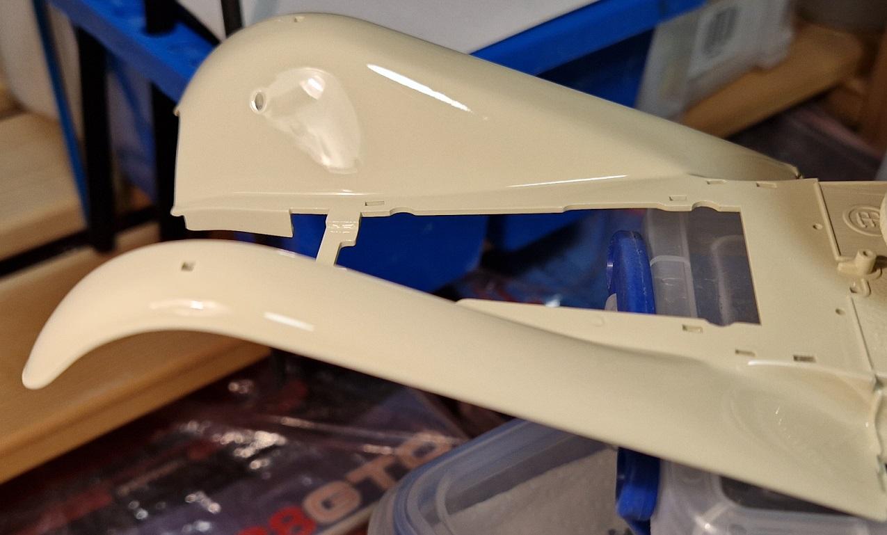

Funkychiken Posted July 23, 2023 Author Posted July 23, 2023 I've stipped all the chrome from the kit, and there was a lot of it! lots of awkward sink marks like these to deal with

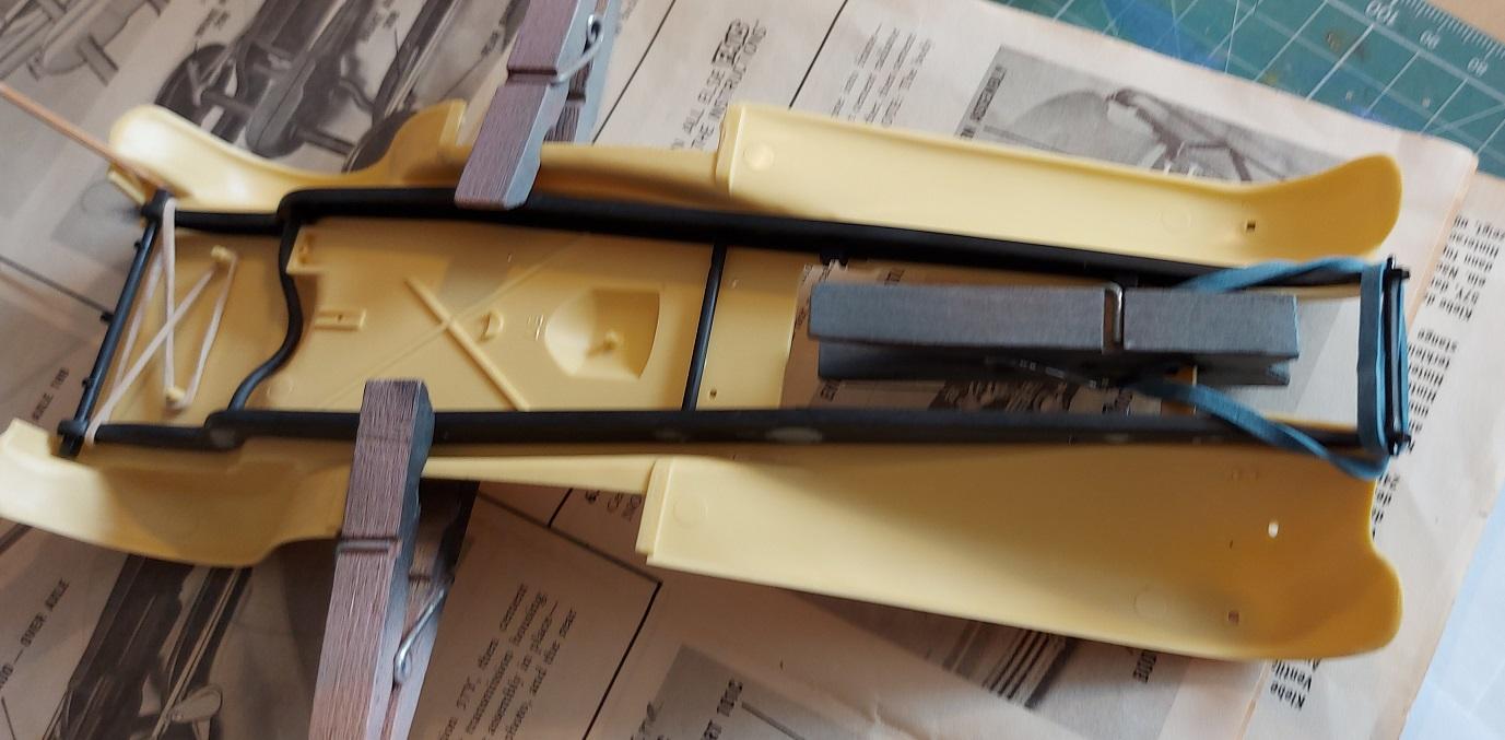

Funkychiken Posted July 23, 2023 Author Posted July 23, 2023 Chassis was assembled using the body as a jig, its not got great attachment points for the cross members, so I did this pre-painting to ensure I stood half a chance of a strait and square chassis

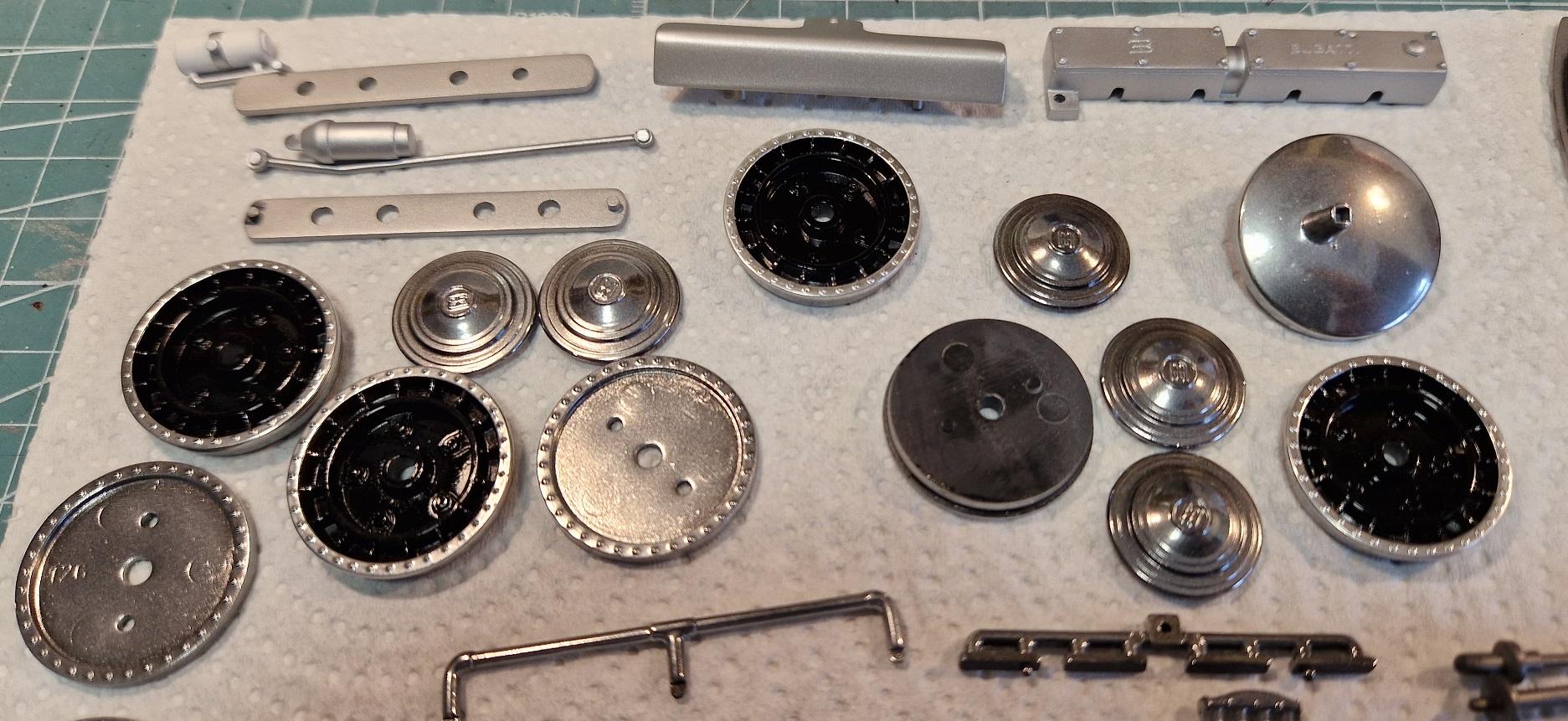

Funkychiken Posted July 23, 2023 Author Posted July 23, 2023 Wheels were stripped of chrome, I used Zero 1k clear over Zero black & the silver trim is actually Alclad II chome - just too many layers of it. I wanted a more silvery look as there is so much chome on the car it would all look the same...

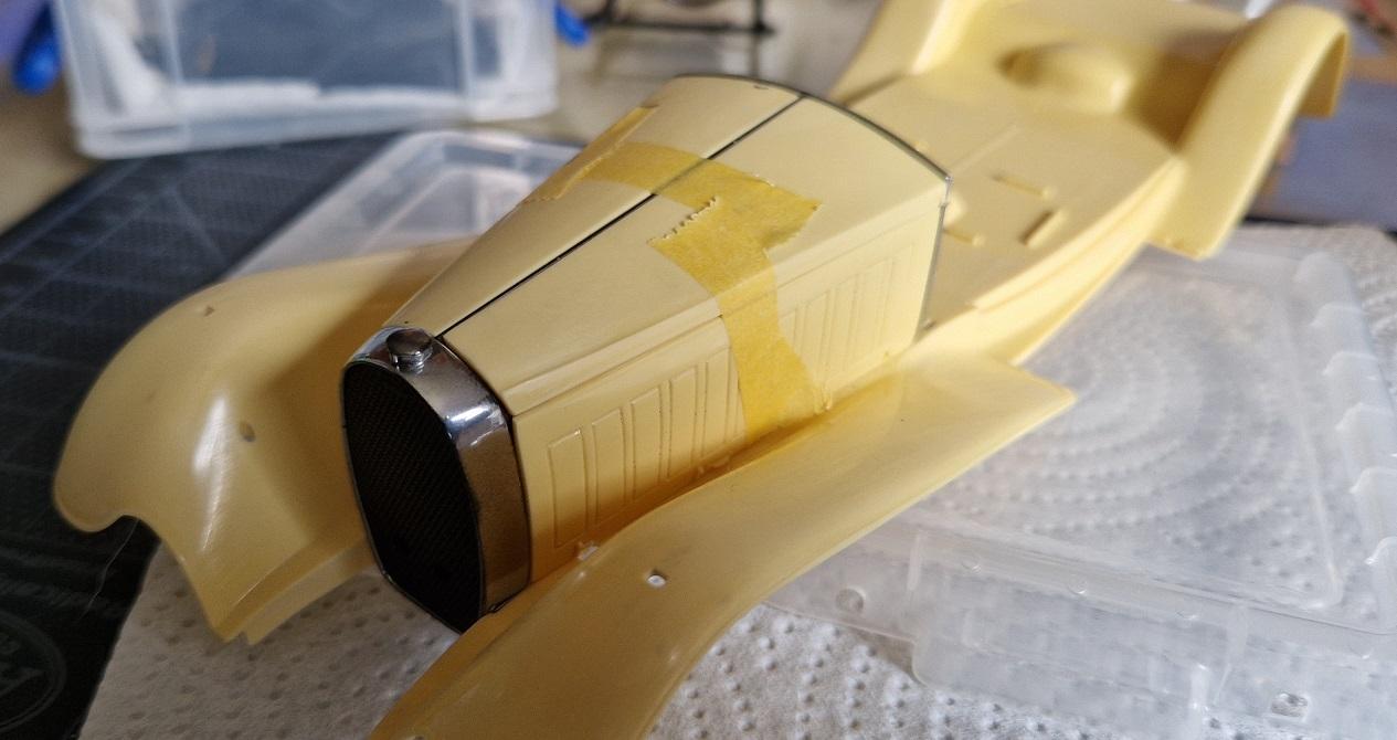

Funkychiken Posted July 26, 2023 Author Posted July 26, 2023 I used the body again as a jig to pre-assemble the 2 bits for each of the Left & Right sides of the engine cover. I had wanted to put a piano hinge on it, but that would have been too much hassle and beyond my skill set, so thats why I added the magnets. the fitmets points are not great, without doing this, it would be wonky

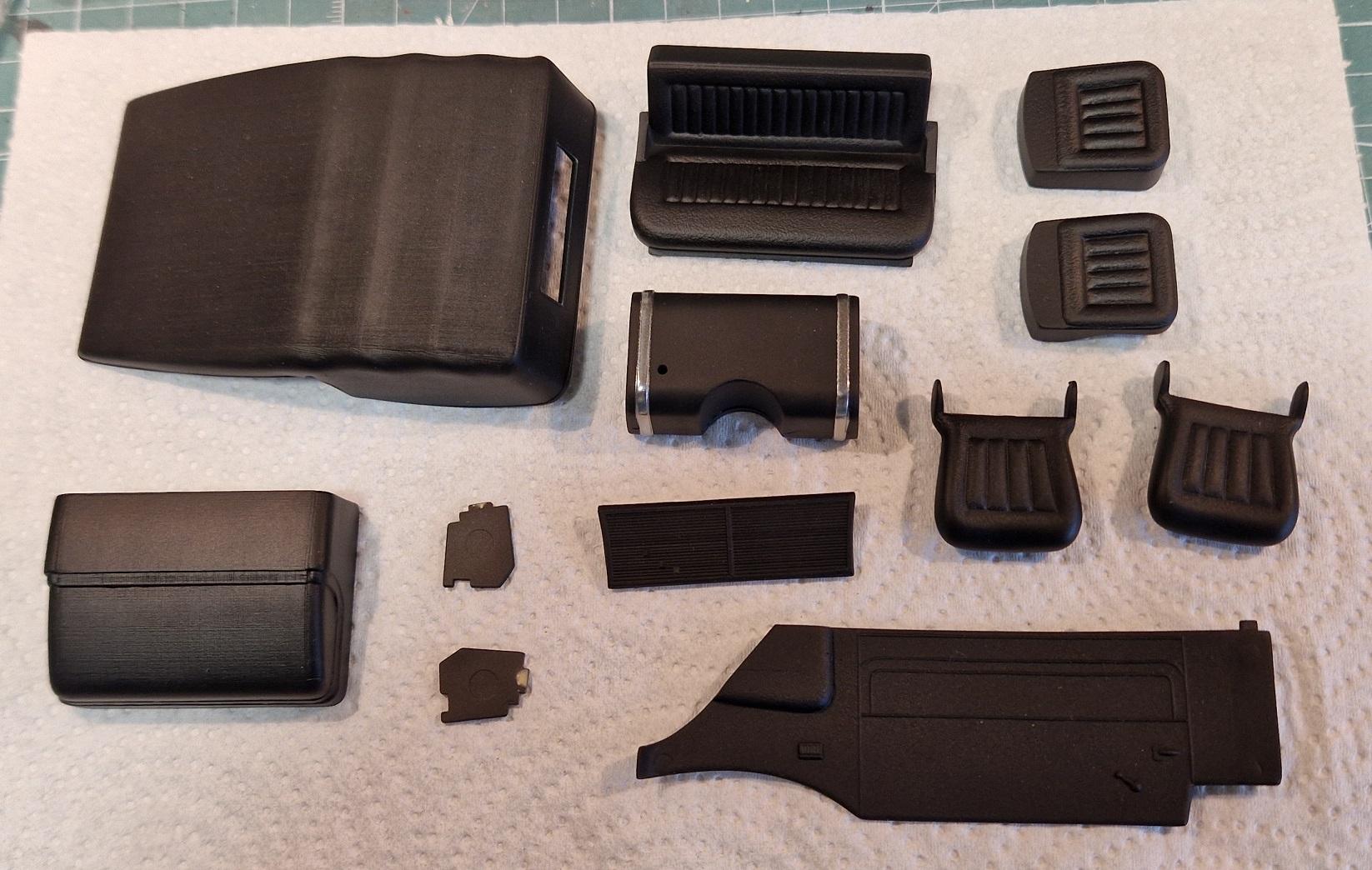

Funkychiken Posted July 28, 2023 Author Posted July 28, 2023 I was on a roll a few weeks ago I clear coated my Mustang with Zero 2K, it came out fairly good. With that one I used 50% Mr Levelling thinner for the thinner part. For this one, I thought I'd try and use 100% thinner for the thinner part of the mix. It turned out great. the smoothest finish I've had so far. Biggest problem was dust - and this may have something to do with the retarder in the thinner. It's going to take a lot to sand out the bits of dust, so I'm going to focus next on the chassis and engine. 1

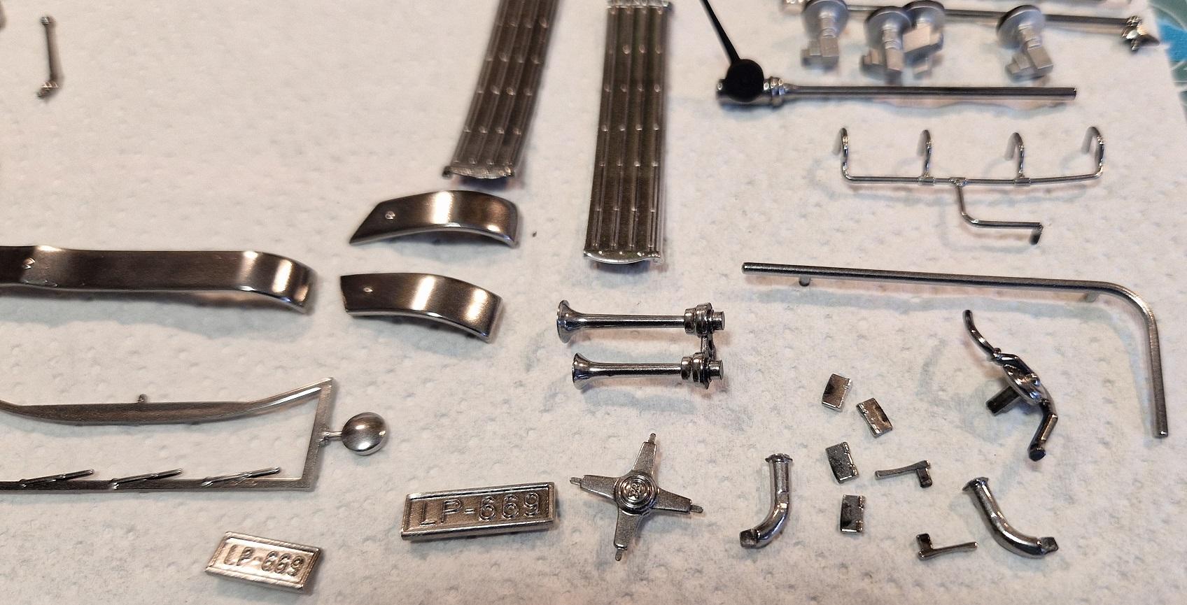

Funkychiken Posted July 30, 2023 Author Posted July 30, 2023 Nearly everything is painted now, only really started to build little bits - like the dash. This week i'll focus on the engine and chassis, then probably have to go to sanding and polishing the coachwork. As said before, everything that was chromed was stripped using Dot3, then the black stuff was finished with Tamiya Semi-gloss. the chrome is with Tamiya semi gloss as a base, then Zero 1K Clear & alclad II chrome light misting. I have noticed that the Alclad II does not grab very well onto Zero 2K clear, so some bits have to be re-done. Other metalic colours are Alclad II Aluminium and Tamiya Titanium, a bit of white in there too...

Bugatti Fan Posted July 31, 2023 Posted July 31, 2023 (edited) Atin. Now that the chrome has been removed from the engine block will you be removing the moulded on plug leads and replacing with wire? The plated parts that have been stripped and redone with Alclad look much better. I have this kit and the chrome is very heavy looking on it. Alex. Some would say that what you did with this kit was sacrilege! But building kits should be fun first and foremost, and your 'off the wall' build with those wheels make it look a real mean machine! Edited July 31, 2023 by Bugatti Fan
