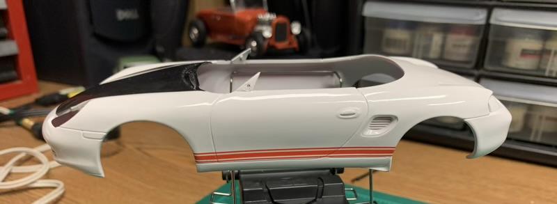

atomicholiday Posted July 26, 2023 Share Posted July 26, 2023 I’m having problems with these decals. What’s odd is that I didn’t do anything different than what I’ve done several times in the past. Here’s exactly what I did. These decals are from the AMT Mercury Comet Cyclone kit, dated 1993. First, dipped the decals in water for about 10 seconds and then set them on a paper towel to soak until they released from the backing. While that’s happening, I applied Micro Set to the area on the body where I wanted the decal. Then I applied the decal like normal. They laid down great. No issues whatsoever other than not sinking down into the panel lines. This was expected. I waited until the next day to do anything about that, and they still looked great 24 hours later. Then I put Micro Sol on them to get them to lay down into the panel lines. As expected, the decals wrinkled. No problem, that’s normal too, right? I left them alone for another 24 hours. The next day they were still wrinkled. So I put more Micro Sol on them and let them set again. No chance. Still wrinkled. When this didn’t work I tried Mr. Hobby Mr Mark Softer. It’s supposed to be a little stronger than Micro Sol. It actually made things worse. The last thing I tried (and I didn’t really expect it to work) was to brush on a coat of Mr Hobby Mr Mark Setter. No change. It should be noted that there was nothing unusual about the paint. Just plain old Tamiya lacquer, not even polished yet. Any suggestions? Or am I just out of luck? Here’s the before and after. Quote Link to comment Share on other sites More sharing options...

atomicholiday Posted July 26, 2023 Author Share Posted July 26, 2023 Thanks for the replies gentlemen. Interesting. I’ve done this several times in the past without incident. This is the first time it has caused me any problems. That being said, are these decals salvageable? I’m open to suggestions. They feel pretty thick and are still in good condition other than being wrinkly. Quote Link to comment Share on other sites More sharing options...
atomicholiday Posted July 27, 2023 Author Share Posted July 27, 2023 Problem solved. Sort of… I gave up on the black decals. There was a set of red in the same kit I got them from, so red it shall be. I did everything in one sitting this time, and the results are better. But still not perfect. There are still some very tiny wrinkles if you look close enough. I’m wondering if the decals were bad or starting to go bad. Never had this much trouble before.🤔 They looked great, but I got them used, so who knows. Anyway, wrinkles or not, I’m calling it good enough. Quote Link to comment Share on other sites More sharing options...

atomicholiday Posted July 27, 2023 Author Share Posted July 27, 2023 Thanks for the tip Rich. I might very well use that sometime. I’m going to leave this one as is. Interestingly enough, red striping was my original concept for the car. But I changed my mind at the last minute and went with black. Now that it’s done, I like the red. So it all worked out. Maybe black stripes weren’t meant to be.👍 Quote Link to comment Share on other sites More sharing options...
