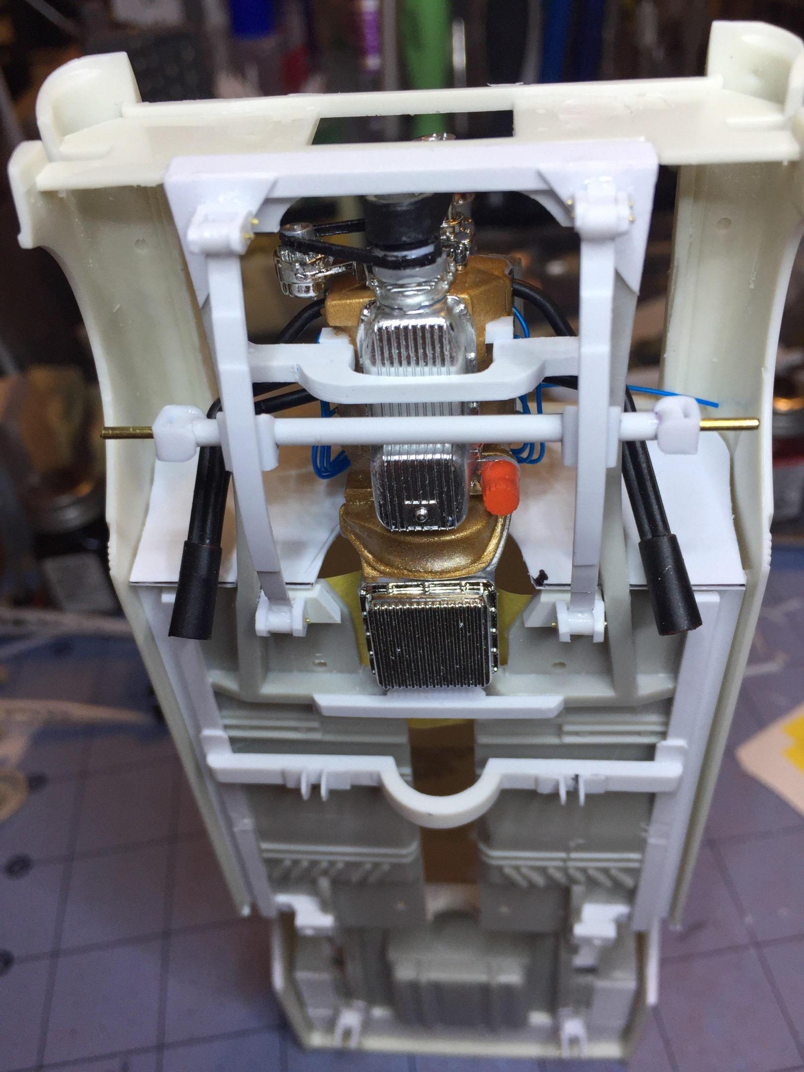

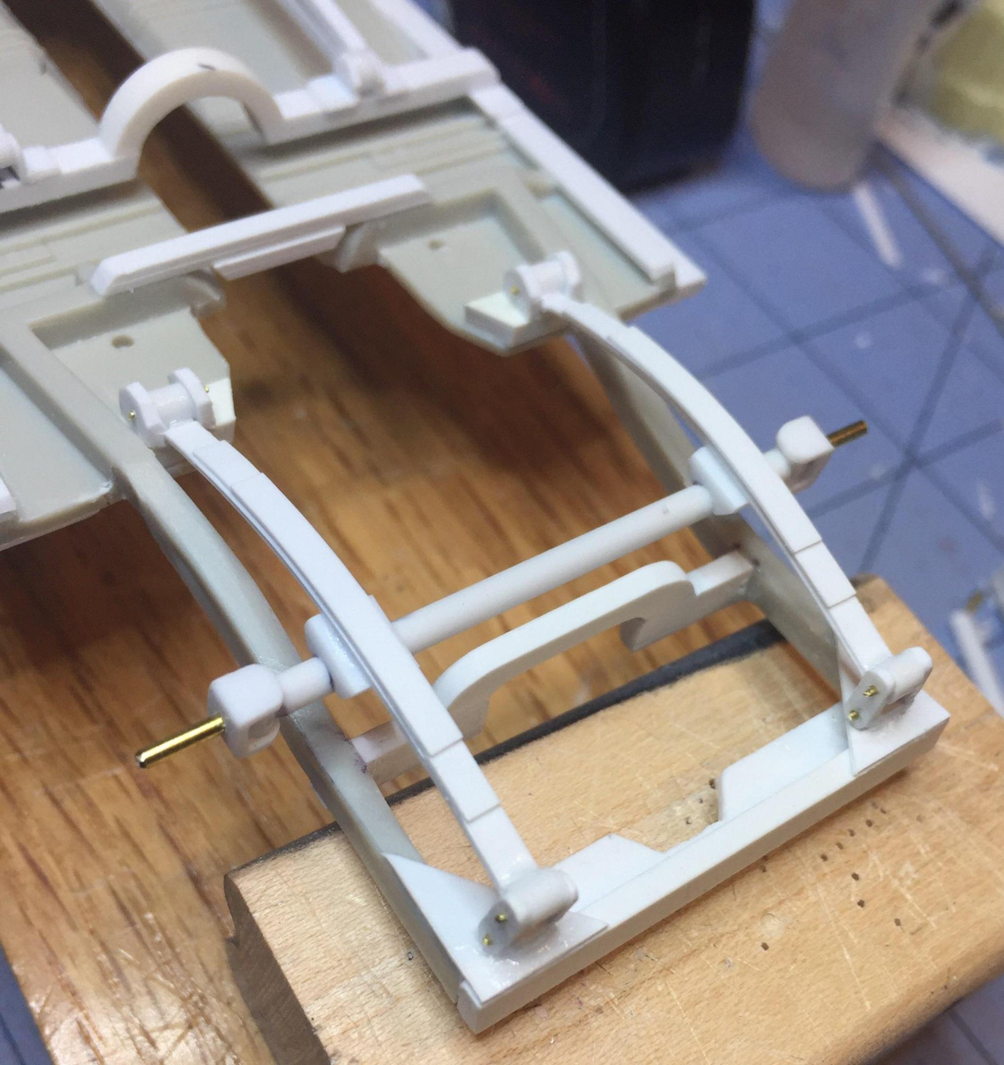

Here's a mock-up.  Axle and engine mount/crossmember.  I will have more later, Google willing ?

A few more progress pix. Still some details to clean up yet but I've got to start thinking about the firewall and some engine bay stuff. I need to hook up a steering box and all that linkage.  I need a radiator and electric fan set-up and a Moon tank mounting idea (gotta have a Moon tank, right?) Also the interior, roll cage, seating, etc. Thanks for looking.

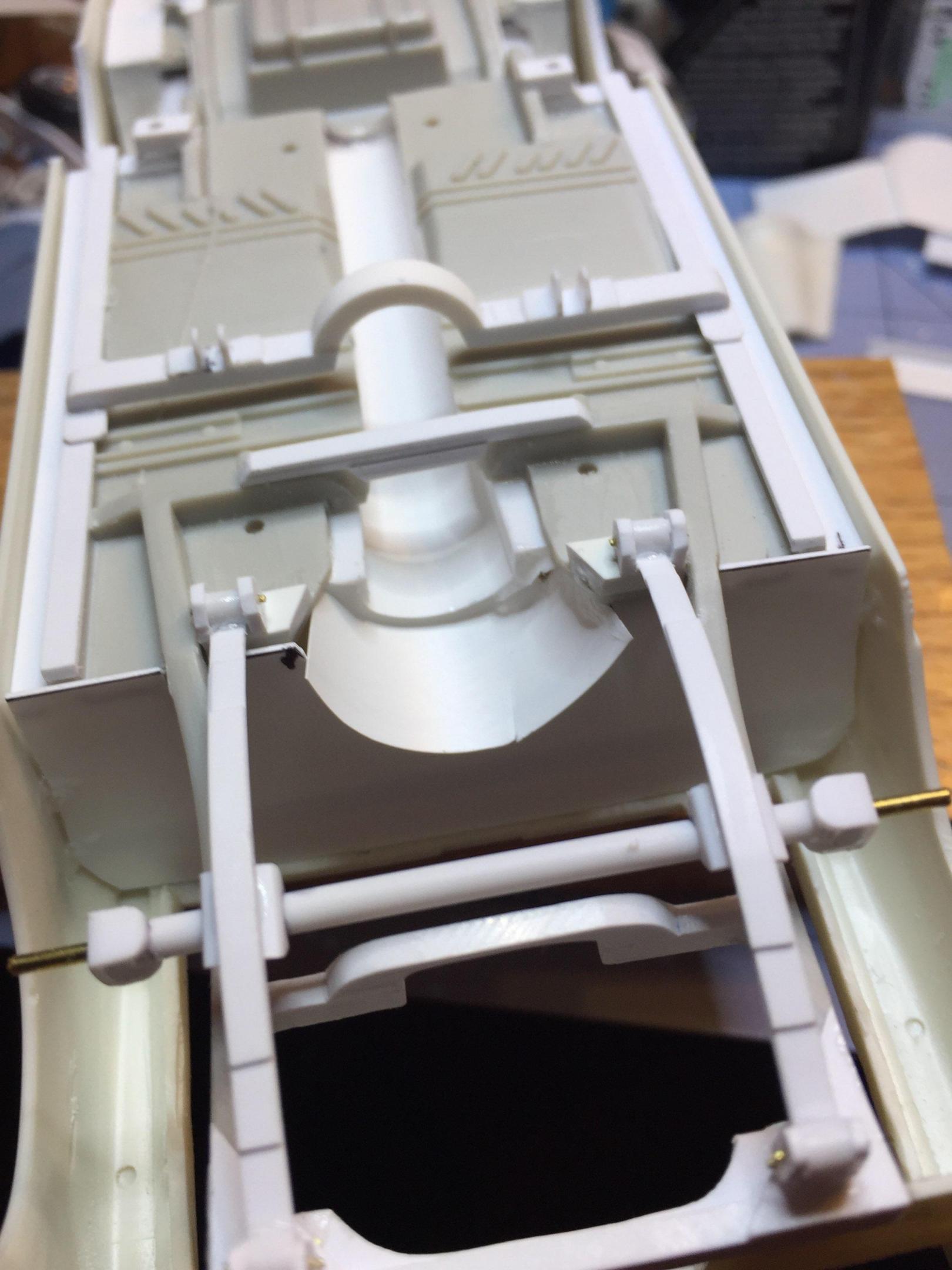

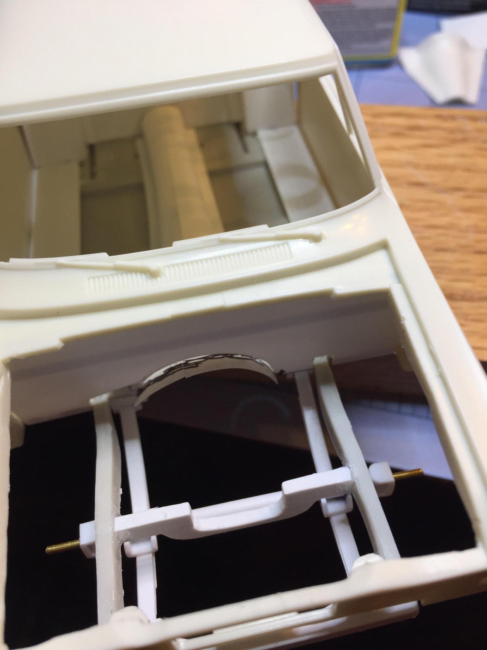

 Moving right along....I started on the firewall, first in card stock (we have a $h1T-ton of that  around here) and then in .020 styrene. I have some .040, which would be more appropriate for this but .020 is much easier to work with (cut it with scissors). I braced it with some strip to stiffen it and give it a possible attachment point for whatever. I found a chassis in my junk yard with a nice big tyranny tunnel (no, not that kind) so I cut it out and it will be included, I hope, to set up a driveshaft tunnel, which is next. Im going with .005, which can be curled like ribbon. Gonna try it, anyway. But not tonight unless I can't sleep. ?
Making a template
Now plastic. The fitting process is tedious and repetitive.
 I'm going for a very slight over-hang where the firewall and floorboard meet. When I resume work, I will tack the firewall to the body and do a full test fit and, if I've got it, run a bead and zip-kick it. Below is the transmission tunnel stolen from Dirty Donnie's Dodge. It will need some work to get a tight fit with the firewall.

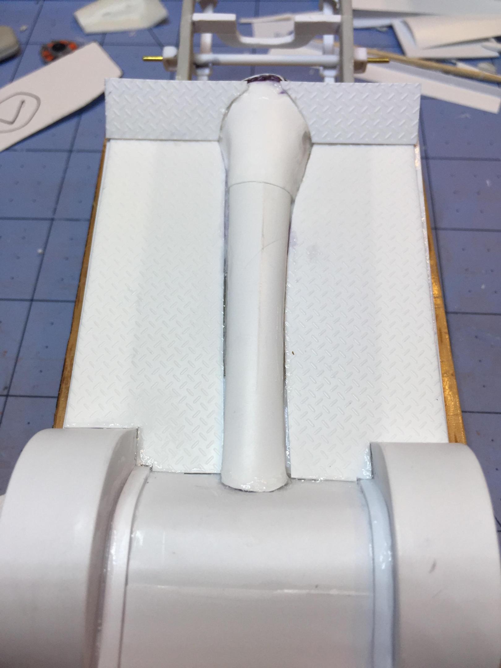

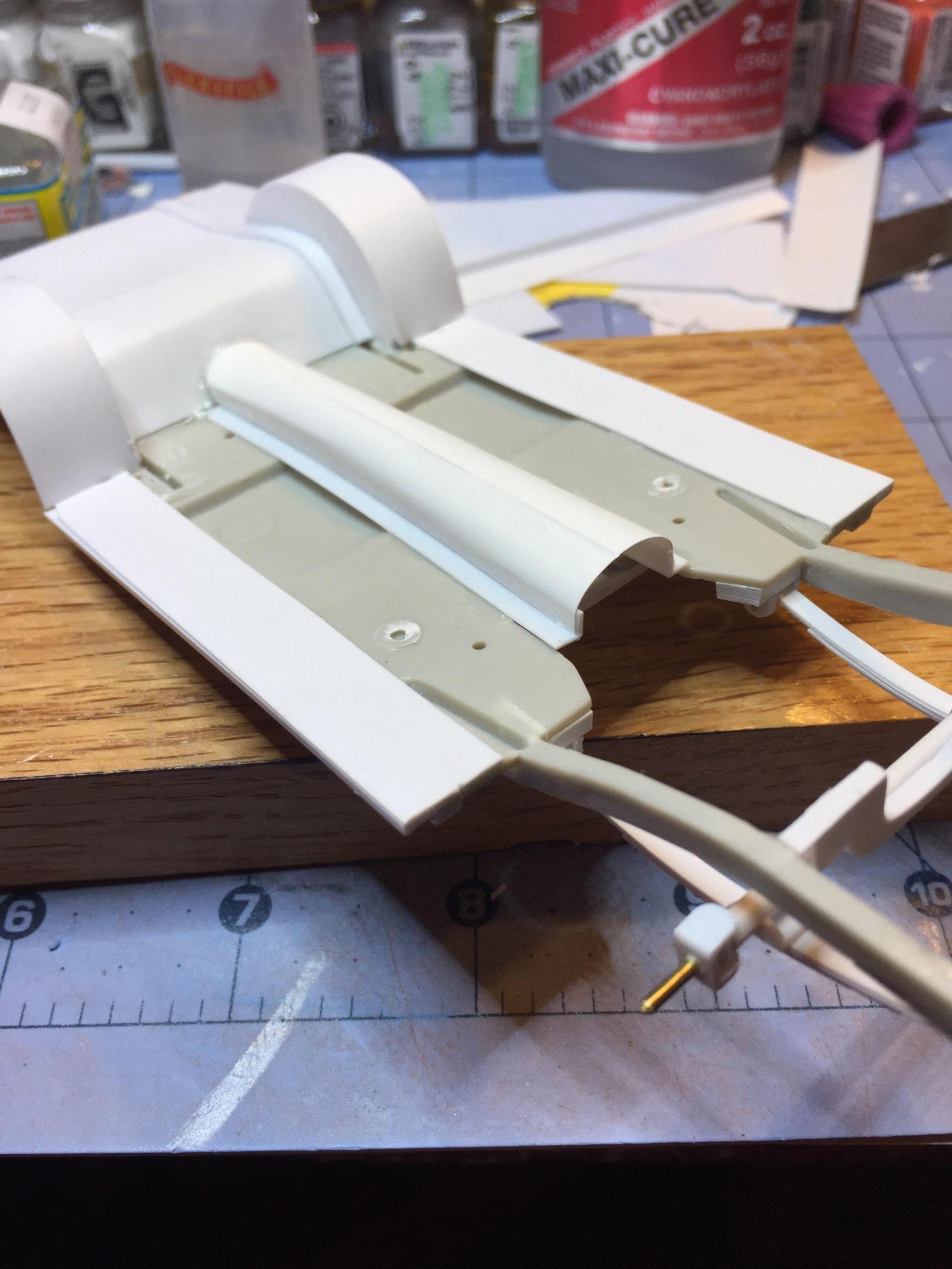

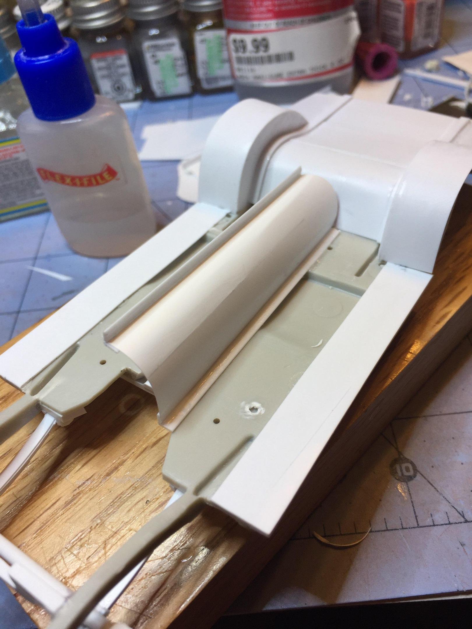

But there's more!  I did sleep but, before I did, I spent 2 hours at the bench and the result is below:
IMG_4648.thumb.jpg.40121306e6bd45bfaa820915288425cd.jpgusing .005 sheet, I curled a piece and attached a flange, 1/8" angle, and glued it down on one side. Using solvent on .005" styrene is not recommended for this sort of operation. I use CA and a kicker for most of this.
IMG_4649.thumb.jpg.00d93ecaf80a831c950630692256a399.jpgafter some manipulation and trimming, I glued down the other flange to the floor.

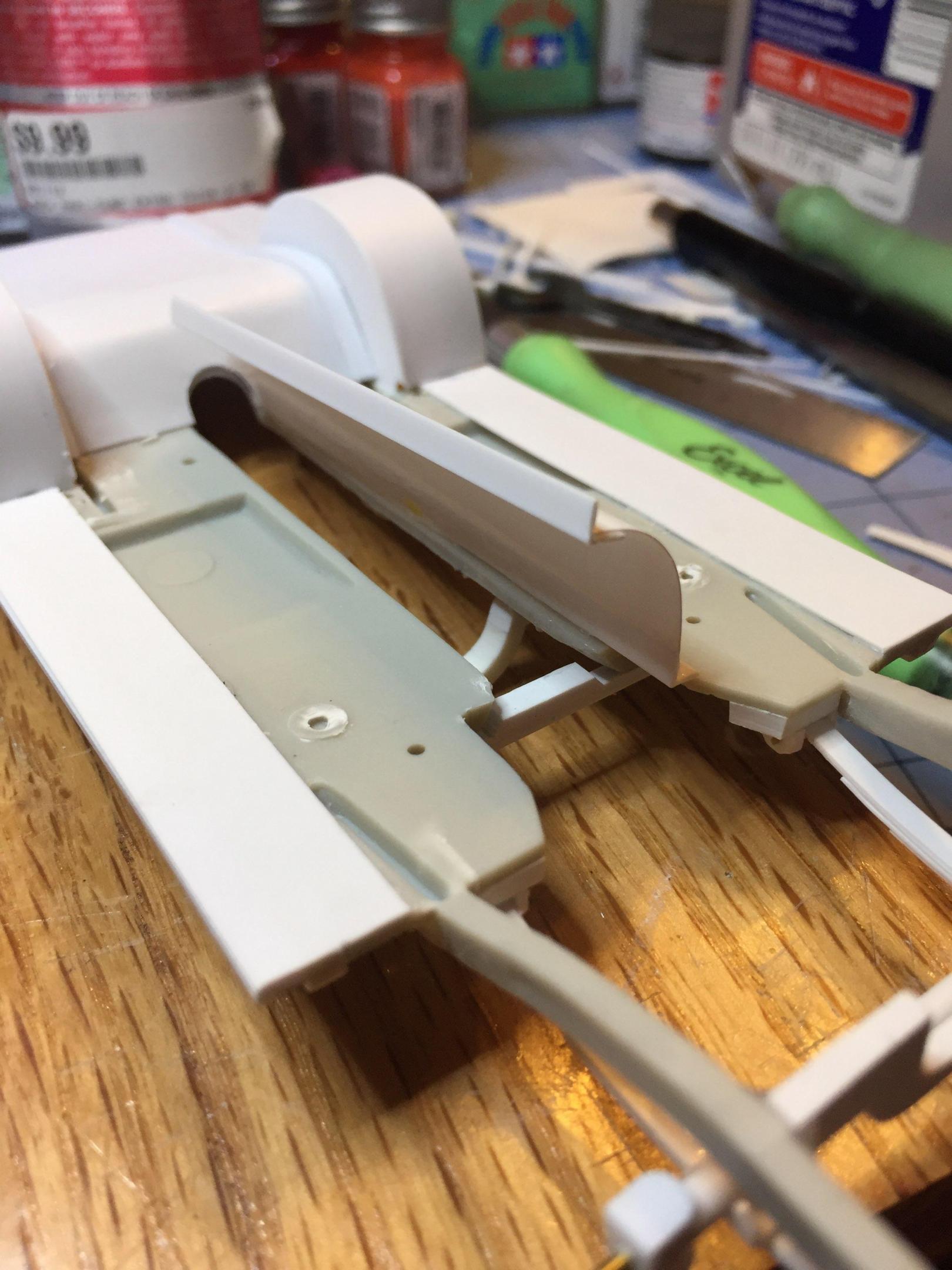

IMG_4650.thumb.jpg.26ab34501c6d5005b05038f2d87b5cea.jpgIt became obvious at this point that Dirty Donnie's trans tunnel wasn't going to help me so I curled more .005" styrene for a trans hump. I must admit I was very pleased with myself when I tried a fit-up with the firewall ?.

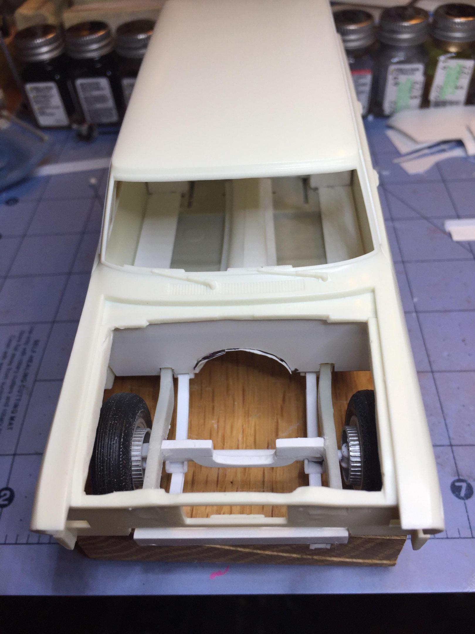

I added some floor material and toe boards. I decided to make it a street-legal gasser. I need to start painting stuff soon so I can finalize the sub-assemblies. This build has been great fun for me so far and I still have a lot to do. Thanks for checking in.
The primary goal while doing a construction like this is making everything fit together after the sub-assemblies are painted and I begin final assembly. So far, it all works.
I started playing around with a means of mounting the stock dash which may prove to be a waste of time.  I attached a structural member to facilitate the installation of the dash and a brake pedal.  I cut the tub apart but the door panel details is so faint I don't think it's worth bothering with.
I'm going for a sort of spartan, utility-like interior with shop-fabricated looking elements and lots of aluminum diamond plate.

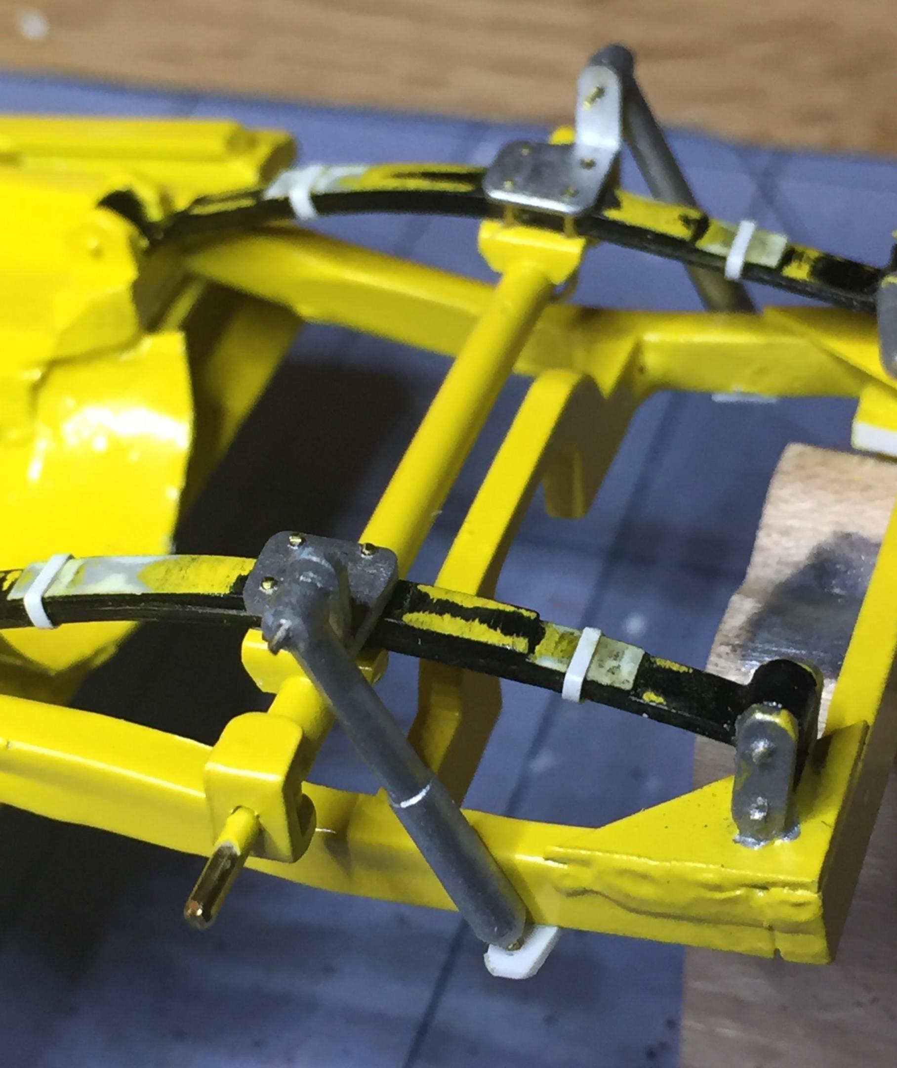

I remembered shock absorbers but only after I painted everything ?. I fashioned bottom spring mounting plates from evergreen angle and found a pair of shocks that were a bit long but figured I'd make them work anyway. The brass rod is .020. The pictures tell the story. I still need to make upper mounts but that's easy enough.
The rear shock mounts were easier. Just some angle scraps. Thanks for looking.

Thanks, Carl. There's something I am learning about scratch-building at this level. I need to plan better. The trouble is I tend to forget certain important components that need to be addressed before painting anything. I totally forgot about the front shocks and how they needed to be attached. Now I'm fighting paint. I've got it done now but it won't look as good as it could have no matter what I do to hide the mess that I created playing catch-up.
IMG_4684.jpg.36d0b89b6e04a59b32e992695aa97809.jpgoh, and I forgot the spring bands too. Bad goof, that one. Gotta clean up that mess somehow. IMG_4685.thumb.jpg.e71fe9a882a81ddce28ea0aeabef4896.jpg
