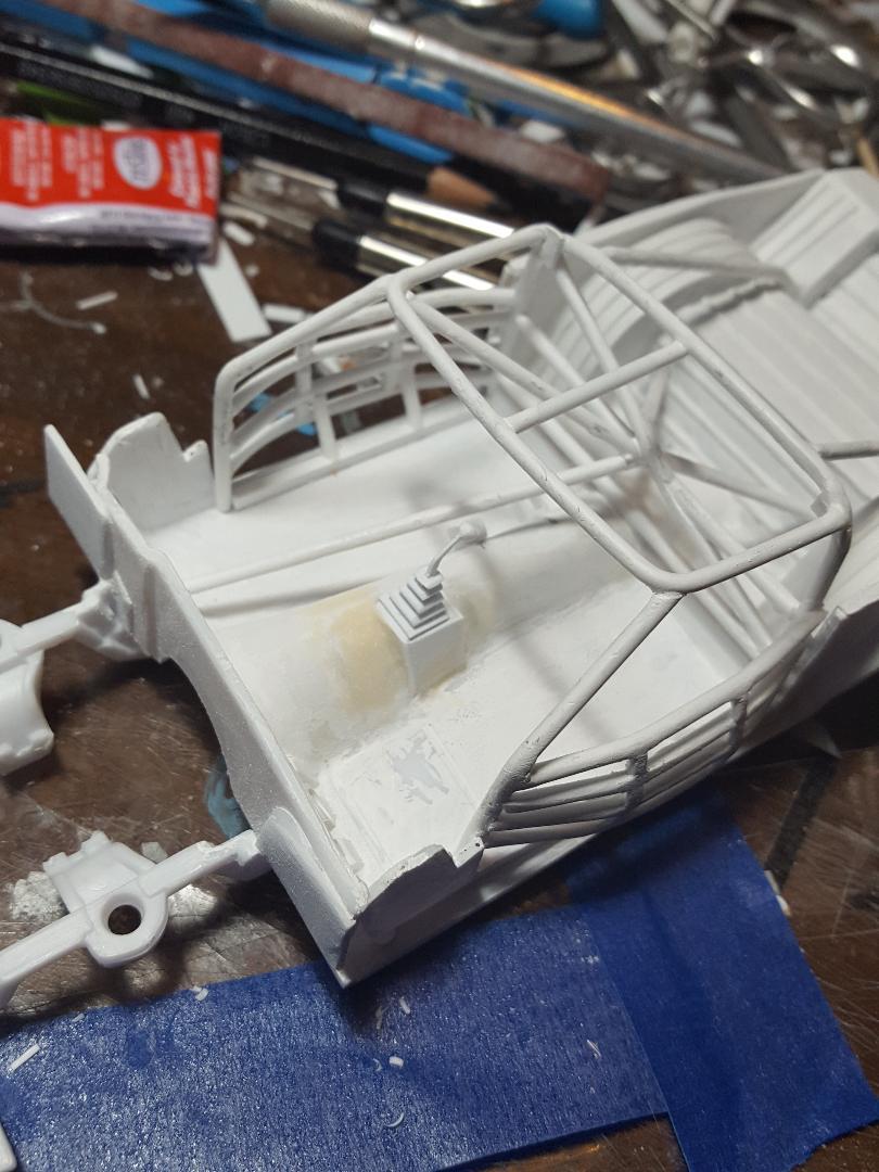

Man, I'm getting tired of working on this thing. And I see no end in sight. Just keep plugging along till I can finish it. Definitely bit off more than I can chew.

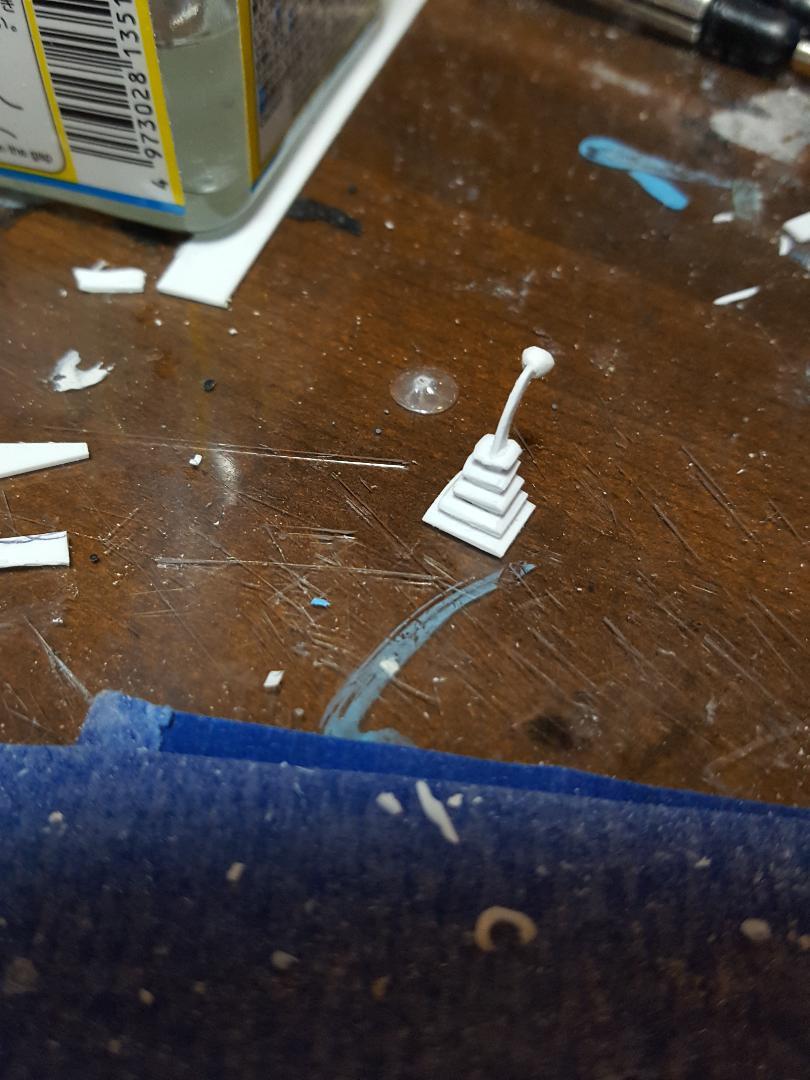

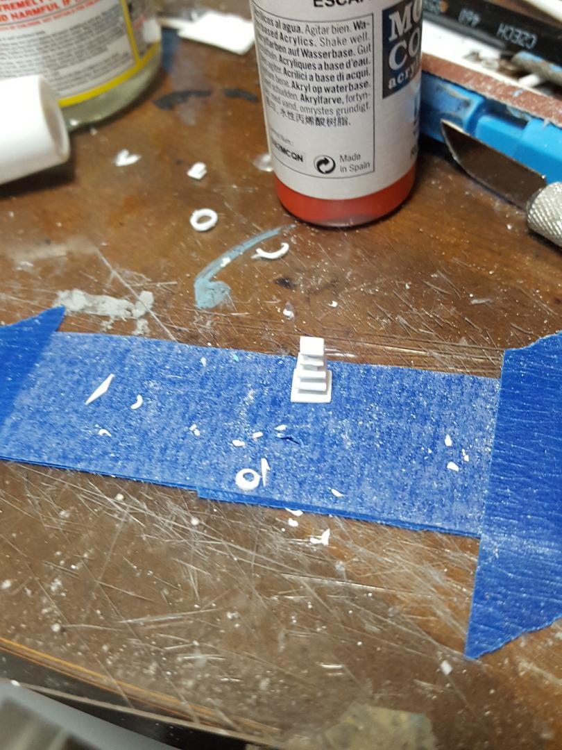

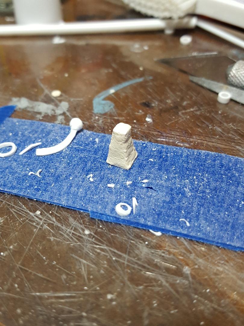

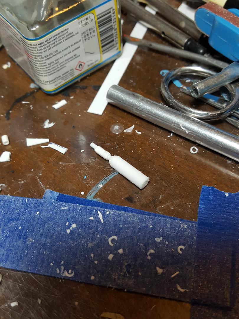

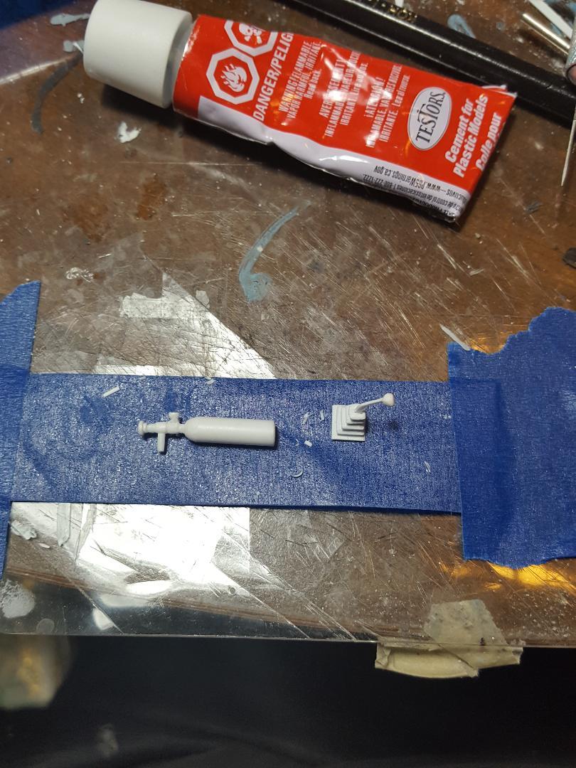

Had to start over on the shifter. the putty deal did not work out at all. Also started on the fire extinguisher. After those pieces are done, I can add the bars to the engine compartment and flip the chassis over and start on the underside which will be a lot of stuff to do. At least I finally found some pretty good reference pictures of the underside. Turns out it has a quick-change rear axle assembly. That's going to be a mind-numbing transformation that won't be close at all. I'm going to keep the detail to a bare minimum. Just want to finish this one and move on.

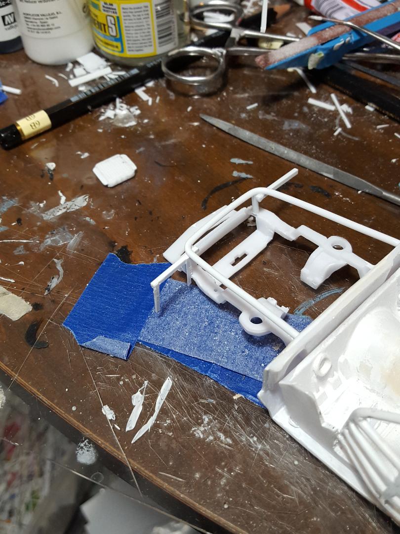

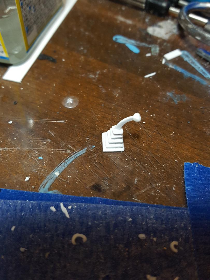

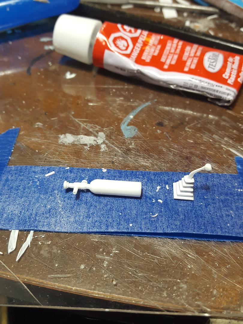

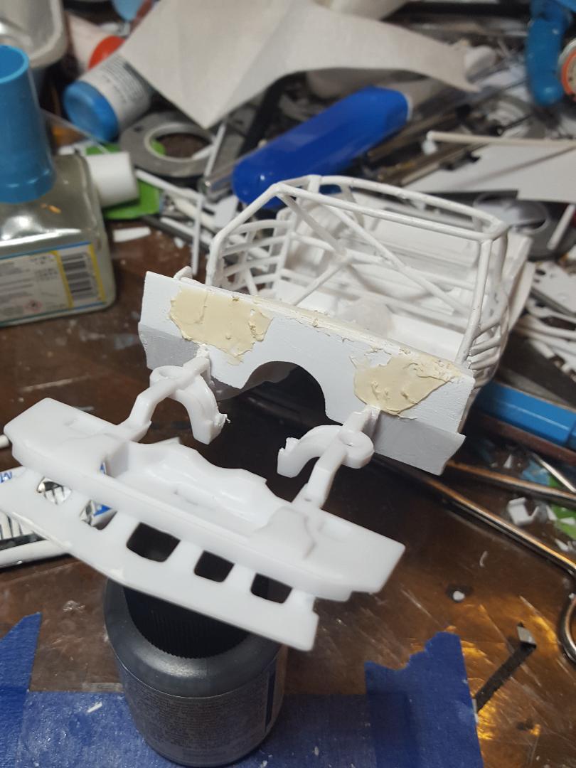

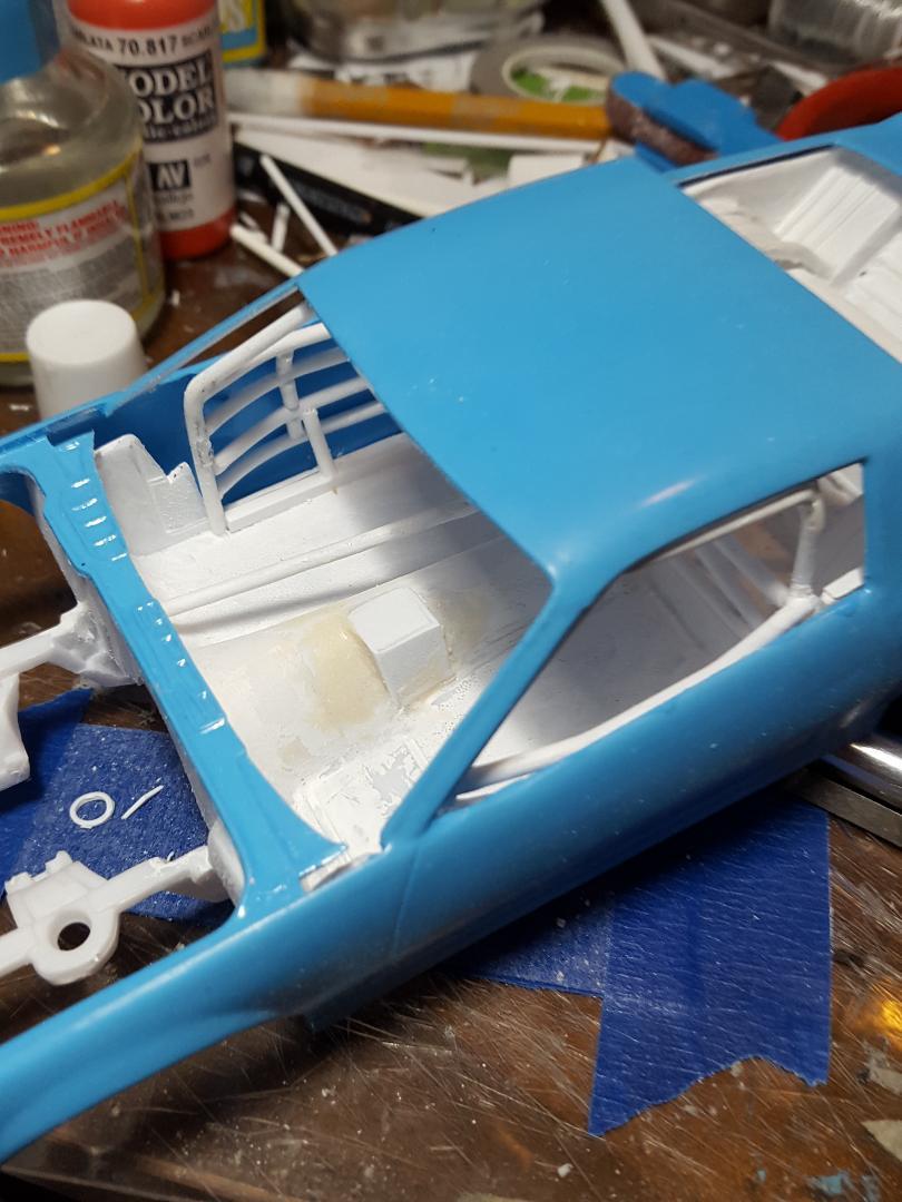

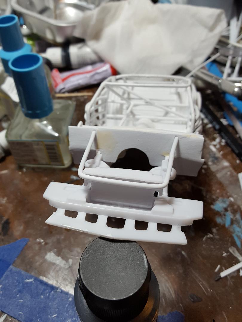

Got the shifter and fire extinguisher finished except for paint. Finally got the firewall flattened out. The stock Camaro firewall is all over the place, but the Banjo firewall is flat all the way across.

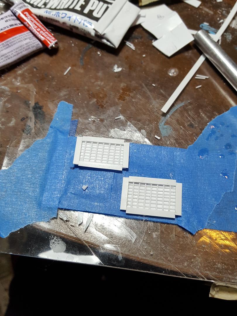

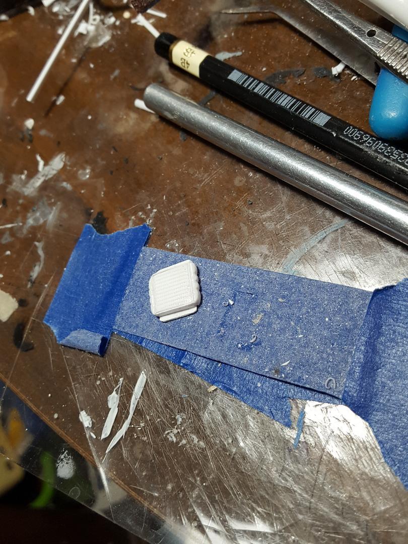

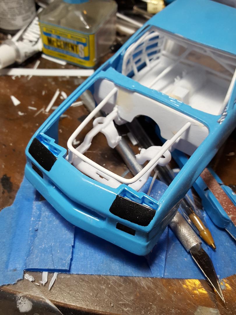

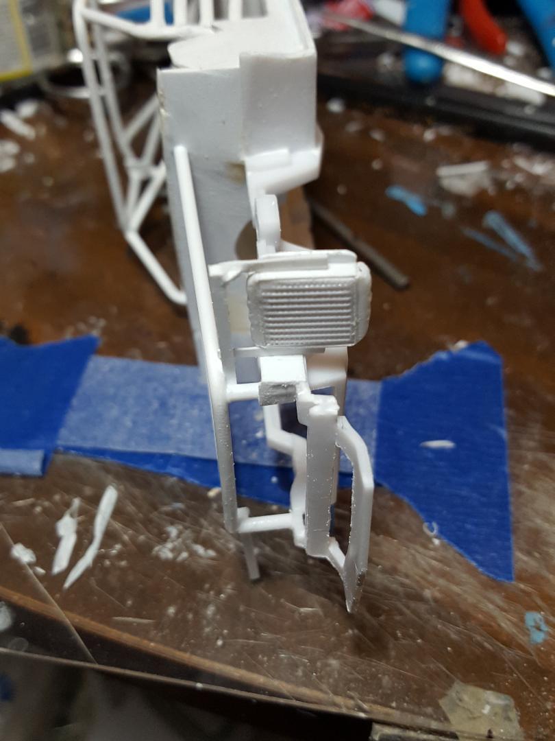

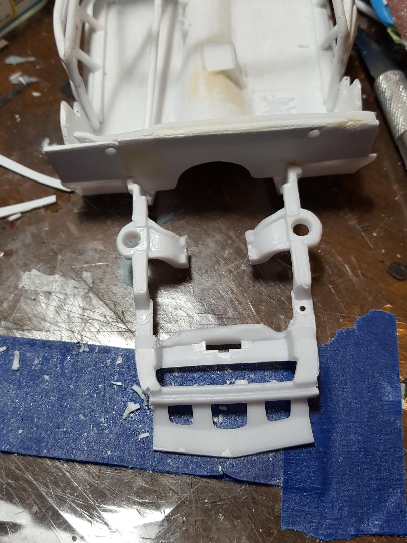

Started on the engine loop and the radiator. I'm using the stock radiator from the kit as a base and making it bigger to the size of the competiton version.
  • Like 2
Almost finished with the radiator. Then I need to make an oil cooler radiator that mounts to the left of the radiator. An expansion tank for the radiator will go on the right side of the firewall. Don't know if I will plumb any of this stuff.

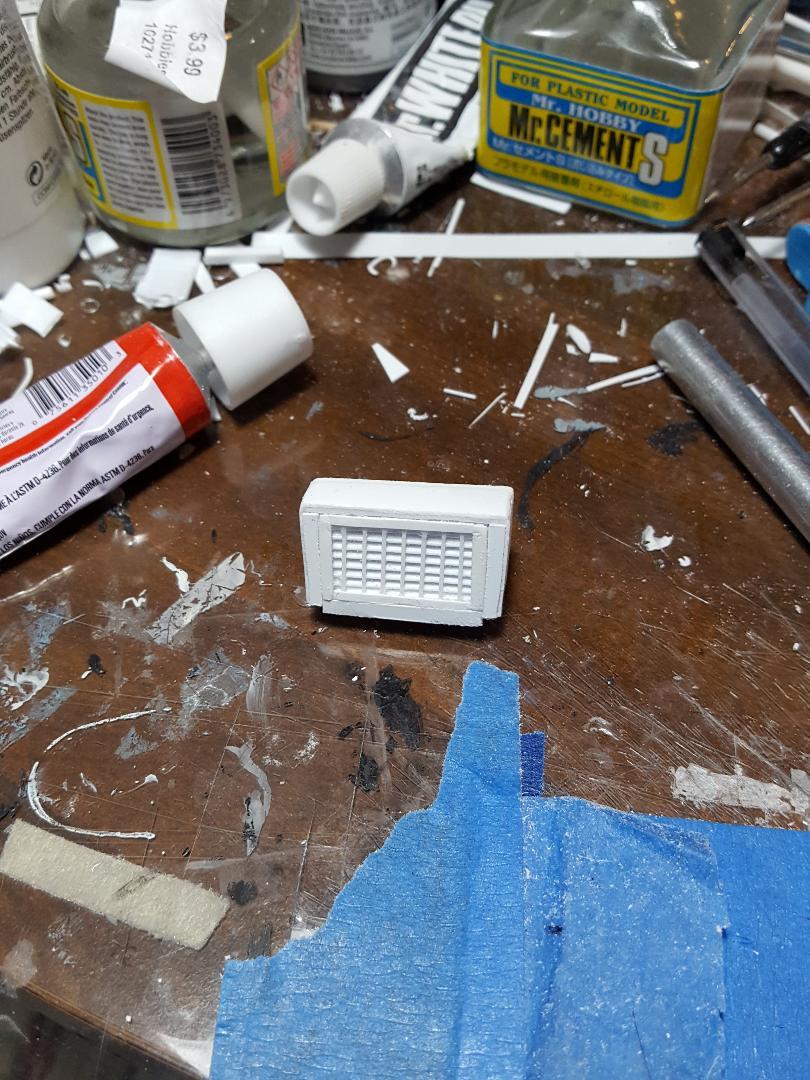

A little more trimming and sanding on the radiator and adding some ports to hook hoses to and it will be finished. I made sure the hood would shut before I glued the engine hoop bar in. The radiator is all aluminum so it has a different look then most and I think I might have made it a little too thick, but I really did not have any actual ref pictures of the 1989 iroc radiator. I used more recent ref pics and hoping that it was close to the 89 version. A few more bars and I can move on to the front suspension which will be completely scratch built. Don't expect too much accuracy. I just need a place to put the front tires /wheels. The stock front suspension would have looked way wrong.
  • Like 2
I also realize the cross hatch is much too big, but the material I had to work with was .020 rod which is way too big to make a finer grid and my fingers and eyes could not have worked with a thinner material so I will just live with this. But you can get the idea that it is a radiator and once its installed and painted no one will notice or care on the finished model. I guess I could have just glued the hood shut but that's no fun.

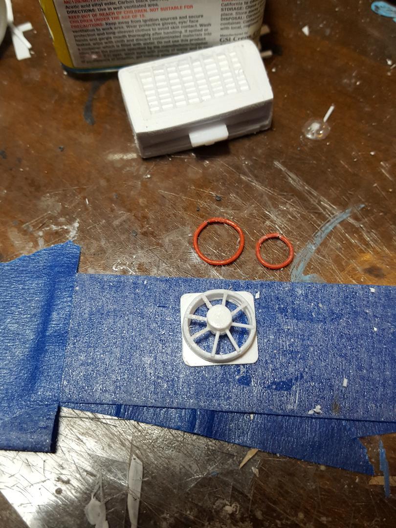

Almost forgot that I need to make an electric cooling fan. The circular ribs will not be fun. Don't know if I will use .010 thick styrene strip or 32-gauge wire. the strip will have to be cut very thin and making the wire circular and gluing it with epoxy might be very hard to do cleanly. The durn thing is so small.
  • Like 1
The ref pic I used for the above fan was from a Dodge Avenger IROC car much later on. I found a picture although not so great of an electric fan from a 1988 NASCAR cup car which looks like it will be easier to duplicate and probably more like what was use in a 1989 IROC race car.  Easier is what I need right now. It's in the far-left side of the picture.

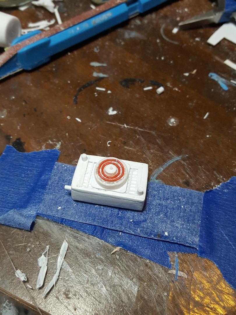

Finally got the metal rings fastened to the styrene with clear epoxy and it looks like it's going to work. Just a little more work on the radiator and the fan and I can move on to the expansion tank, brake master cylinder, and eventually the front suspension, which will be totally different than the stock Camaro front suspension.

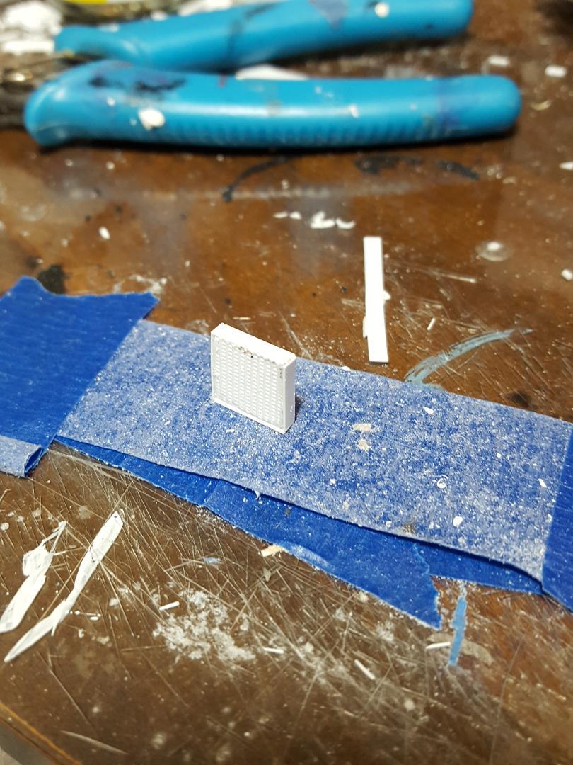

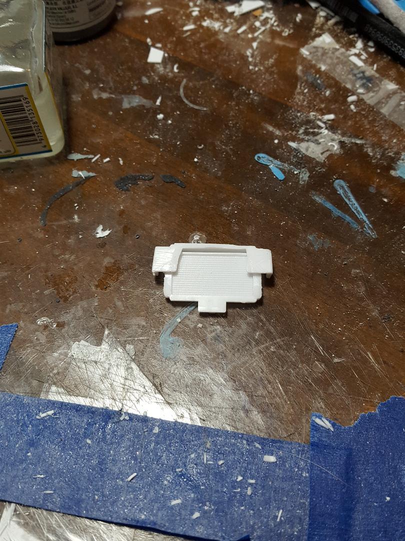

Pretty much done on the radiator and fan. I forgot that I now need to make the oil cooler radiator that sits to the left of the radiator. I found a radiator in my parts stash and think I can cut it in half to have the proper cross hatch for the radiator core for this smaller radiator.
  • Like 3

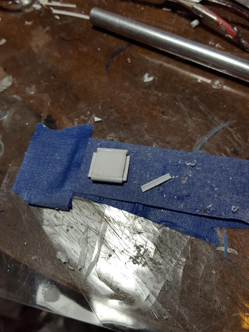

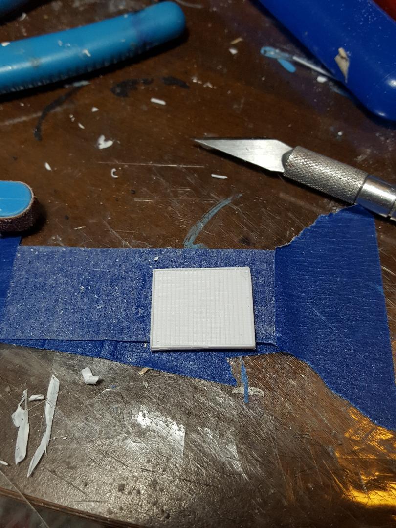

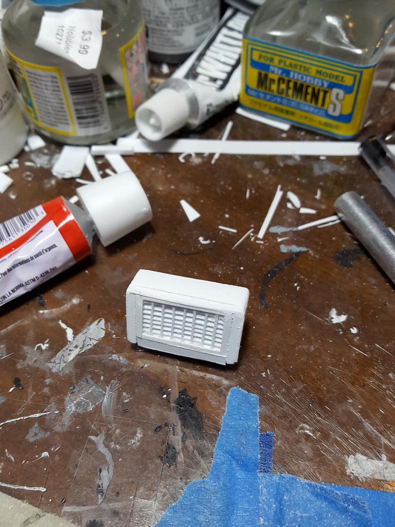

I took the radiator I found in my parts box and took off all the extra tanks to make it into a simple square. I then determined how big I needed the oil radiator to be and made two squares the same size and glued them together, and then sealed off the 4 sides with strip styrene. I will fashion new tanks for the top and bottom of the radiator and make mounts on the chassis to install it. I will also add ports to it for if I decide to plumb it.
  • Like 2
Almost through with the oil cooler radiator. I used tubes cut in half to make the top and bottom tanks for it.
