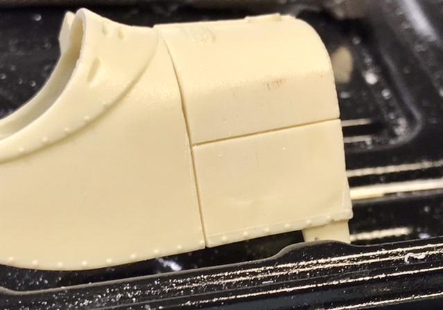

absmiami Posted November 13, 2023 Author Posted November 13, 2023 Some exploratory body work …. The bonnett is designed to hinge …. And it does …. The lower engine compartment panels are thinned and modified - the Don Lee Special had no left side openings …

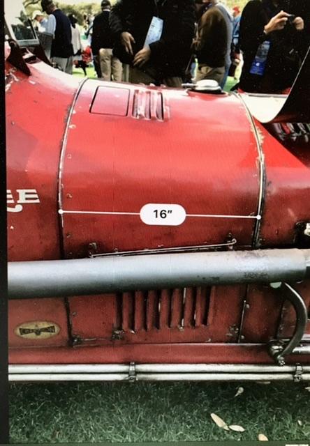

absmiami Posted November 13, 2023 Author Posted November 13, 2023 Underneath the cowling is a secondary oil tank - there is a removable panel aft of the bulkhead - serving access to the tank and the transmission -

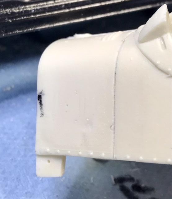

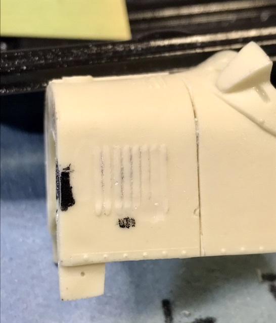

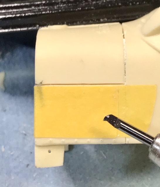

absmiami Posted November 13, 2023 Author Posted November 13, 2023 Can’t resist the temptation to make a removable panel - starting by locating the cut lines … and removing the louvers - which are in the wrong place - at least for this car - series I P3s ?? Dunno …
absmiami Posted November 13, 2023 Author Posted November 13, 2023 Measured and taped scribing guide lines - panels match the height of the eng compartment side panels … then scribed the cut lines with a Tamiya .015 scriber …

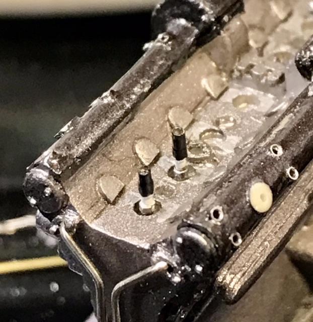

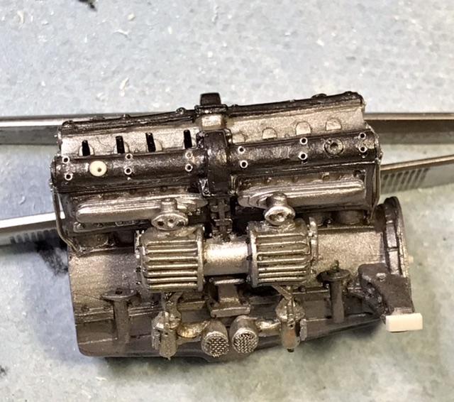

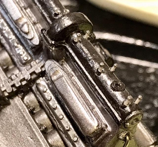

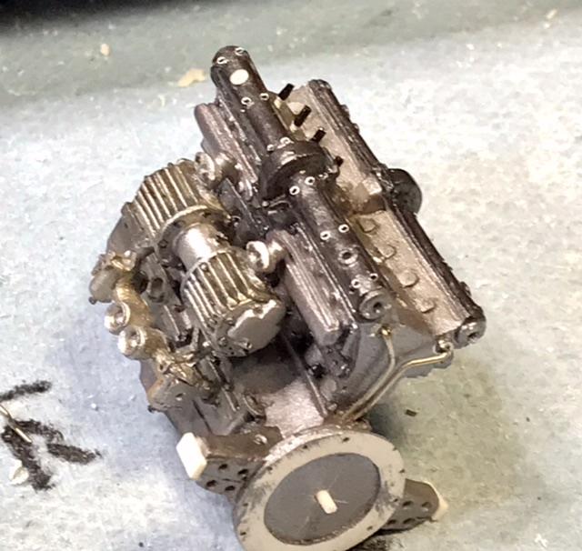

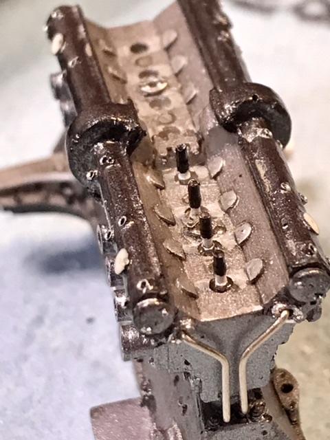

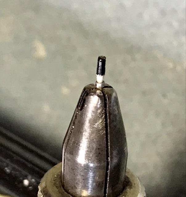

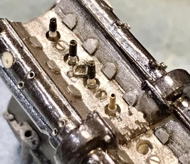

absmiami Posted November 14, 2023 Author Posted November 14, 2023 Engine wednesday … the plugs are made from .06 brass tube, .031 alu nuts fr my RB Motion stock, and .08 alu tube - filed and sanded and painted to make the plug boots - the plug wire will slip into the assembly and i should’t have to worry about the plug tip getting dislodged …
absmiami Posted November 14, 2023 Author Posted November 14, 2023 4 so far - cant make 8 in one sitting - to challenging …

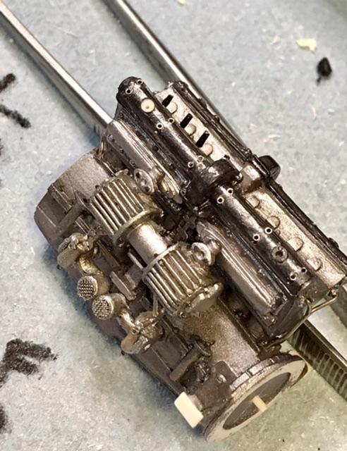

absmiami Posted November 15, 2023 Author Posted November 15, 2023 Paint - tamiya silver and gun metal - on the supercharger - and screens on the carb horns …

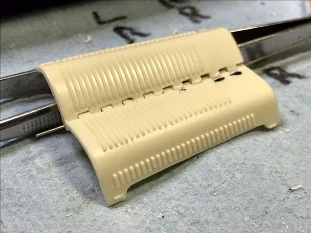

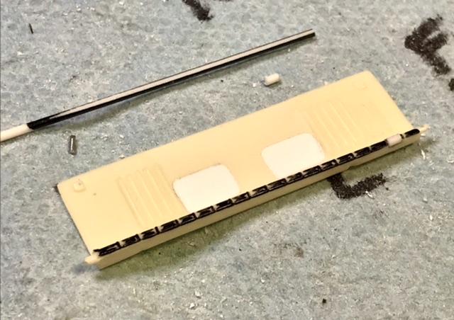

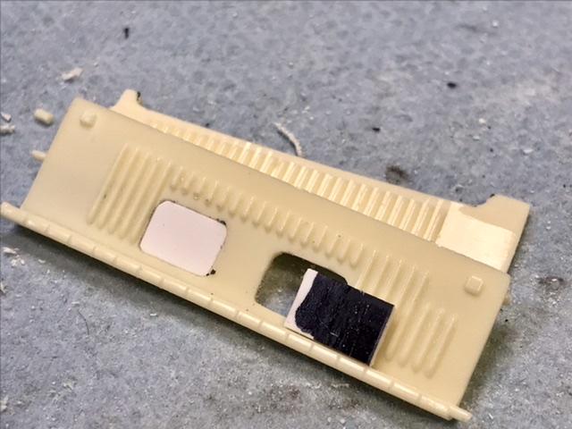

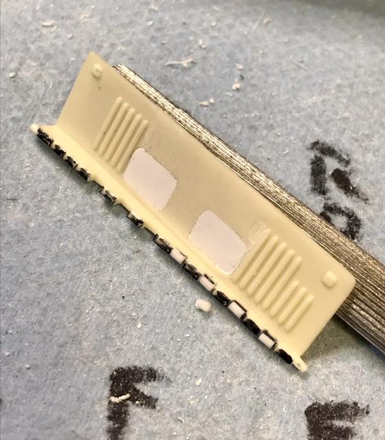

absmiami Posted November 28, 2023 Author Posted November 28, 2023 Changes to lower left hand engine compartment panel - first some filing and cutting - using .40 Evergreen rod - short lengths - to simulate the panel hinge - looks better than the hinge markings on the casting -

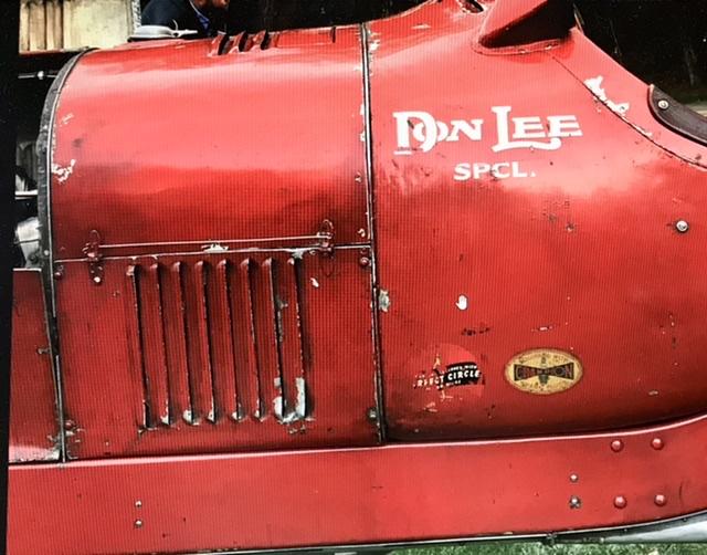

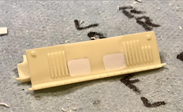

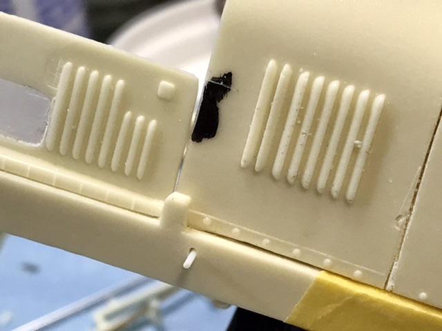

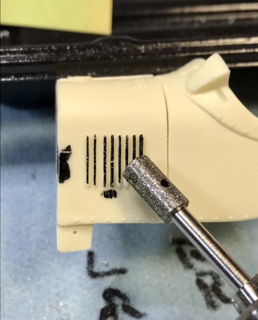

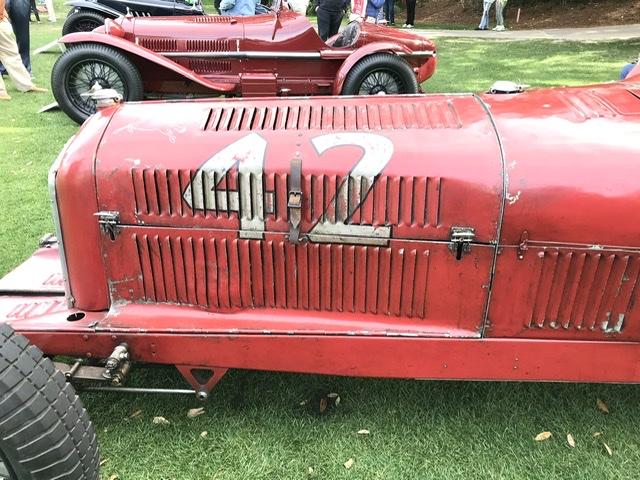

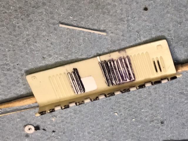

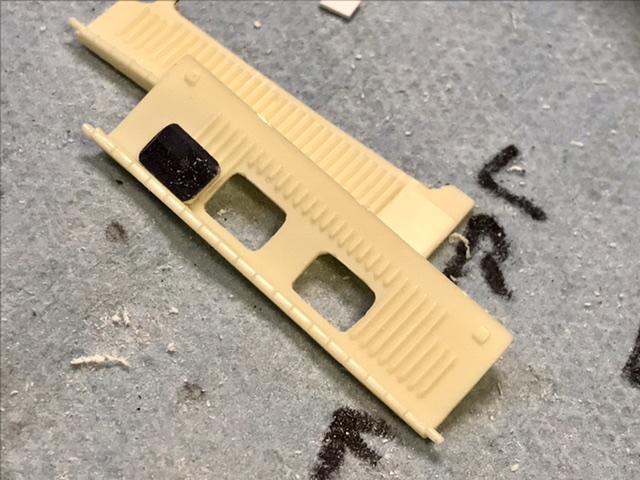

absmiami Posted November 29, 2023 Author Posted November 29, 2023 Gracias the panel on the Don Lee Spl was fully louvered - which unfortunately means i had to add a bunch of - er - louvers … Using Evergreen .015 by .020 strip - scraped and filed to shape and then CA glued to the resin - using slow curing CA …
absmiami Posted November 29, 2023 Author Posted November 29, 2023 (edited) Slow going - gluing one strip at a time …. About six more to go … Edited November 29, 2023 by absmiami

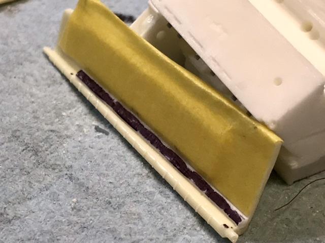

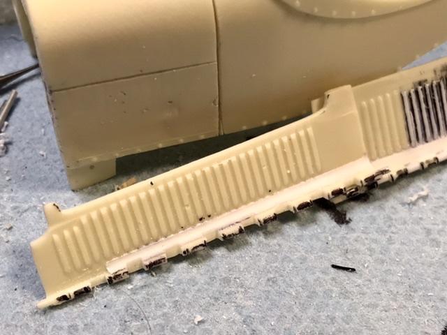

absmiami Posted December 2, 2023 Author Posted December 2, 2023 If you look closely at the picture of the left eng bay panel posted earlier this week - you’ll notice that the hinge at the panel’s base curves - the kit casting pokes out at a right angle - this needs corection on both panels - left and right - the curve is created with quarter round Evergreen strip - glued and shaped with a couple orr needle files - the quarter round strip is old stock that i never need/use - until i need/use it …
absmiami Posted December 2, 2023 Author Posted December 2, 2023 Also adding the hinges to the right side panel per the left …
