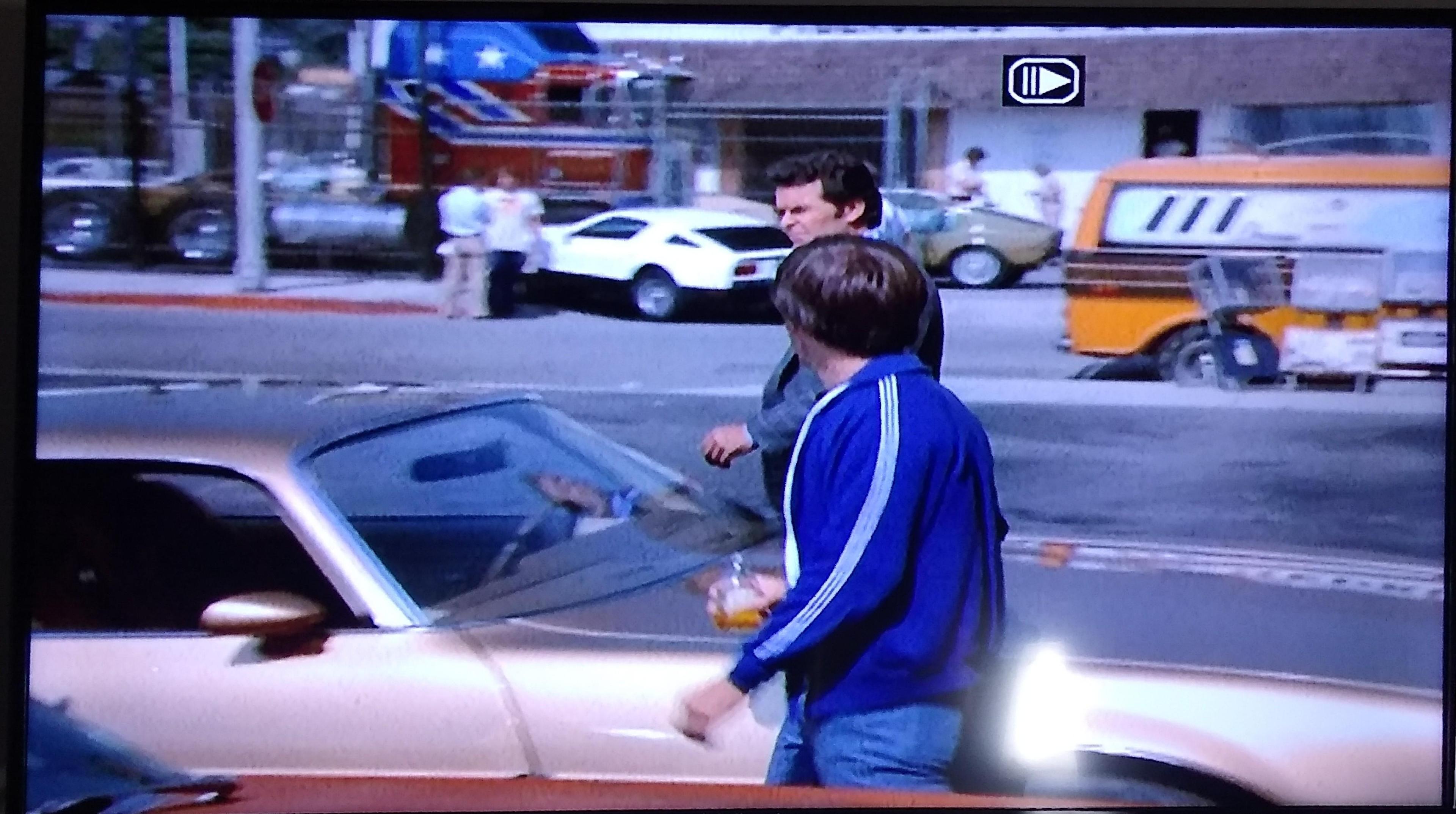

In the photo of the real thing they've moved the deckplate to behind the 5th wheel for a stunt where Sonny unhitched a drawbar trailer from the pintle hook fitted to the rear cross member. The deckplate was only held by rubber straps.

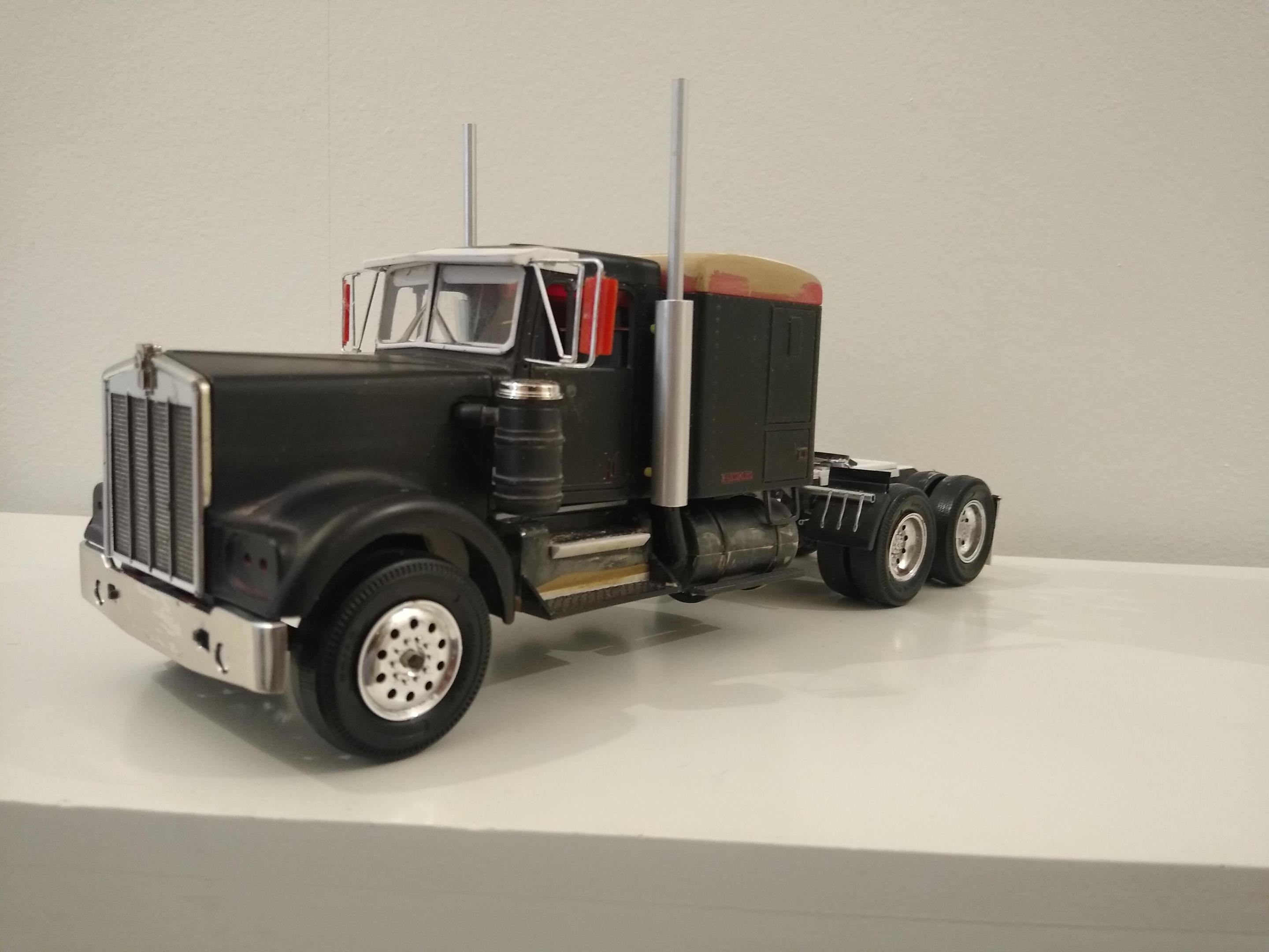

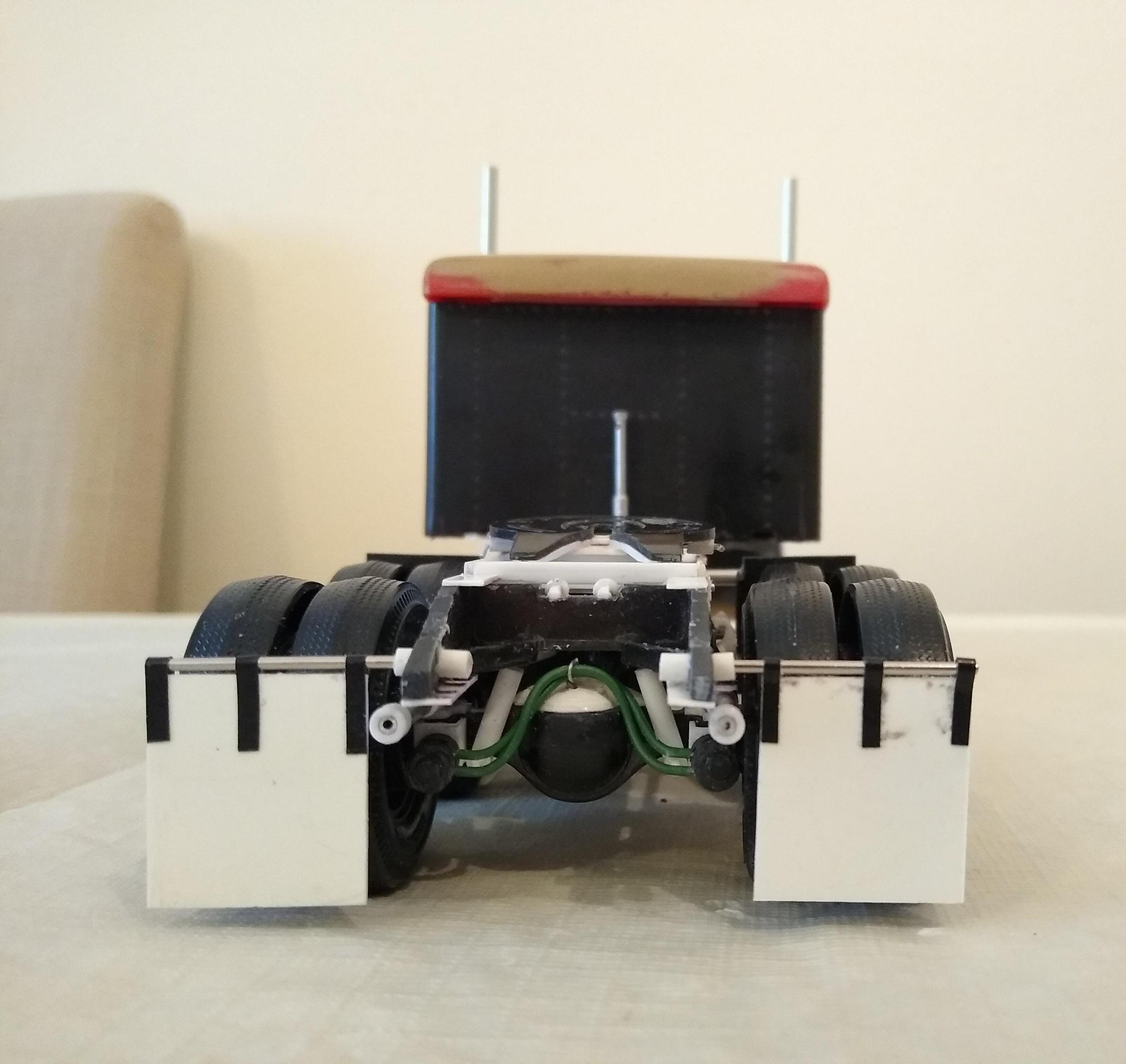

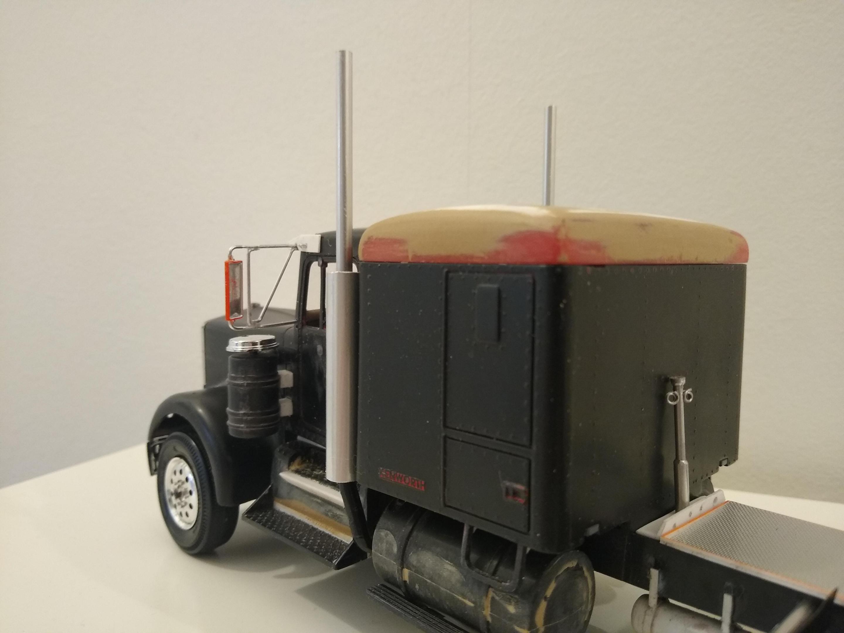

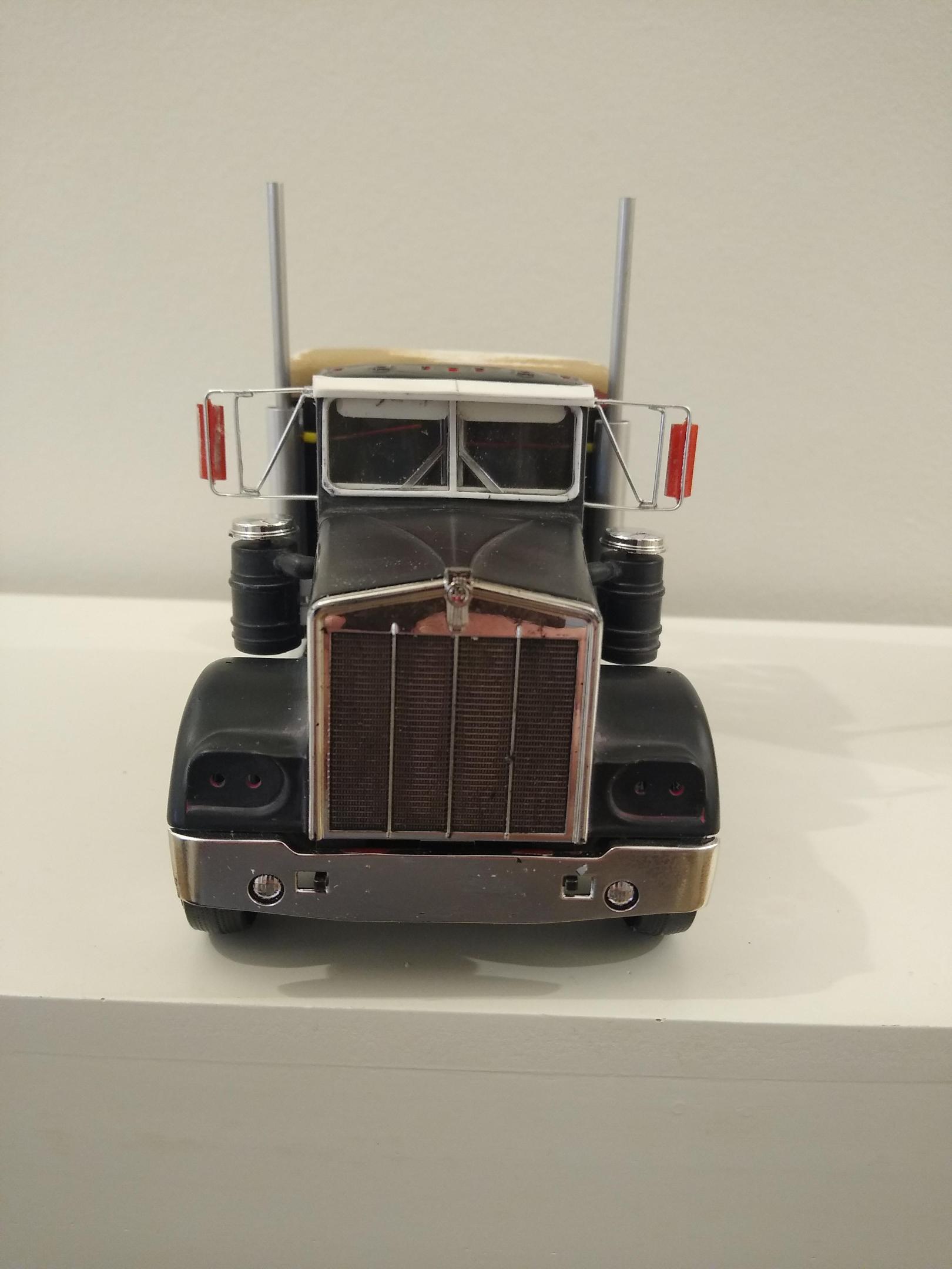

Got my air filters mounted and made mirror arms from 0.8mm ali wire. I've got to make the braces to the cab roof and scuttle panel but they can be done after paint. I used the T600 kit arms as a pattern and then cut the mirror heads off and transferred them across. Look better than the kit stuff if a little rough.

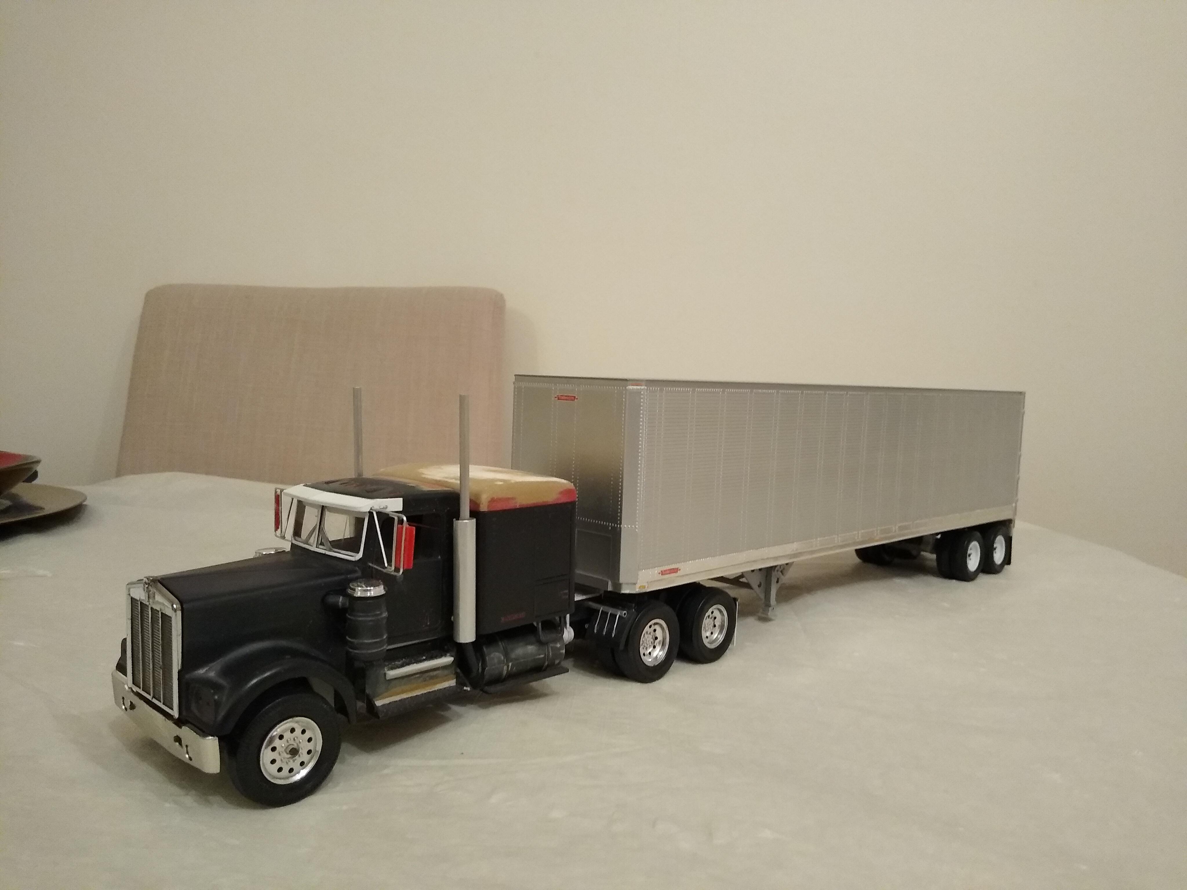

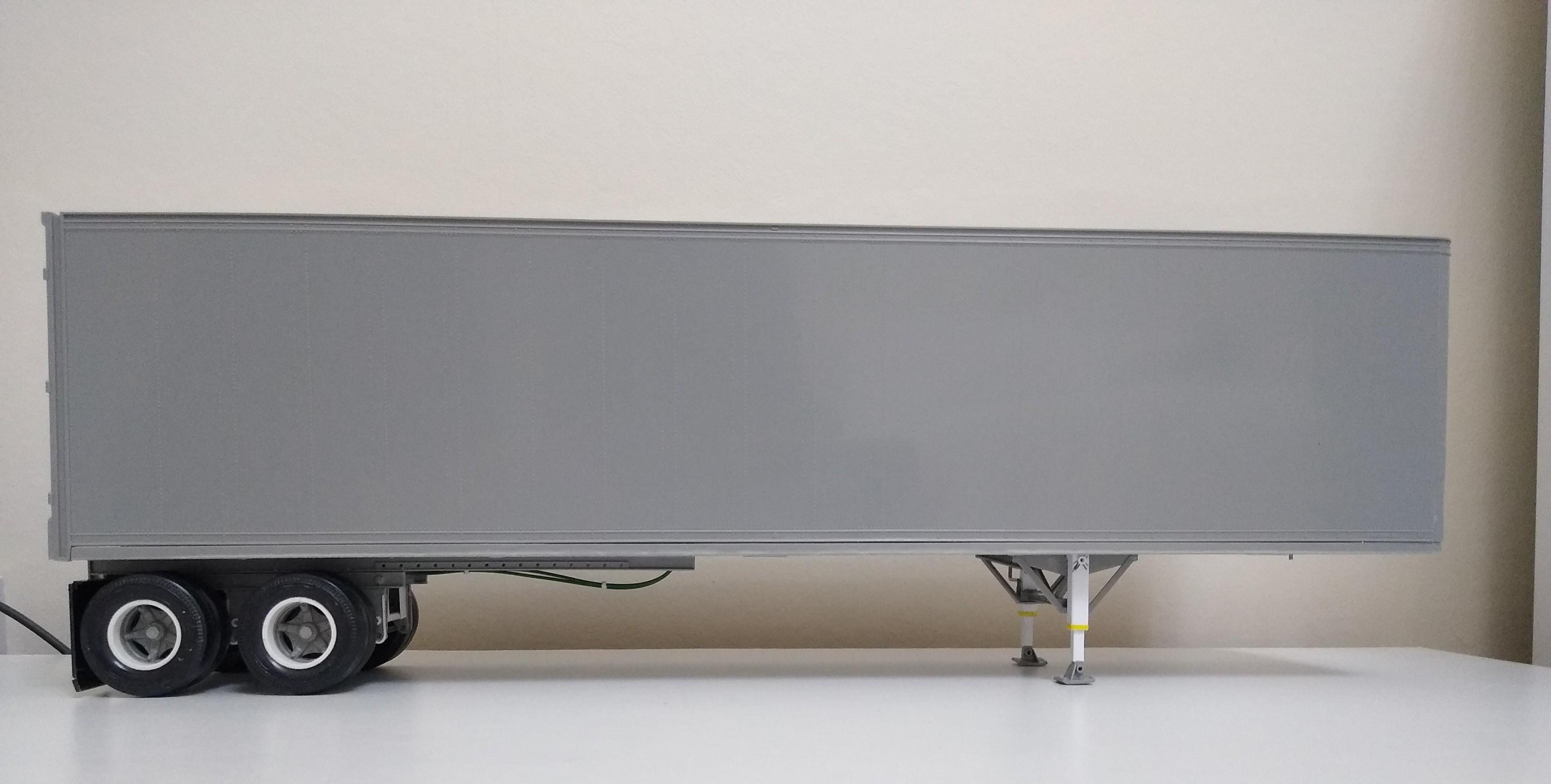

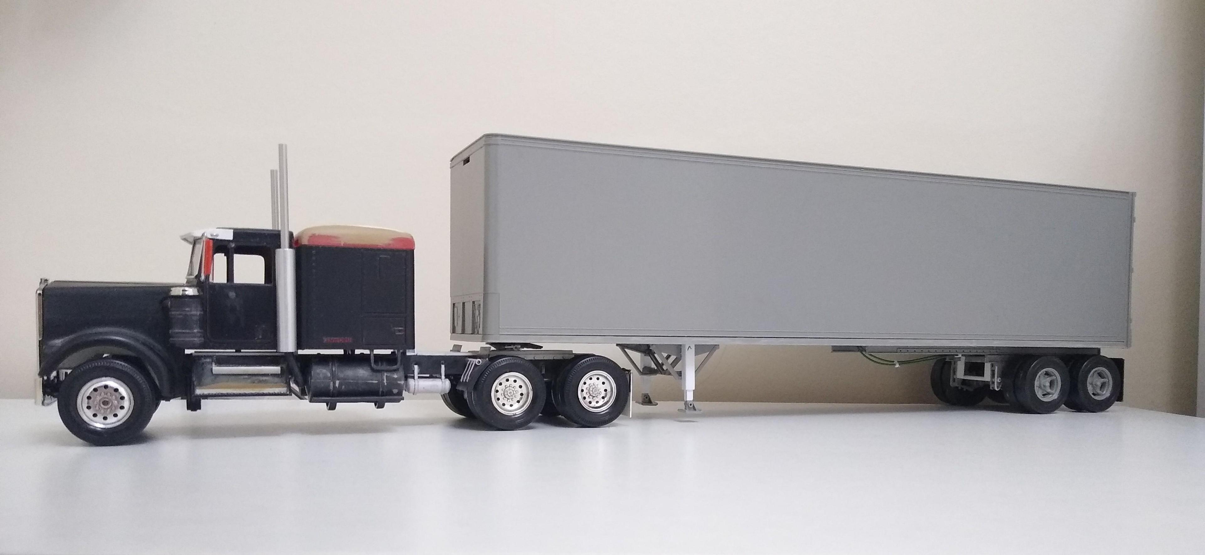

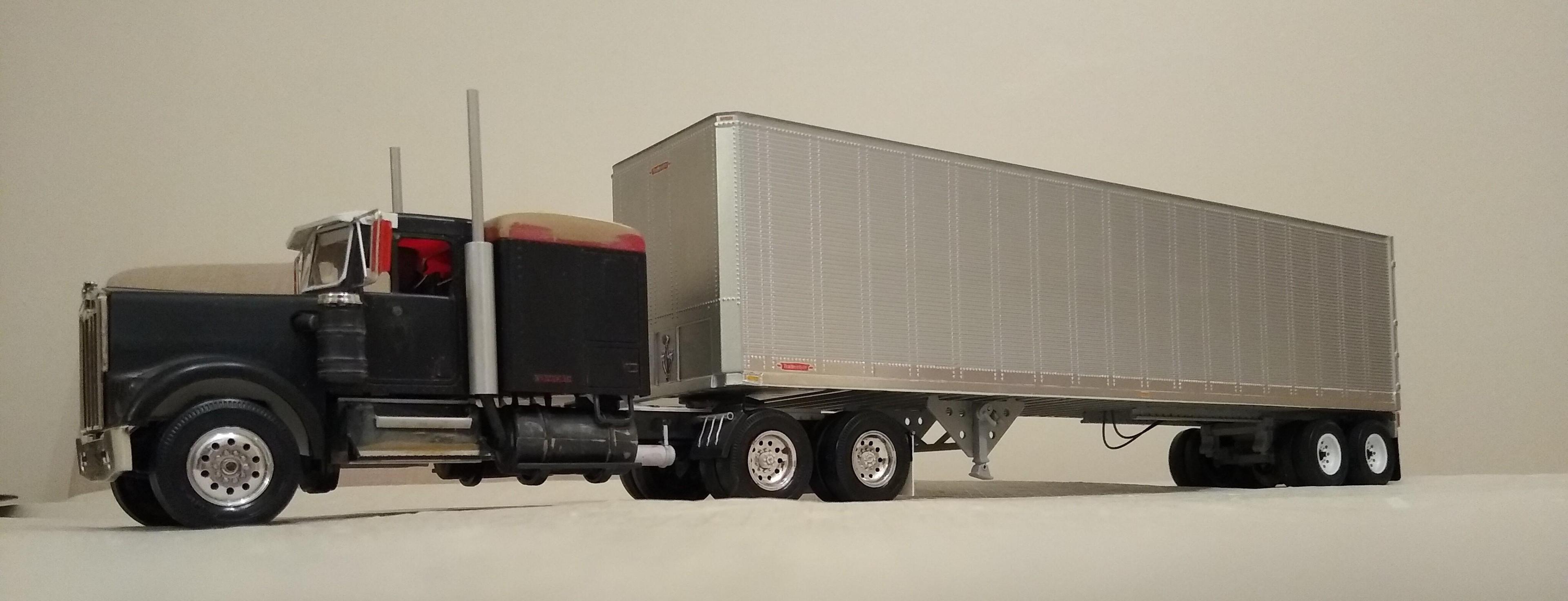

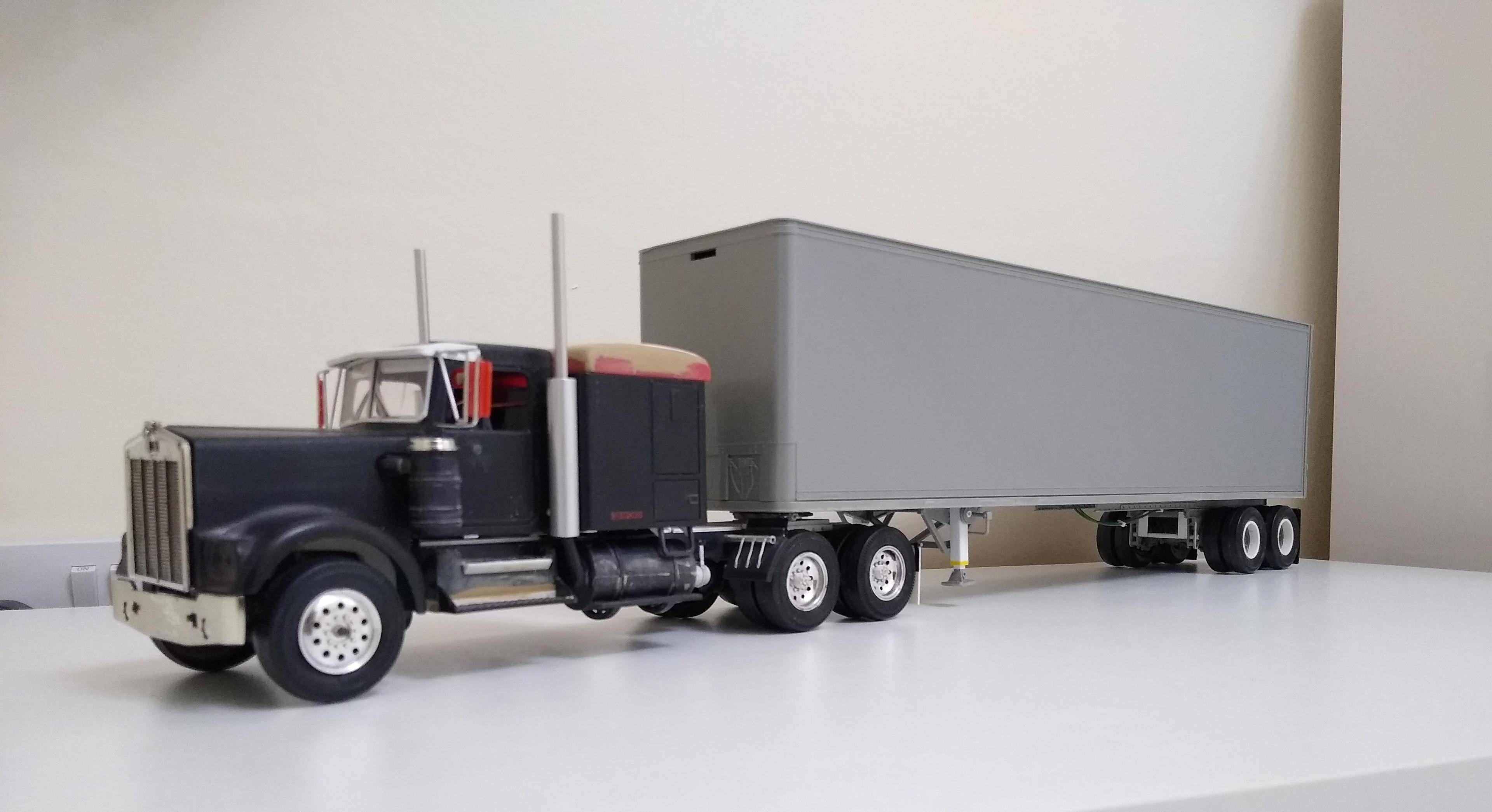

Here is the truck mated to my Trailmobile dry van. Looks right to me. I want to do an aluminium Fruehauf dry van as you mostly saw it with in the series. Typical that I've got six van trailers and none of them are right for it.

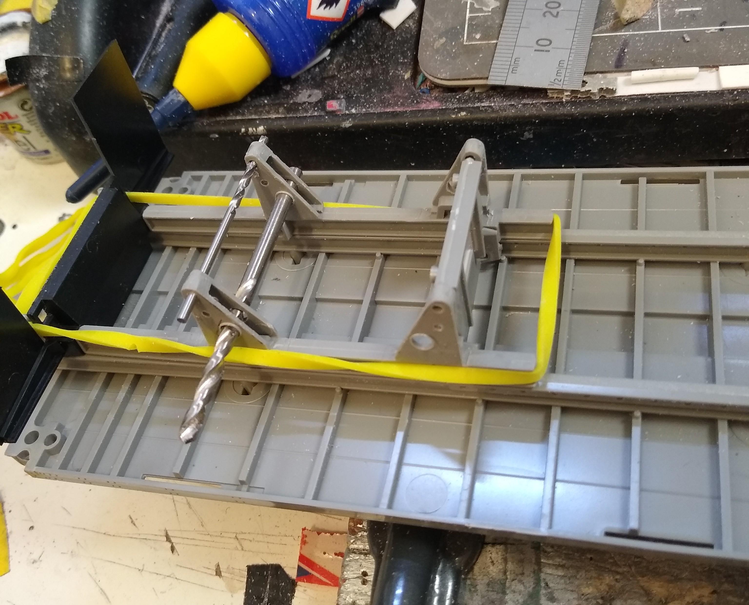

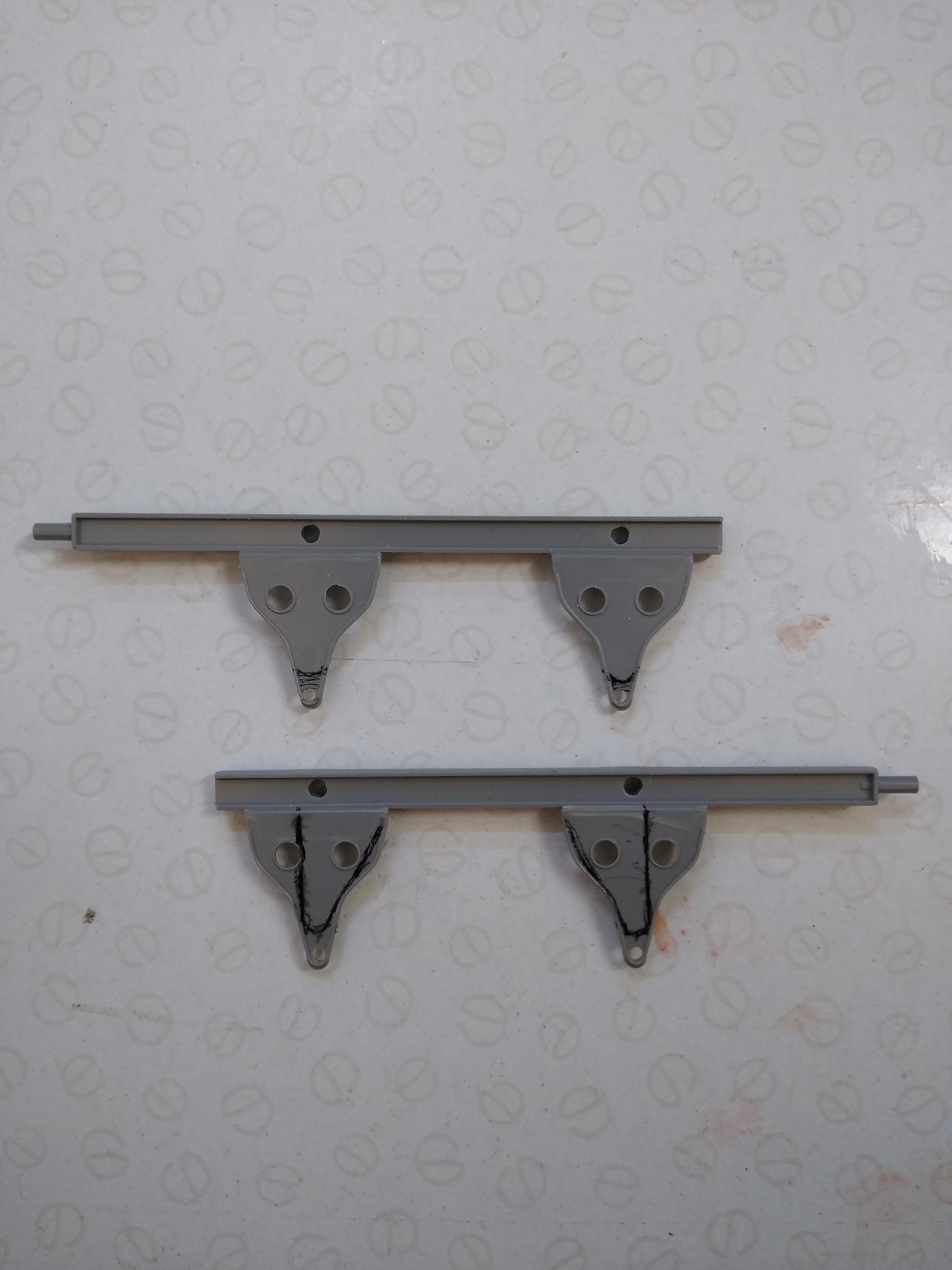

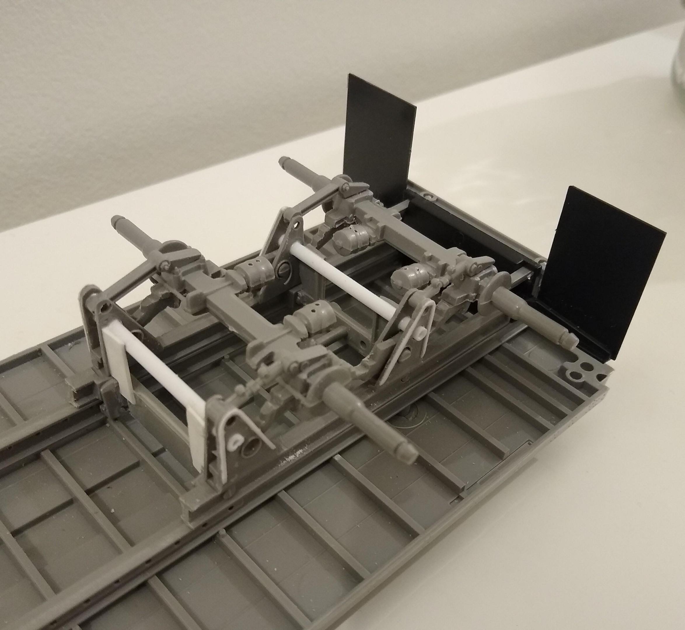

I still have considerable work to do on the tractor but I'm itching to start work on the trailer, particularly the suspension. The 1/32 Monogram Fruehauf vans come with the F2 spring suspension that has the wide side brackets. There was another version Fruehauf did, I think it was 'F2 Lightweight' because it had smaller brackets and crossmembers (I've worked extensively on both but never found out why the difference). This is the version Pruitt's truck used. After extensive Googling I established that the kit pieces could be modified to suit, which made things much easier.
I took the original pieces and as well as doing my lowering procedure (documented in other builds) I reduced the size of the side brackets and crossmembers. I held everything in line with drill bits while I bored the holes through each set of brackets for the new tubular cross members. Added some 0.75mm strip around the edges to replicate the rolled lip.
Results look really good I think.

Yes they did, at least on the truck used in the "Life Line" episode 4 1974 wich the picture below is from.

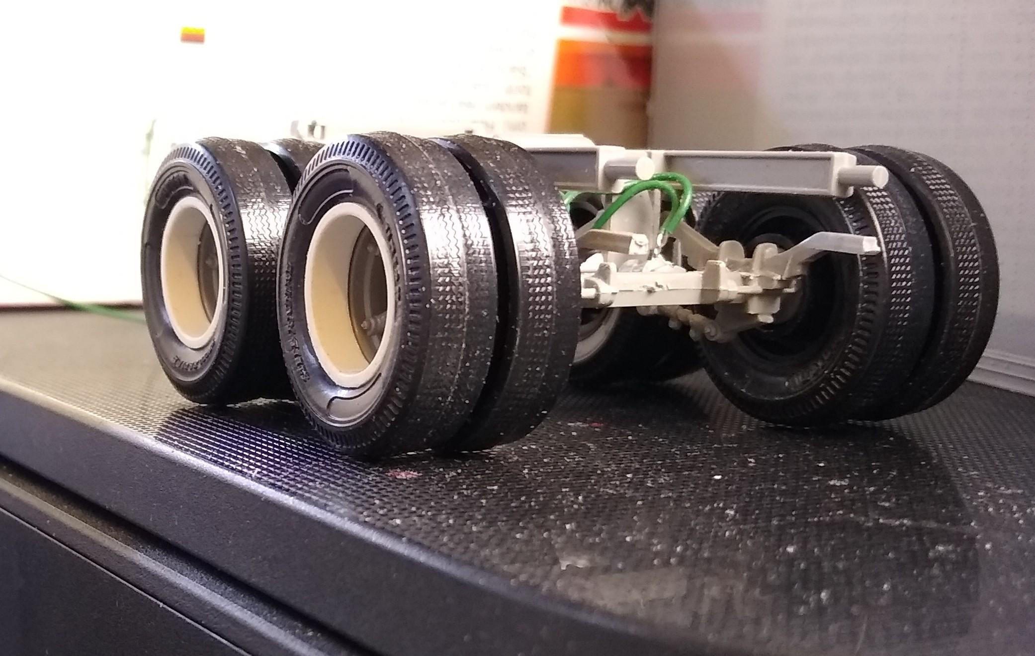

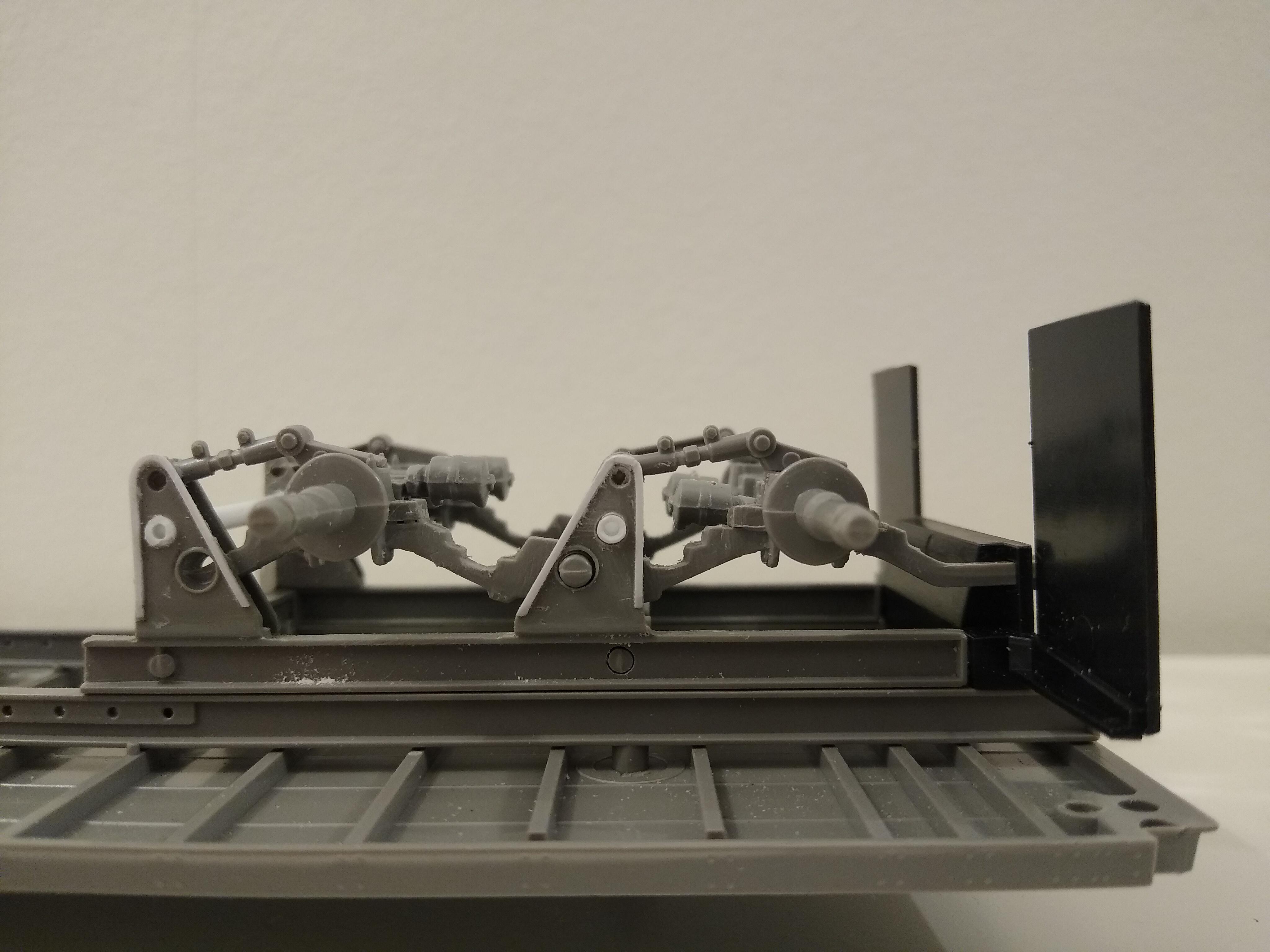

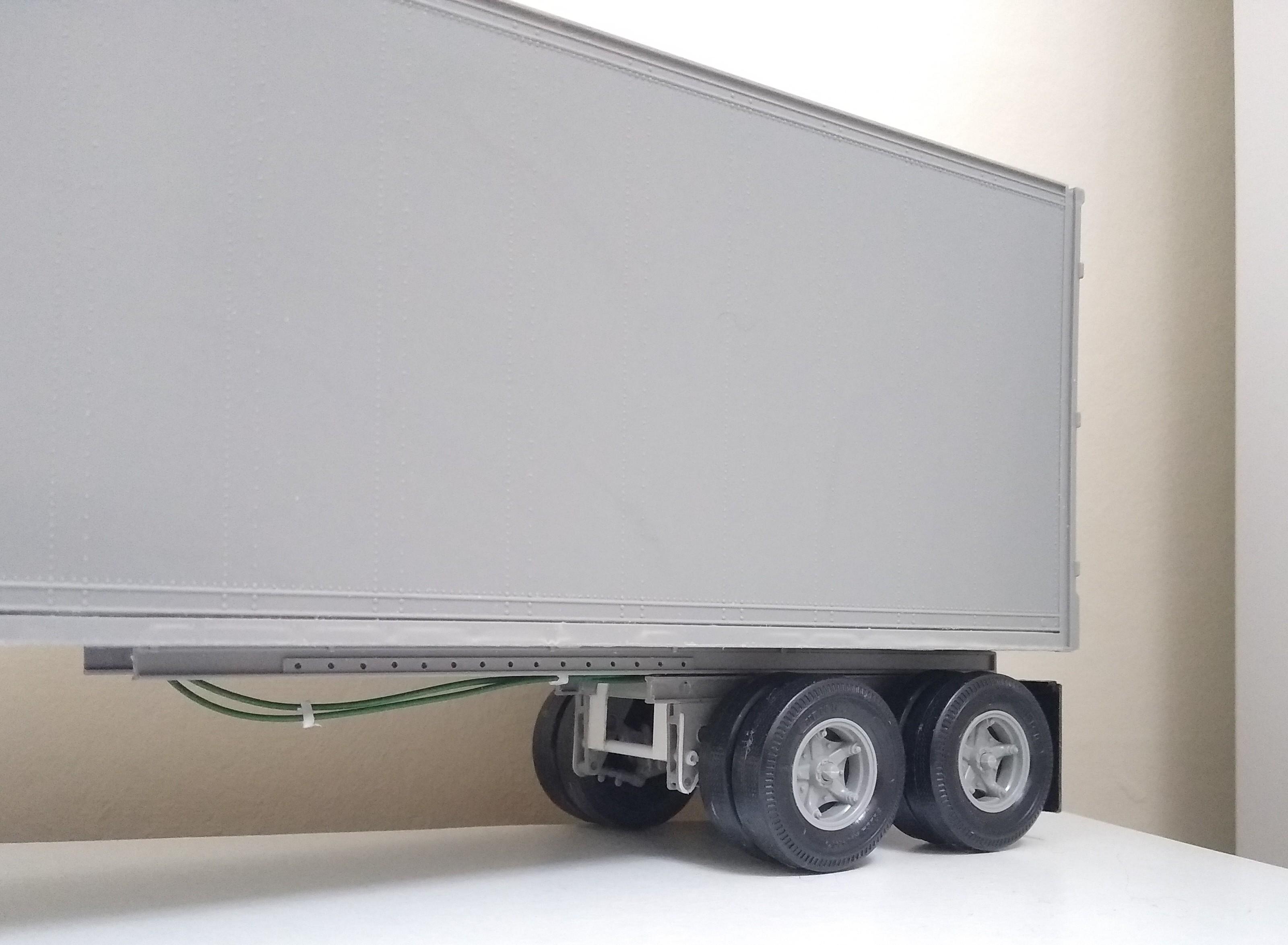

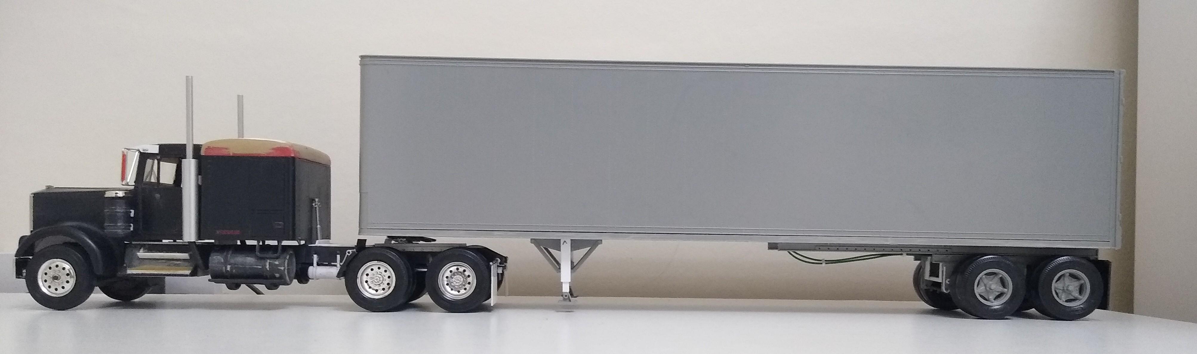

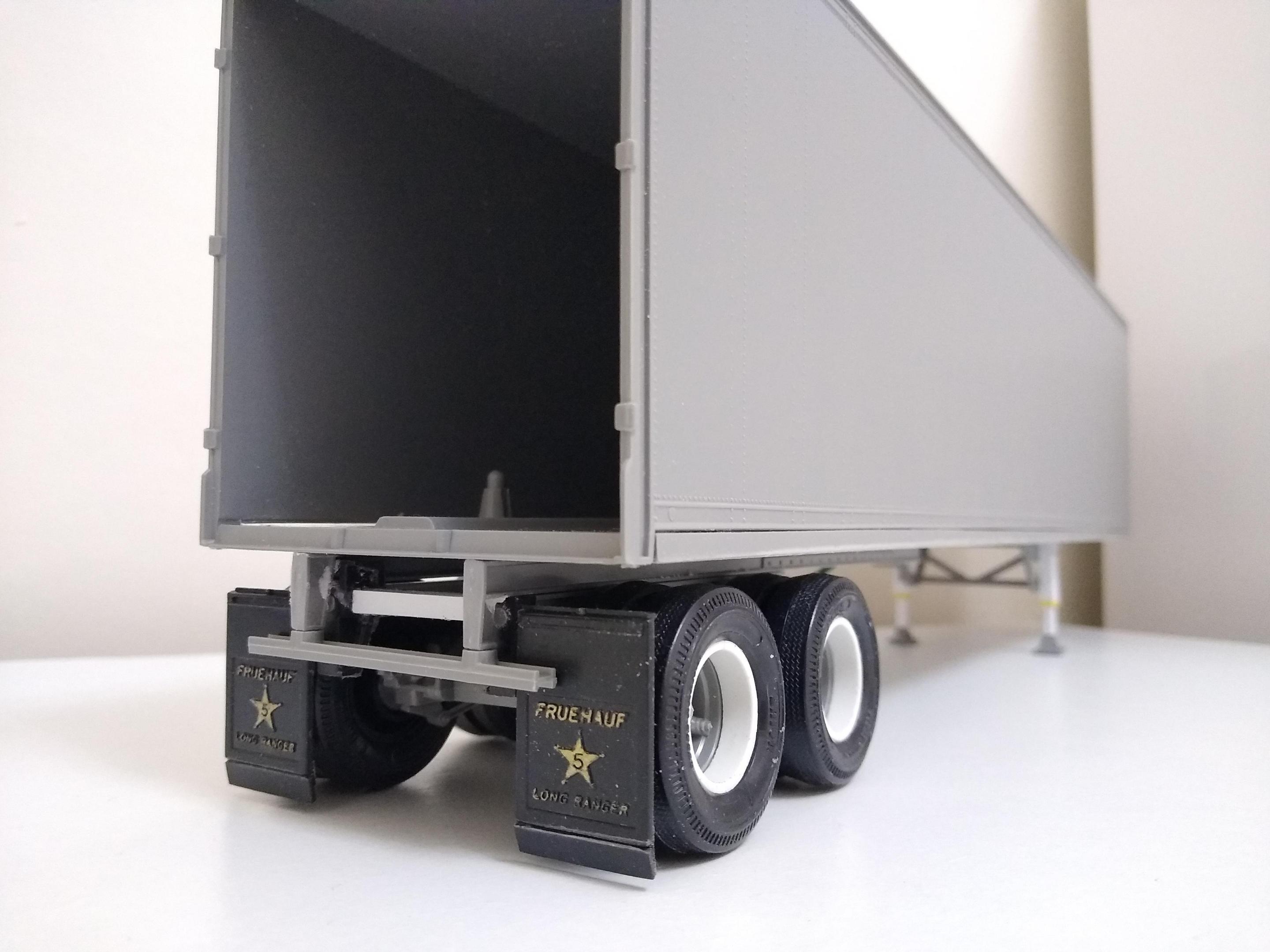

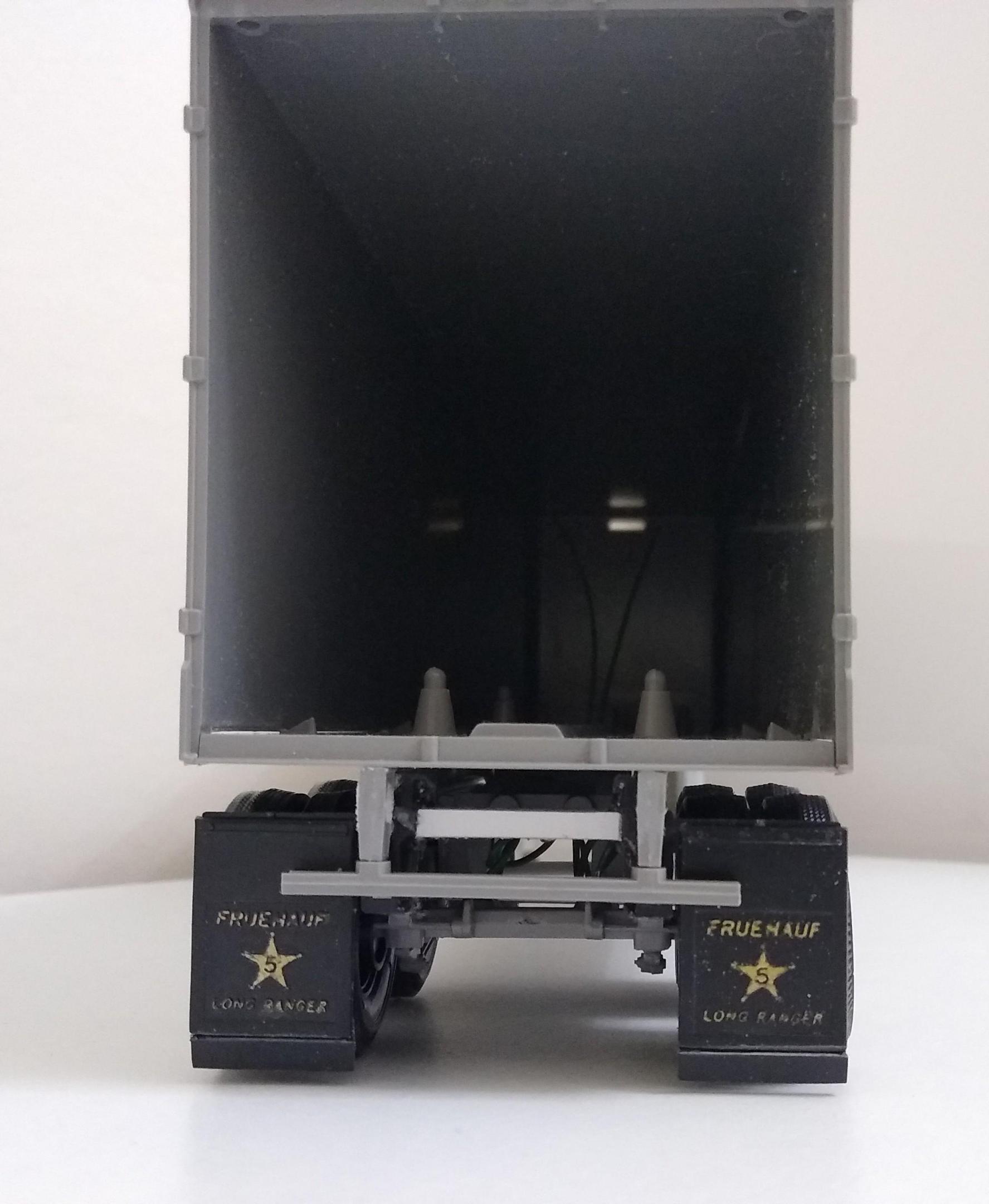

Piped up my tandems, did my usual alterations to the landing gear to make it functional and just had to mock it up. I know it's a minor change to the rear suspension but to me it makes such a difference. I'm very pleased with it. Still a lot of work to do tidying up and making things fit but I think I've caught the look.
  • Like 2

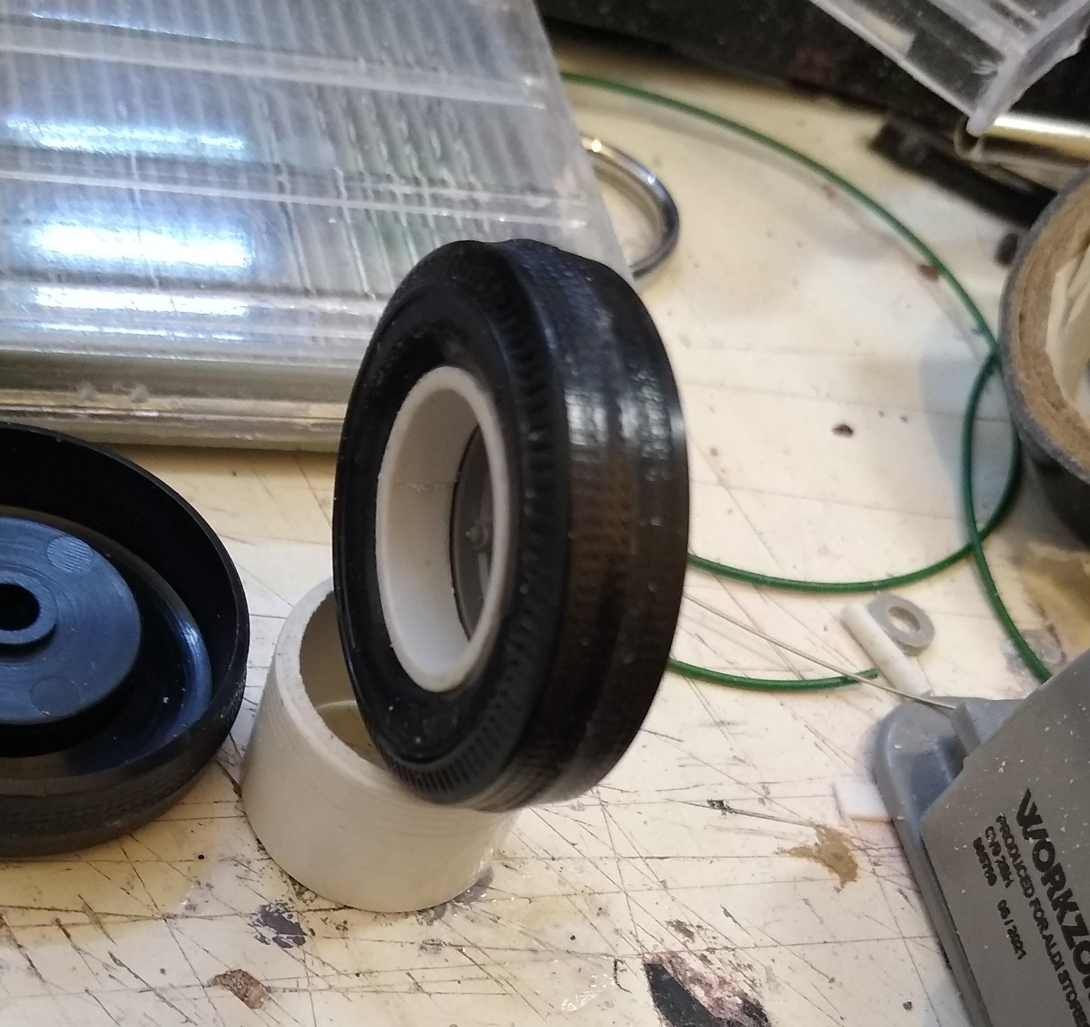

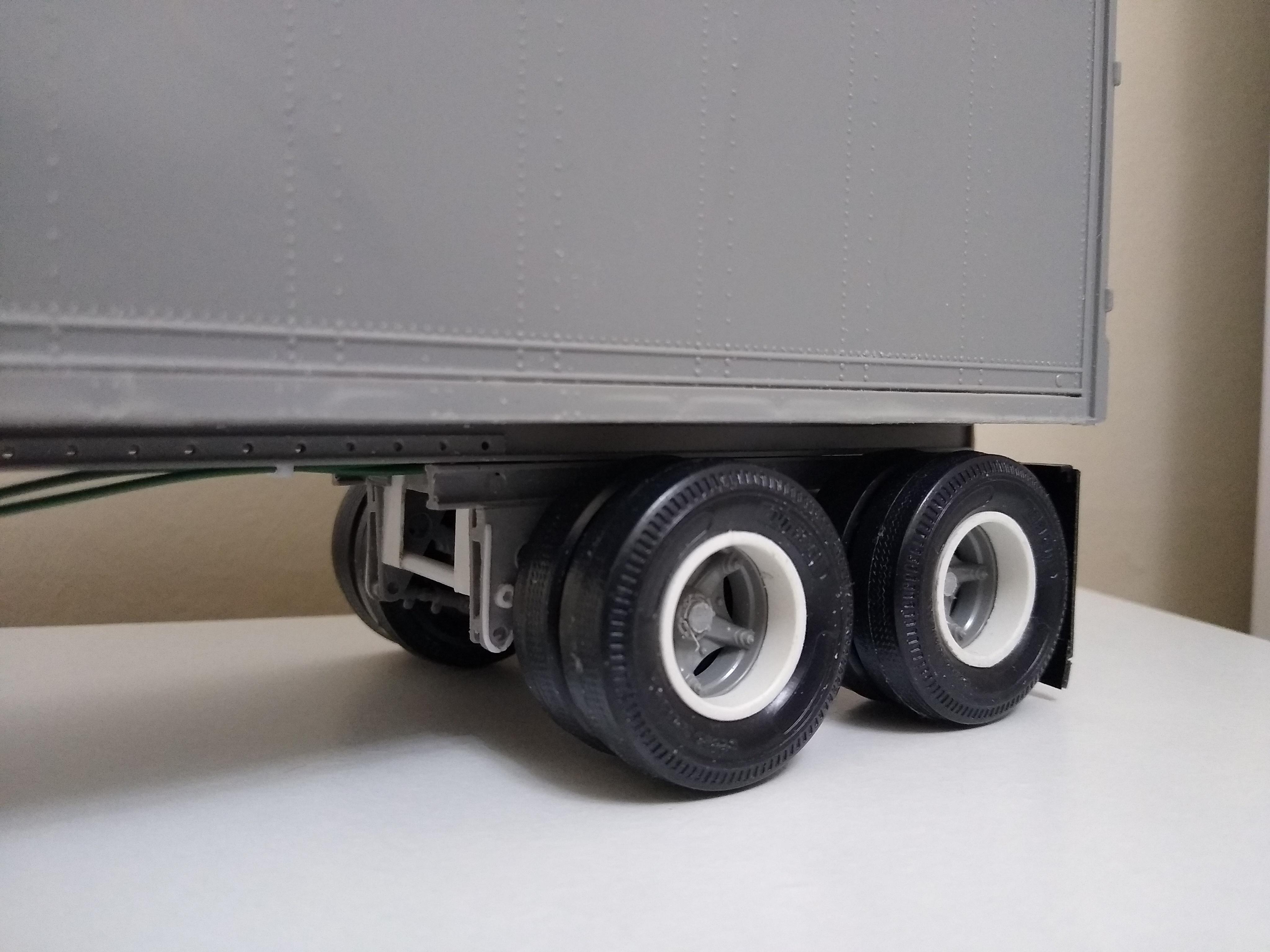

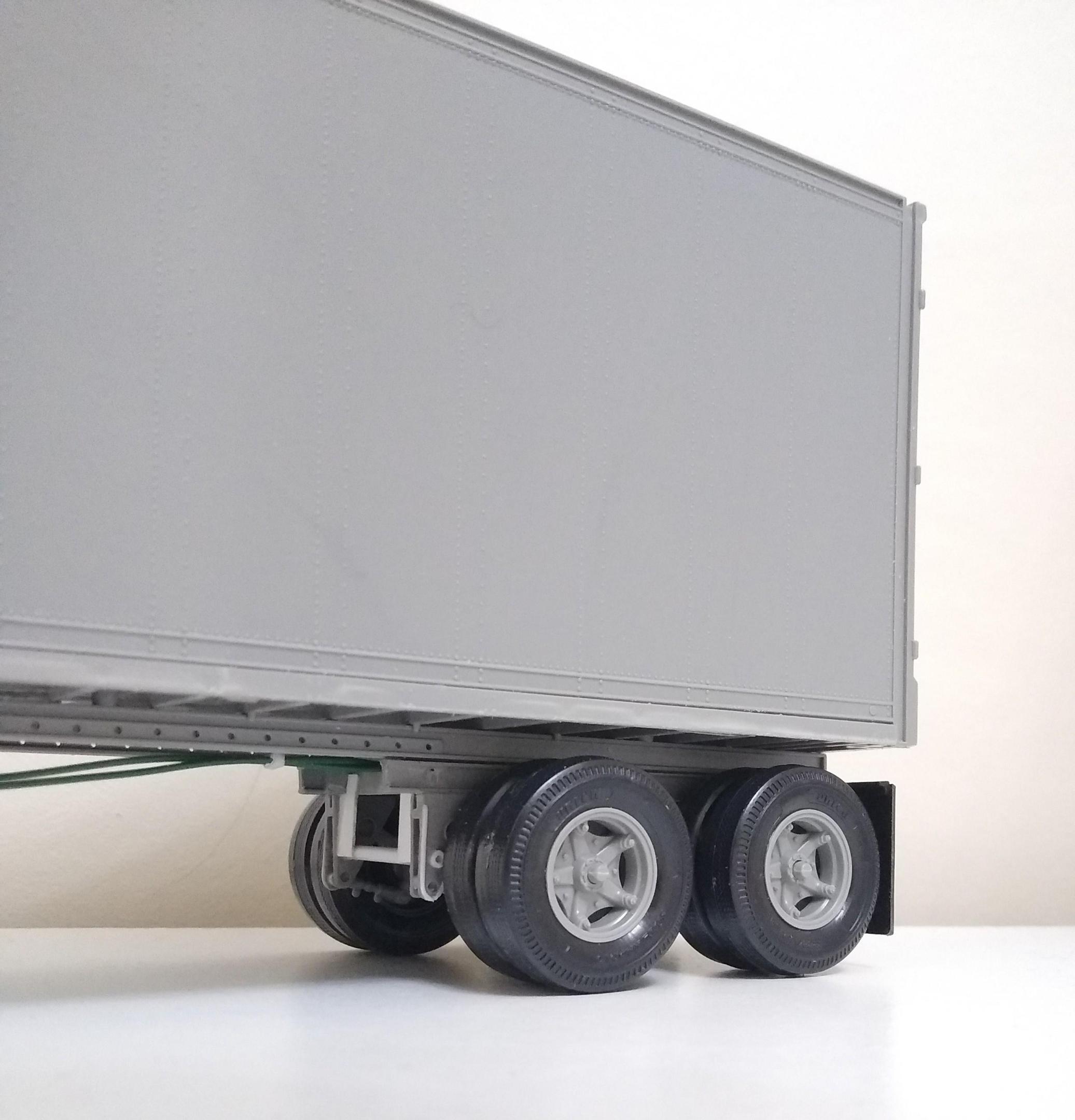

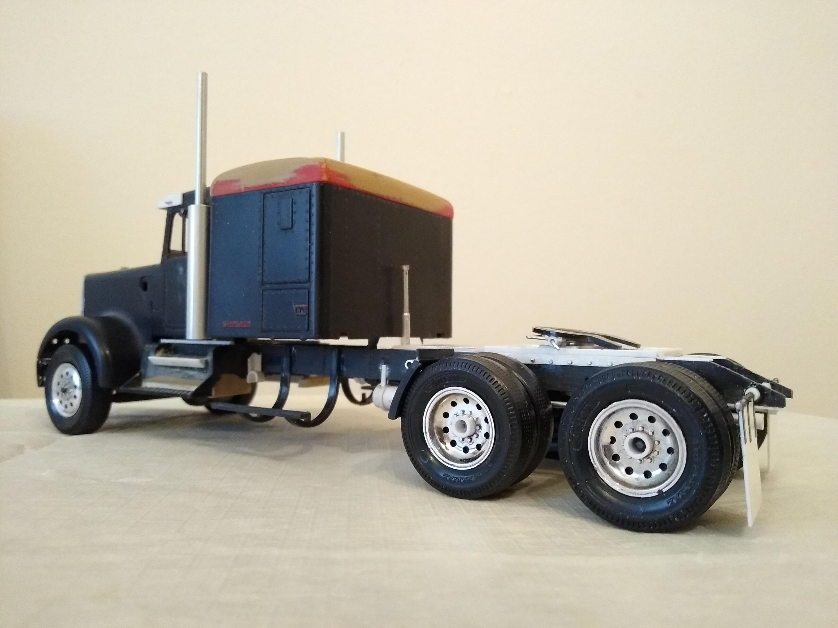

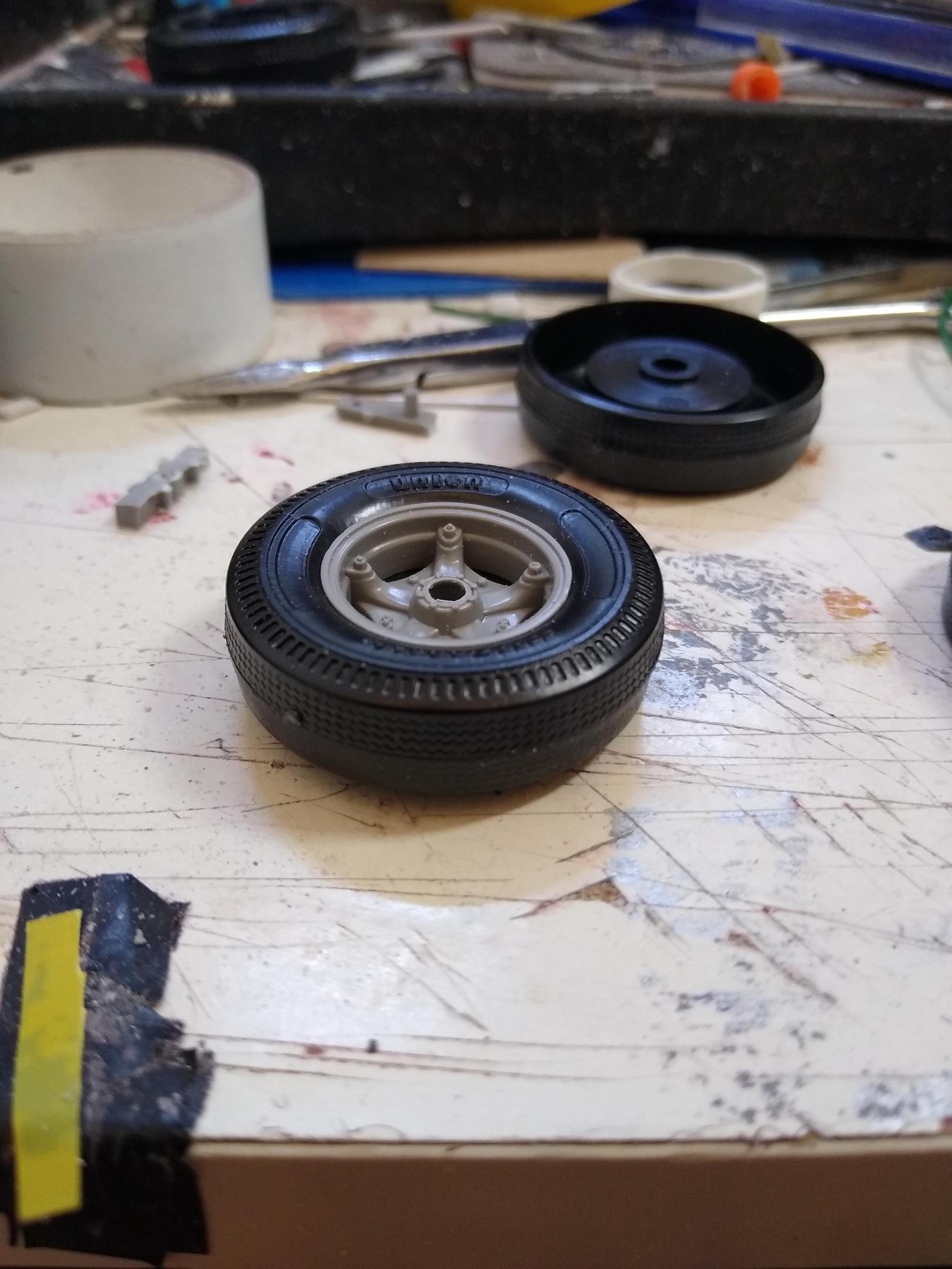

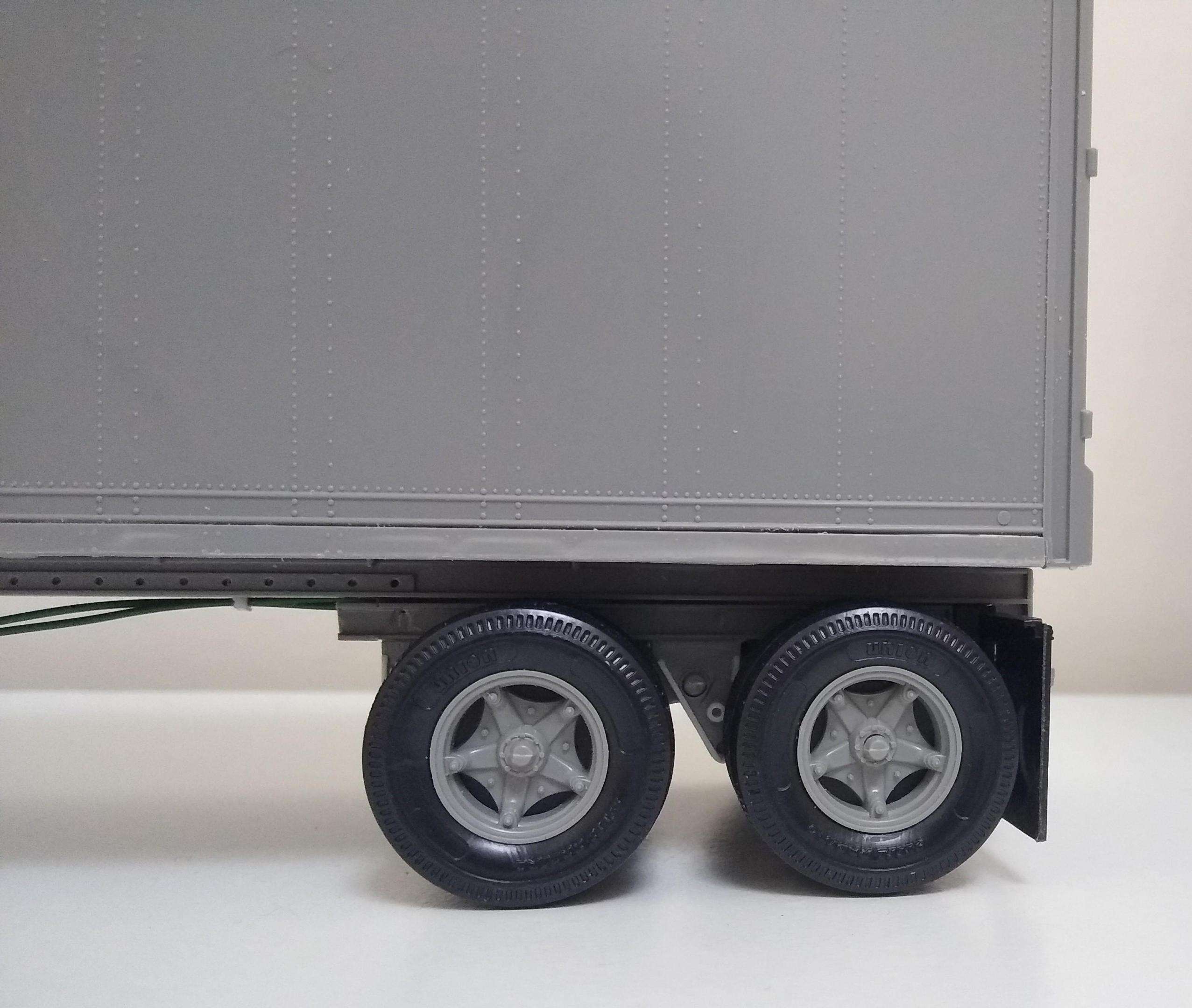

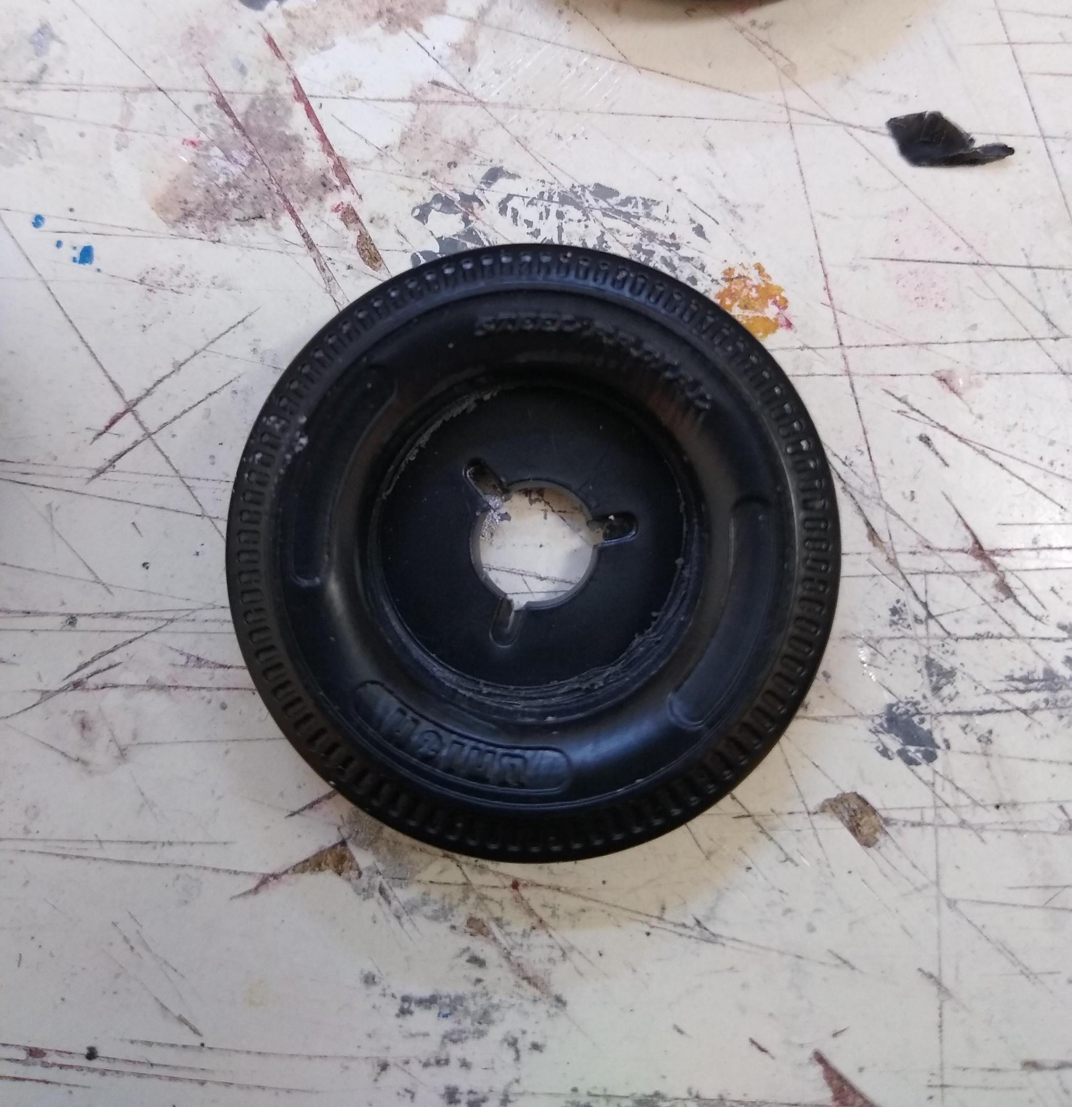

I decided I had to do something about the wheels on this trailer because the shallow wheel moulding really spoils the overall look of the model. I've often considered doing it but always chickened out, not this time!
The 5 spoke wheel is so well cast so I want to keep them, I just need to recess them to the correct position between the two tyres. The outer tyre has a flat backing that needs to be removed so the wheel move inwards.
Took the boss down on the back by about 4mm and shortened the stub axle to suit.
Then I needed a new wheel rim. I used 20mm electrical conduit cut to 5mm slices, then split it and took a section out so that it would fit into the 18mm wheel opening. I made them really tight so that they push themselves round and leave no gaps. The joint between the wheel and the rim just look like the strengthening rib in a rim.
Boxed them up, what a difference! I'm really pleased with them. I should have done this a long time ago!
Also added a square crossmember at the rear and cut the rear pan-type crossmember away. There's only one thing missing now - a side loading door. Thinking to be done.
No I'm not going to do anything about the tyres.
Edited by Rockford
Text editing
  • Like 3

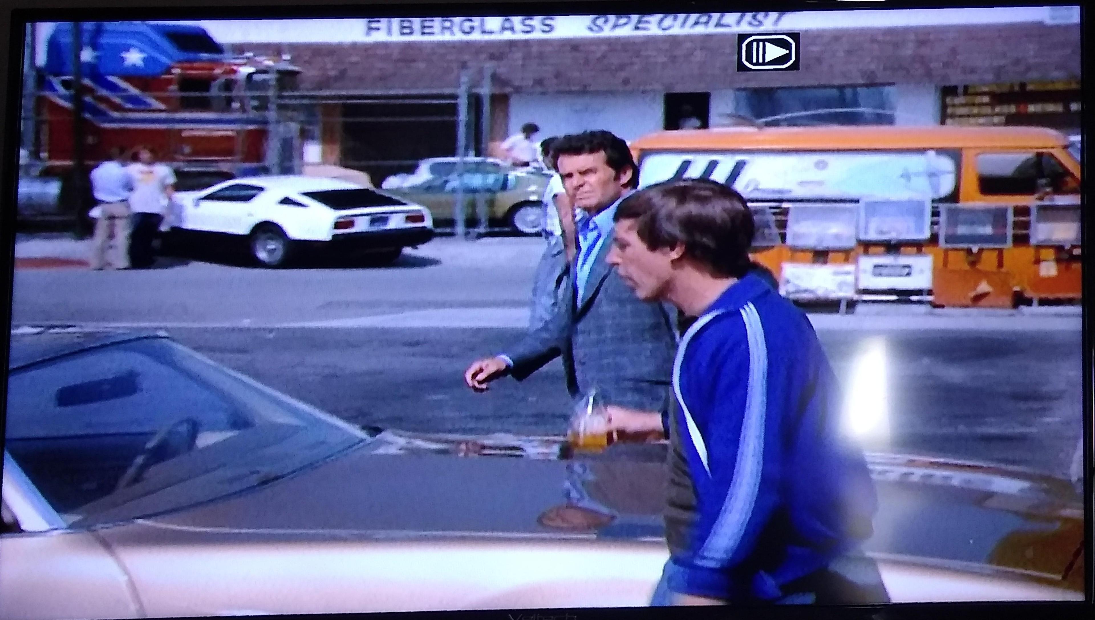

Watching The Rockford Files (obviously, I'm a fan) and I just glimpsed this gorgeous K100 Aerodyne in the Fibreglass Specialists, among the exotica. Never noticed it before. Nothing to do with the project but never mind.
