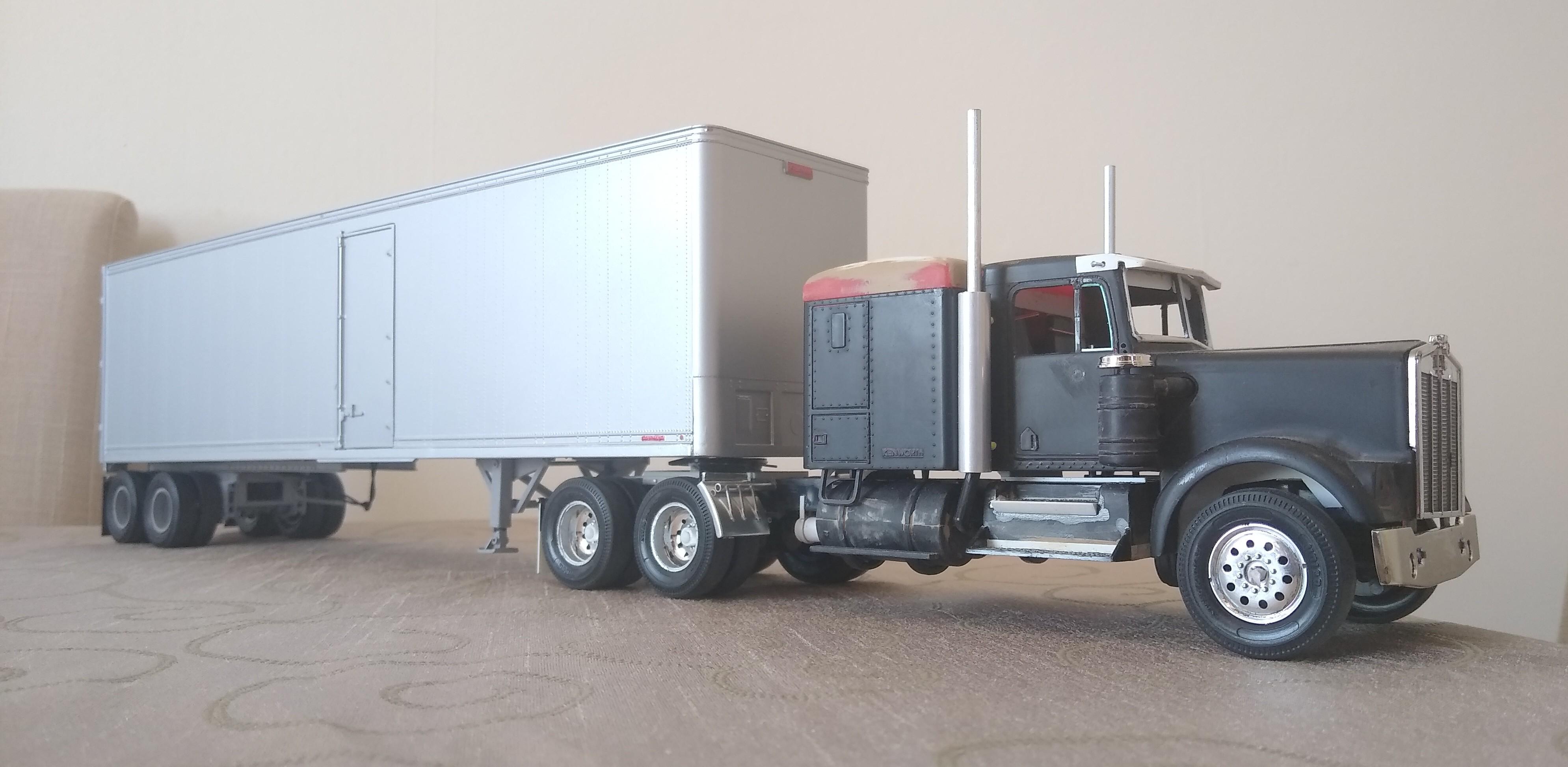

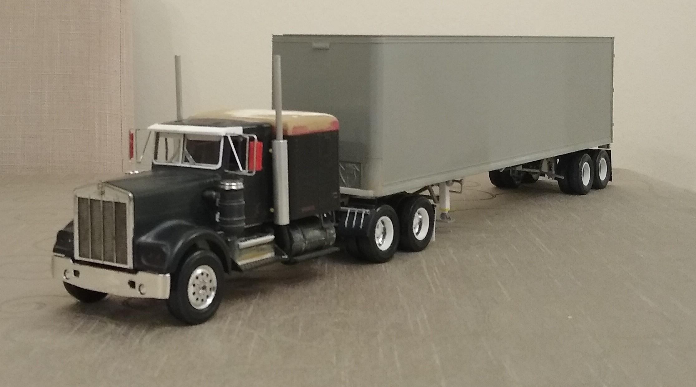

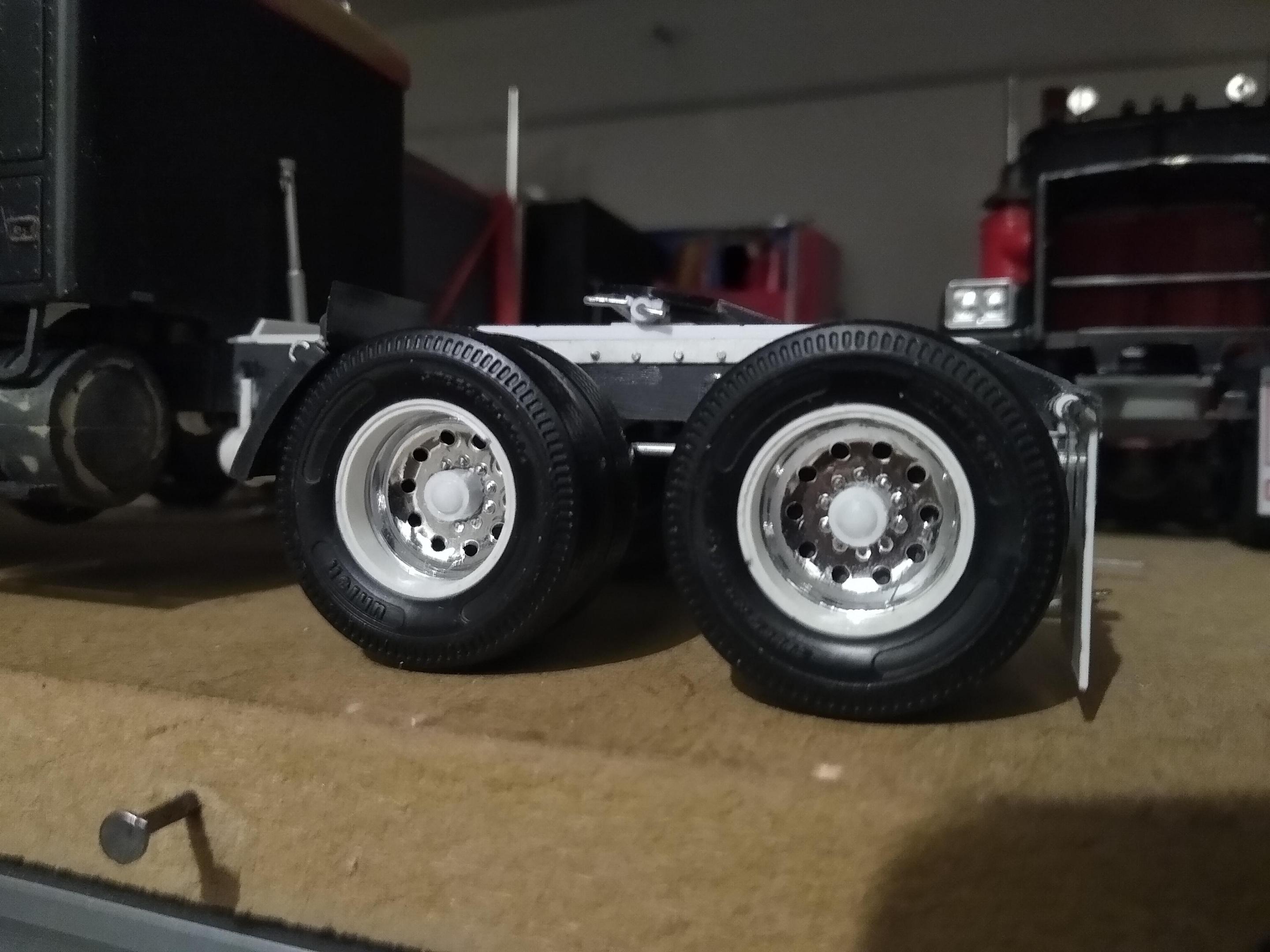

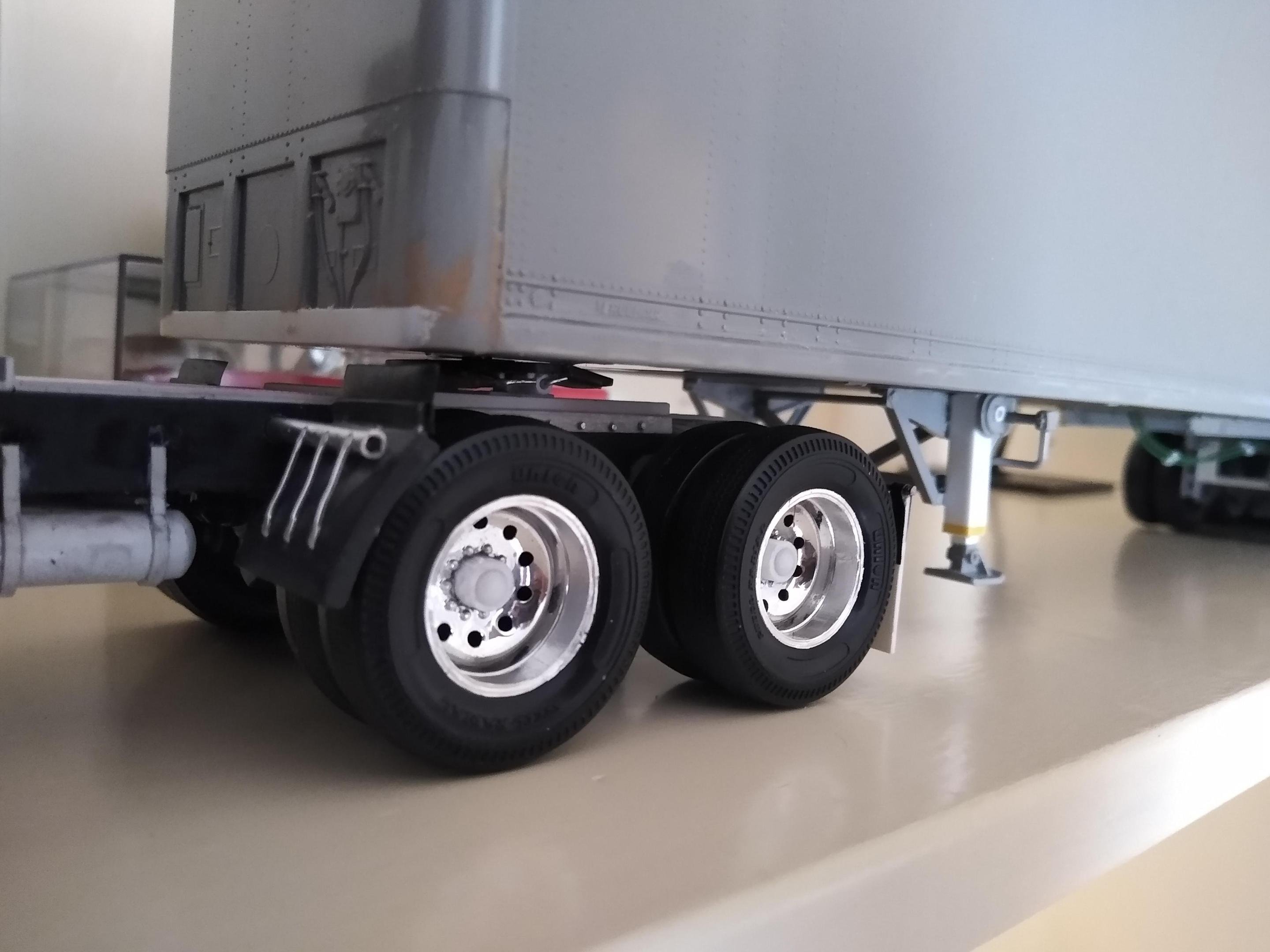

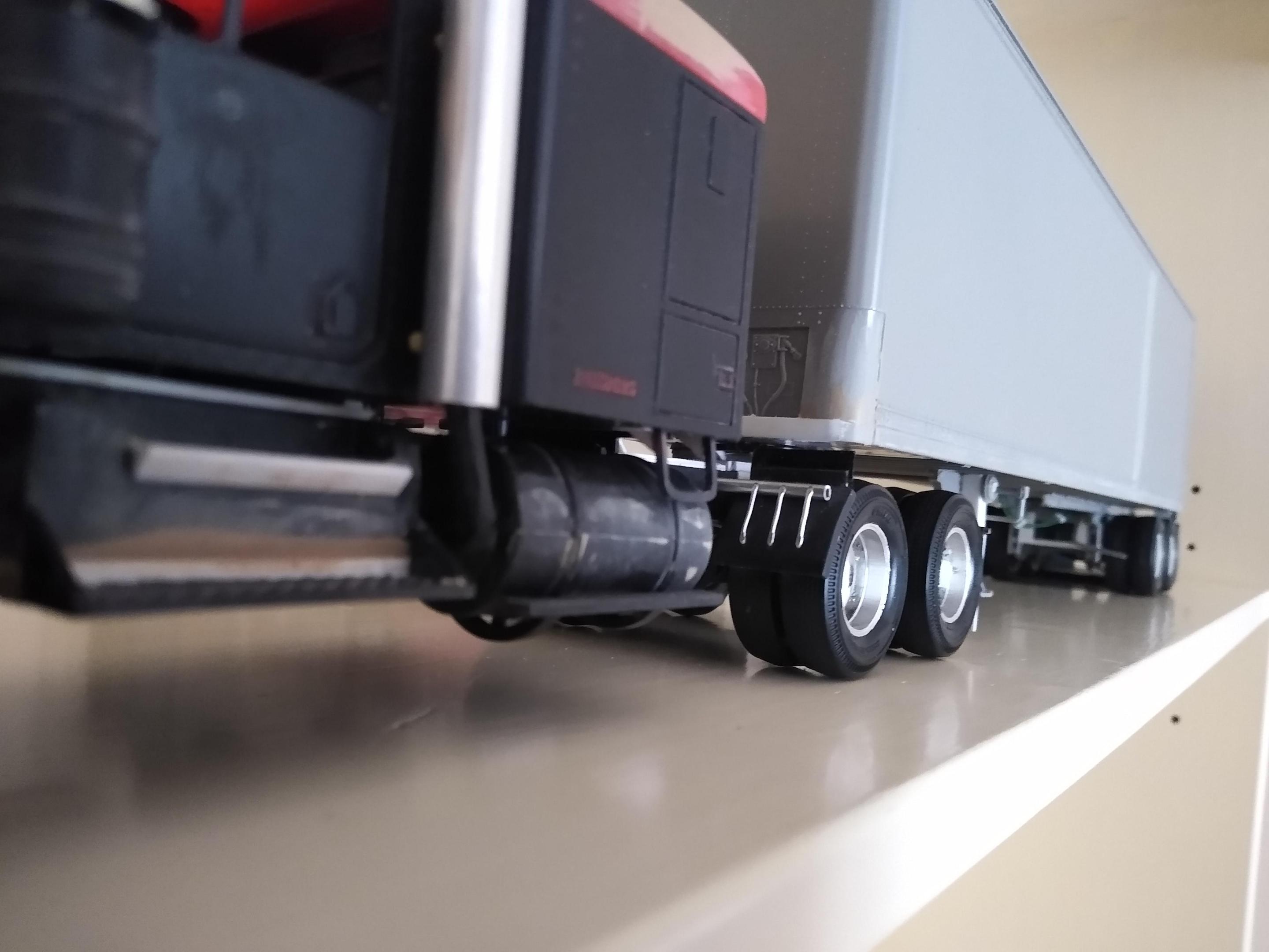

Well Håkan I took the leap. I had a "spare" set of drives on a built truck I only paid a few quid for so I used them. I did the same as the trailer wheels but used two strips of 0.5mm plastic card, one inside the other, to create the lip on the edge of the rim.
Used BMF on them and they marry up to the kit wheels very well. Added drive hubs too. At last, a 1/32 with wheels that look right (almost). I suppose Sundance deserves the best.
IMG_20231226_135049135.thumb.jpg.aa0afd683ffcebf614cc6b27f33f7ce0.jpgIMG_20231226_135040509.thumb.jpg.30f2cc0d5928537b951df25b5e0765e8.jpg
In the last picture you can also see the adjustments I had to make to the lower rail on the front bulkhead of the trailer. The is proud at one side and too short on the other so I added a strip of plastic across the front and then sanded it back.

See, it wasn't that hard was it, I had faith in you and thought you could pull it off when I saw what you did with the trailer wheels.?
This looks way better than the old wheels.
So you did a good job Steve
I do not like the wheels in Revell-Monogram snap kits, not in this scale nor in the 1:25th scale, they are awful representations of truck wheels that doesn't look realistic at all, they look more like wheels on a toy than on a model.

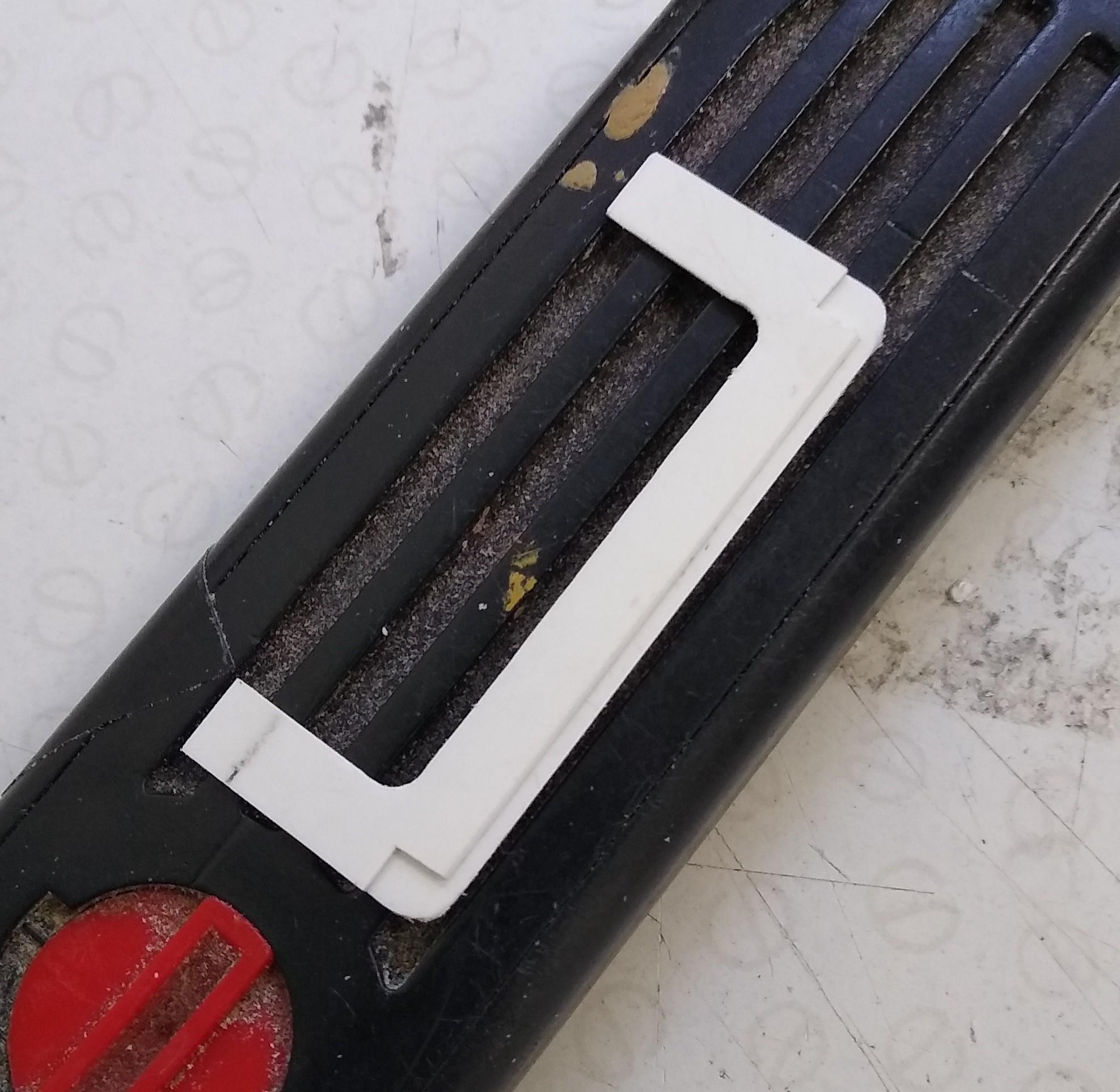

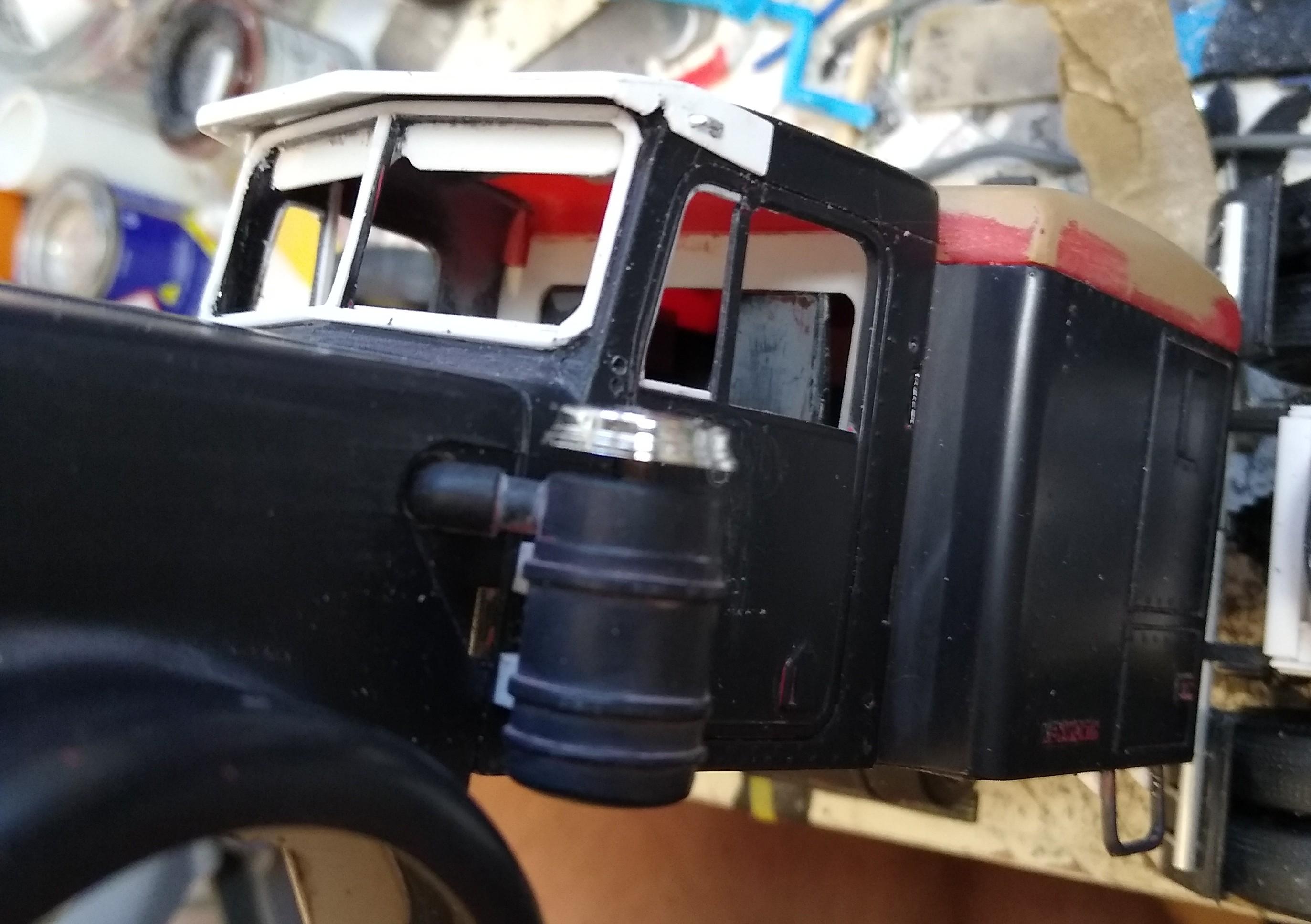

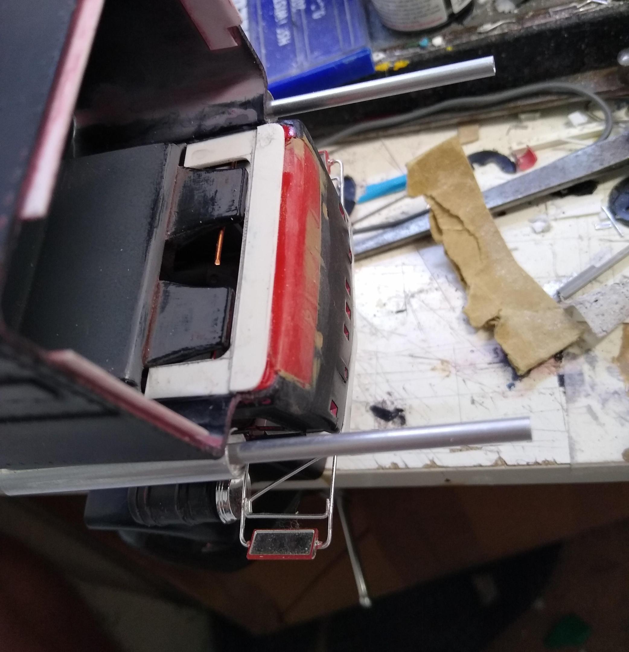

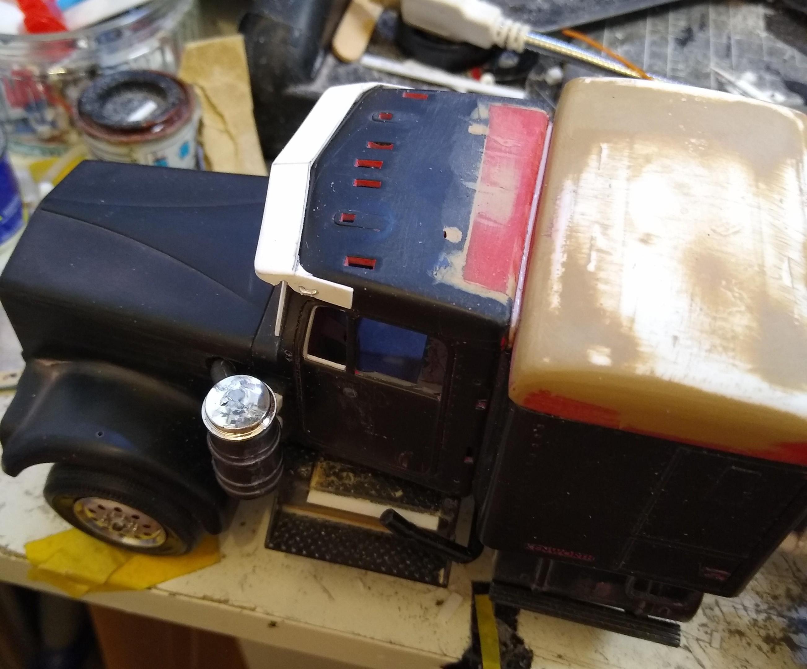

It's been six weeks since I was able to touch any of my projects and I've been getting out of the habit so I pushed myself to do something today.
Made an upper bulkhead for the sleeper access and fitted the sleeper cap. The bulkhead mimics the gasket between the two. I'm going to make some decals to represent the diamond buttoned interior upholstery.
Did some remedial work on the tyres and added the quarter light rubbers (in 0.75mm square strip) to the quarter lights.
Not the most dramatic day's work but has to be done before paint and it's got me moving again. As we hit April, suitable conditions for painting are almost here. Weather in GB has been atrocious, cold, wet, windy for months.
  • Like 3
You are doing some extensive fabrication for sure!
Given 1/32 in scale, I am sure everything is going to be smaller and less tolerant when it comes to customizing and fabricating parts to fit.
Looking at the photos, things are fitting quite well and I think you got everything going well!

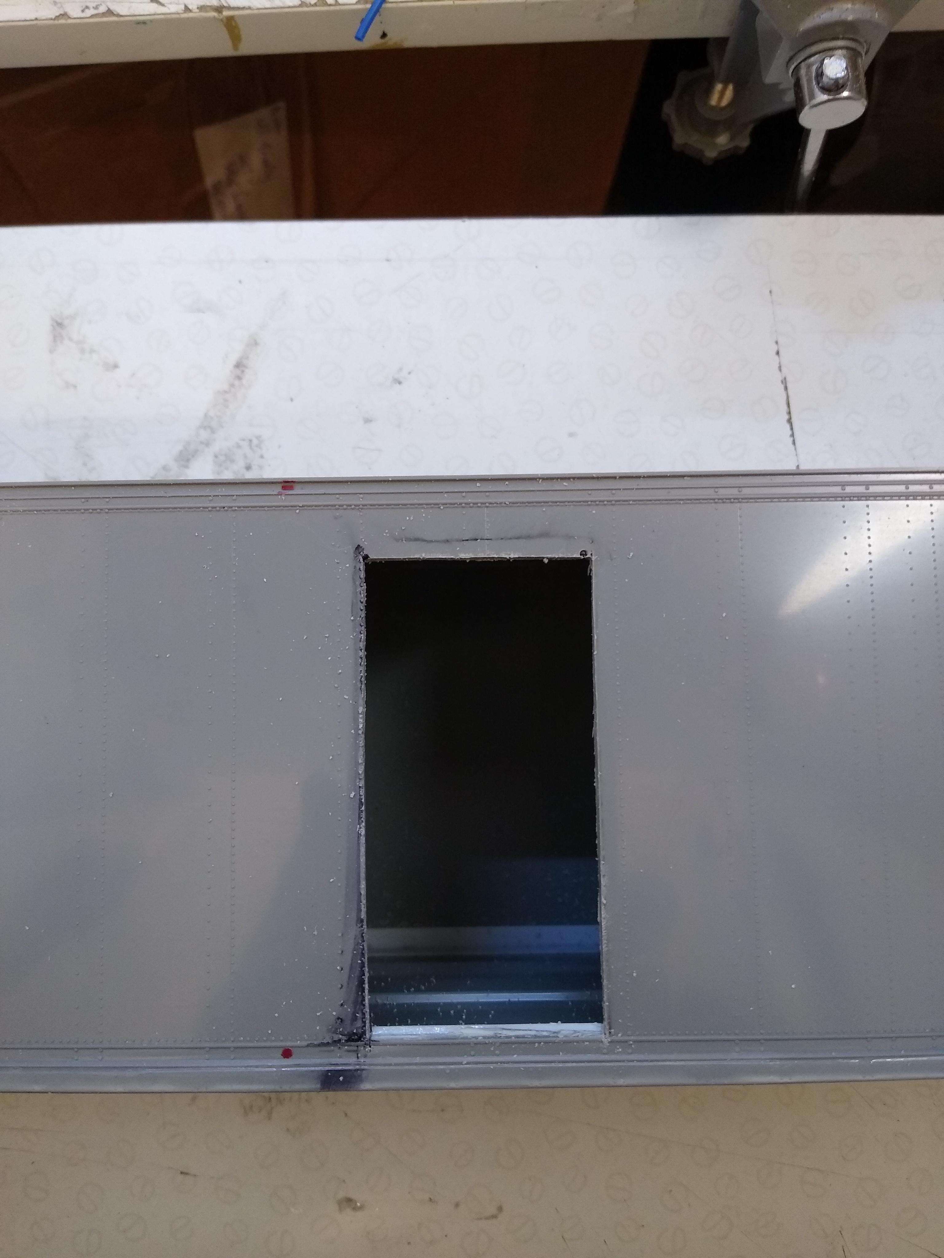

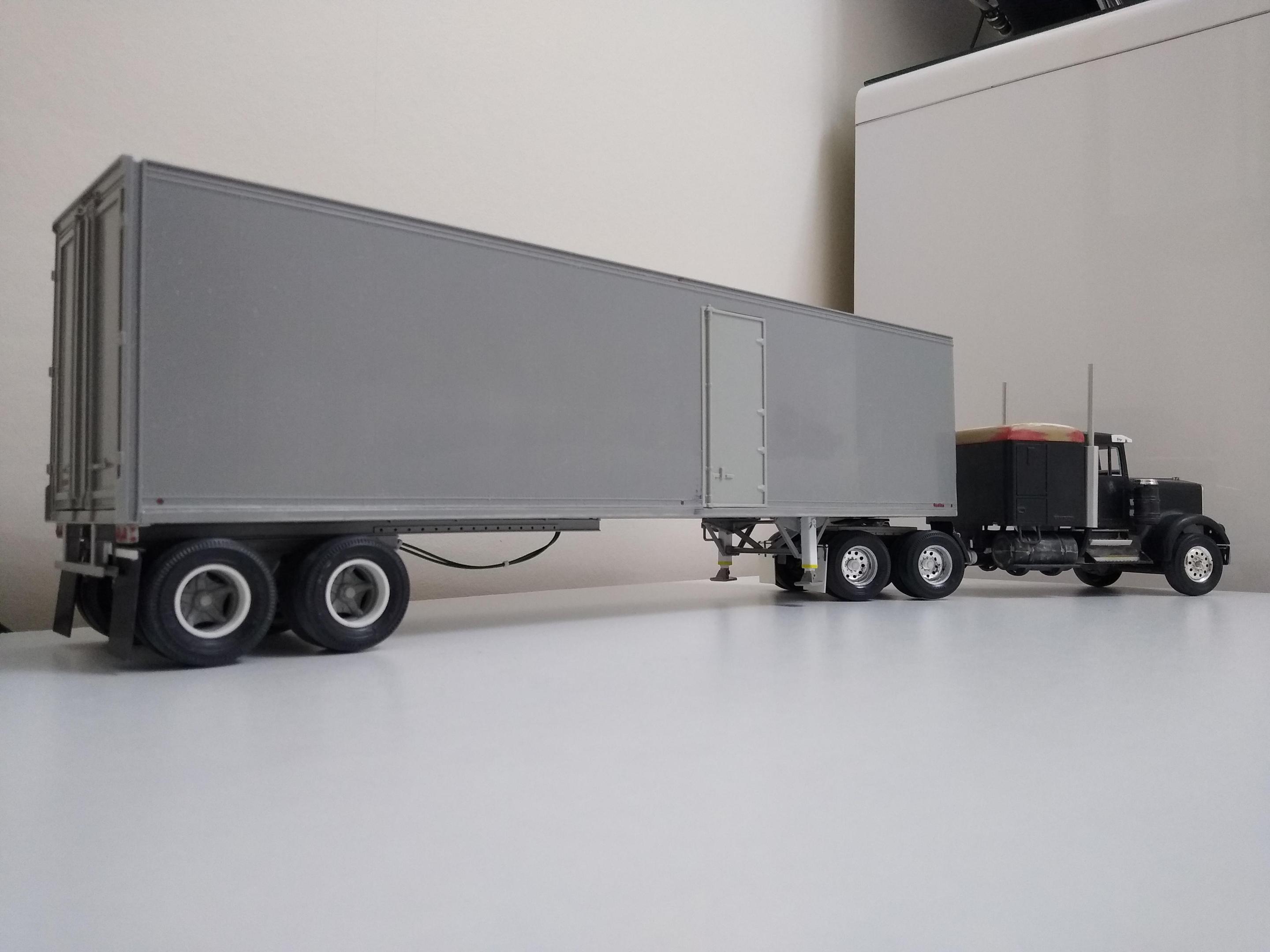

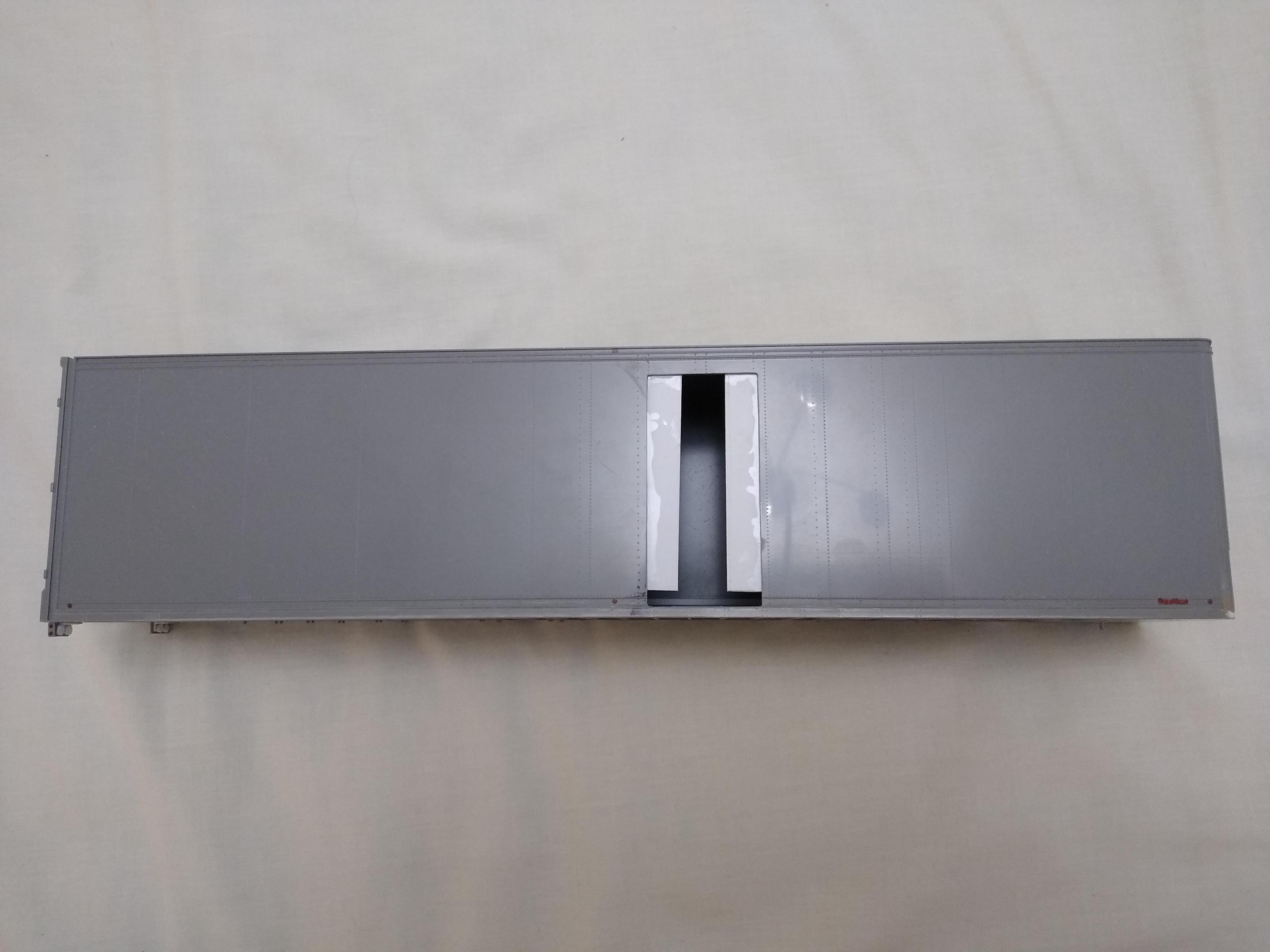

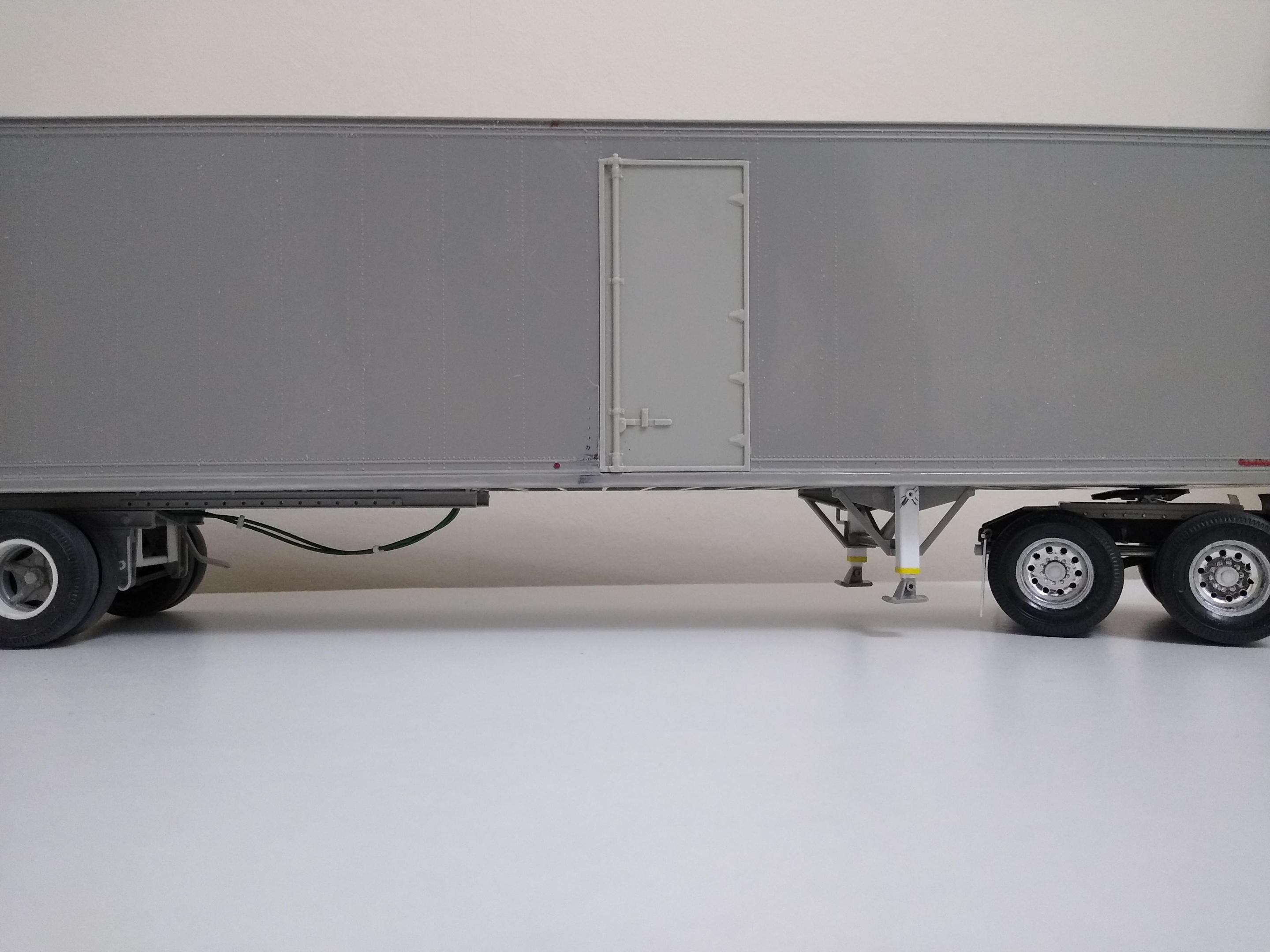

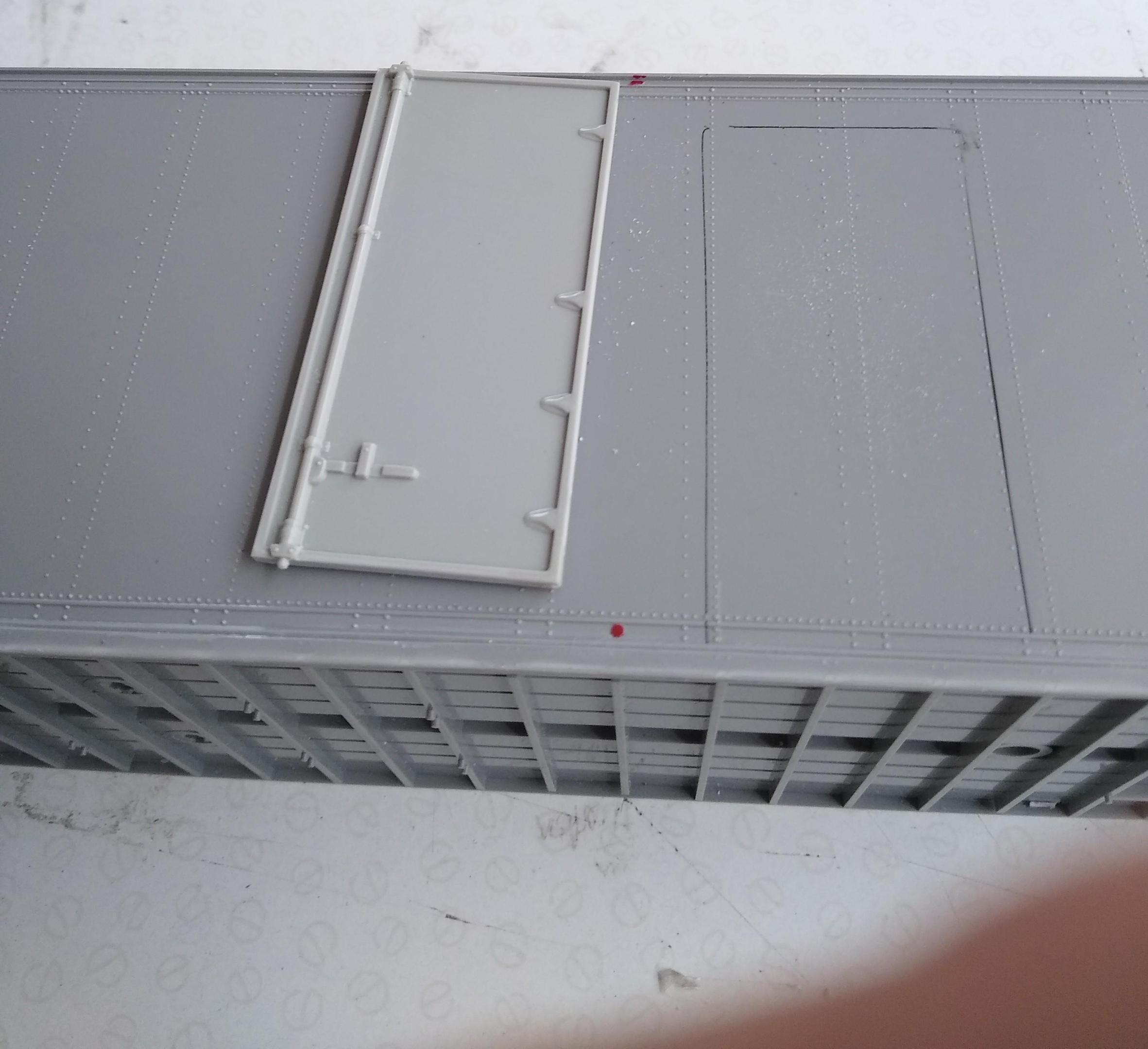

Force and I were talking about trailer colours for Sonny Pruitt's rig (the van is bare aluminium but my query is the chassis: silver or grey?) and he reminded me of something that's been nagging at me for a while. The trailer had a side door, the Monogram one doesn't.
I'd considered laying one out in plastic strip but I wasn't happy about making a handle, the lock bar, the hinges etc ... The Fruehauf doors are too tall because the side doors are smaller and couldn't be cut down tidily. Then I realised that, of the two AMT Trailmobile doors I'd saved recently, I only need the LH one, the RH would be perfect for the job.
I marked the van where the door opening is and then gently scribed the lines with a knife. Took a hobby saw and gently dug into the cut until it went through, then took the cut to the limits.
The opening was purposefully too small so I could use the door as a GO-NO-GO guage until it fitted all round.
Two pieces of card stock behind for support and plopped the door in. Still needs the reinforcing piece under the lower rail but looks good to me!
  • Like 6

Wow! How did you manage to make such an exact sun visor?
Jürgen, I honestly don't know how I managed it. I did use the AMT 1/25 version as a pattern for my angles etc... and reduced the size accordingly for 1/32. It took a full day though.

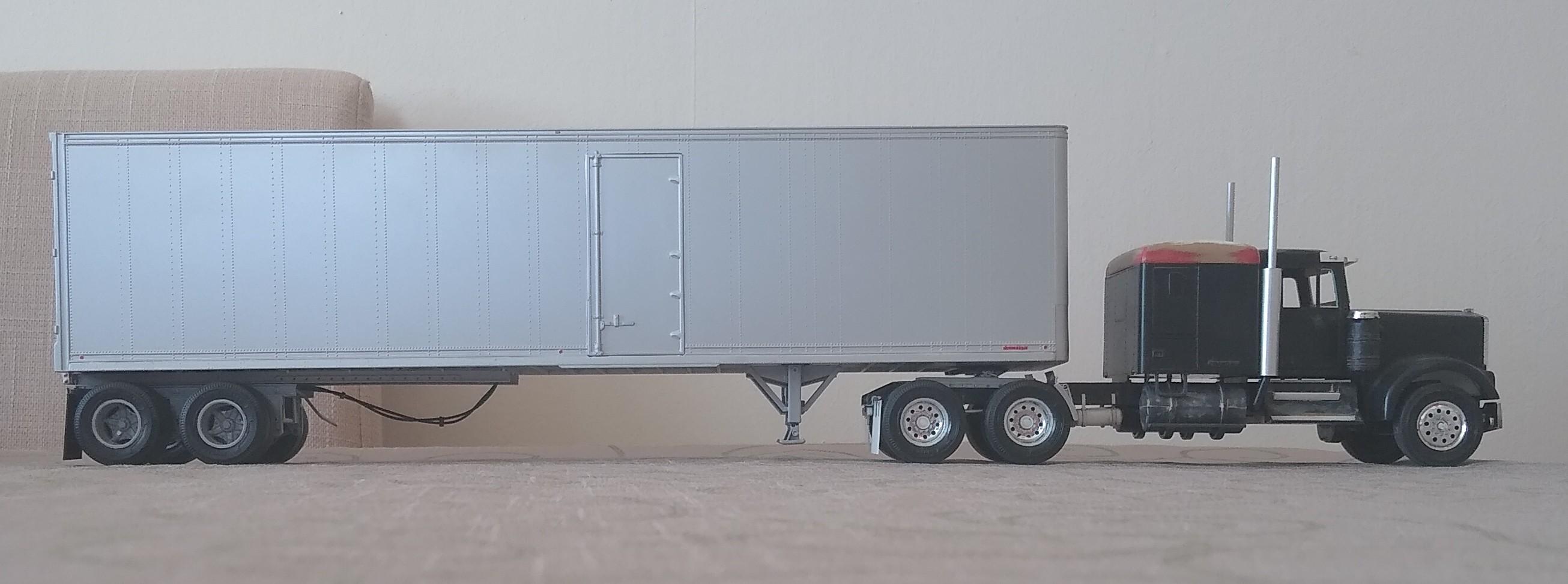

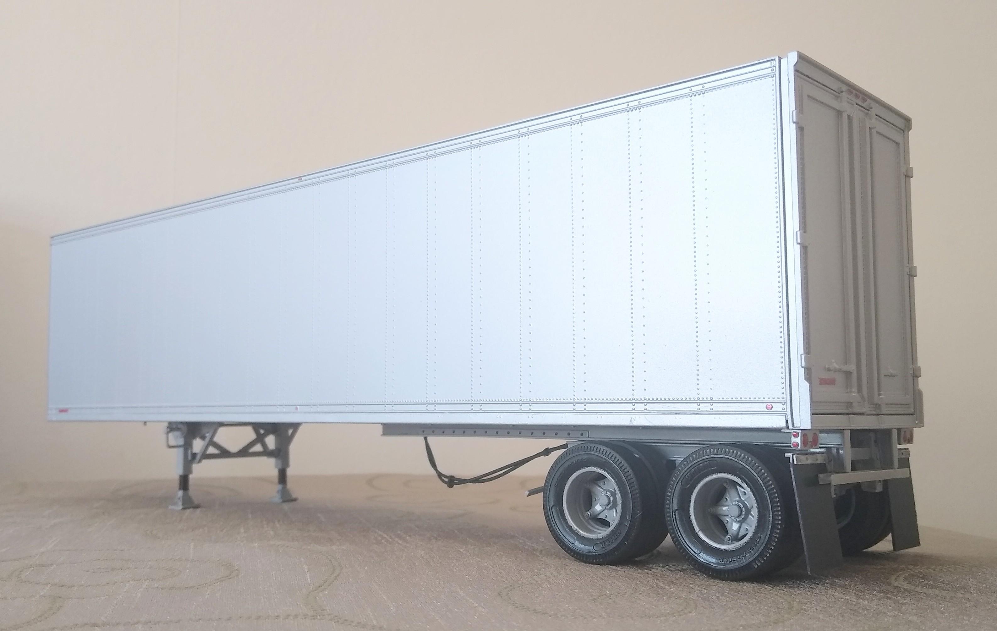

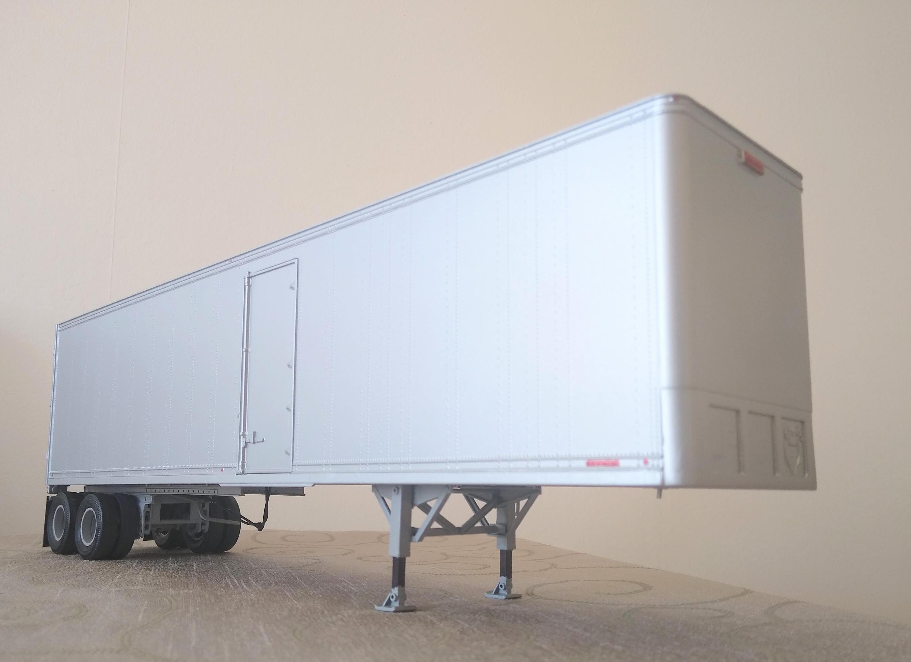

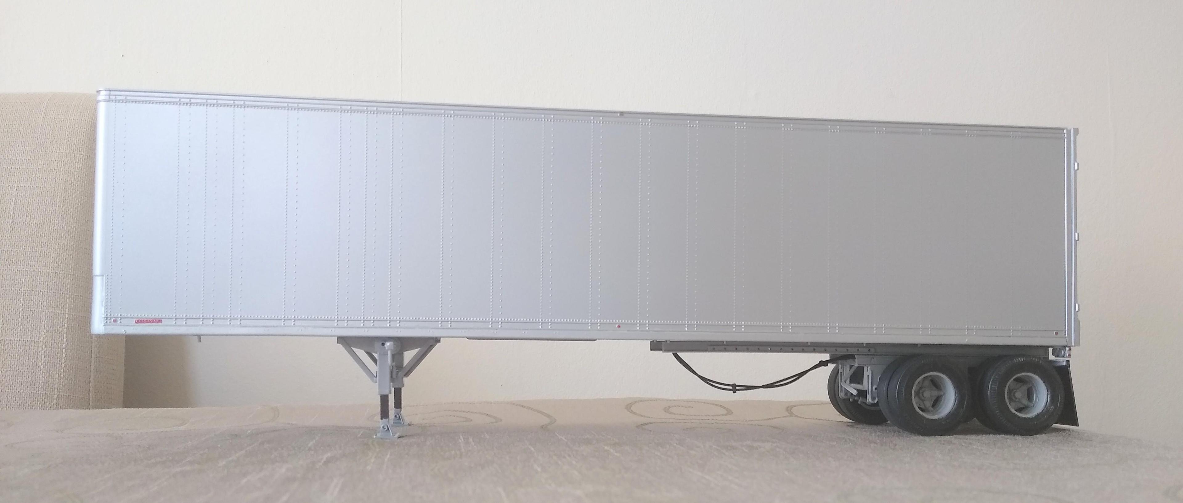

Besides nearly ruining my Trailmobile last week I also managed to get Sonny's trailer painted. Left it all to harden for a week and boxed it all together this afternoon. Looks good to me. I like the F2 lightweight suspension and the deeper wheel rims. I'd have loved to have painted Sundance but I need to get some grey primer, I don't want to take a risk with that rubbish I bought for the Trailmobile.
  • Like 2
