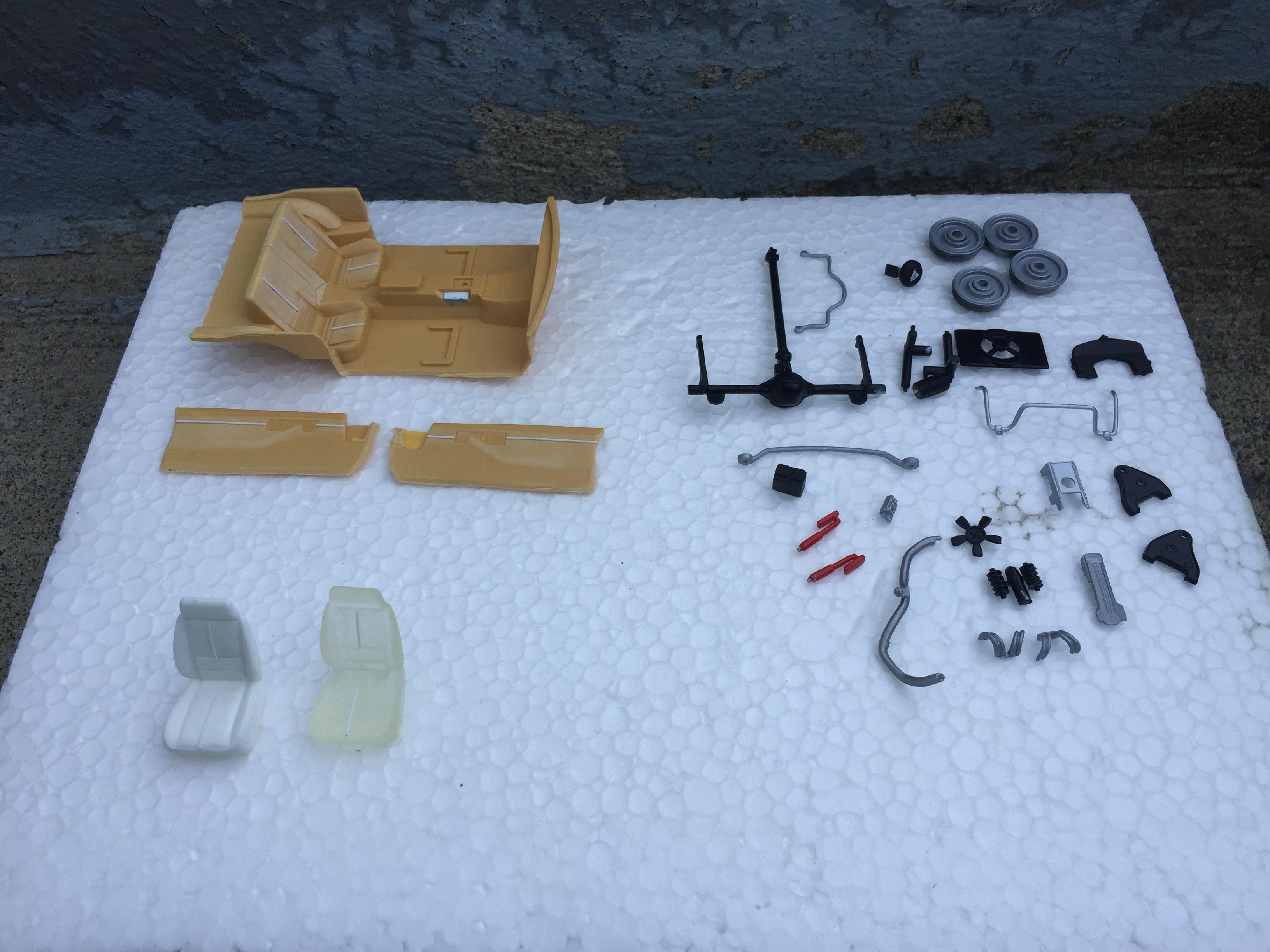

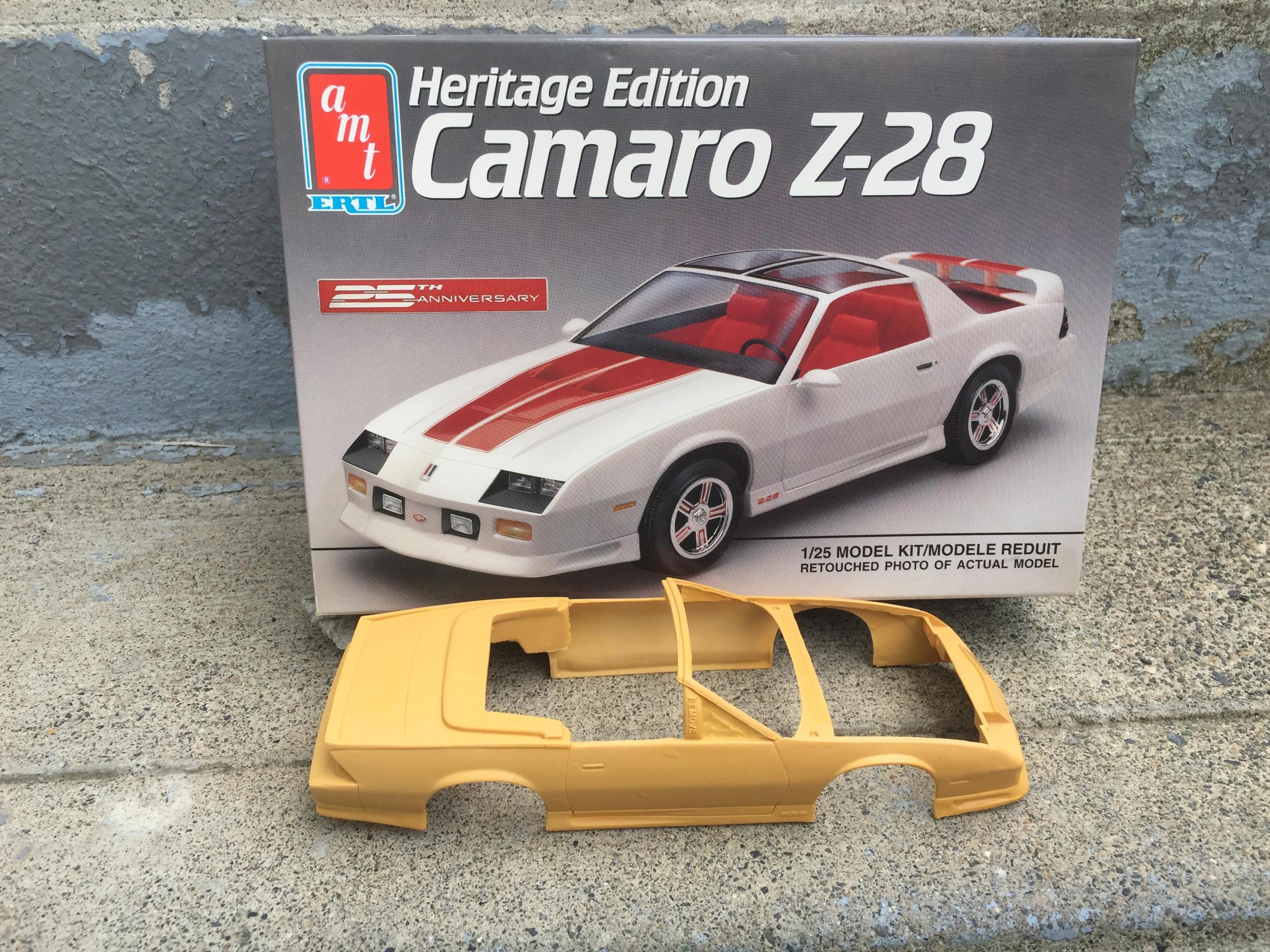

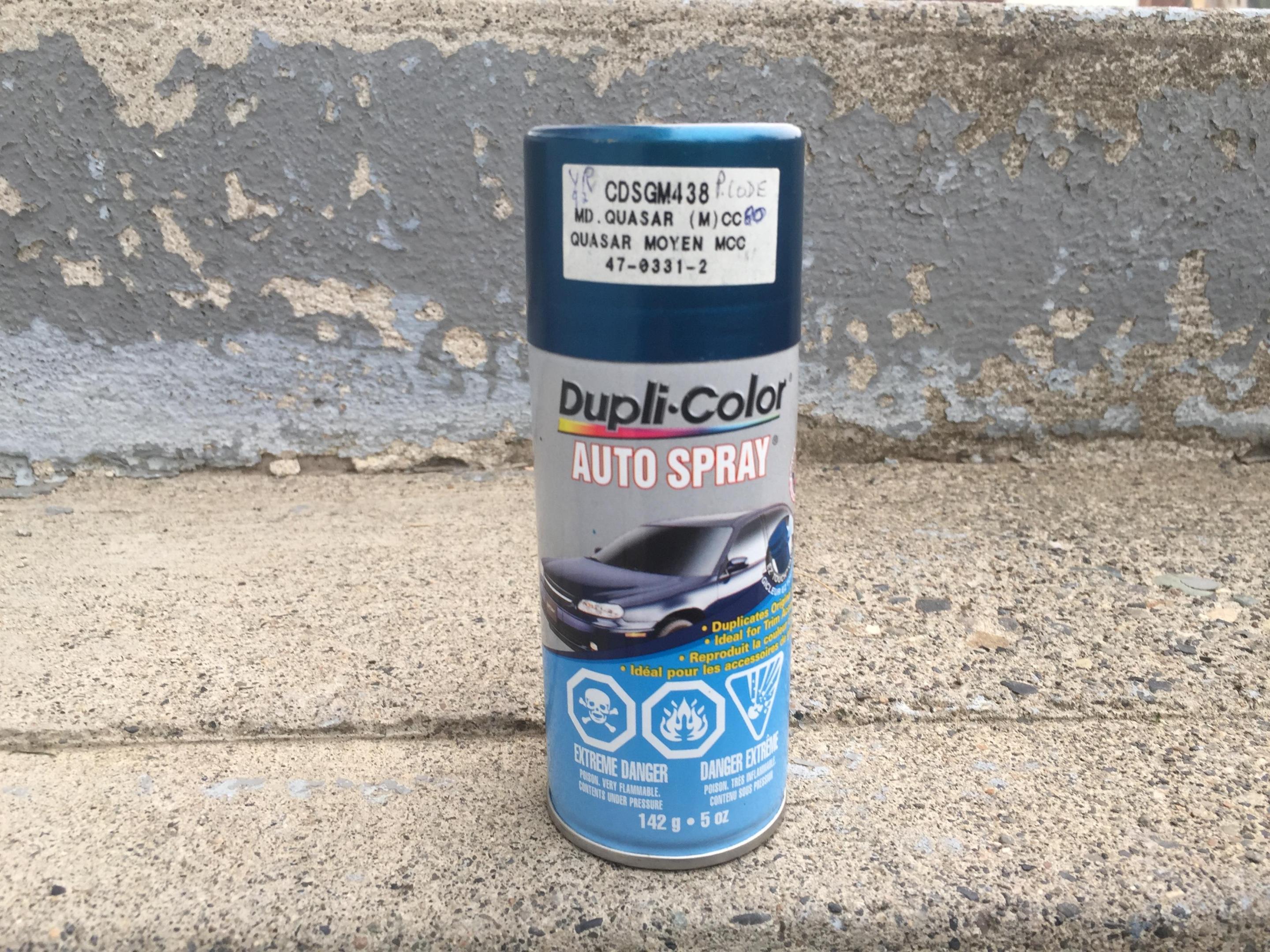

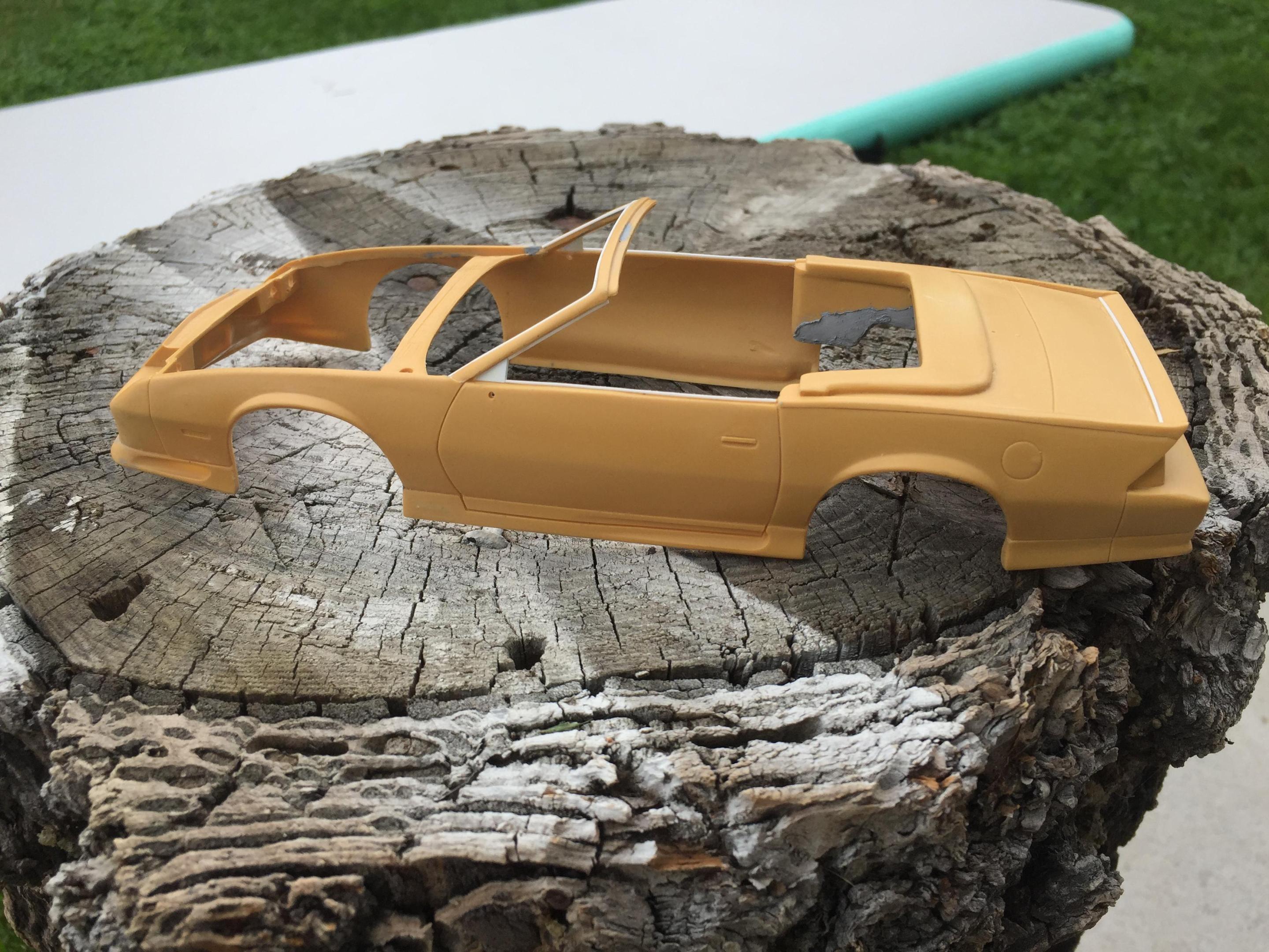

Hey everybody a new build i started awhile ago,but is a slow WIP,building a replica of my 1:1 car using a transkit i've had for awhile.I have an Original transkit from All American Models,but i misplaced it in my stash?.but i've got a few knockoffs in my stash so i'm using one of them. IMG_6002.thumb.JPG.7ee2979f8415dbfbd53ad4571c5ccf76.JPGIMG_6011.thumb.JPG.d6256f4b68f1fca13ac00bdd1c420e0b.JPGMany hours sanding to get the body ready for primer,added styrene strips for weather stripping since none was on the bodyIMG_6027.thumb.JPG.507d0135ba7beb08d05c8e4e810a76bc.JPG The factory color for my car,had this can at least 25 years and yes,it still is good!IMG_6005.thumb.JPG.fc657dd1120aba710bba97a3e7cfc0b9.JPGIMG_6033.thumb.JPG.11f39b79be69929254c6b77bd4c540cc.JPG  IMG_6031.thumb.JPG.dbd9f1676c1c047368383367f0d31d4b.JPG

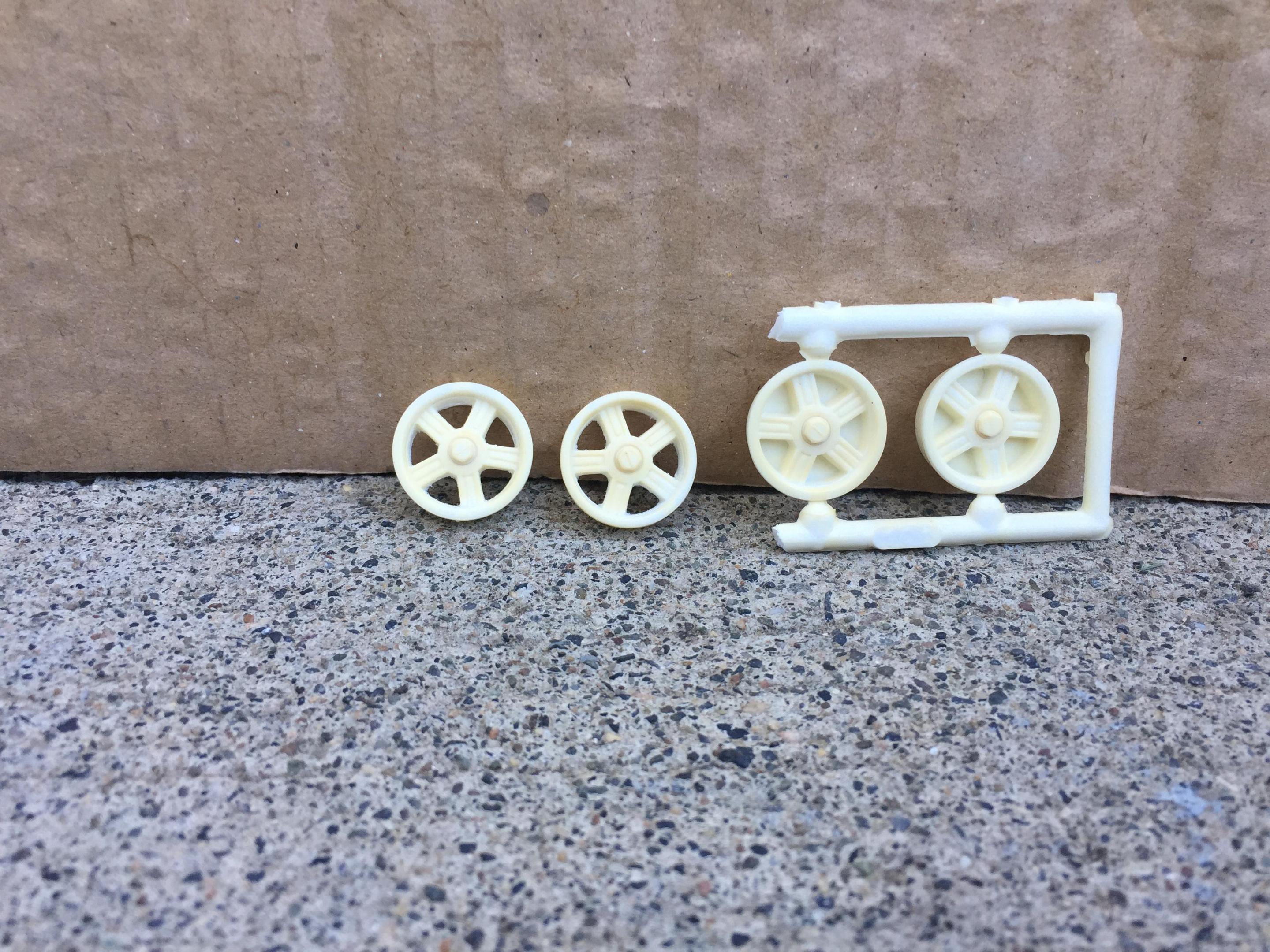

I also cut out the plastic out of the wheels for a cleaner look,i'm attempting to cast them in clear resin,but so far i've had no success.?IMG_6030.thumb.JPG.3fe166df51f3e15c2ff3164f708ff4d9.JPG

I’m liking this so far! Nice color and opening up the wheels looks a lot better
Thanks,i'm glad i did it,but it was very time consuming!.

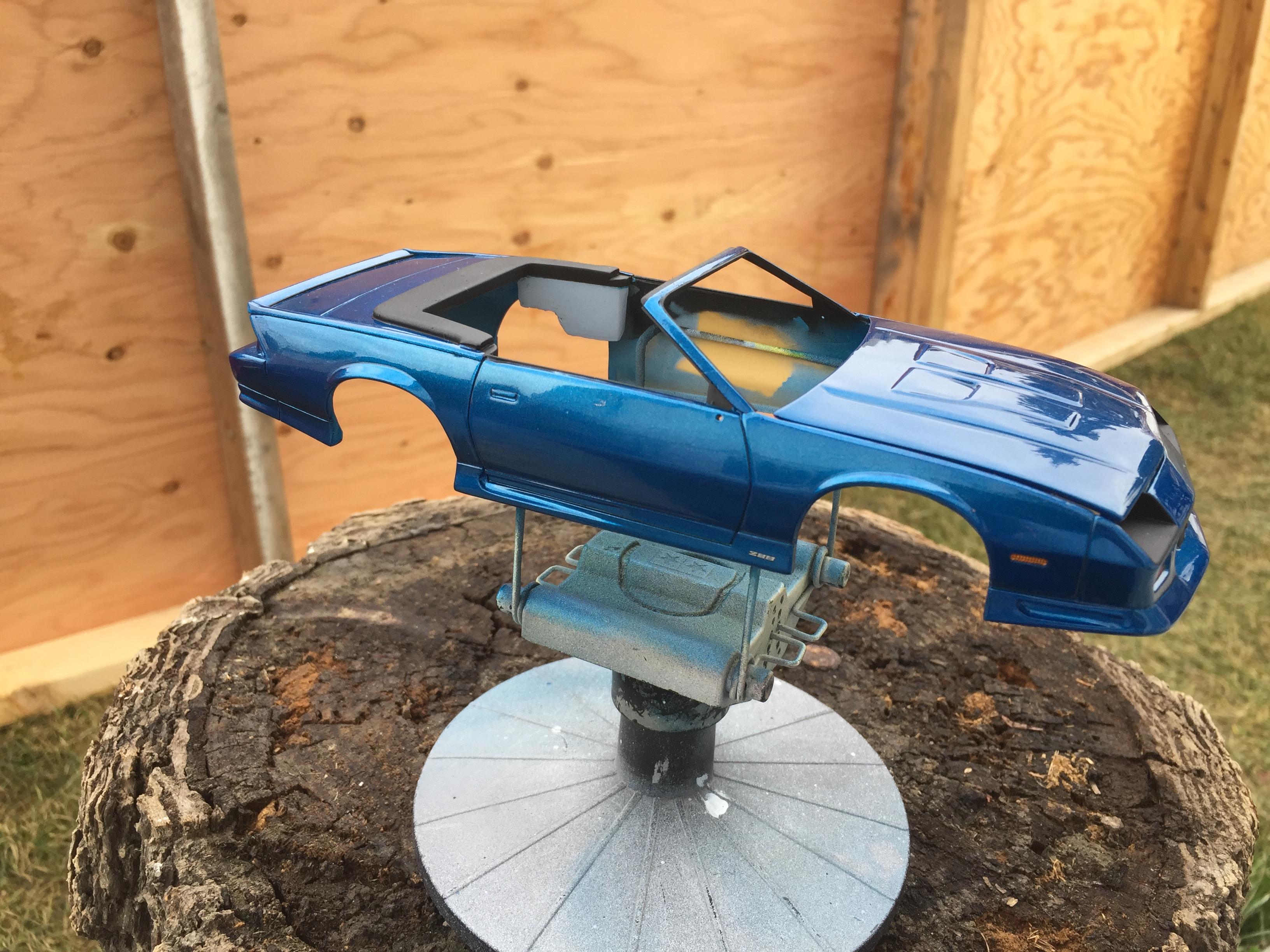

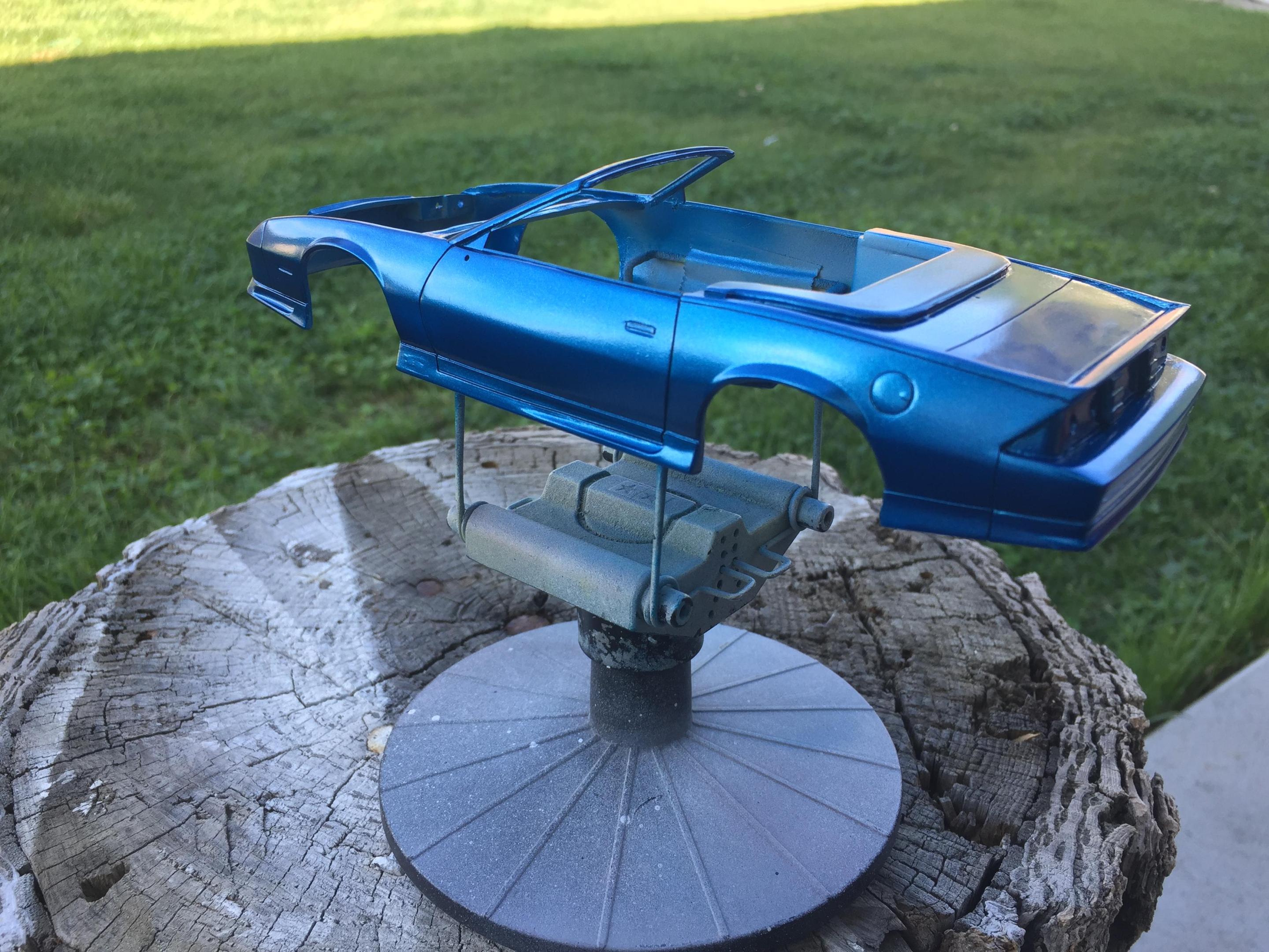

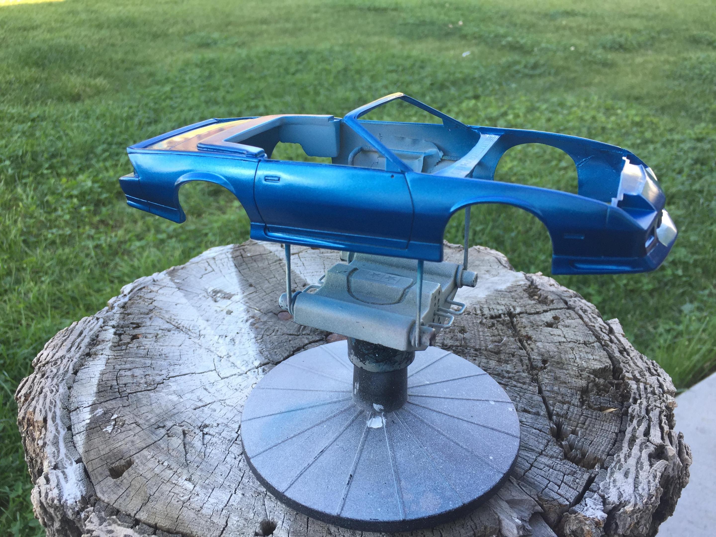

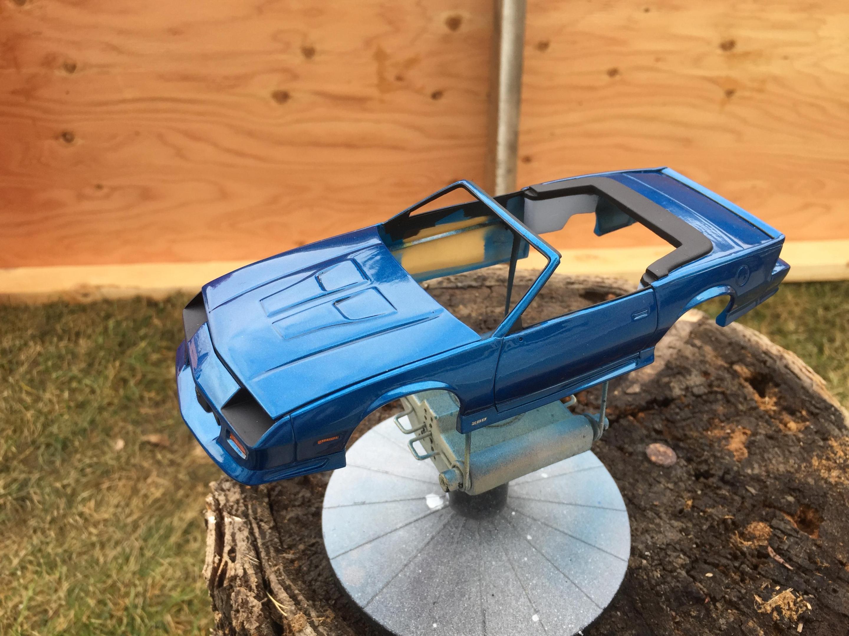

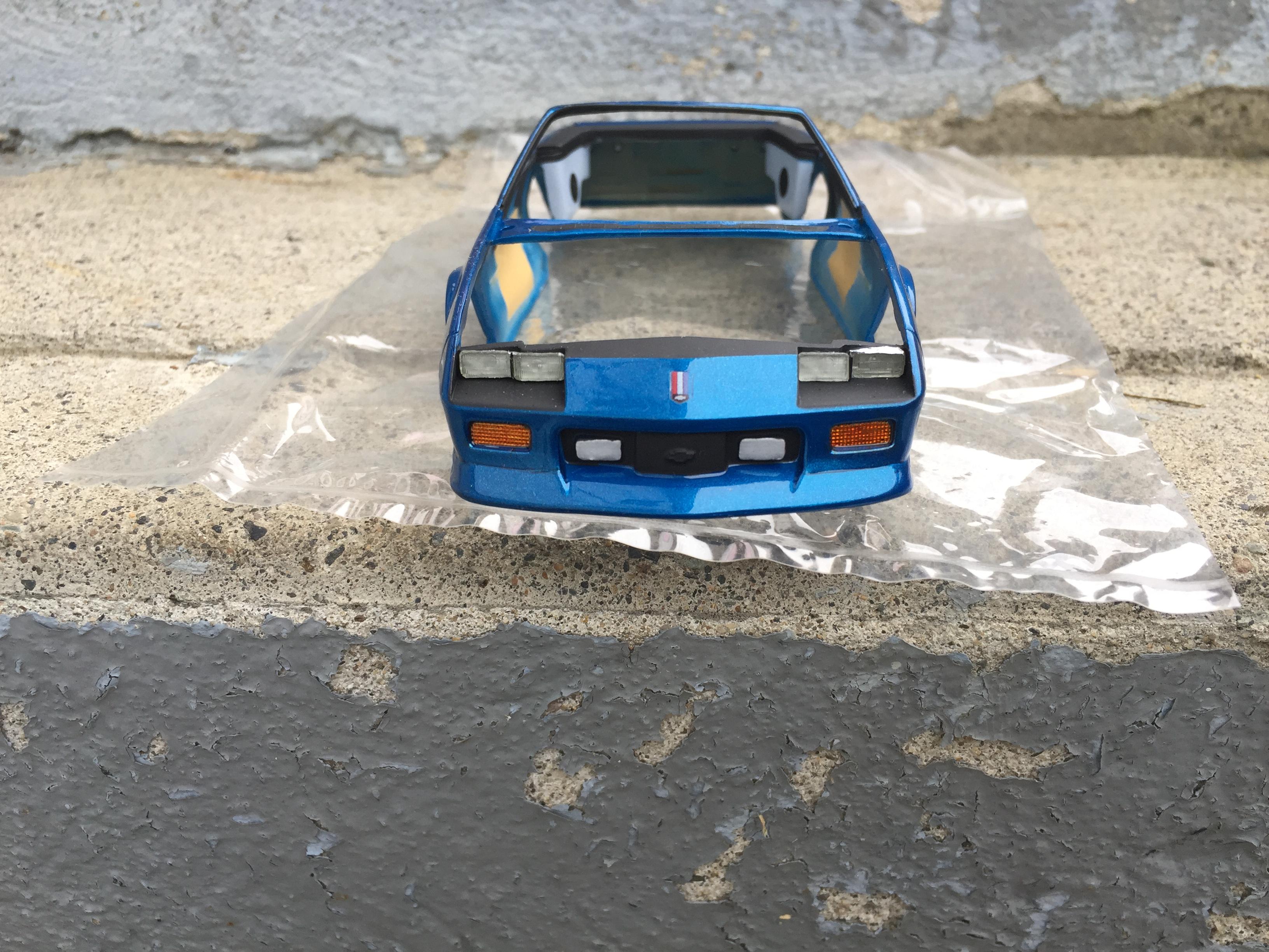

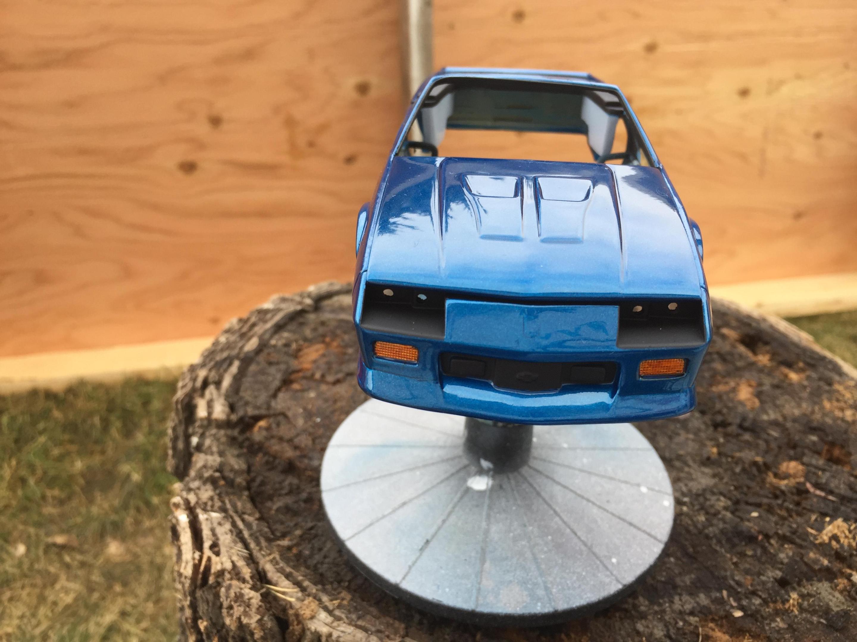

Hey,back with alot of updates:body is cleared and the trim is painted i used decals from Rays kits decals for the side emblems.IMG_6160.thumb.JPG.62526f7d048e1364f69f768924480af3.JPGIMG_6158.thumb.JPG.cc13010585601df8a36a51926b30639c.JPGIMG_6159.thumb.JPG.075c593ae5bd1c4753a9b54fe649c7e3.JPG

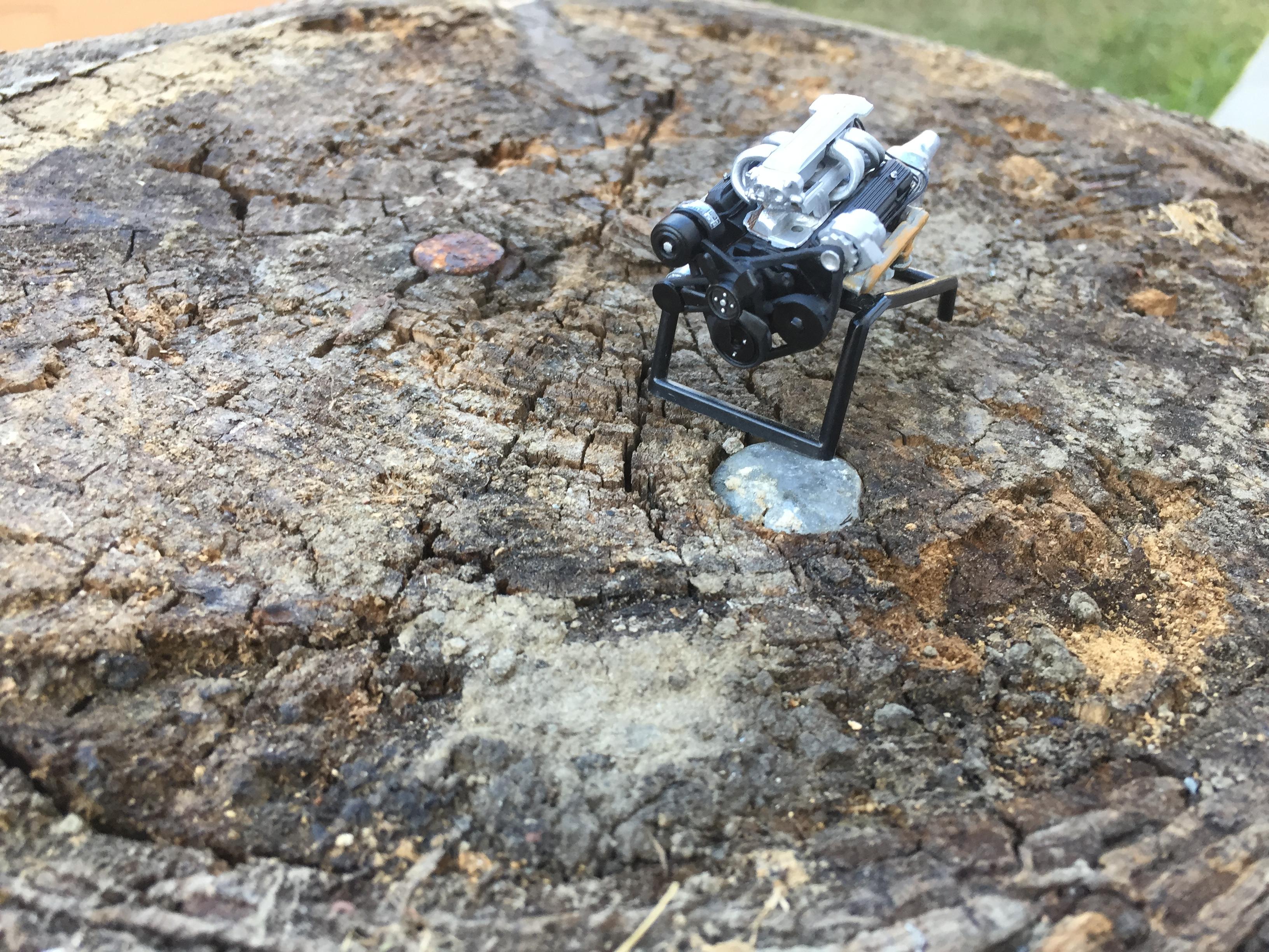

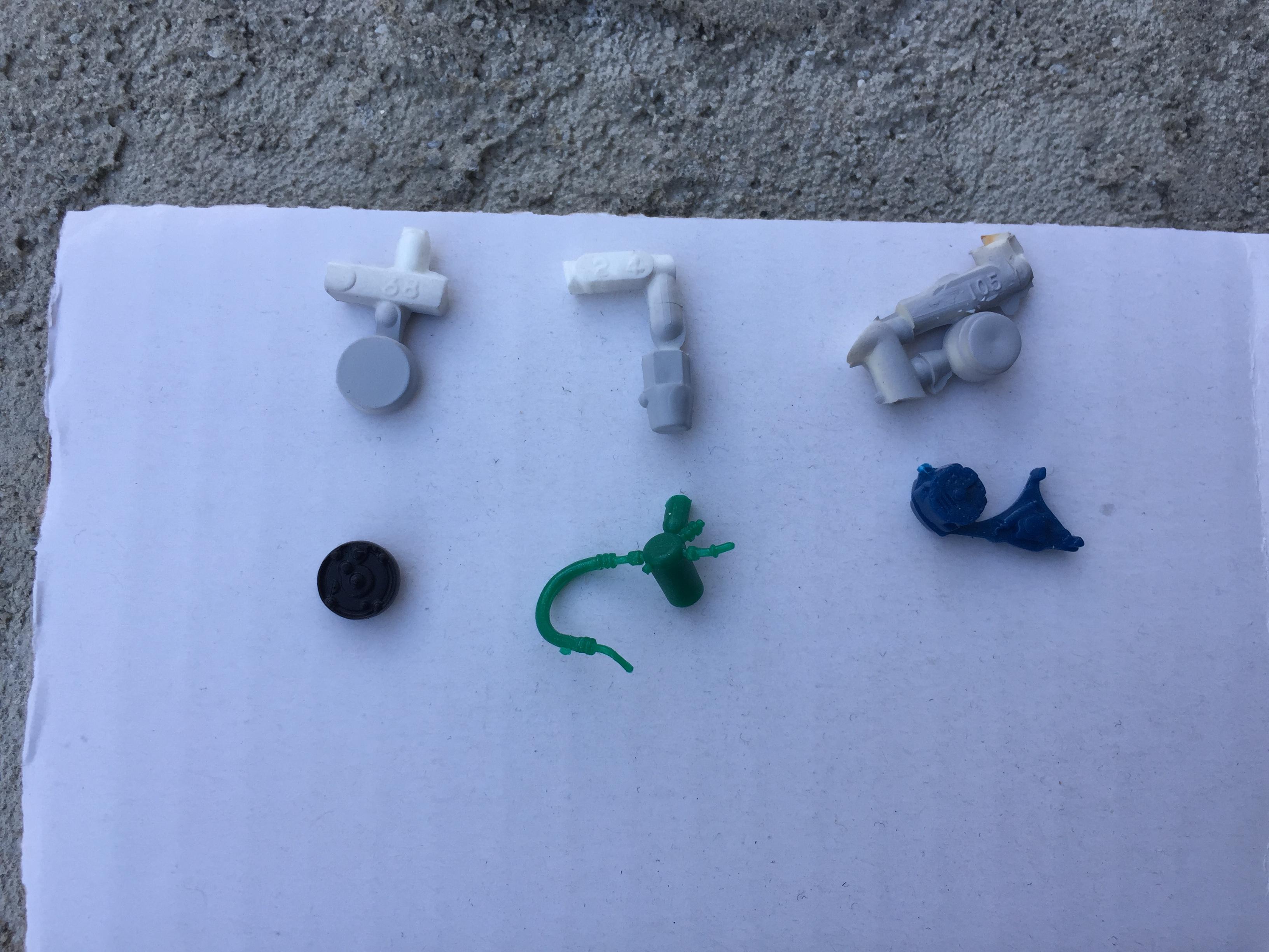

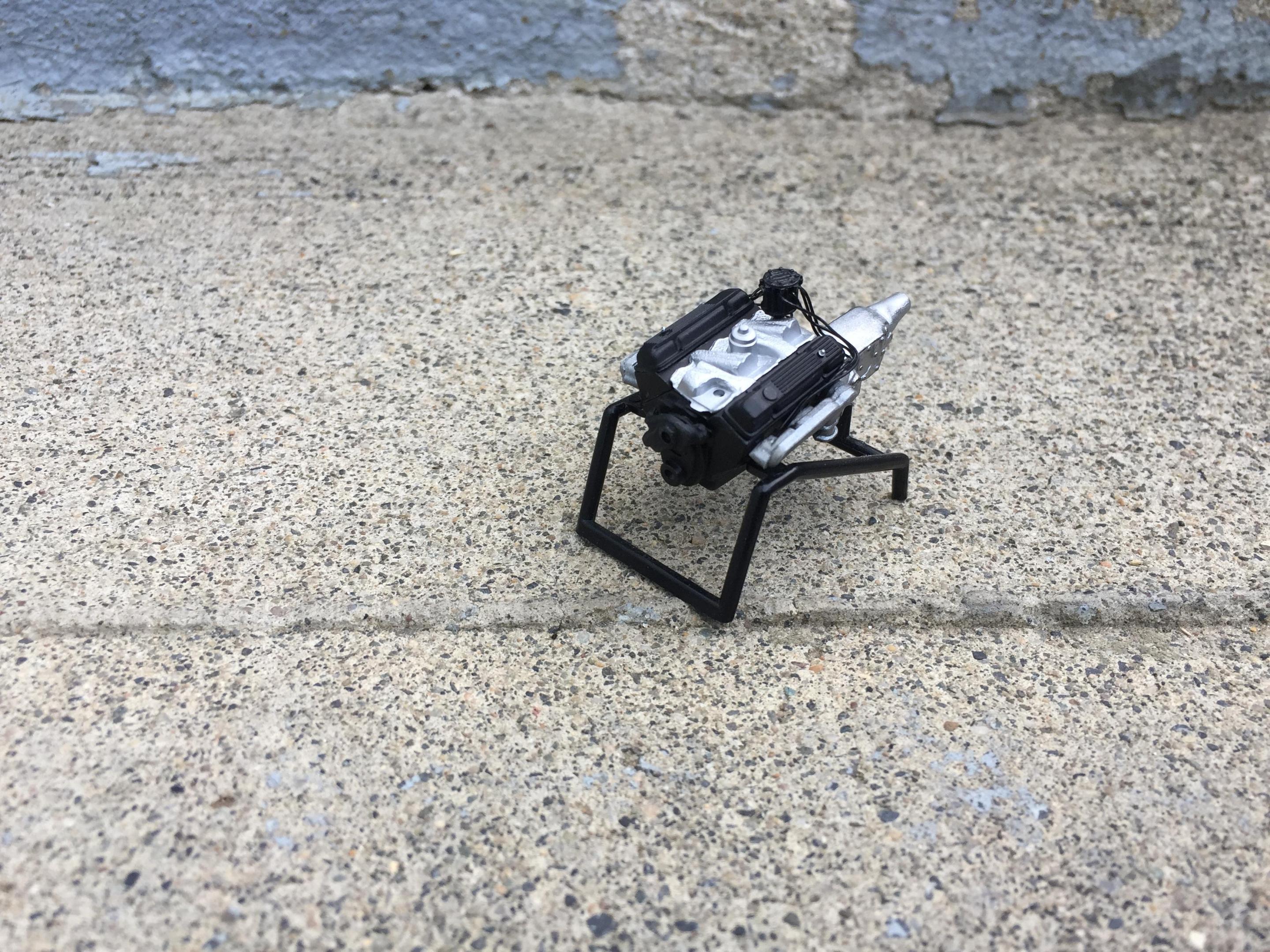

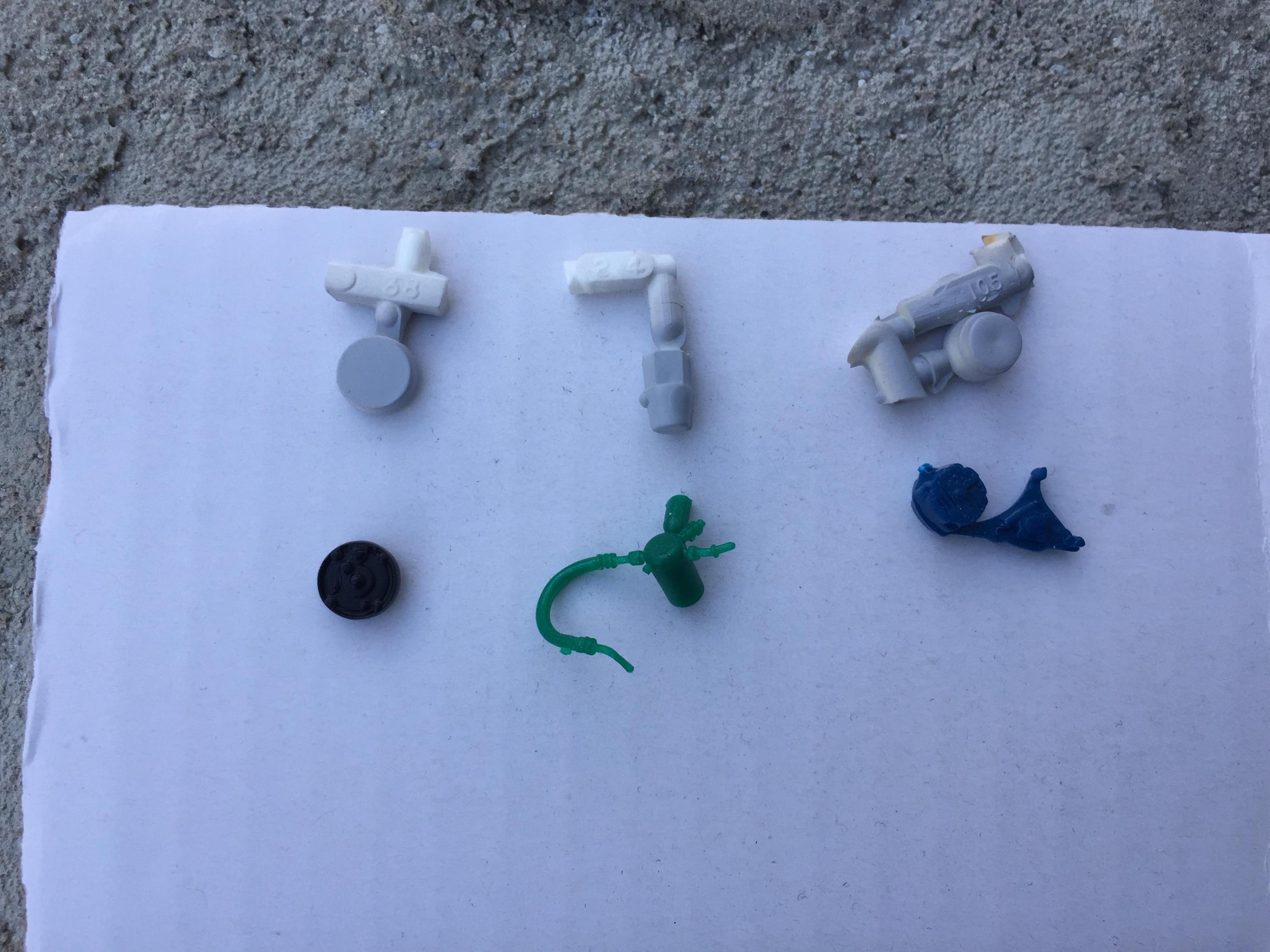

Engine is finished as good as i can do,but wasn't correct in some areas i had to swap the places Alternator and Air conditioning unit, i also swapped out some parts for better parts in my parts box,the top gray pieces are the Amt parts.Also the kit does have a fan,so grabbed one from the parts box.IMG_6138.thumb.JPG.4aeb847f689fa63c67d7023de2360fac.JPGIMG_6142.thumb.JPG.4203b9b04d78cd9709b3a199f2566268.JPG

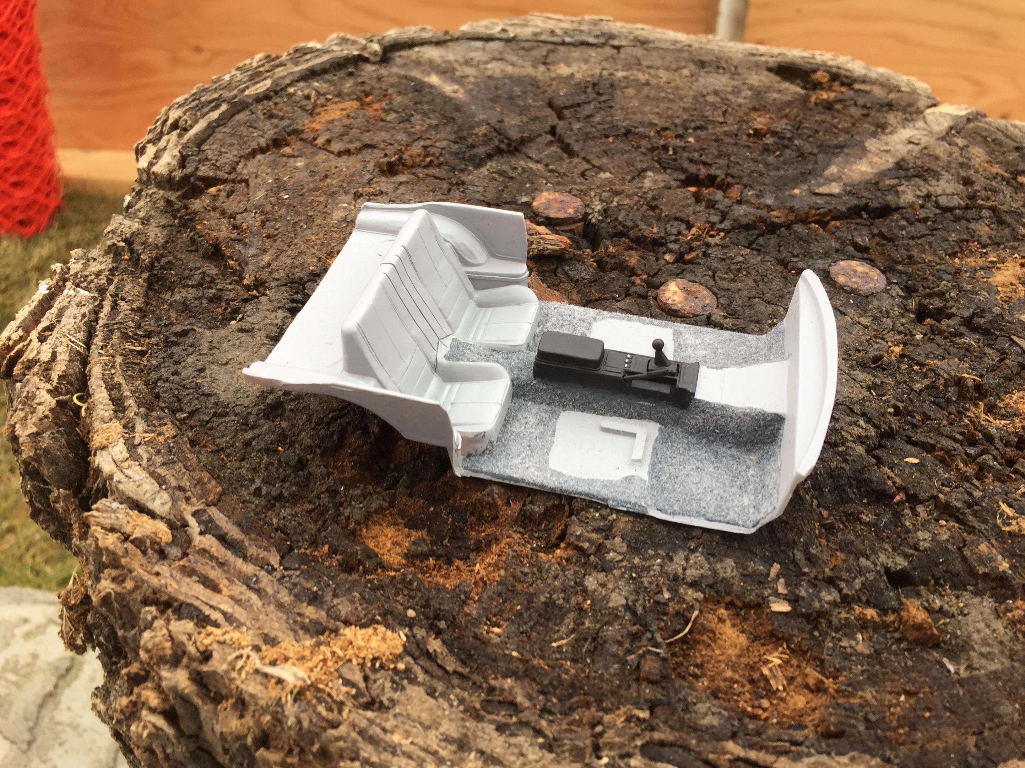

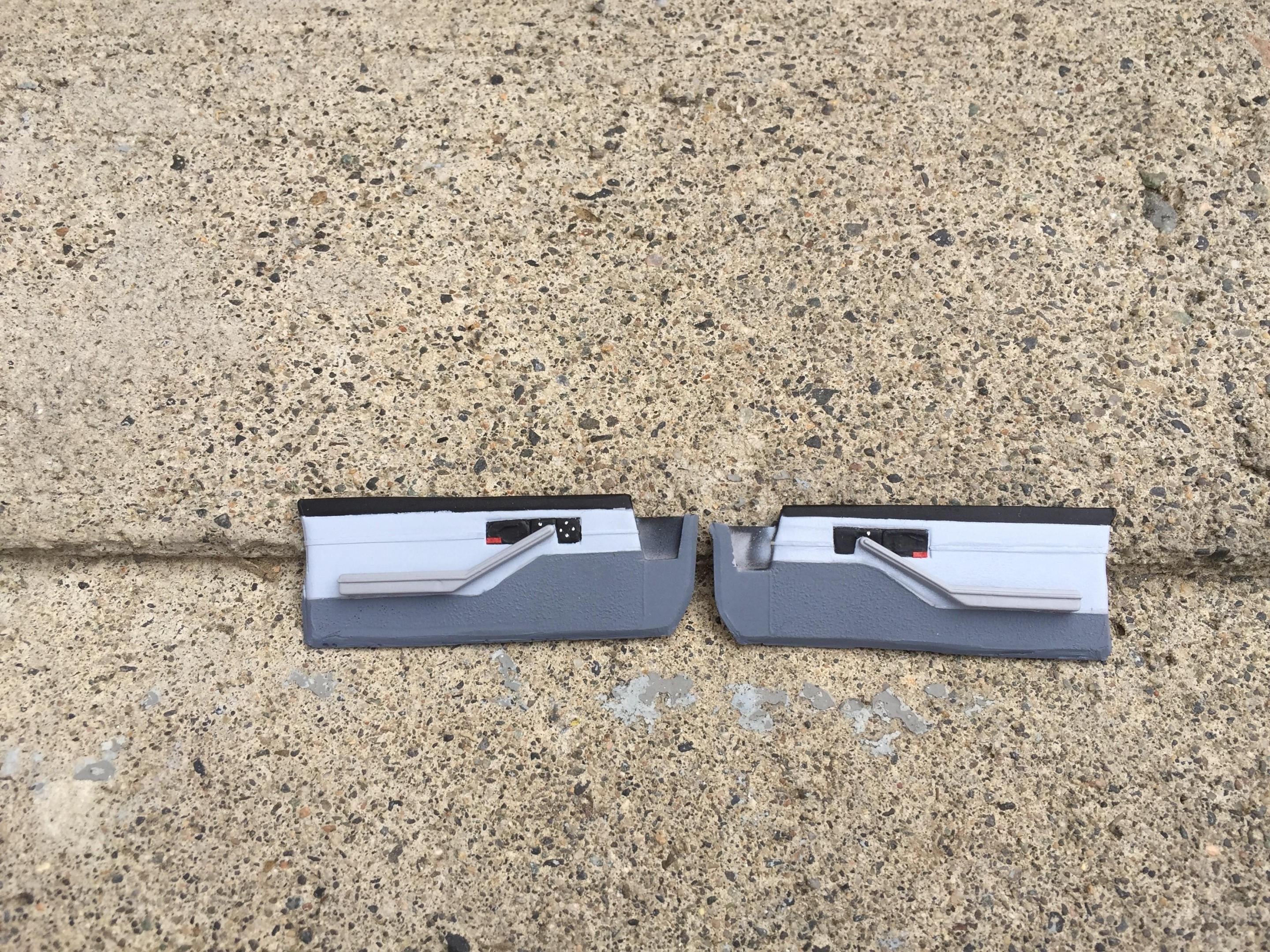

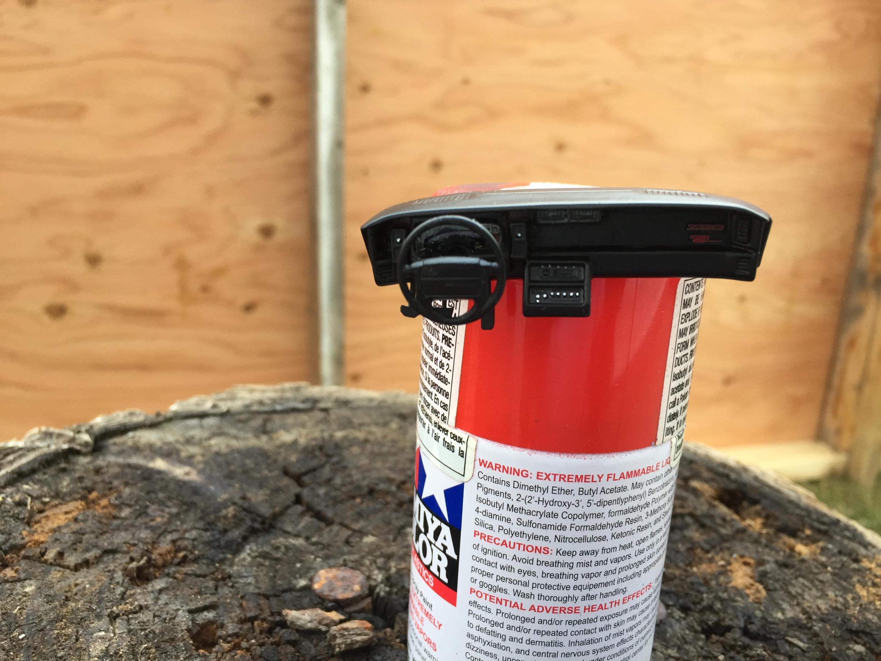

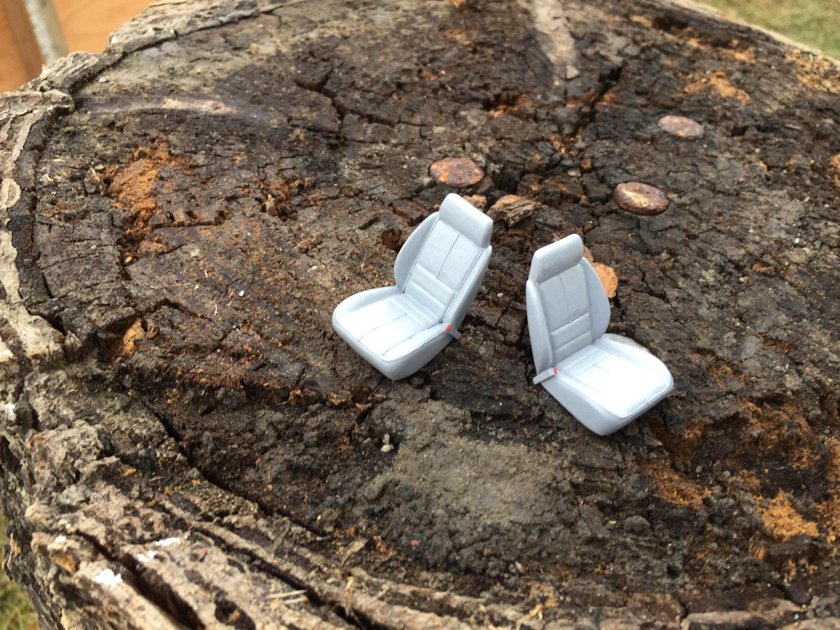

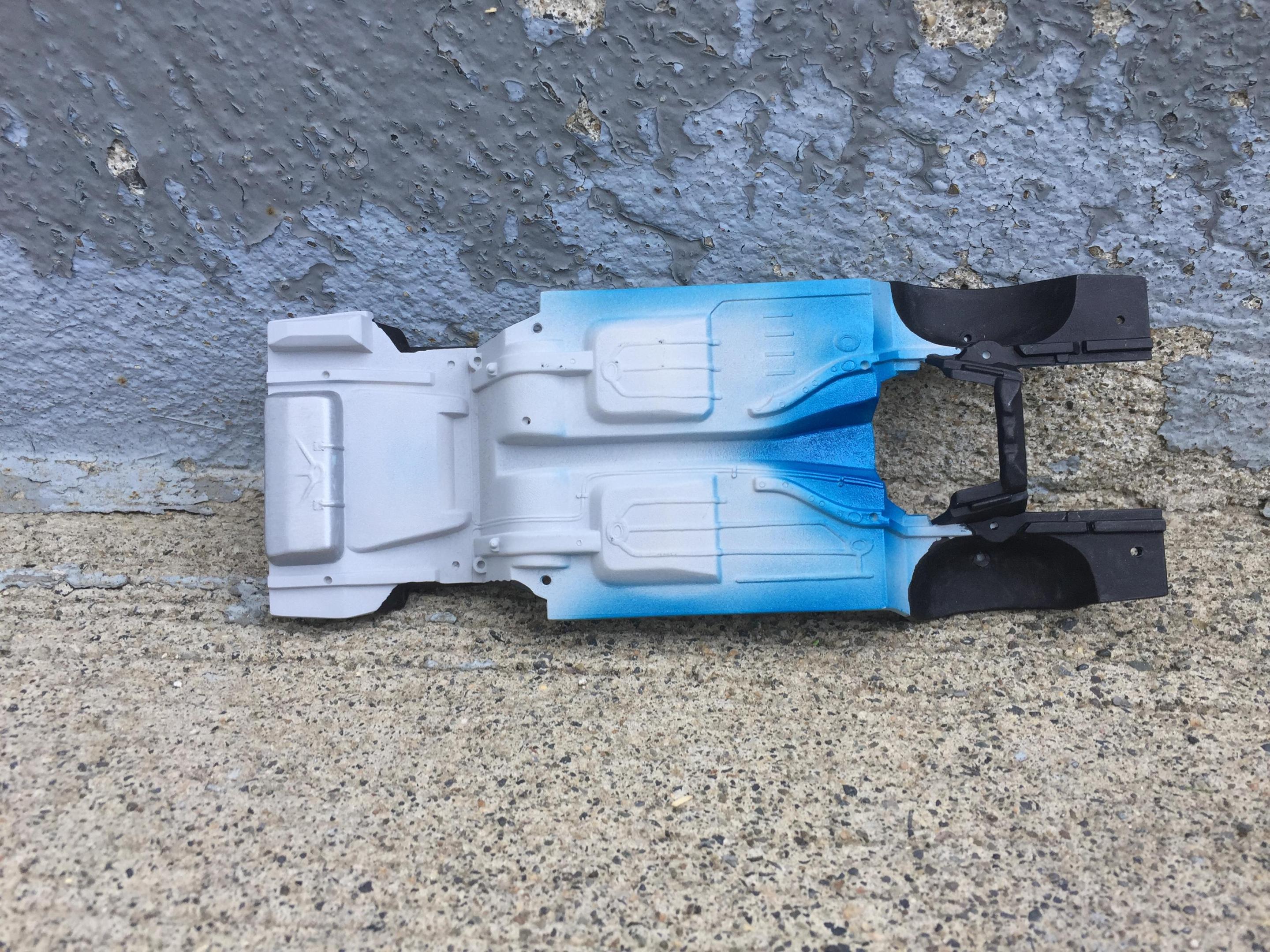

Lastly the interior,which seems more correct for a 85-87' Iroc, it had ribbing on the rear seat and doors and dashboard.So i separated the doors so i could get in to sand  it off,i resin casted the armrests from the Revell'82'Ultra Z camaro and used the parking brake as well from the camaro,still lots more to go though.IMG_6154.thumb.JPG.c85ee1780f43df634e73b900ae88c43d.JPGIMG_6155.thumb.JPG.5493010c18f5df3686388550b1199783.JPGIMG_6156.thumb.JPG.12778f604a61198811545cf4924cb9e8.JPGIMG_6157.thumb.JPG.628b813d2296384cb6bc45d6c18a3fe1.JPG

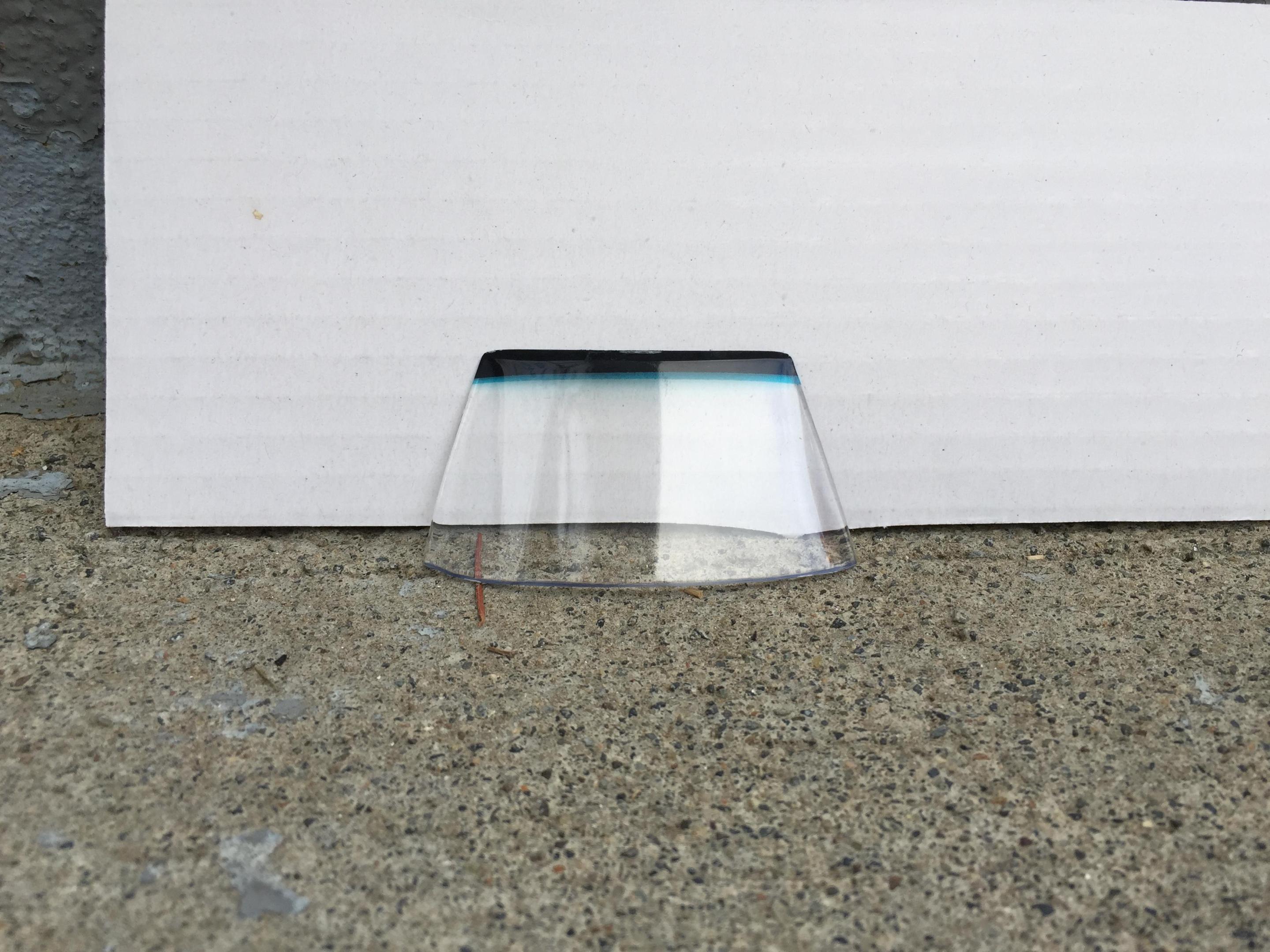

Alright back with a small update,windshield was painted with Tamiya matt black and a light couple coats of Tamiya clear blue and a little novus 2 to get rid of some small scratches.

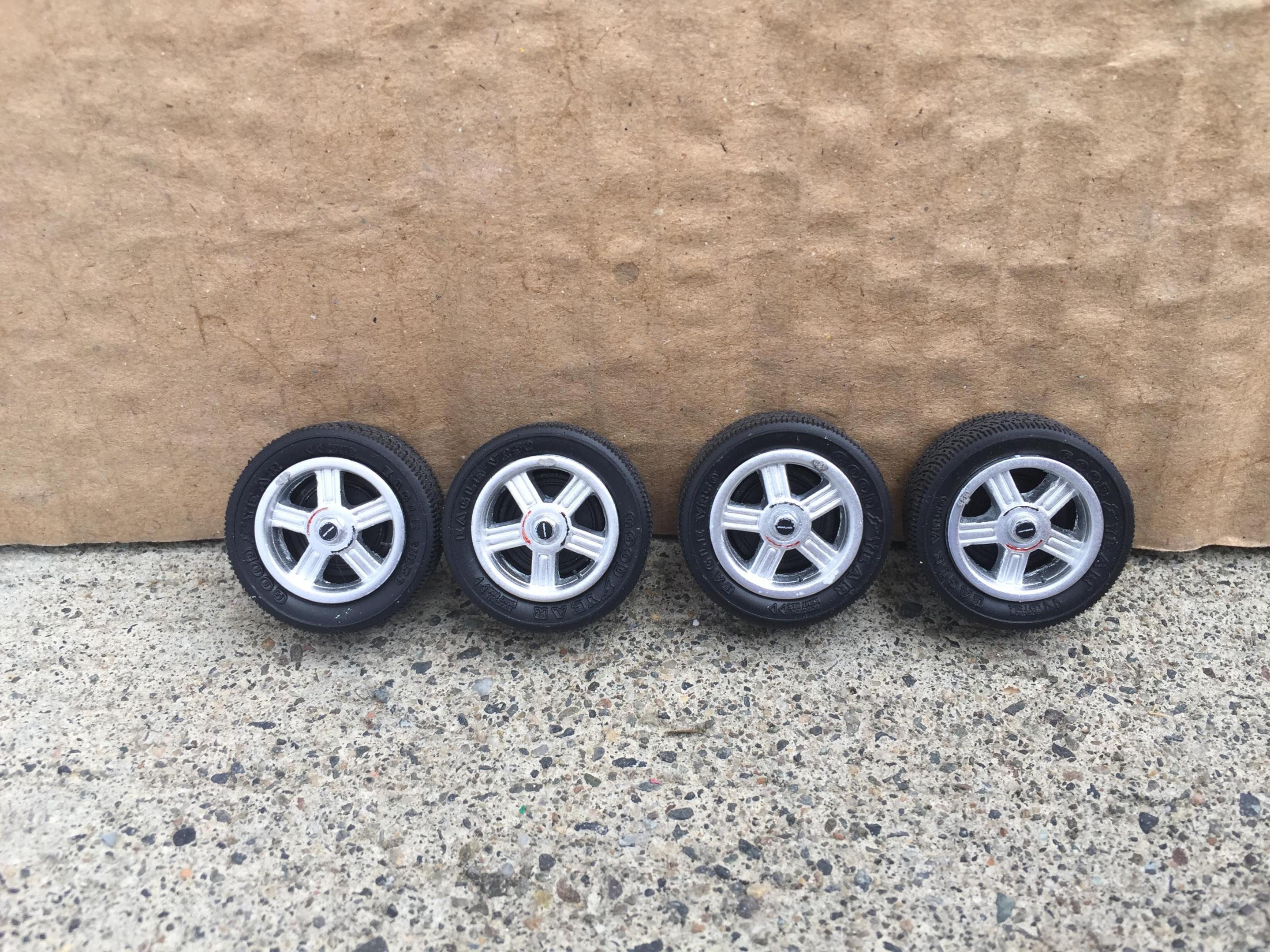

IMG_6186.thumb.JPG.a8aaa7b0fc2635f6d36d255f79376573.JPGSince i failed trying to cast the wheels in resin,i just scribed the plastic out on the other two wheels.Repainted them with Spaztix chrome as i couldn't find a color to match my wheels i added P/E wheel weights  and valve stems and the centre cap is a decal from  Rays kits.IMG_6189.thumb.JPG.9e9e0980df4a7cc568b182435946ea32.JPG

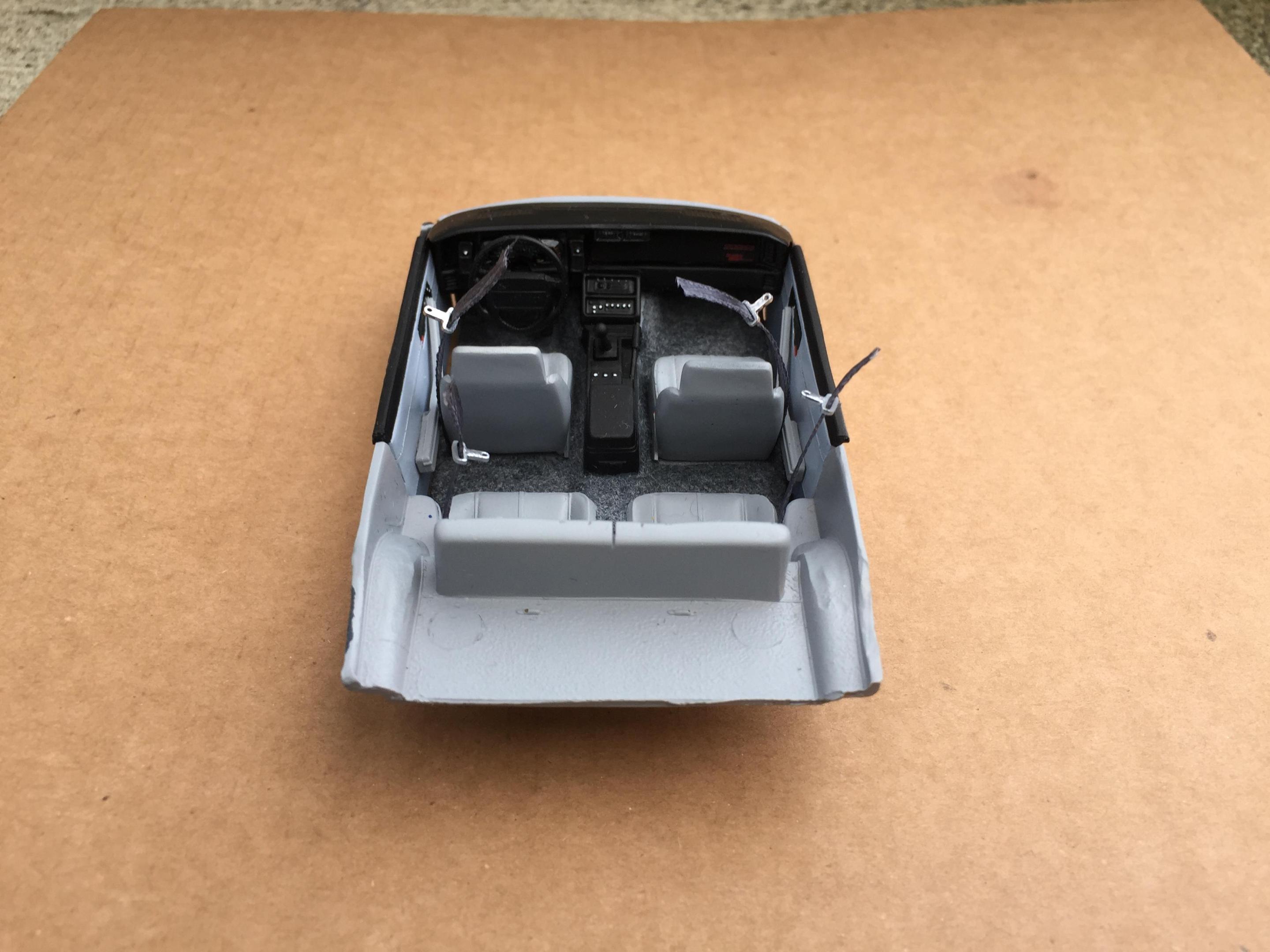

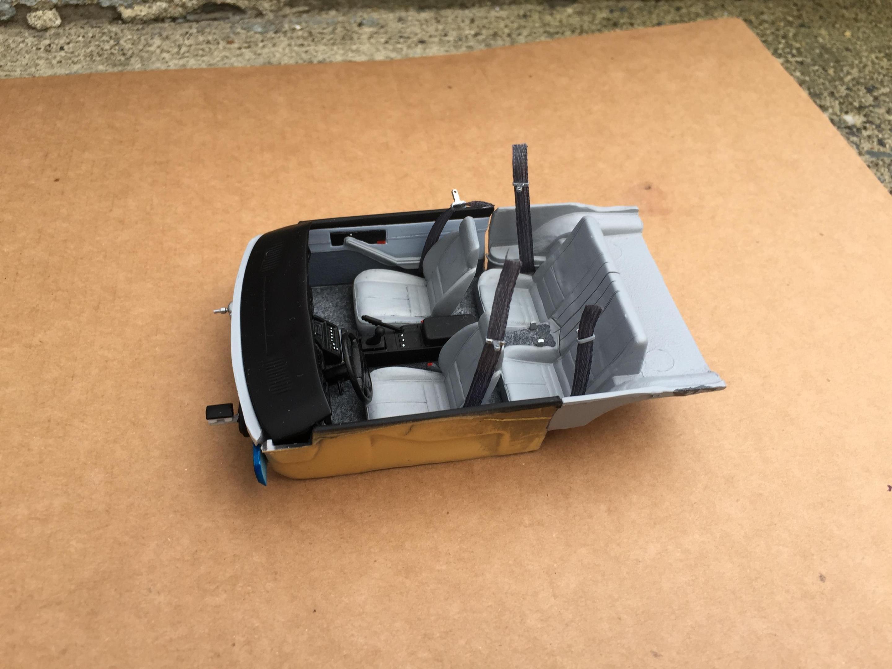

Thanks for the positive comments everyone!....okay so the interior is done i just need to glue the seatbelts to the body/backseat.IMG_6216.thumb.JPG.8af3d0764532a35b2ac1101412107fcf.JPGIMG_6217.thumb.JPG.0da5e7b3b9393bb4f2aabb80269e4373.JPG

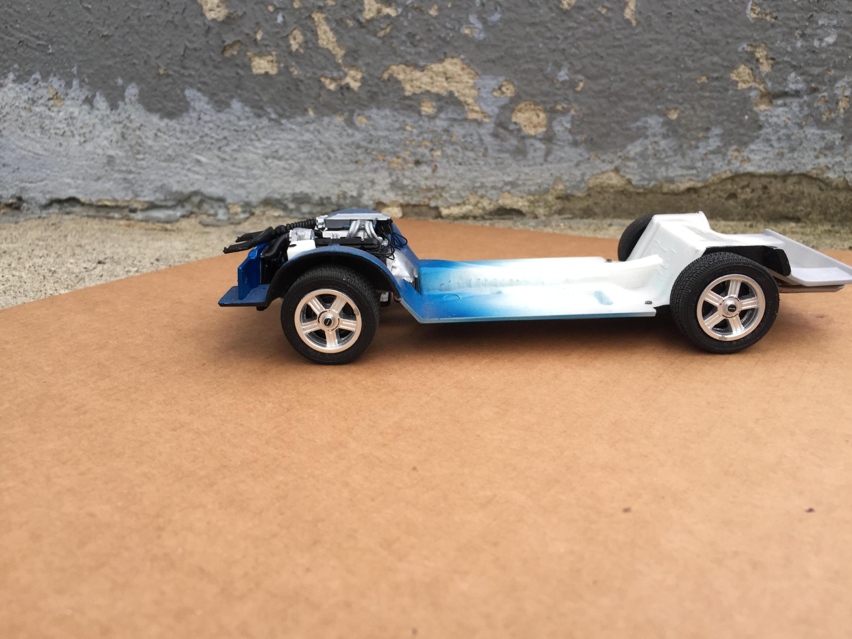

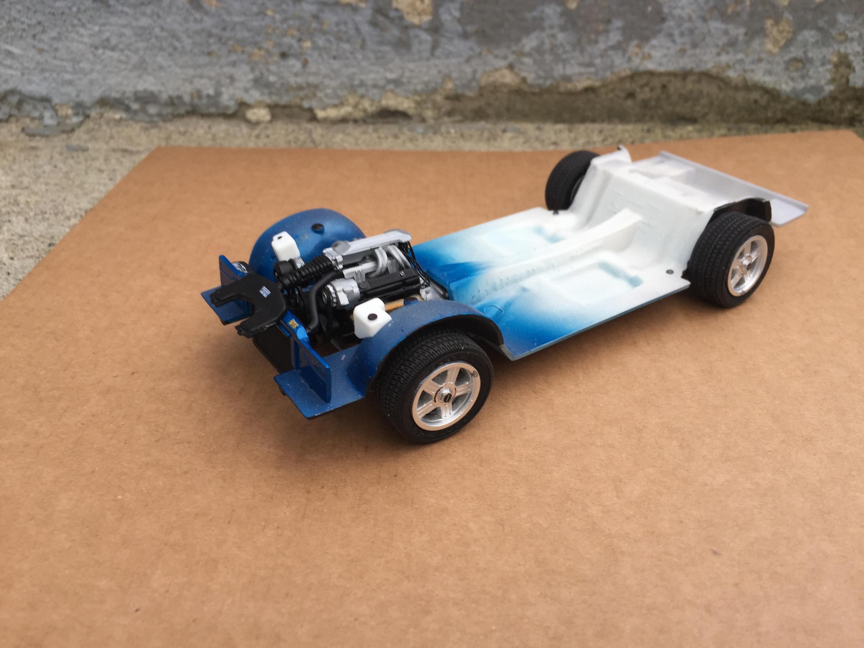

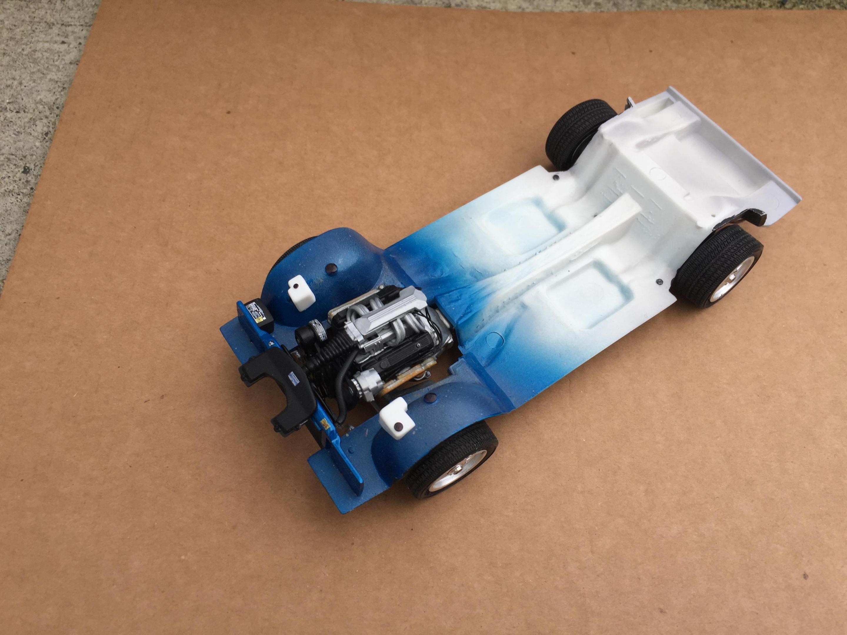

The chassis is done and so is the engine wheels and tires.IMG_6220.thumb.JPG.84a808670e3c69c941dd57e01d18c087.JPGIMG_6221.thumb.JPG.90da809ae38fddf6b6608bb9ab848397.JPG

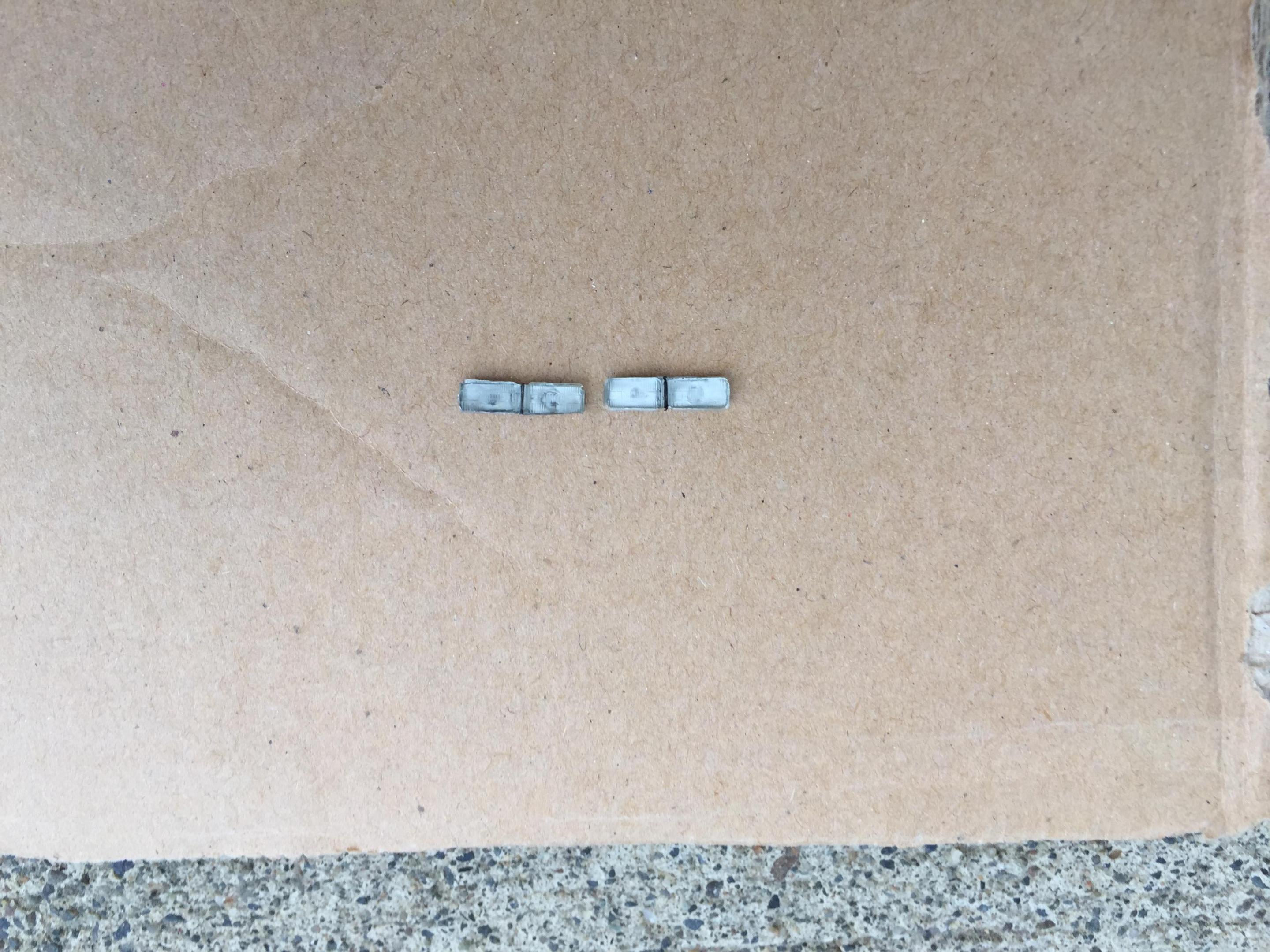

Lastly i cast the headlights in resin and painted the backs in Vallejo silver,not sure i'm 100% satisfied with them and may do another.IMG_6222.thumb.JPG.085a4f41eed8ce5974cd4a3c57d836a8.JPG

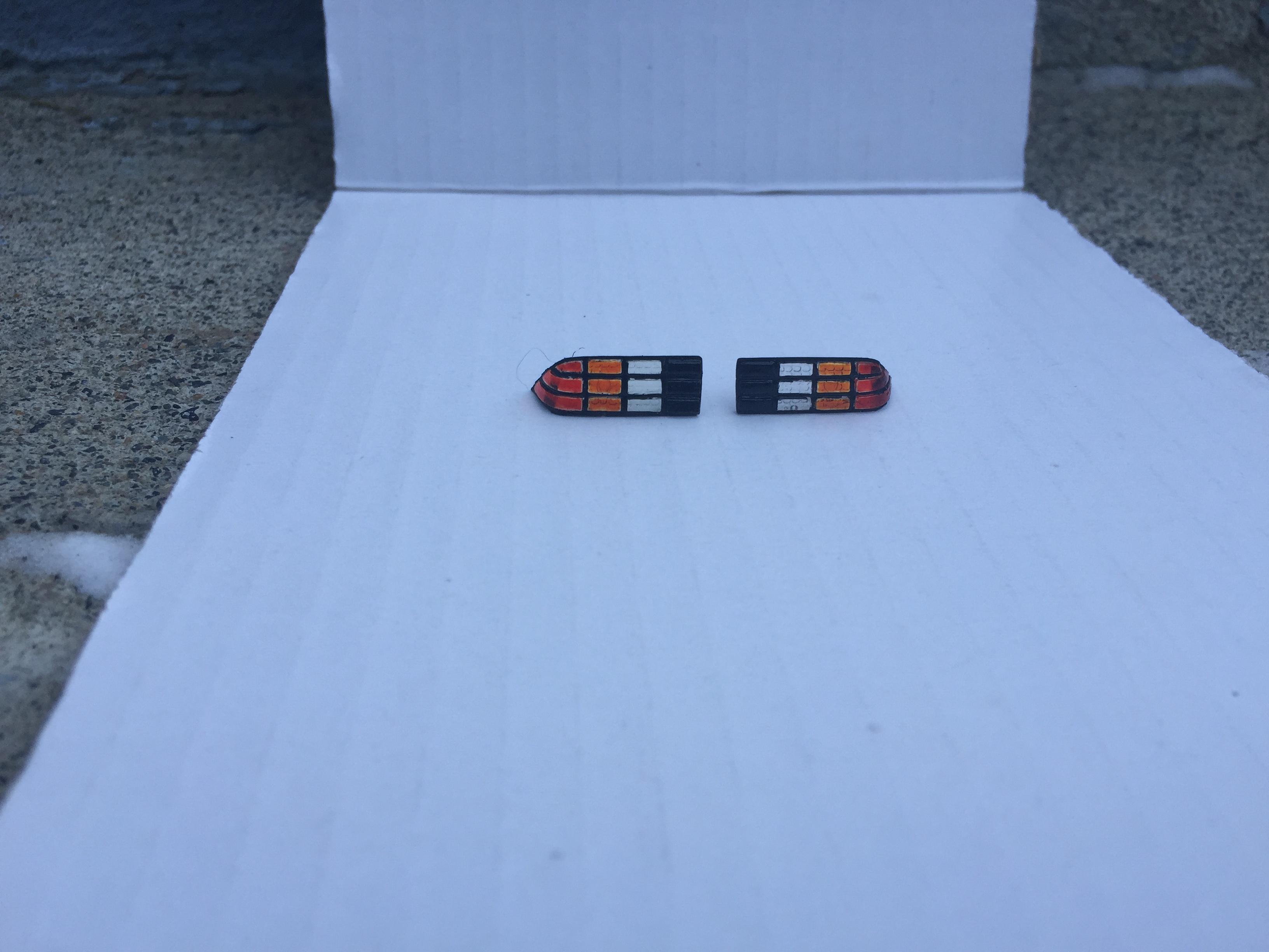

Another update,headlights installed and i cast the taillights in clear resin and painted them with Tamiya clear red and orange and testor's gloss black.IMG_6230.thumb.JPG.b6ce9282f56f51133fc0b77989a53209.JPGIMG_6234.thumb.JPG.53afffd0033e8dc02a33784bf4024d7f.JPG

Very realistic looking finishes.
Thanks!,i thought i'd try to add a little weathering instead of a perfect showroom look.

How hard is this kit to find? I also had a 1:1 92 Camaro and would like to build a replica of it, but have never seen this kit
  • Like 1
The coupe shows up on Ebay quite often,the prices vary from $50-75 dollars,AMT also made a 91'Z28 coupe which is a little cheaper than the 92 kit,the convertible transkit was made in the early ninties and very rarely shows up on Ebay.
