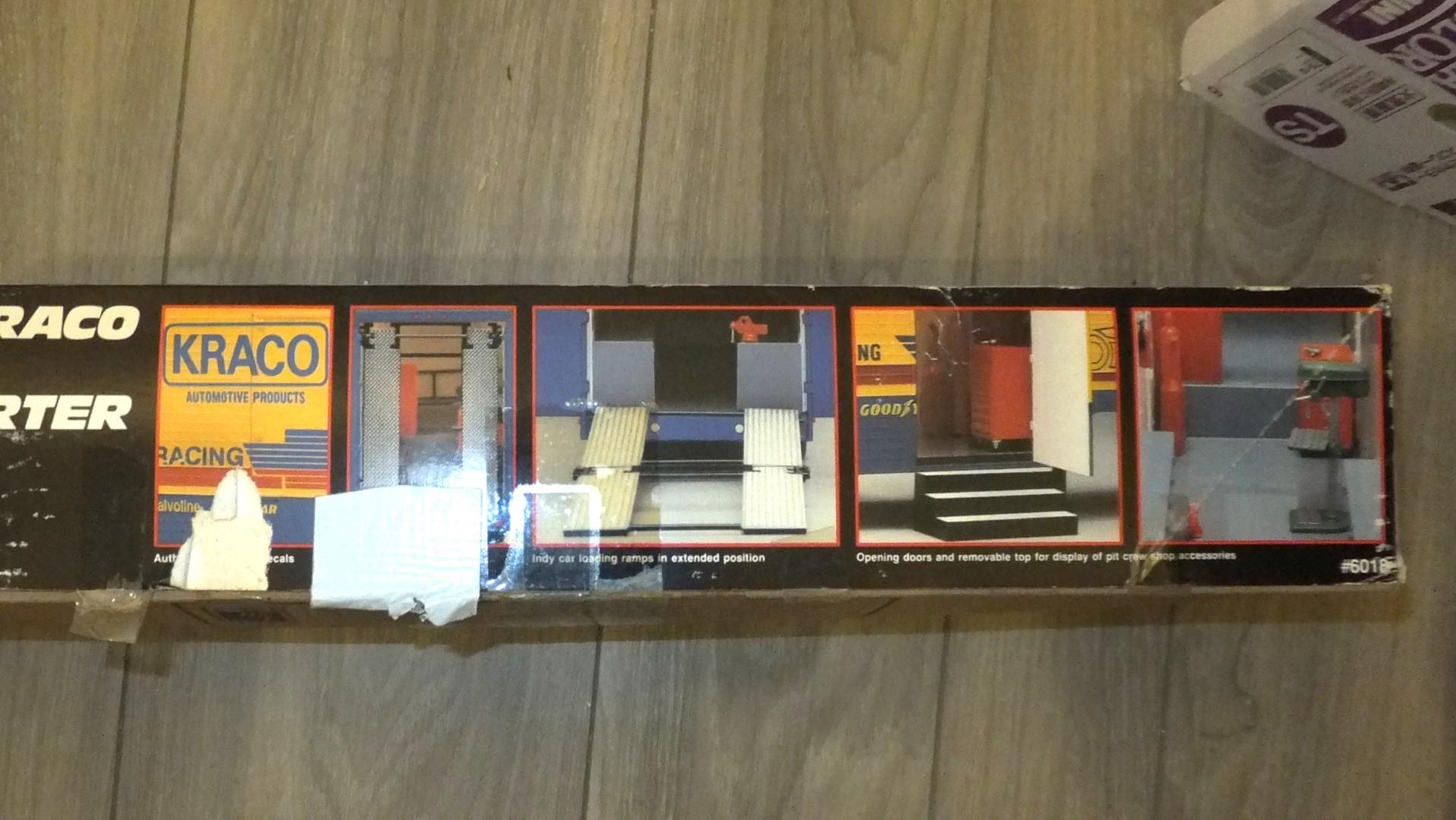

Exotics_Builder Posted November 8, 2023 Posted November 8, 2023 4 hours ago, Mark said: I recall the stock car transporters as being based on an earlier moving van trailer, with some added interior parts. Including the moving van trailer to widen your search should turn up more available kits, and possibly at a lower price too. It is. I have one unbuilt downstairs in the stash. It has a few interior pieces but is not what I would call a race car trailer without considerable mods
Exotics_Builder Posted November 8, 2023 Posted November 8, 2023 (edited) 1 hour ago, Exotics_Builder said: It is. I have one unbuilt downstairs in the stash. It has a few interior pieces but is not what I would call a race car trailer without considerable mods I went downstairs to the stash and pulled out the trailer. I can scan the instructions if that would help narrow your search. Edited November 8, 2023 by Exotics_Builder
Exotics_Builder Posted November 8, 2023 Posted November 8, 2023 Instructions from Scalemates https://www.scalemates.com/products/img/7/1/0/141710-80-instructions.pdf
