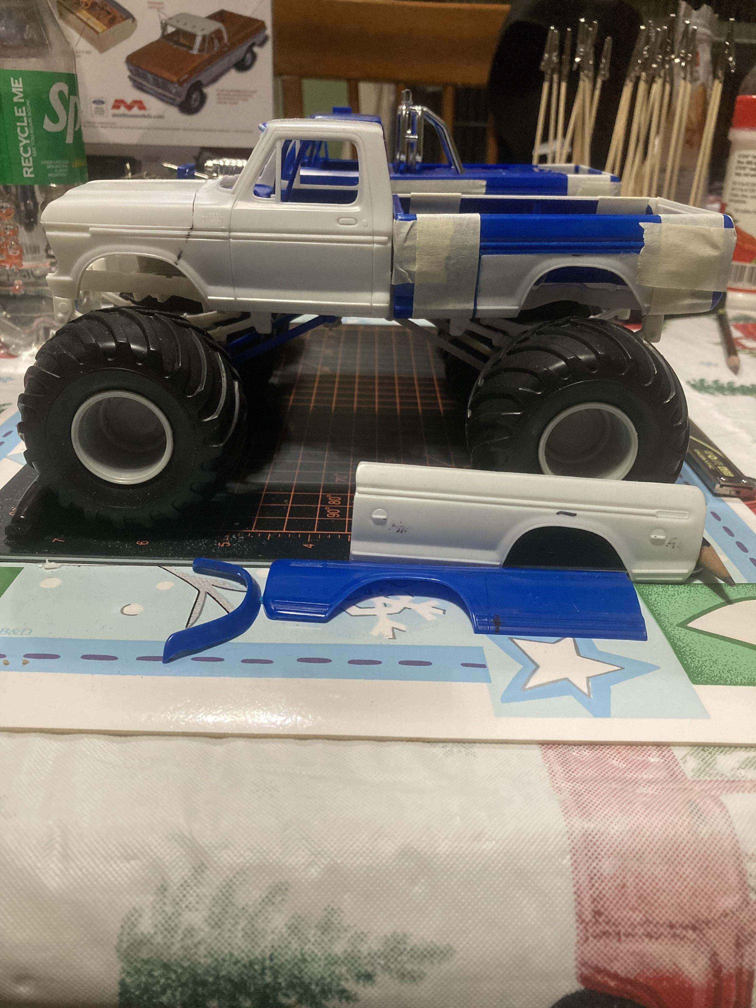

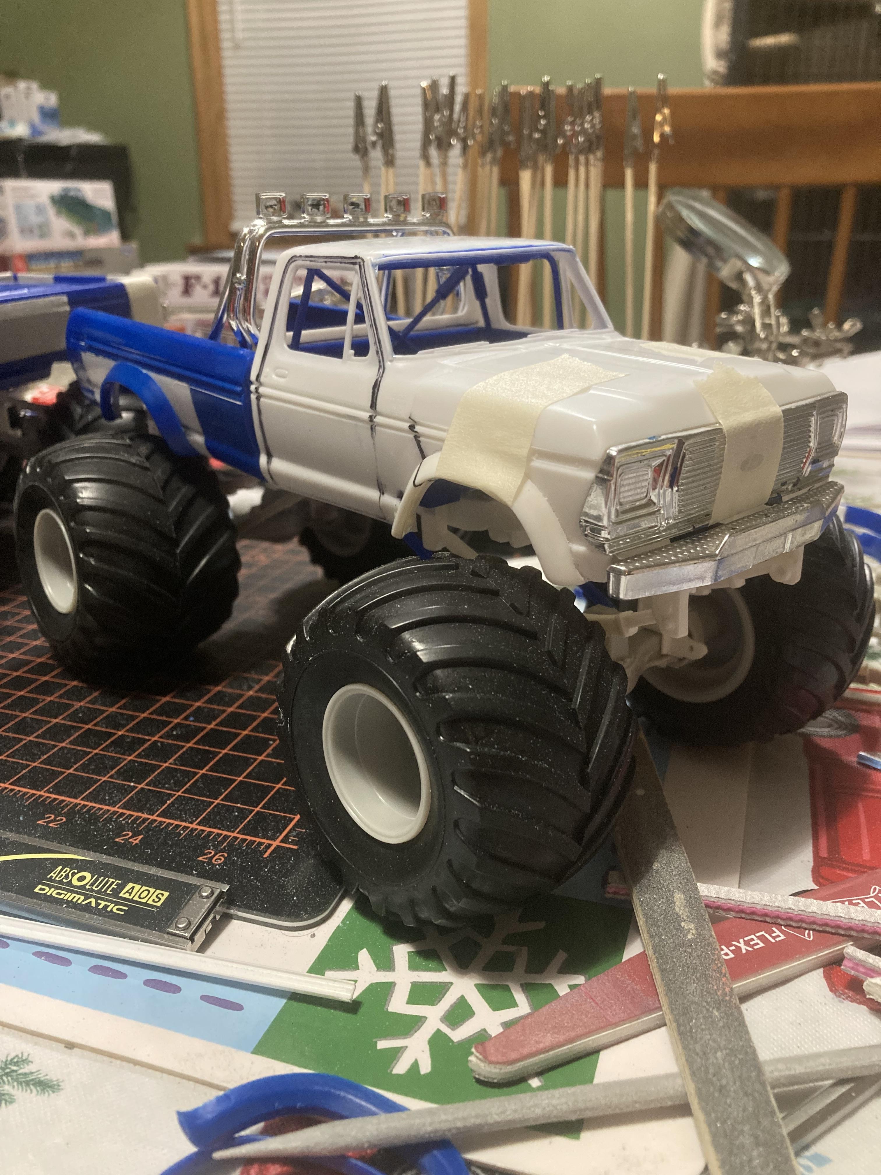

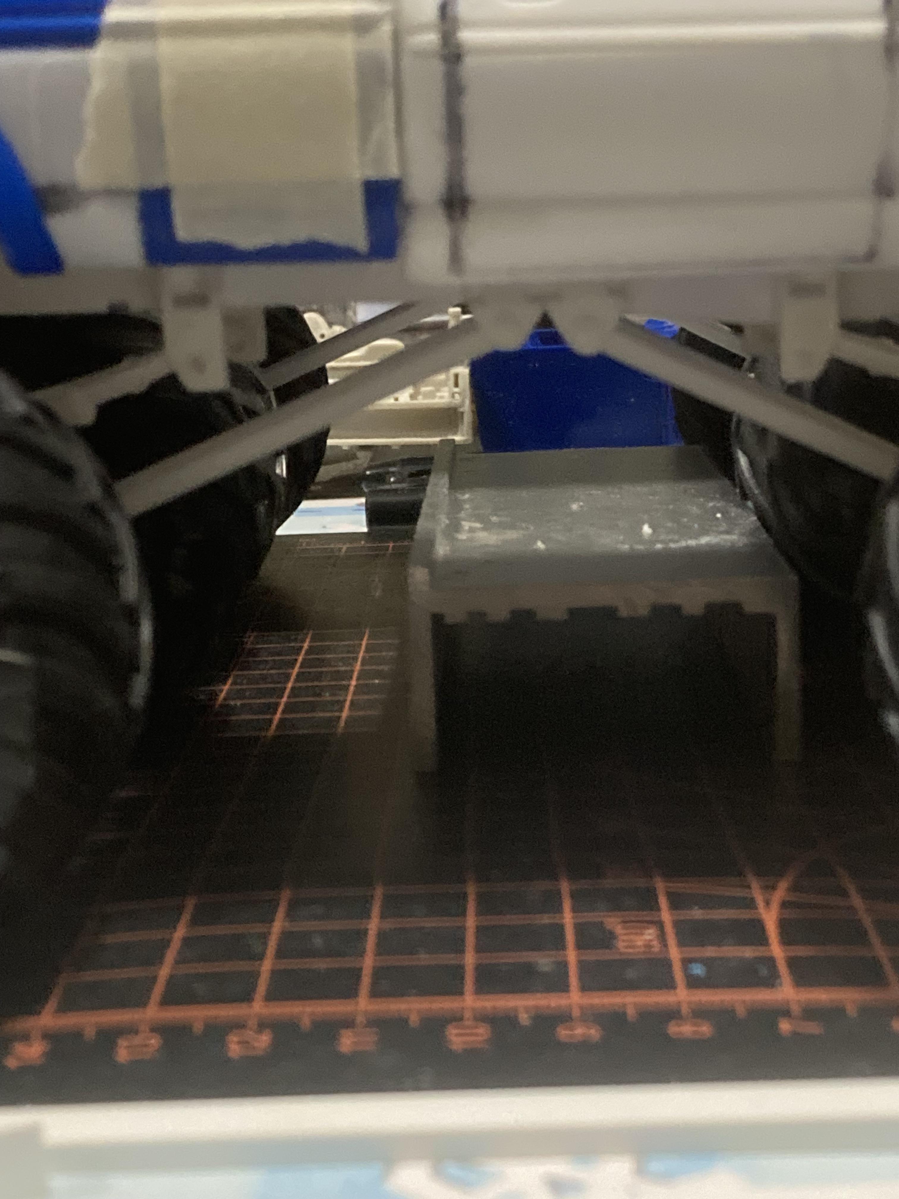

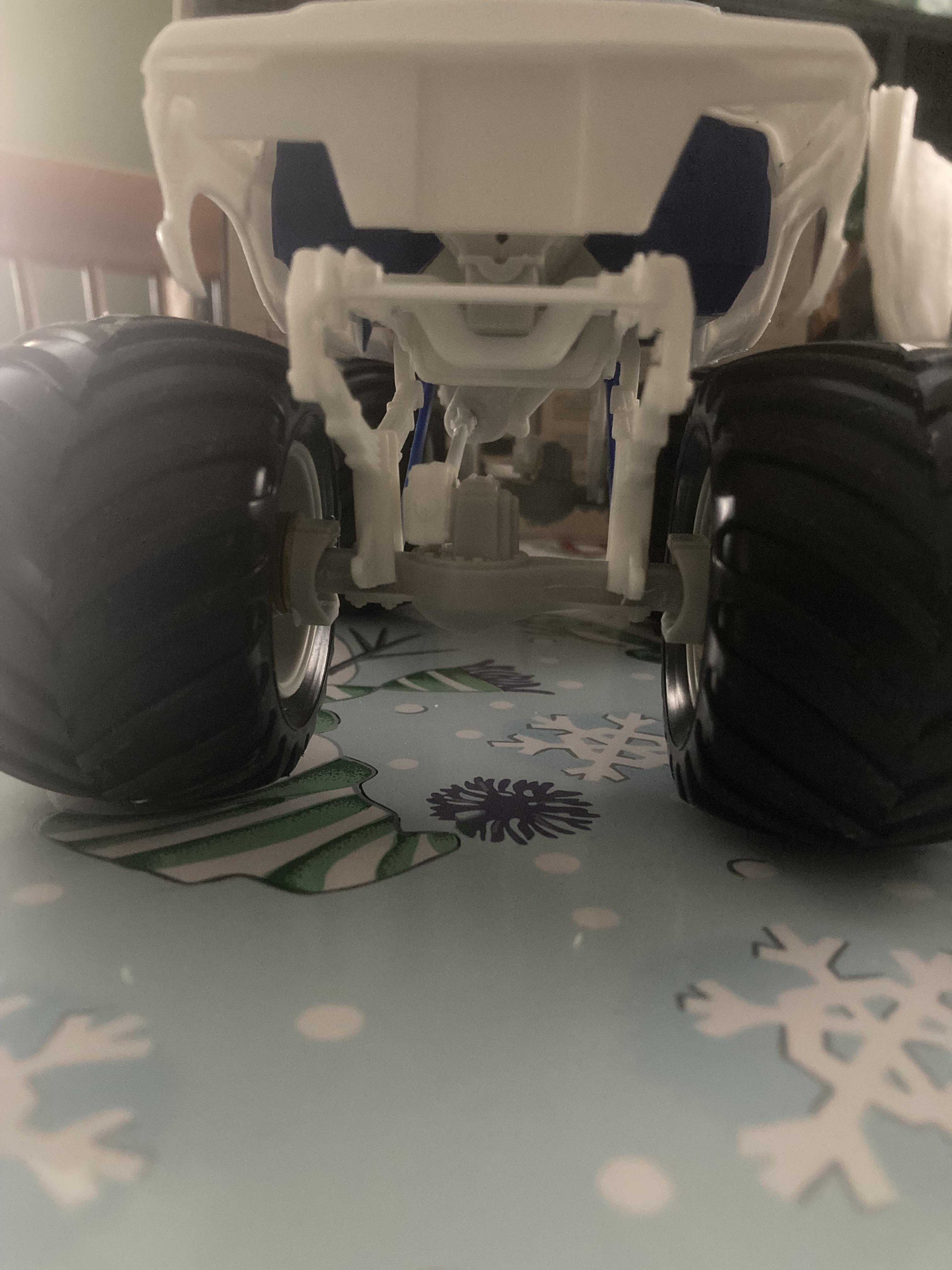

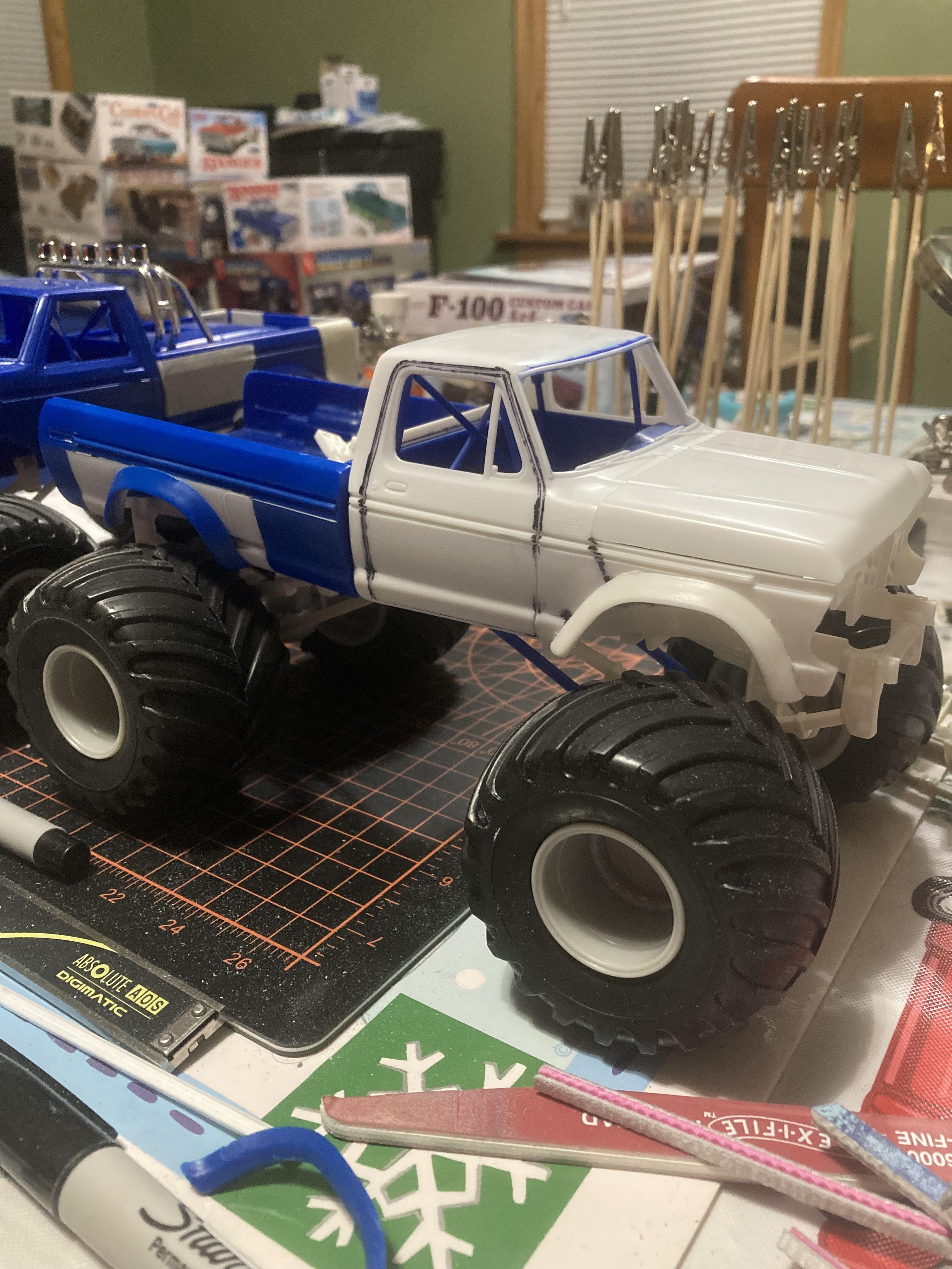

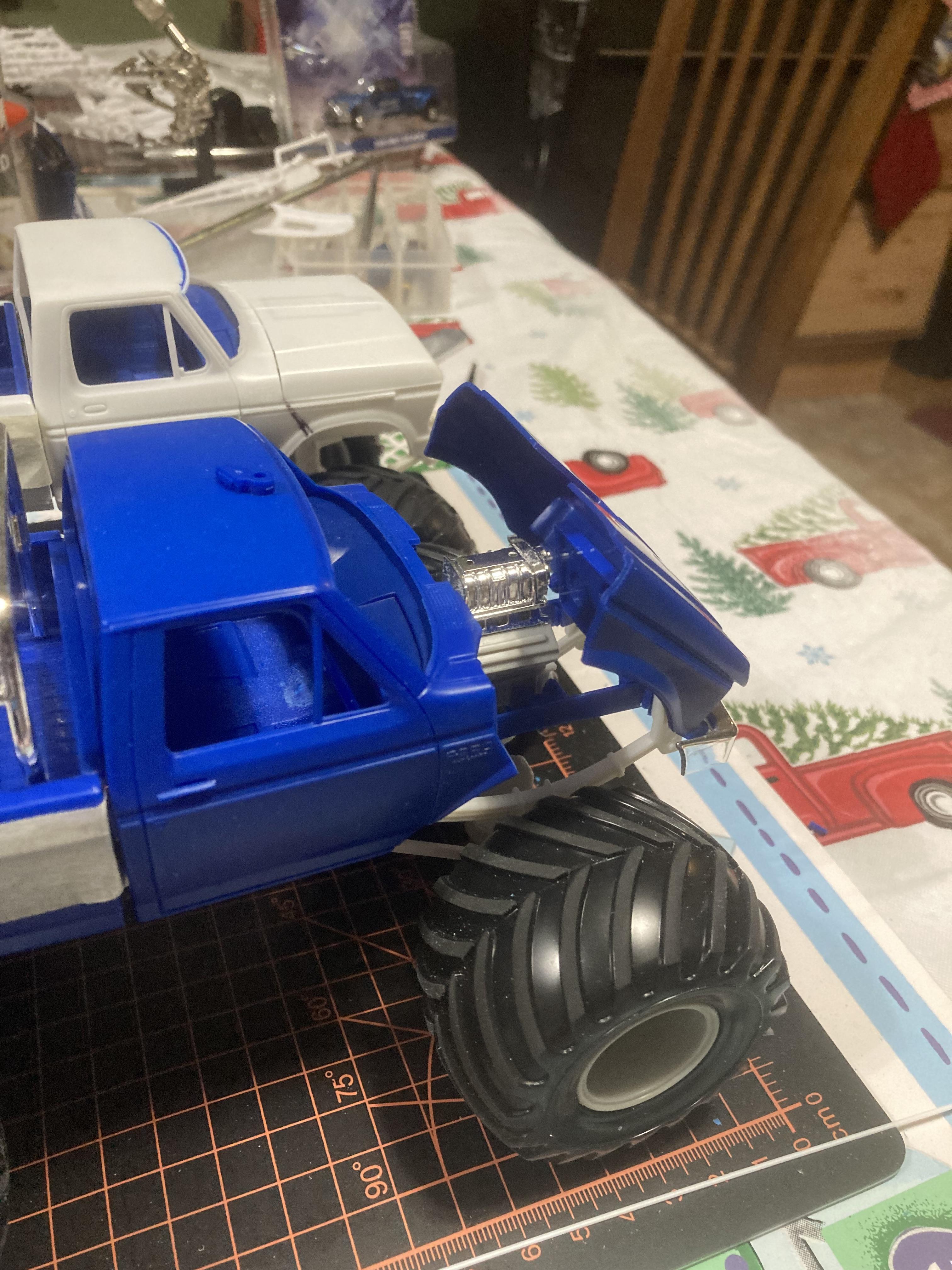

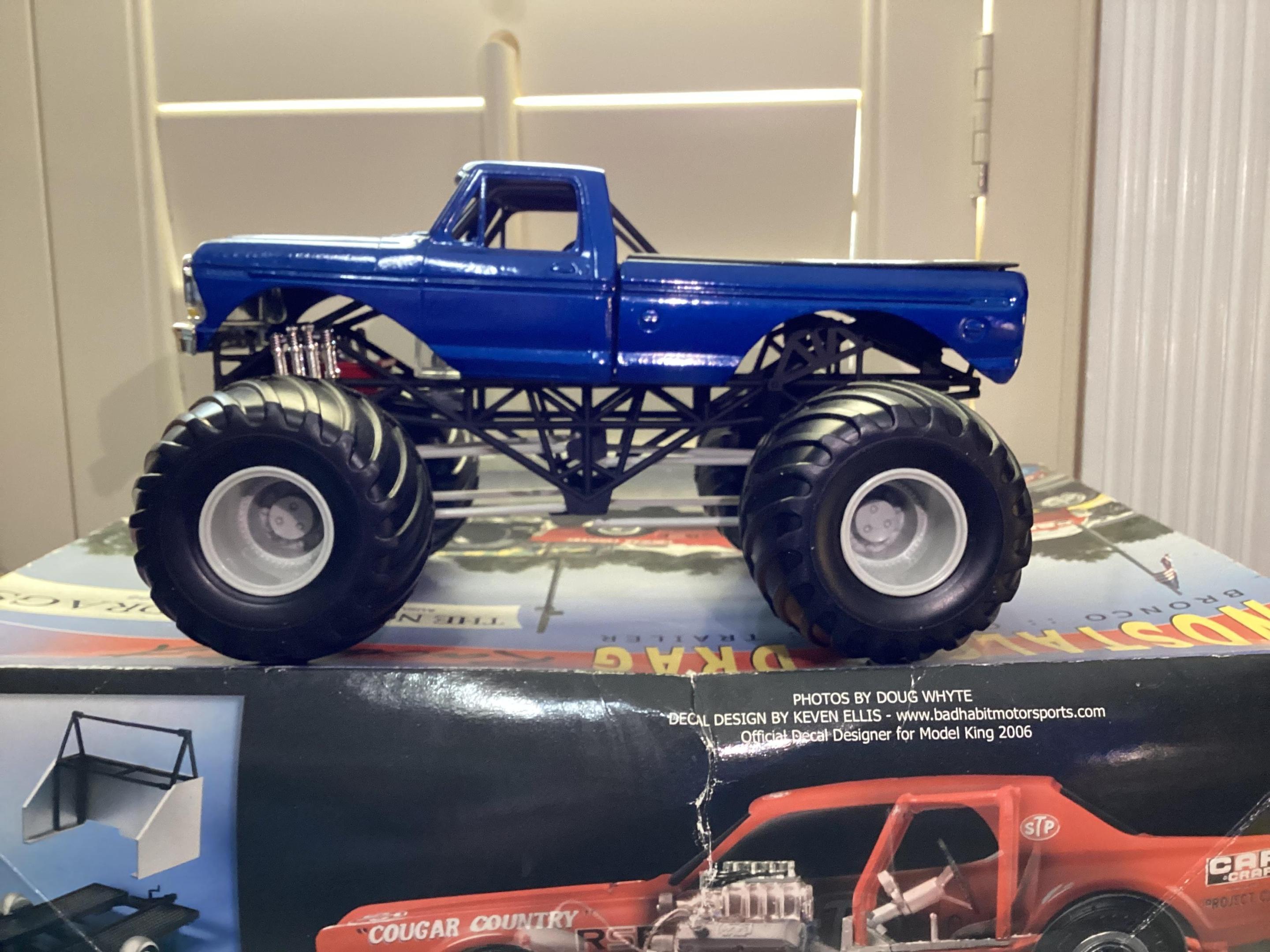

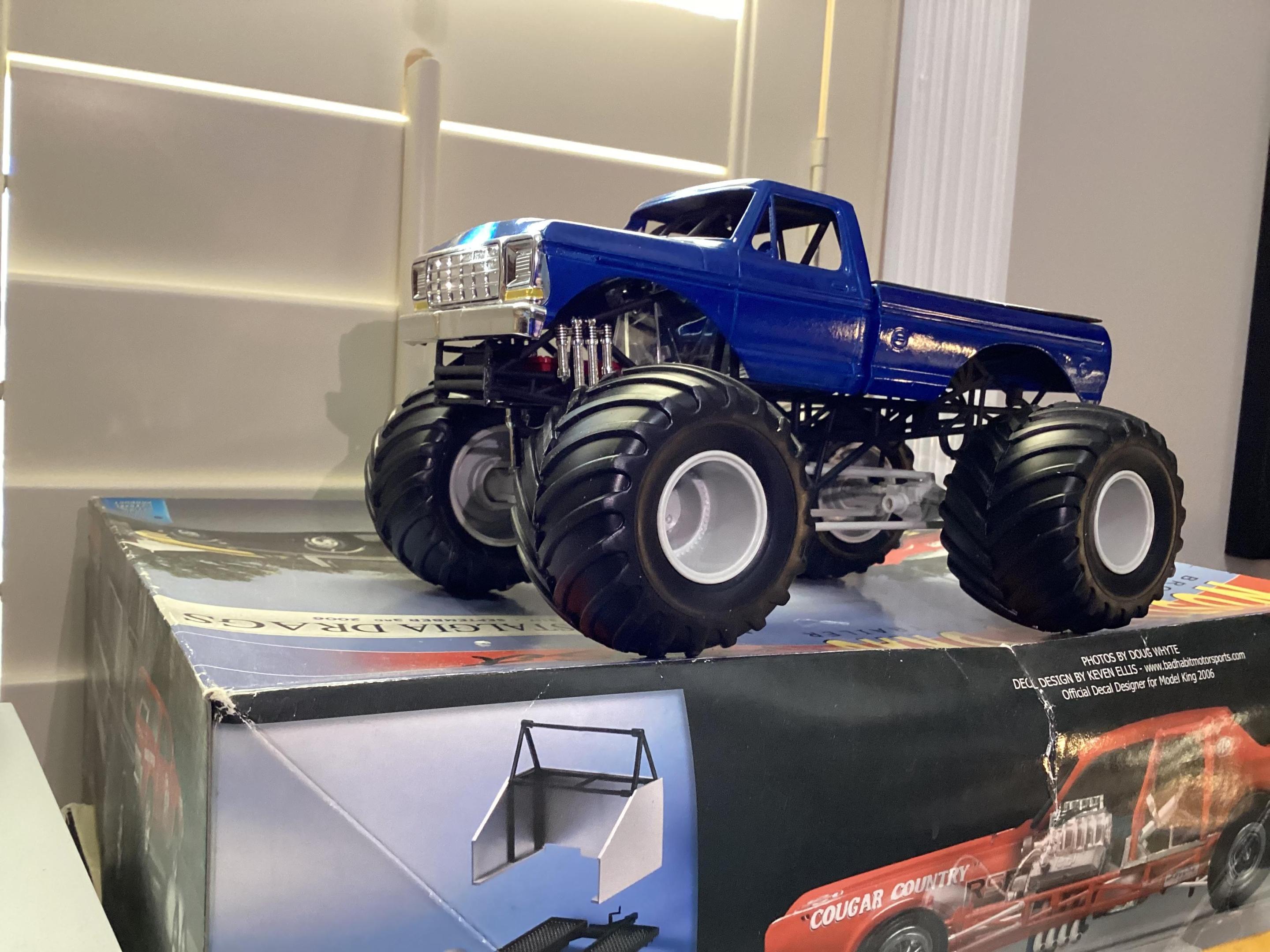

Just got back into model cars, and decided I’d start with my most favorite subject matter…Monster Trucks. Especially Bigfoot. Here’s some photos I’ve taken over the course of the build. Started 3 weeks ago.

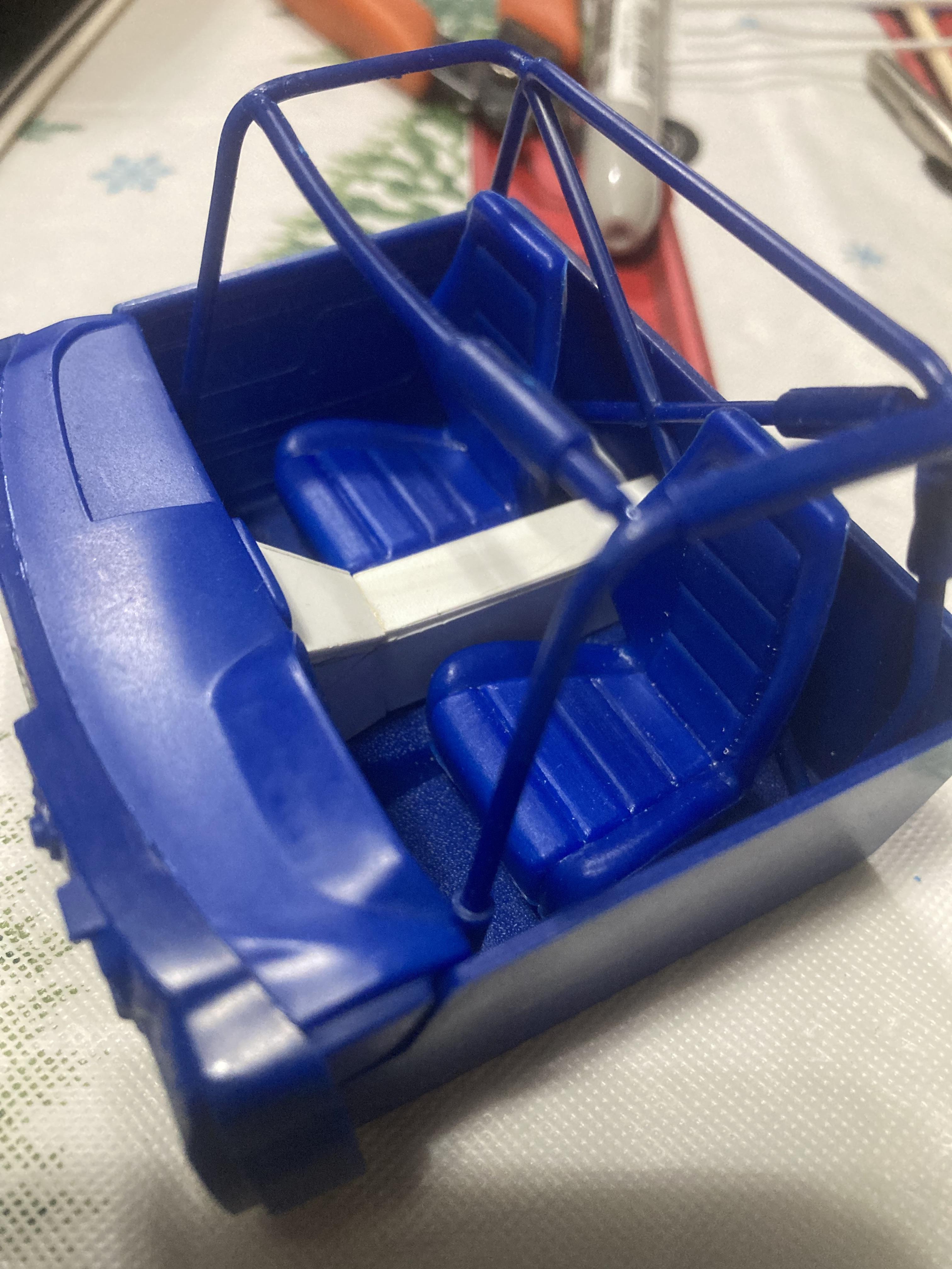

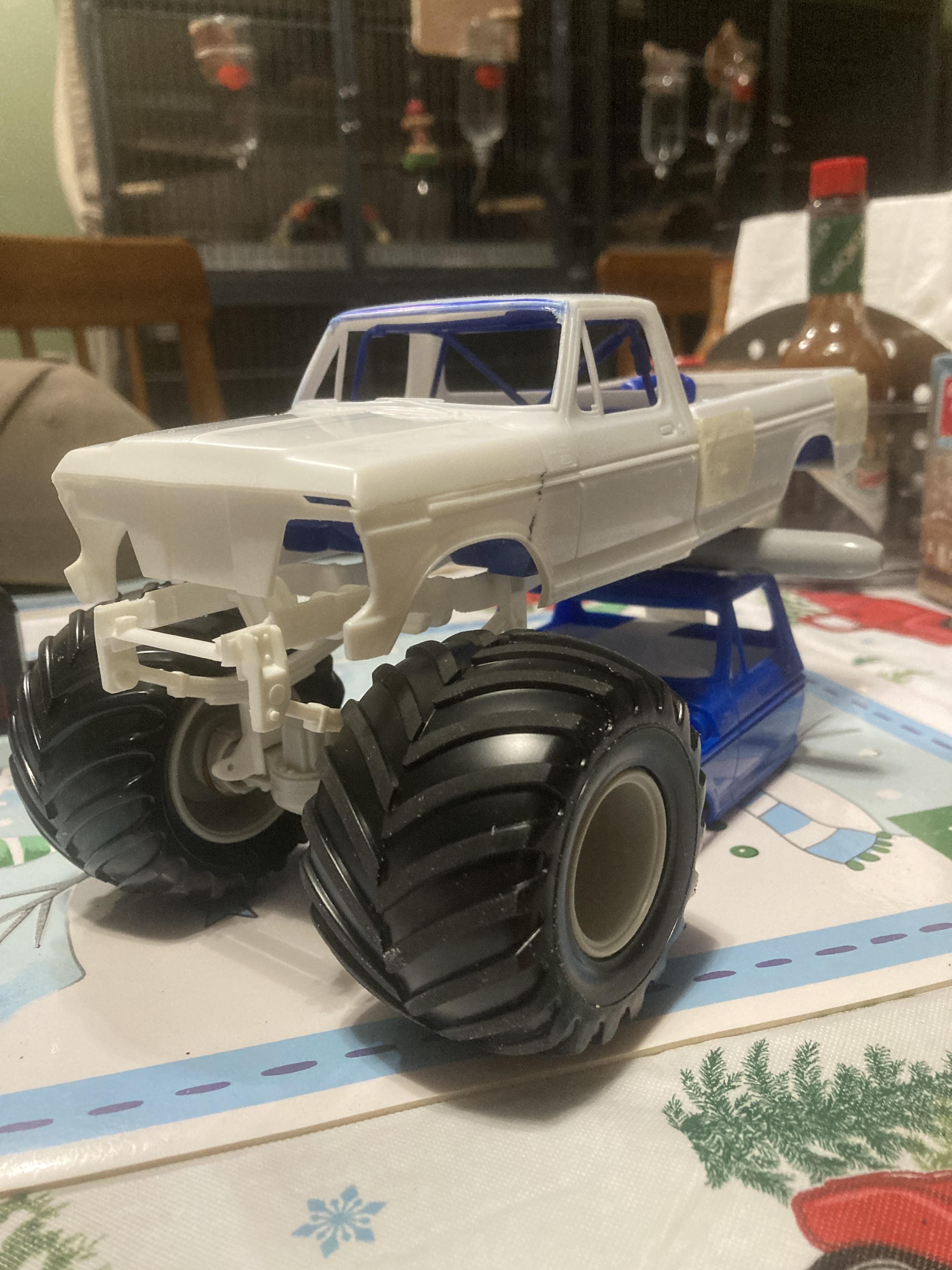

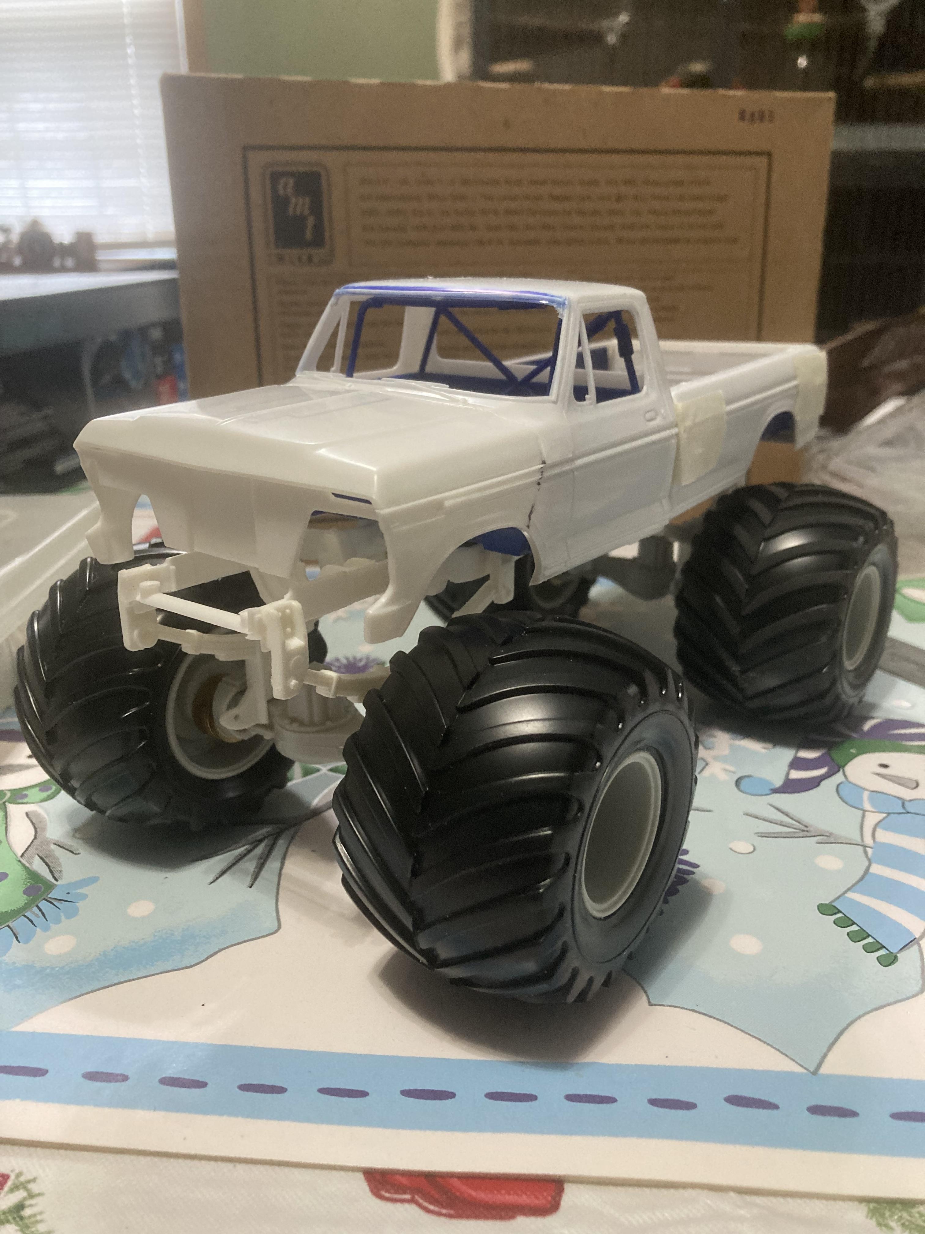

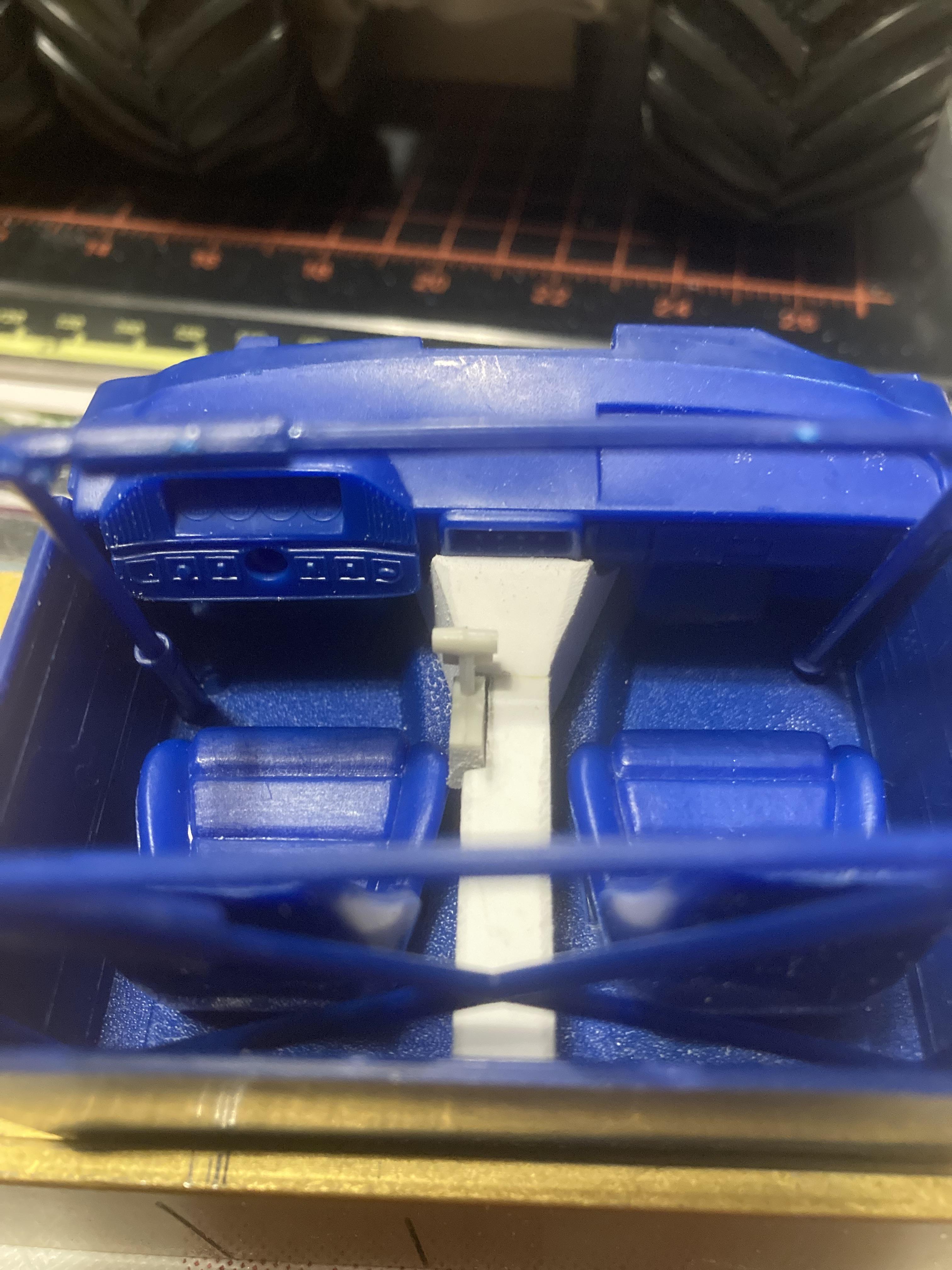

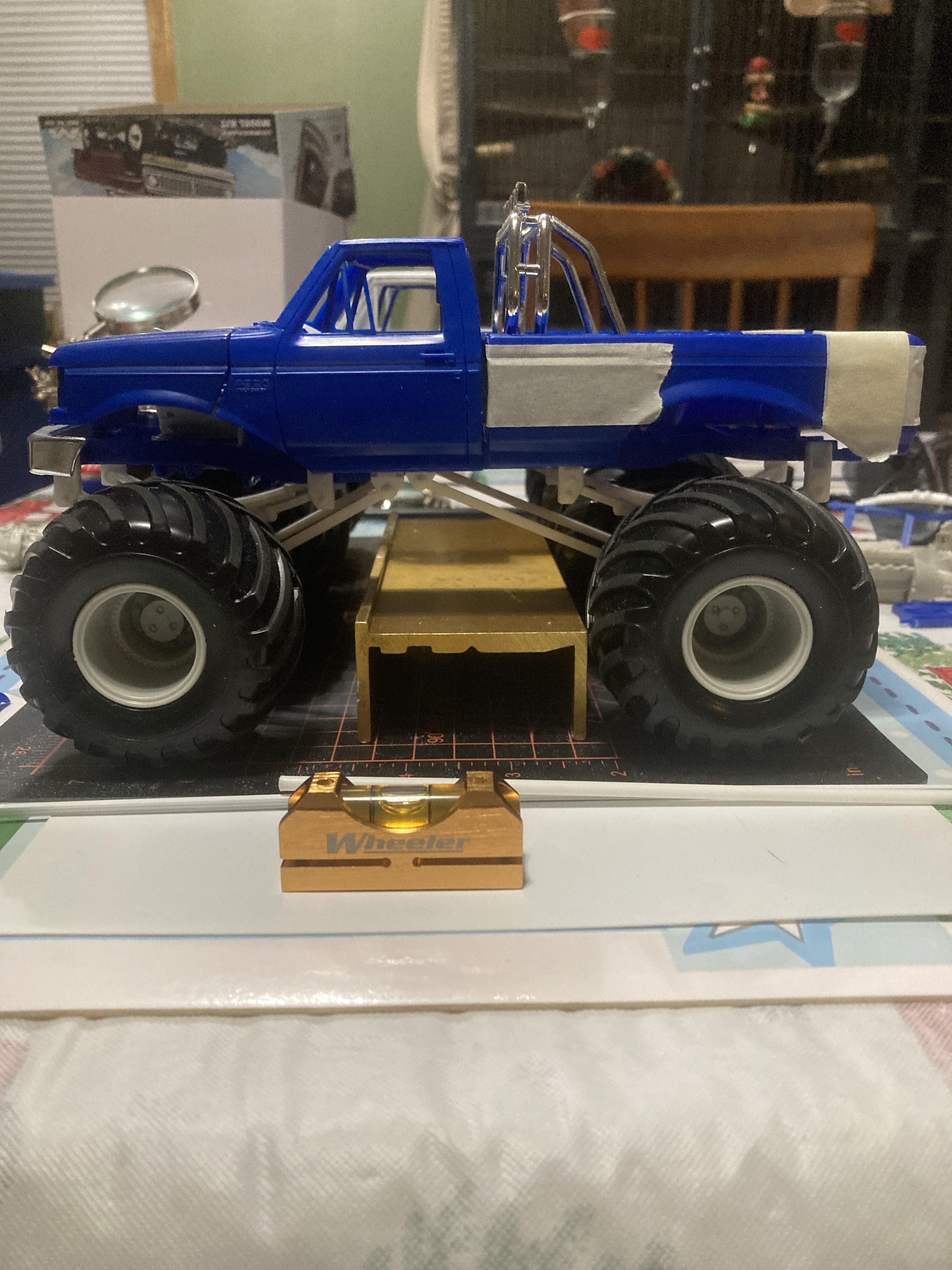

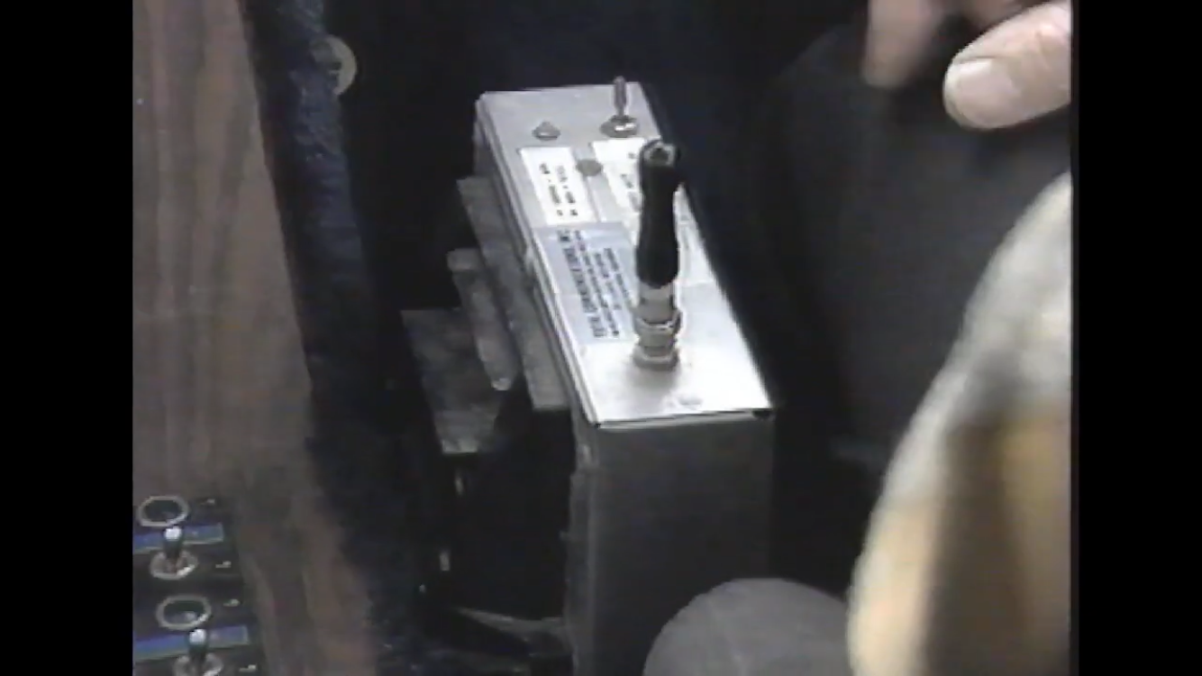

Did some more work on these two tonight…worked on getting rid of the dreaded cab lean, and am building a center console for Bigfoot 3. I found a YouTube video where a morning show had a woman drive Bigfoot, as a request…Bob Chandler filled that request. During the video there are some in cab shots of the center console, shifter location, RII box, and gauges, as well as gauges on the dash. So, I’m tackling that now. The kit interior is pretty crammed, so I’m having to do the best I can with what space I have available.

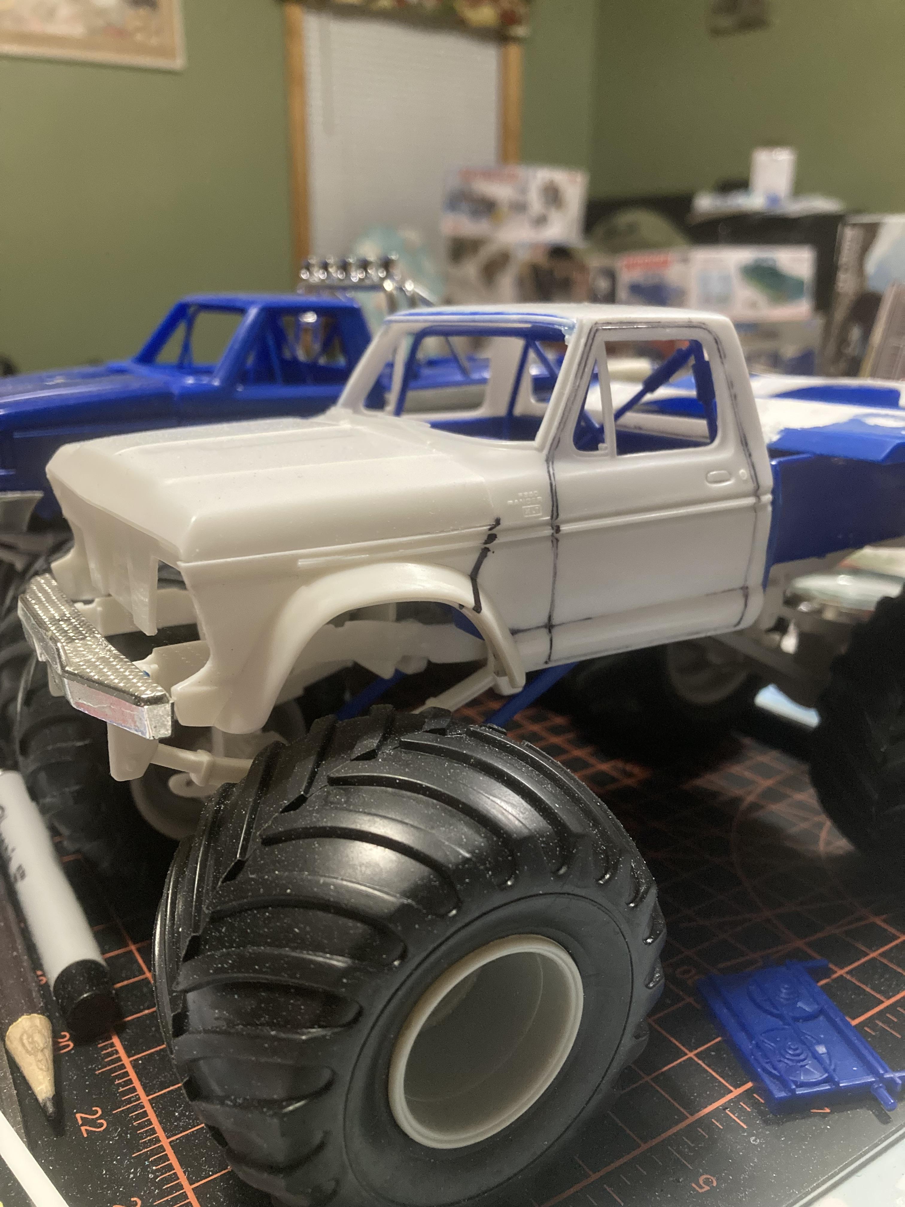

Thanks much. As you can see, I'm not starting with an actual kit for Bigfoot 1...ebay folks want $400 for sealed kits and parts aren't much better in price. So, I'm kitbashing this one from a 78 Super Stones, the second release Bigfoot, USA-1, and some parts I got in a model car junk yard years back. The engine is from a Bigfoot 10 reissue, heads and valve covers are from a 55 Juke Box pro mod, and I of course had to correct the fenders myself. There will be some detail master engine stuff going on soon enough. Just correcting all the wrongs first. I honestly don't know why people are asking $400 for those kits. They are not that great.

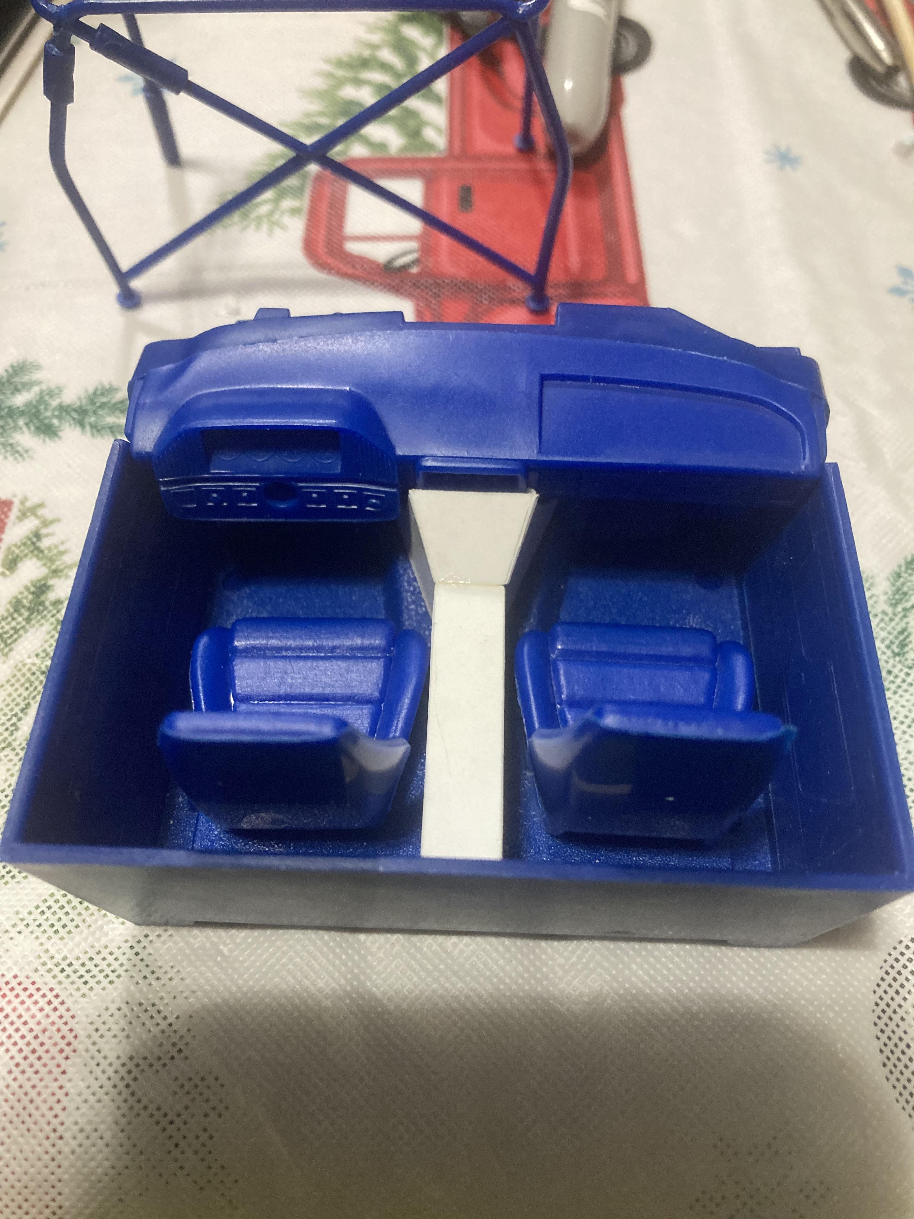

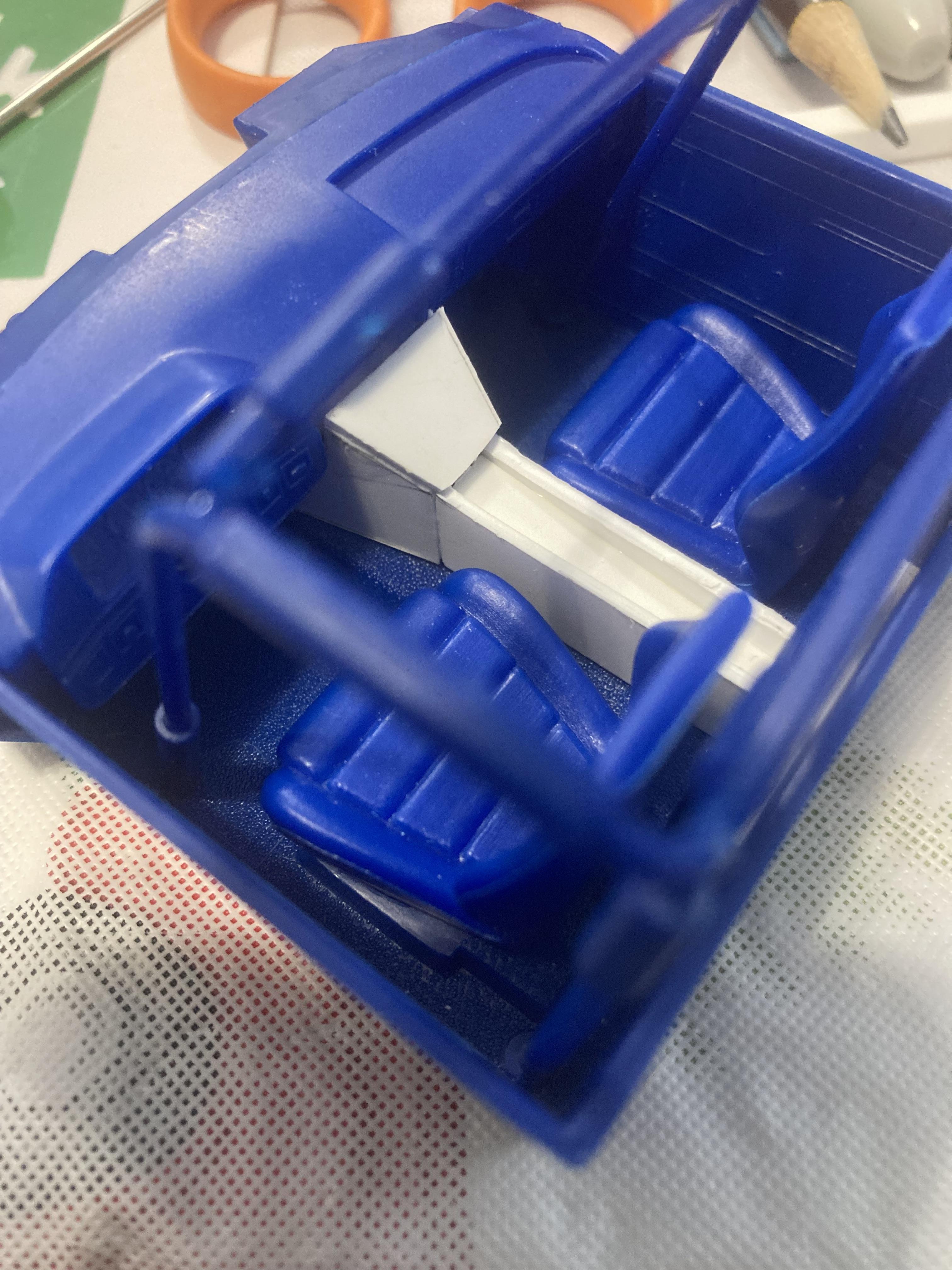

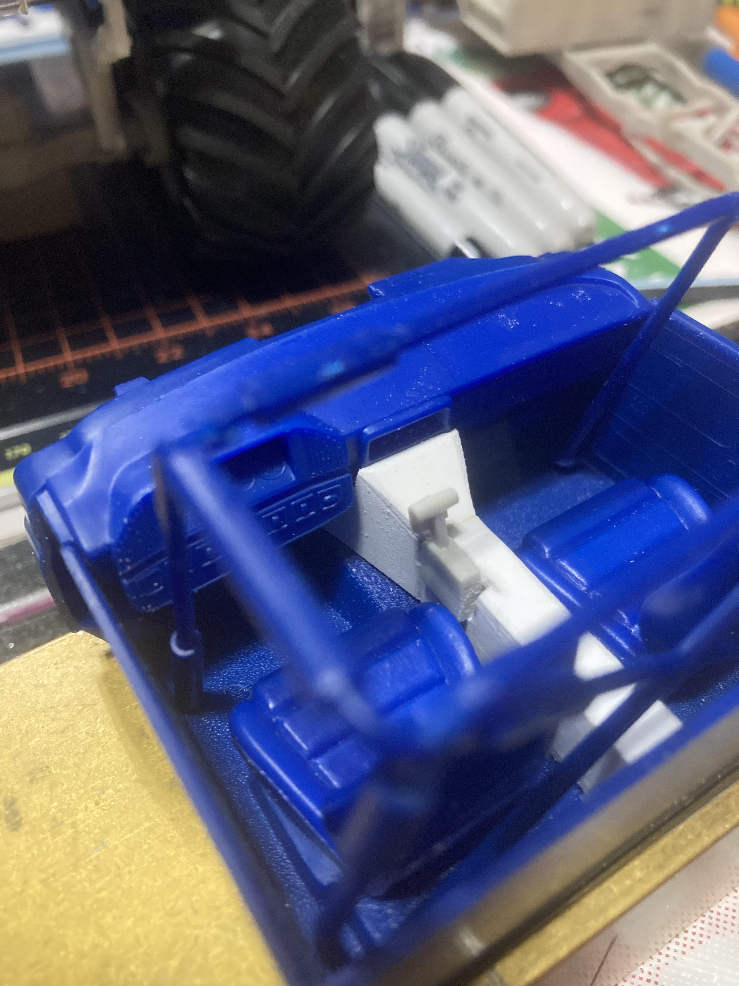

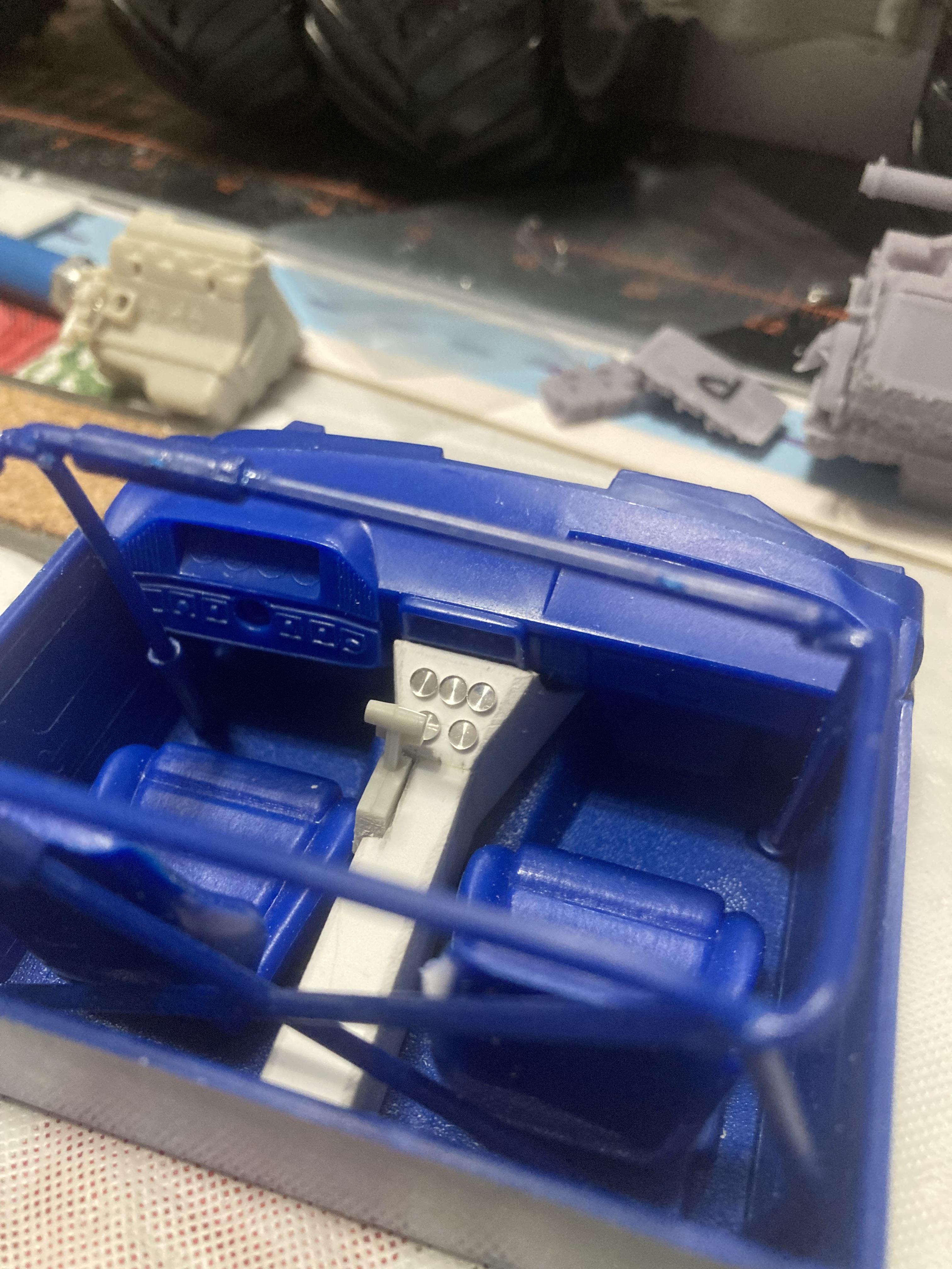

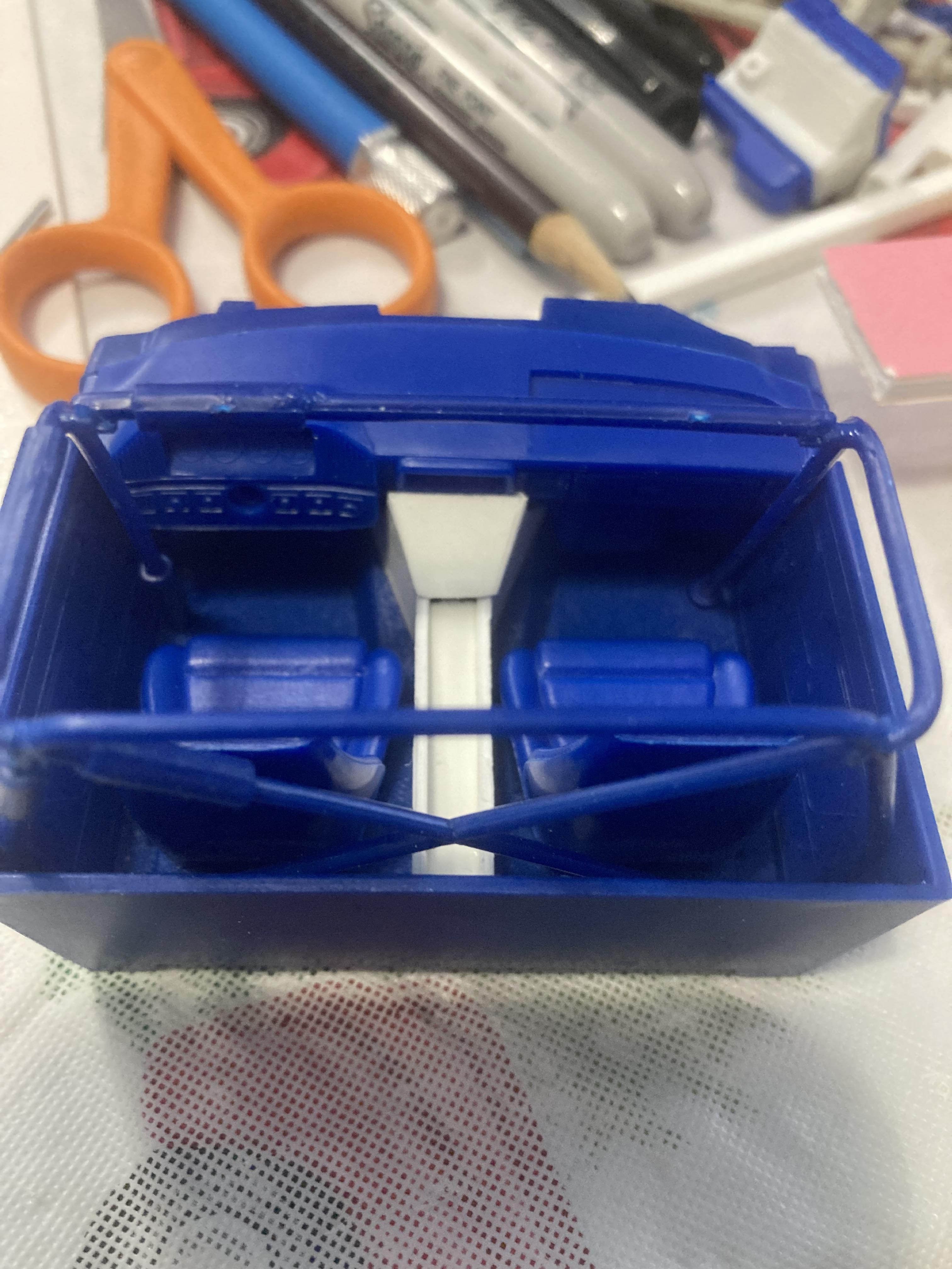

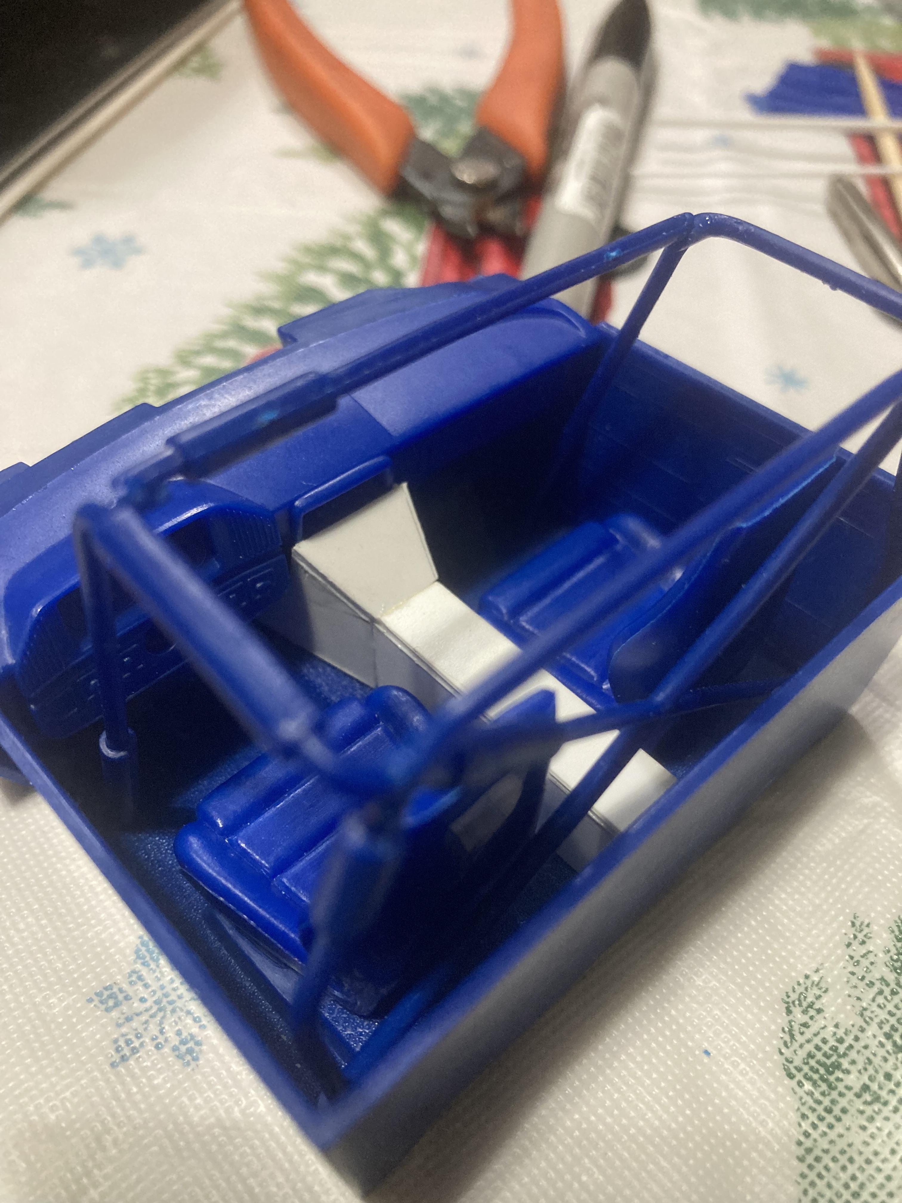

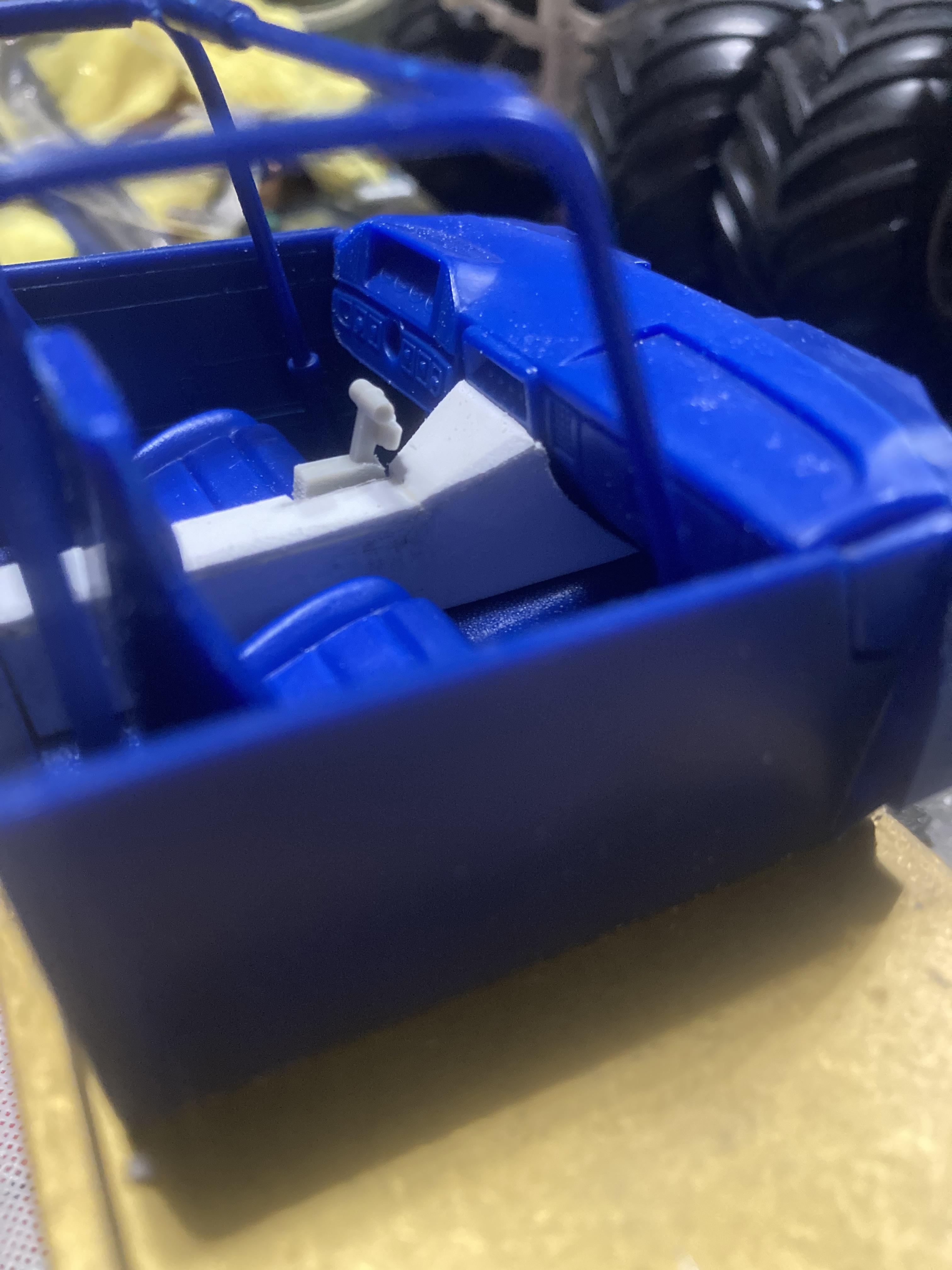

Worked on Bigfoot 3 center console some more last night. Just getting the basic shape and making sure it’s somewhat symmetrical. The large trapezoidal piece will have gauges placed in it from detail masters, little round gauge faces, #3227. I’ll mark out and drill holes to place them into, to replicate the gauges Bob had in the 1:1 truck. The shifter I’m using is from the Bigfoot 10 kit, and will have to be inset at about the front corner of the drivers seat, and an RII box will be a modified plow control box from a moebius 72 ford ranger plow truck. I’m still working on what I want to do for the console arm rest just behind the shifter. Anyone know a good source for scale wood grain decals?

Another update to Bigfoot 3…not much to report on Bigfoot 1

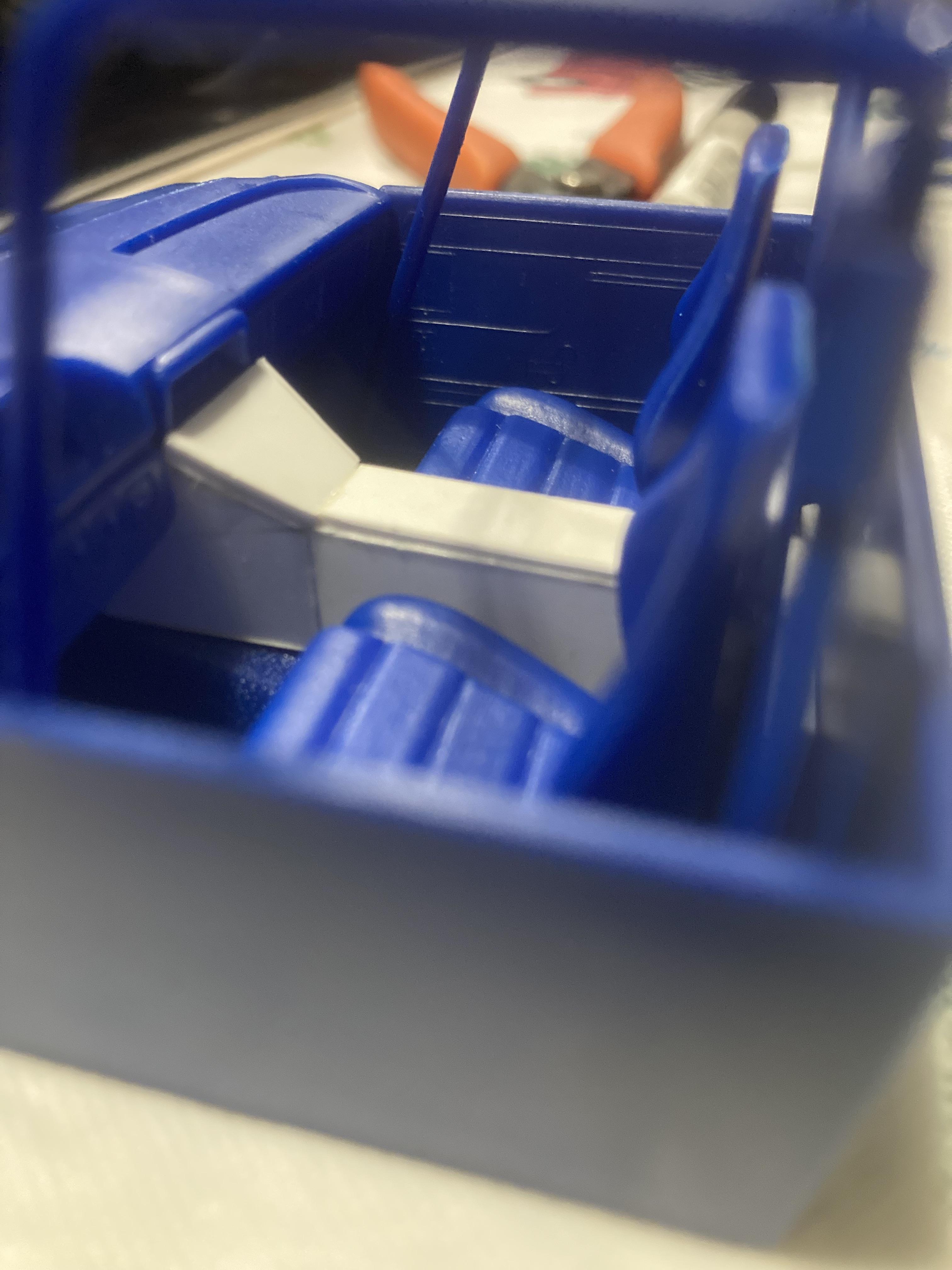

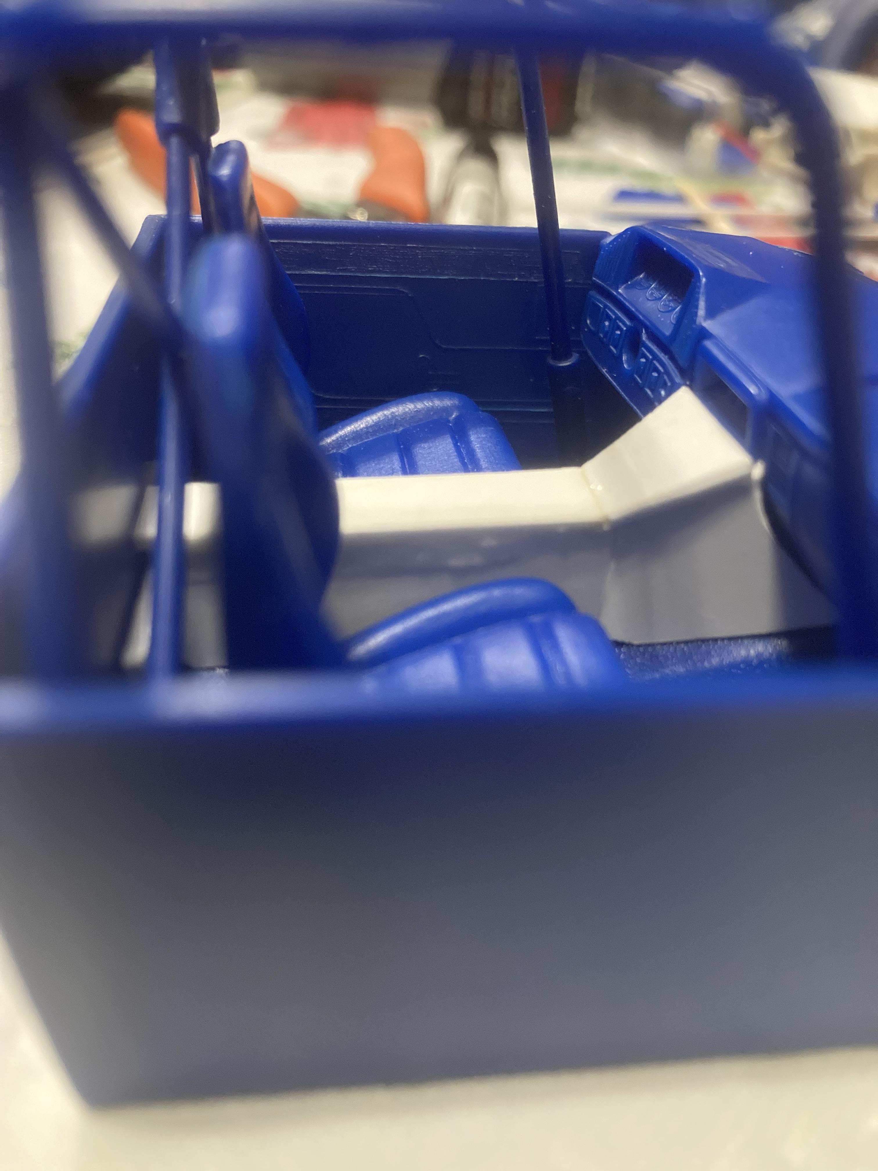

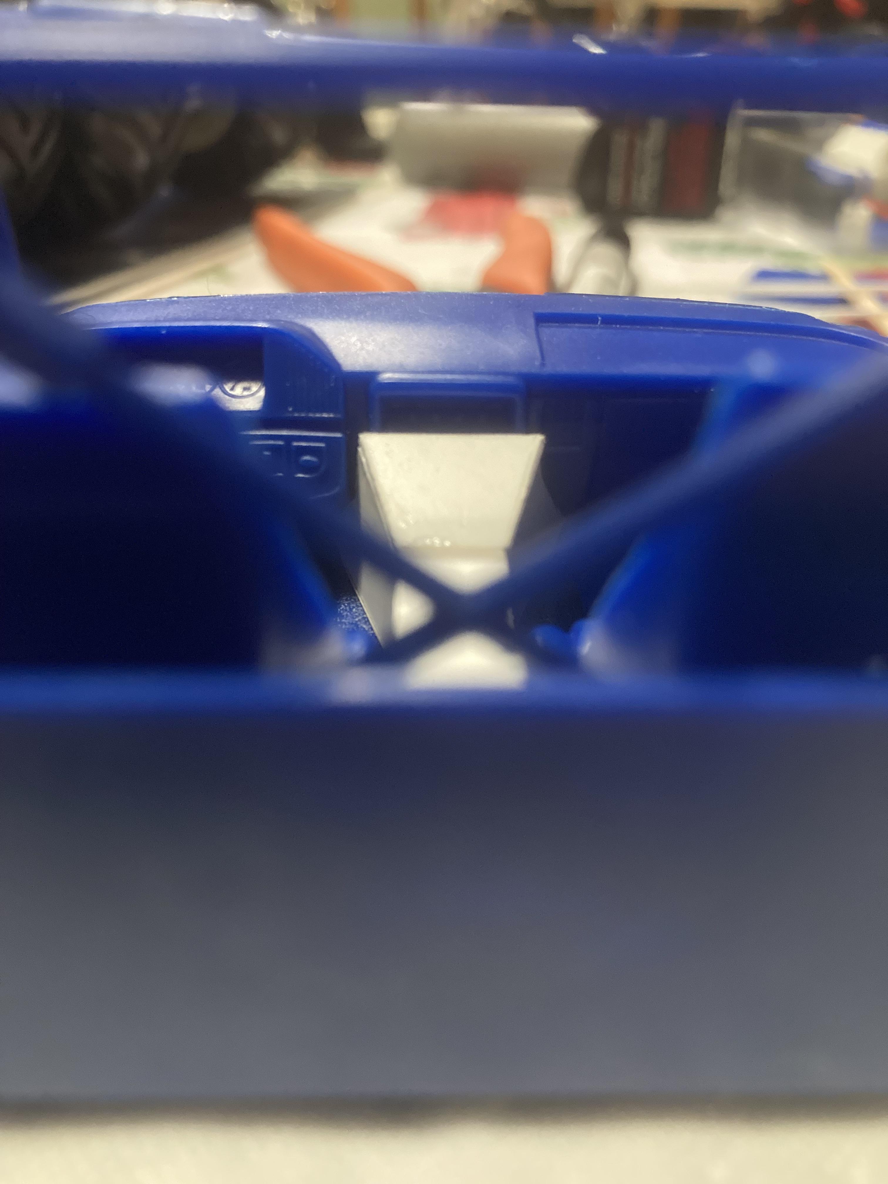

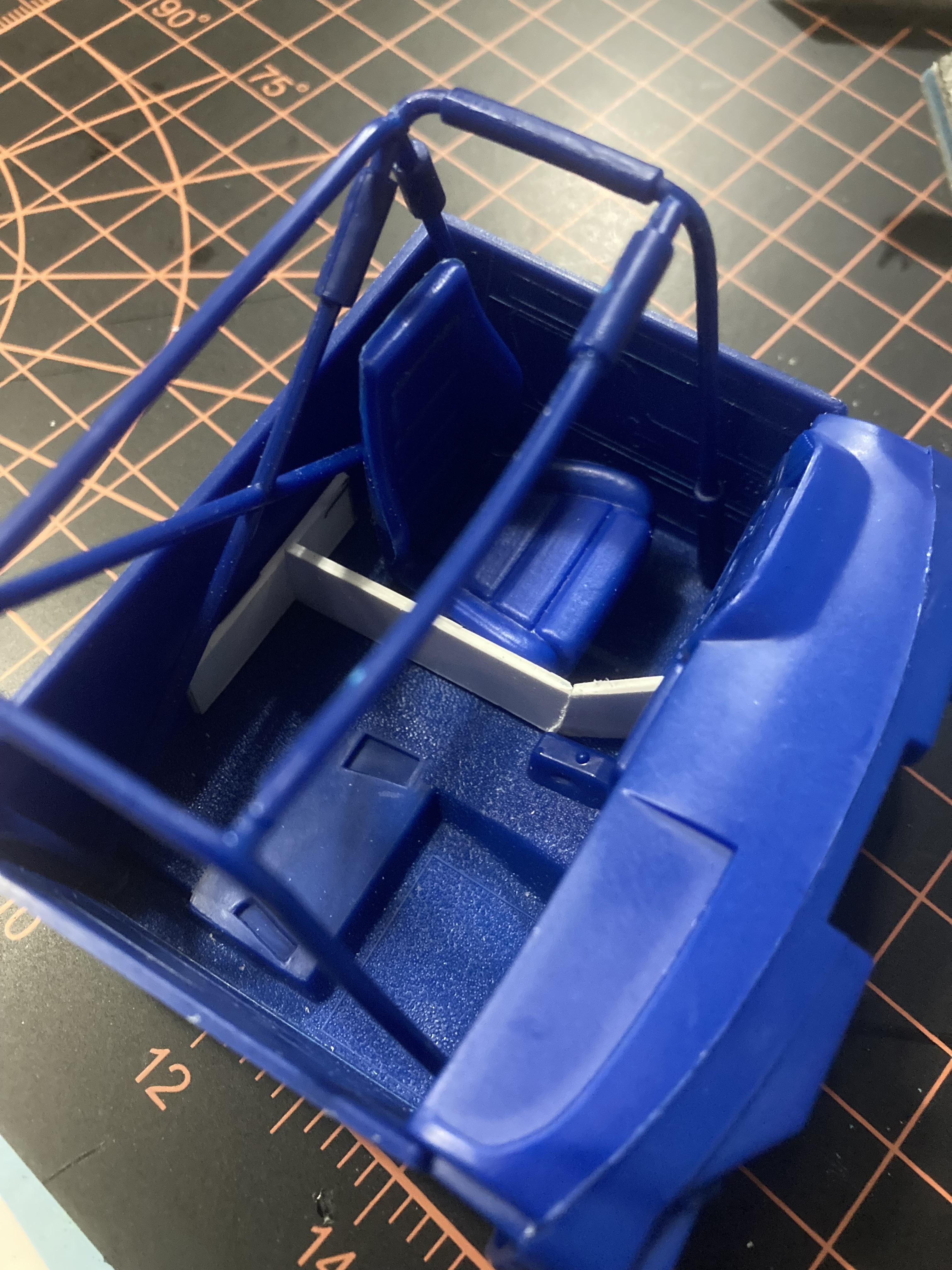

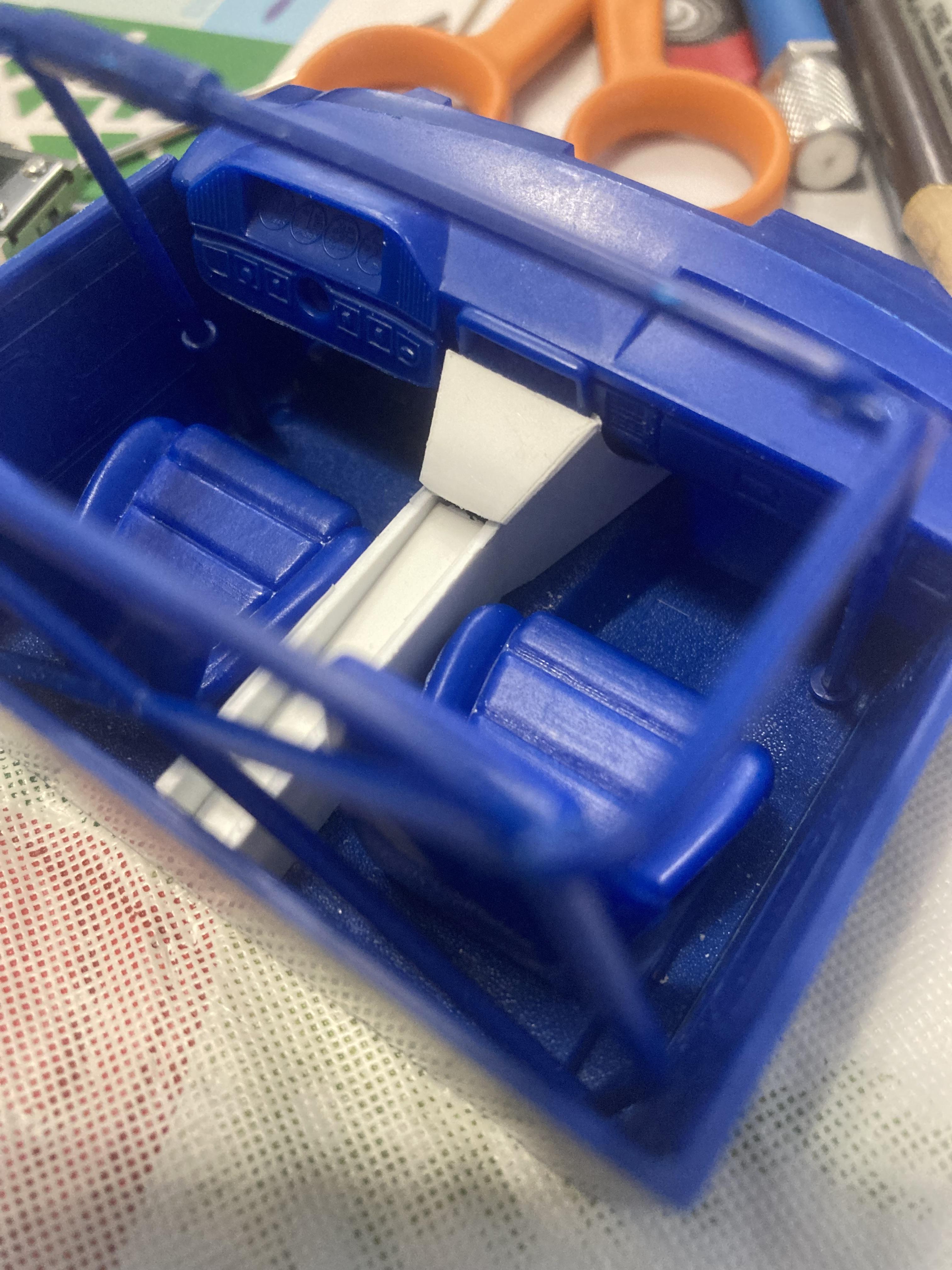

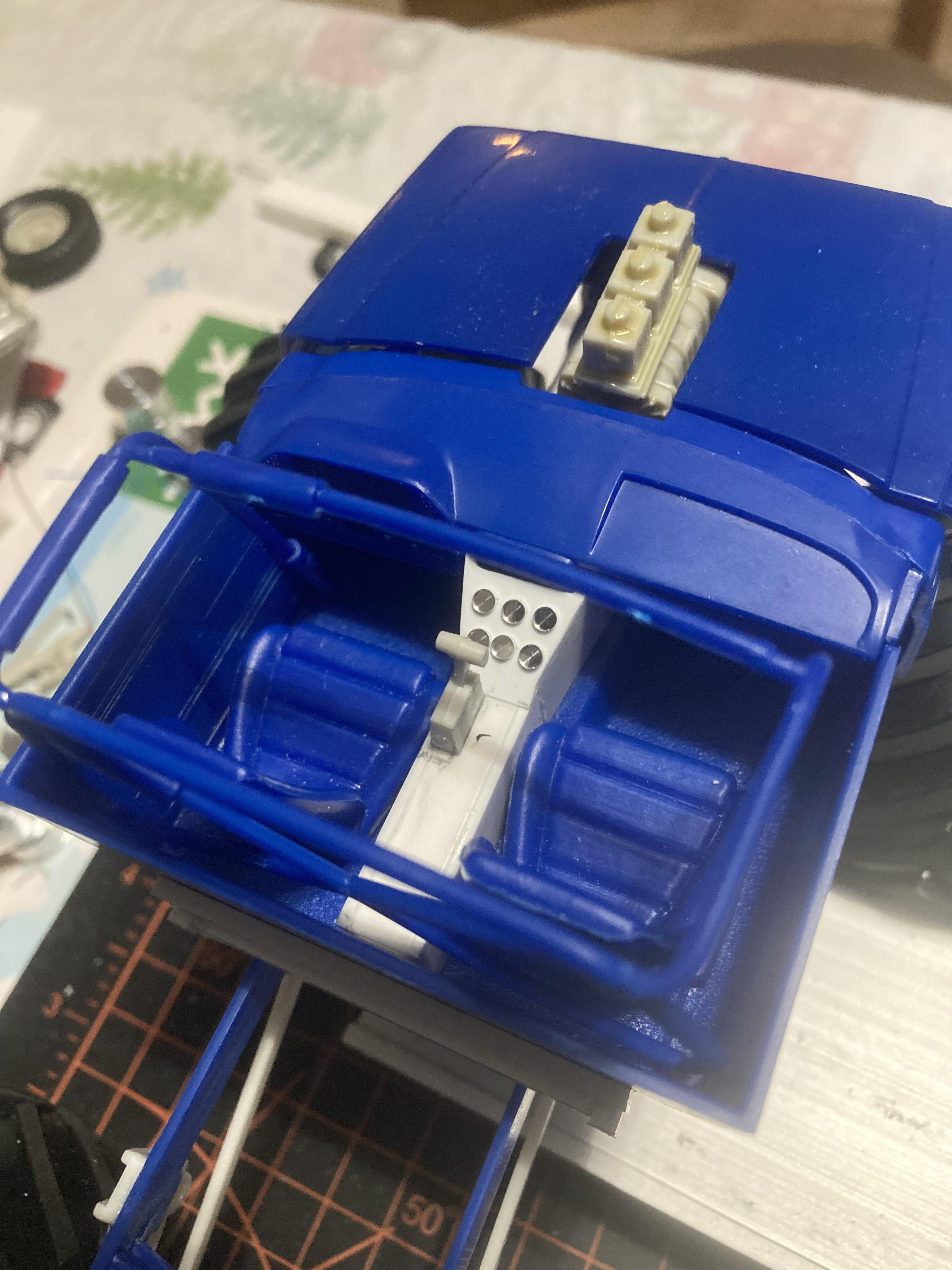

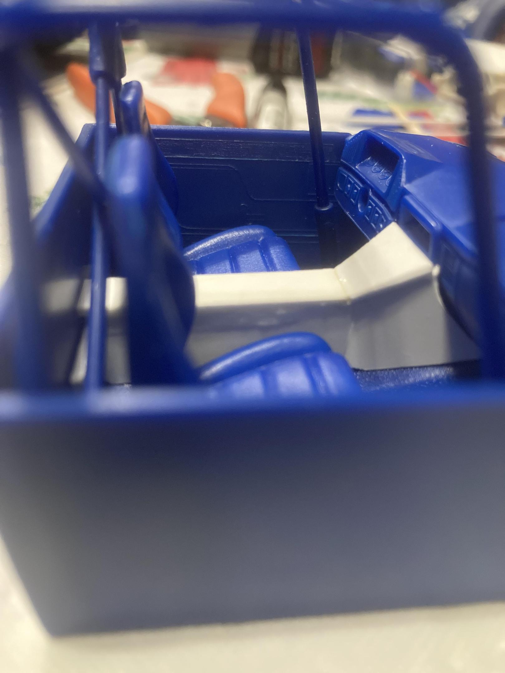

First, the interiors center console is looking much more like one would expect…a few shots in the perspective of looking through the cab glass, rollcage in normal position…at this point I’m satisfied with its basic shape, and will now start sanding it to final form, then lay out my gauge holes, and inlet the shifter box…then start building the bracket that holds the RII box…for anyone curios what an RII box is, it’s a Remote Ignition Interrupter…you can shut the truck down remotely in case of runaway, or bodily injury is imminent. Bob claims to have developed this technology for the safety of the sport, so I’ll include it in the cab, as seen in previous photos.

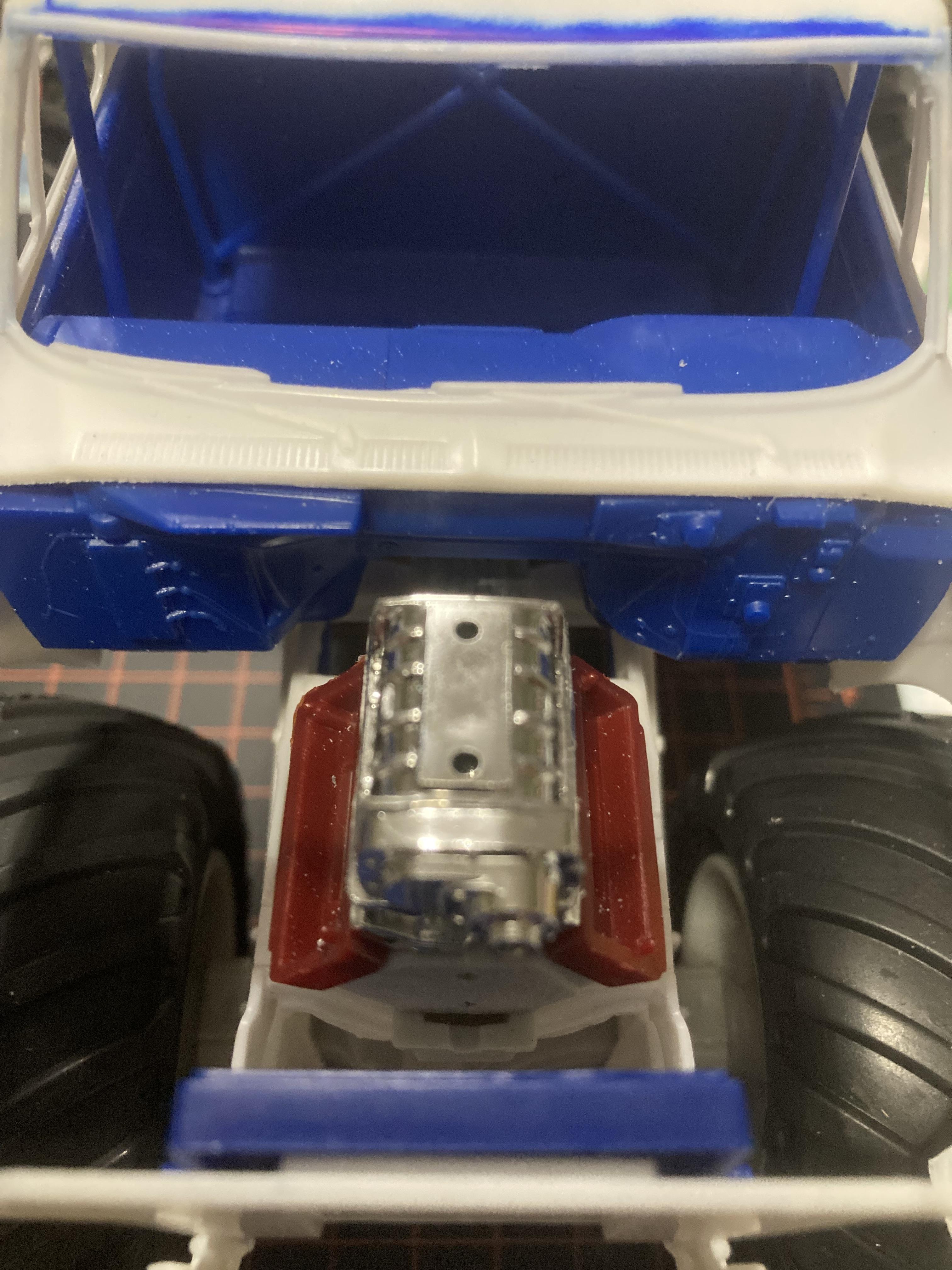

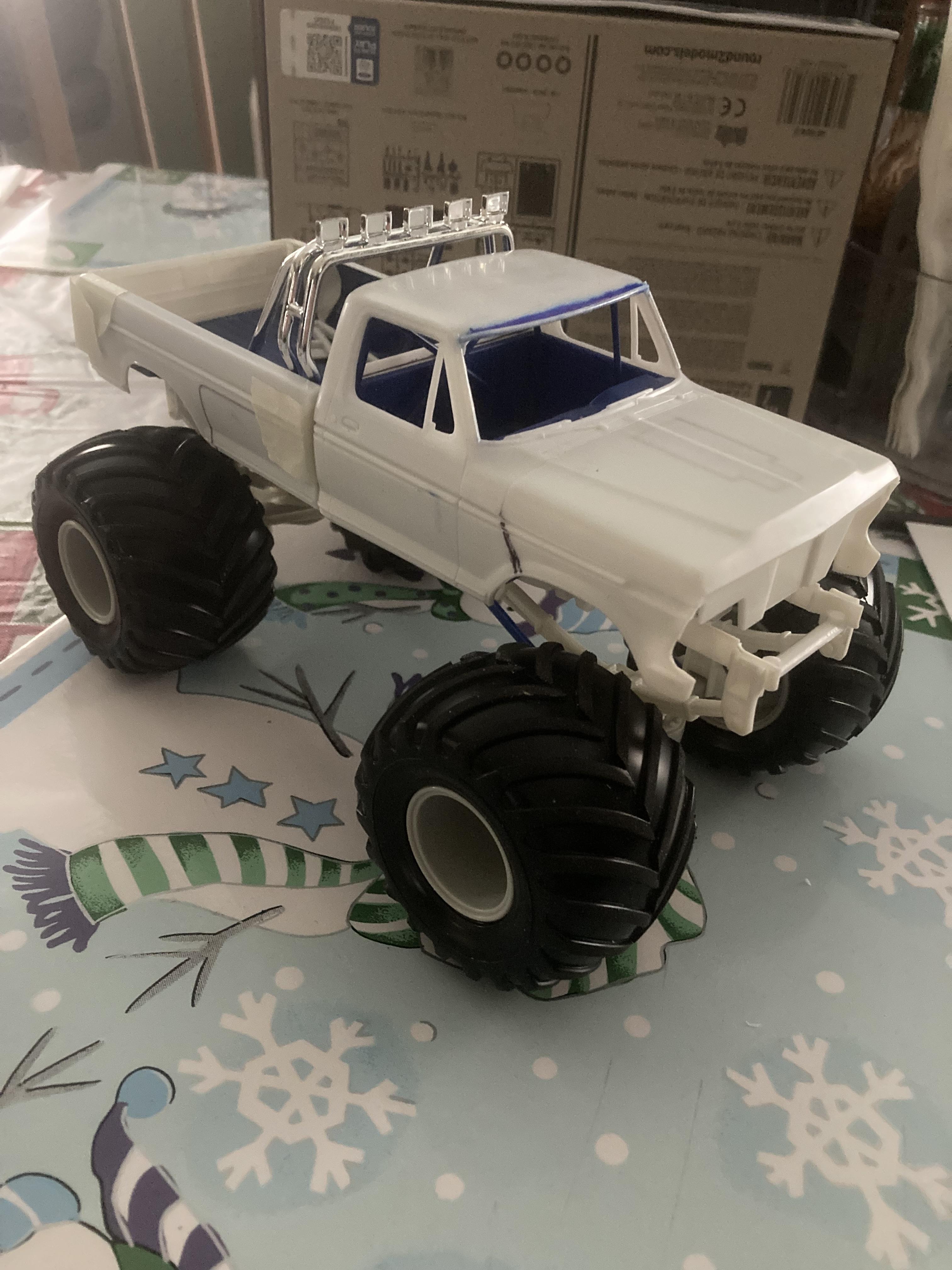

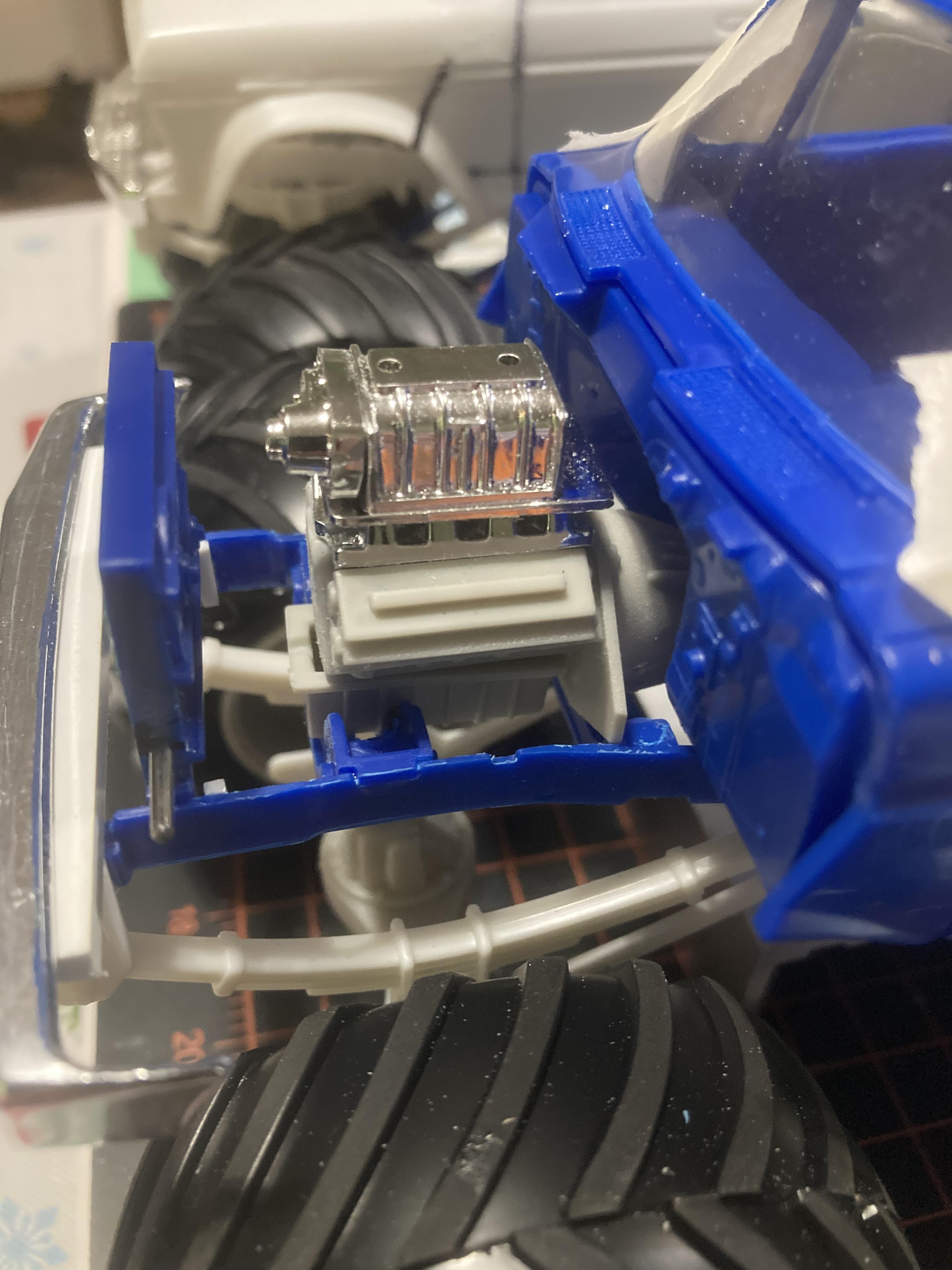

Second, I think I’ve finalized placement of the engine and radiator in BF3…the frame places it too far forward, causing the hood to sag…

Console is sanded to a more final form, and shifter has been inletted into its home base…
The driver seat is encroaching on the shifter box, but I’ll remove the seat tabs and place them where they don’t look so pushed to the center of the cab…

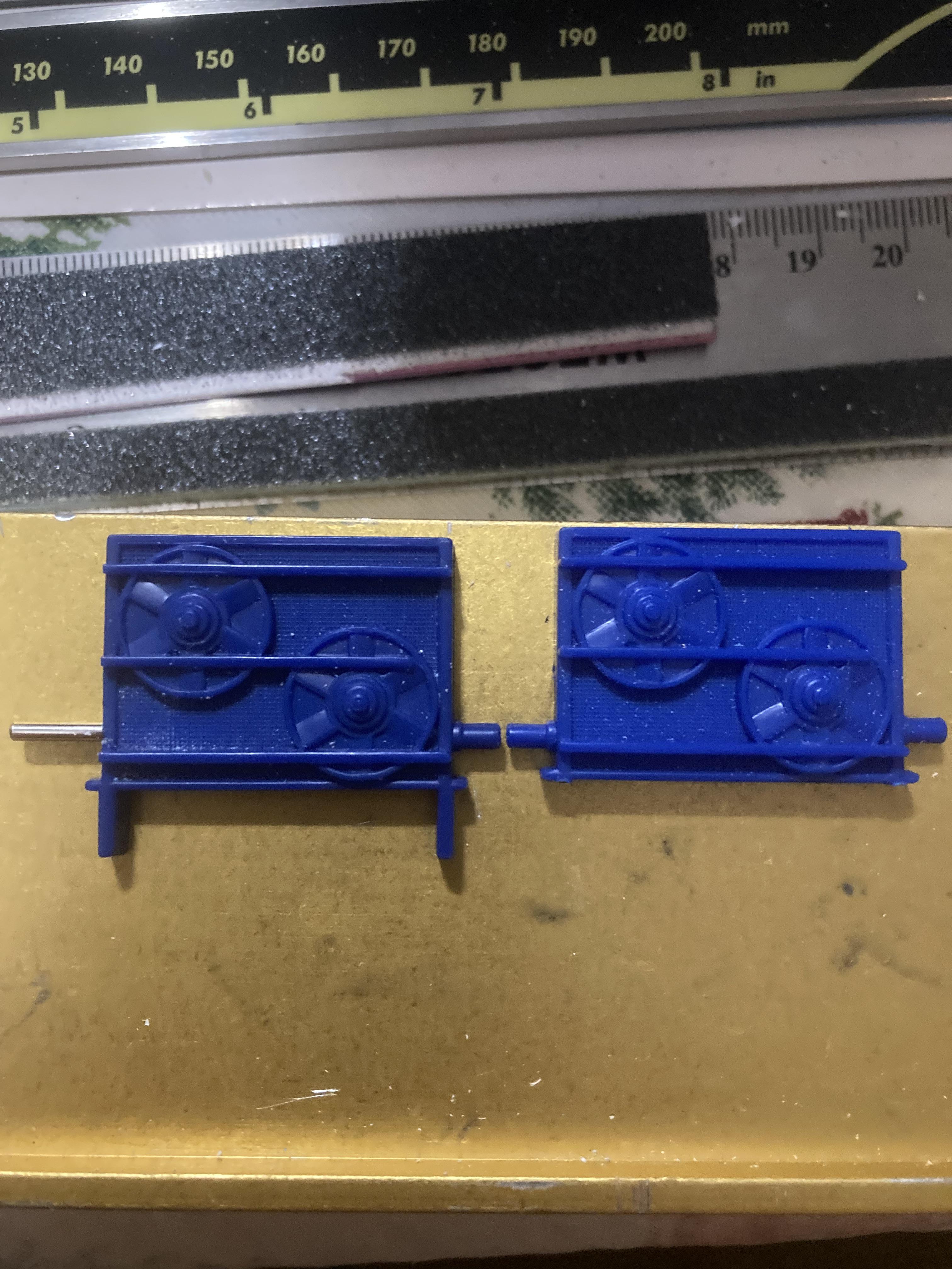

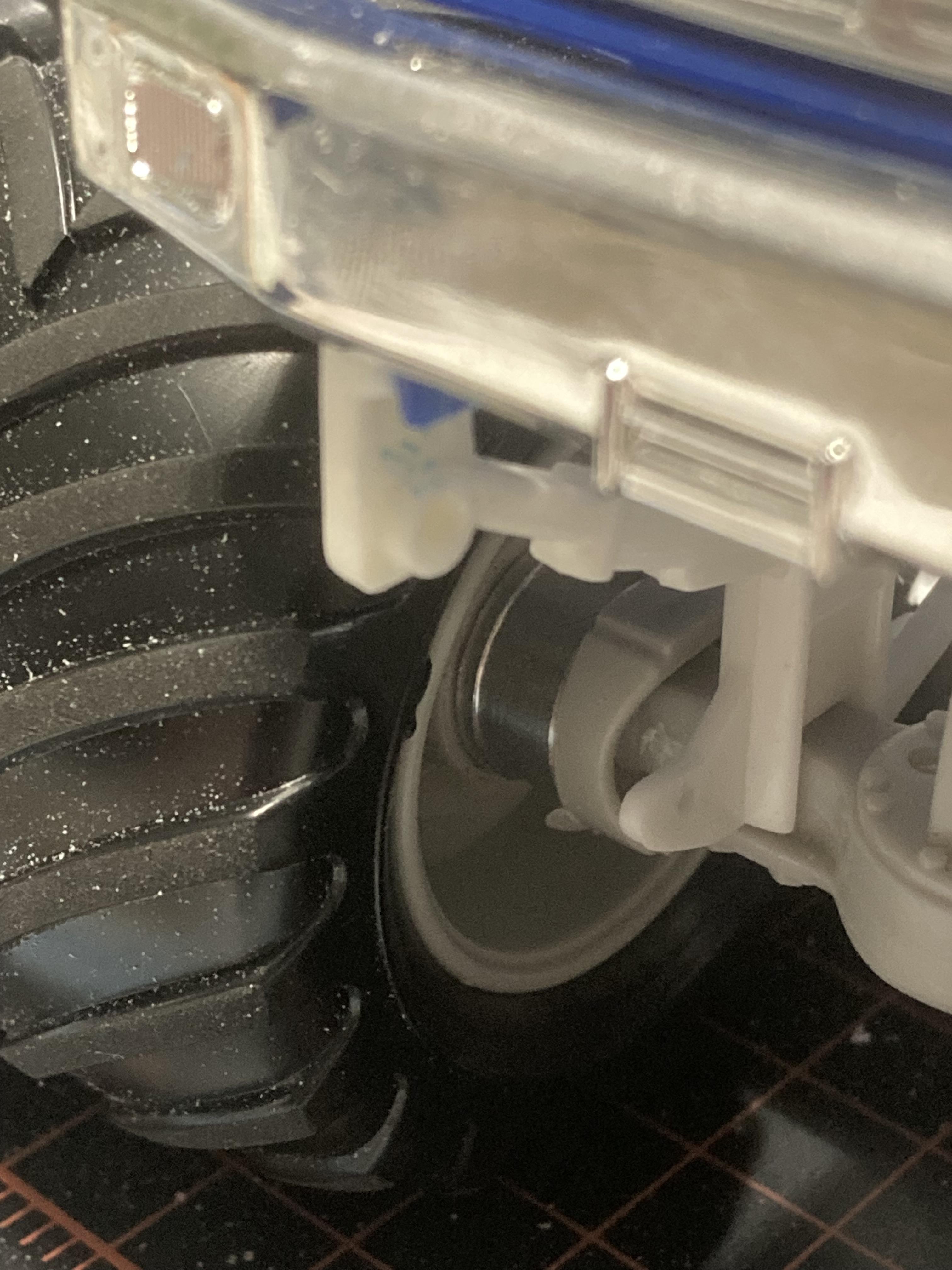

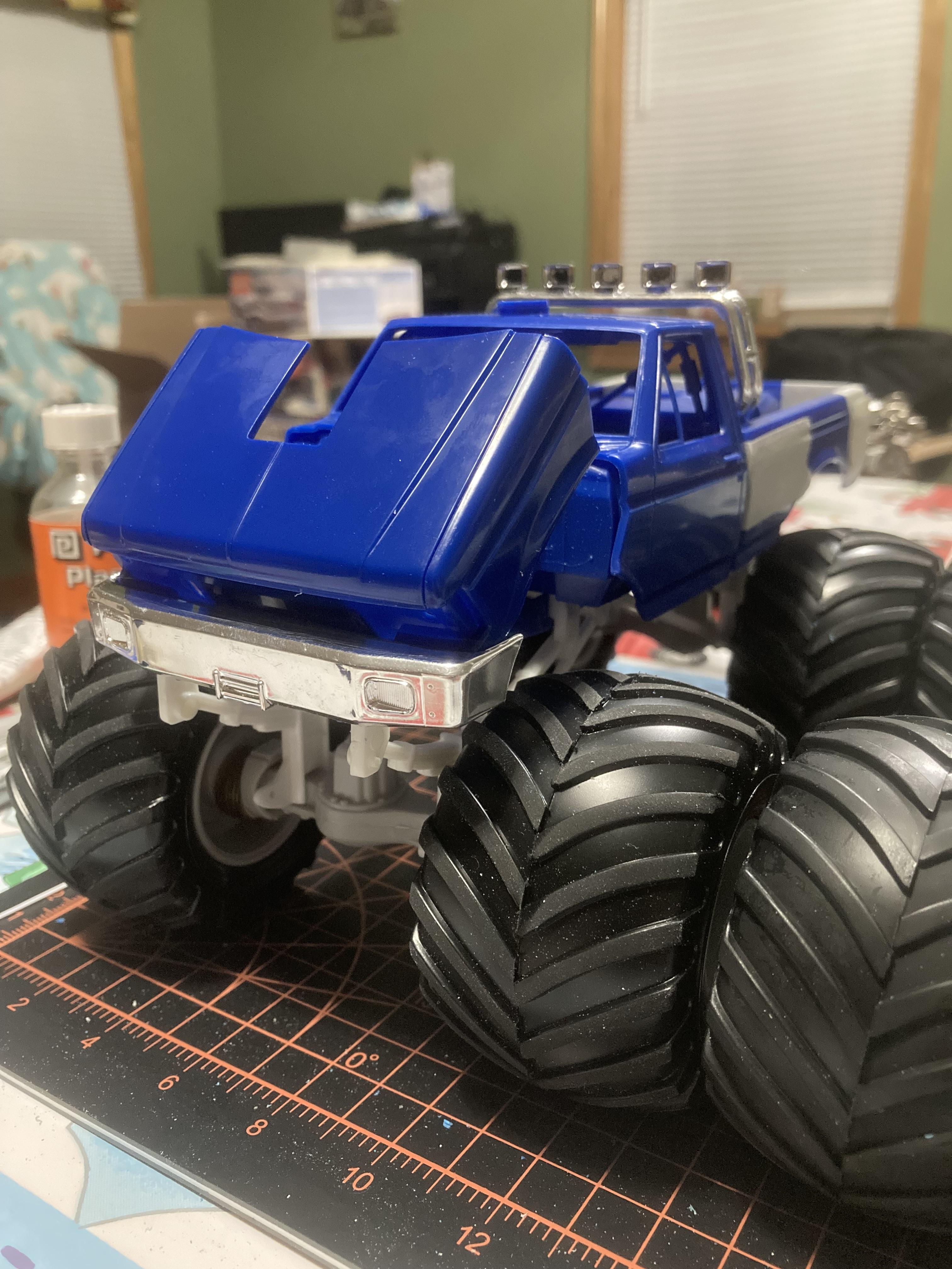

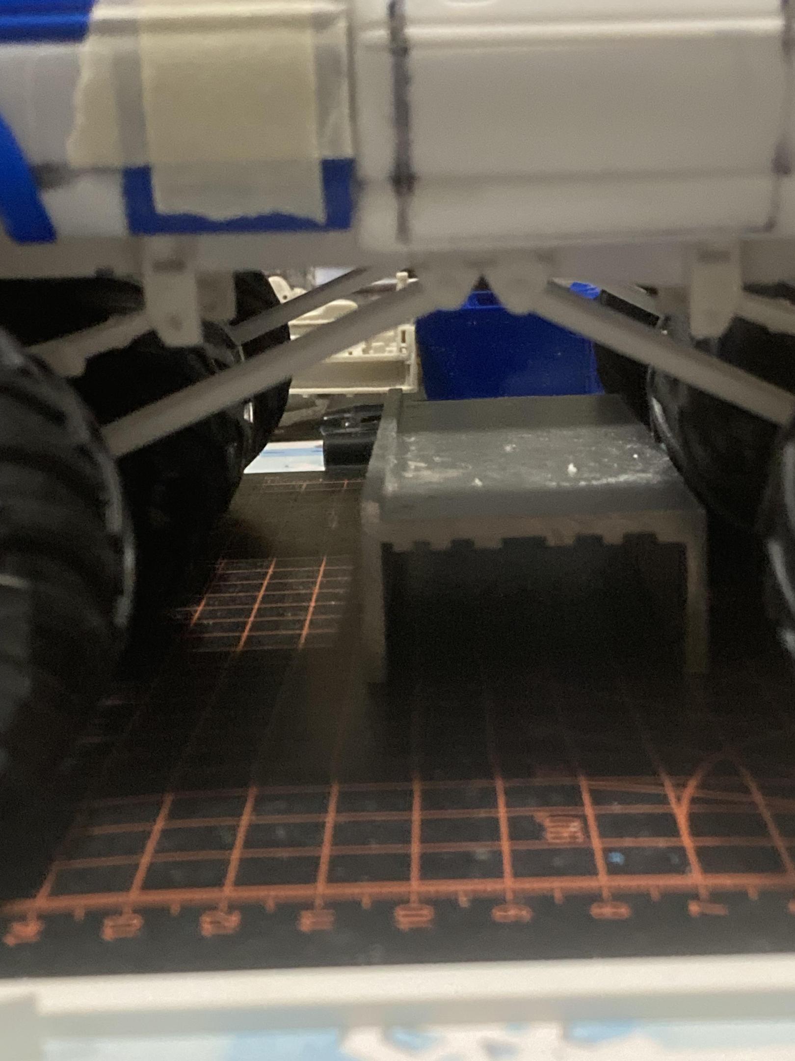

I also corrected the radiator hinge pin issue, which will cause clearance with the hood on final assembly…as you can see in the pictures, it has quite an offset, and was causeing me to scratch my head when things were not lining up quite straight…
With my mock hood, and now a removable pin for the pivot, I was able to see if the hood would now sit level with the bumper…as can be seen, it’s quite good…

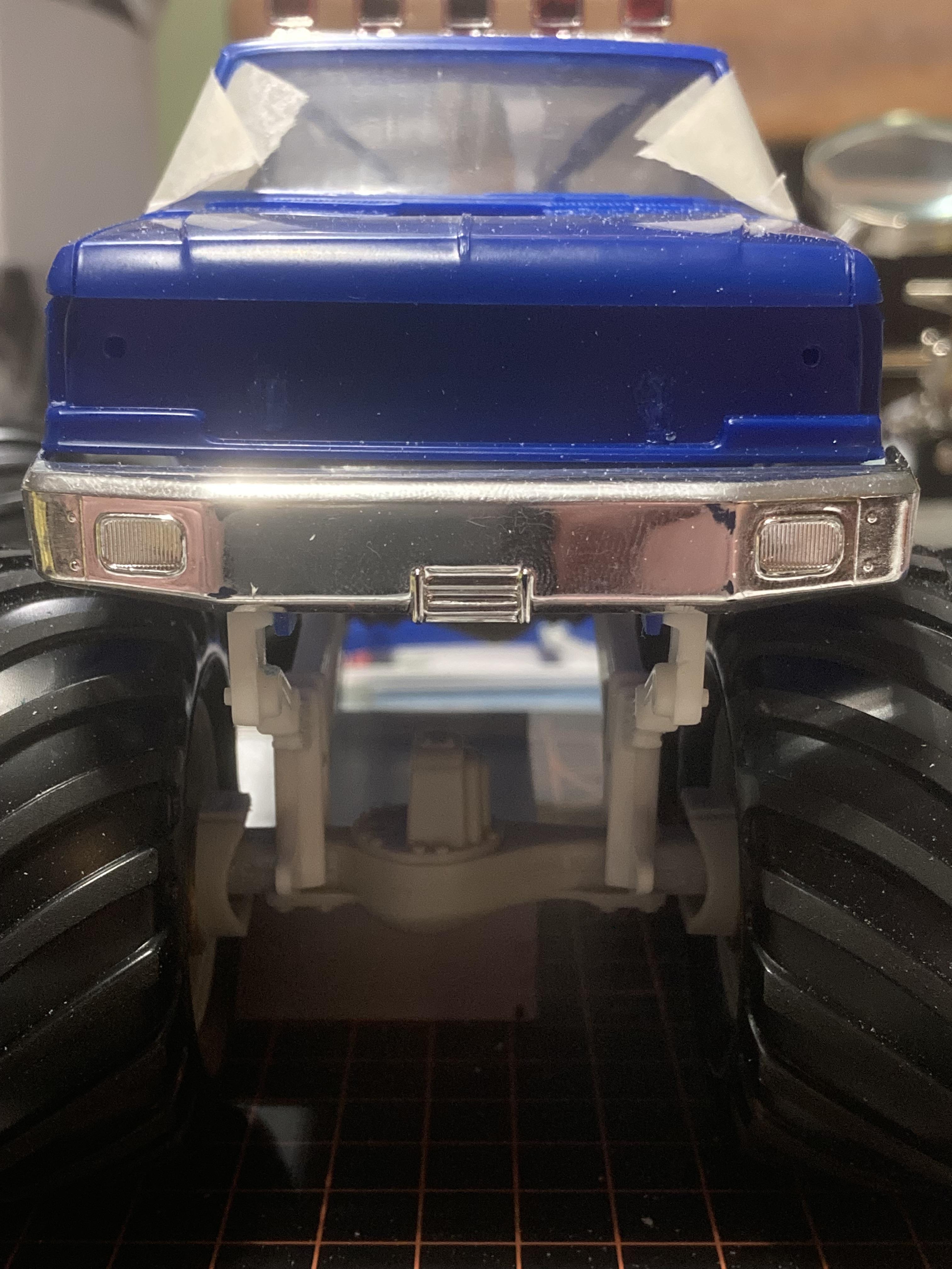

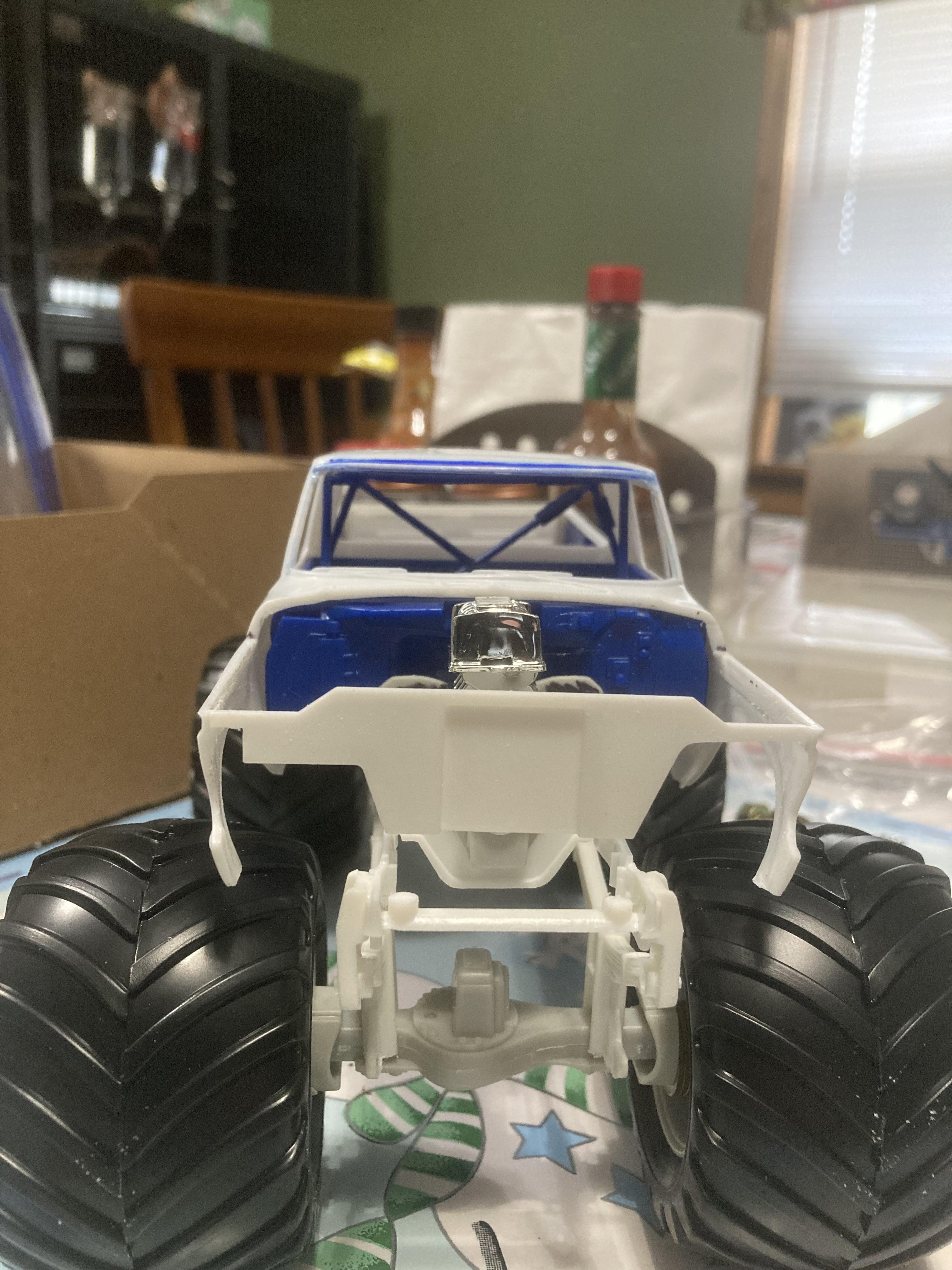

The bumper has also been modified, as well as the front portion of the frame, to allow the bumper to tuck in close to the hood, while still allowing the flip open to occur…anyone who has built these kits, knows the bumper is about a mile away and looks plain awful

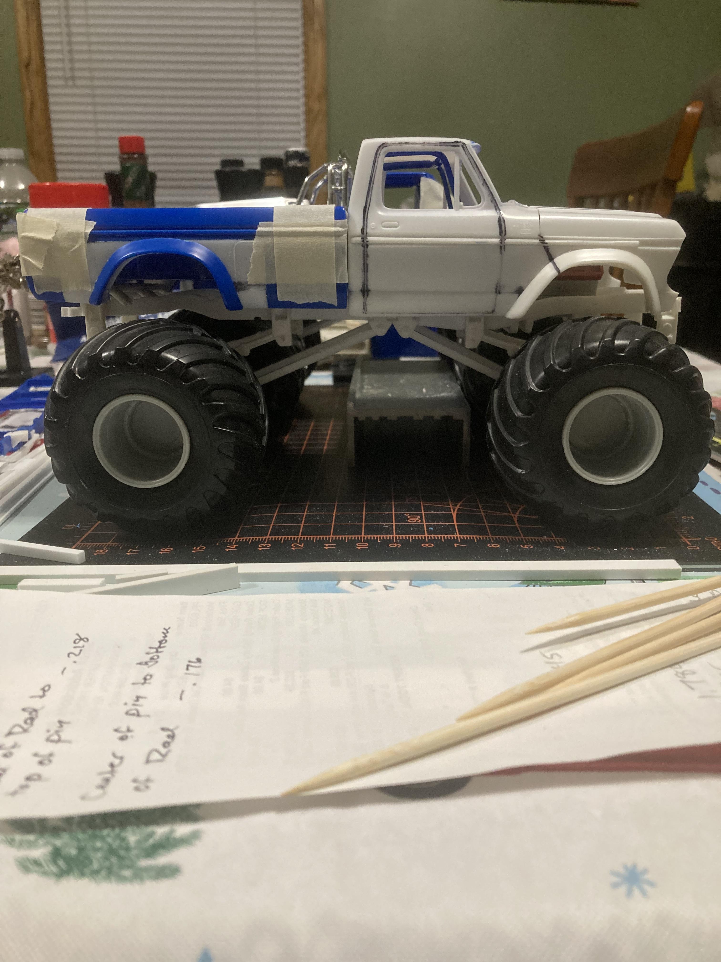

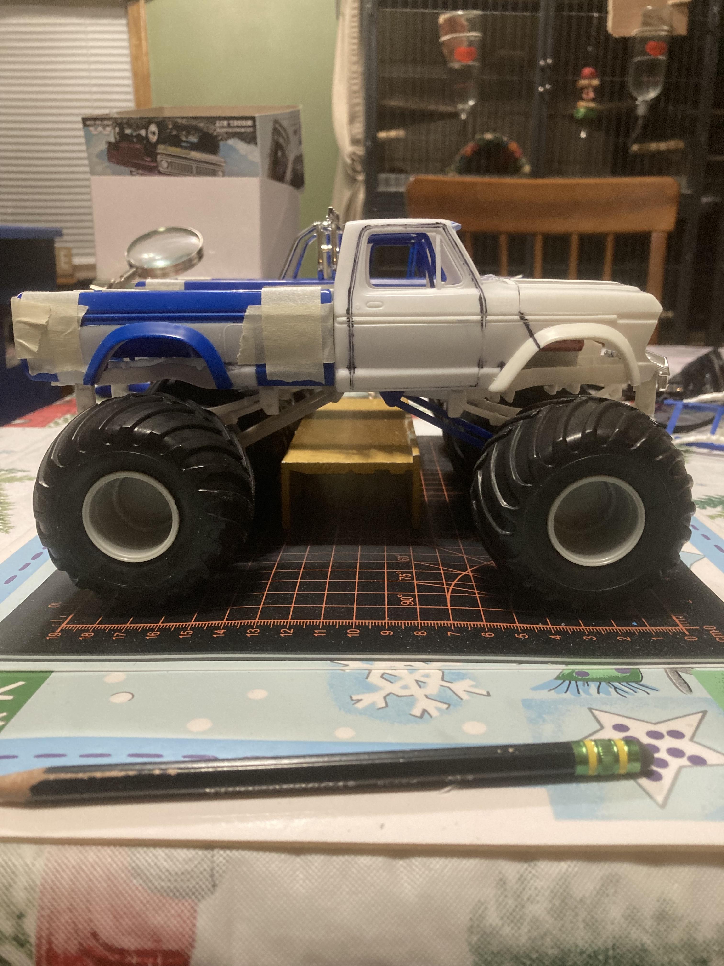

decided to fix an issue tonight that has been bugging me about BF1…

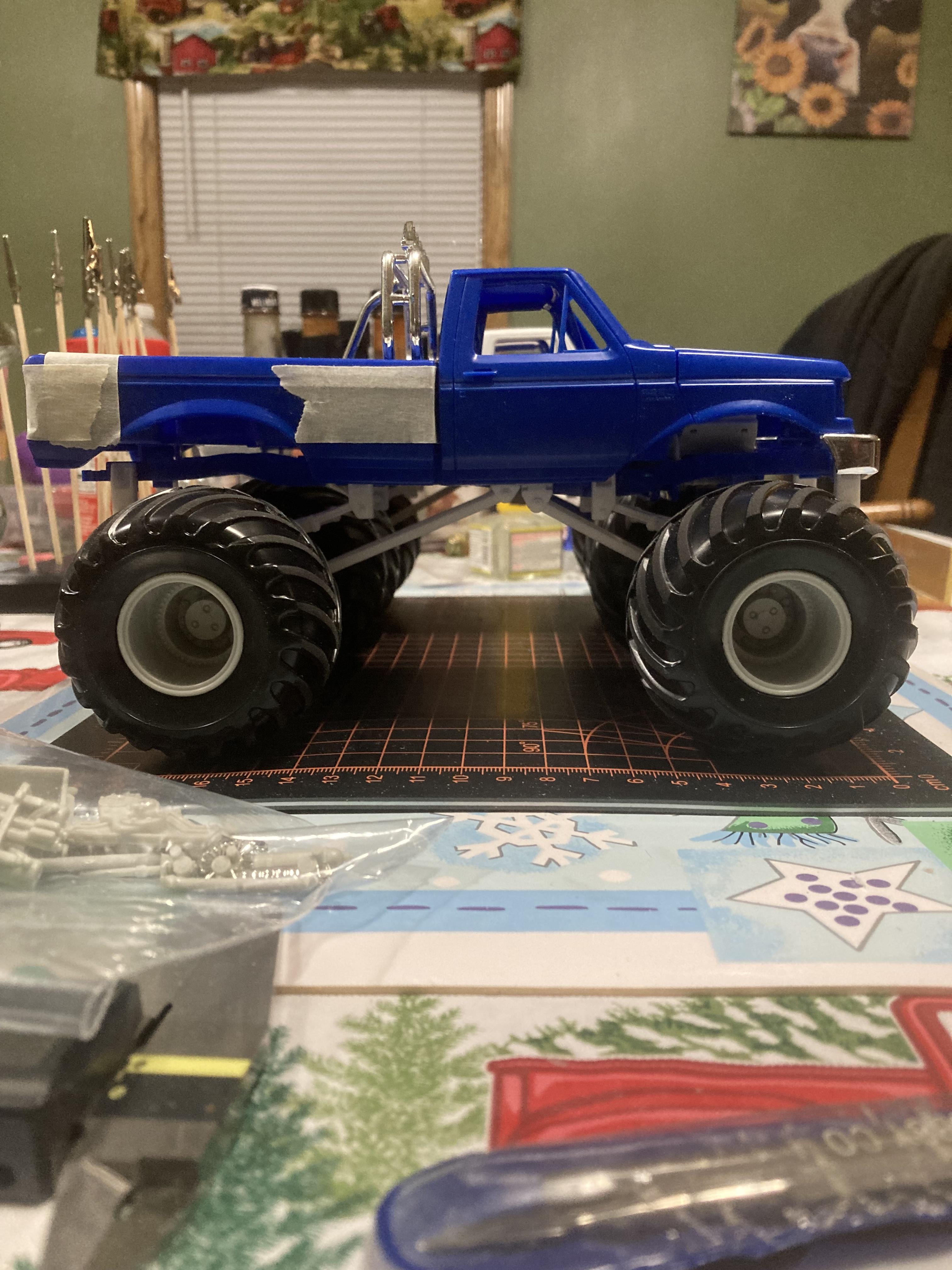

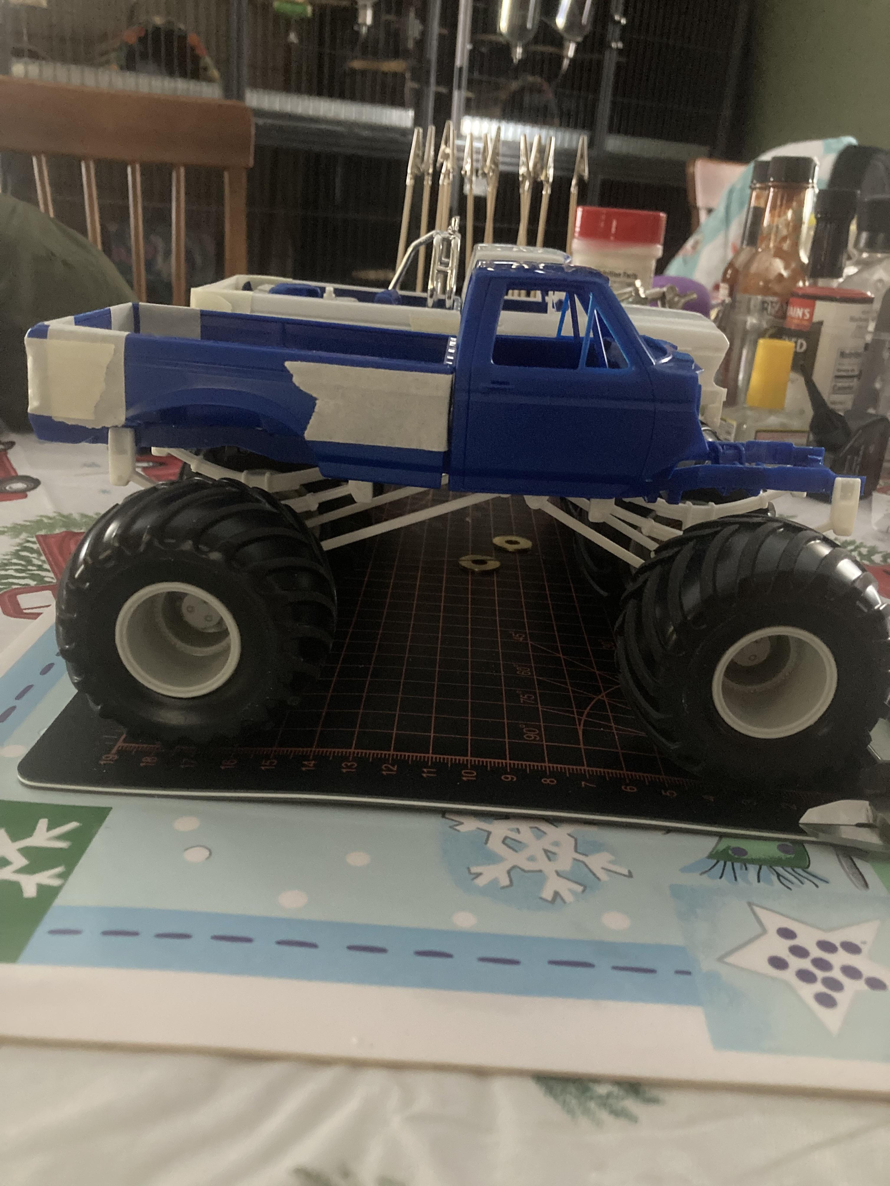

the torsion bars were parts box pieces I had, and they were equal length. This isn’t correct for Bigfoot, on any of the springer trucks. So since I had a USA-1 kit with unused ones available, I cut the other one off, cleaned up the affected areas, and glued the new ones in place. I think it looks much better, and more prototypical to the real truck.

Had the day off from work, and it’s cold and windy. Decided to work on BF3 today.

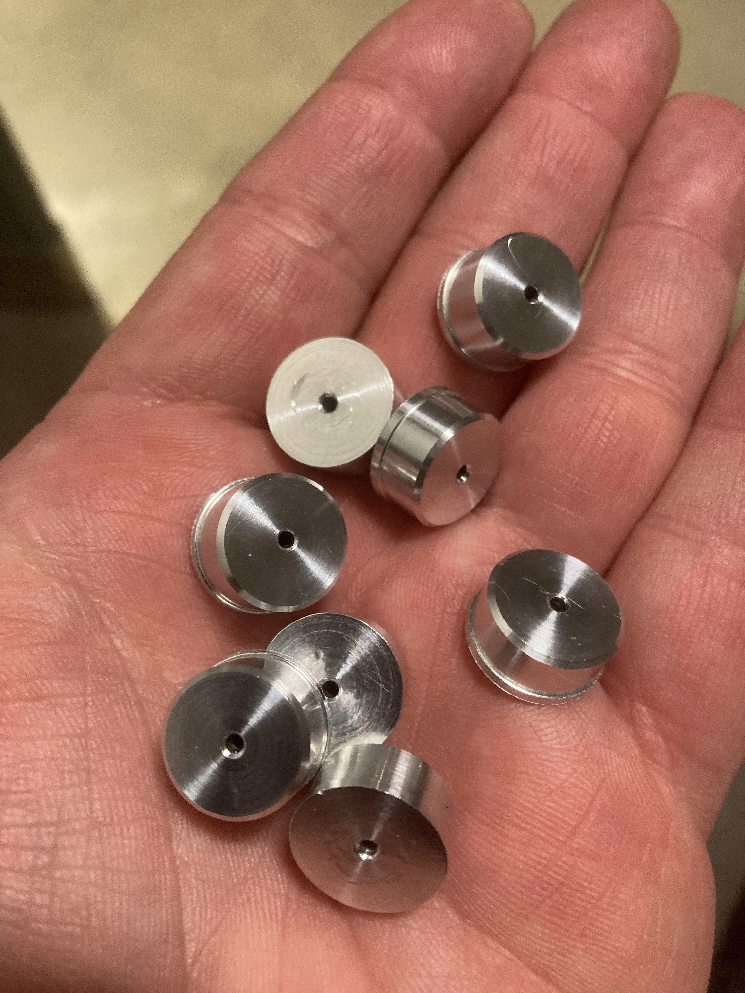

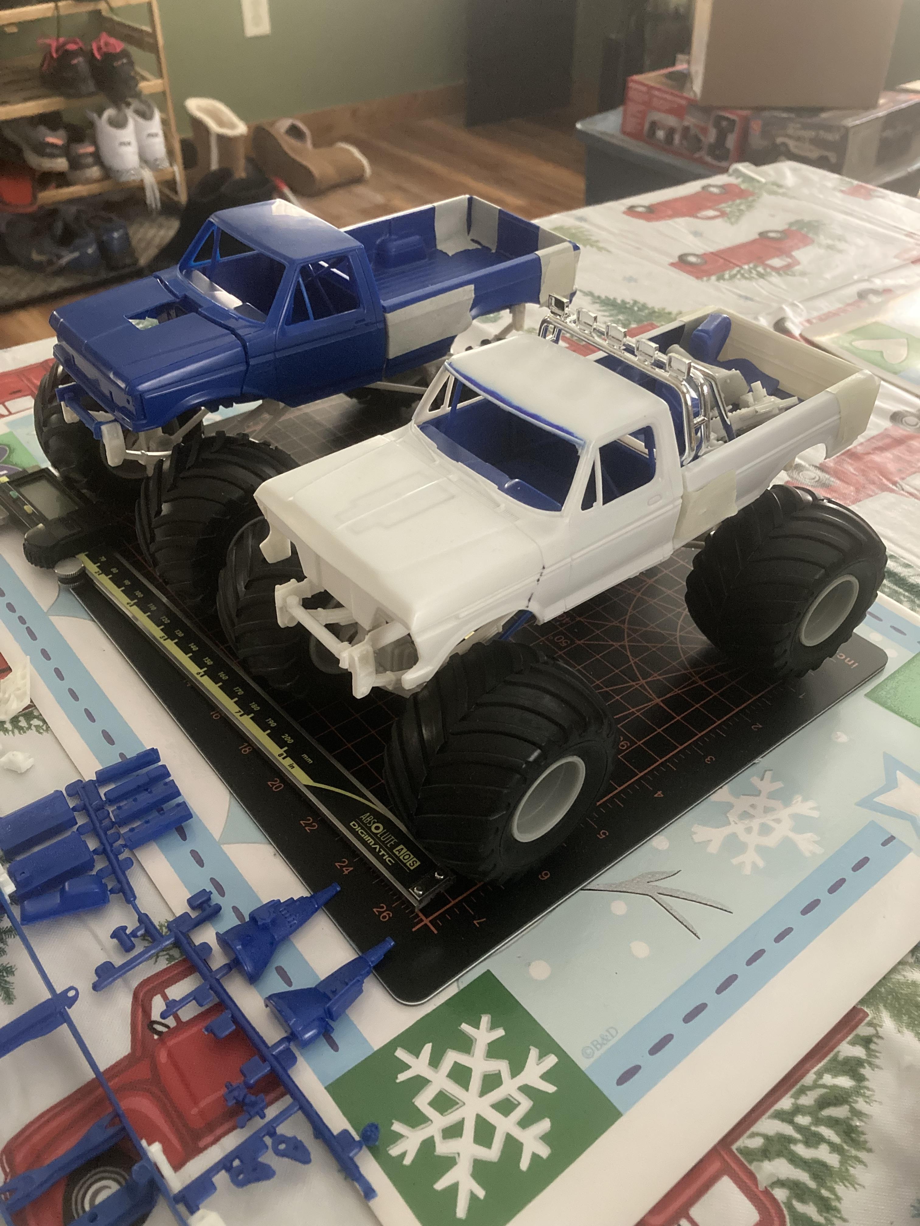

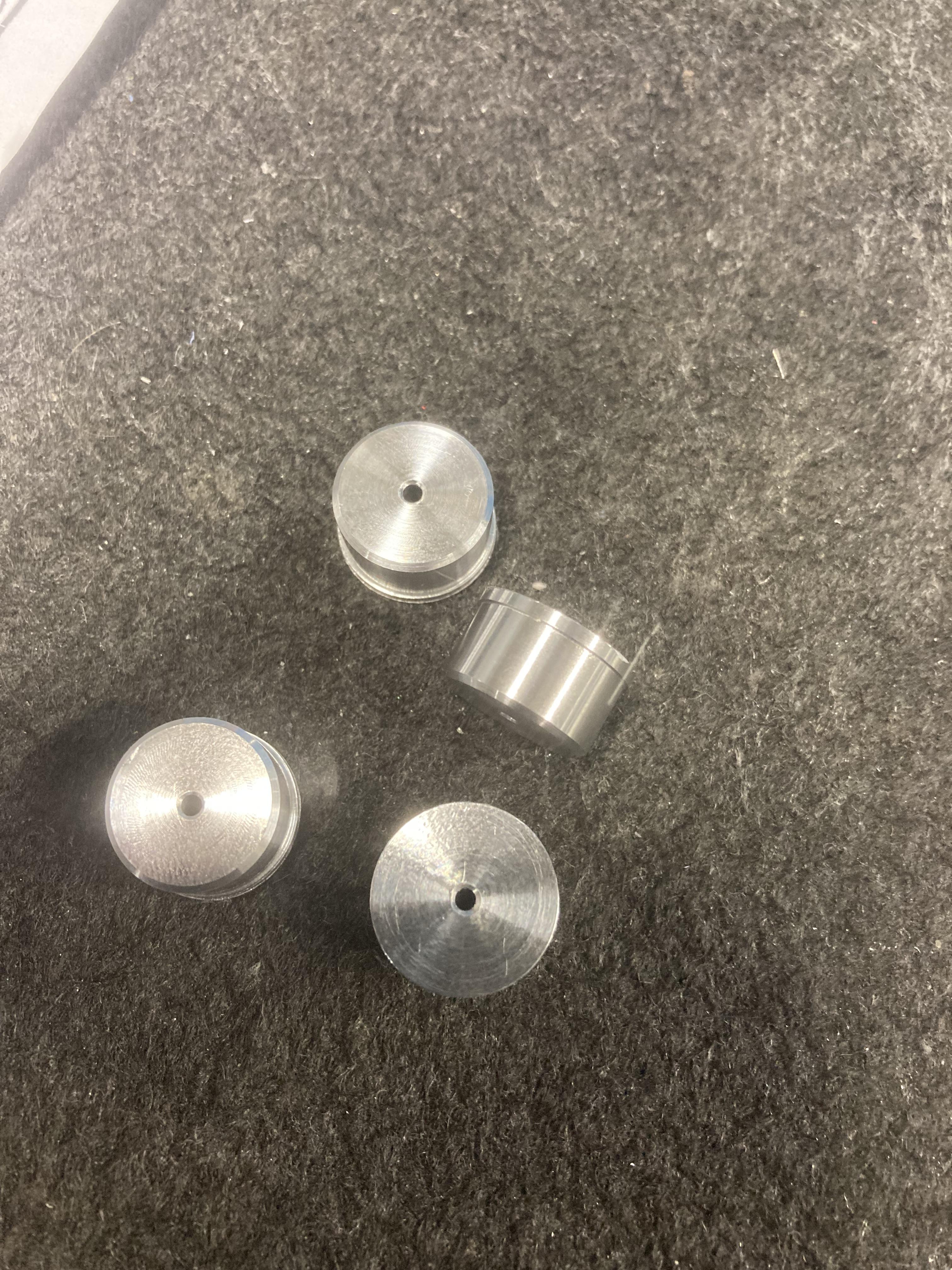

I have the great fortune of working in a machine shop. BF3 needed some wheel spacers/planetary hubs to take up the space behind the wheel and axle combo I force matched, to have the planetary hubs, BF3 ran. So, I made some. I made two widths and settled on the narrower spacer. They came out great and space the tires just slightly wider than BF1. I’m okay with this, as planetary axles are typically wider, due to the addition of the hubs gearset housings.

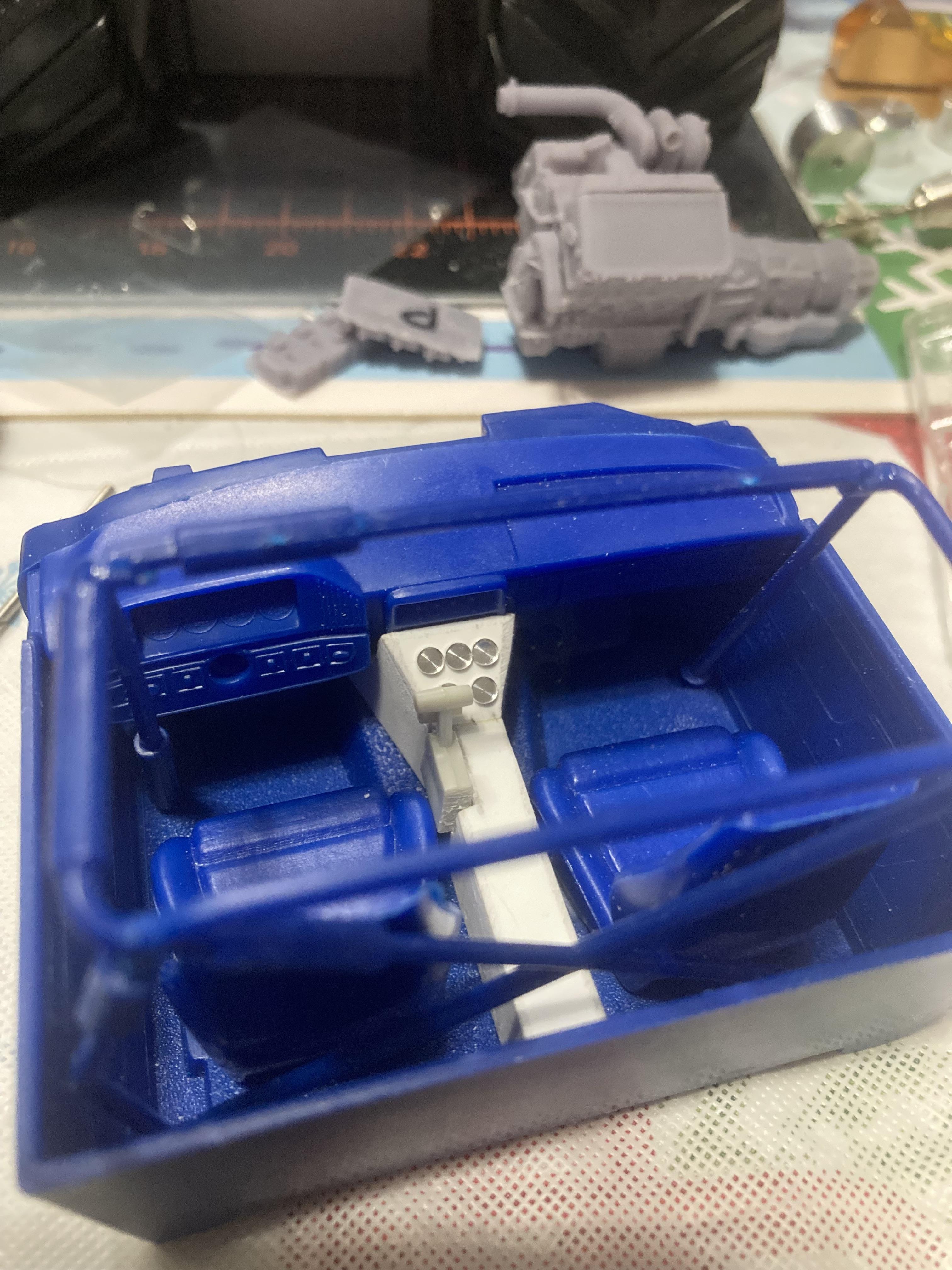

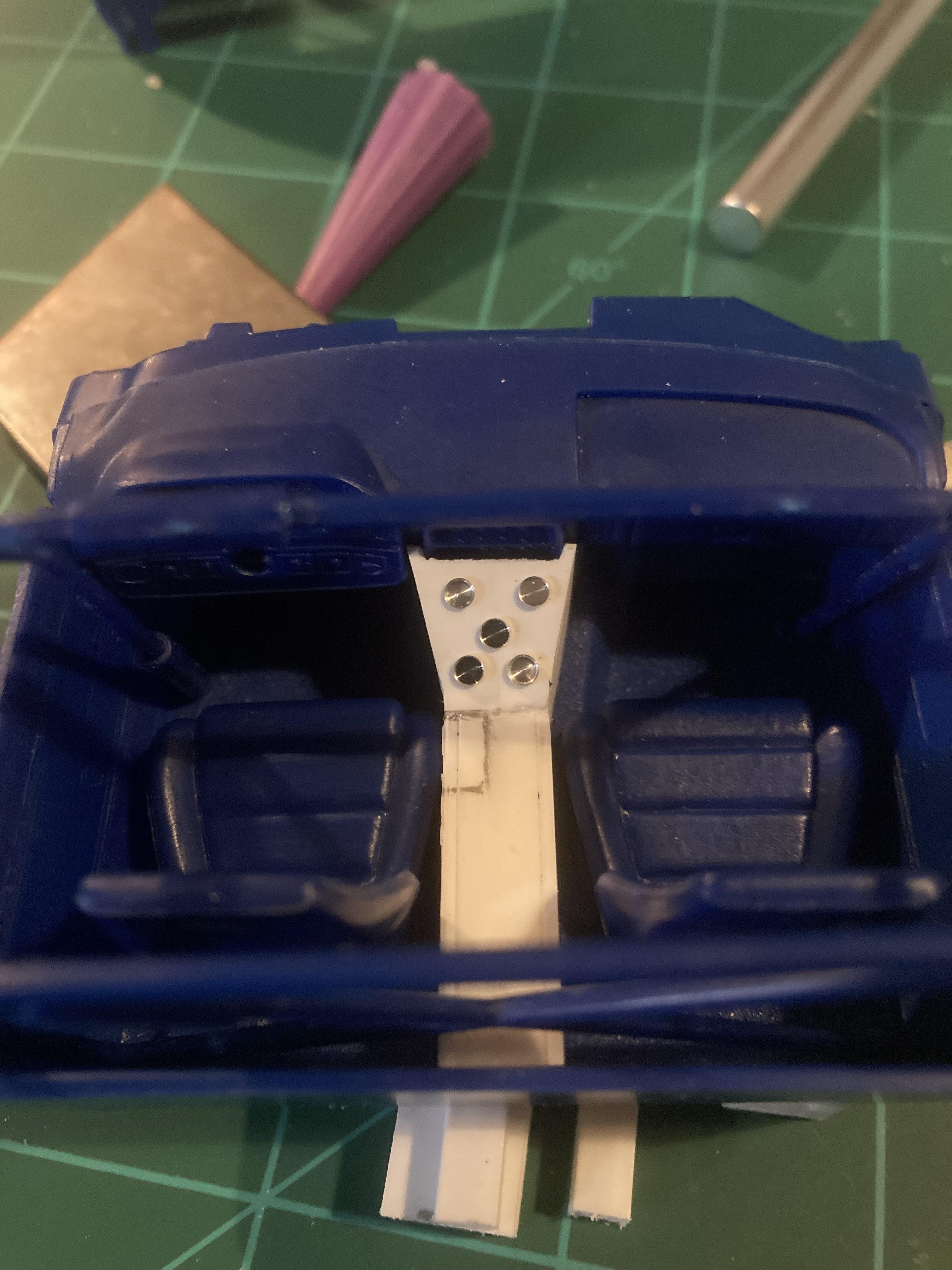

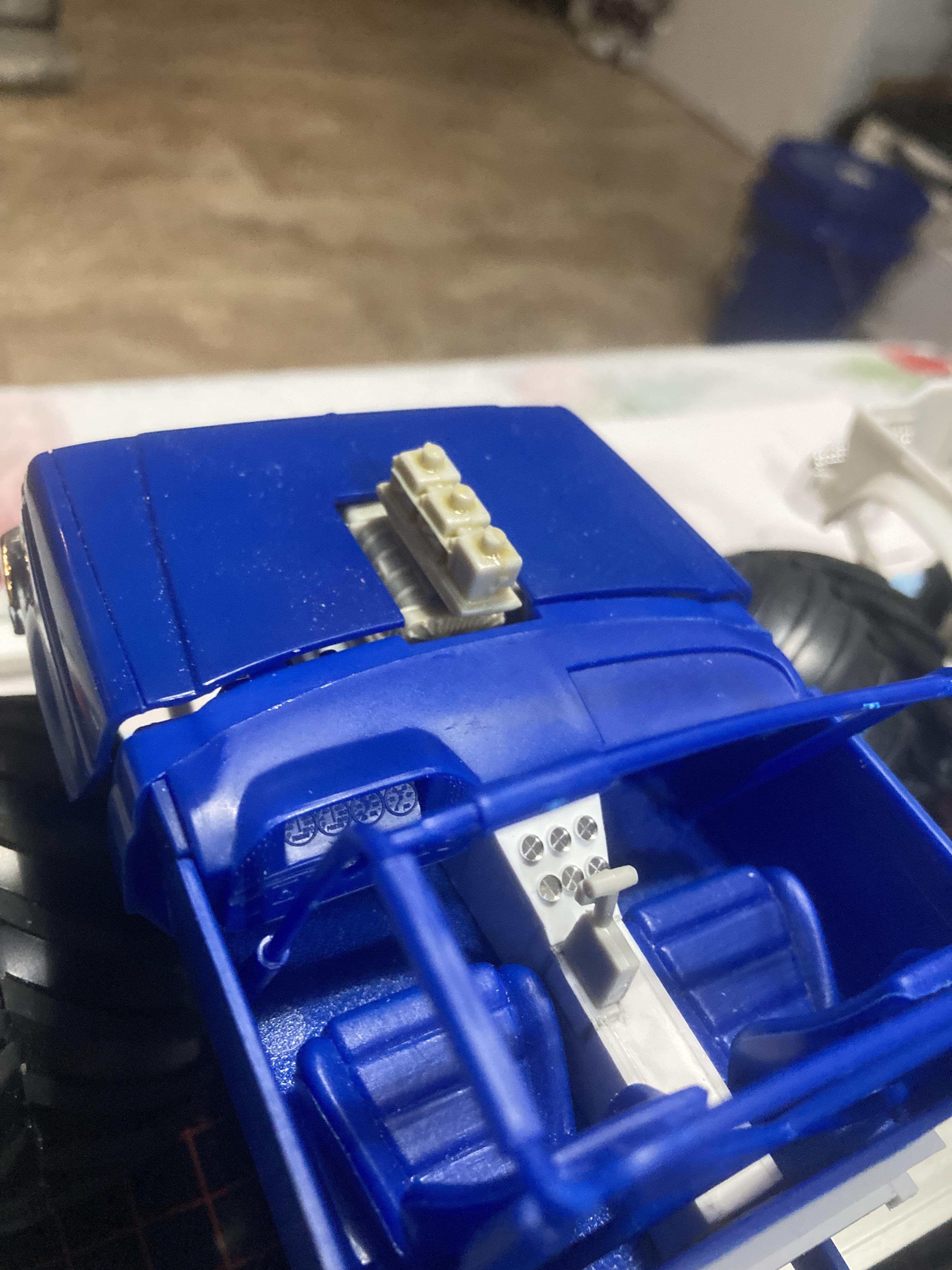

Next, I tried my hand at measuring out and fitting six gauge faces into the center console, made specific to BF3. Well, six gauges wasn’t going to happen, and I had to settle for five. I almost had to pull the gauge cluster plastic up to redo it, but all the gauges laid in nicely on the top row and the second row was good enough and evenly spaced, so I left well enough alone. I did try to get six gauges in there. I think it looks pretty good. It definitely adds another bit of interest when looking in through the cab windows. I still need to do a console armrest pad, and the RII box and mount. I will also need to start placing the large tach and smaller gauges on the dash.

I decided I didn’t like the center console I’d made for Bigfoot 3…So, I started over. I made it wider, but the same height. This allowed me to add the 6 gauges I was looking to have on the upper panel.
I also made one for Bigfoot 1, and decided I wanted only 5 gauges, as it is the “older” truck of the two. I’m not sure I like it. May pull it off and make a new panel…I’m struggling with the alignment because the gauges are so small, and my eyes aren’t as good as they use to be. When I drill them out with a pin vise, I think it’s off just enough as I step up to the larger bits. And to my eyes it looks off. I’m still resting on this one.
