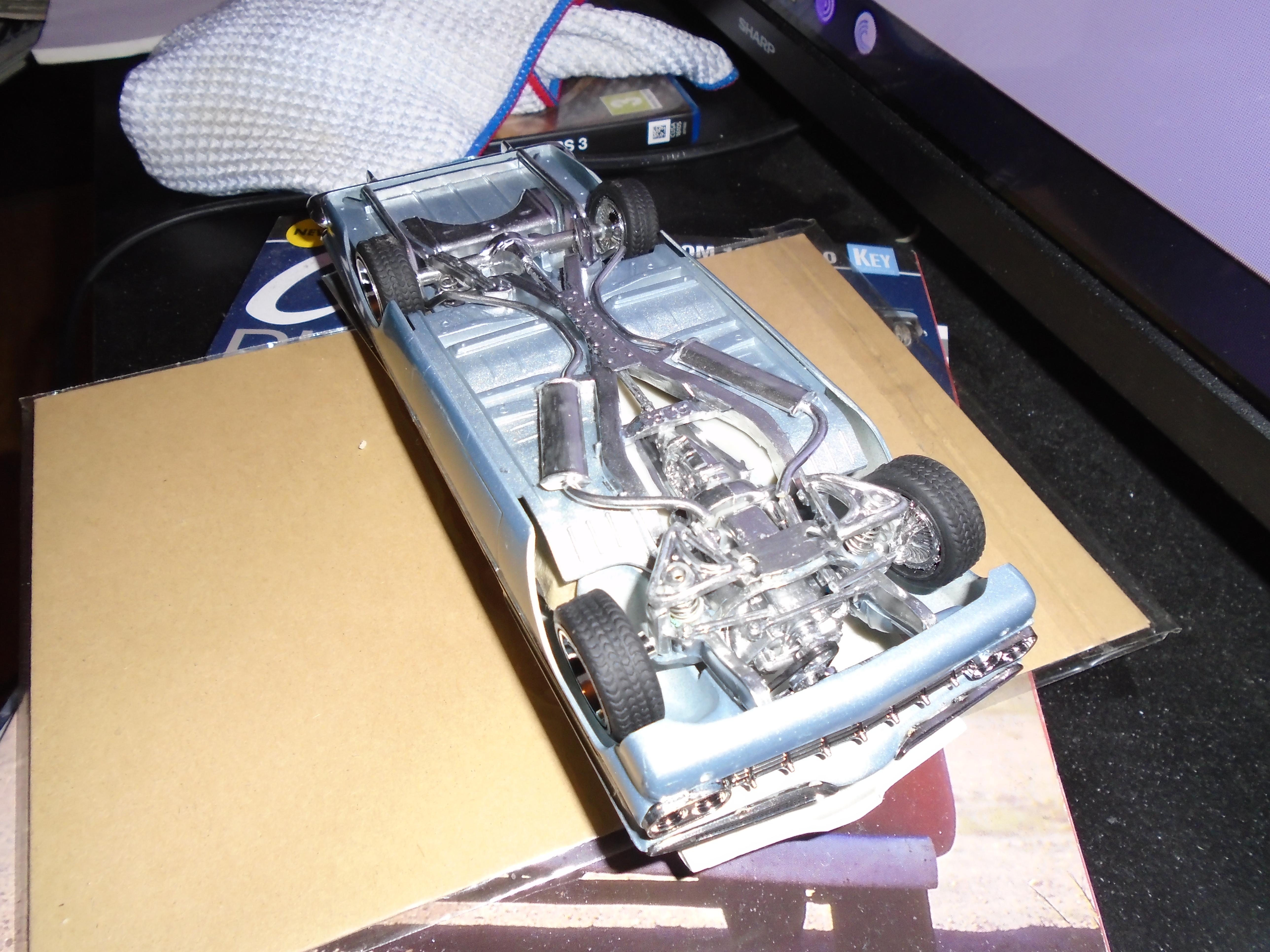

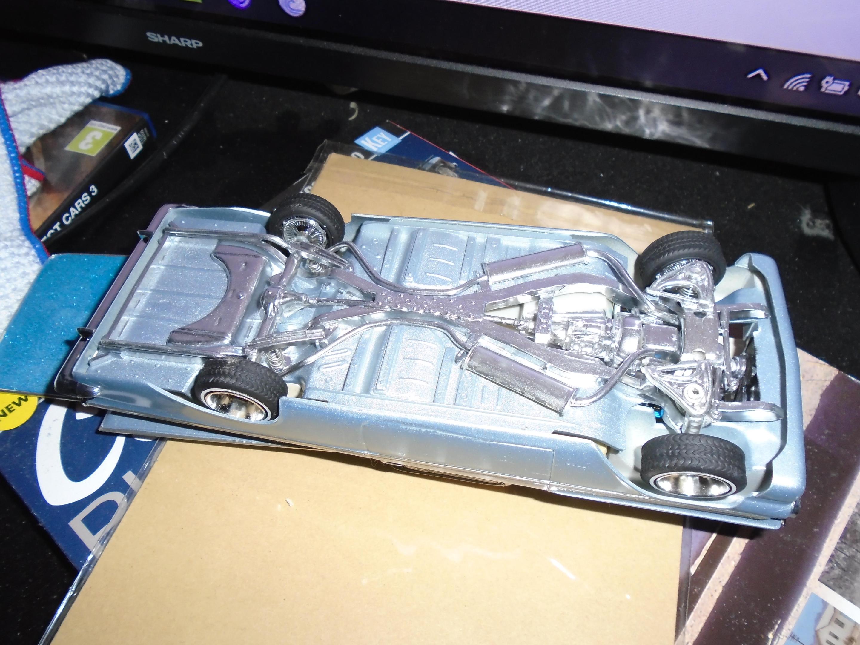

stitchdup Posted December 21, 2023 Posted December 21, 2023 all the chrome on the underside of this elco was done in january 2017. it has not been cleared and was done with the 2mm pen. It has sat in a cabinet since then. it is over duplicolour clear and paints. It has lost some shine where its a bit thinner but the majority still has a shine 1
