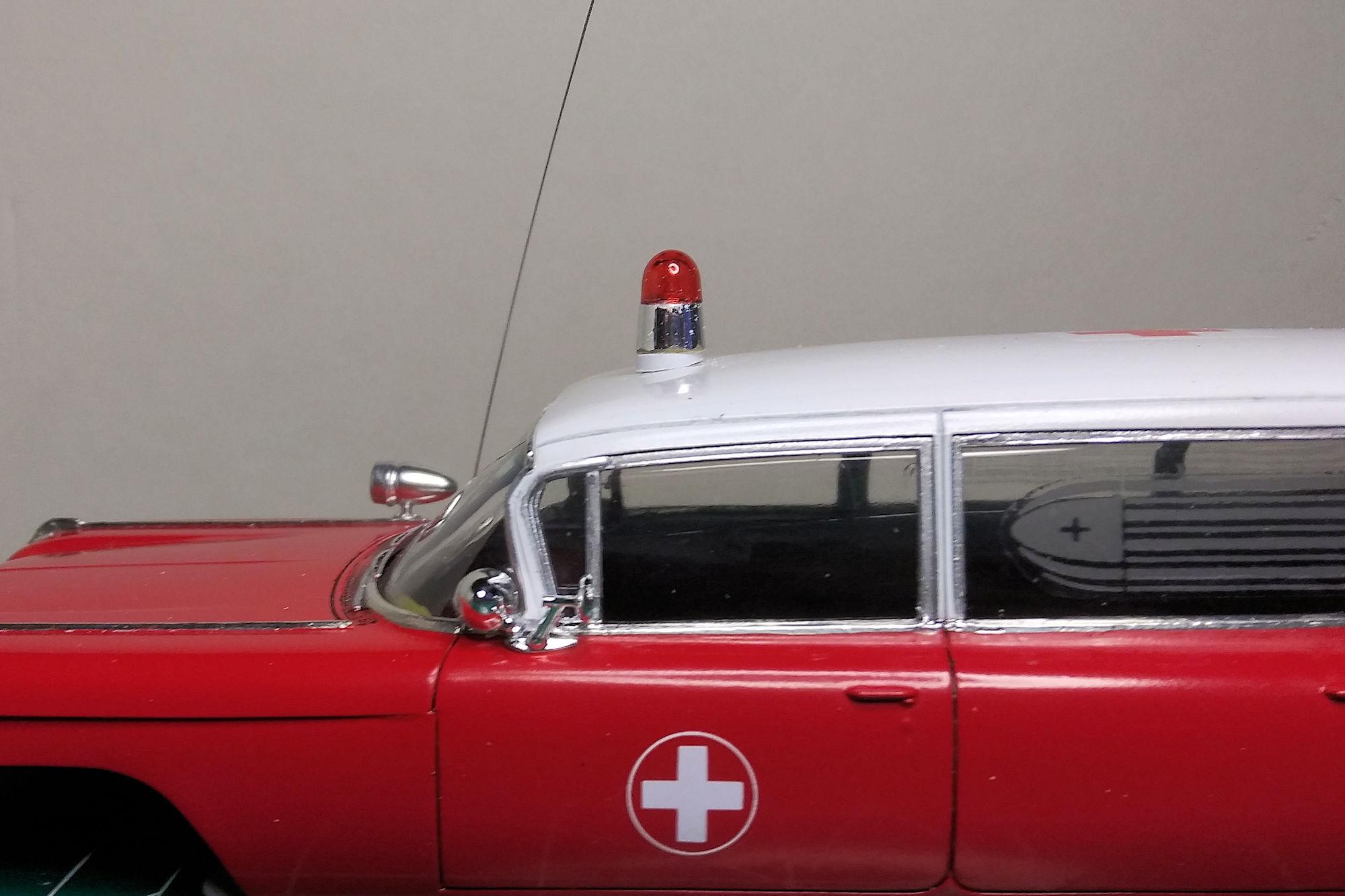

There's just one more thing that I can't live with. The angle of the gumball machine on the roof has never seemed right to me. I tried to get used to it the way it is but it just never looked right to my eye.
It's time to fix that.
I cut a piece of styrene tubing and filed it to an appropriate angle.
The tubing is a little undersized and though it's not perfect, I think it will meet the need. I may correct this at some future time. But I'm just as likely to live with it the way it is. I suppose I could also file down the beacon base but I don't feel like re-chroming it right now.
I apologize for the less than optimal cell phone photos but my real camera is in the shop and... "The build must go on!"
Thanks,
David G.

I recognise that feeling David . . . When something is nagging at you, and it's not quite right, you just have to address the problem !
The beacon was angled ever so slightly forward . . . Now it is perfectly vertical . . . Job done !
David

Hello Everybody!
Now that I have some of the other events and occurrences in my life settled and dealt with, I've found some mental energy to finish up with some of this build's loose ends.
As you may remember, I tried adjusting the angle of the gumball beacon on the roof using a bit of styrene tubing. It wasn't an ideal solution but I thought I could live with it.
After a few weeks of living with it, I decided that I could no longer live with it and corrected that angle issue the way I should have done in the first place. I removed the beacon and filed its base to allow for the slope of the roof. I like this much better!

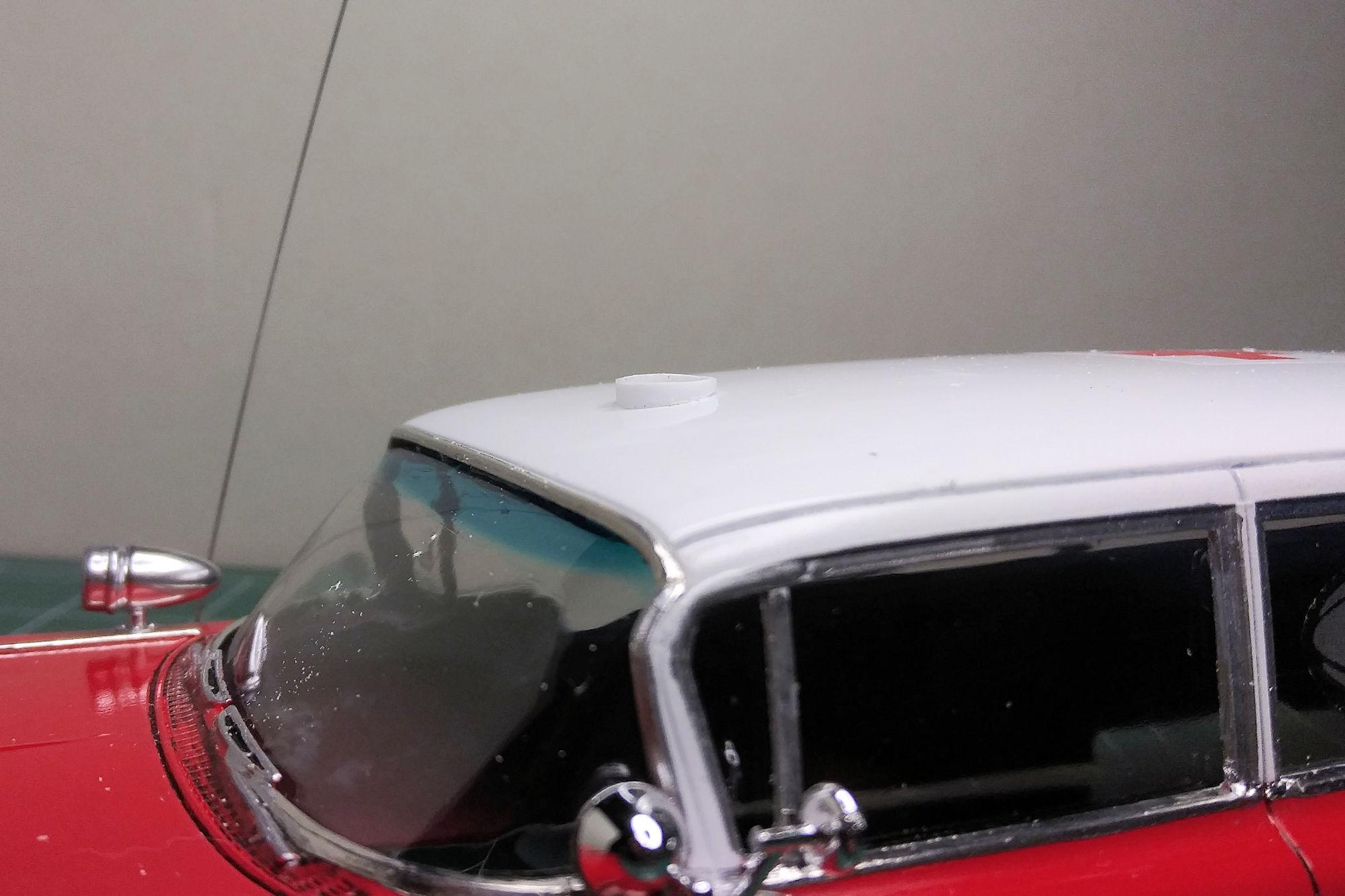

How's the antenna installed? Looks a tad long due to the big loop, but that might just be the image. I had an idea for making one for my car. They make those straight pins with different sized plastic heads on them. I thought if I could find the right size, I'd drop a small spring down the pin shaft and glue that in place. Then cut the pin off and put my wire into the spring. Then glue that big ball to the bodywork and loop my wire down like you have yours.

I'm pretty much done with this one... finally!  ...and I'm currently editing my end-of-build photos.
So here's one of those photos to answer your question regarding the antenna mount.
During my research for this build, I did see several similar mountings for whip antennae. Though I think their ends were attached to the rear bumper or a second body-mounted point.
The antenna itself is a 17 gauge guitar string stuck into a base from the parts box.
Thanks for the question Randy! I'm always happy to share information and tips.
