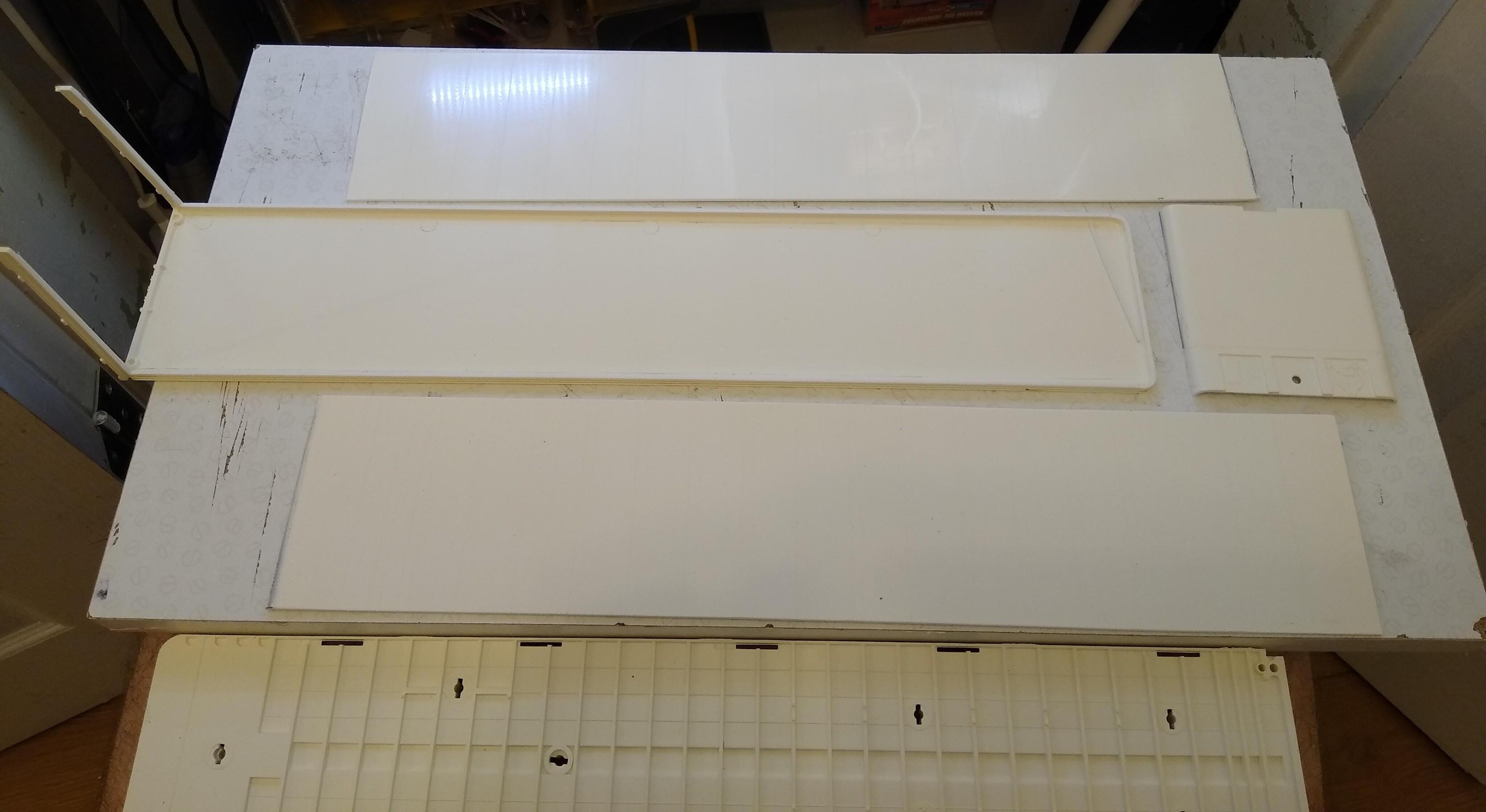

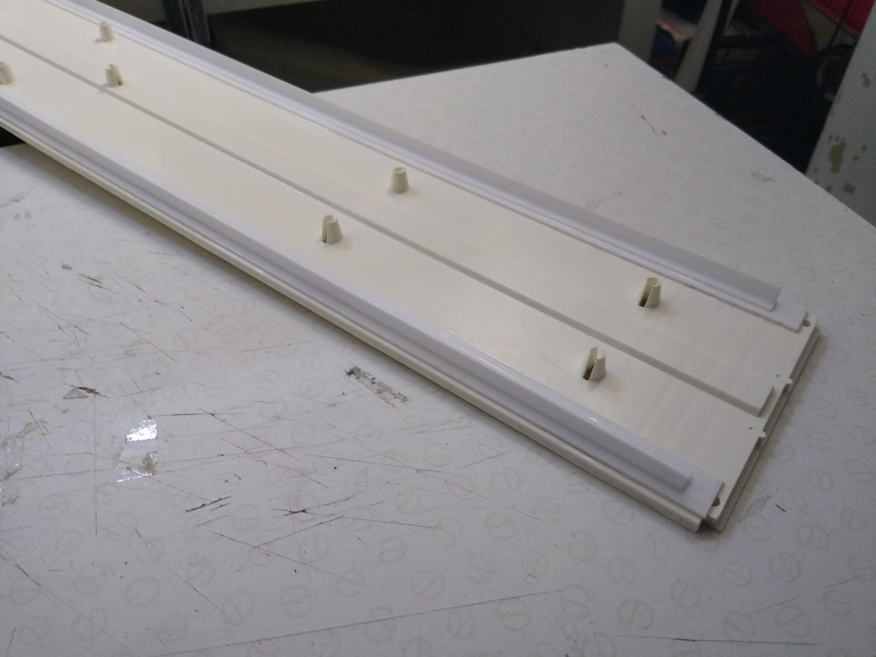

So I made my own from a Monogram Reefer kit. Cut the sides out and recessed them. Added 1mm square strip at each rivet line to keep that detail.

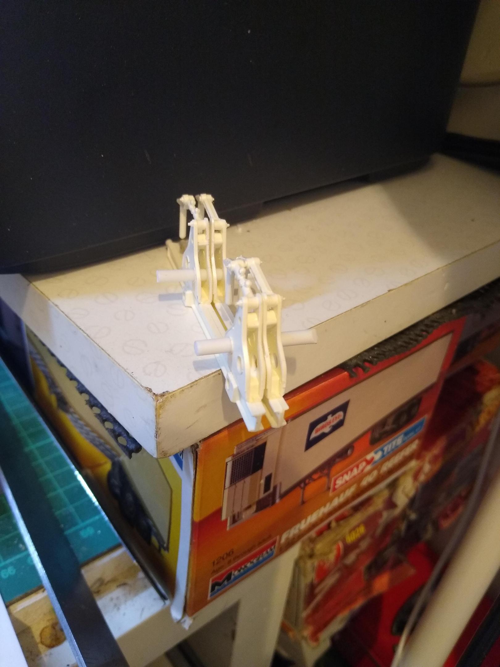

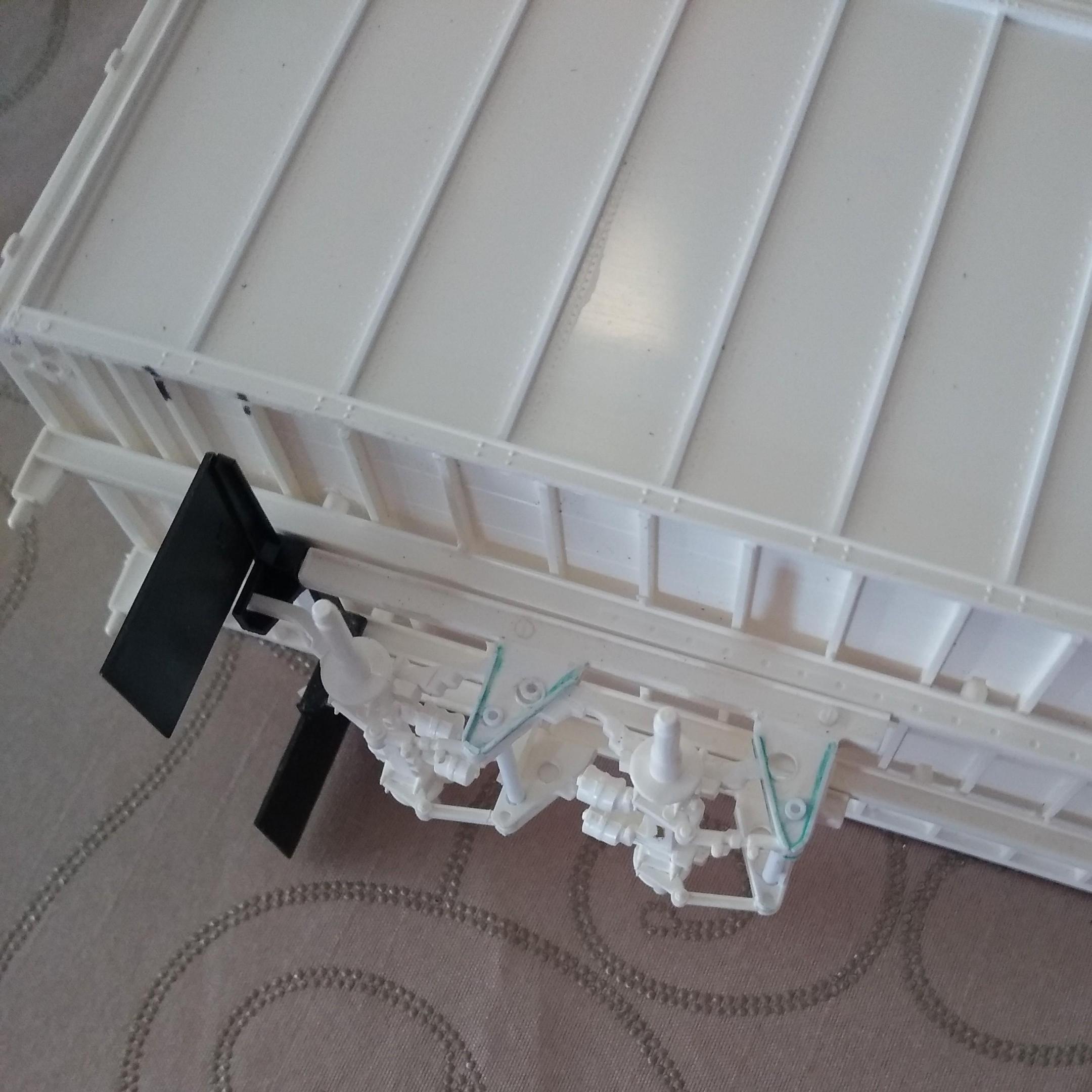

After that it was pretty standard stuff like suspension mods. I pegged the two suspension rails together to make it easier.

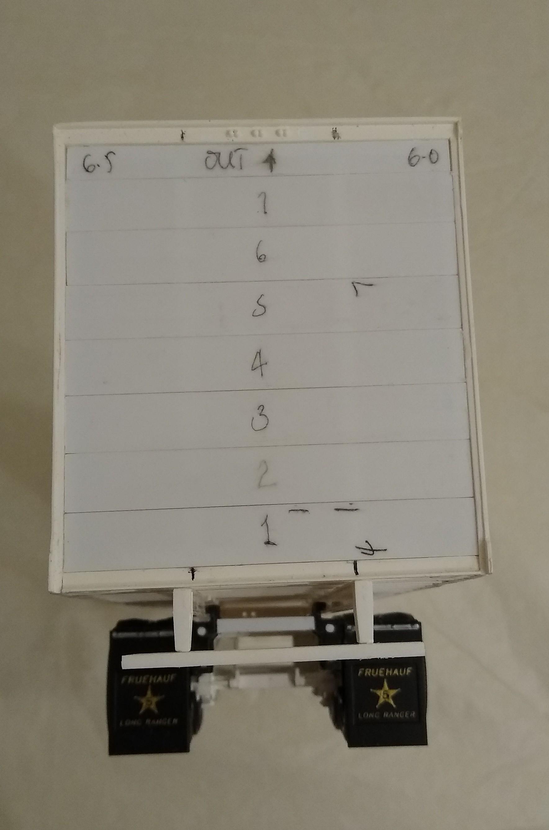

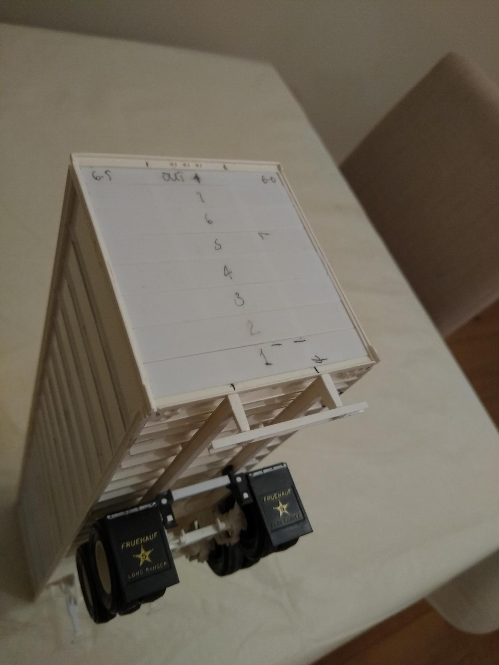

Getting the van body near square was a real struggle. Once released from each other, the roof and sides proved to be bent all over the place which required heavy bracing on the chassis. I borrowed the suspension off the Pruitt trailer for a mock up.

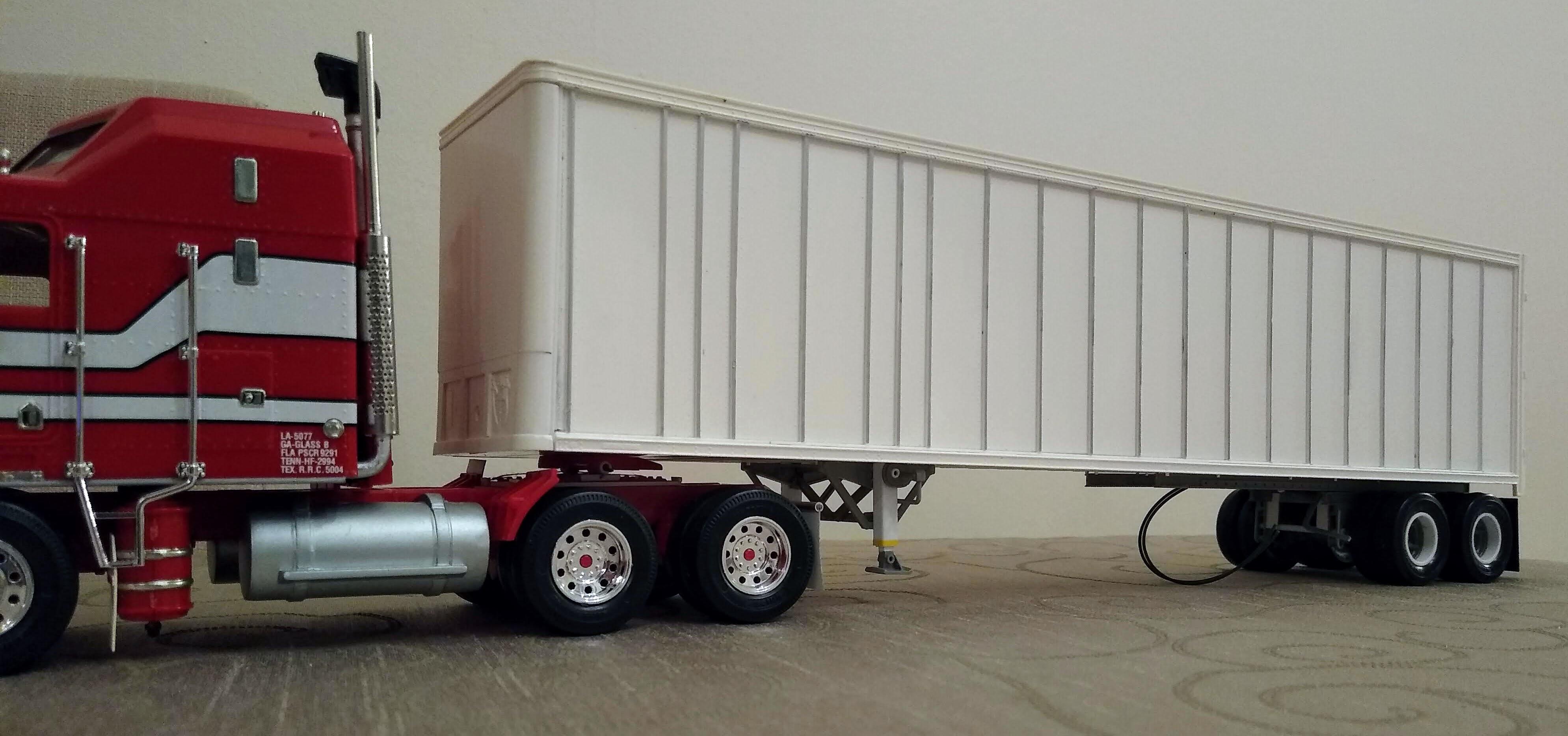

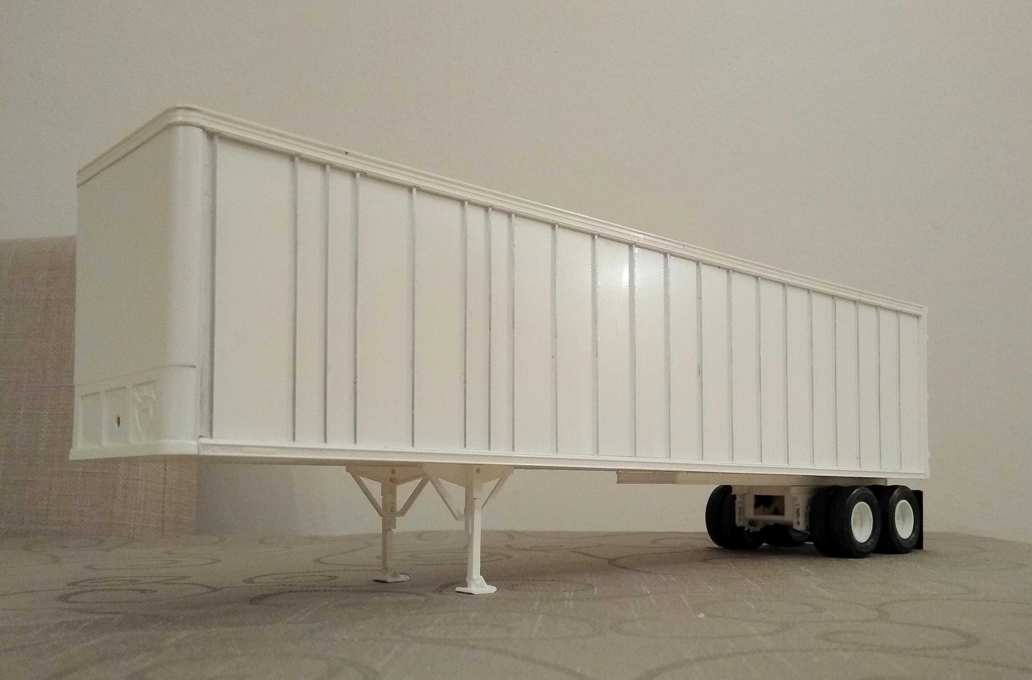

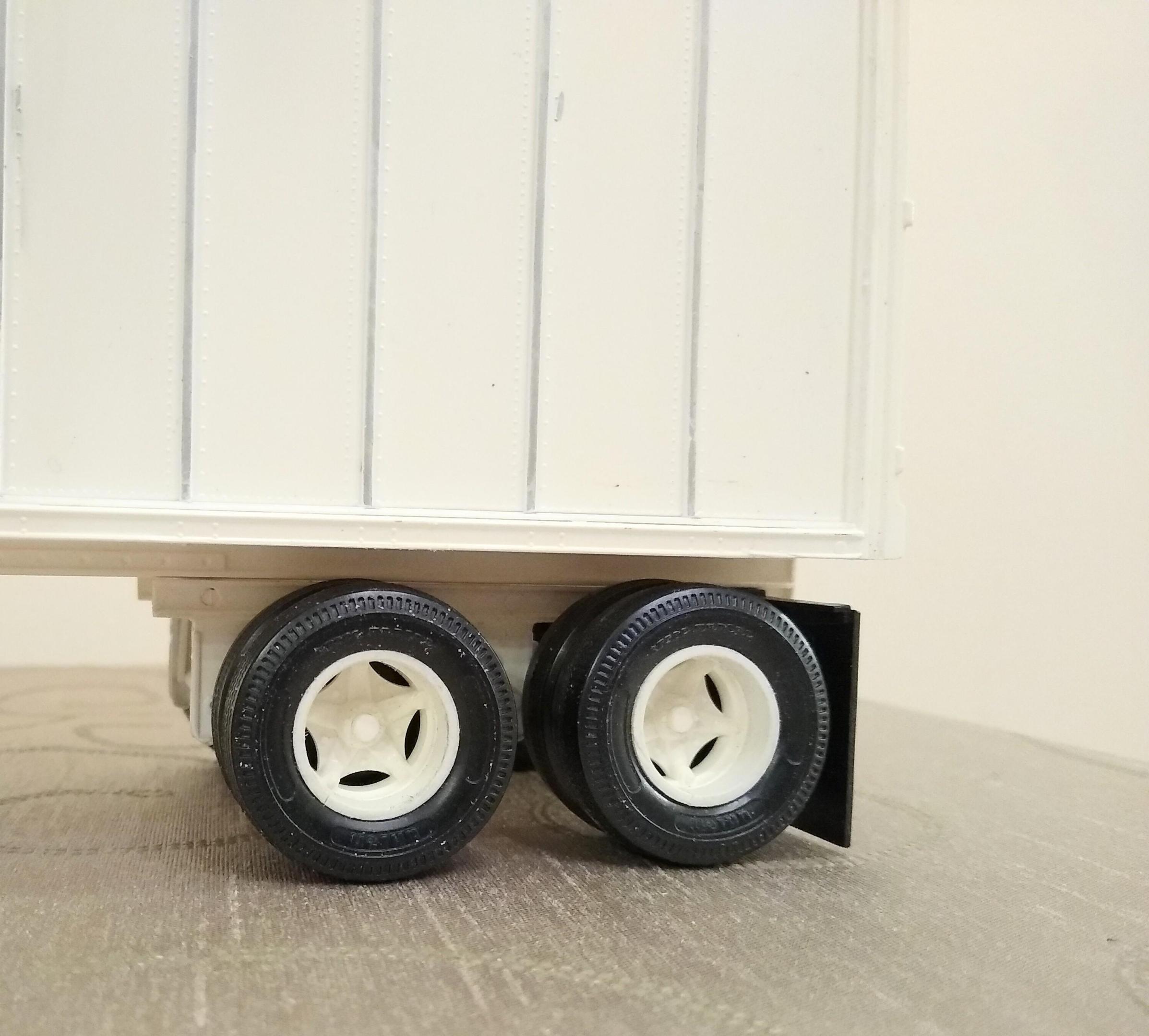

Got it on its feet. Altered the wheels to eliminate the shallow wheel rim. Landing gear tomorrow.
  • Like 2

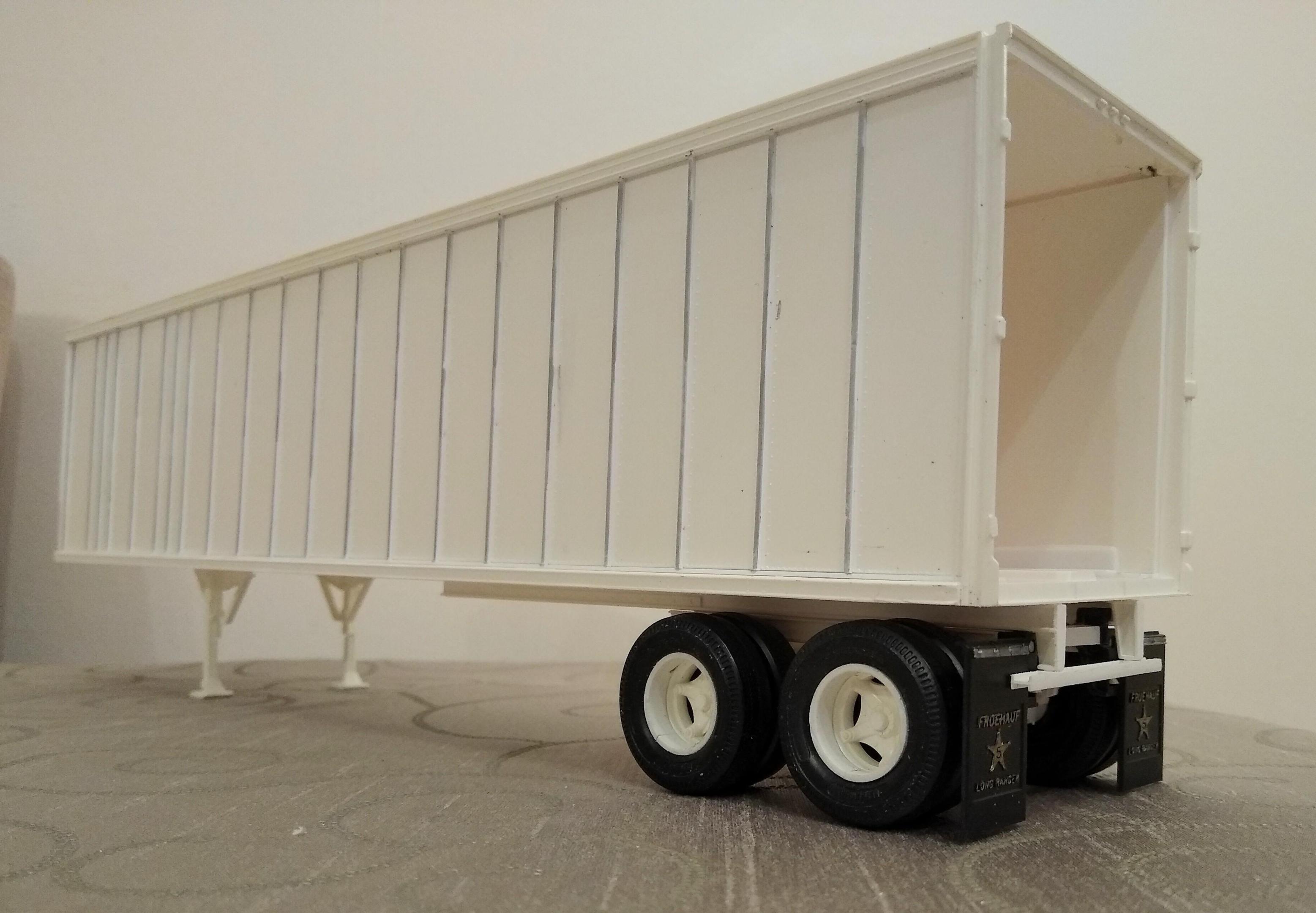

Built the operating landing gear. Reprofiled the front bulkhead and started building a rear roller tailgate instead of the kit doors. Also added the backs to the rear lights.
  • Like 3
You got this build going so clean and neat.
Rolling tailgate is a nice touch, I don't think I have seen this type of tailgate in a kit, so you know your build is special.

Nothing that complicated with the landing gear, I just use square tube and rod so they can telescope like the real thing and create enough resistance to support the weight of the trailer when extended. I just push and pull manually.
There's a tailgate rear door on the 1/25 AMT doubles trailers and the Coca Cola Ford, but there's nothing in 1/32. These exterior post vans seemed to have this type of door because they weren't insulated etc... so could be quite simple. I'm hoping mine helps to hold the box almost square, it really is all over the place.

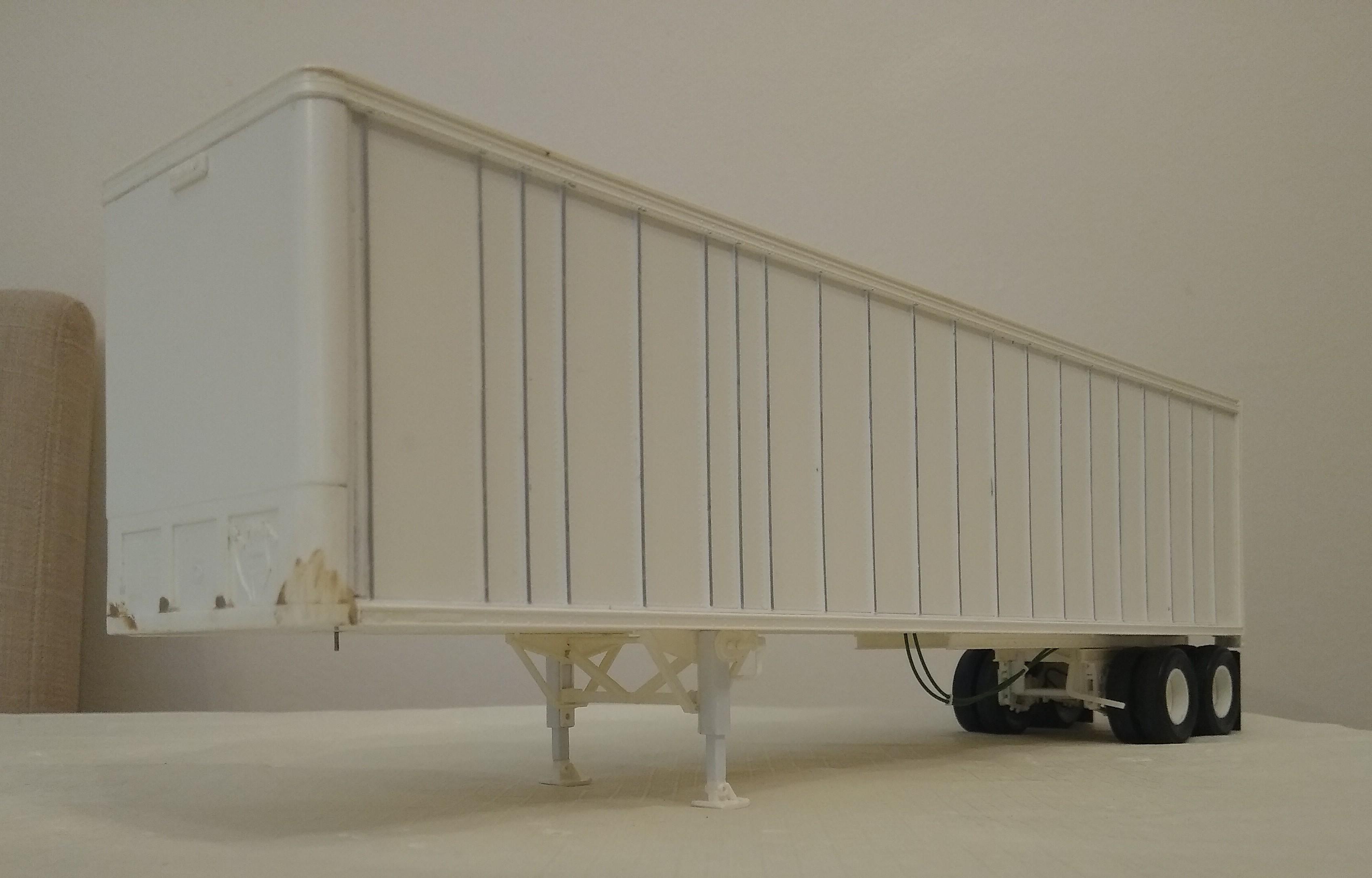

I planted the two uprights in the tailgate aperture both for support and so I could drill a row of holes along them, into the holes I pushed dressmakers straight pins to represent the coachbolts that hold the hinges in place. I also scratch built a locking mechanism at the bottom and a pull handle. I might tie a piece of thick cotton to that to mimic the rope you see on so many of them, so that the driver doesn't have to stretch to reach it. This will soon be awaiting the right weather for paint.

Not a lot to report, snatched a few hours to plumb the tandems in. I always leave it until the end and end up working through the subframe, awkward! Looks good enough.

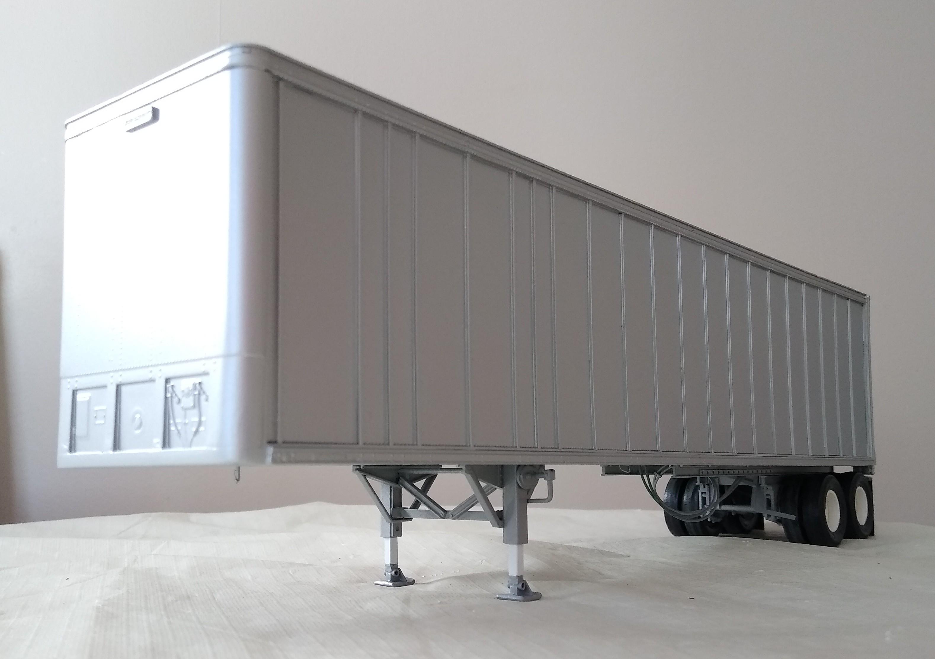

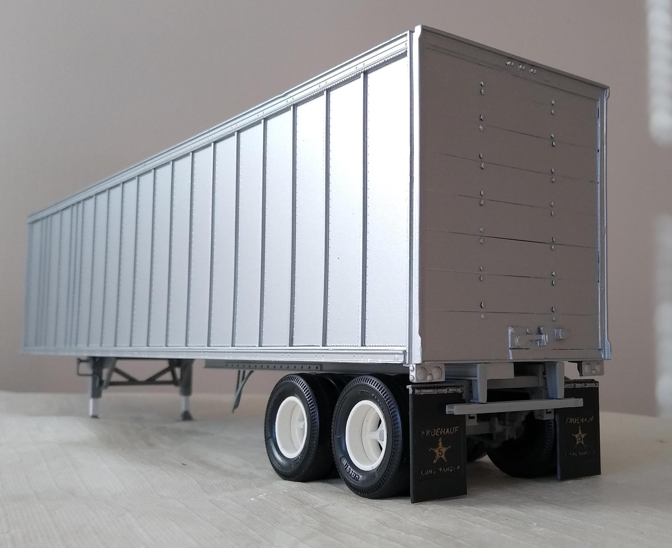

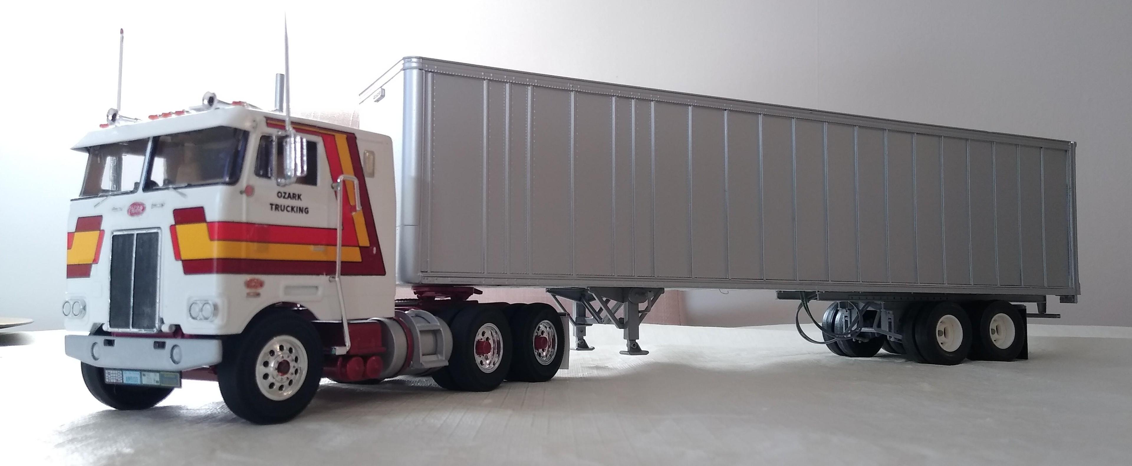

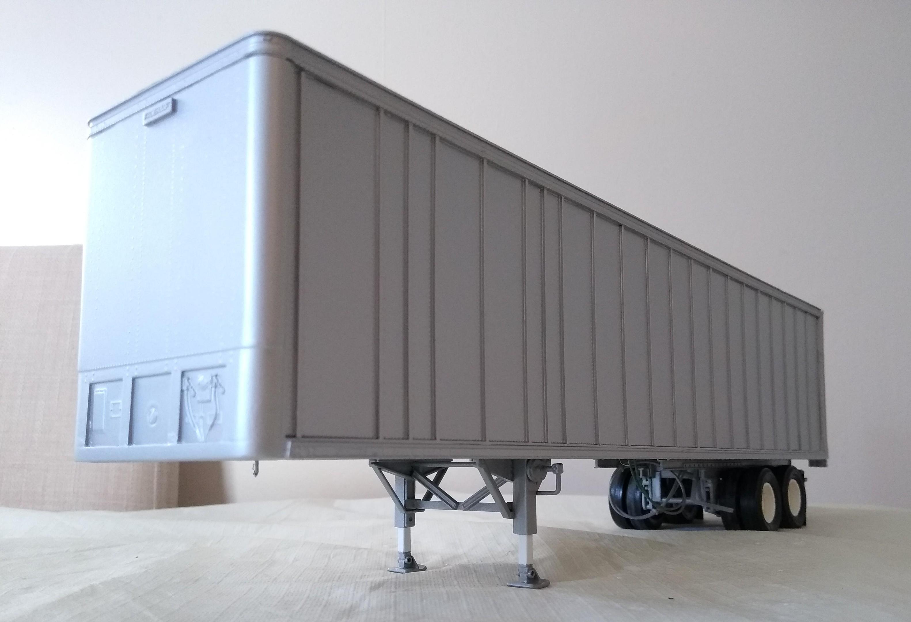

Finally a change in the weather. Got to shoot the colour on my trailer, as if I need another one to store.
Looks ok. Just got the detail painting to do now, lights, hoses, wheel spiders etc...
The modification of the suspension to F2 lightweight has transformed the look of the trailer for me, can't really understand why though.
