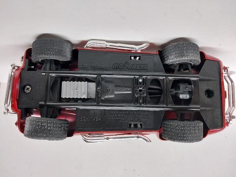

Gramps46 Posted January 18, 2024 Posted January 18, 2024 Very interesting project Matt and I agree with Bill's suggestions. This is meant only as an aside based upon the subject. Majorette did a 1/24 diecast licensed by AC Cars Limited according to the chassis. They labeled it as an AC Cobra. It does have the correct taillights for an AC but is left hand drive.

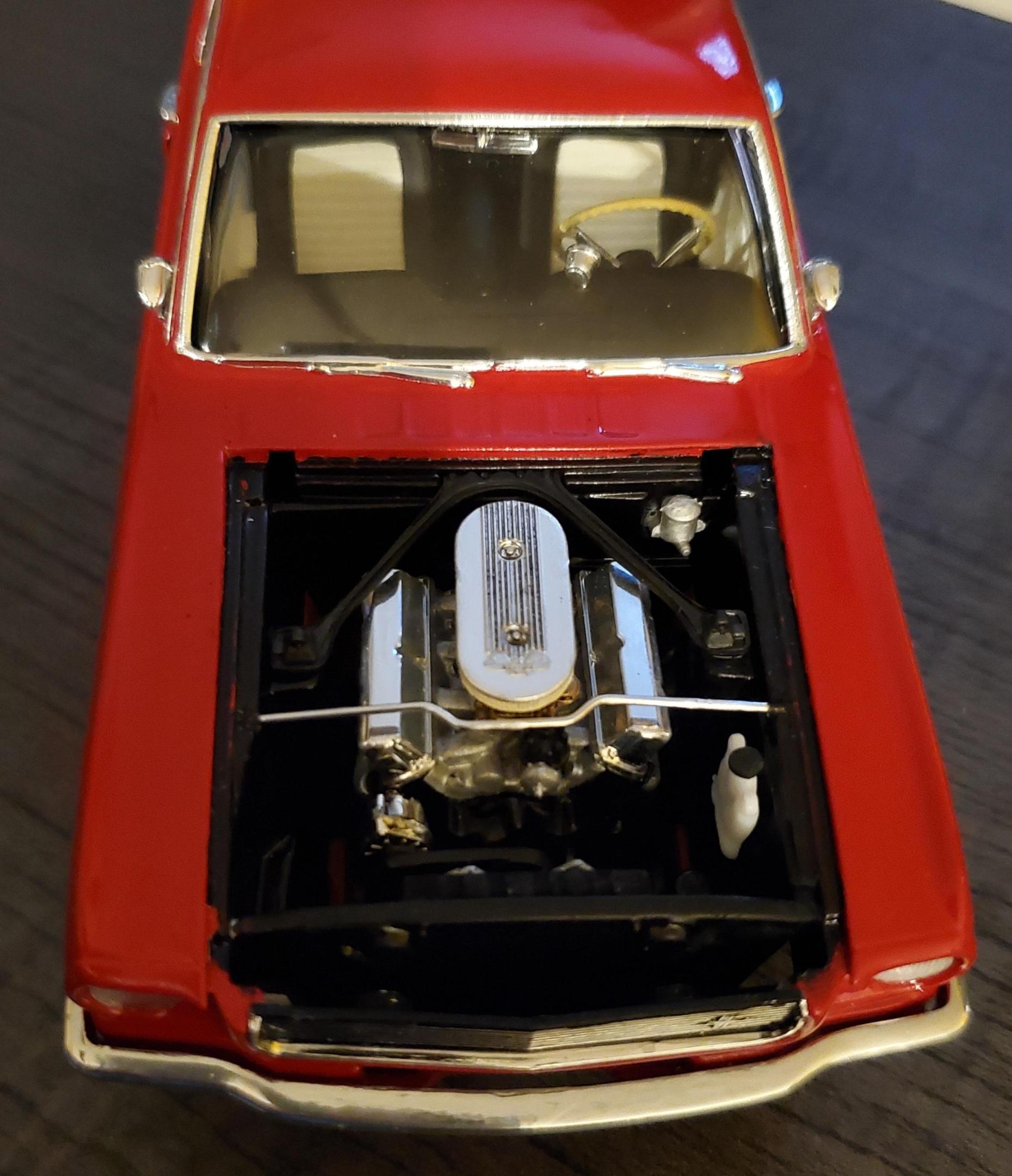

Fat Brian Posted January 19, 2024 Posted January 19, 2024 On 1/18/2024 at 8:34 AM, Matt Bacon said: PS... it also looks as though I can drop the 427 back into the Mustang, for a rare-groove but period-correct option. Win all round... best, M. Expand Here's a build I did of the Monogram 66 Mustang kit with the Cobra 427 in it. The 427 has the Cobra road race oil pan so you might have to cut it off and find a replacement. My engine has the block and oil pan from the Monogram 69 Talladega kit with the Cobra heads, valve covers and intake. I switch the C6 from the Talladega for a manual transmission. Fitting any exhaust manifolds was a huge problem. I had to sand the inside face of the shock towers until they were literally paper thin and run the manifolds from the AMT 66 Galaxie. It's a cool build though and impressive once it's in there. 2 1
