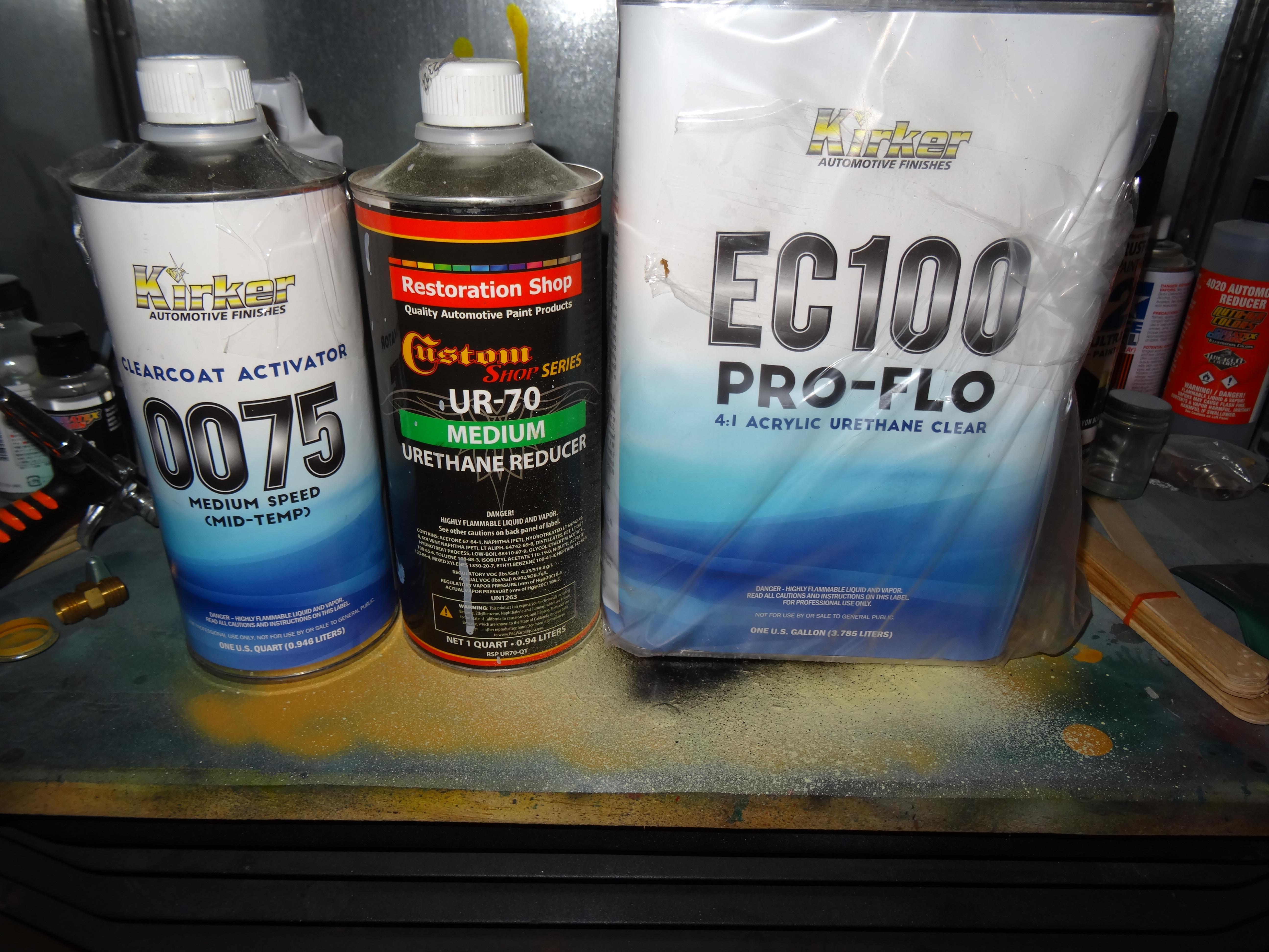

TransAmMike Posted July 1, 2024 Posted July 1, 2024 18 minutes ago, LennyB said: Yes, Mike, I like working with the 2K. Thanks for stopping in. What 2K did you use. I've never tried it.
customline Posted July 1, 2024 Posted July 1, 2024 (edited) Awright, that's it! What's the deal with this so called 2K clear? What is it ? and why do I keep seeing it on these pages? It's like it just sprung up in the last couple of months and now it's everywhere I go now. Can someone please clue me in? Am I that ignorant? (Well, possibly ?) Edit: nice job on the rear end work, Lenny, it looks a lot better ? Edited July 1, 2024 by customline 1
LennyB Posted July 1, 2024 Author Posted July 1, 2024 22 hours ago, TransAmMike said: What 2K did you use. I've never tried it. Mike, This is what I used on my recent builds. After I got annoyed with the lack of progress I was making with other clears, which I think is documented earlier in this thread, I went out to the garage and grabbed this automotive clear that was left over from a 1:1 build and never looked back. It might seem expensive to buy a gallon of clear at @ $75.00 but it will last a long time. 3 hours ago, customline said: Awright, that's it! What's the deal with this so called 2K clear? What is it ? and why do I keep seeing it on these pages? It's like it just sprung up in the last couple of months and now it's everywhere I go now. Can someone please clue me in? Am I that ignorant? (Well, possibly ?) Edit: nice job on the rear end work, Lenny, it looks a lot better ? Jim, I can understand as the term 2K is rather generic and has nothing to do with Y2K. The 2K really means that you need a catalyst or hardener with the clear. I have been using this mixed with the hardener straight for the first couple of coats and then add in some reducer for the final coat so it flows out nice. Wet sanding before the final coat. On this coupe I only had to sand out a couple of blems on the drivers door otherwise the shine is as sprayed. I've done four bodies this way in the last couple of months and except for some fisheyes on the 1963 Plymouth I'm happy with the result. One thing I think is important with this is to have a dedicated airbrush for just the clear. I think that was the cause of my fisheyes. The stuff dries so that you can handle it in a couple of hours and hard as a rock after a couple of days. So if you do have to wetsand or polish it you will want to do it within 48 hours.
TransAmMike Posted July 2, 2024 Posted July 2, 2024 Yeah that's waaaay outta my price range for the very occasional use. I'm sure there are some specific model 2k in a smaller quantity. I know Splash has one but like I said, never used the stuff.
customline Posted July 2, 2024 Posted July 2, 2024 2 hours ago, LennyB said: Mike, This is what I used on my recent builds. After I got annoyed with the lack of progress I was making with other clears, which I think is documented earlier in this thread, I went out to the garage and grabbed this automotive clear that was left over from a 1:1 build and never looked back. It might seem expensive to buy a gallon of clear at @ $75.00 but it will last a long time. Jim, I can understand as the term 2K is rather generic and has nothing to do with Y2K. The 2K really means that you need a catalyst or hardener with the clear. I have been using this mixed with the hardener straight for the first couple of coats and then add in some reducer for the final coat so it flows out nice. Wet sanding before the final coat. On this coupe I only had to sand out a couple of blems on the drivers door otherwise the shine is as sprayed. I've done four bodies this way in the last couple of months and except for some fisheyes on the 1963 Plymouth I'm happy with the result. One thing I think is important with this is to have a dedicated airbrush for just the clear. I think that was the cause of my fisheyes. The stuff dries so that you can handle it in a couple of hours and hard as a rock after a couple of days. So if you do have to wetsand or polish it you will want to do it within 48 hours. Thanks, Len. I figured it was more complicated than I am willing to get into. It's not for me. I am glad it works for you, though, it looks terrific.
LennyB Posted July 2, 2024 Author Posted July 2, 2024 11 hours ago, TransAmMike said: Yeah that's waaaay outta my price range for the very occasional use. I'm sure there are some specific model 2k in a smaller quantity. I know Splash has one but like I said, never used the stuff. It works for me as I also use it for full size cars. You can buy it in smaller quantities so you could look into that.
