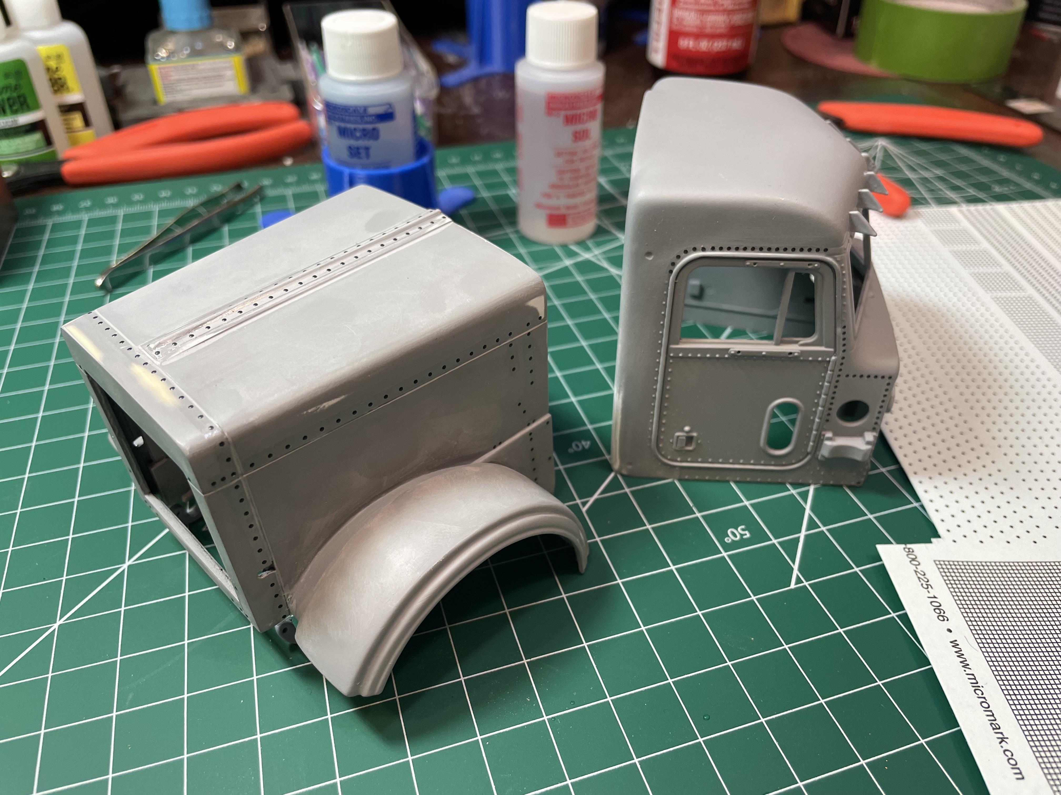

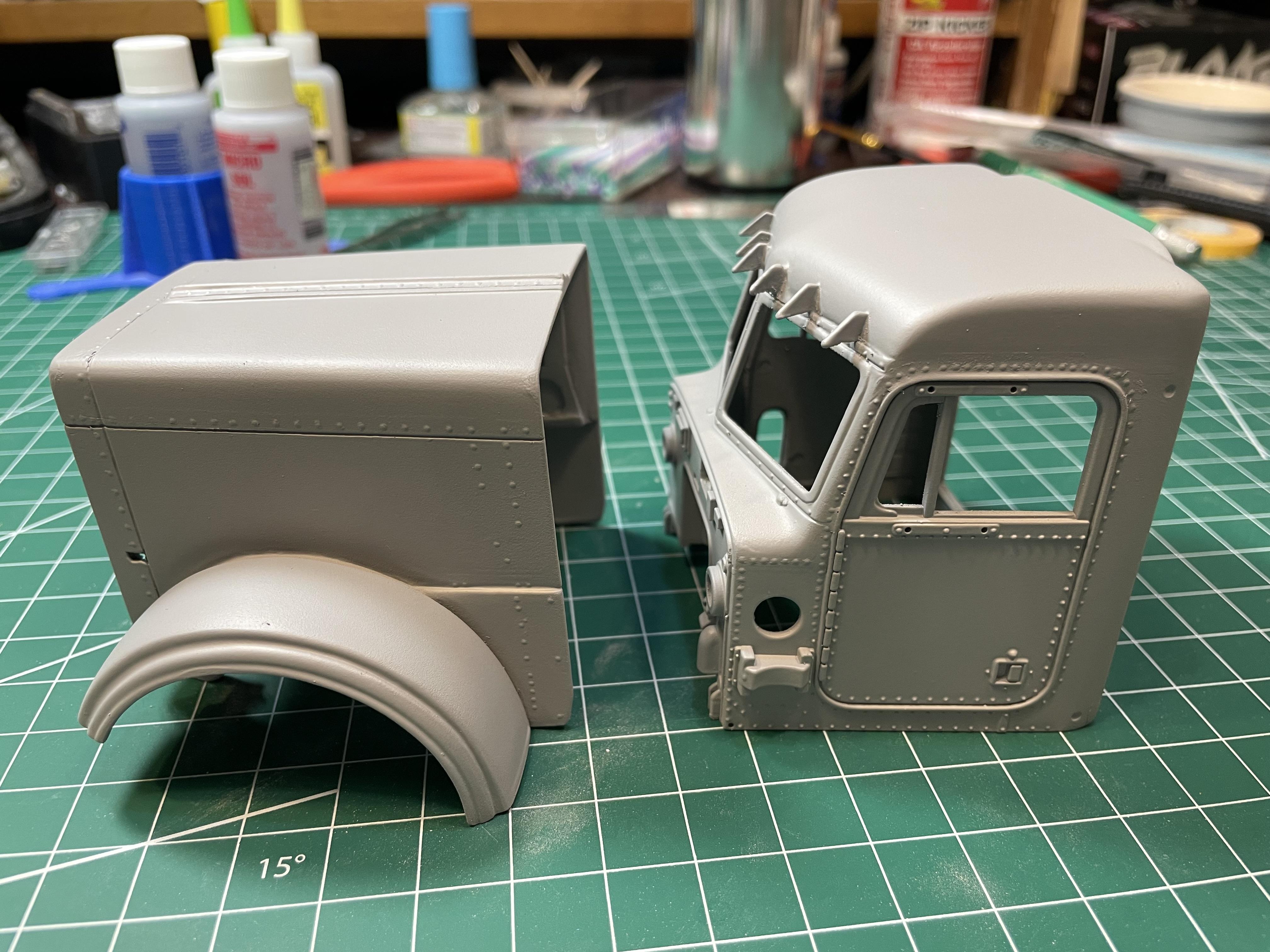

After taking the summer and early fall away from the project, it’s back on the bench. I added the micro-mark rivet decals to the cab and hood to replace those lost to the putty and sanding process. Plus, I added rivets to the hood side near the cowl and the lower hood extensions that were not part of the original casting. There’s still a bit more sanding and touch-up before a final primer coat. IMG_9902.thumb.jpeg.ff121e64aec028853bcb30cb808dd2de.jpegIMG_9903.thumb.jpeg.a686c67b5aa9645e563504d6a56e43a2.jpeg

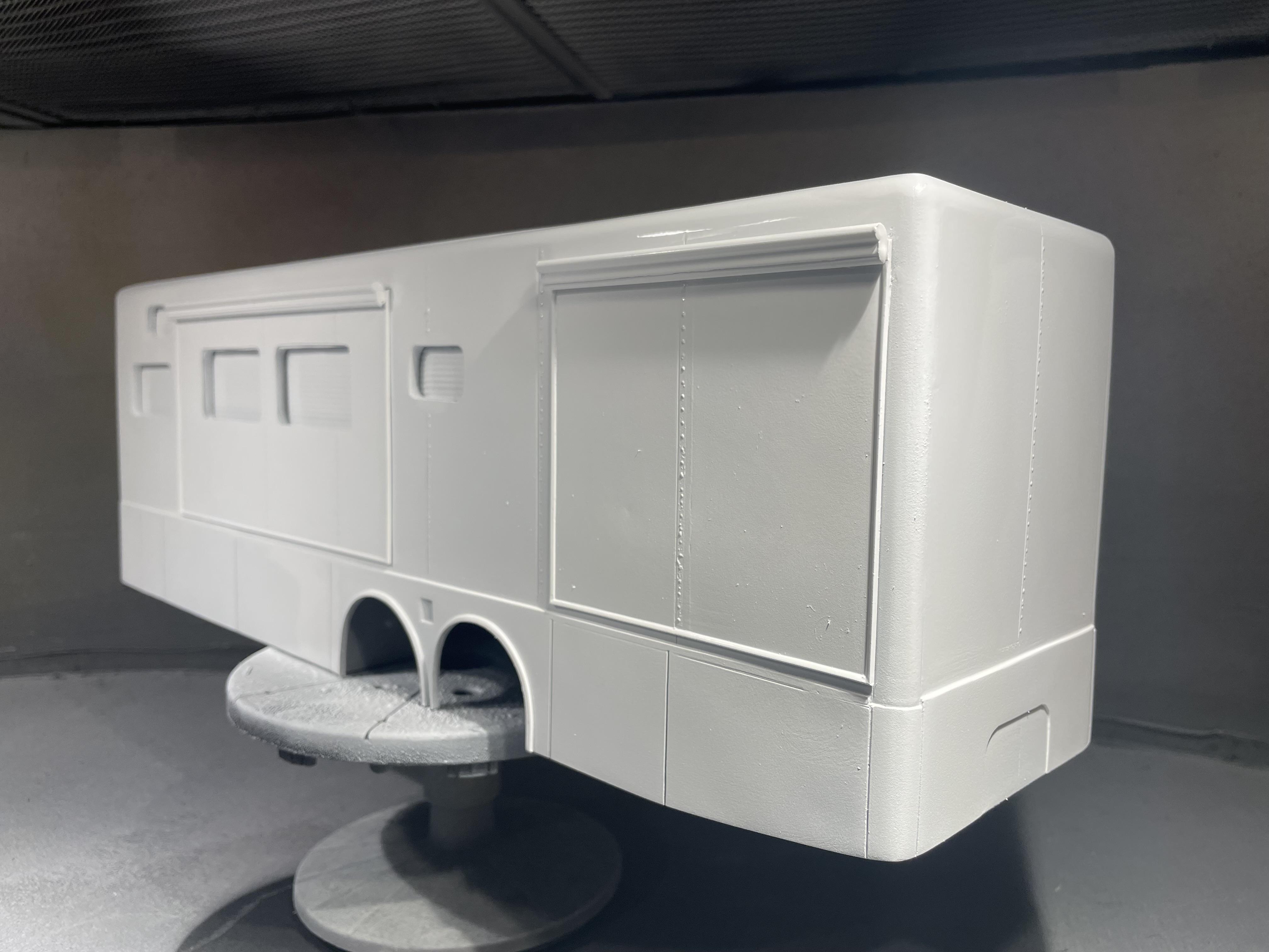

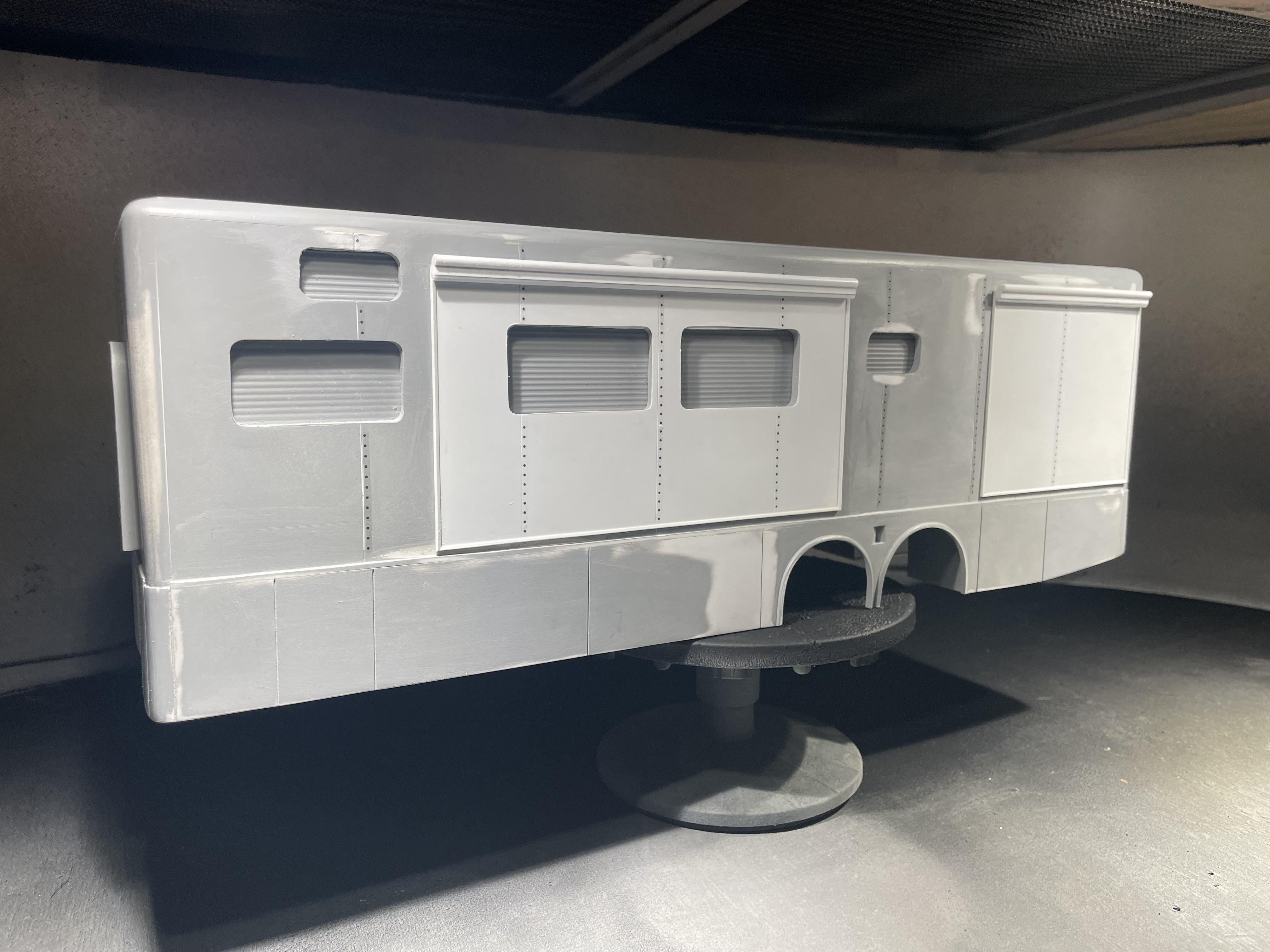

The next update includes the coach’s slide-out wall detail, and the slide-out topper/awning units. I scribed the side panels and they’ll receive the rivet detail next.
I ultimately decided that I’m going to add the rivet detail, though most manufactures have gone to using a special tape to adhere the aluminum skin. NRC Modifications still use rivets, and that’s the custom toterhome manufacturer this build is based on. That’ll be next, before the final primer coat.IMG_0175.thumb.jpeg.e8ac2beb7a3e3b9bf2492706fe48d66d.jpegIMG_0176.thumb.jpeg.a4fb739af3413781a71aecdb1e5c9223.jpegIMG_0174.thumb.jpeg.55c74788af04ce735822e52c5ae9c394.jpeg
I’ve also made four modern high end style roof-mounted awning units, two on each side, along with a front awning fairing. The fairing was customized from a ford LTL cab visor, and it will include clearance and marker lights. The rectangular door panel above the wheel wells is for an outdoor entertainment center.
All of the slides and doors are non-functioning. I’m crazy, but to make everything operate demands a higher level of crazy than what I’m willing to give.

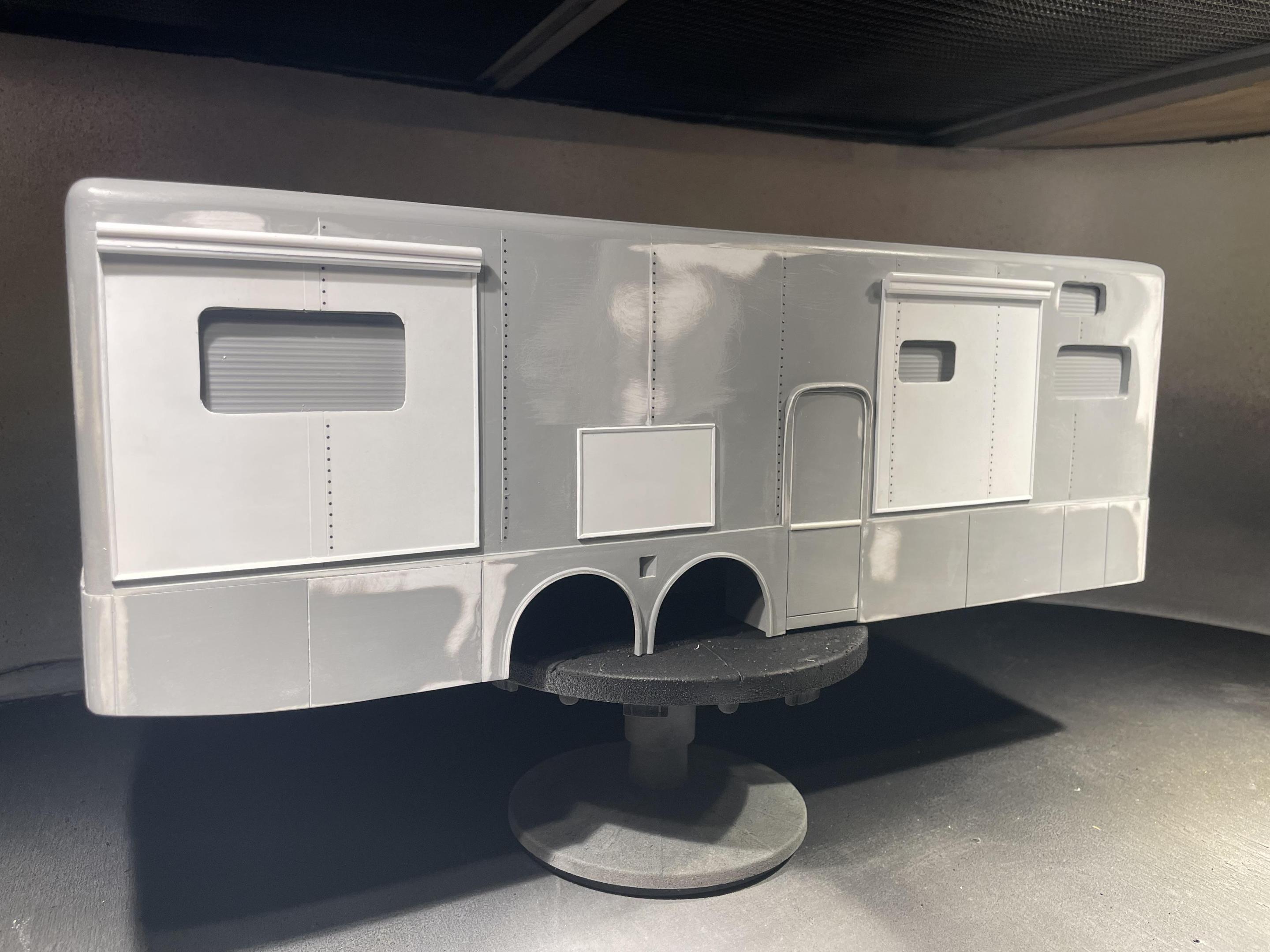

Got the rivet decals applied.IMG_0212.thumb.jpeg.f19bb7a0dd399673c5d4ea8fd954b266.jpegIMG_0211.thumb.jpeg.987cb77329688d9b57b71edca21a9093.jpeg
To be honest, they are annoying to work with. They are the ones from Micro Mark. Maybe a different brand would be better? They are much more fragile than typical decals. After applying the rivets, I added another coat of primer. A little more touch up body work and then the final primer coat will be next.
